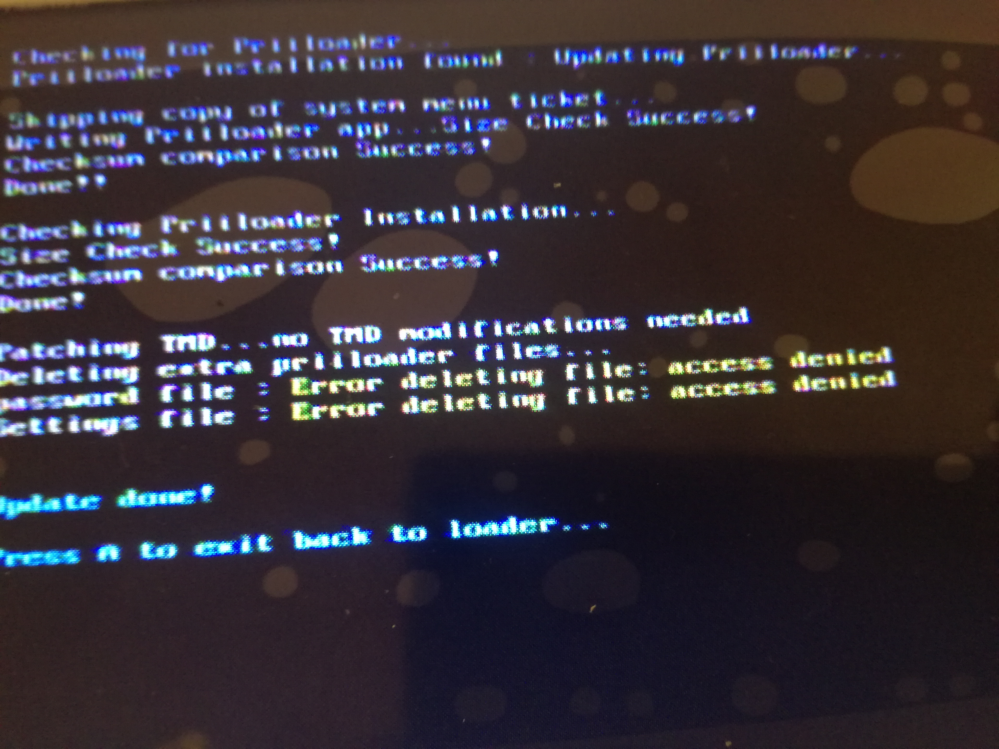

Hello everybody
I have a vga priiloader installation error, how can I fix it?
Thanks
sorry for bad english.

It wasn't able to delete the settings and password file, probably because they weren't there, but the installation went fine
