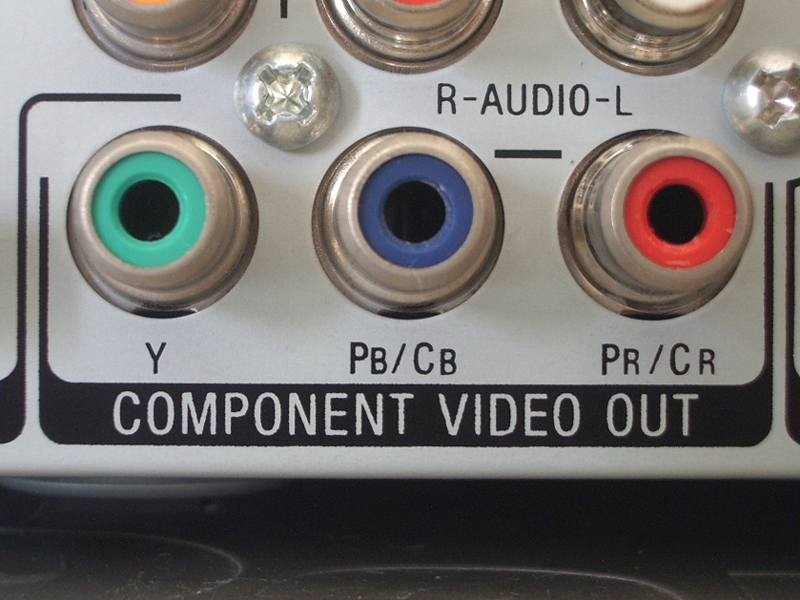

I found the cause of the color problem. I soldered the wires based on the pin colors of this official guide image:
I'm going to do new tests now.
Maybe this is the problem @Gunstar.
That's definitely the issue.
When in doubt, go by the text, not the colors.
The vídeo it's now crystal clear lol
I really did not expect this little mistake in the guide
Thanks for the support.
It's not a mistake in the guide. The colors are matched to the YPbPr component video standard connector colors

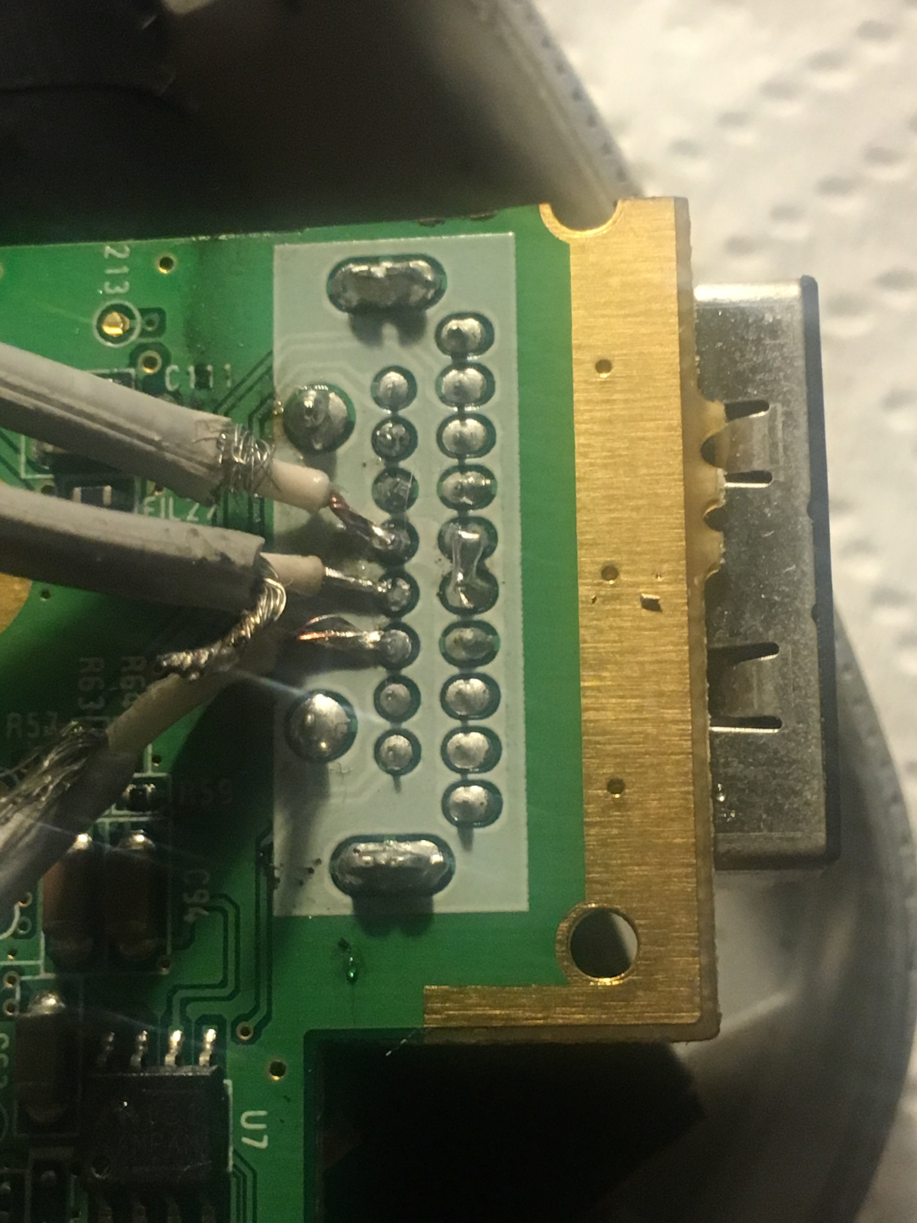

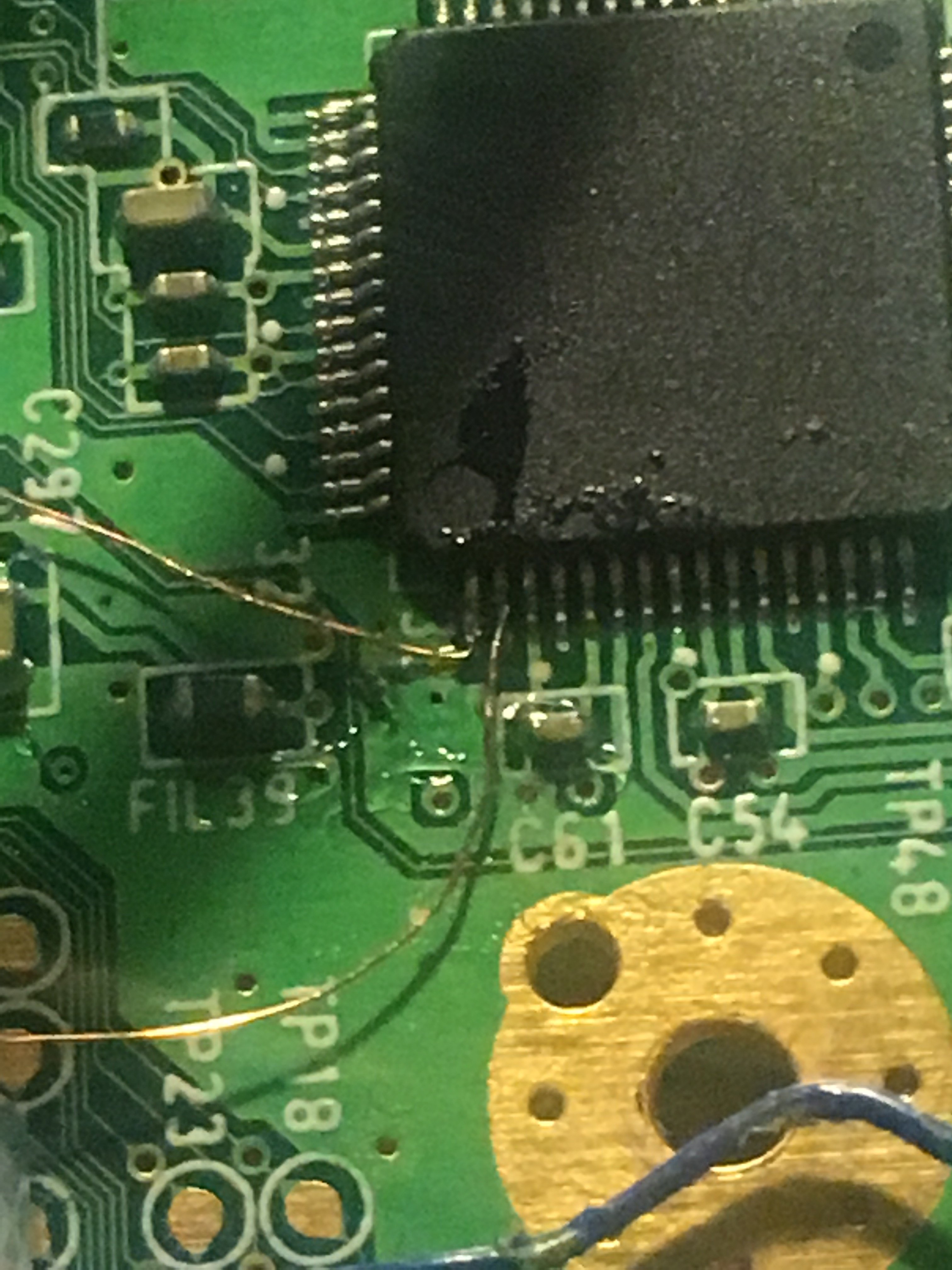

Hi. I have installed the VGA priiloader patch but I am not getting any sync on my screen at all. I reconnected composite and saw that in the settings editor GUI the video output was set to 480p video. The Wii works just fine in composite when connected and boots to the settings editor GUI. Here is some pictures of my wiring. I checked continuity of all of my wiring and everything is connected correctly. I haven't grounded any of the RGB signals but I have a ground wire running from the Wii to ground on my screen driver board.
Is there any way I can check that VGA priiloader was installed successfully?
Make sure you haven't flipped hsync and vsync. I remember that some vga screns from china have swapped labels
I have checked both and I'm still not getting a signal. Could it be software related?
My screen and driver board are the following Dalian models. The silkscreeen for the keyboard screen controls was reversed so I am wondering whether the pinout for VGA is also reversed as well...
