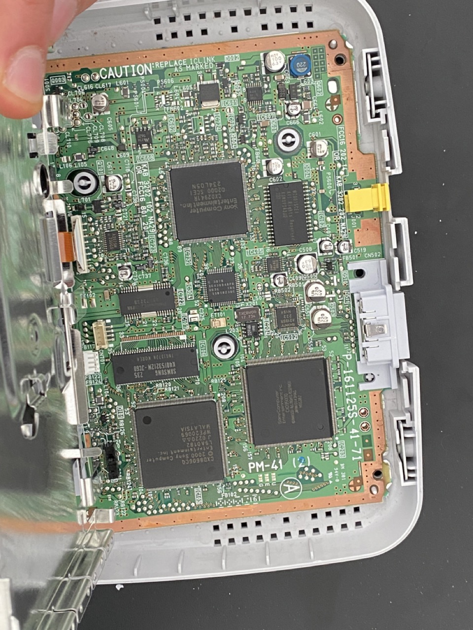

Would love to do the VGA Mod on this PSONE. I opened it but can't find the RGB, H and V sync soldering point.
Any new info would help a lot

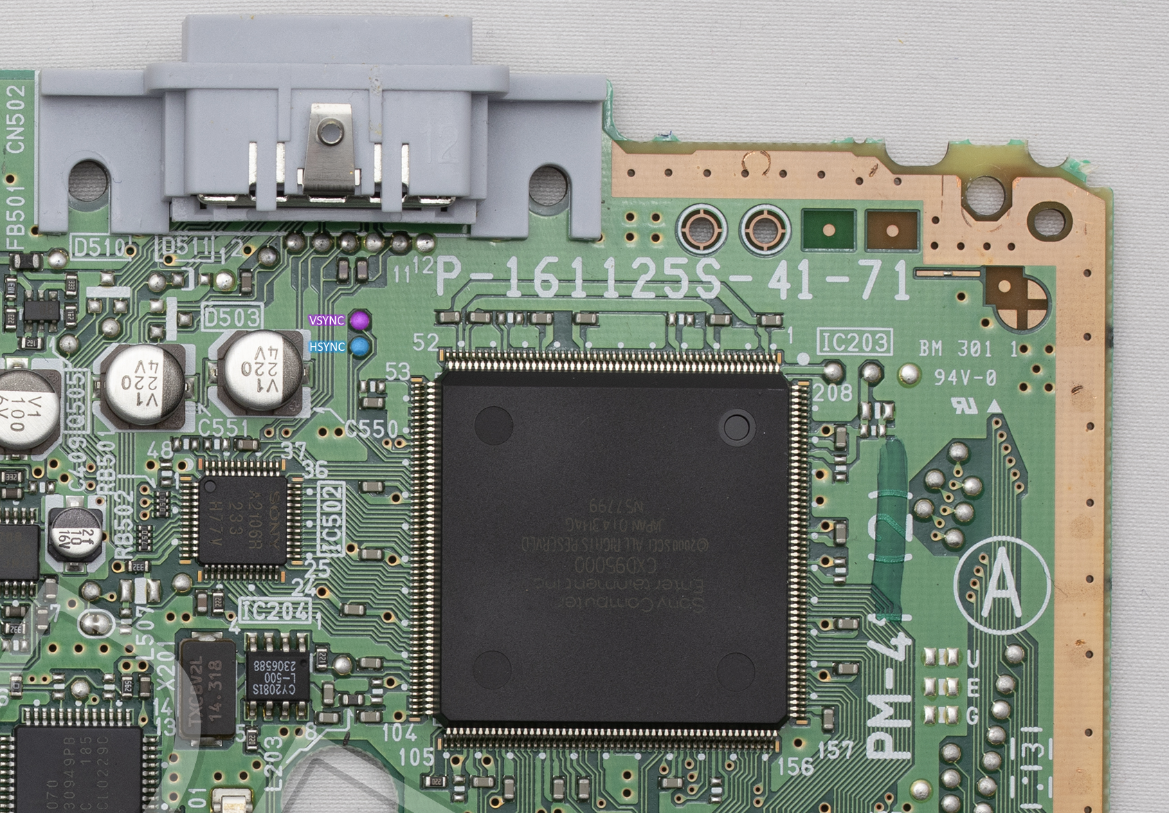

You literally quoted the post with the info you need. The H and V sync lines are here:
And the RGB lines you can pull directly from the AV port.

According to the silkscreen, IC203 is the bottom right chip. Wesk said the pinout is the same as the original PS1 GPU, so the HV sync pins are in the circled area. Whether there are any convenient solder points for these pins, I can't say, the image isn't zoomed in enough. You may have to solder magnet/kynar wire to the legs of the GPU, same as the Wii VGA mod.
Looks like that's a PM-41 (2) which has the GPU RAM combined into the GPU. The pinout is "rotated" slightly compared to the original GPU, but you can still grab H-Sync and V-Sync from these convenient solder pads! Pin 64 is VSYNC and Pin 65 is HSYNC.

Those two VSYNC and HSYNC solder pads will be easier to work.

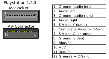

It may seems obvious, but how can I identify RGB ?
If I compare to the PSX, the blue should be this one ?

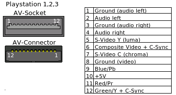

The AV pinout is the same across all PS1 models so you can look at the RGB wiring used earlier in the thread.

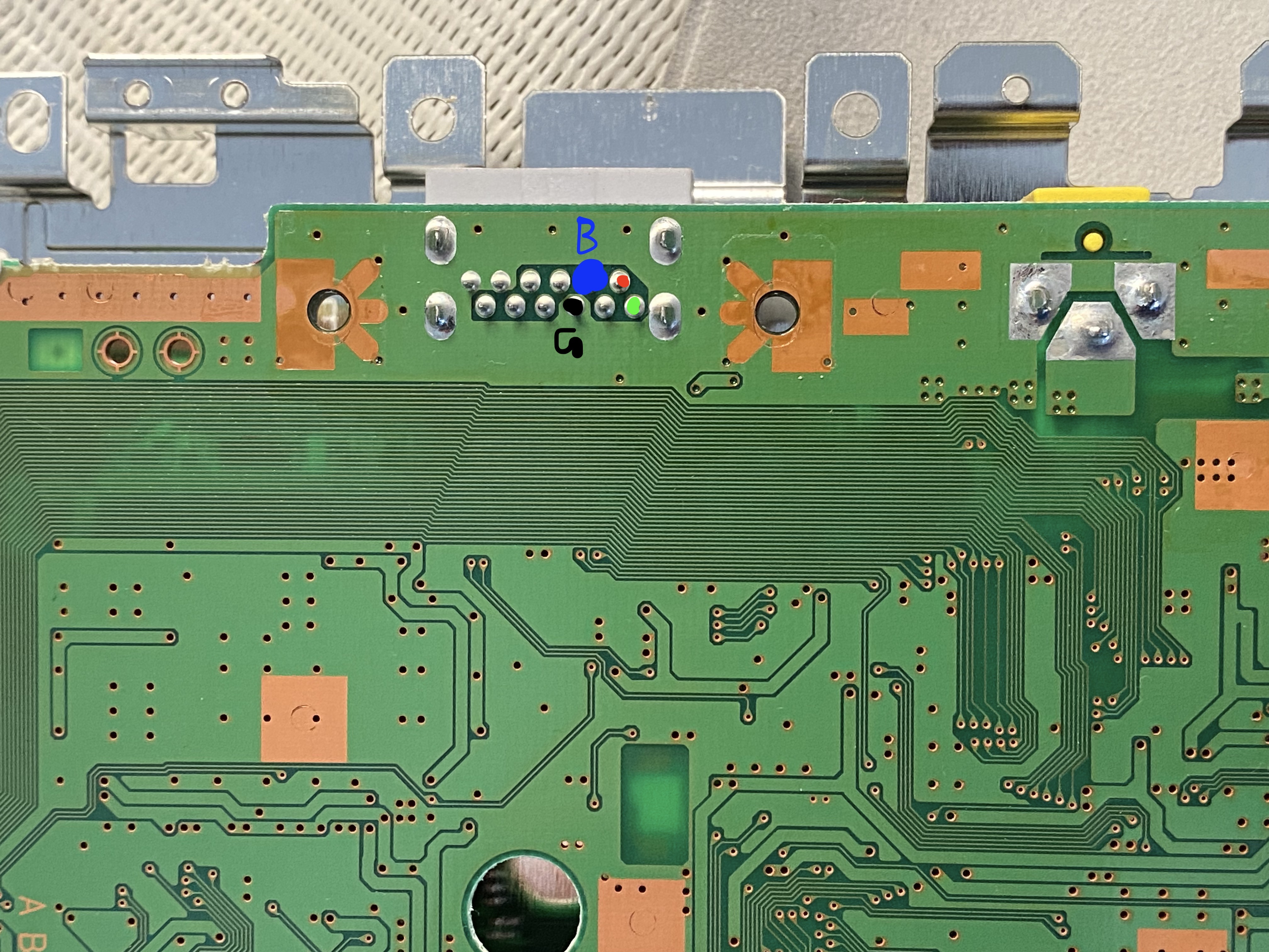

How/Where do I connect the ground contact(s) on the board? Based on the pictures from @Wesk and @buzzyc, it looks like you split the R, G, B cables into two and use the respective cable for both ground and the R/G/B signal, and no ground for H/V signal? Is that correct?
Can I just find a video ground connection on the board and connect it to pin 6 (for example) of the VGA connector? If so, where would I find that contact on the board? I can see where it's located on the SCPH-7501 based on the picture further up the thread, but cannot find the same spot for the SCPH-5502.

GND is GND, you can use any ground point for shielding the video lines. H and V sync don't need to be shielded in this particular instance.
Perfect, thanks for confirming!
I'll try to connect it like this:

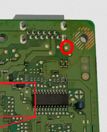

For PU-22, the process is exactly the same as PU-18 and a lot of other revisions. The GPU is the same between these revisions and also breaks out the H/V sync lines into convenient vias and test points.
Sorry for the crude diagrams, did them on my phone. Theres 2 locations for H/V sync, firstly some vias on the top of the board near the GPU:
Secondly, some test points on the bottom of the board (actually is where the vias on the top of the board connect to, just use whatever is easier):

The AV port pinout is universal, yes. All PS1s take the same cables
