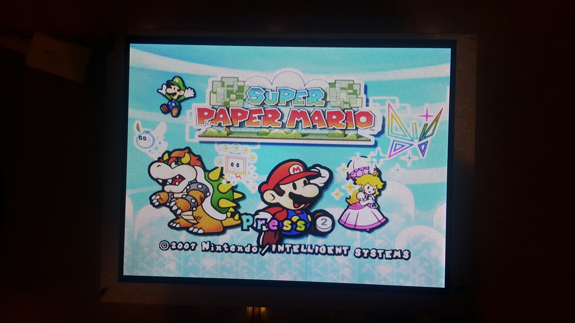

I found out I had the h and v on the wrong positions. I'm now getting a screen on both my units but they have a yellowish color. Vga pinout I attached is correct? Hmm I could try using thicker wires.

Make sure your blue line is connected properly. Your screen looks like only the R and G lines are connected.
Okay I used thicker wires and the colors are fixed but I'm still getting noise. I'm already using a thick wire for the ground.
