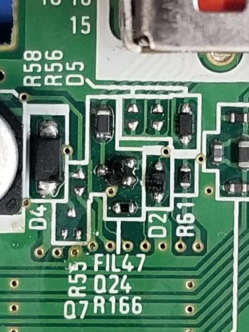

Which MODE pin is connected to 3.3v? Pin 8 or 10?
Im working on making a non invasive VGA cable out of a component cable and utilizing the unused data pins 14 15 and 16.
Ill put 3.3v on data pin 14,linked to the correct Mode pin and H V sync on 15 16.

Sorry If I come across as lazy asking, I just wanted to draw up what im doing before I open the Wii.

Look at the diagram. There's only one mode pin, pin 8. Pin 10 is actually 3.3V, so you don't need any extra pin to grab 3.3V, just short 8 and 10. There are some people who have used pins 15 and 16 for HV sync, but iirc you need to remove some resistors on the board that are usually connected there.
To free up data pins 14 15 16.
Remove R58 R56 R55 & Q7
