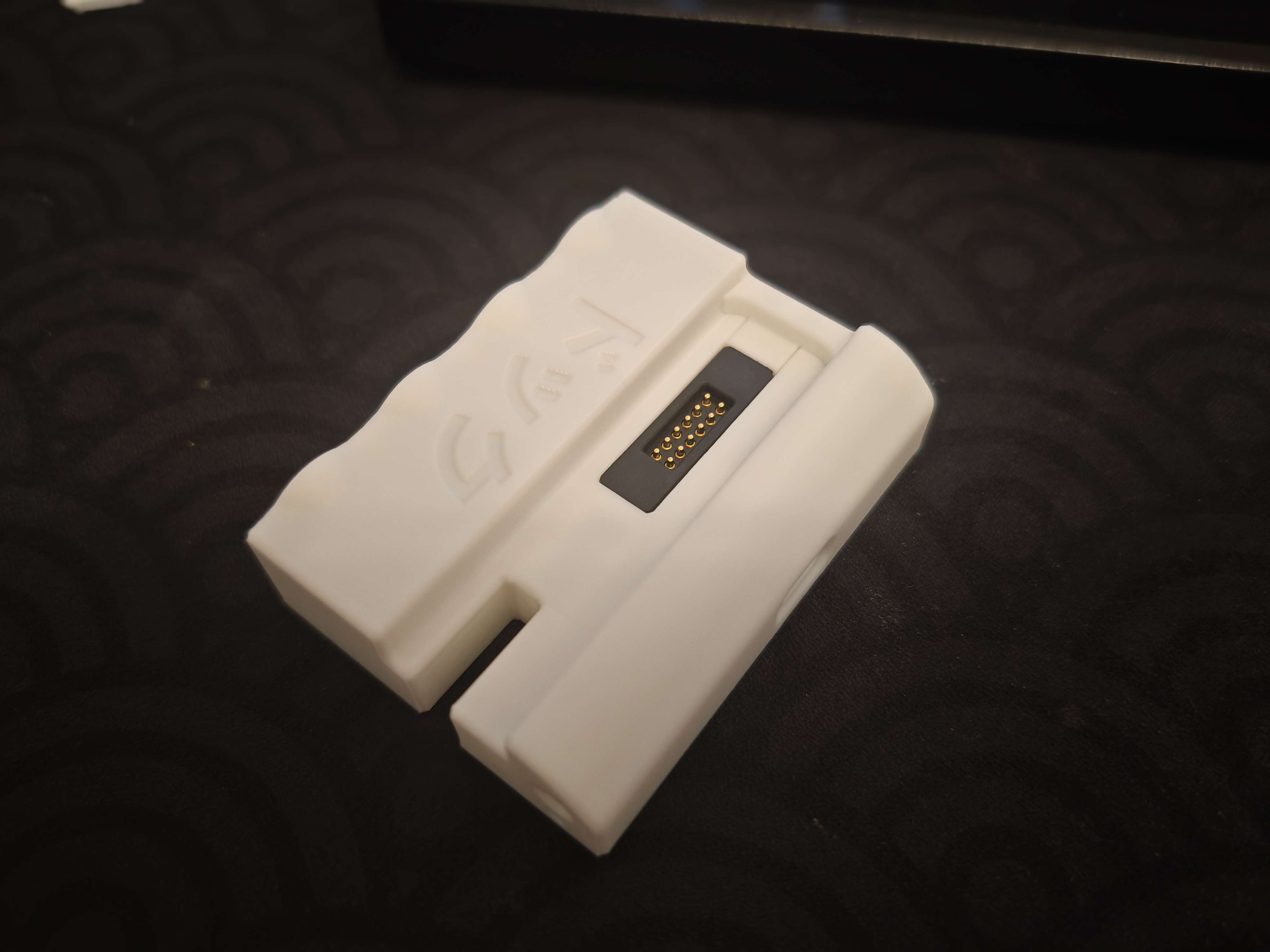

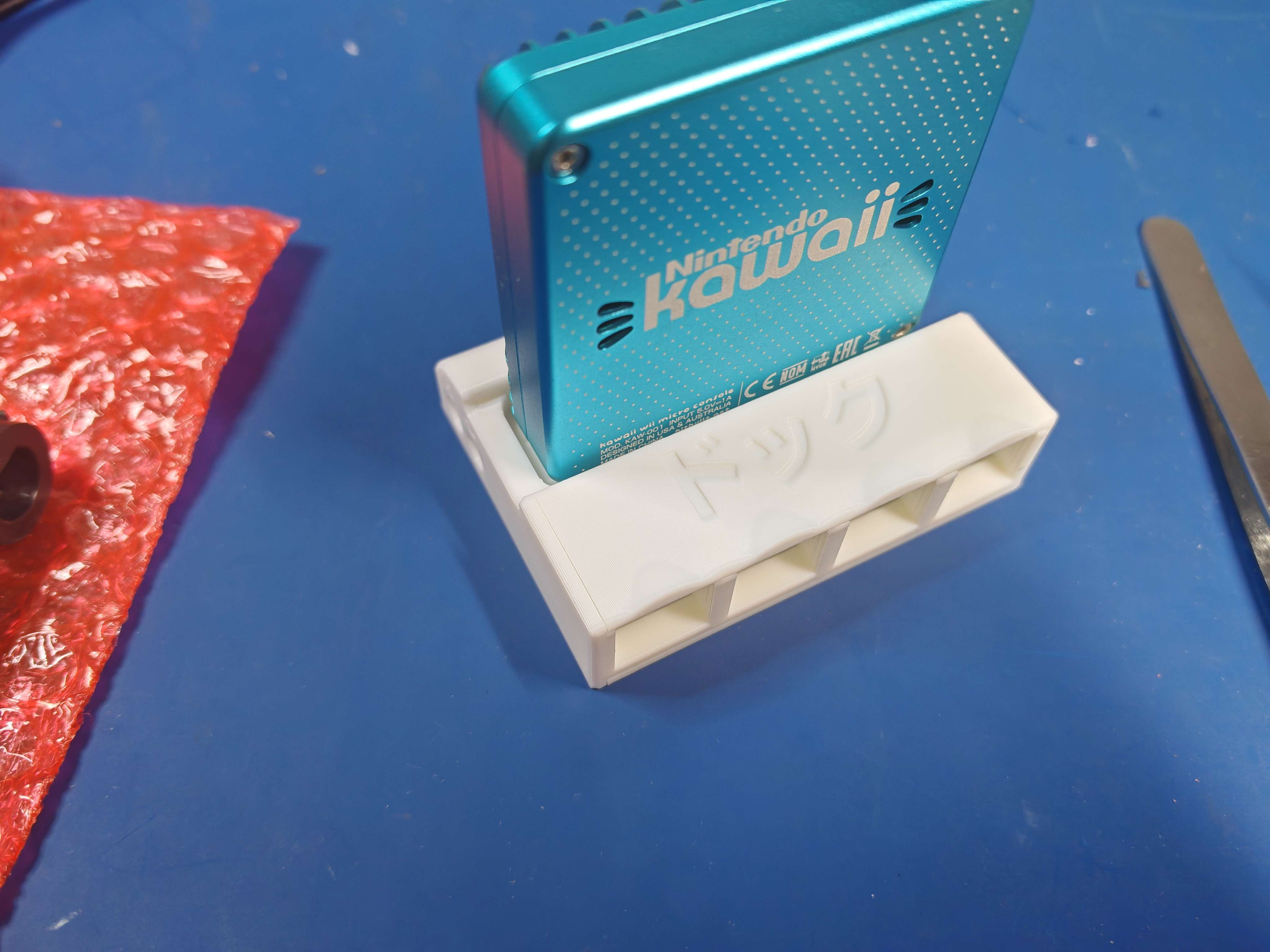

I got a Bambu X1C and did some test prints of the dock shell. Ended up adding a ridge alongside the Kawaii and tweaking the internal mechanics a bit.

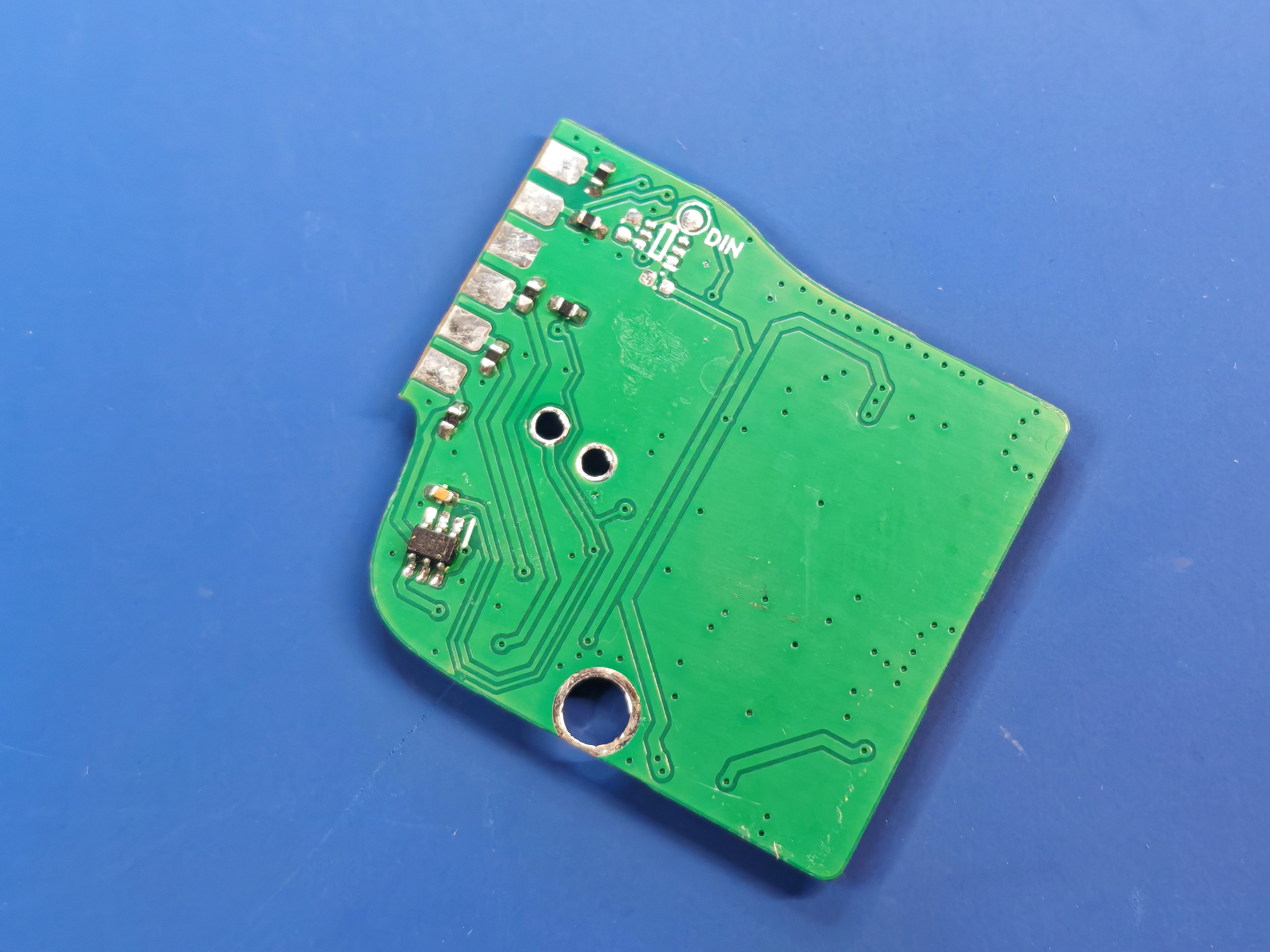

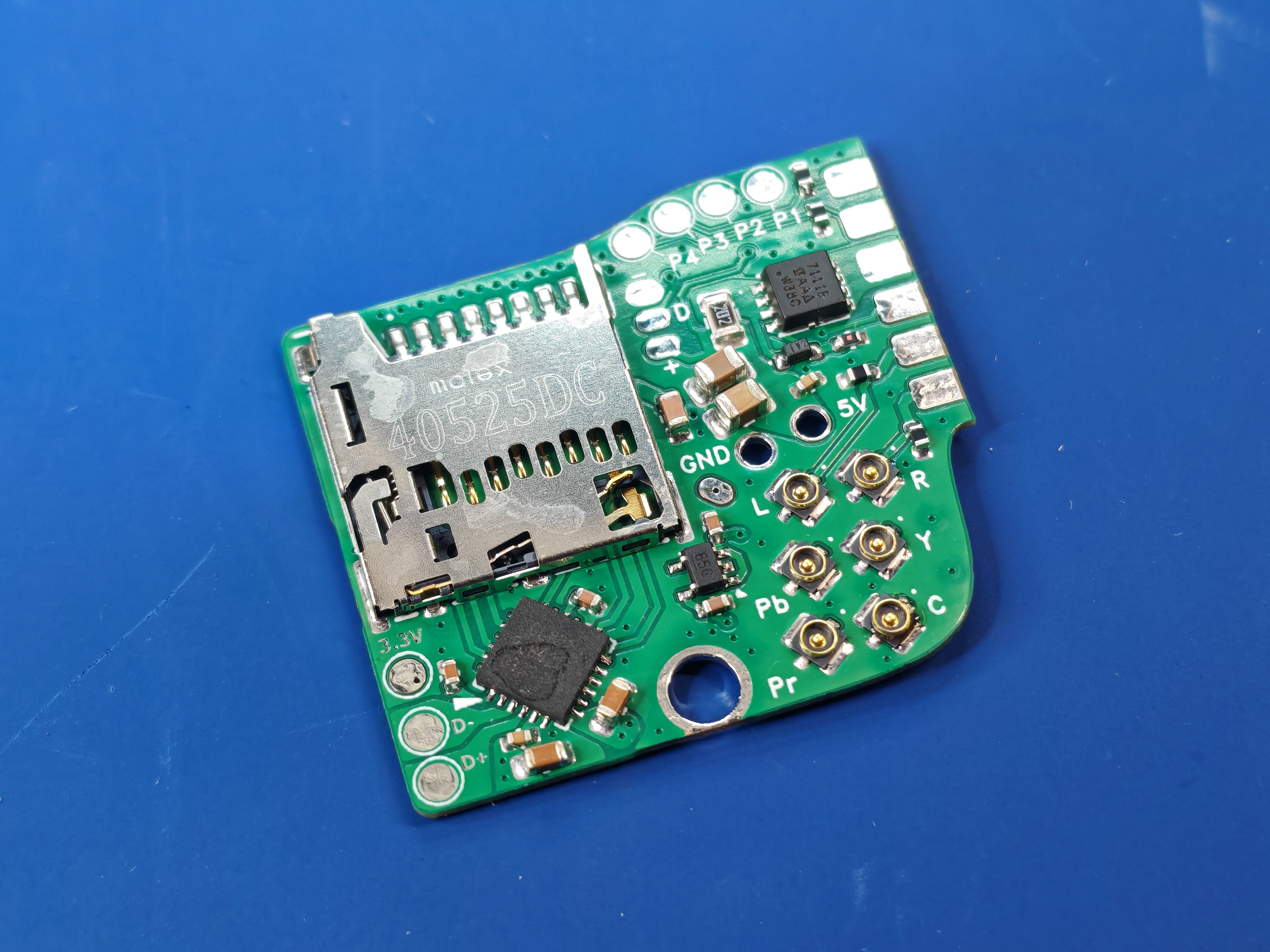

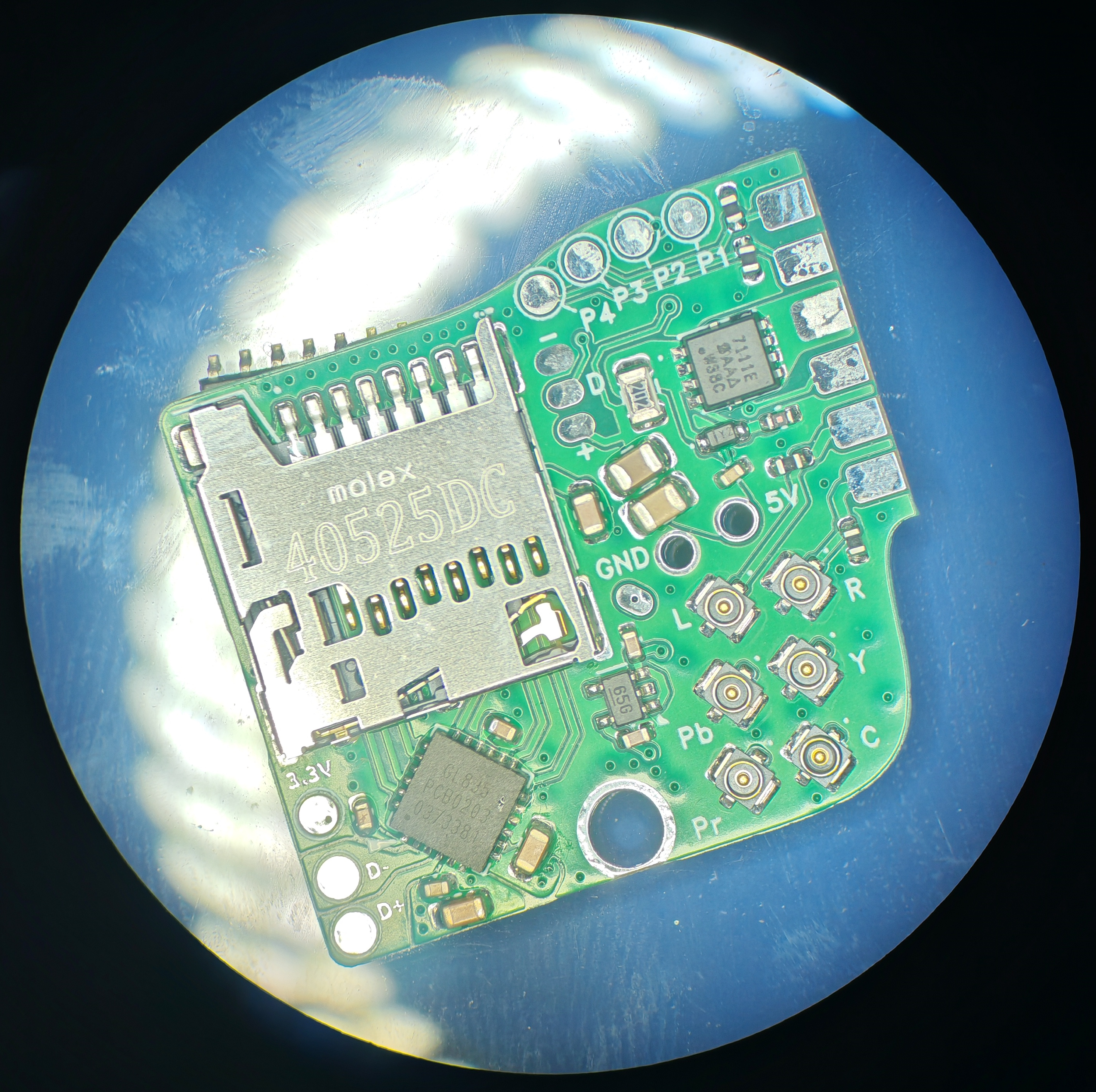

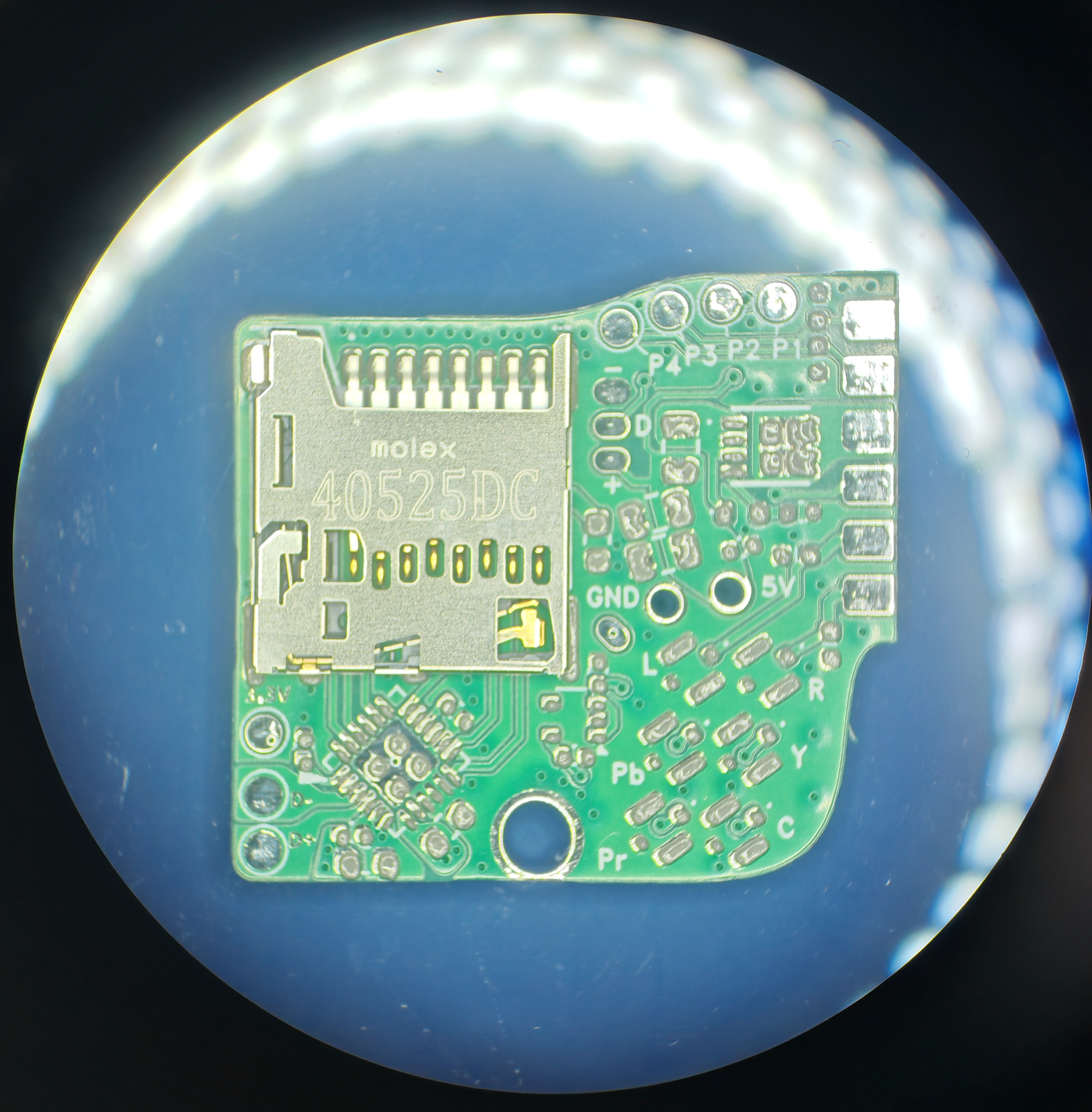

Then I started working on testing the internal Kawaii PCB!
I ordered the wrong size level shifter, so I'm unable to test the addressable RGB LED for now.

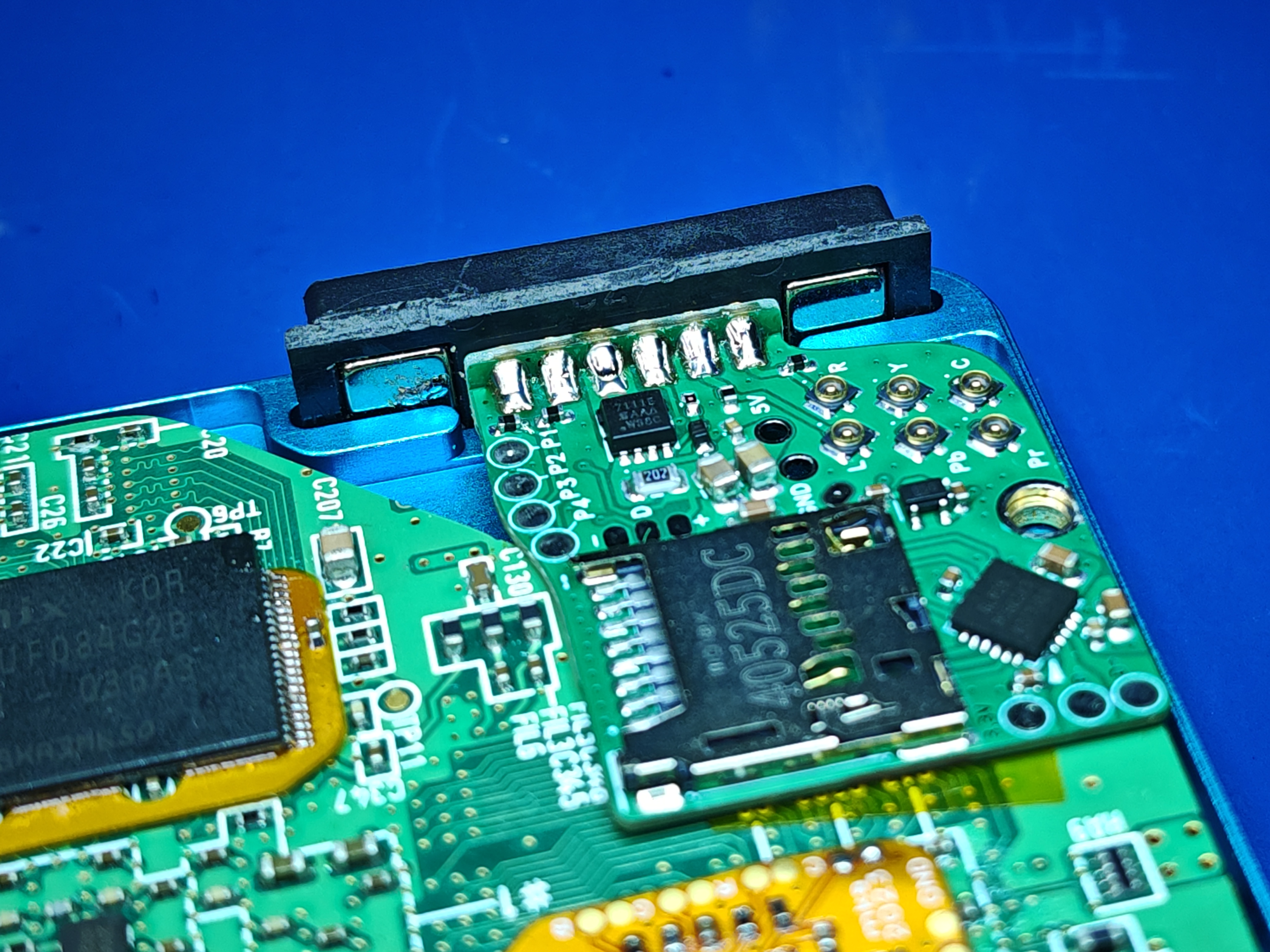

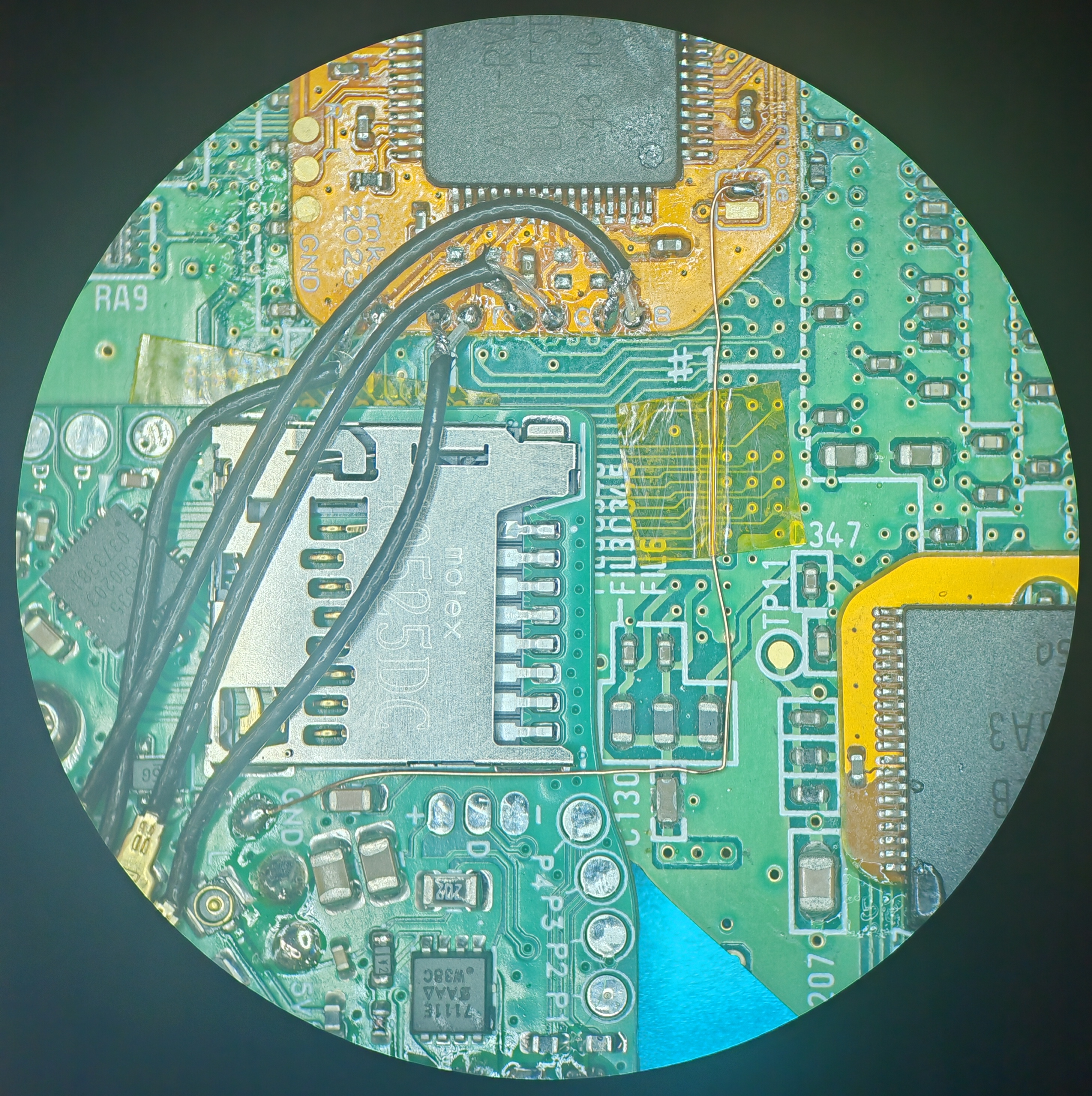

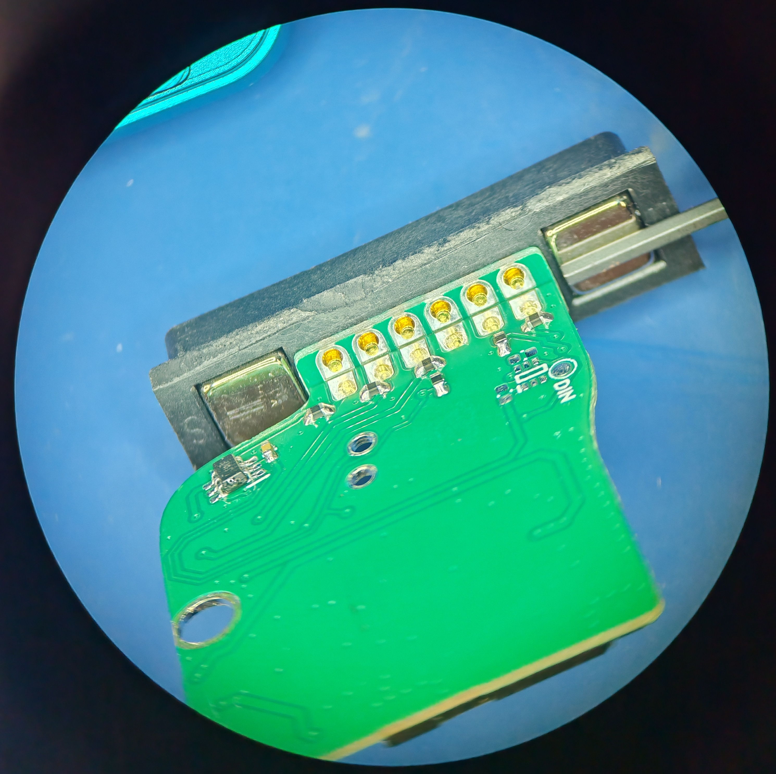

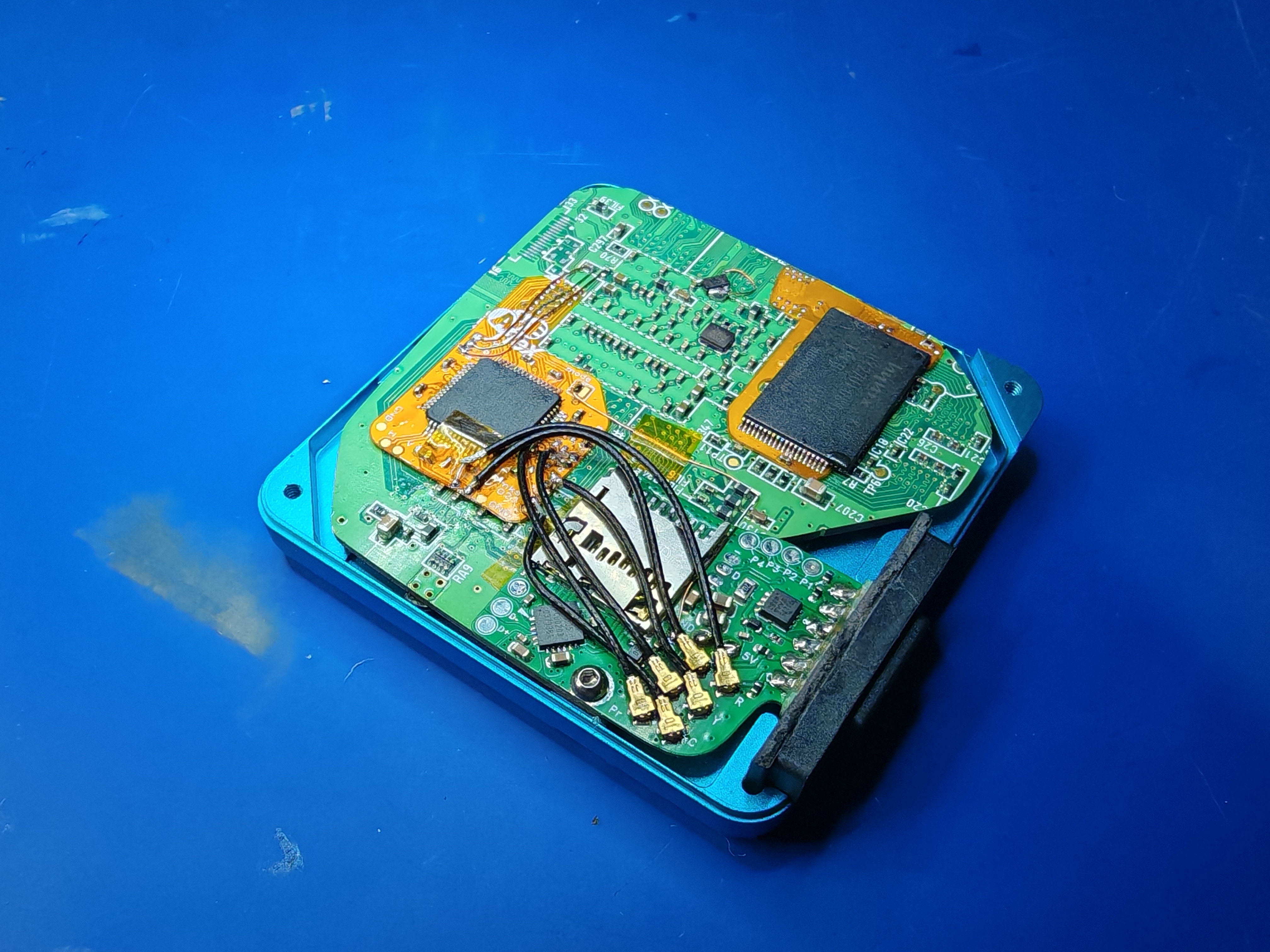

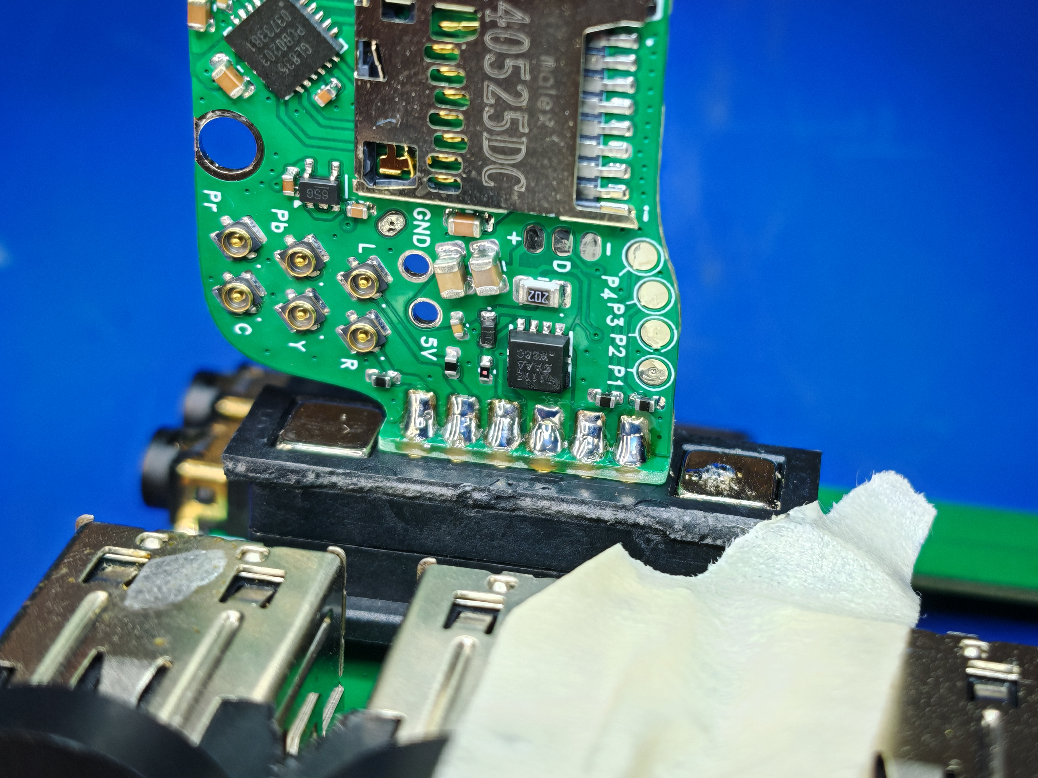

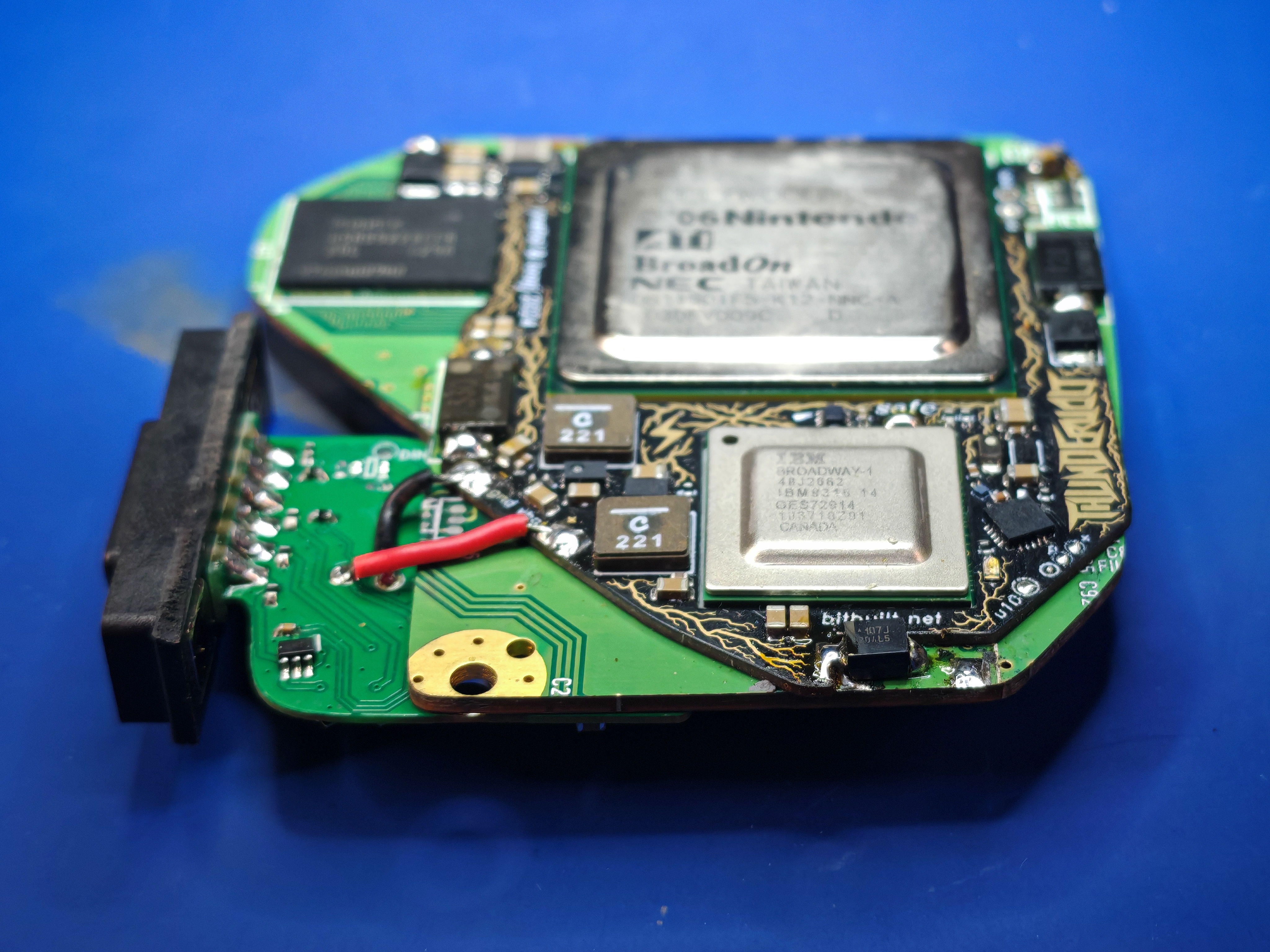

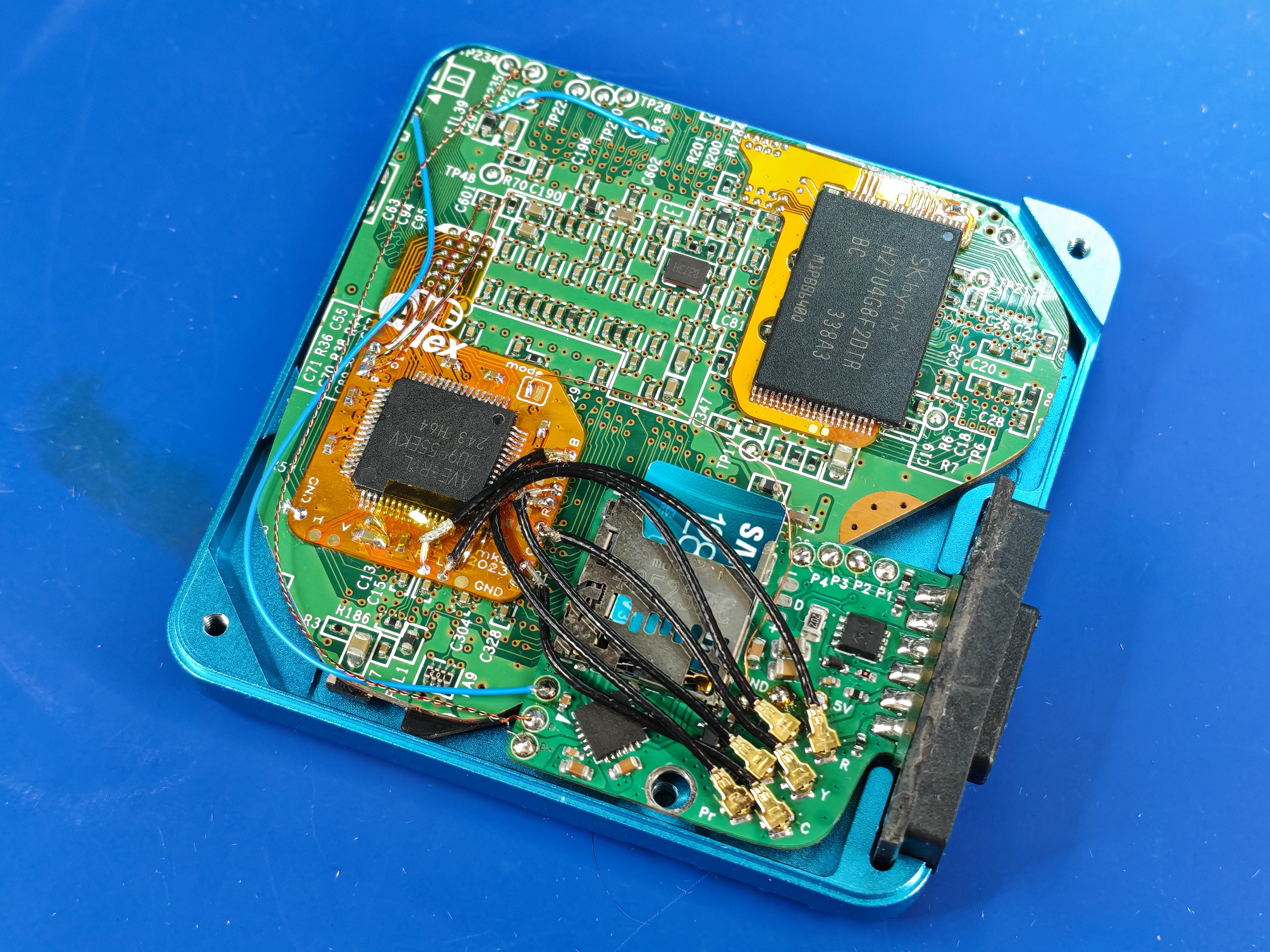

Detail of the pogo pin interposer PCB which helps the two boards solder together:

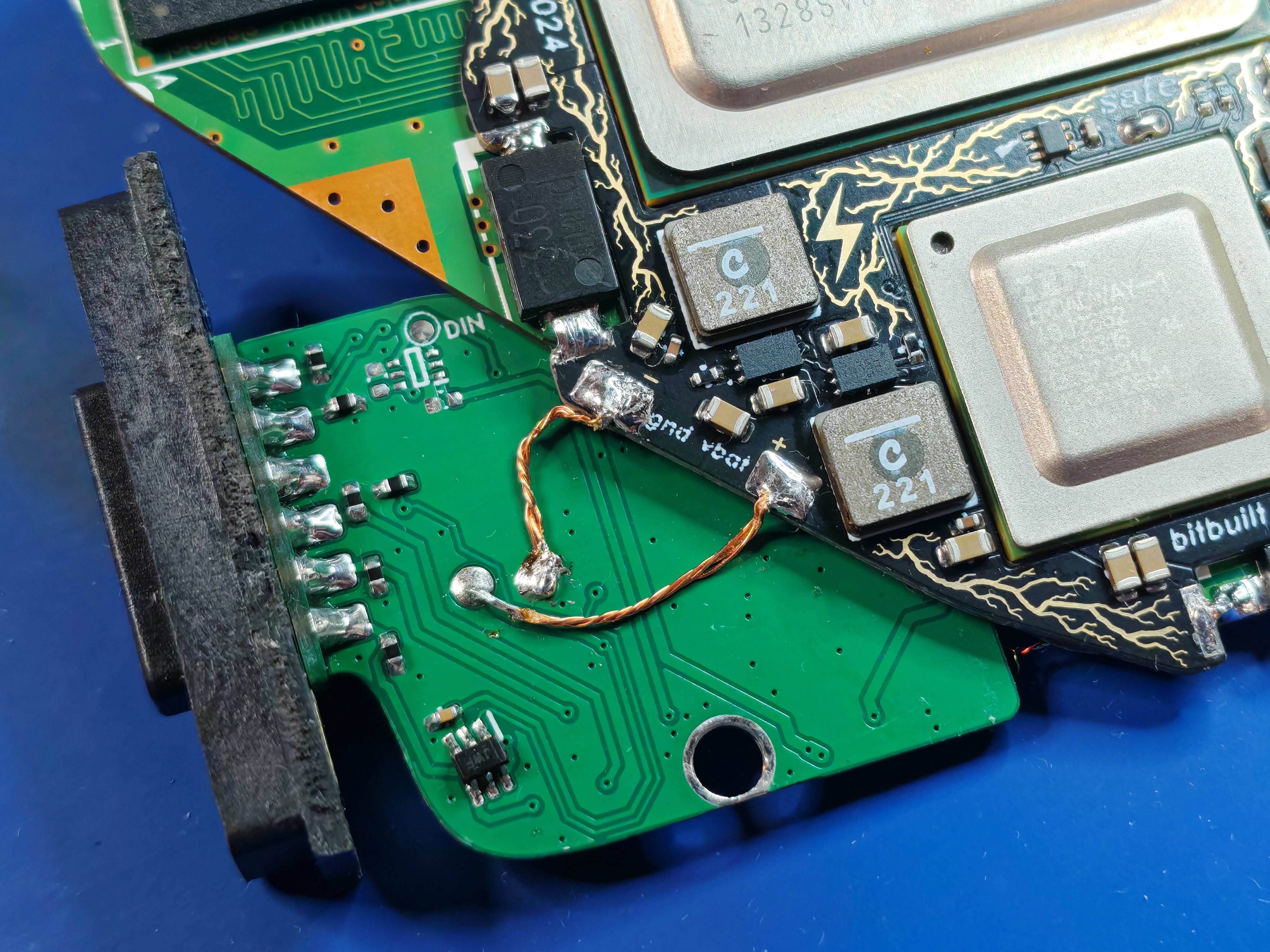

Internal PCB mated to the motherboard to create a three layer PCB sandwich:

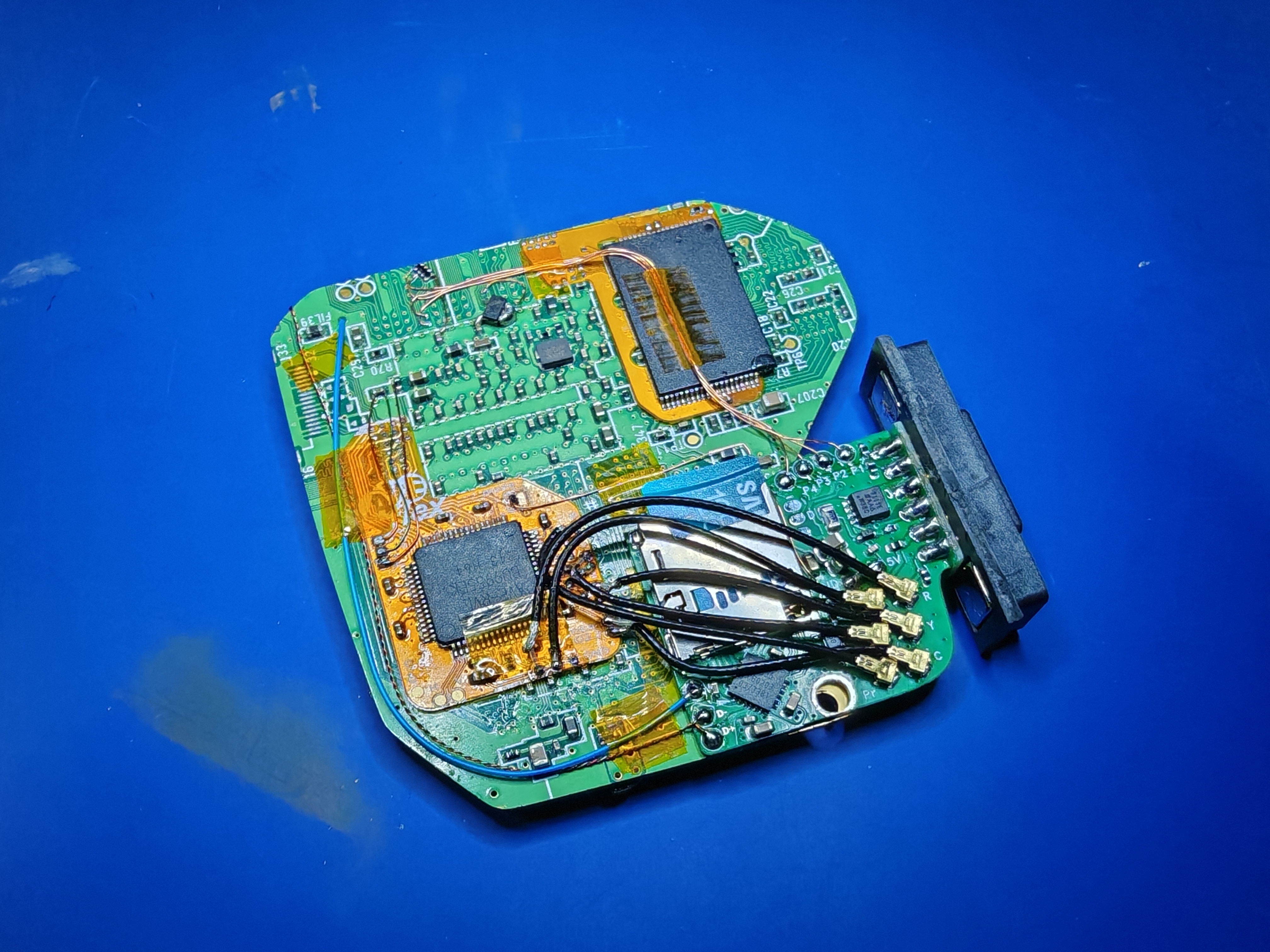

MHF4 RF0.81 coaxial pigtails deliver audio and video to the internal PCB:
Replacement 1.15V tantalum:

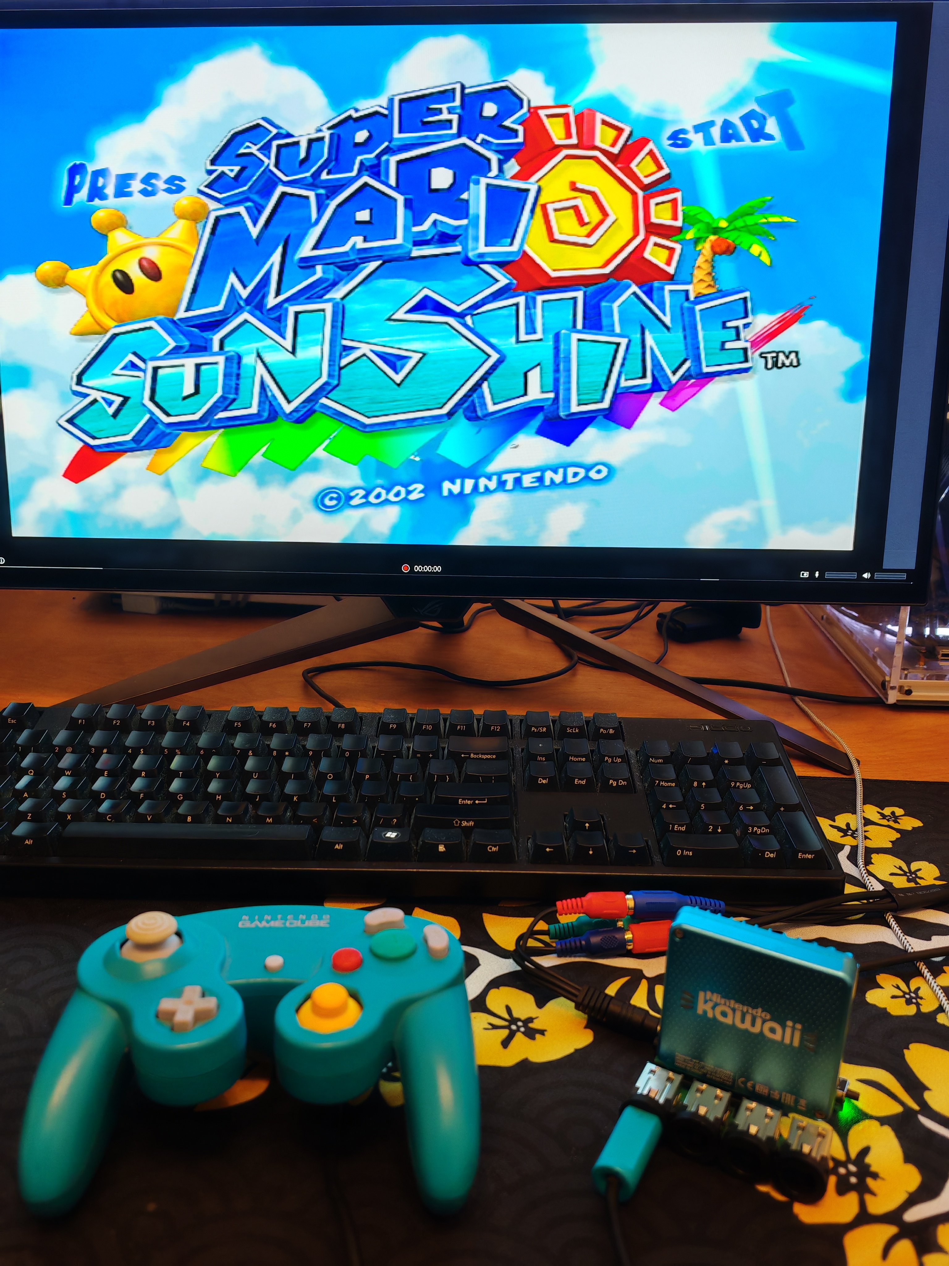

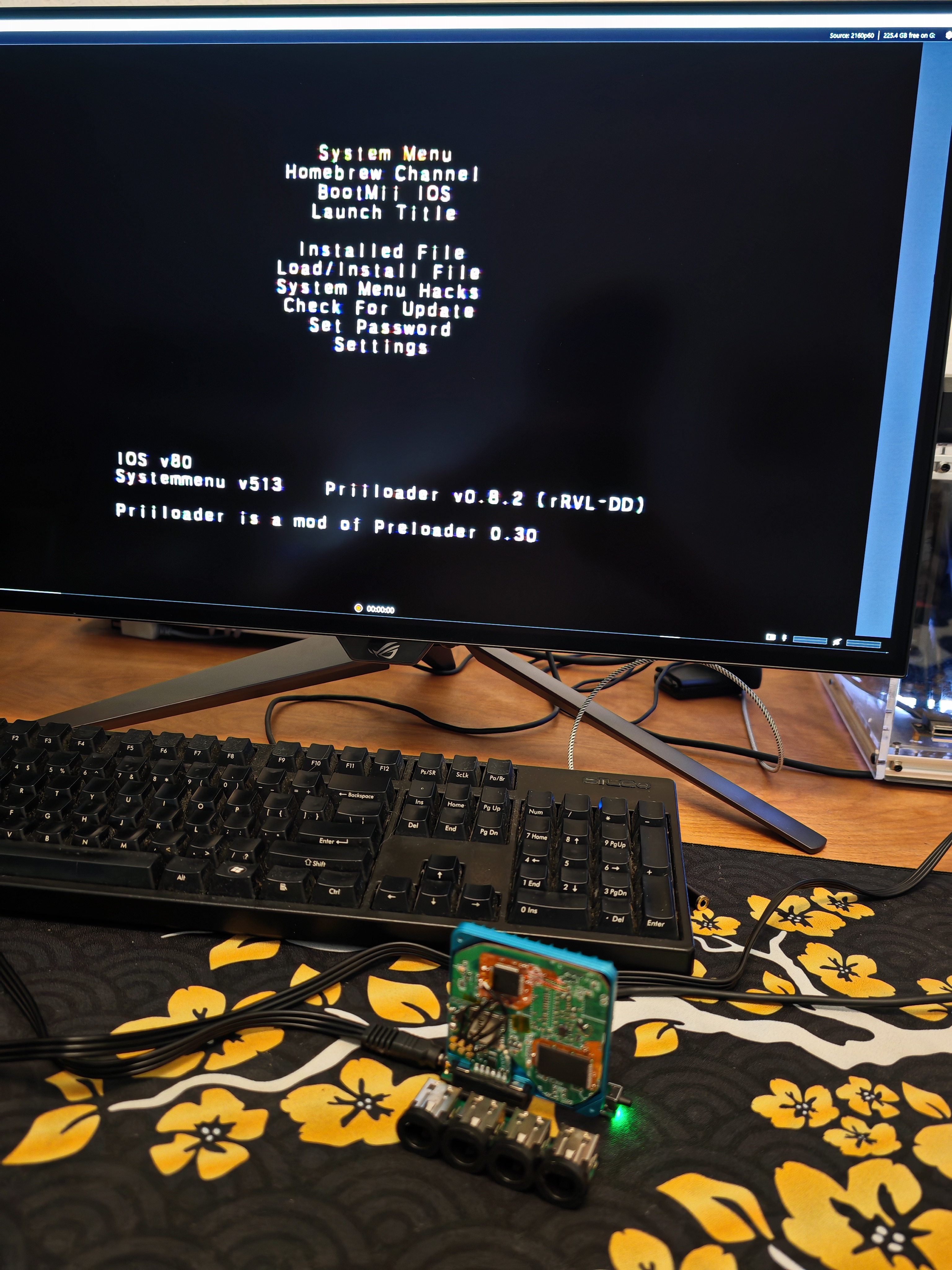

It works! Composite video, component video, and mode switching all function as expected.
I accidentally swapped Y and Pr on the dock side, so that'll have to be fixed in the next dock PCB revision. I also forgot to connect MAX16054's CLR pin to GND. Two bodges ain't bad for a multi-board design.

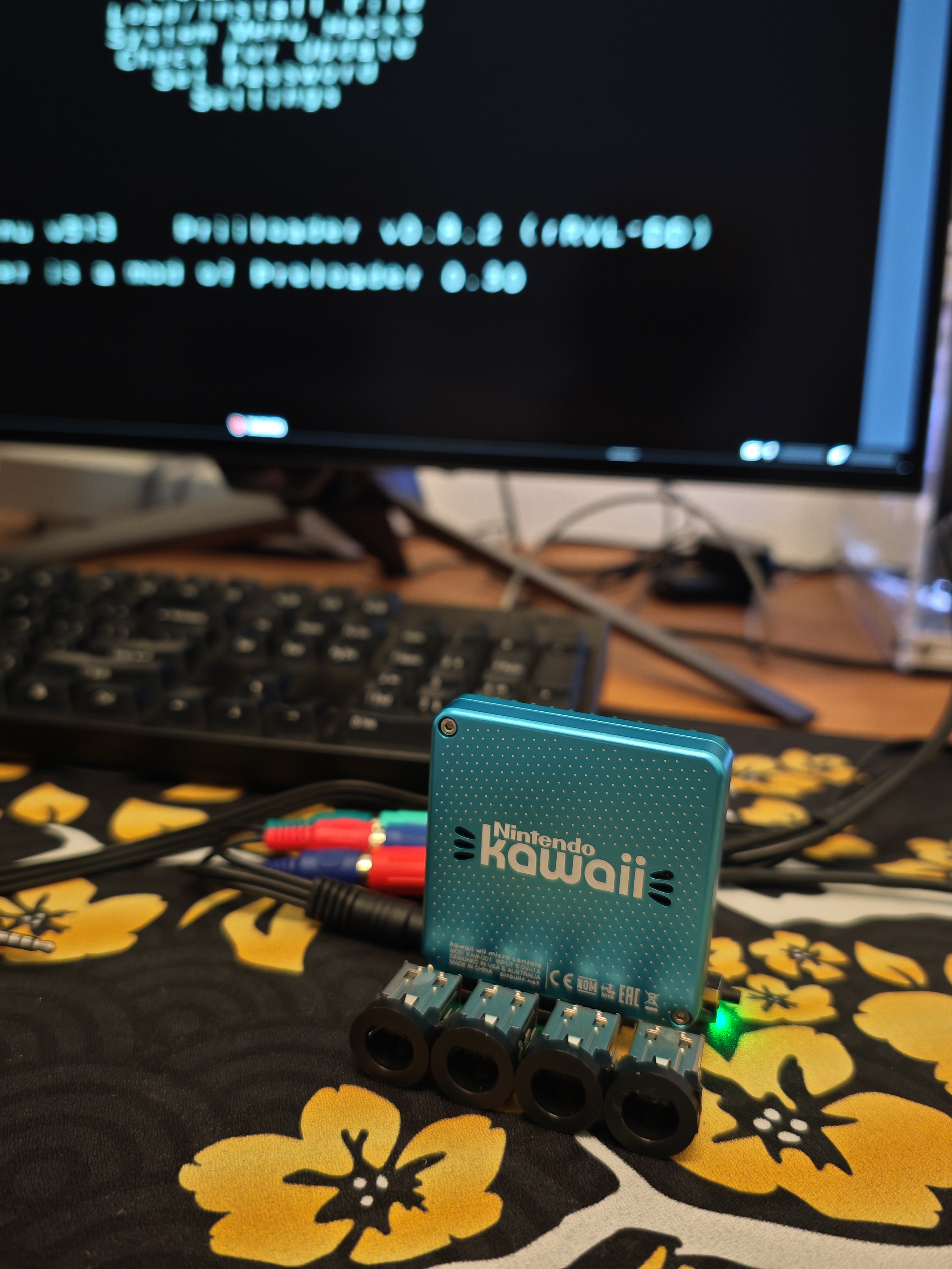

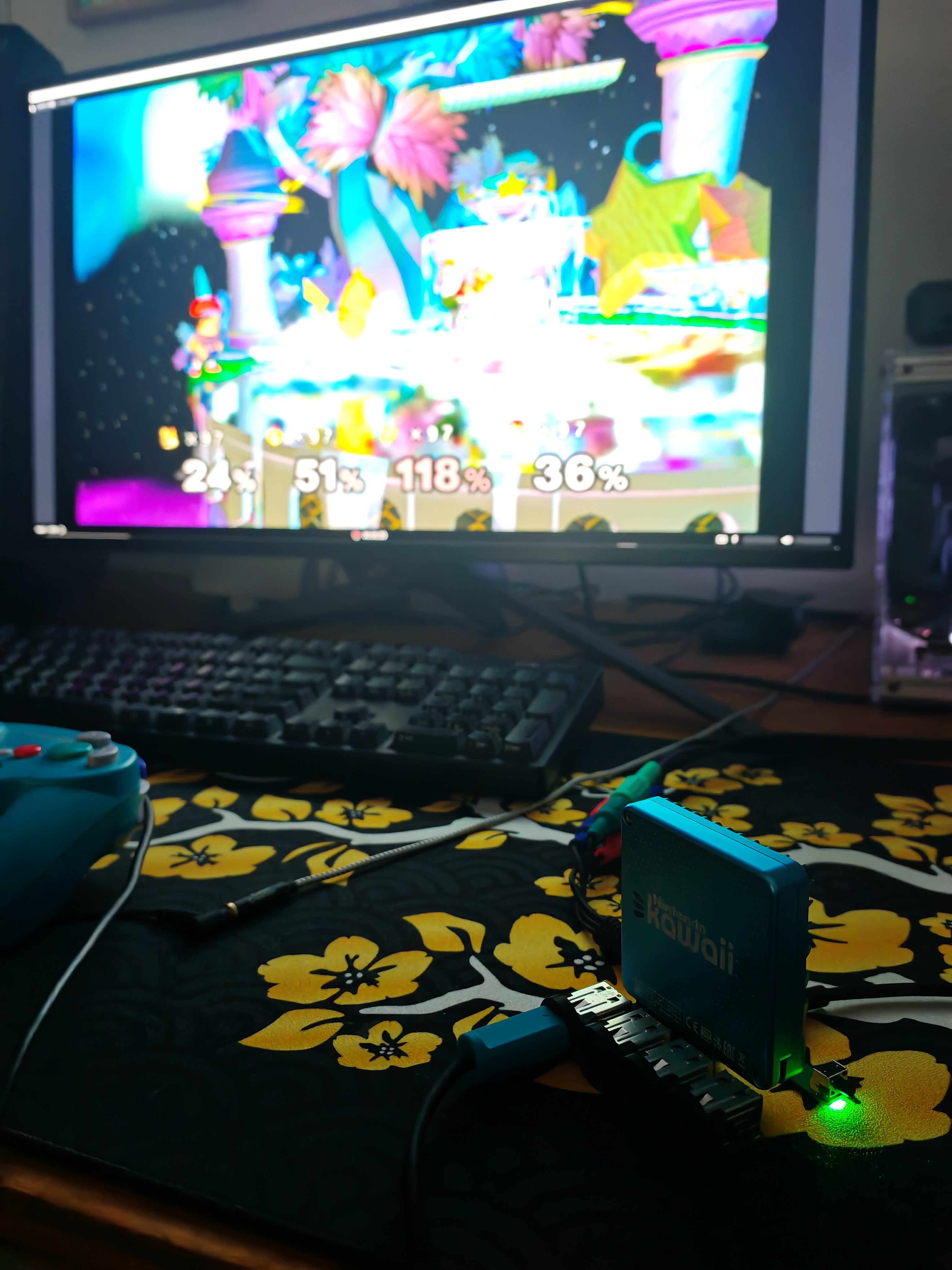

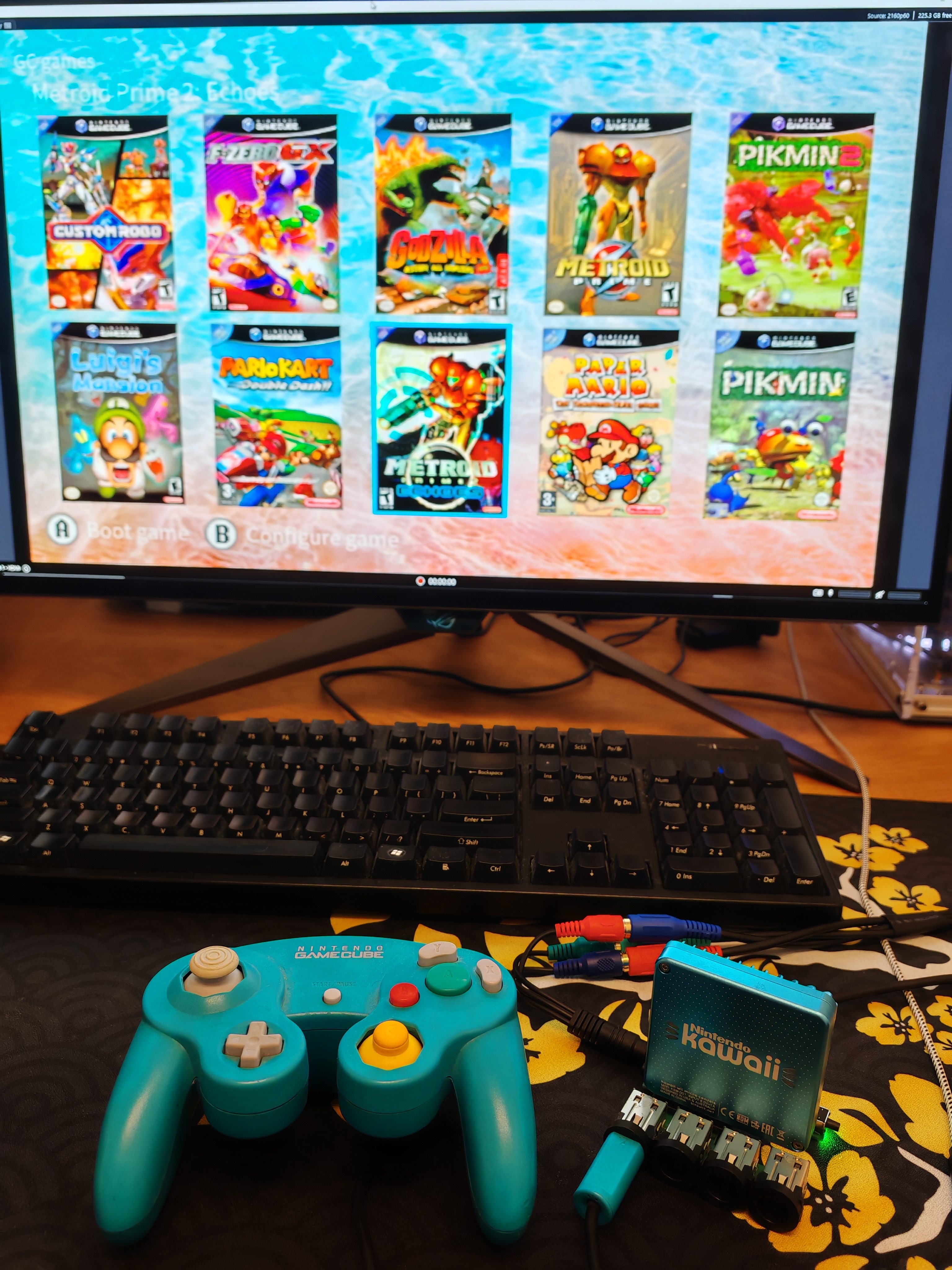

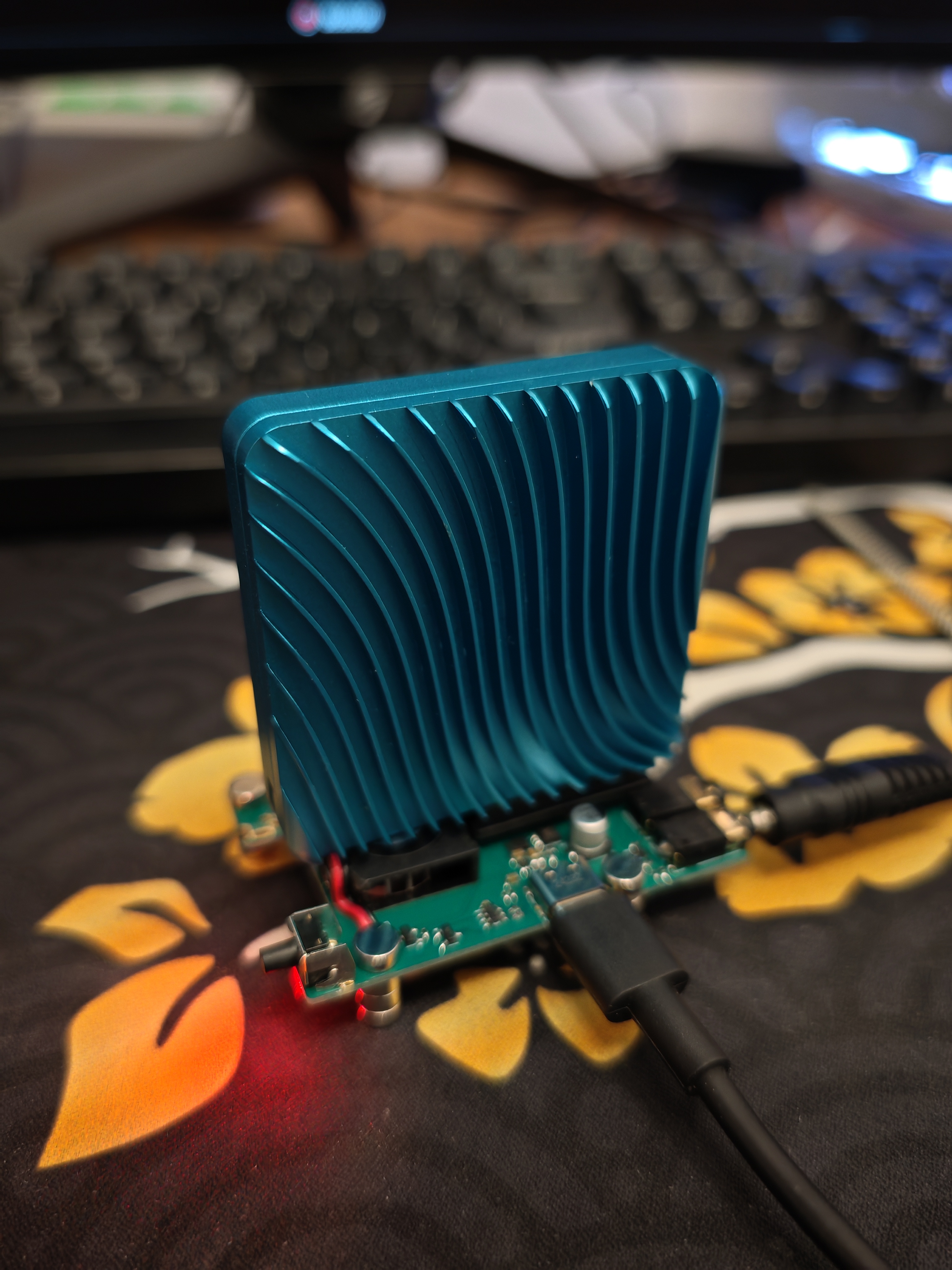

I wired up USB and controllers today!
And also 3D printed some RGB LED plugs which press-fit into place. Since the metal shell will expand as it heats up, they may need to be glued in long term.
It works!

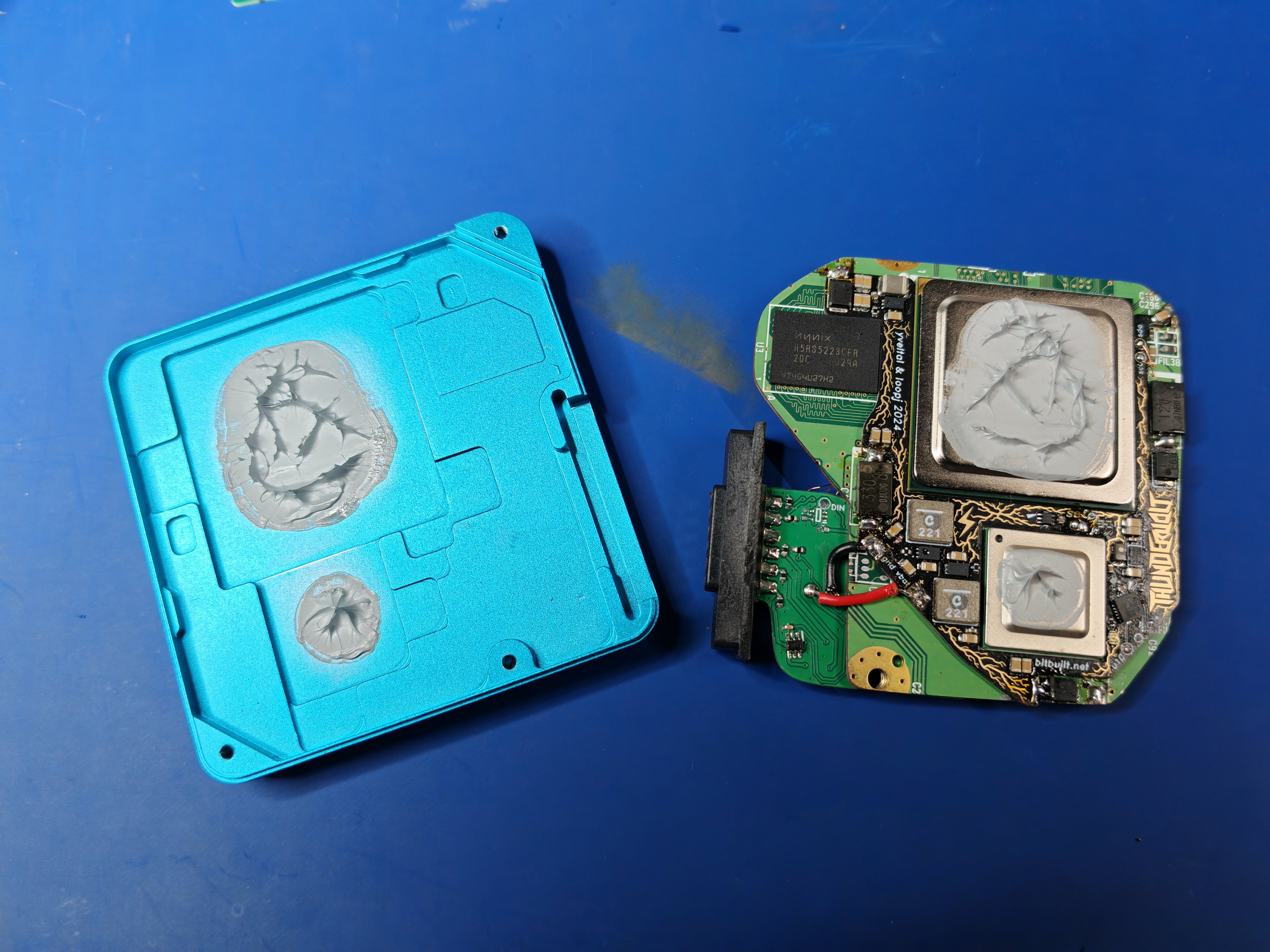

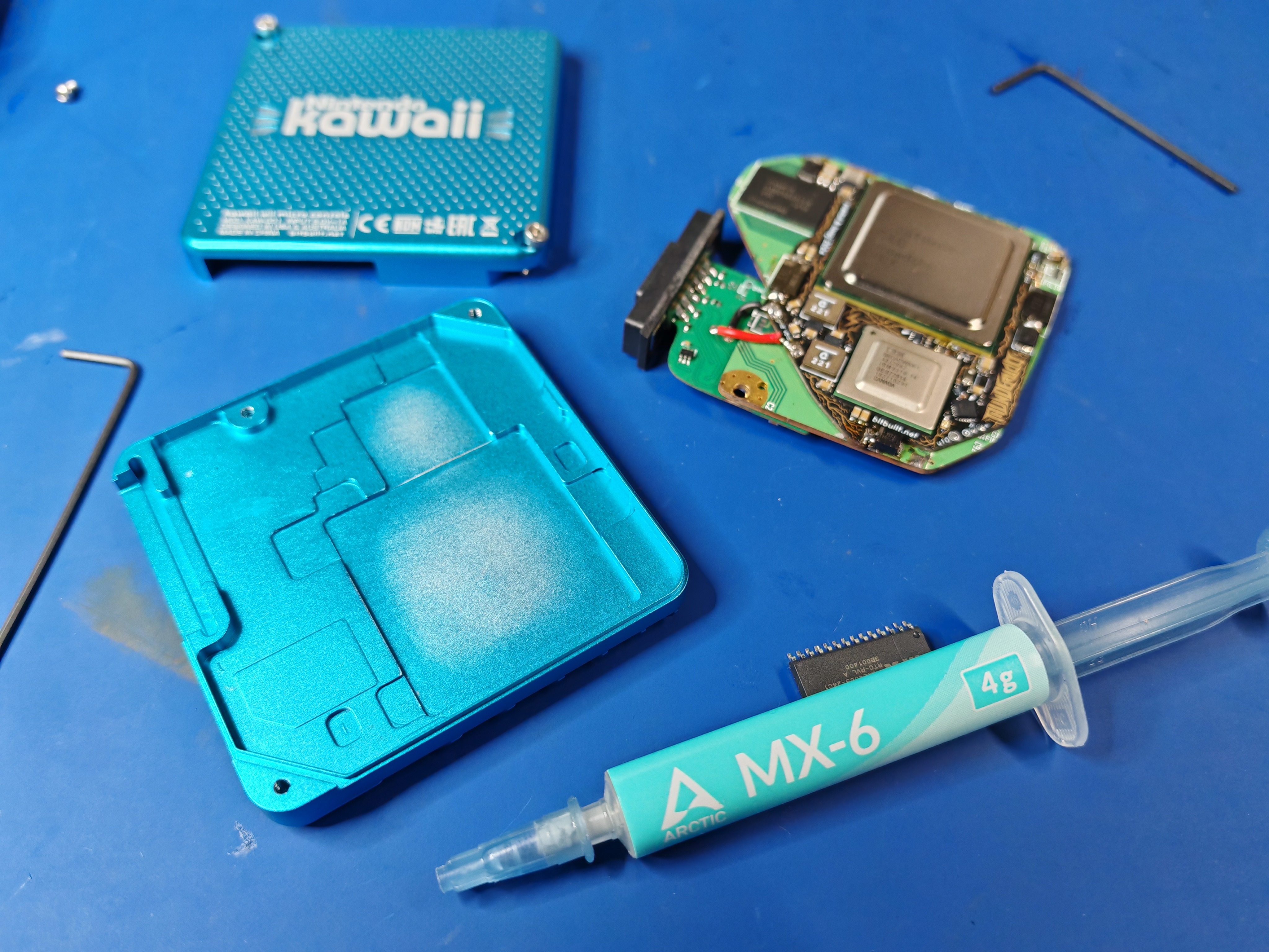

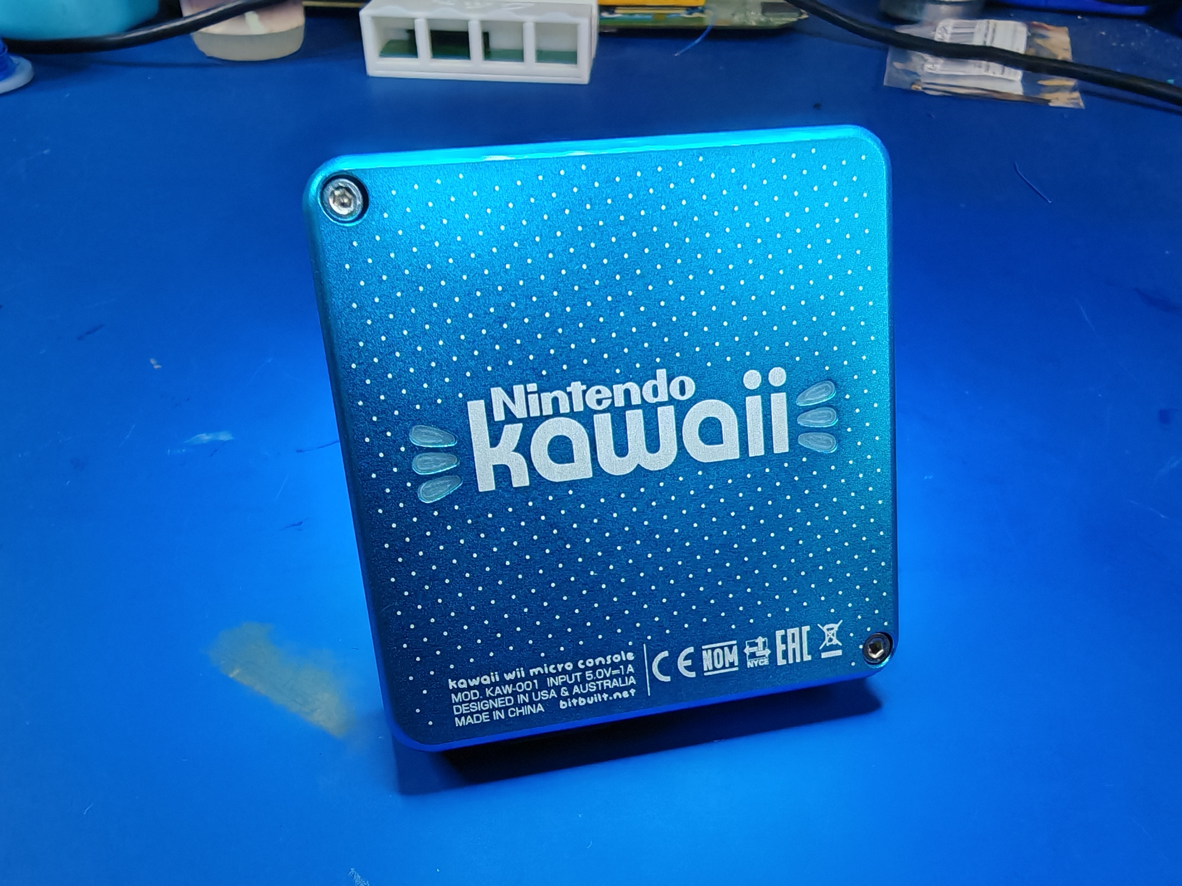

My old thermal paste was dried up... the new stuff just arrived.

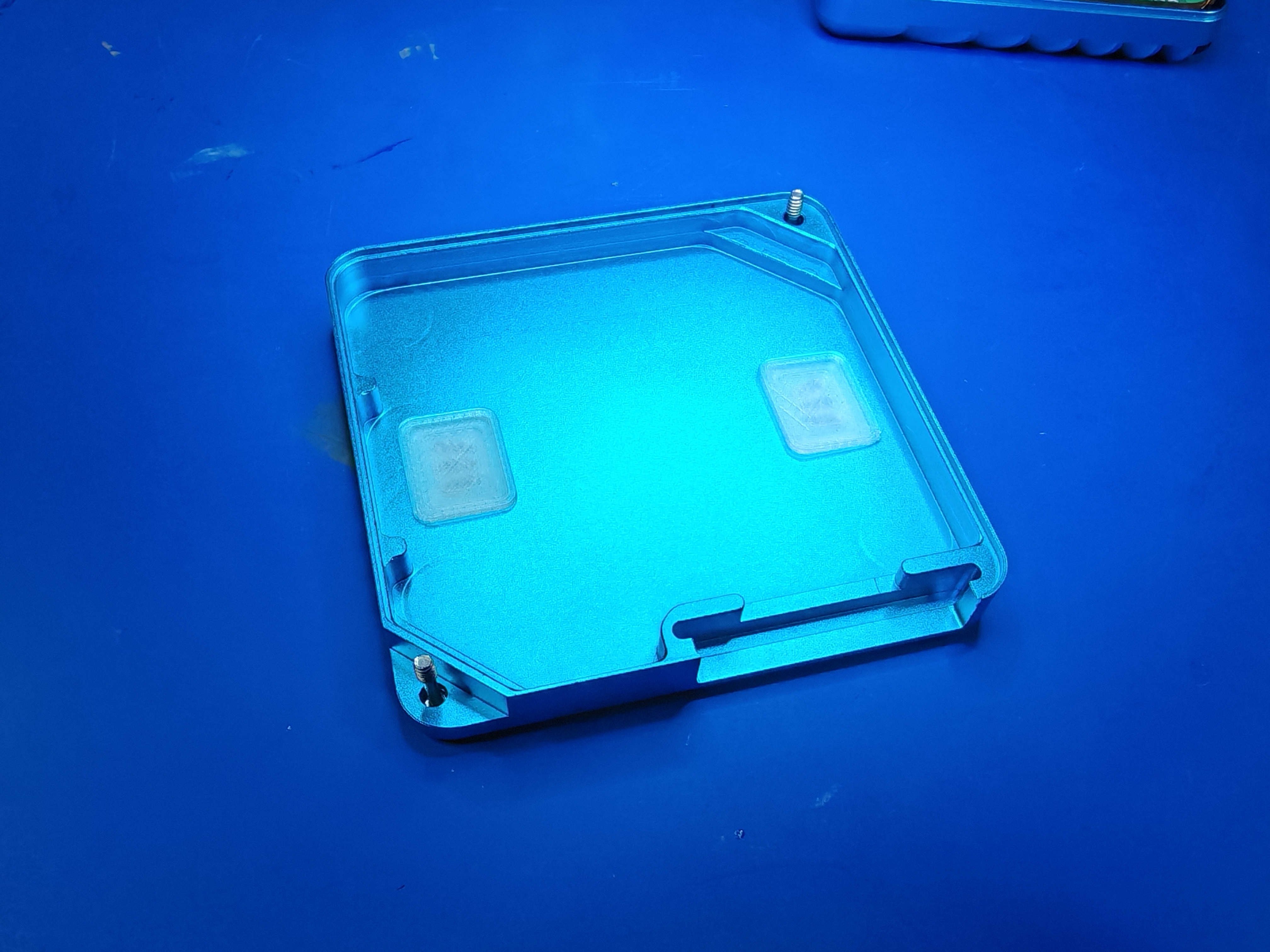

I sanded off some of the alumina to hopefully help with heat conduction. I didn't go overboard because I need to keep the rest of the shell non-conductive. Many solder joints are in contact with the insulative alumina, so any inadvertently exposed aluminum would be catastrophic.

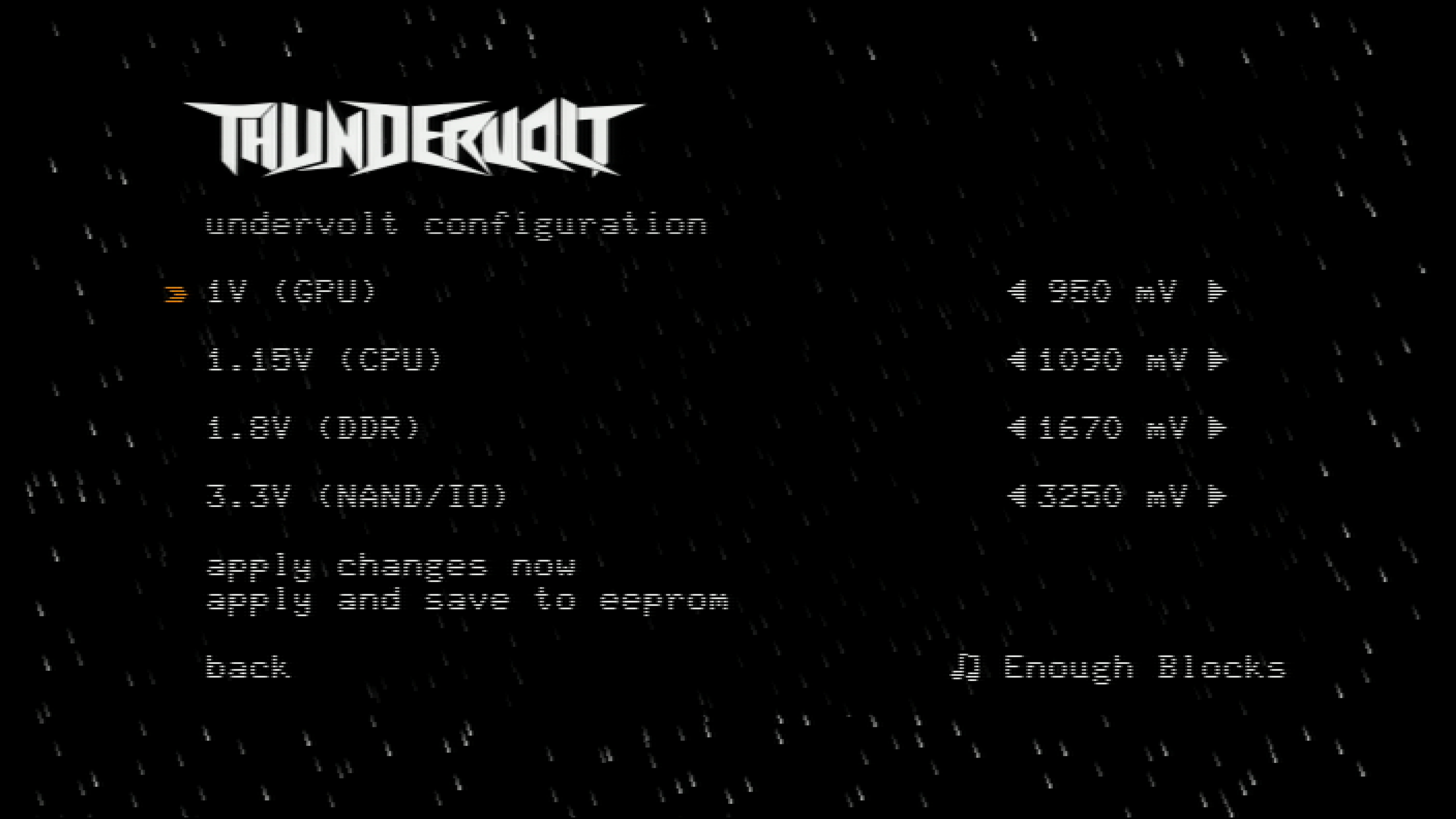

This motherboard really doesn't like being undervolted. In fact, its tolerance has decreased over the course of my testing. Not sure why that is. In the end, I had to go with a very mild undervolt to maintain stability.

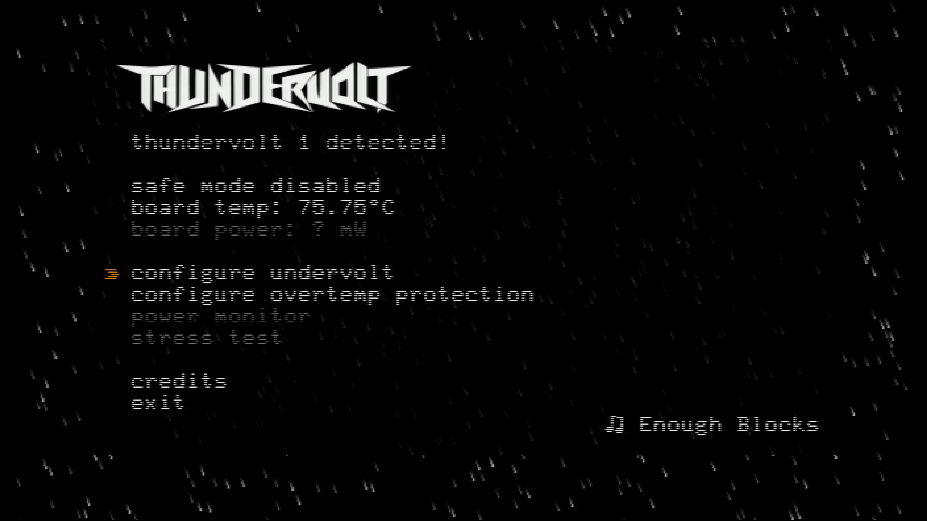

With these settings, Thundervolt reported a board temp of 75°C after ~40 minutes of 4-player Melee. The case is well above the touch temperature comfort limit for metal (43°C)-- probably close to the touch temp safety limit of 60°C.
It crashed after an hour or so. Wesk says this is typical of higher temps. Not good enough!
Keeping the board temp at 60C or below is the goal for stability reasons. I would like to get the outer shell temp to 50C or below, so it can be touched safely during operation.

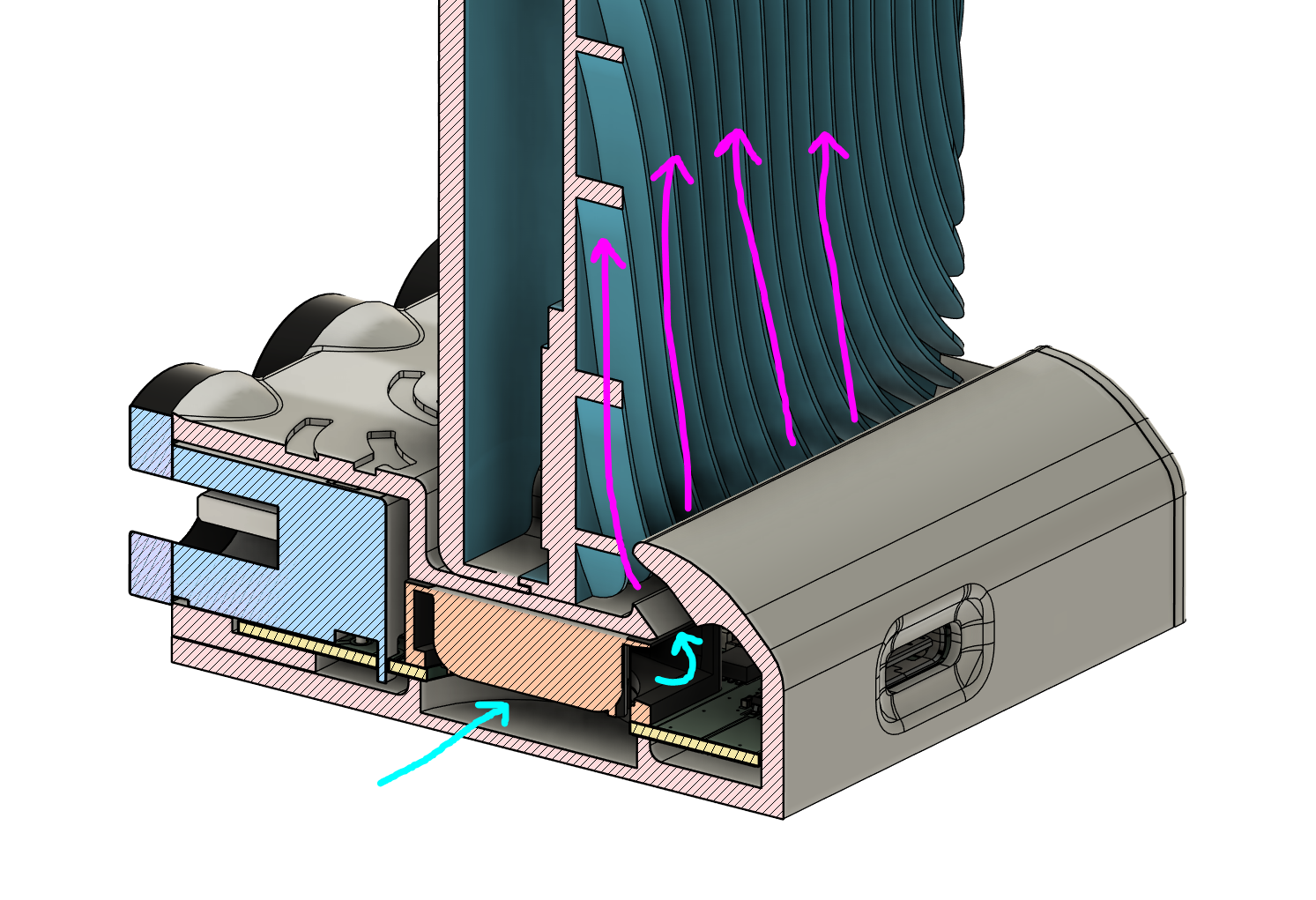

  • 〇 Adding a fan to the dock
    • @Wesk successfully added a 20x20x6mm blower fan to the dock MCAD, without growing its dimensions
    • This should probably be saved as a last resort to decrease temps if the other options can't get things below ~60C
    • But I'm going to add support for the fan in the next dock PCB revision regardless, so we have the option if needed

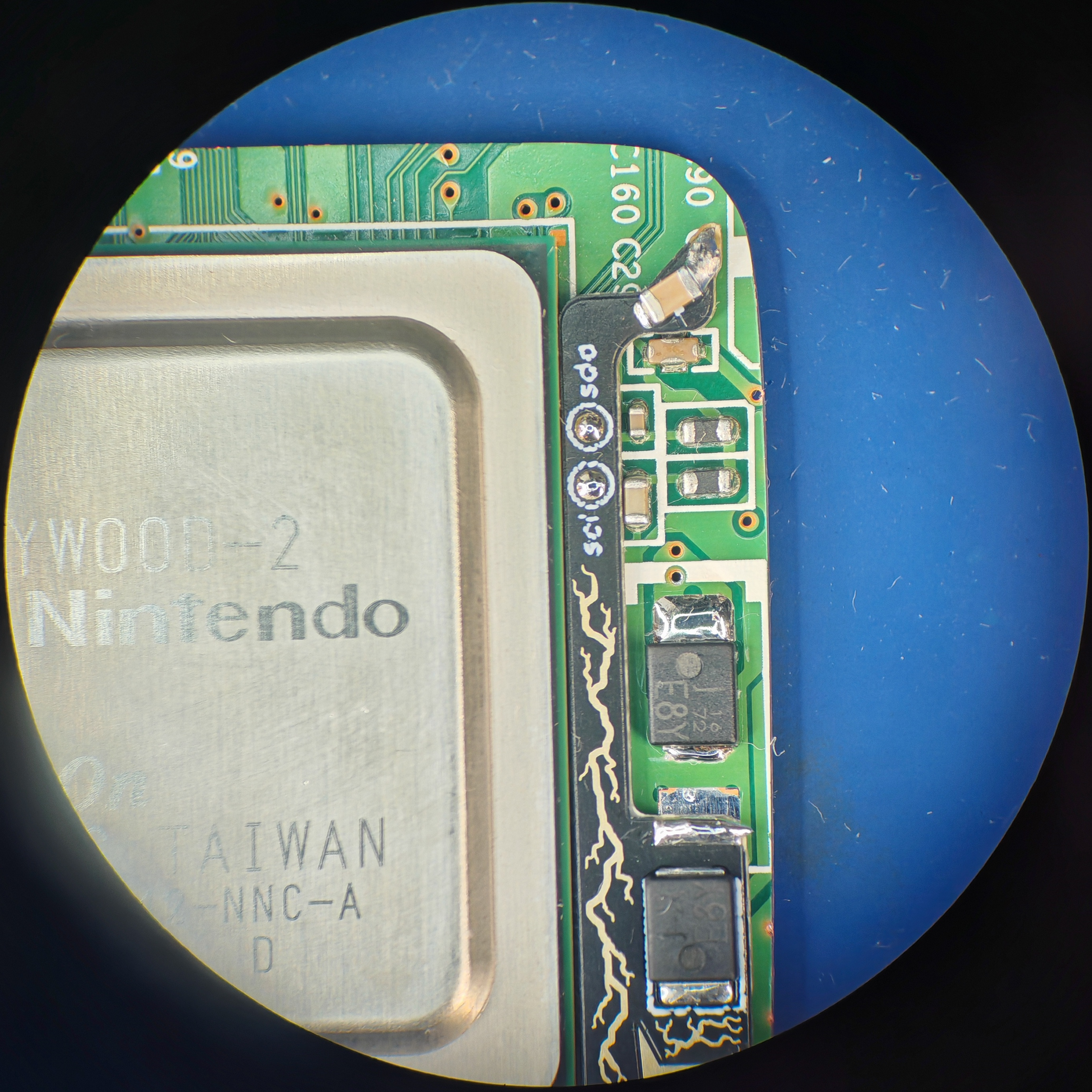

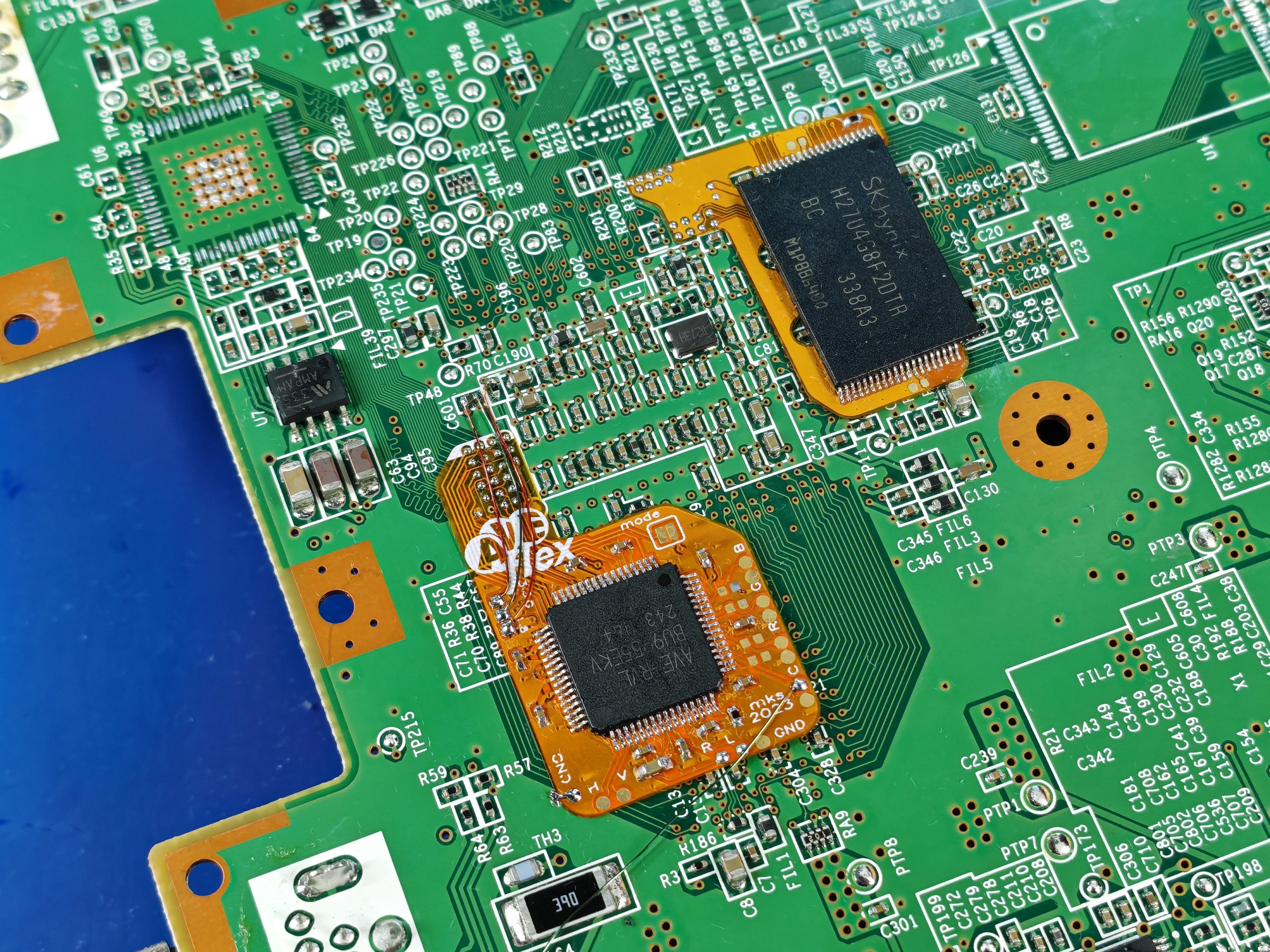

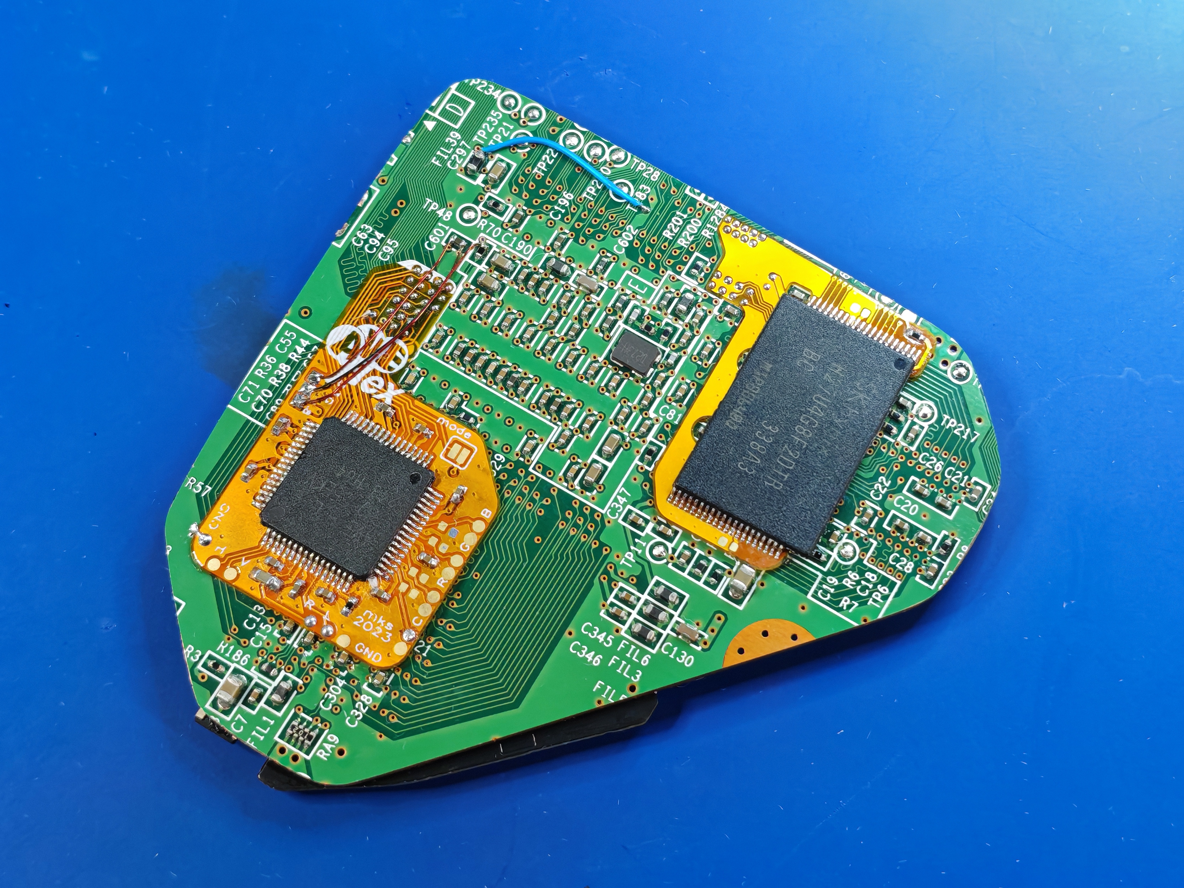

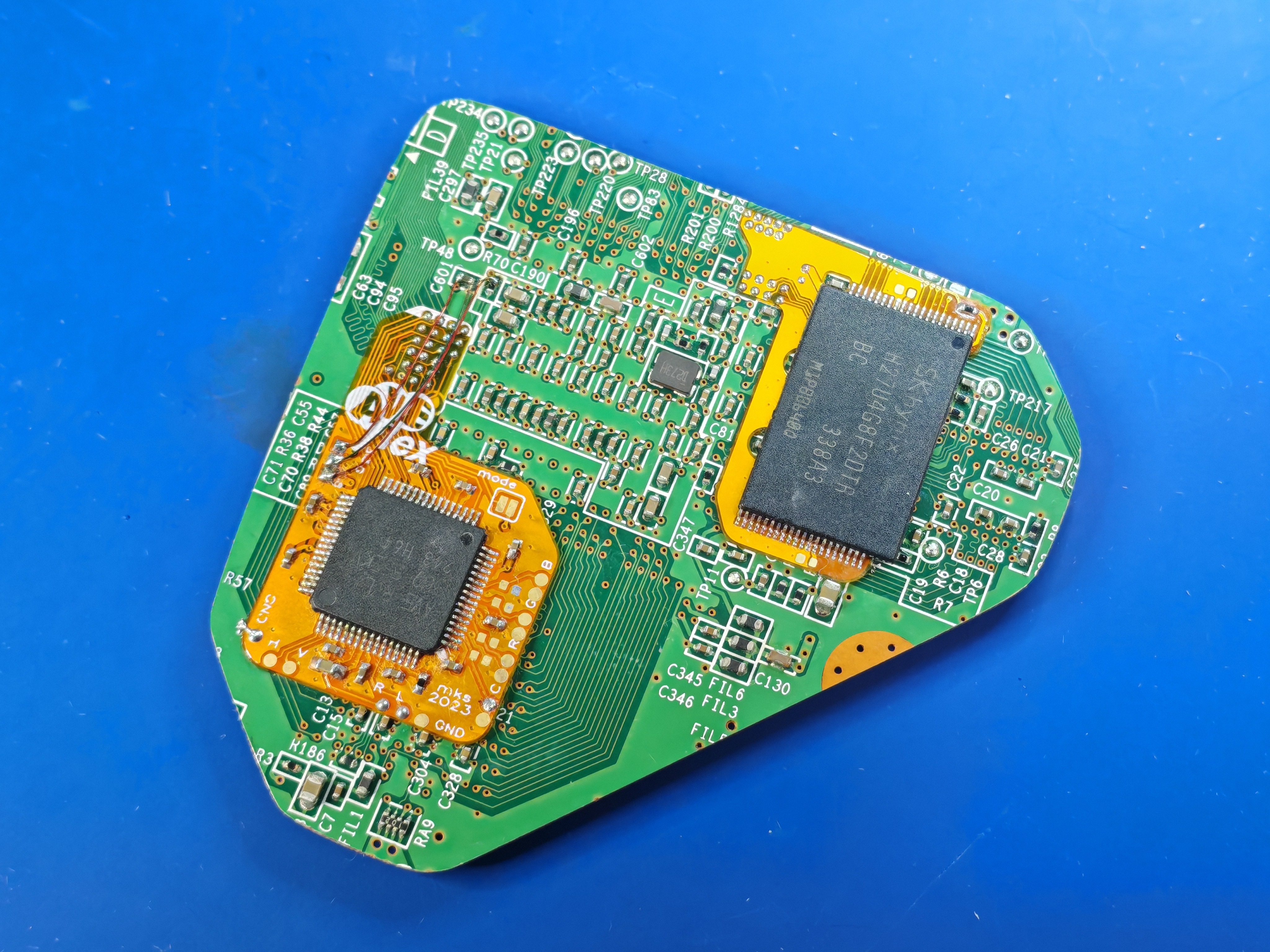

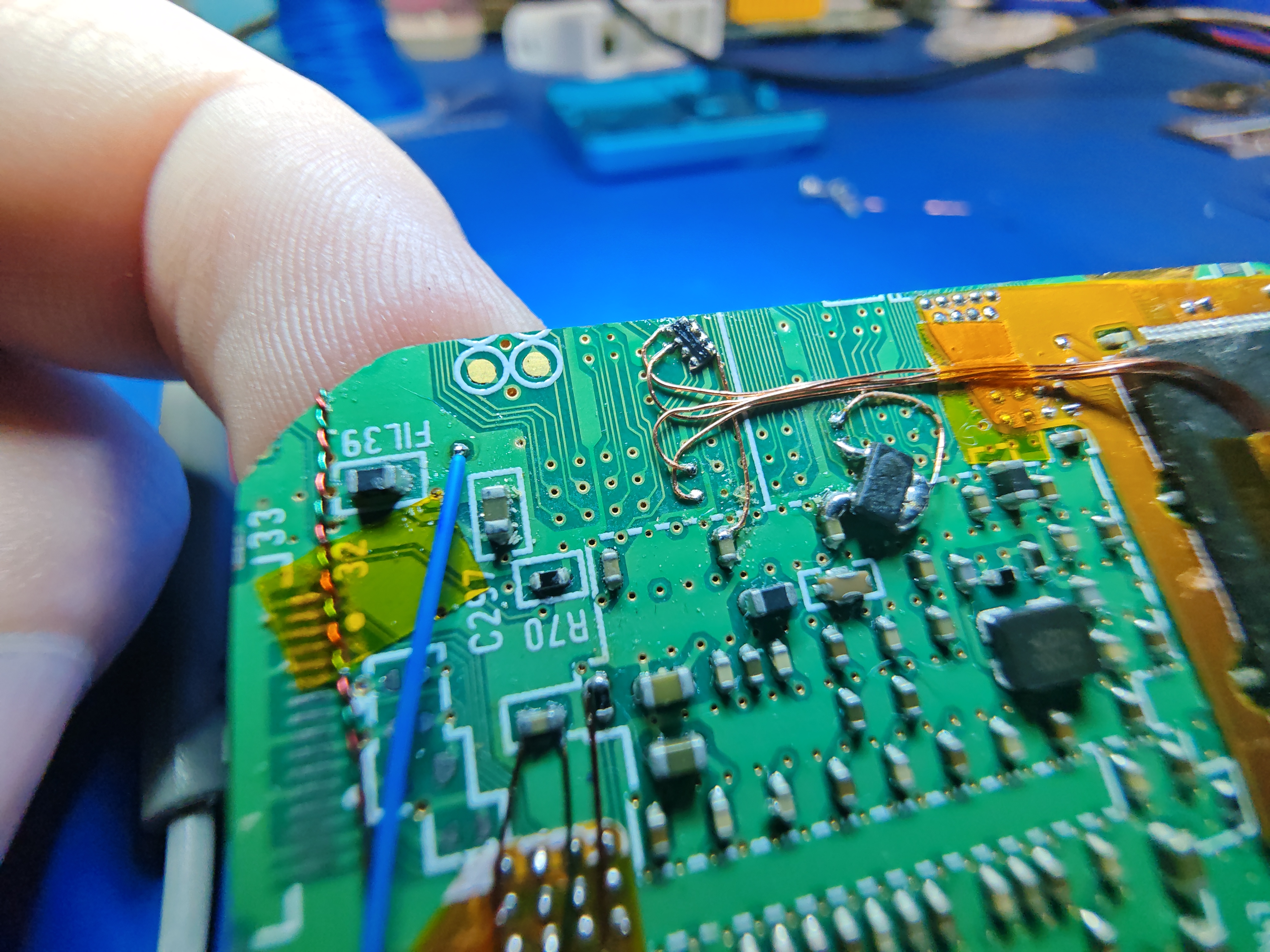

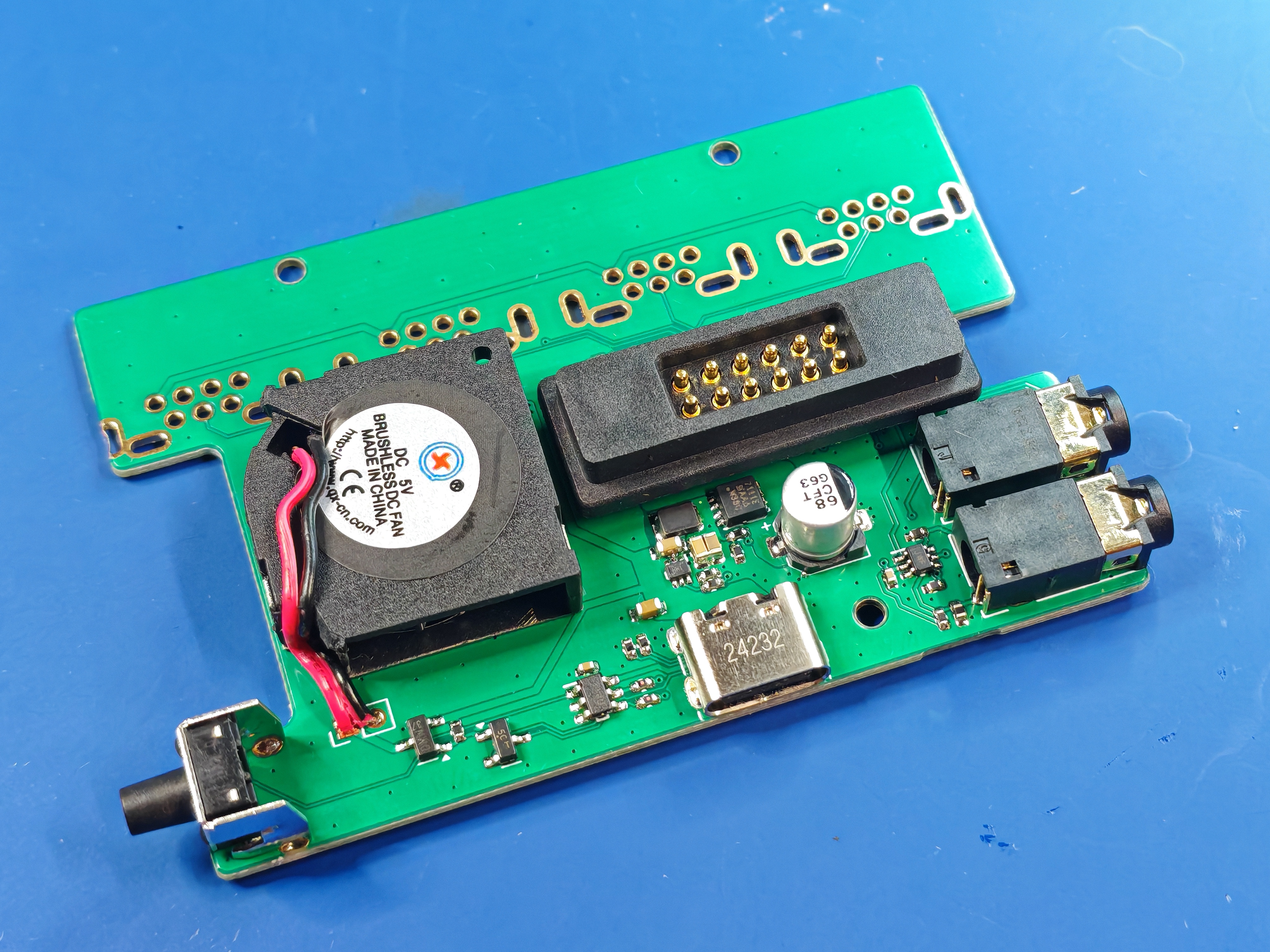

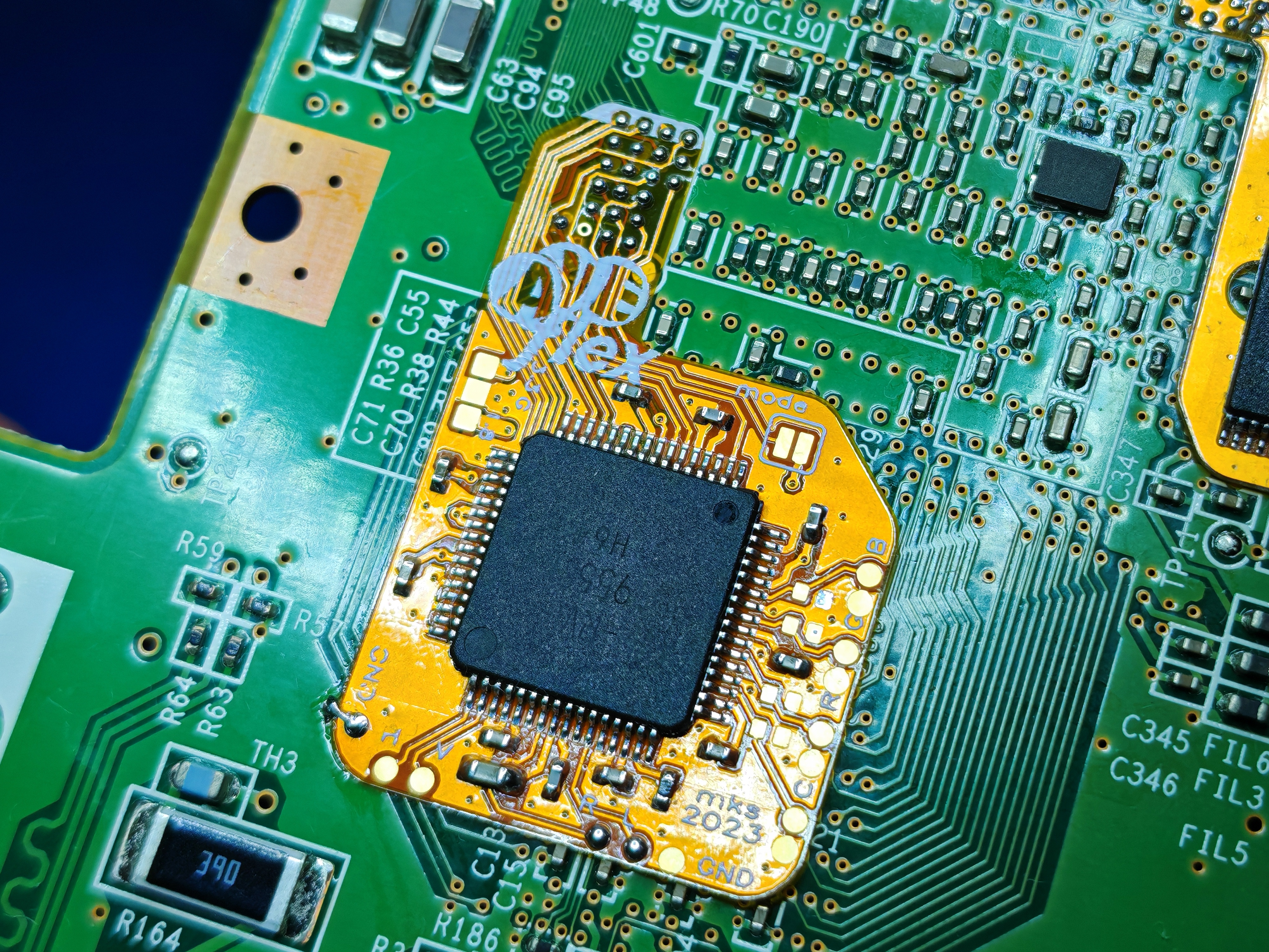

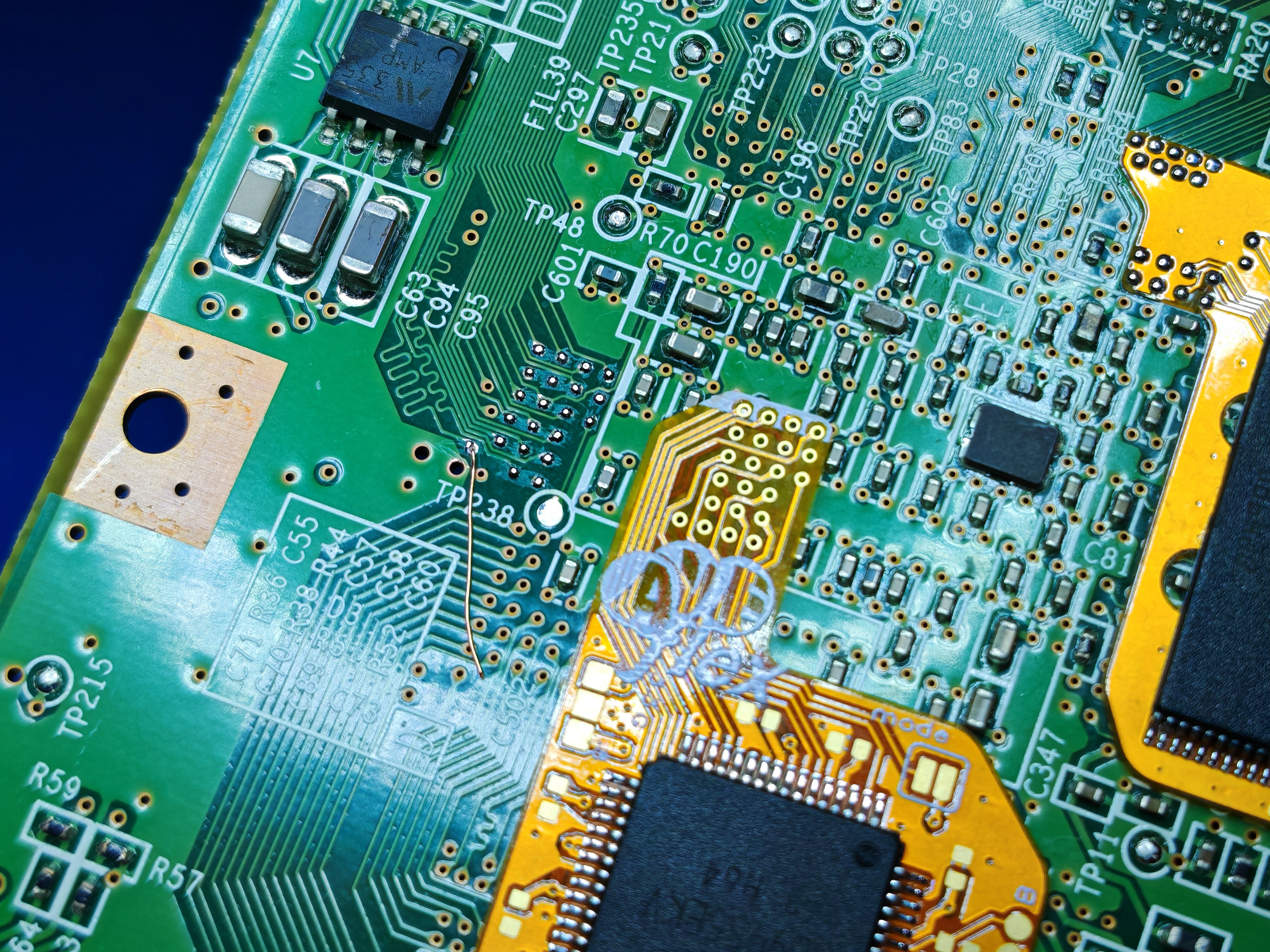

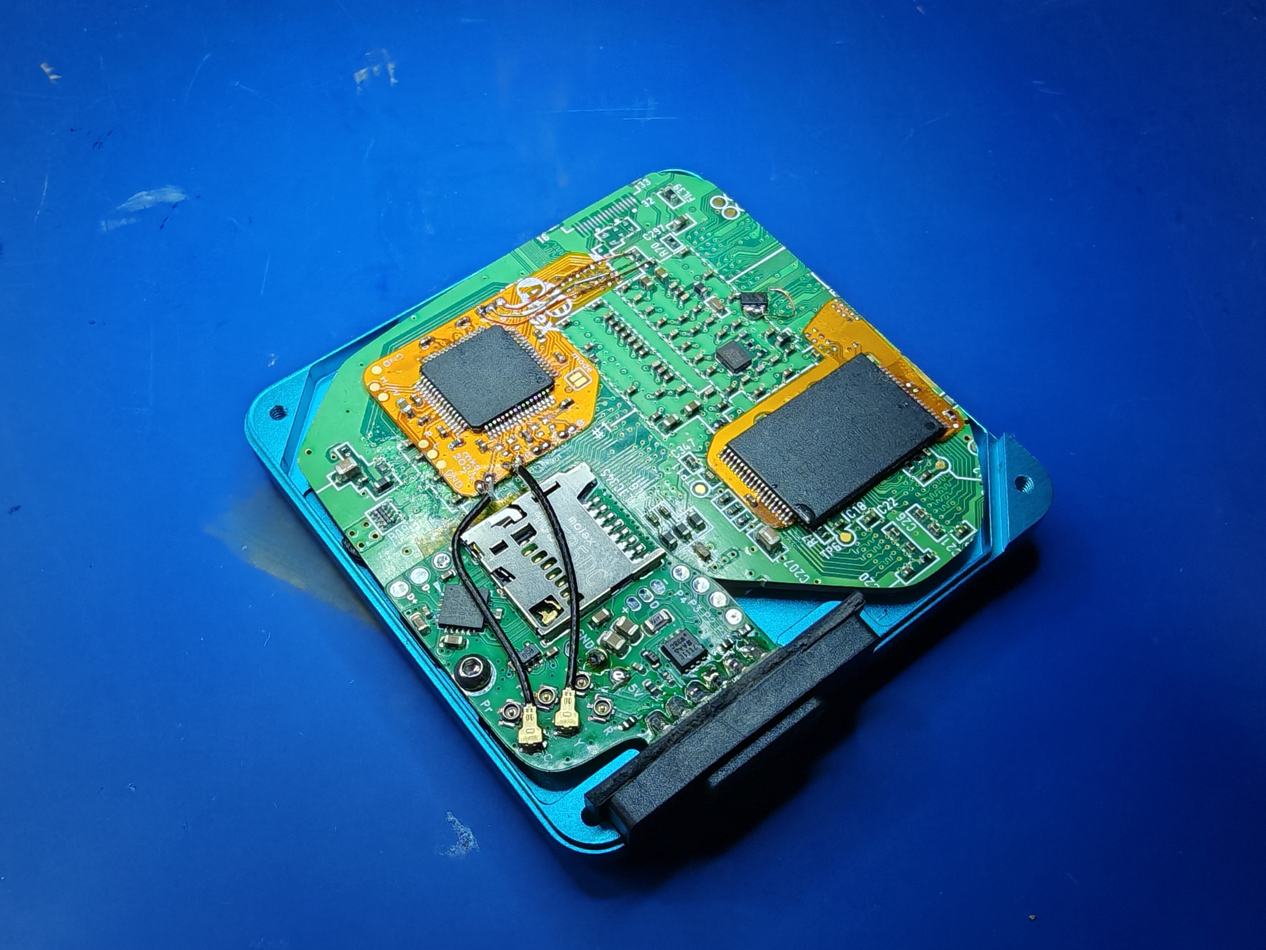

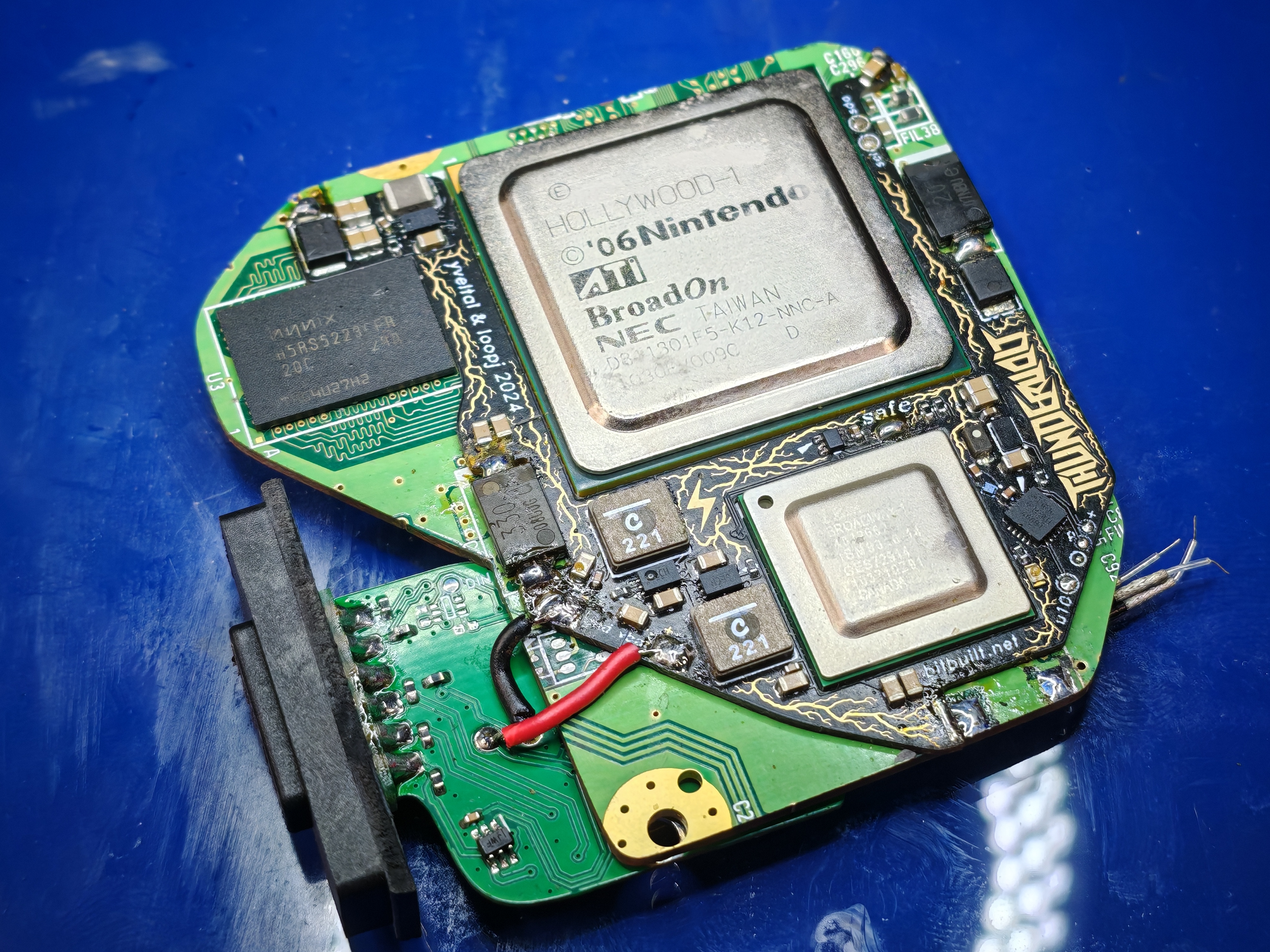

Short update today. One of my Hollywood-2 Wii Minis is nearly ready to trim! Note: when installing AVEflex on a Mini, a single jumper wire is required for VDATA0.

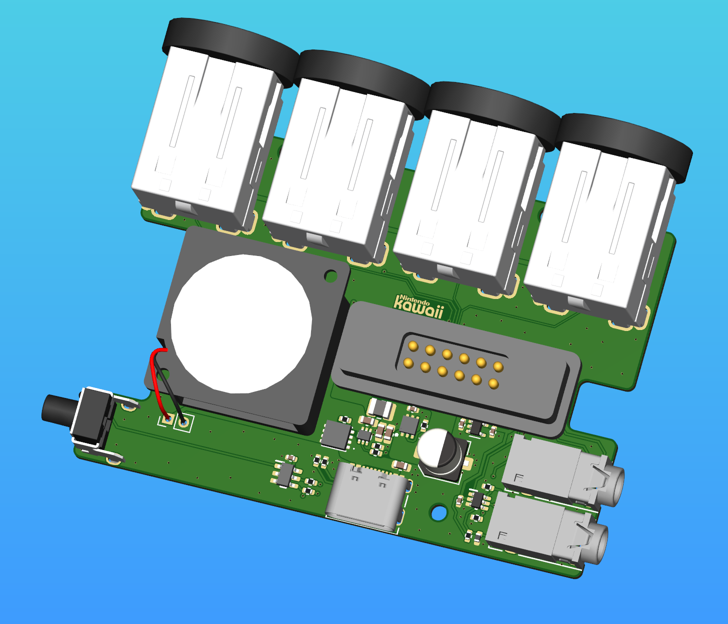

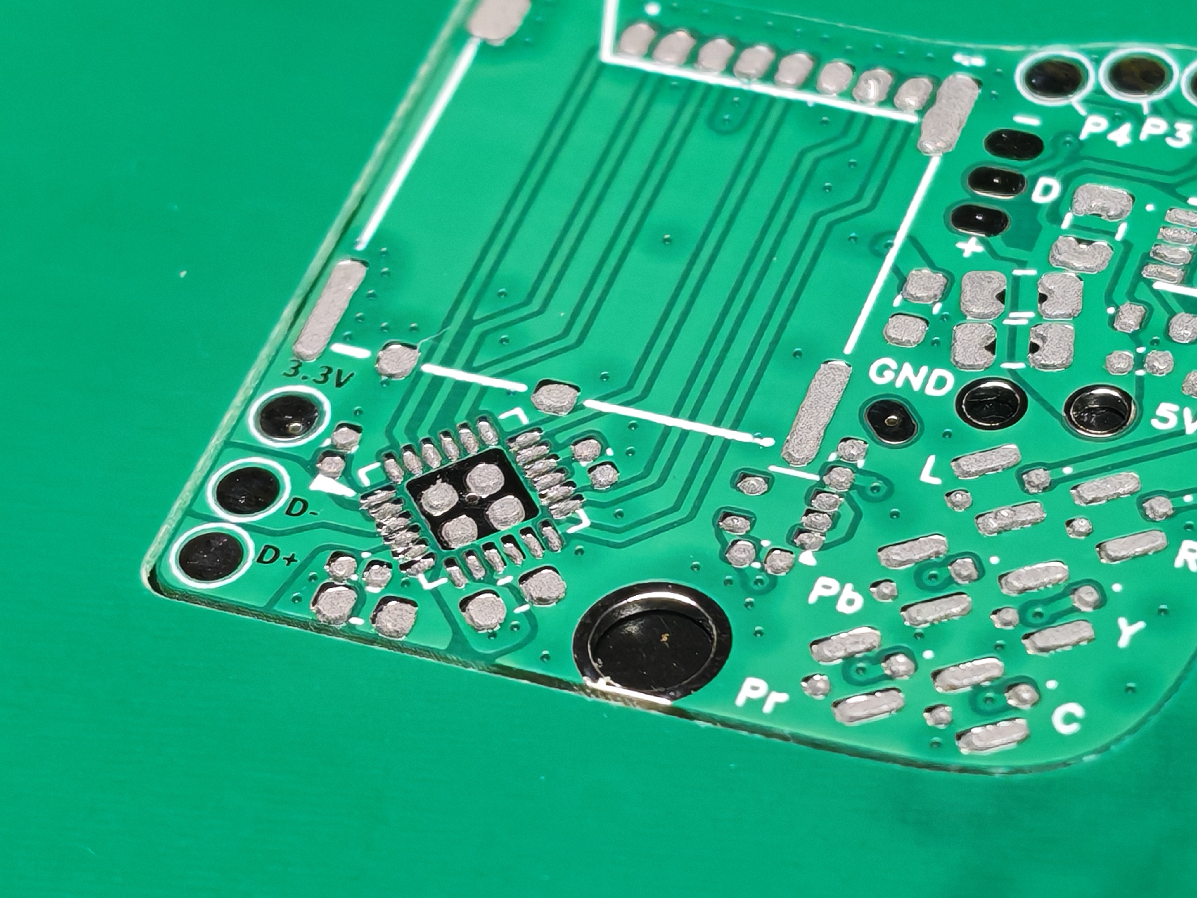

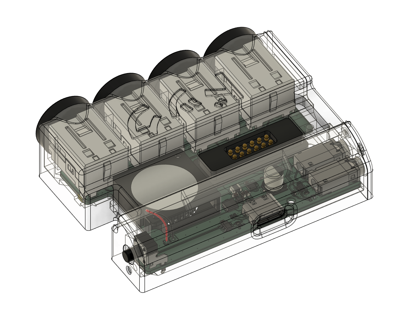

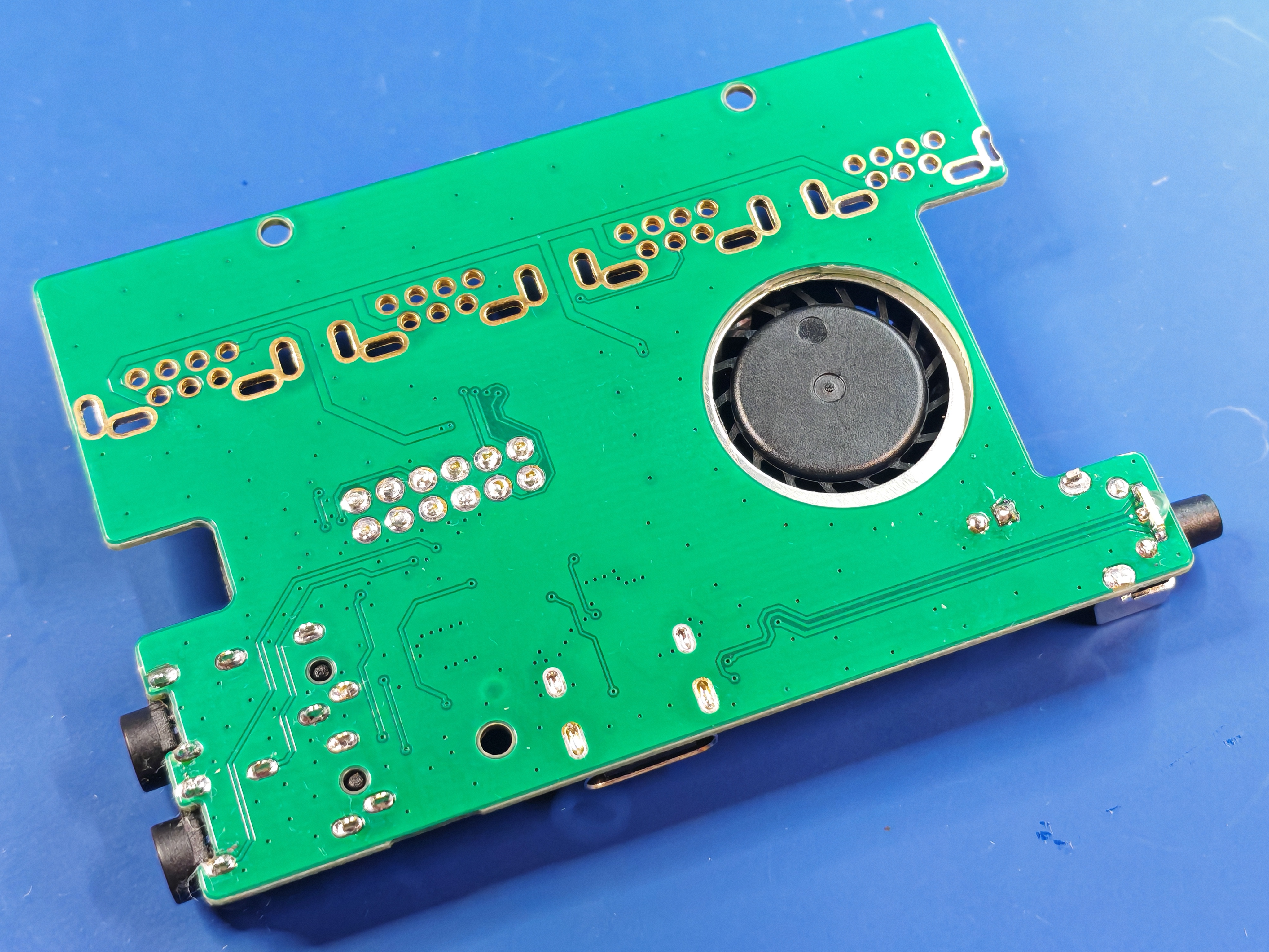

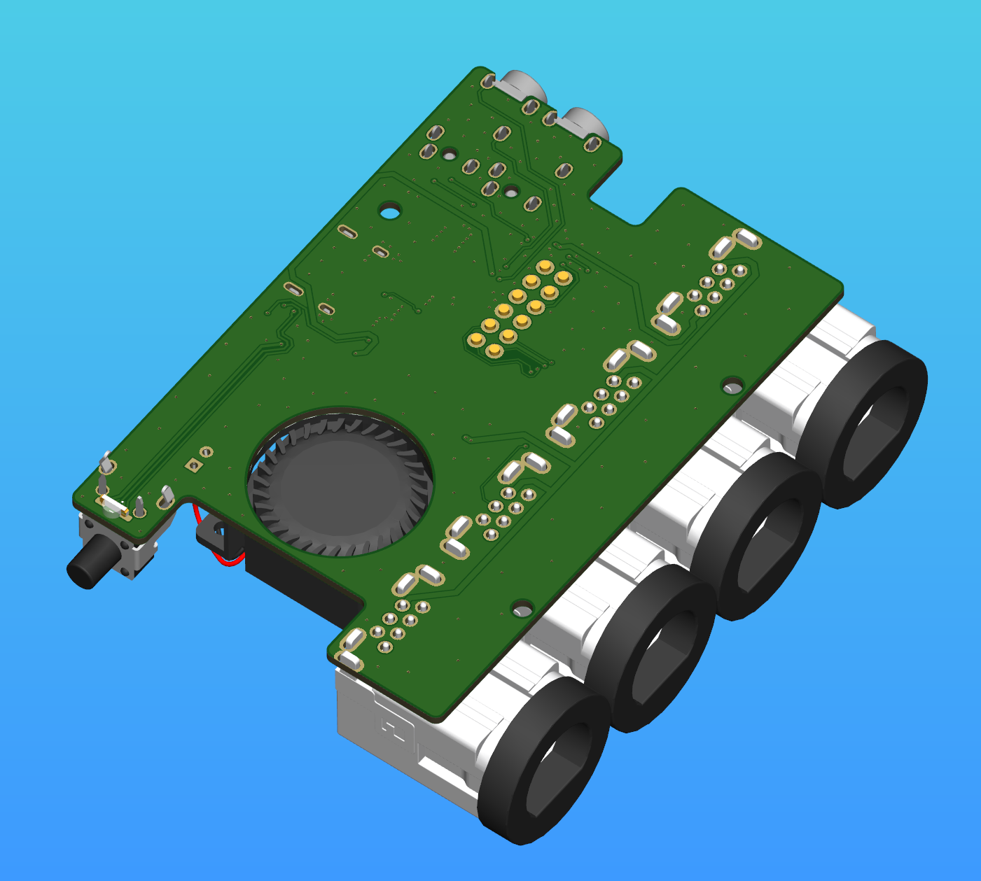

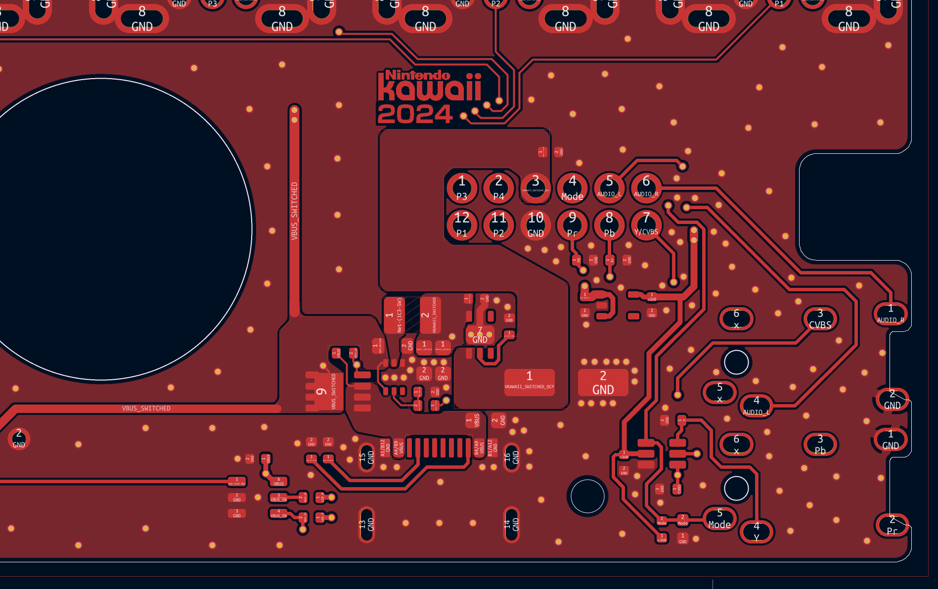

Here's the revised dock PCB, incorporating a lower voltage Kawaii supply, the 20x20x6mm fan, and multiple YPbPr pinout fixes.
@Wesk did the all of the initial fan MCAD integration. I've been cleaning things up, and making sure the revised PCB fits snugly.

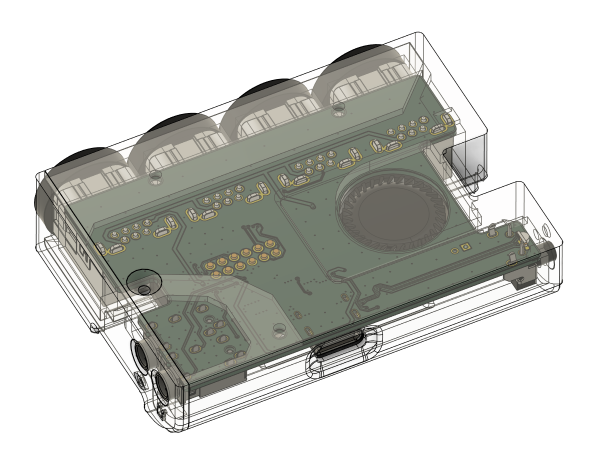

Airflow path:

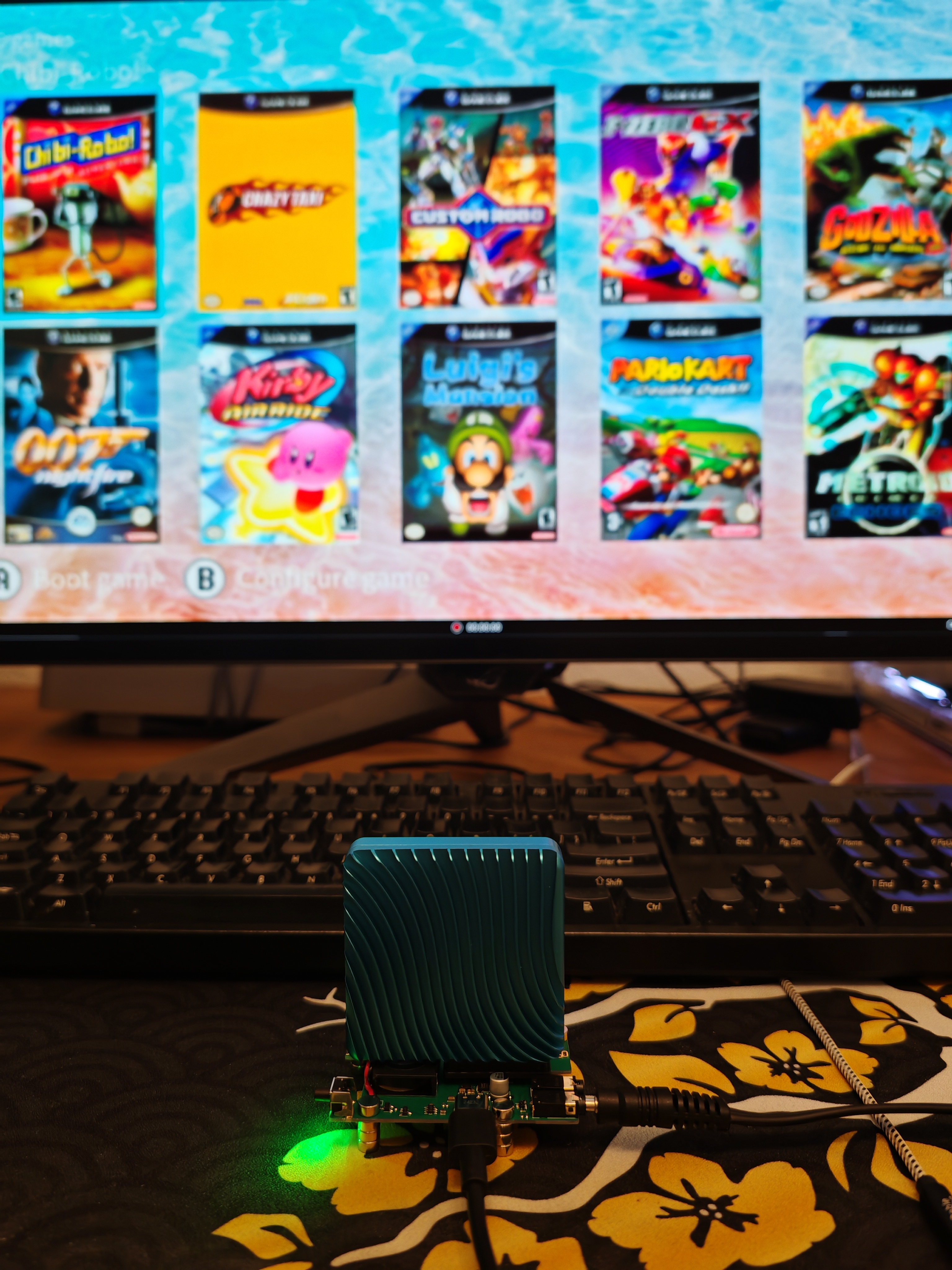

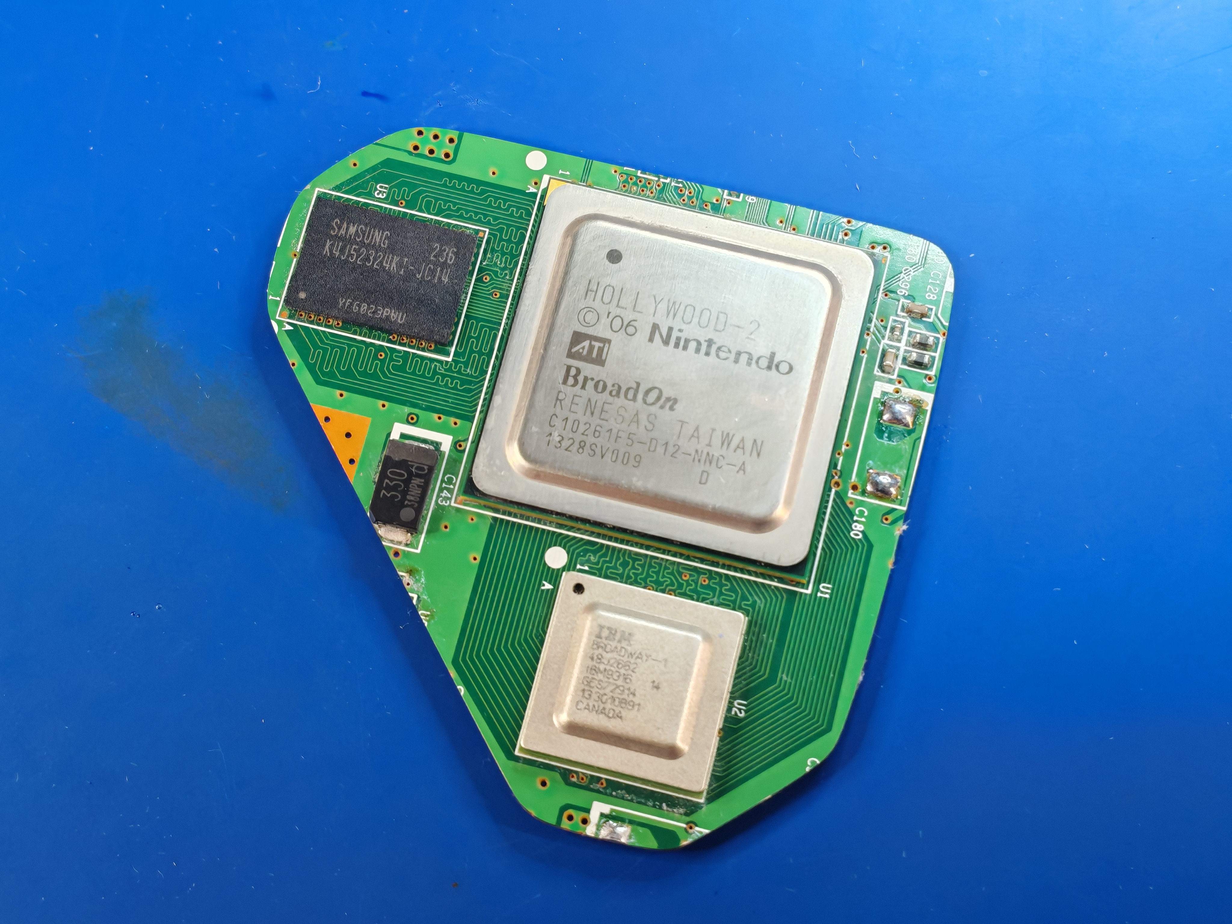

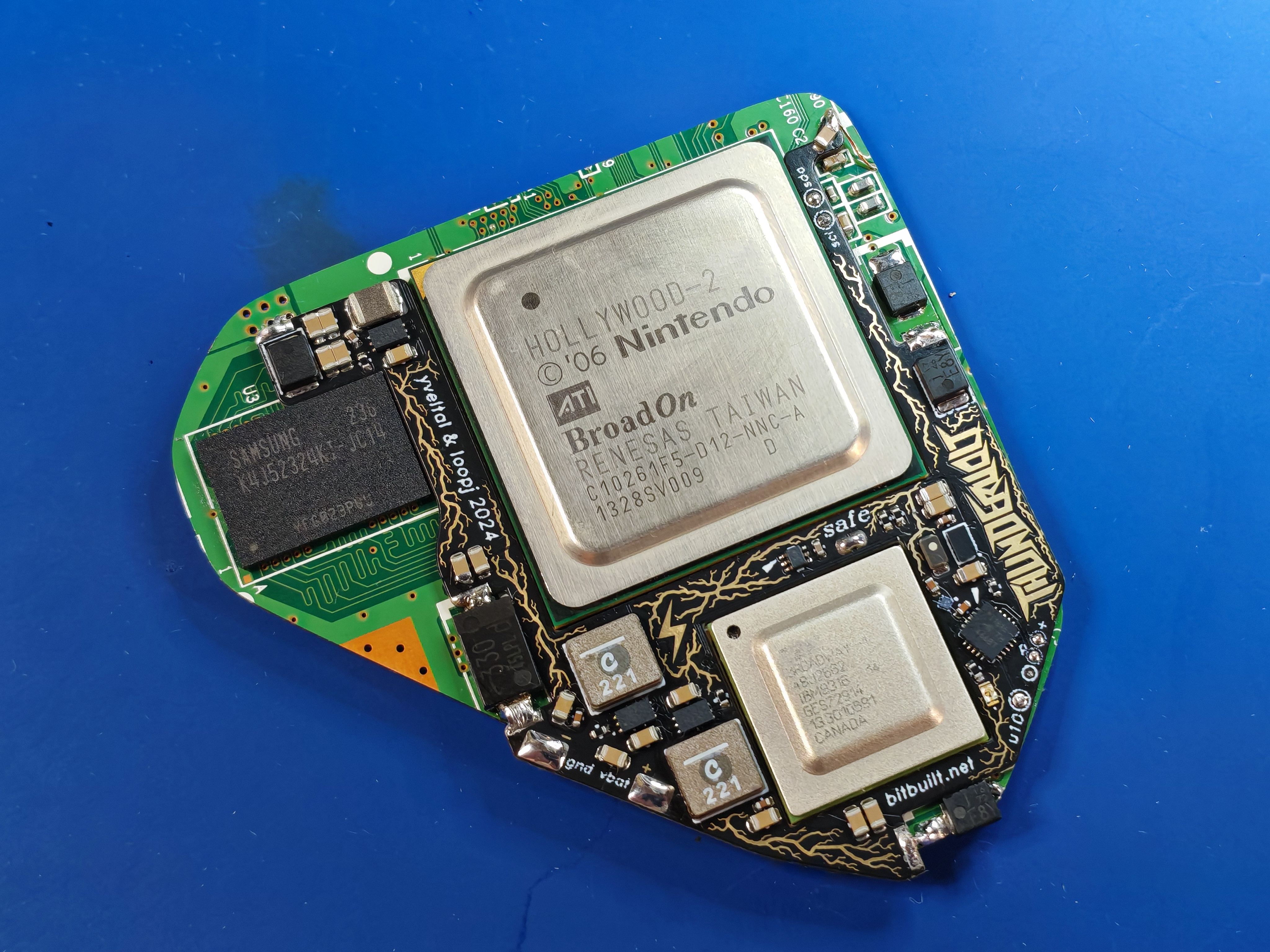

The Hollywood-2 Kawaii is alive! I'll let the pics do the talking.
Final dock revision (for real this time!)
Thermals are already way, WAY better than before. More testing to come after Thanksgiving!
