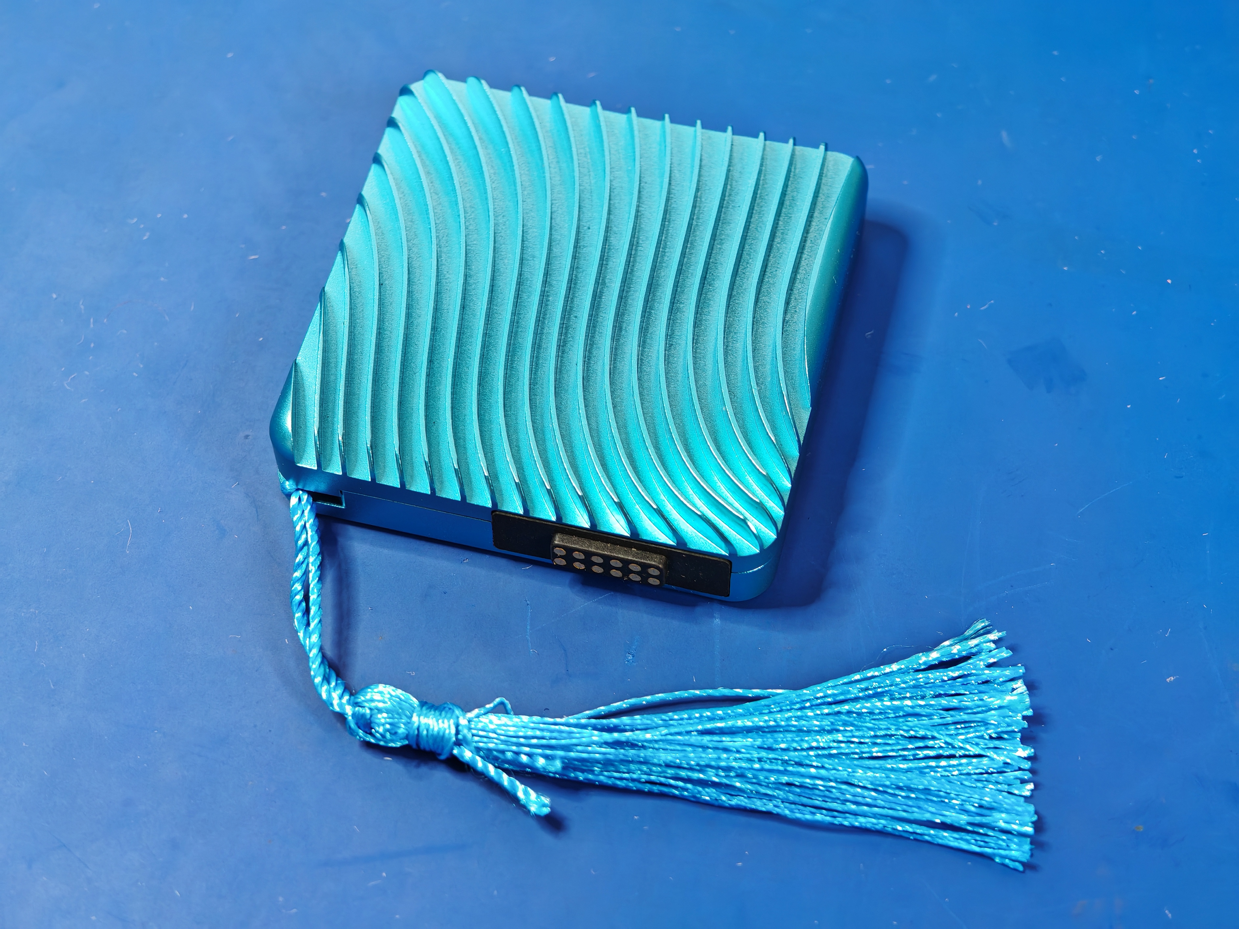

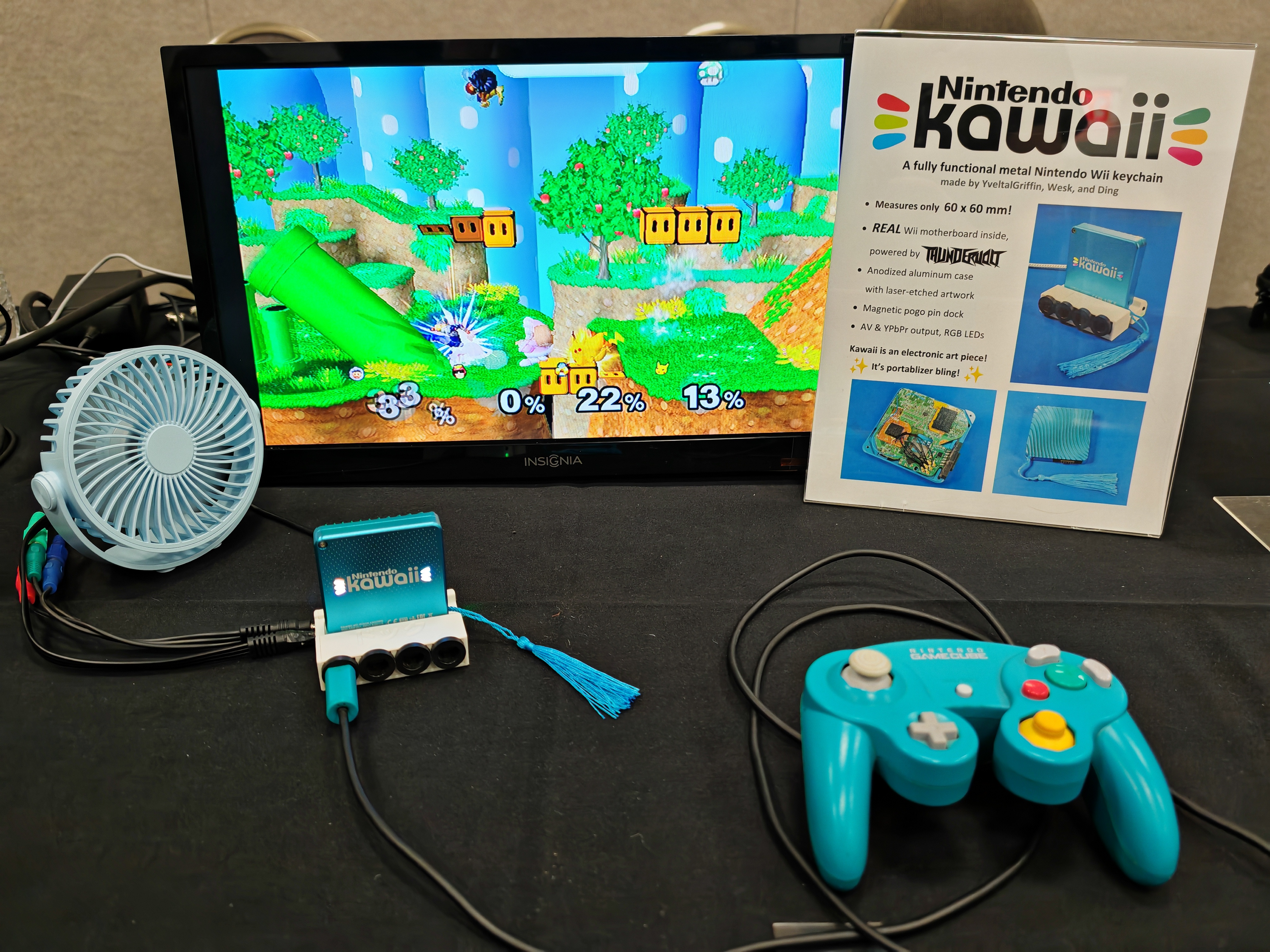

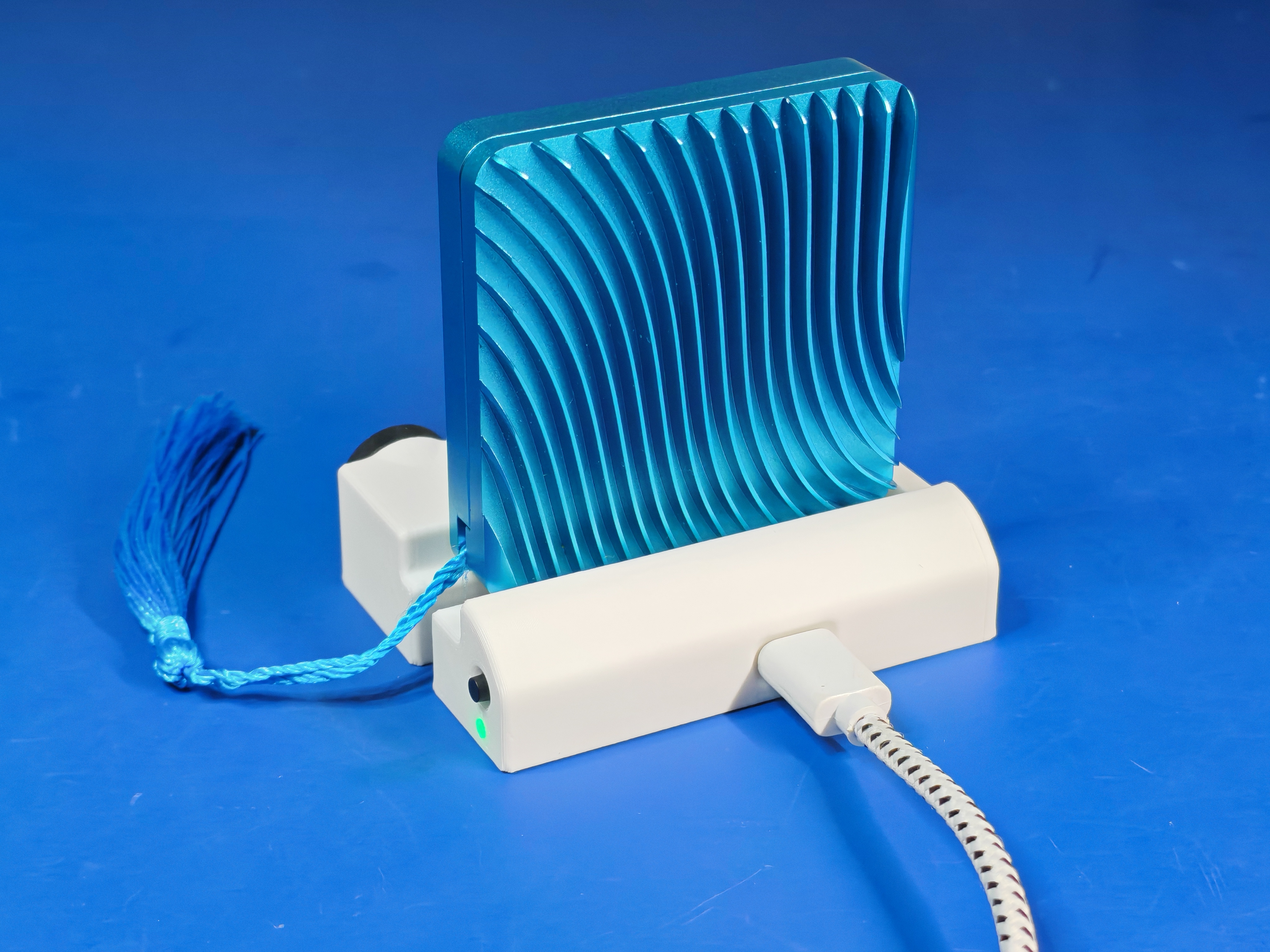

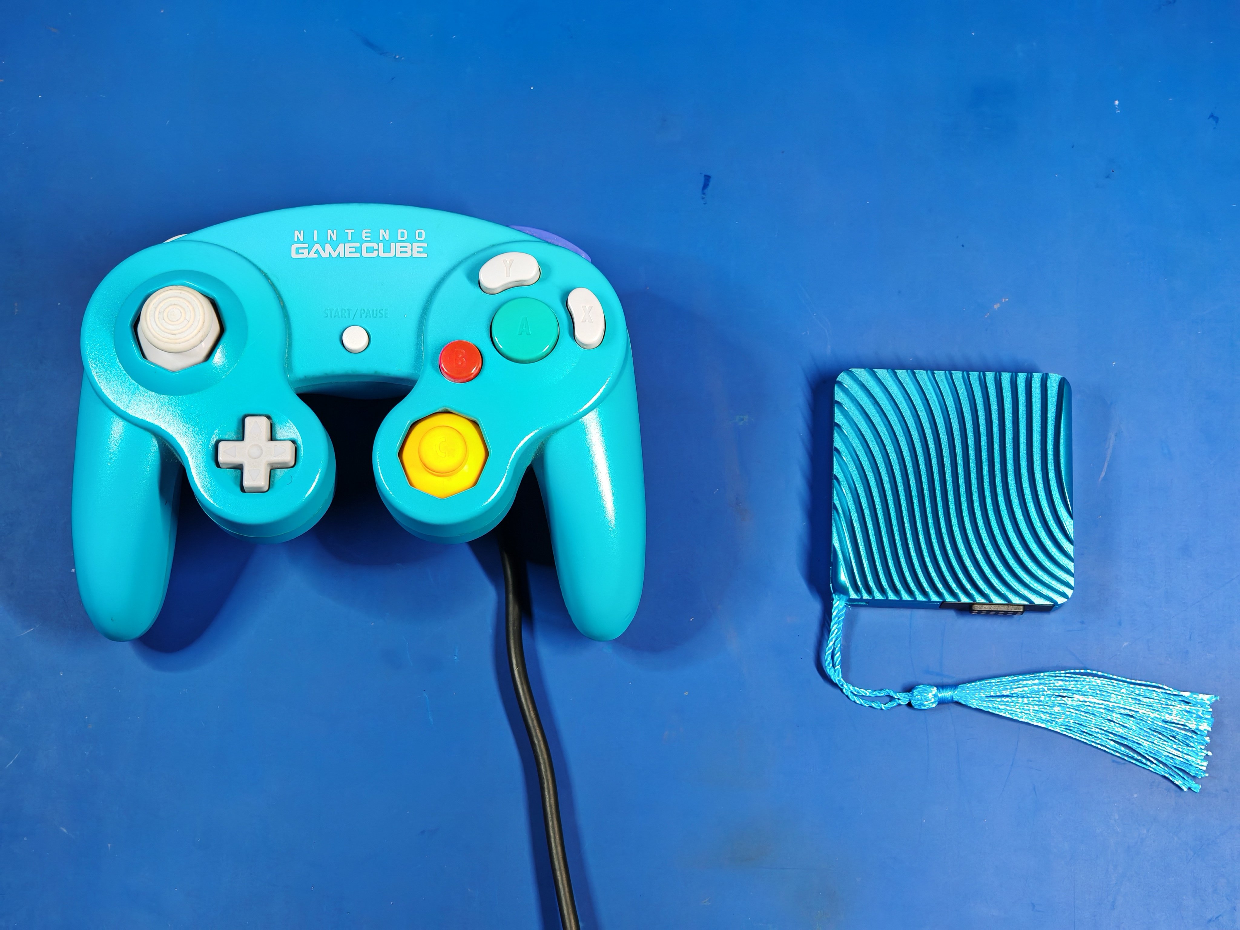

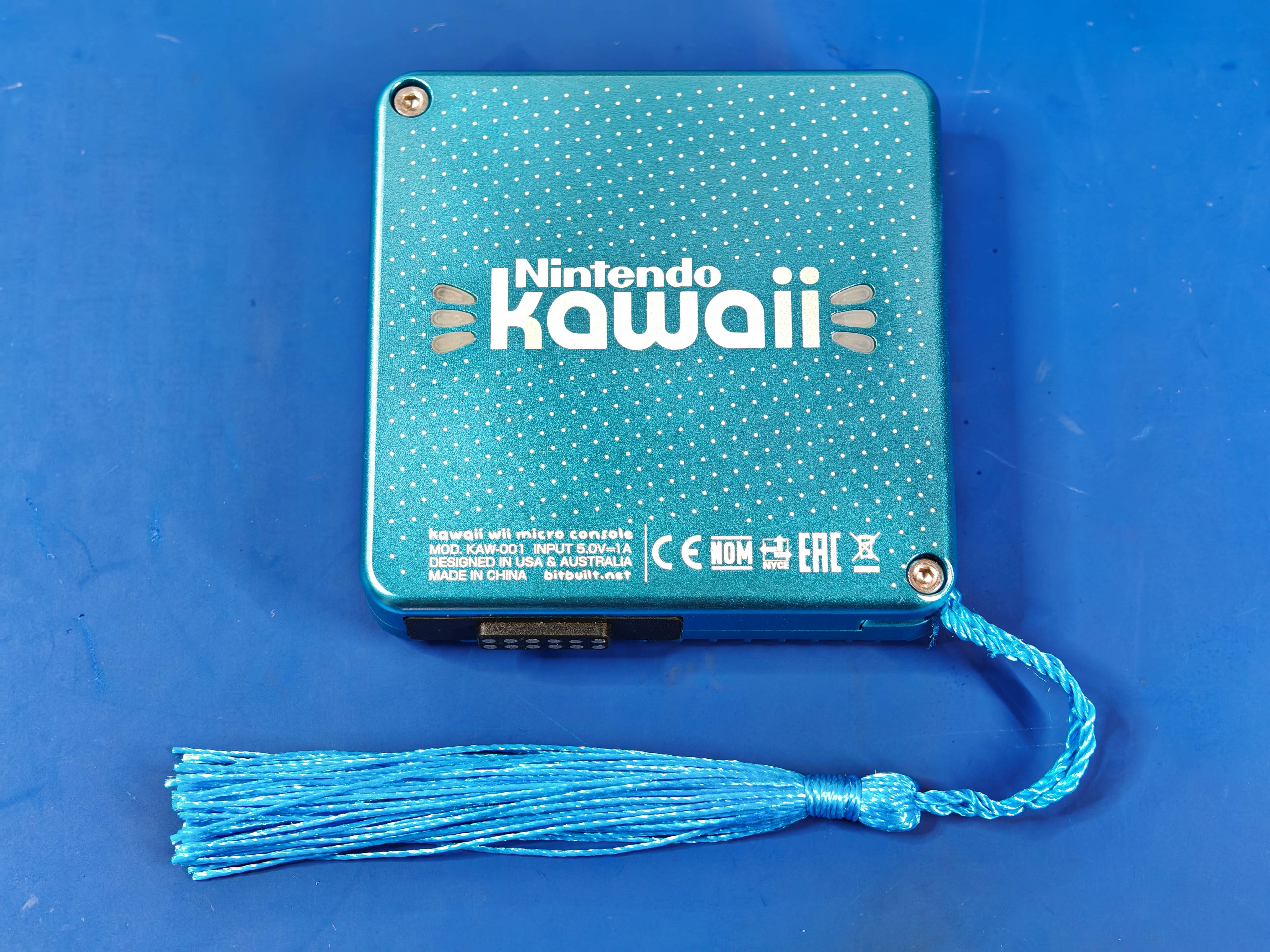

The Kawaii made its public debut at the 2025 Midwest Gaming Classic last weekend!
It was connected to an HDMI monitor via my Retrotink 4K. Being able to pop it off the dock and hand it to people was really special. Many folks had seen it online, and were super excited to hold it in person!

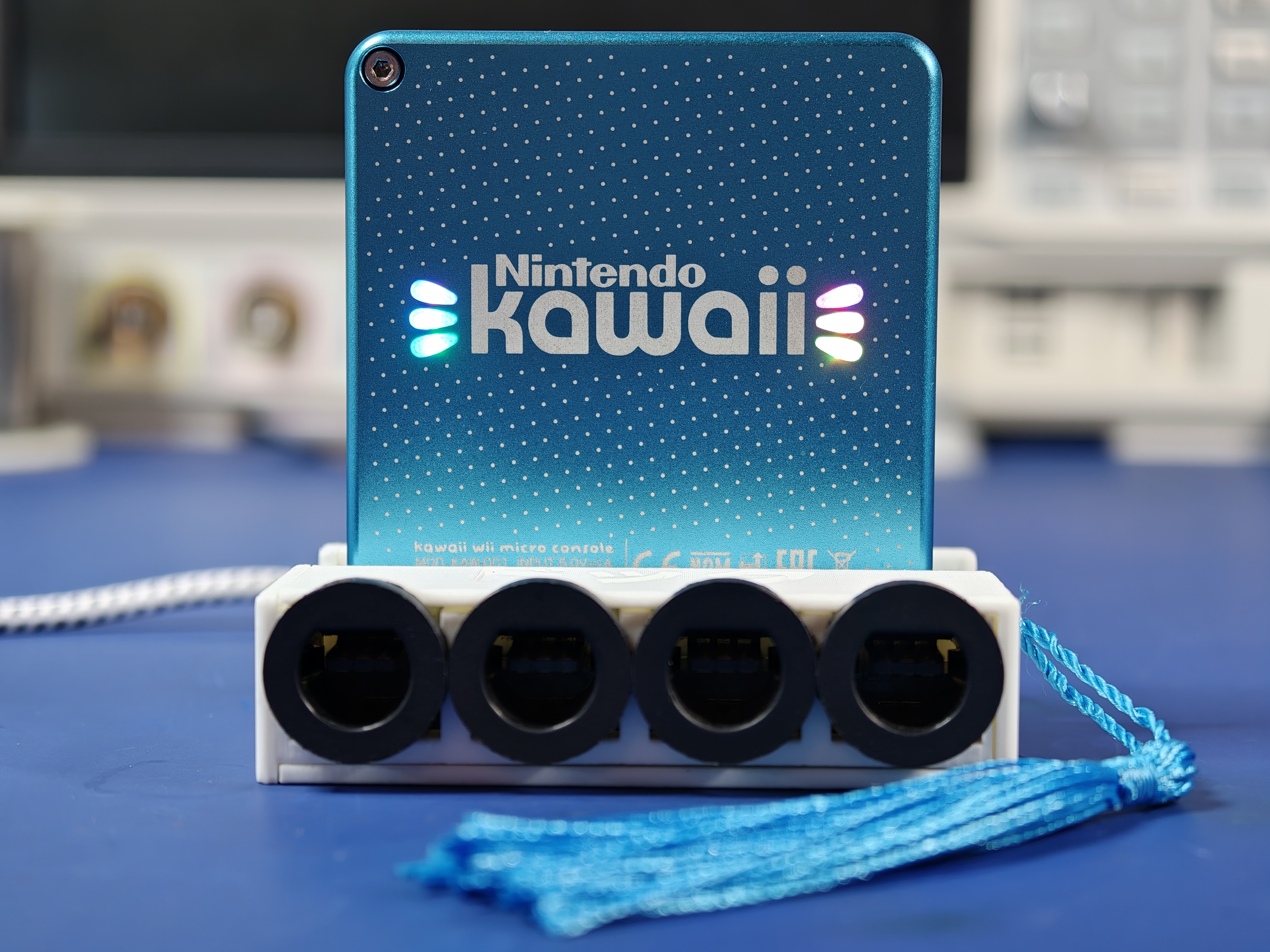

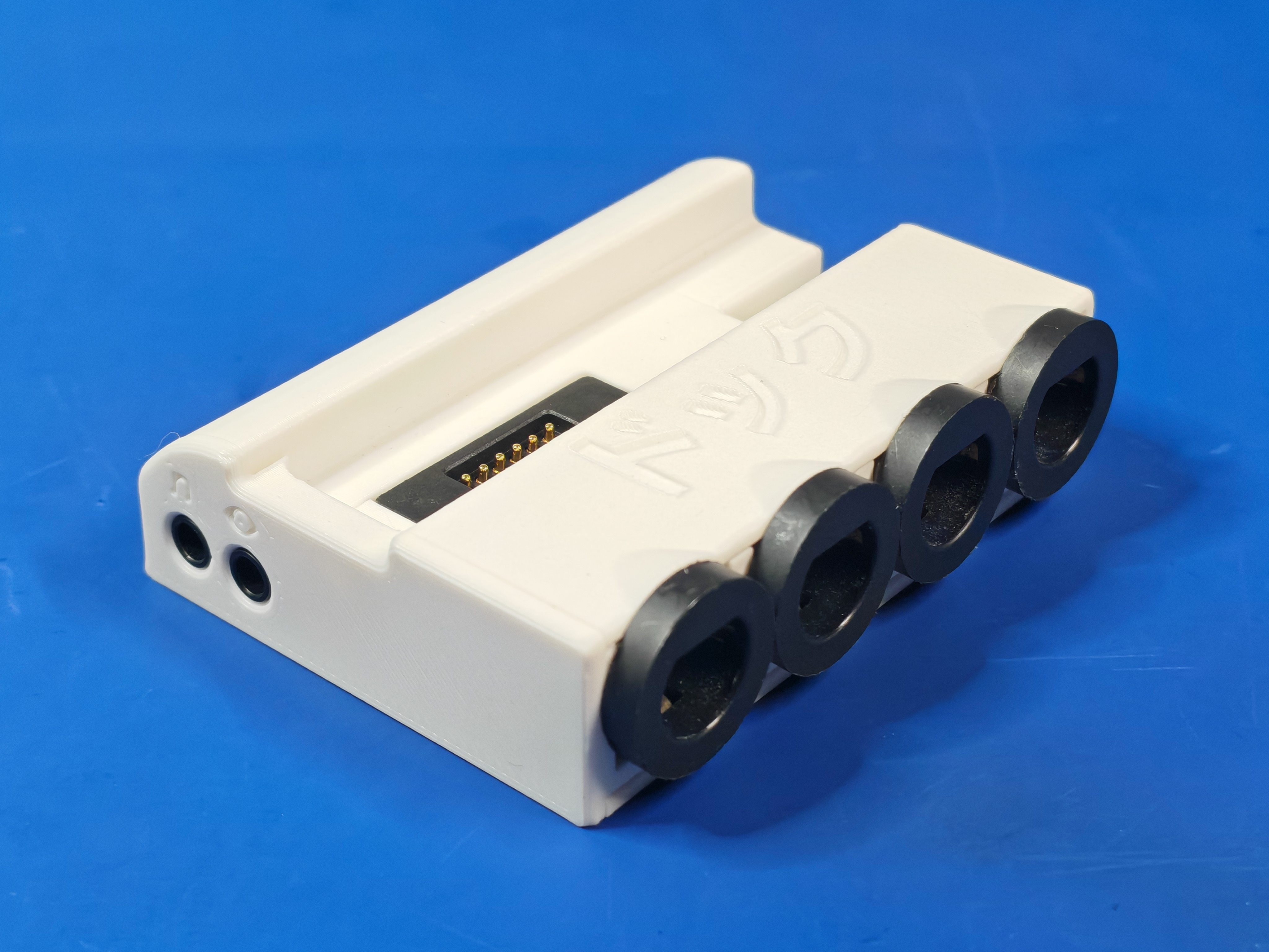

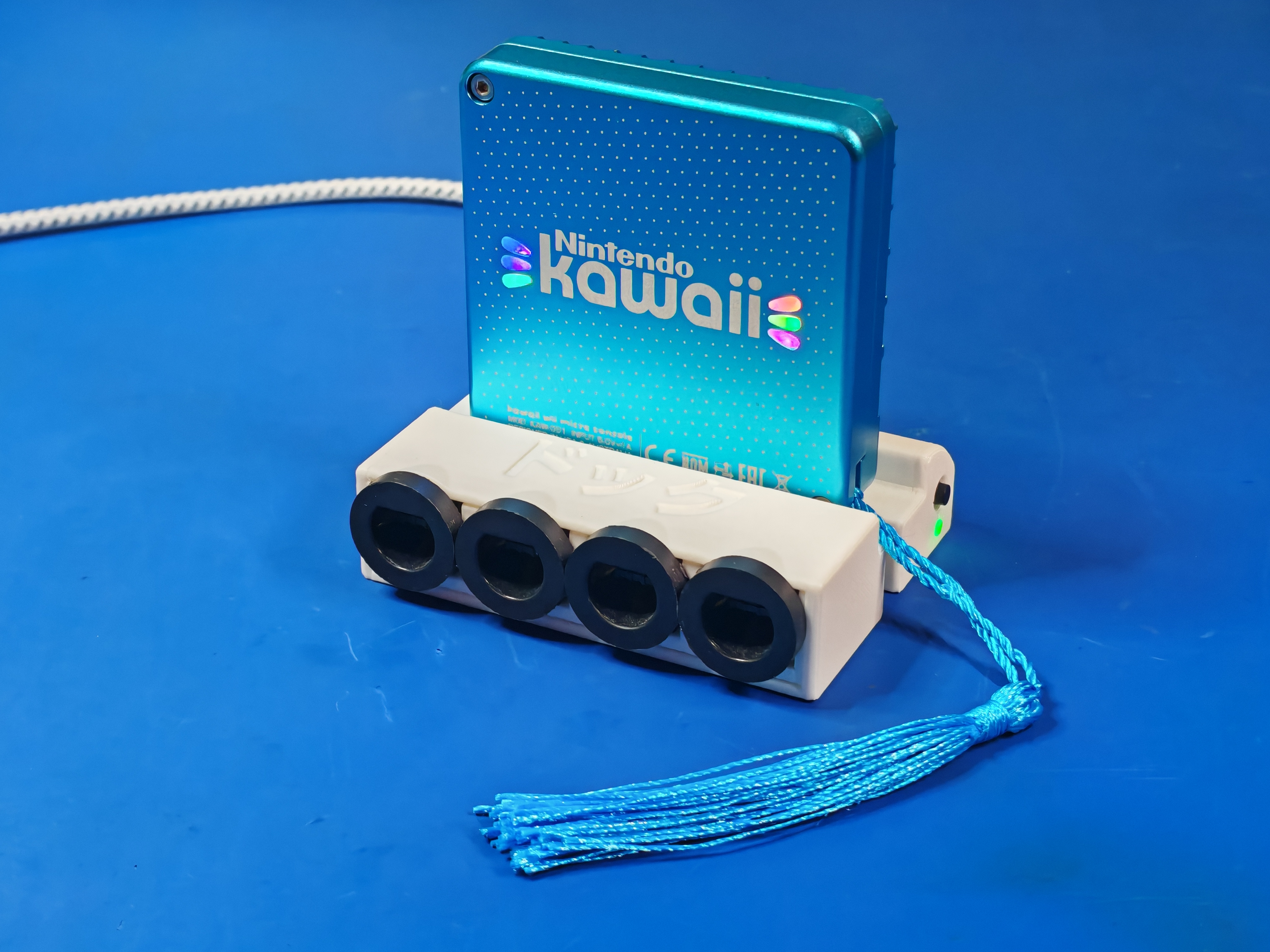

Here are some better photos of the Kawaii and dock.

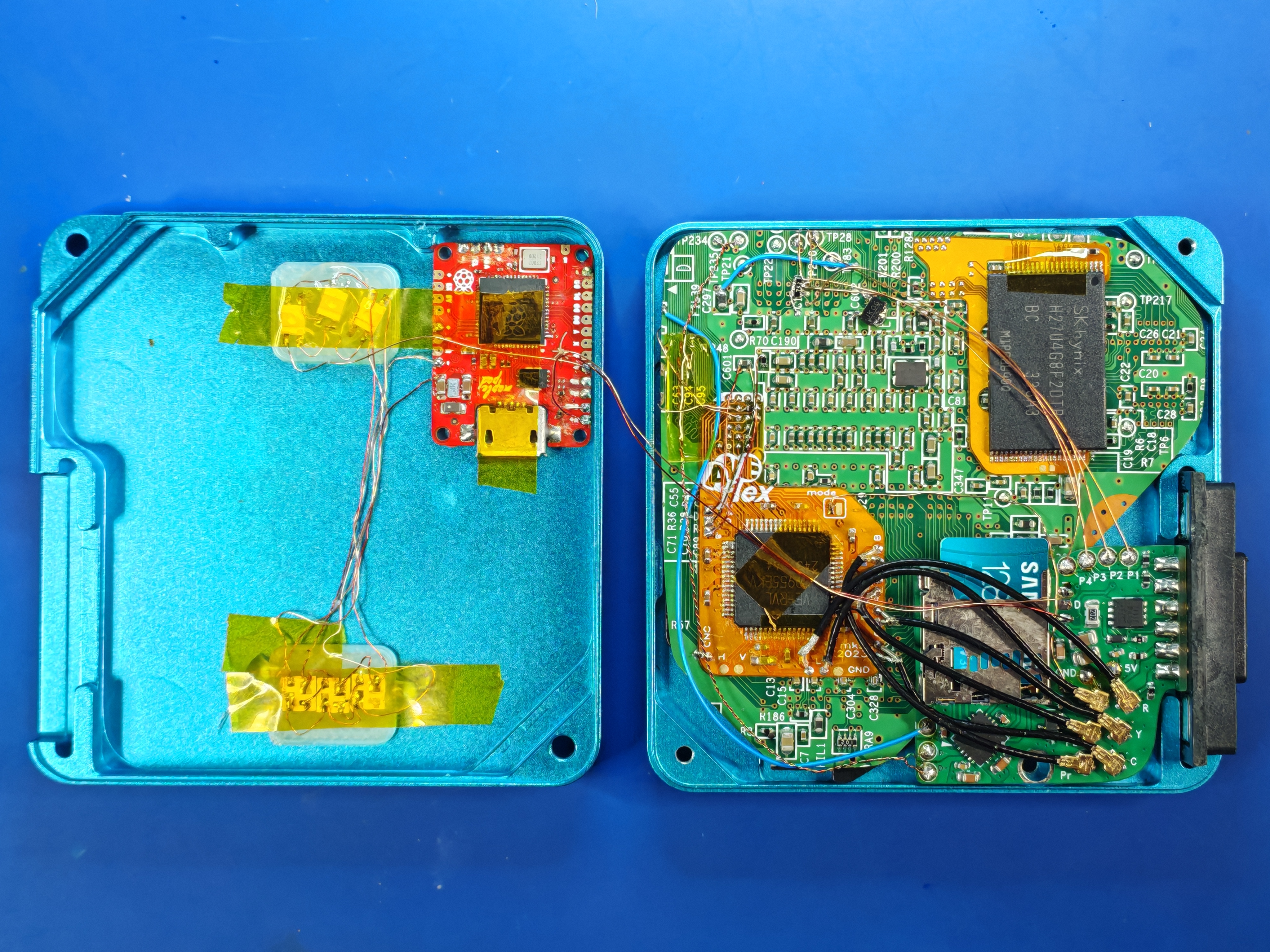

Unfortunately, I couldn't get Thundervolt's RGB LED control working in time for MGC. As a stopgap solution, I wired up a MaplePad RP2040 board I had lying around. The LEDs and MaplePad are hot glued in. The final RGB LED PCBs will fix this jankiness.

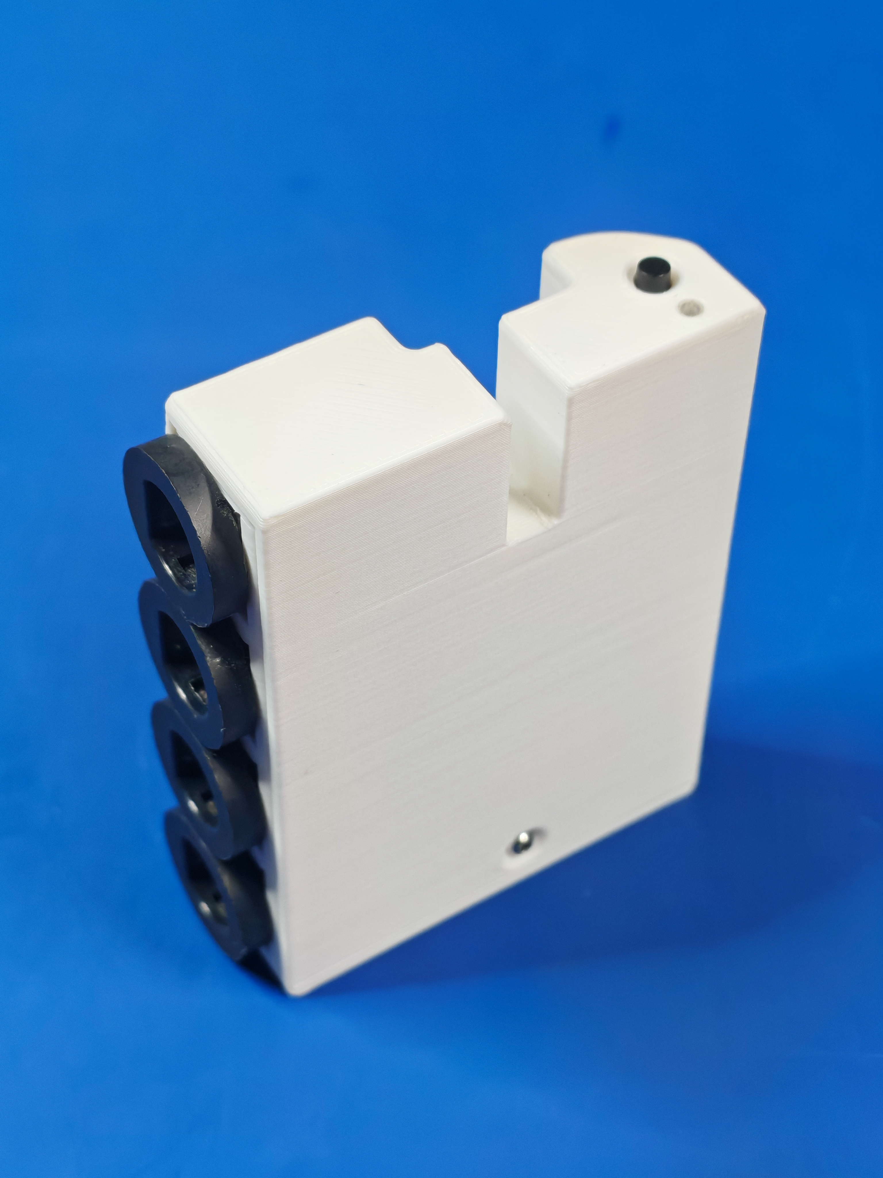

Some details about thermals:
  • With the 20x20x6mm fan dock, the Hollywood-2 Kawaii "stabilized" at 60°C board temp, ~50°C external temp.
    • While this was 15°C lower than the Hollywood-1 Kawaii, it still wasn't cool enough for users to touch the unit while it was on
    • The tiny fan was kinda whiny. And the Wii still crashed if the ambient temp was high enough (>24C)
  • At MGC, I used the original fanless dock, and had an external 5-inch fan blowing on the Kawaii at all times.
    • This kept the internal board temp at 40°C or less the whole time! External temps were 30-something degrees
    • People were able to touch and handle the unit with this setup, which was great!
  • On achieving passive cooling:
    • Wesk and I played around with enlarging the dock to fit a bigger fan, but honestly I don't like how the bigger docks looked.
    • A copper Kawaii (with silkscreened graphics?) might solve the thermal issues, at the cost of aesthetics.
    • Increasing the aluminum shell's fin count, delidding and liquid metal probably wouldn't make much of a difference.
For me, this project was always a meme build / OMEGA showcase, rather than something meant to be used on a daily basis (build a Short Stack or GC Nano for that!) The Kawaii really is a piece of electronic jewelry more than anything else. As such, I am very satisfied with the current state of the project, even if it's not 100% passively cooled.
I'll design and order the RGB LED PCBs soon. Once those are tested, everything will be open sourced on my GitHub! After that, I'll look into doing a group order of anodized shells.

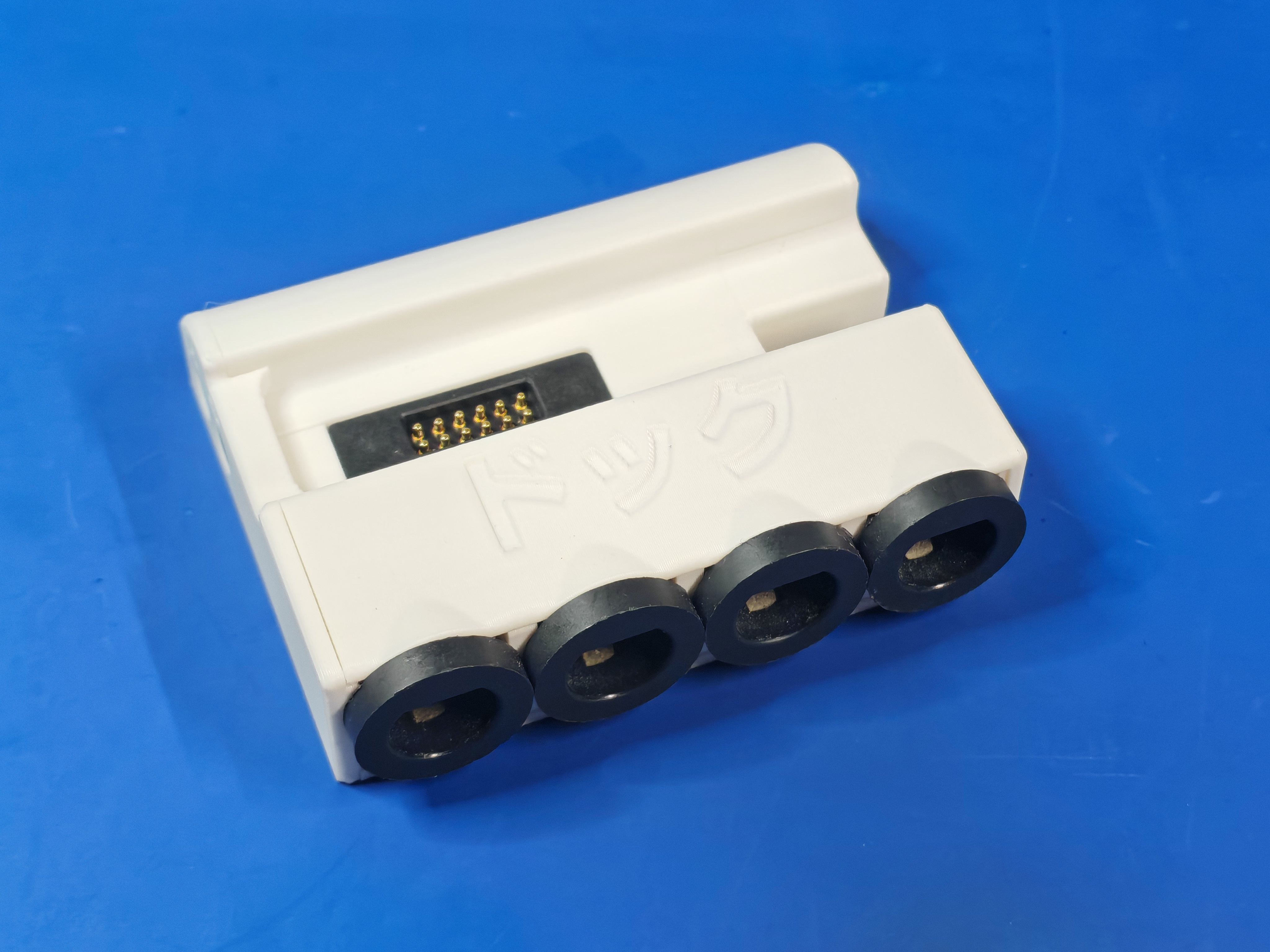

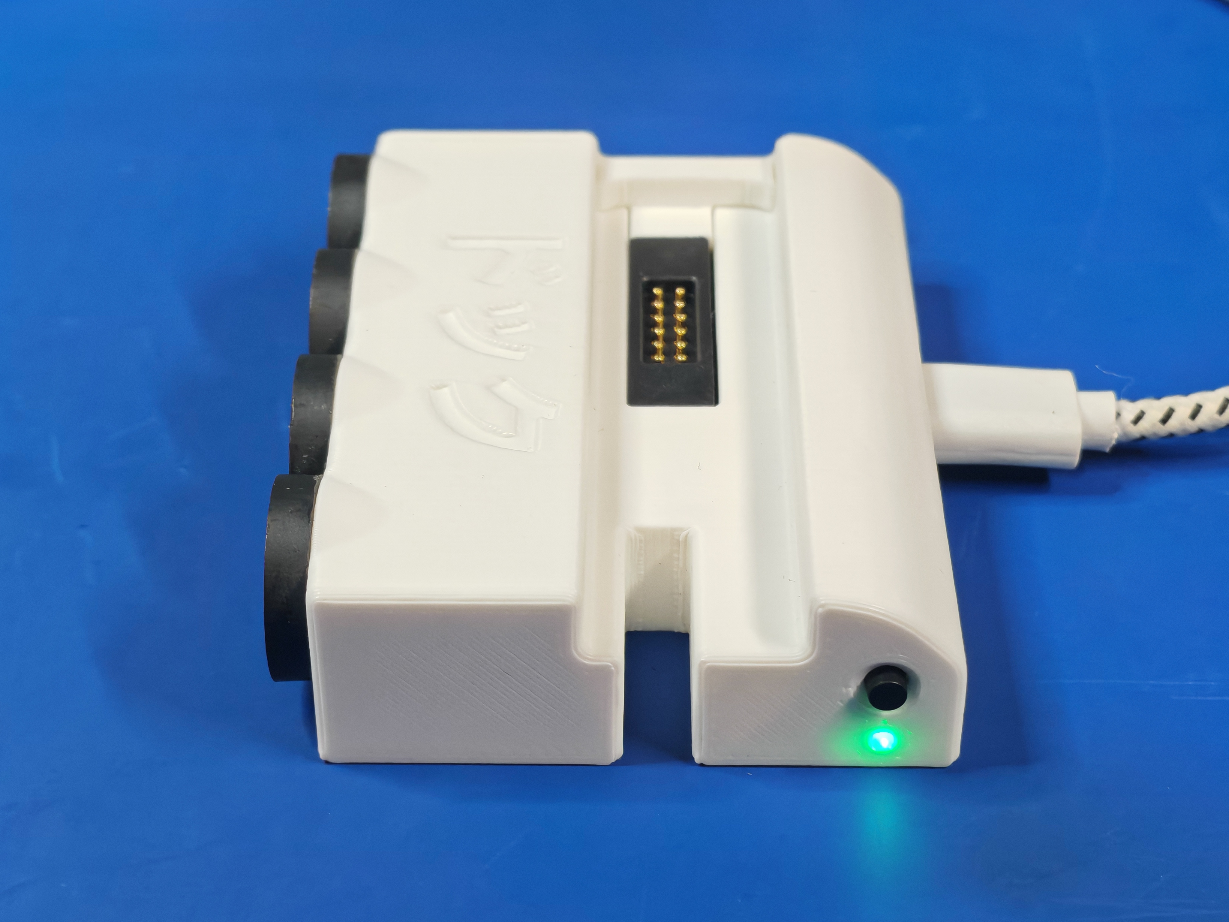

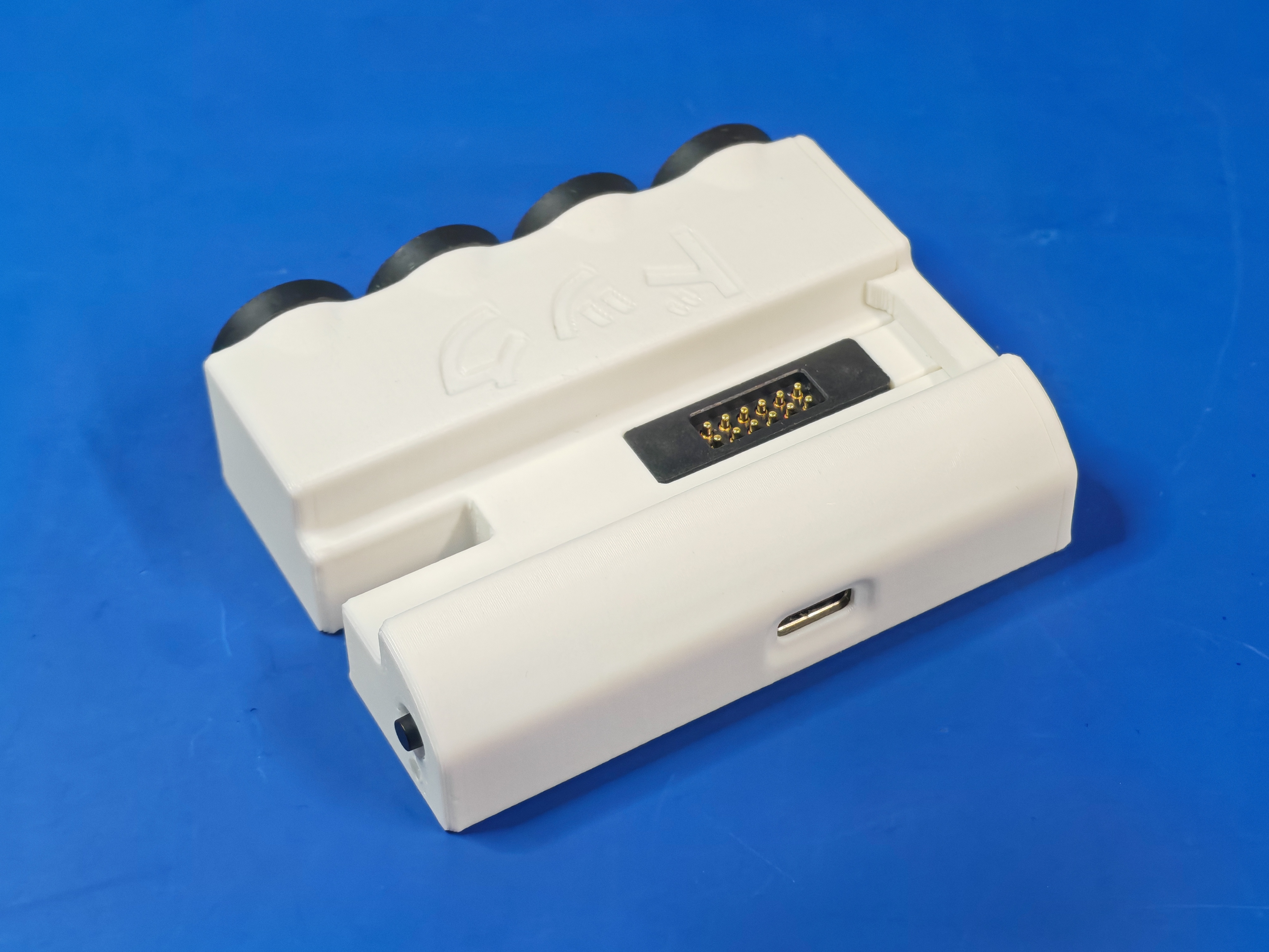

View attachment 38334View attachment 38335
View attachment 38337View attachment 38338
View attachment 38339View attachment 38340View attachment 38341

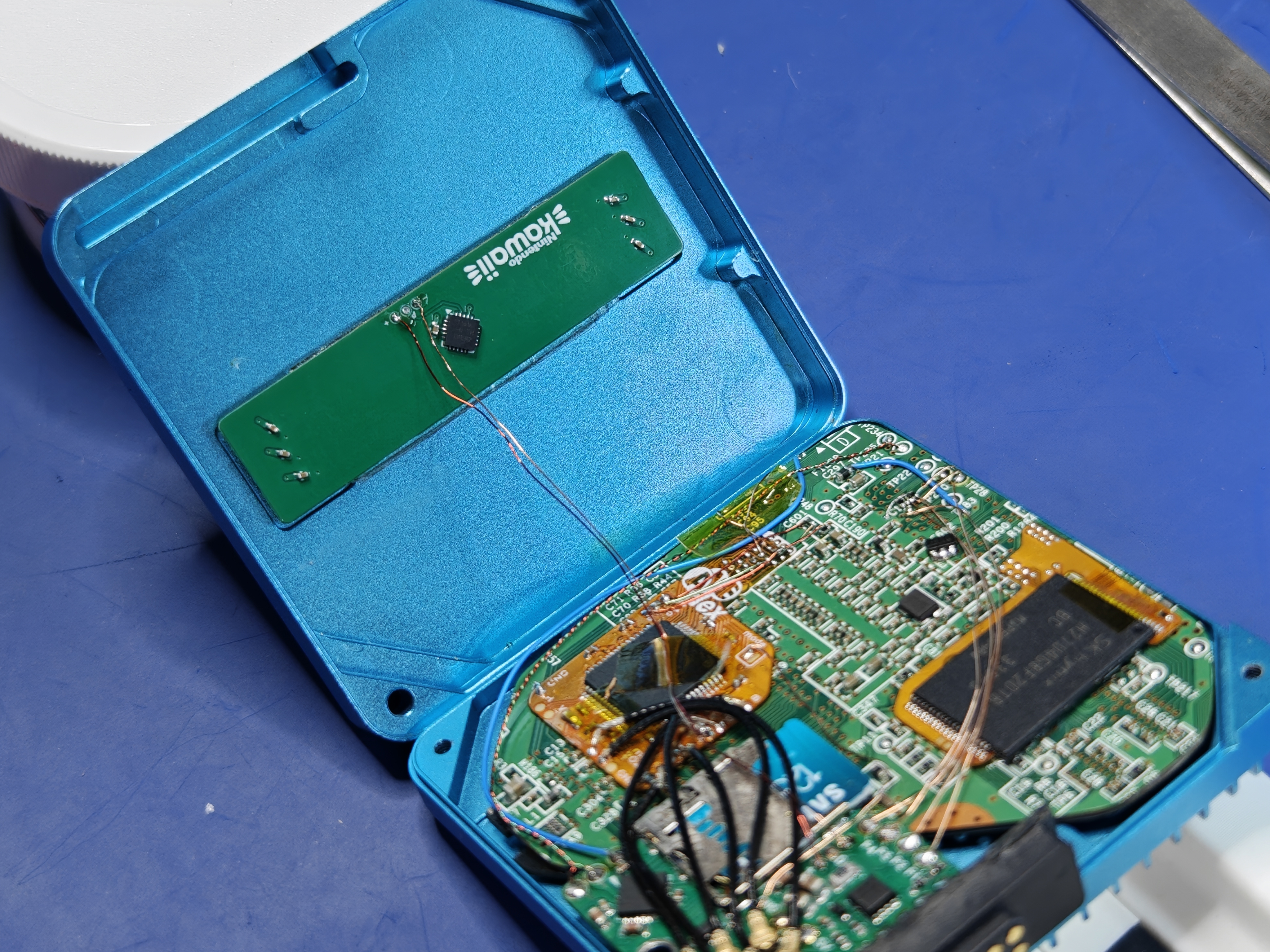

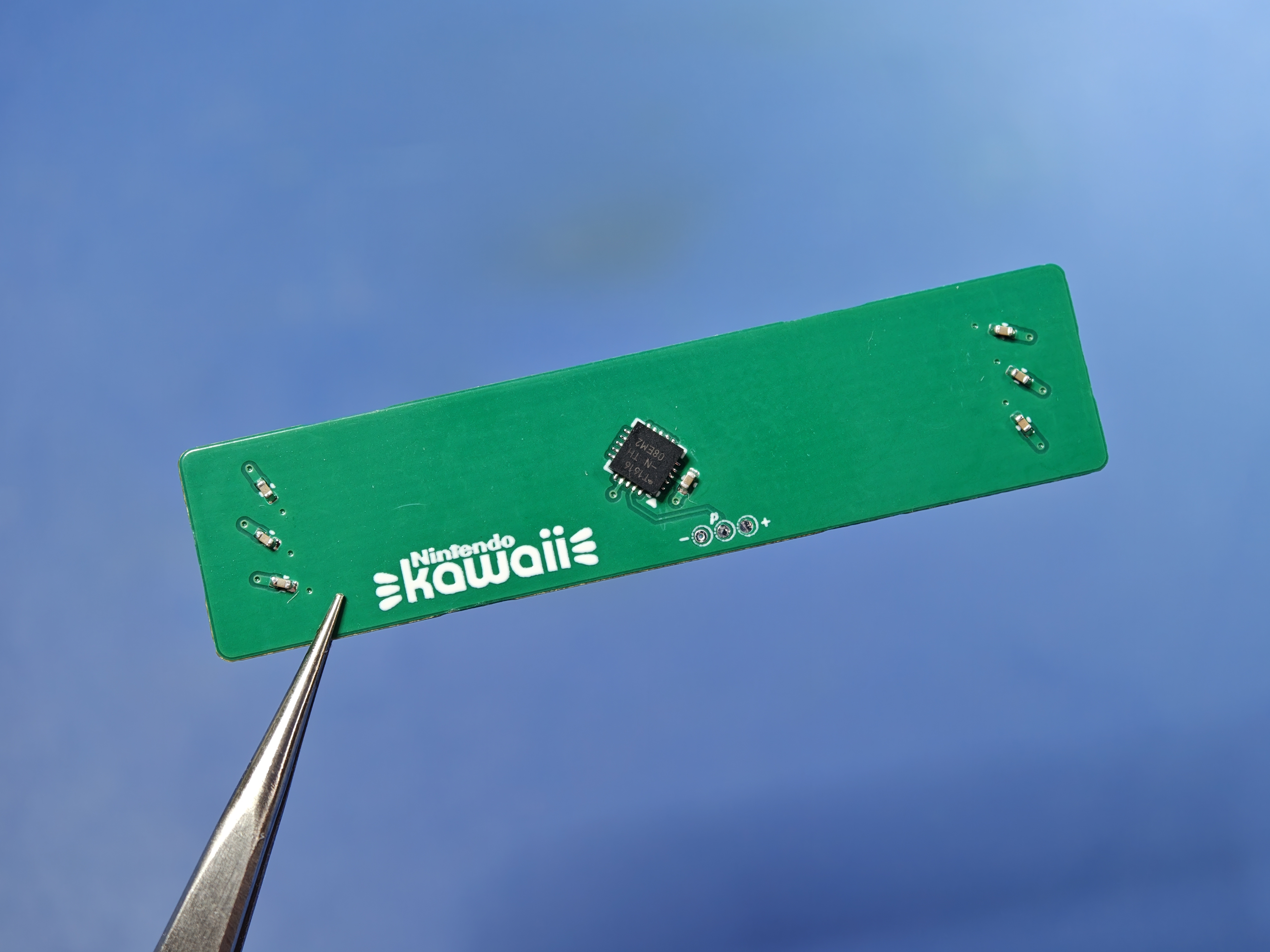

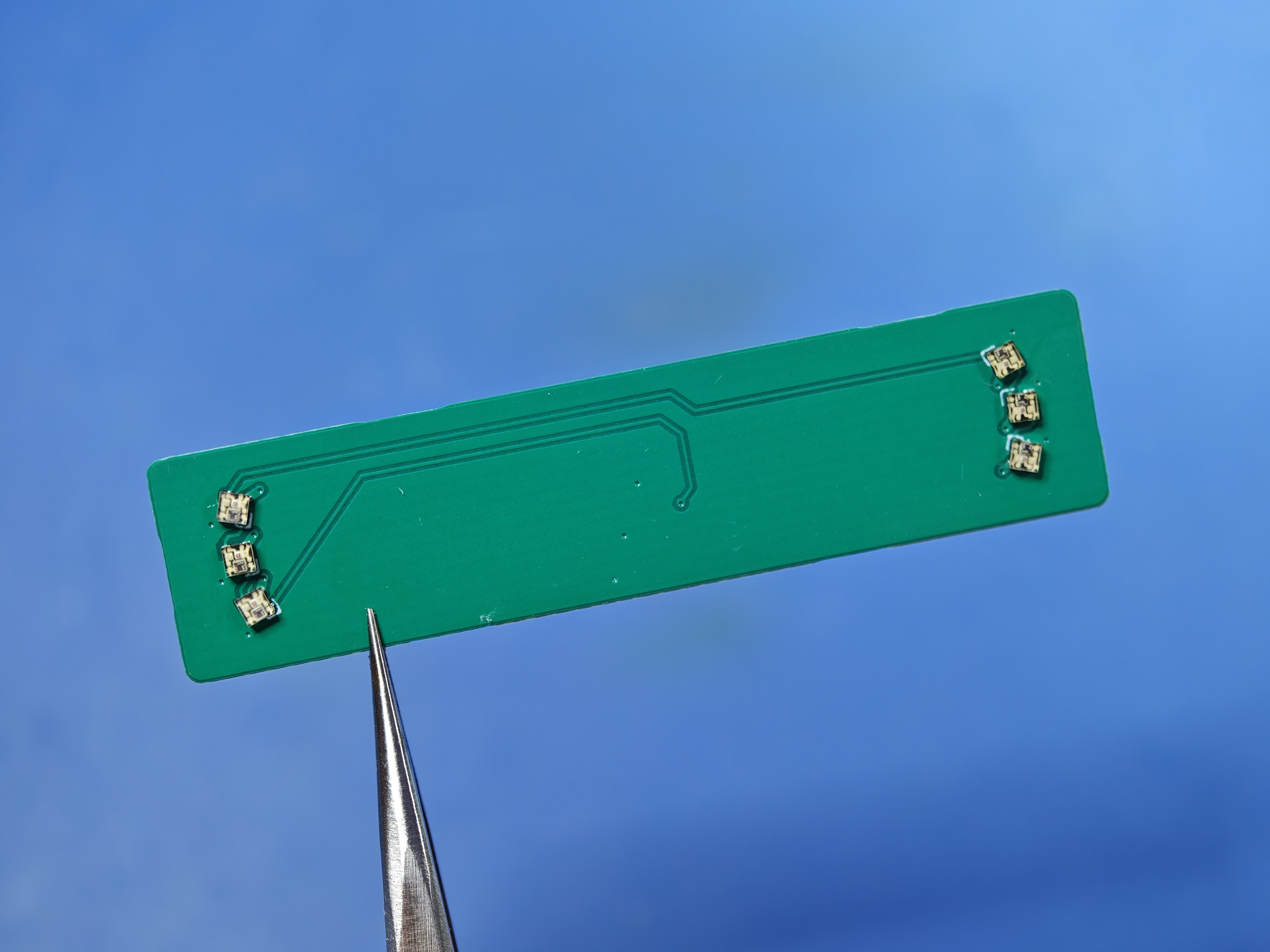

I took a break from projects for a while, but I'm back and preparing for the release of the Kawaii.
This weekend I tested the new RGB LED PCB, which has an ATtiny1616 and six SK6805-EC15 addressable LEDs.
It's adhered to the rear shell with super strong 3M 300LSE tape.
The LEDs looking washed out is a limitation of my new phone's HDR. They're just as vibrant as before.
@Redherring32 and I have discussed making a pure silver Kawaii, by melting down some bullion to form a square billet for Ding or someone else to CNC. Besides the higher thermal conductivity, silver would bring the project full circle, back to the idea of jewelry.
But for now, I want to wrap this project up so I can focus on other things. I'll post all of the MCAD & ECAD files to GitHub within a few days, so anyone can build a Kawaii of their own. No assembly guide will be provided beyond what's already been posted in the worklog. Thanks for following along! :D
