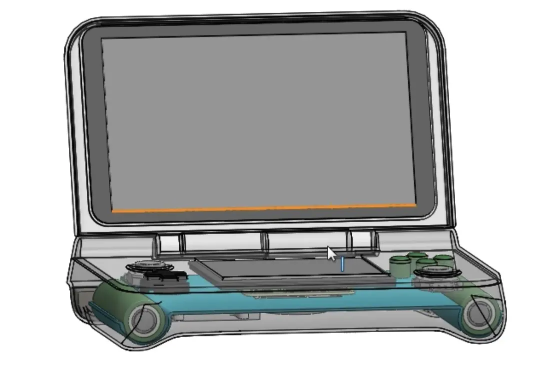

I don't have much worthy to share at the moment, but I can at least share some of the specifications I have planned and a quick CAD picture.
Retro Flip CMx
Retro Flip CMx
- Analog triggers via RP2354B gamepad - hall sensors - custom molded
- Shoulder buttons - custom molded
- BQ25792 IC, with dual power path support for VBUS input
- 2S battery configuration with buck reg and balancer
- TPS65988D (for 2 USB-C ports) - one port supports USB 3.0, OTG and DP. Other port supports USB 2.0 and PD
- DisplayPort support
- Hall sensor for lid switch - auto sleep on lid close
- 3DS sliders. Rear back buttons for L3/R3
- Custom heatpipe plus finstack design for cooling
- Switch lite fan
- Button for entering maskrom mode/eMMC programming
- Top screen - DSI (7" OLED top display, 1080p, 16:9)
- Bottom screen - DSI (4.16" IPS LCD, 960p, 4:3)
- Two 3DS XL hinges
- Switch joycon rumble motors
- Switch joycon ABXY
- Internal skeleton - removable base shell (inspired by Tschiki's PS2 portable)
- Blackberry 8520 finger IR touchpad x 2 via SPI (think steam deck trackpads, but small!).
- 2 x hotkeys for various functions
- Gyrometer
- CM-Q85 (QCS8550), CM-Q87 (QCS8750) compatible
- Custom PCBs - controller and carrier
- Custom capactive stylus
- 2x 21700 Tesla cells (10Ah capactiy) w/ battery clips
