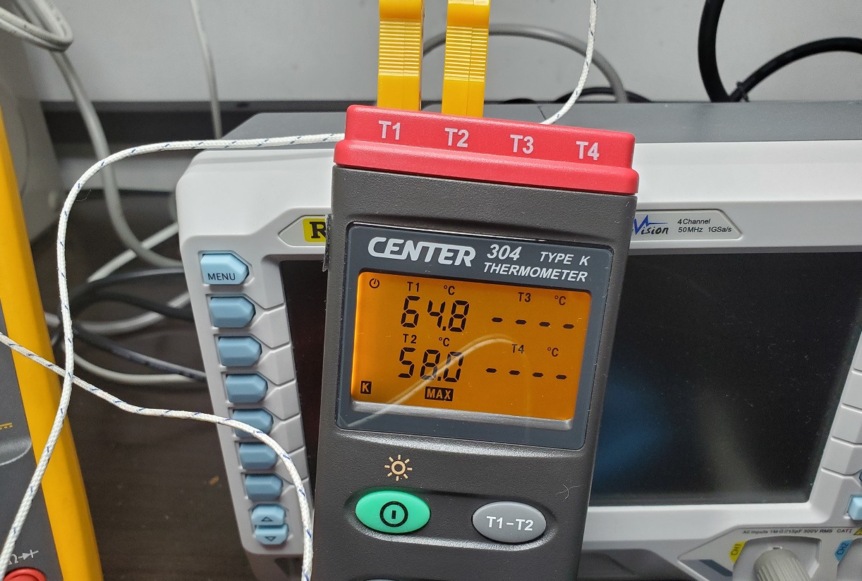

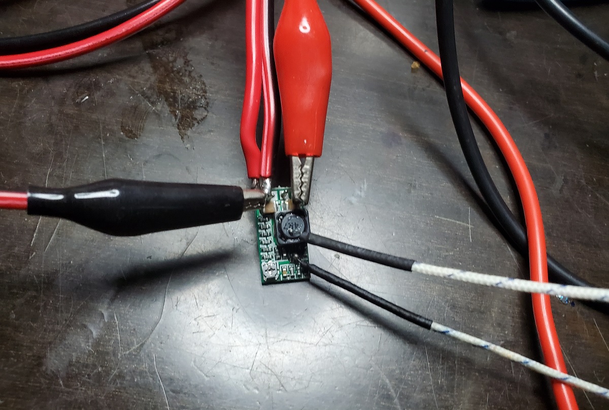

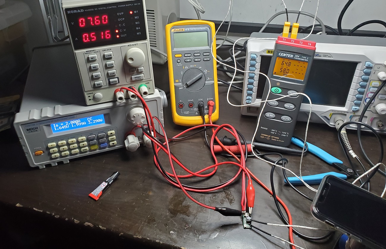

OK, time for me to eat a bit of crow here. I just had an attack of boredom and decided to test the regulators that the OP linked to ... and they honestly seem pretty good.
View attachment 9082 View attachment 9083 View attachment 9084
This is my (messy!) test setup - the voltage was basically arbitrary (it's what you get when you jump the 1.8V link but leave the pot connected) - the input voltage was set to 7.6V to represent 2 Li batteries in series.
I left it running for 3 hours @ 2A load, the the peak temperatures were as indicated - the upper display (T1) is the regulator IC and the lower one (T2) is the magnetics. The end of run temperature was about 3 deg. C less than the recorded maximums in both cases.
DC efficiency is 83%, and remained pretty much unchanged throughout the run.
I would expect the PTH08080 modules to be a bit more efficient and run slightly cooler - mostly because they have a dedicated low-side switch and judging from the waveforms this one doesn't.

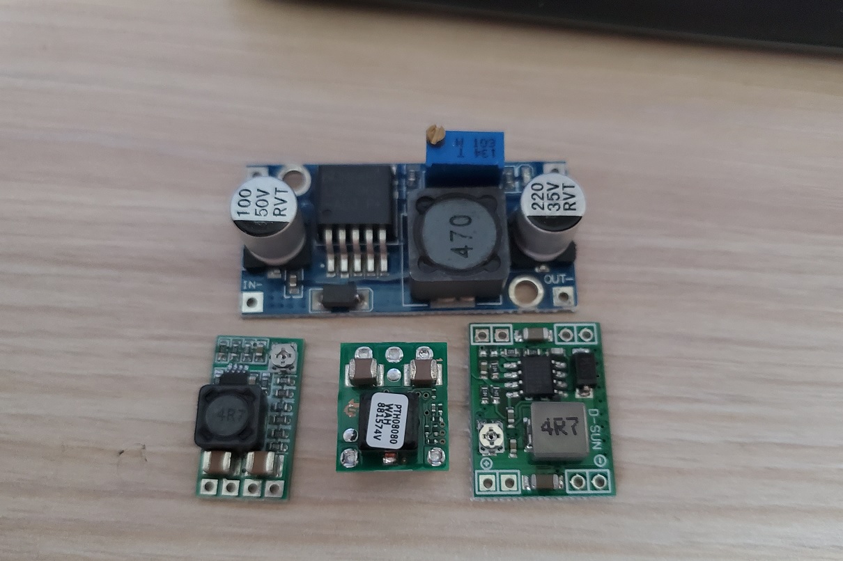

OK, I'll do some more testing - probably at the weekend. I'll try to get some comparison data. To add some context, I've dug out a few other regulators, too:
The top one is one of those terrible LM2596 regulators - it's mostly included for comedic purposes, since I fully expect it to grenade on at anything like full load. The next (from the left) is our mystery regulator using an unknown IC from some unknown vendor, the next is a PTH08080 (bought from Avnet, so presumably real) this uses a TI TPS54350 and should be properly designed since it's from the same vendor as the chip - the last is another little switcher based on the Monolithic Power MP1584 - this is a high frequency (1.5MHz) chip, which may explain the small size of the inductor. Or it might just be underspecified...
the left one is what i used in my first portable,it works well until now,but the quality of these regs vary from the chip quality they used. Now when powermii pcb becomes opensource, i turn to make it , and i found the inducer quality is very important to avoid overheating

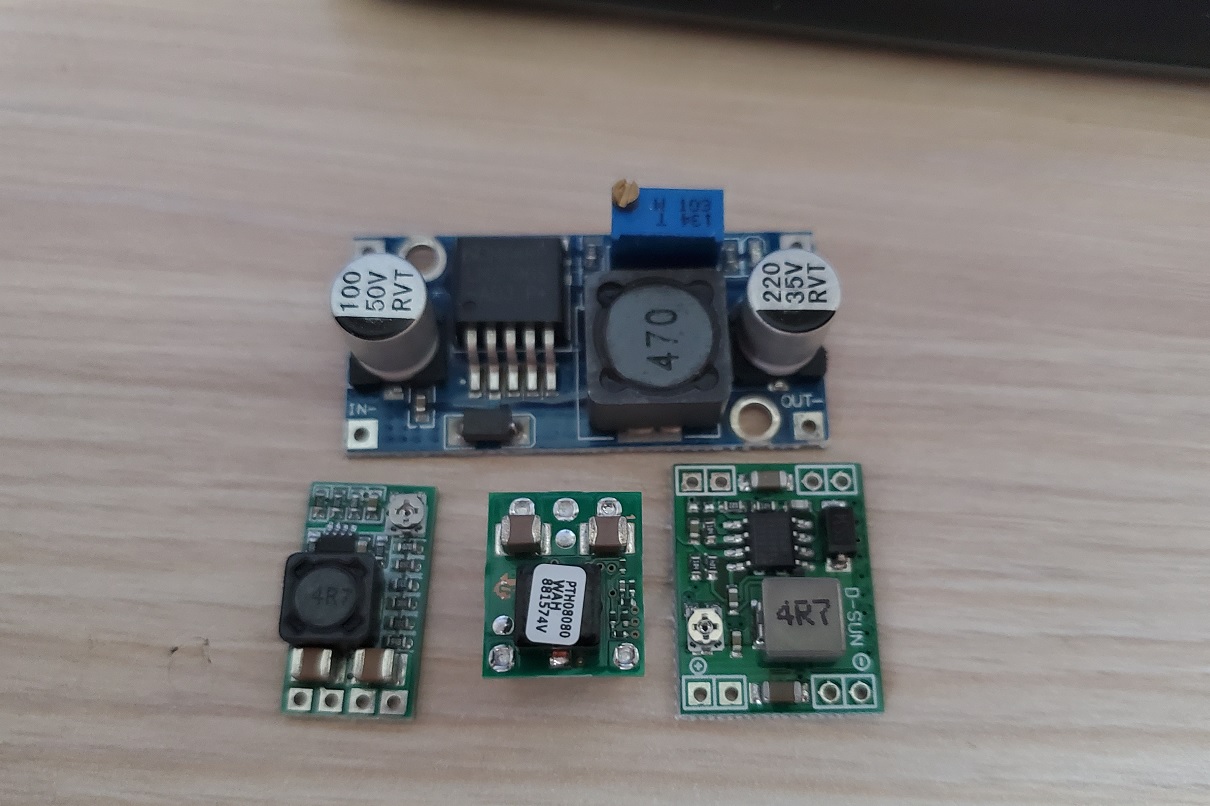

OK, the results are in, and it took a lot less time than I expected, because two of them were so bad no extensive testing was done.
The chosen testing conditions were 1.0V output and 2.0A load, since this is an operating point that will make the regulators work really hard.
DUT 1: LM2596 based regulator.
Well, I expected it to suck, and it didn't disappoint me - I had to test this at 1.2V because that's the lowest specified output voltage. The output voltage was highly unstable and had about 200mV p-p noise on it. DC efficiency was 49%. I terminated the test early when the IC hit 86.4c after about 5 minutes of operation. OK, it didn't actually blow up, but I have a feeling it would have if left longer.
DUT 2: MP1584 regulator
I expected this to be a decent performer, but it turned out to be nearly as bad as the first one - at least it could be trimmed down to 1.0V, but on anything more than about 500mA load it was constantly shutting down and restarting. When I trimmed the voltage up to the point where it worked normally (about 2.4V) then the DC efficiency was 61% - I didn't bother testing the thermals since I was pretty sure they were going to be bad given the low efficiency. (*1)
DUT 3: Mystery Taobao regulator
This one at least gets credit for actually working - this time I tested it at 1.0V, and the performance was somewhat degraded from the results I got earlier at a higher output voltage. This time it hit 66.3c (on the chip) and the measured DC efficiency was 78%. Noise is about 60mV p-p - neither input or output filter caps made much difference to this, so it's presumably inherent regulator noise.
DUT 4: PTH08080
As expected, this was the best performing device - this was connected with a 100uF input filter cap as per the datasheet recommendations, but no output filter cap. One interesting result was that this was the only part where the magnetics got hotter than the chip did - the chip hit 42.2c and the magnetics 45.6c. Measured DC efficiency was 93% - noise was about 25 mV p-p.
Conclusions:
The obvious favorite here is the PTH - the Taobao regulator did work, but it is significantly less efficient and runs noticeably hotter than the PTH did and is hence not possible to recommend in this sort of battery powered application.
*1: This board had parts fitted with values that were quite different from the ones in the datasheet. It's possible it would work better if they were changed, but that rather negates the purpose of buying a pre-assembled regulator module.

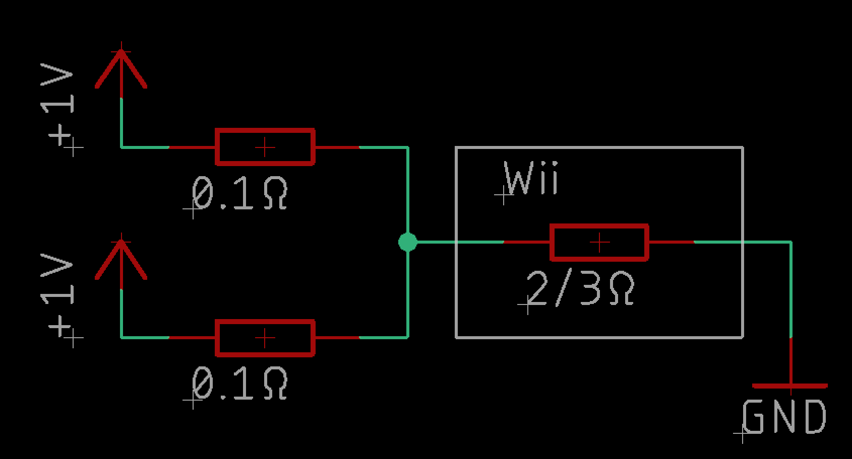

How much proof do you need I'm wondering. You can drive those cheepos pretty hard. If you wire 2 of them in parallel how I mentioned before, you have effectively 0 chance of over driving them. Aside from that, their efficiency improves when they run cooler.
Oh boy..
First, the thing you mentioned about putting two of them in parallel, is kinda stupid; Using a resistor to "isolate" the regs from each other? Smart I guess, but it really doesn't work like that. You are also forgetting the fact that you will cause a very significant voltage drop this way and you are essentially just wasting power. That voltage drop means there is wasted power, directly related to the amount of current drawn by the sink (in this case the wii). Say we calculate the losses for the 1V line. We can roughly do that by considering how much it draws. That would be about 1.5A. (so about 1.5W, again these are all rough guesstimates) We could then represent the components attached to the 1V line on the wii as a 2/3Ω resistor. The entire circuit would look something like this:
See the problem? Those resistors there each will result in about a 0,06W loss. and a 0.08V drop.. Thats not insignificant. Considering the output voltage will drop anyways given the load and their rated current, (which is usually inaccurate with these Chinese regs) you would need to set them at around a 15% or so higher voltage then the voltage you are trying to get to the wii in the end. Anyways, as @Trimesh found, the highest efficiency you can expect from the best reg he tested is 78%.. Not that bad, but catastrophic in a battery powered device. given the fact that there's an 8% loss from these resistors by putting two regs in parallel, and there's a 78% efficiency overall, the total efficiency drops quite dramatically to just 72% (best case scenario, this gets worse the more current you draw).
