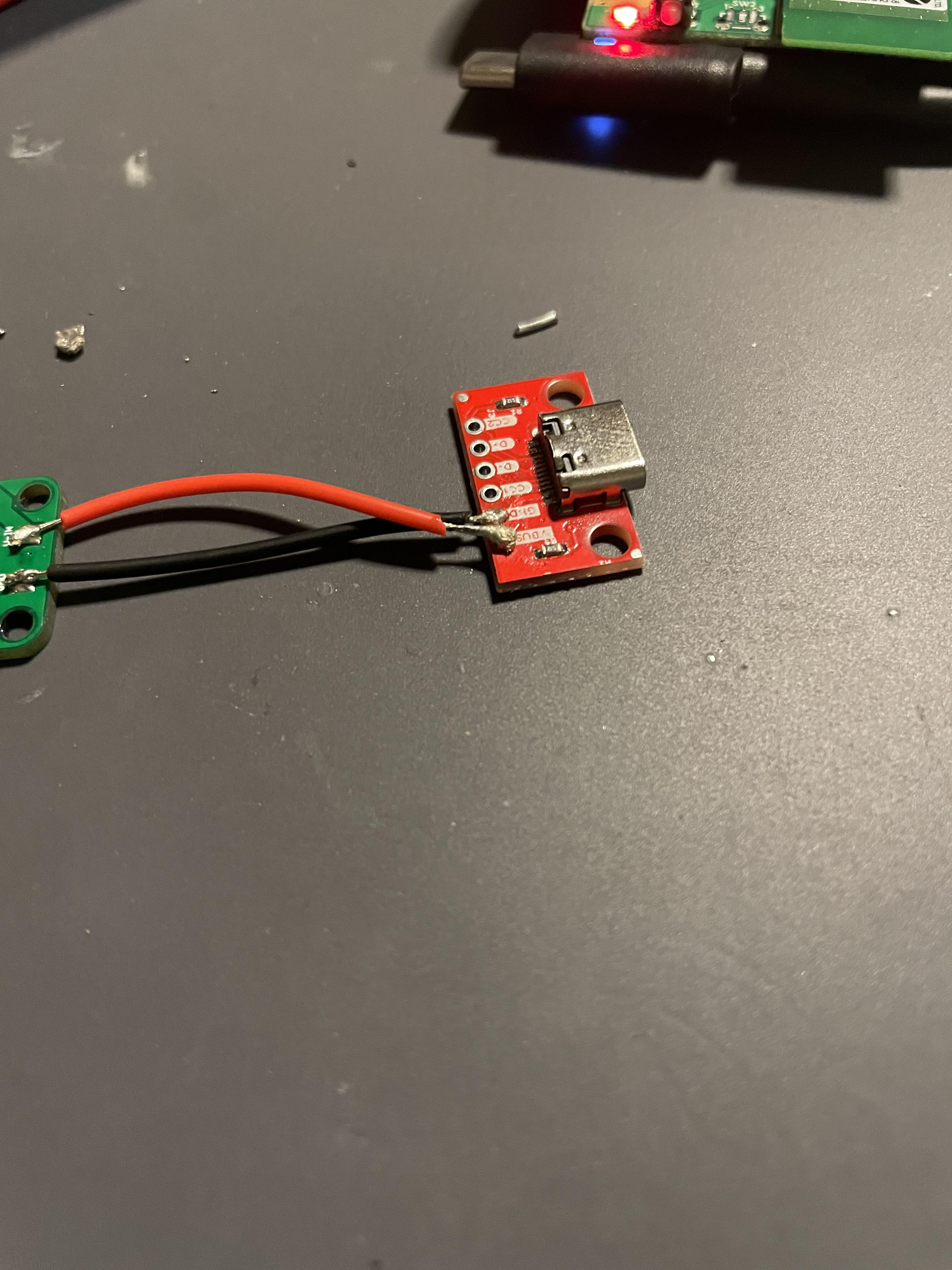

I finally got around to wiring up a USBC power supply to power my regulator board (I luckily had two RVL-PSUs I held out from the store days) but when I wired everything up and checked the voltage, I got 5v of output from this usb-c breakout board, which is fine for me for just testing stuff, I suppose. I knew I needed more than 5v because it seemed like such a low number in my head.

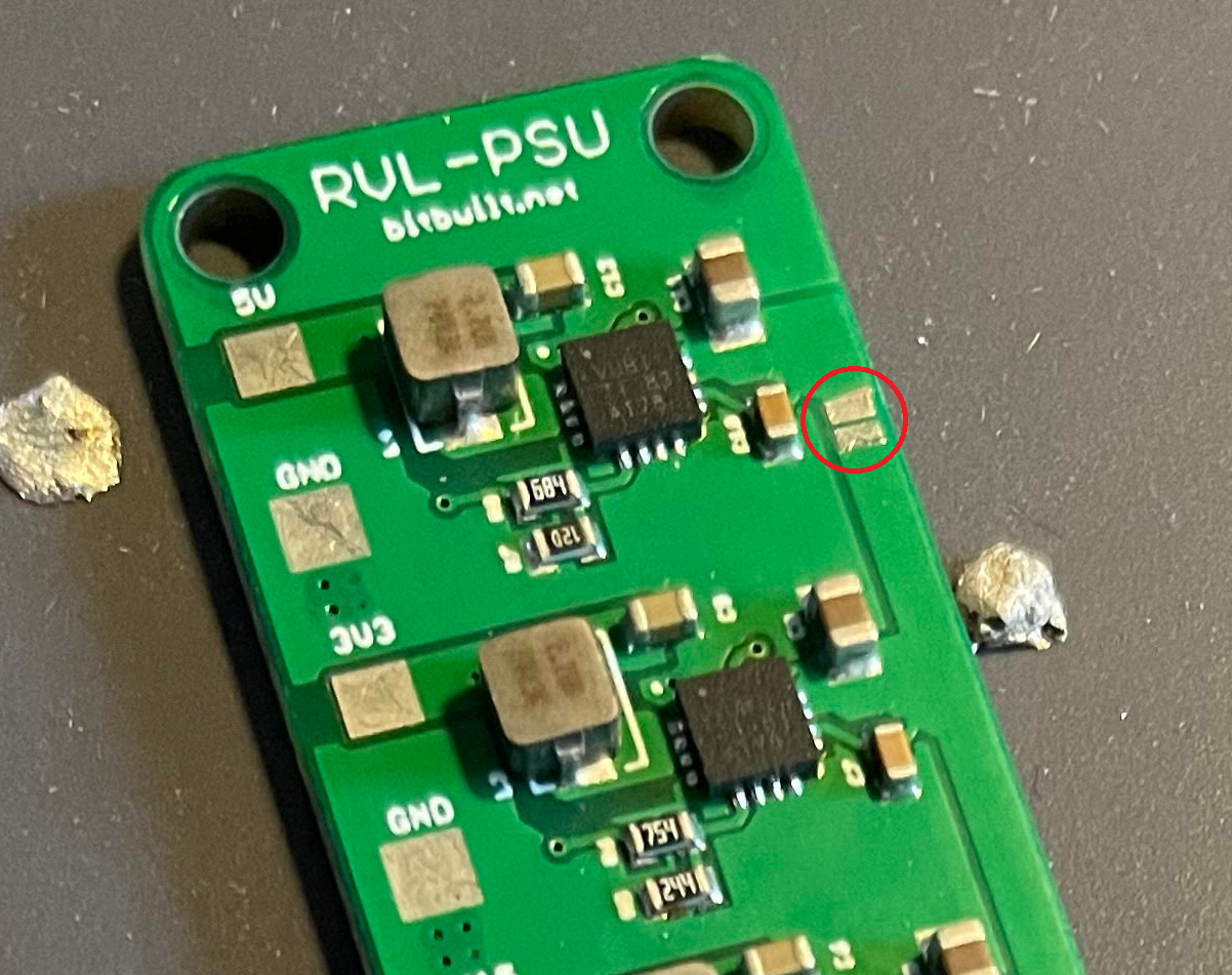

Anyways, I'm running along the pads in the RVL-PSU and I clock 1v, 1.5v, 3.3v, and then I get to 5v. No reading. It just gives me a big ol' 0 on voltage readings.

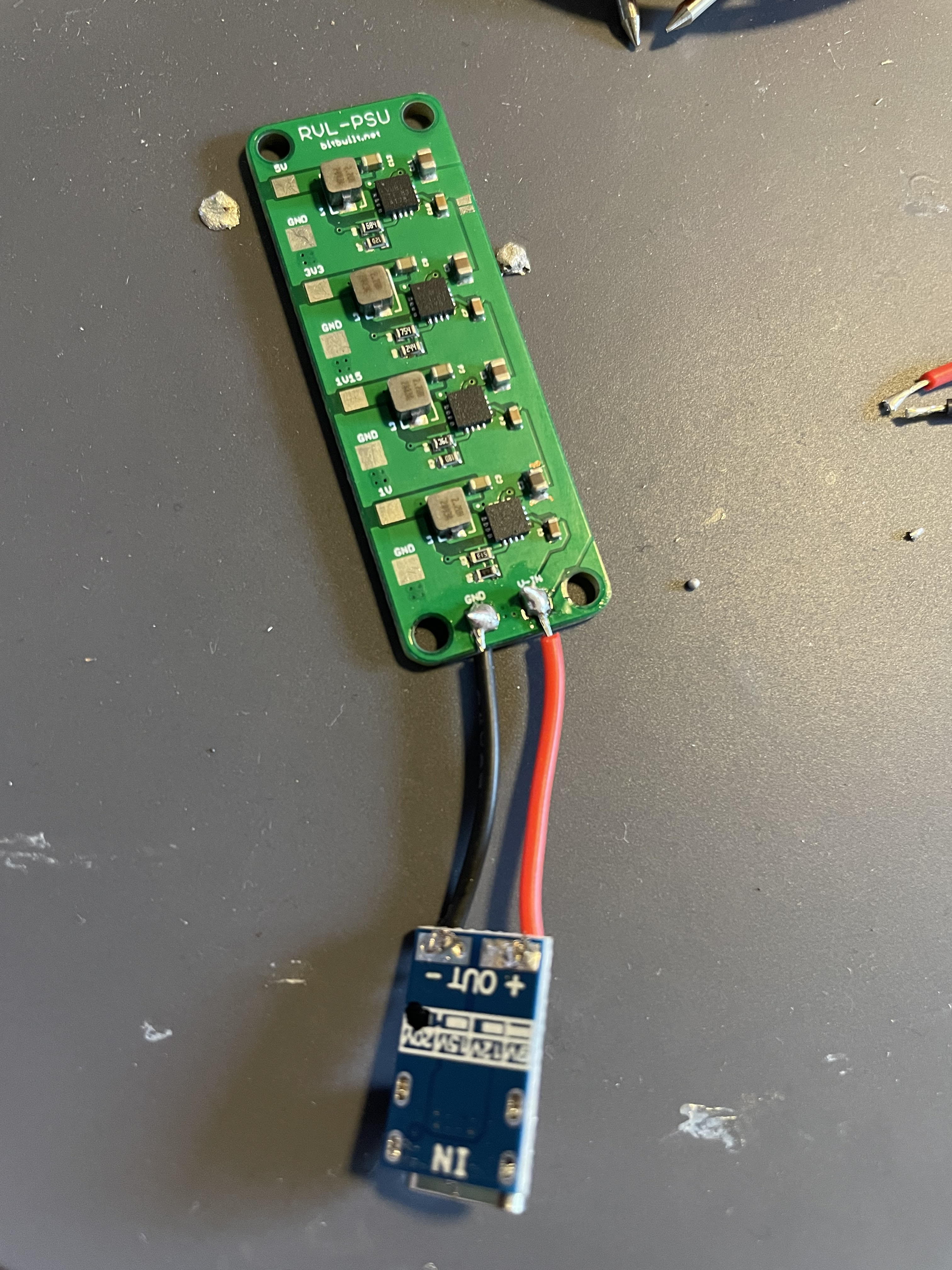

So I get some more boards that guarantee I get 20v from my power supply.
I'm using one of these boards to negotiate 20v of power from my usb-c power source onto the RVL-PSU, with (+) mapping to v-in and (-) mapping to GND.
I can verify I'm getting 20 volts, I can also verify I'm still getting the other stepped down voltages listed above. but 5 is still busted.
I would say "okay yeah the board is broken", but I had a SECOND RVL-PSU and the same thing happened. It seems unlikely that'd just happen to two boards like that, but also I'm not unwilling to believe that 5v is just dead, and I know I can still use the board, I think I just may have to get 5v elsewhere.
