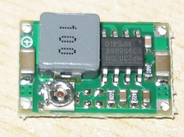

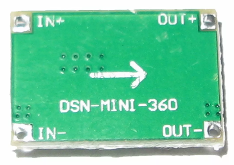

Okay, so i see that everyone is using those PTH08080 regulators, the thing is, where i live it's impossible to find those regulators and the closest i could find are some called "mini360", they're dirt cheap and they do 1v to 17v with 1.8a max output.
I bought one of these to test some stuff and the first thing i did was accidentaly plug it in backwards and it let the magic smoke out
Has anyone tested those and are they any good?
here's a couple of pics of it.

And that's about the performance you'll get from cut price regulators like those. Cheapo regs tend to overheat like Huskies in Summer when they get within a mile of their listed maximum current. We use PTH regs because they're high quality and they work. You can try the cheapo imitations, but 99% you'll be disappointed in the performance, or damage the console. Better to save up for longer and pay for PTH8080s from Digikey or Mouser, or perhaps find someone willing and able to middleman ship them out to you.

I tried them with the Wii. They suck, they get very hot and they shut down after a bit

hm that's what i thought, i'm gonna buy a couple of the mini 360's and a couple of RT8272 and leave them running at full load for a couple hours, i might get away slapping on a heatsink on the RT8272 if it gets hot
