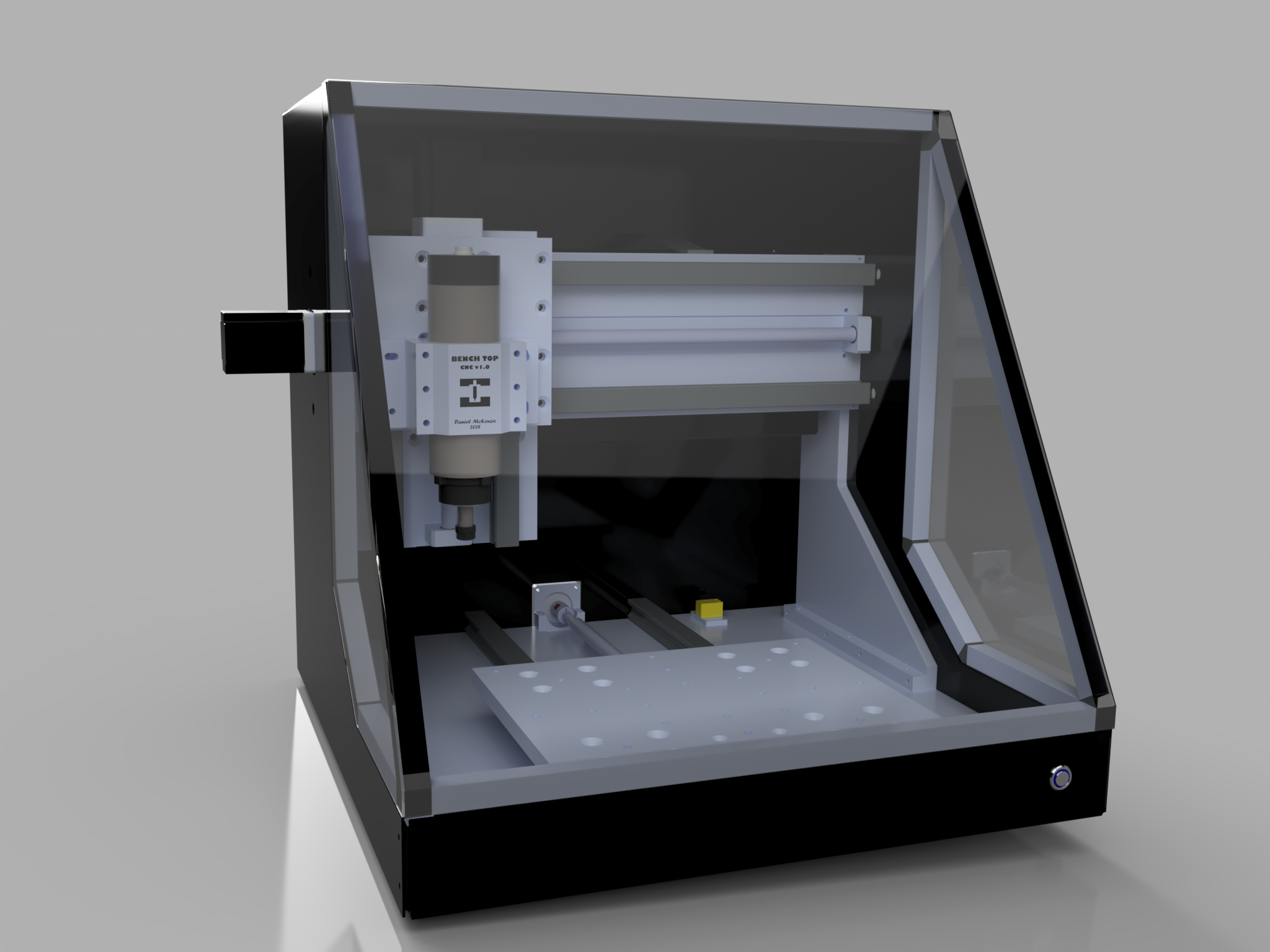

What CNC are you using?
Its my own design. 3 Axis, 350x300x100 work area, 25mm linear rails, 16mm ballscrews, Nema 23 stepper motors (on 24v), gecko g540 stepper driver, an ethernet smooth stepper for PC interface and a 1.5kw Chinese spindle. The whole thing is enclosed in a 600x600x600 box which helps keep the noise and dust/dirt in.

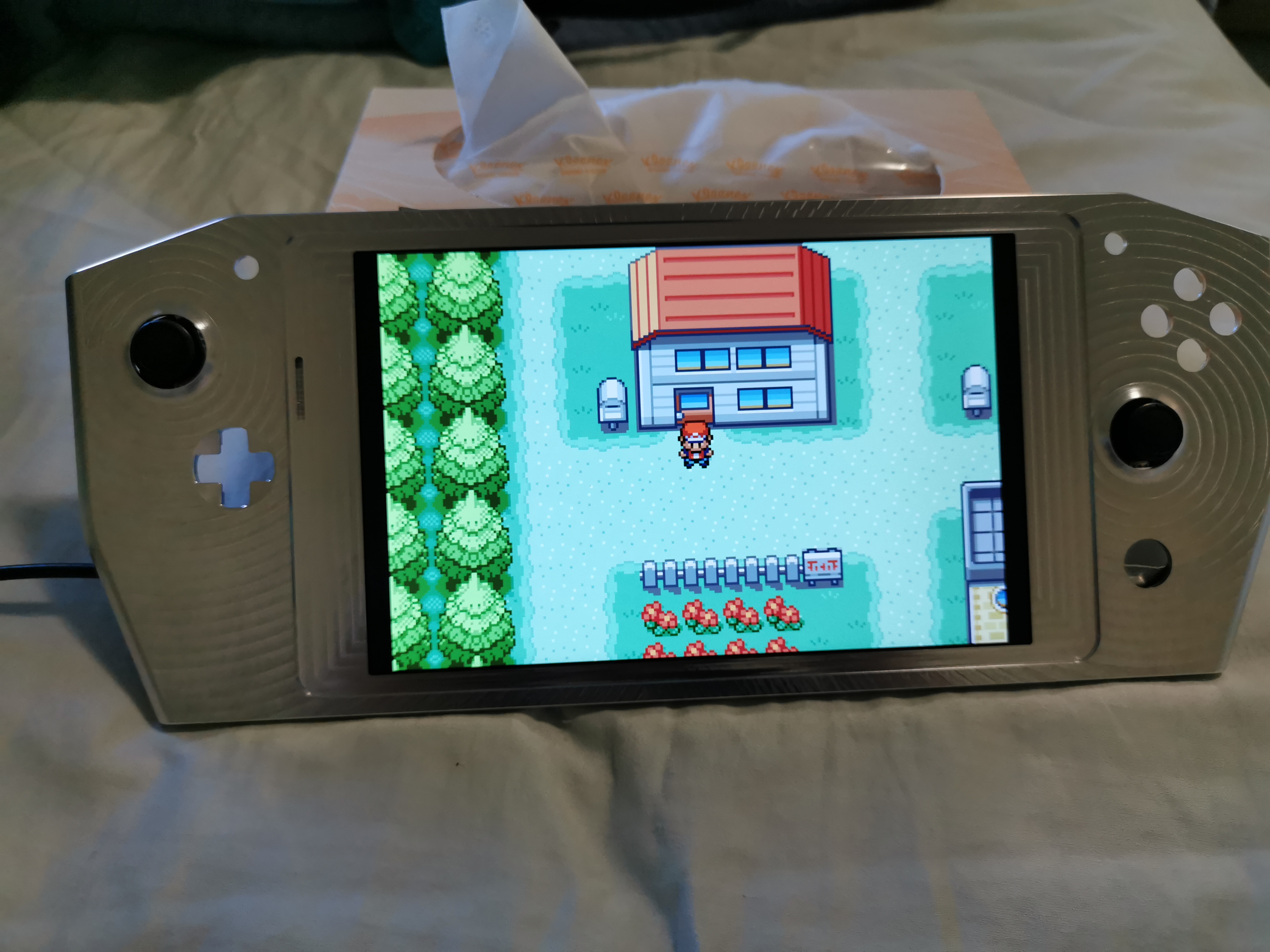

Took a quick video just to show how need for speed performs on the little tablet.
Also this thing makes Gameboy games look great haha. Probably a bit of a waste to play on it though. Also, excuse the tissue box prop. Needed something to keep it standing up for the video

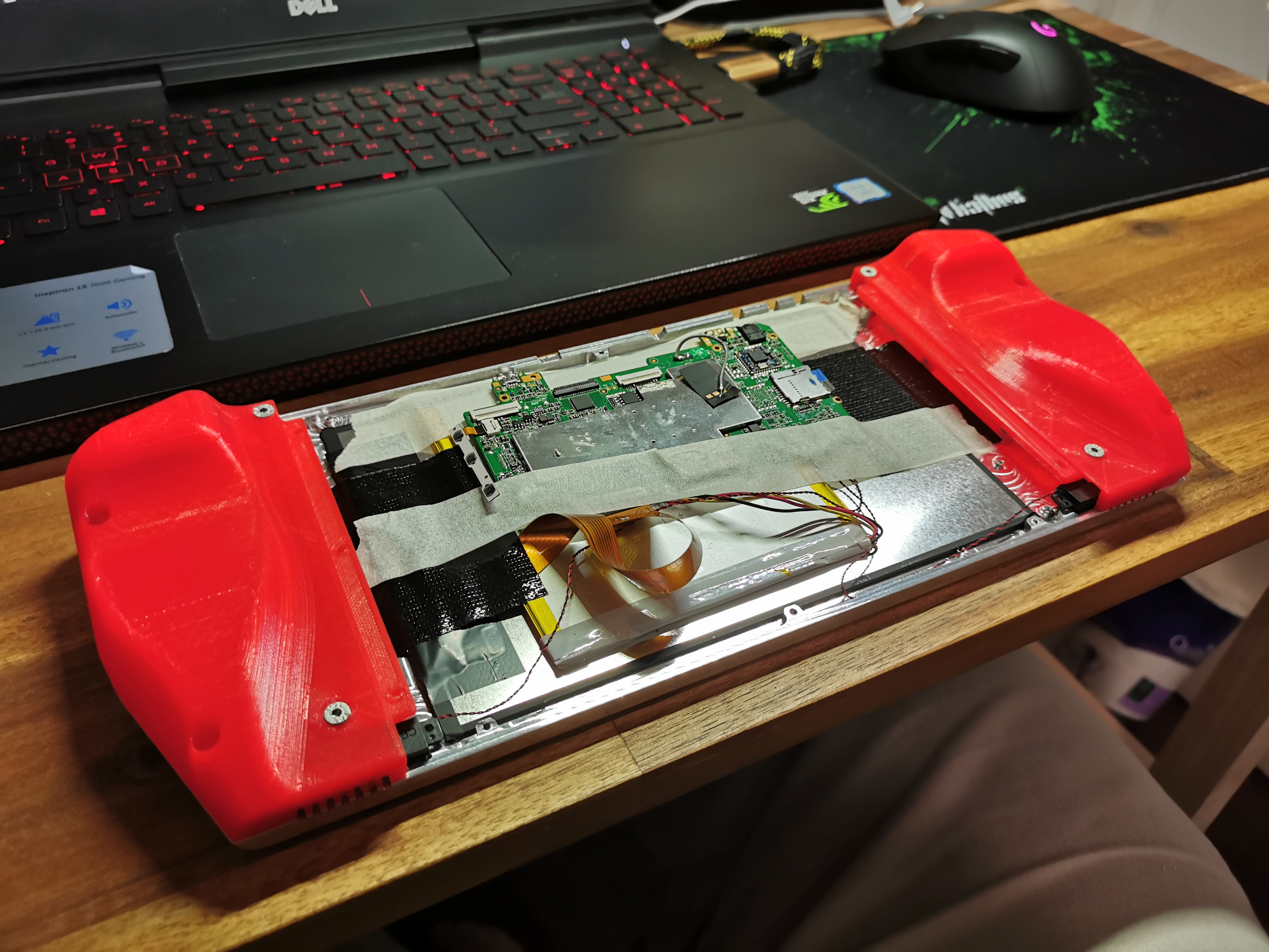

Joysticks, clear plastic joystick surrounds and temporary 3D printed hand grips fitted! And thanks to quarantine I have tomorrow off work so I can start tracking down stuff I need to have a go at casting these buttons! And before anyone asks, no that is not where the main board is eventually going to sit. Its just there for ease of access at the moment while I muck around with it testing games.

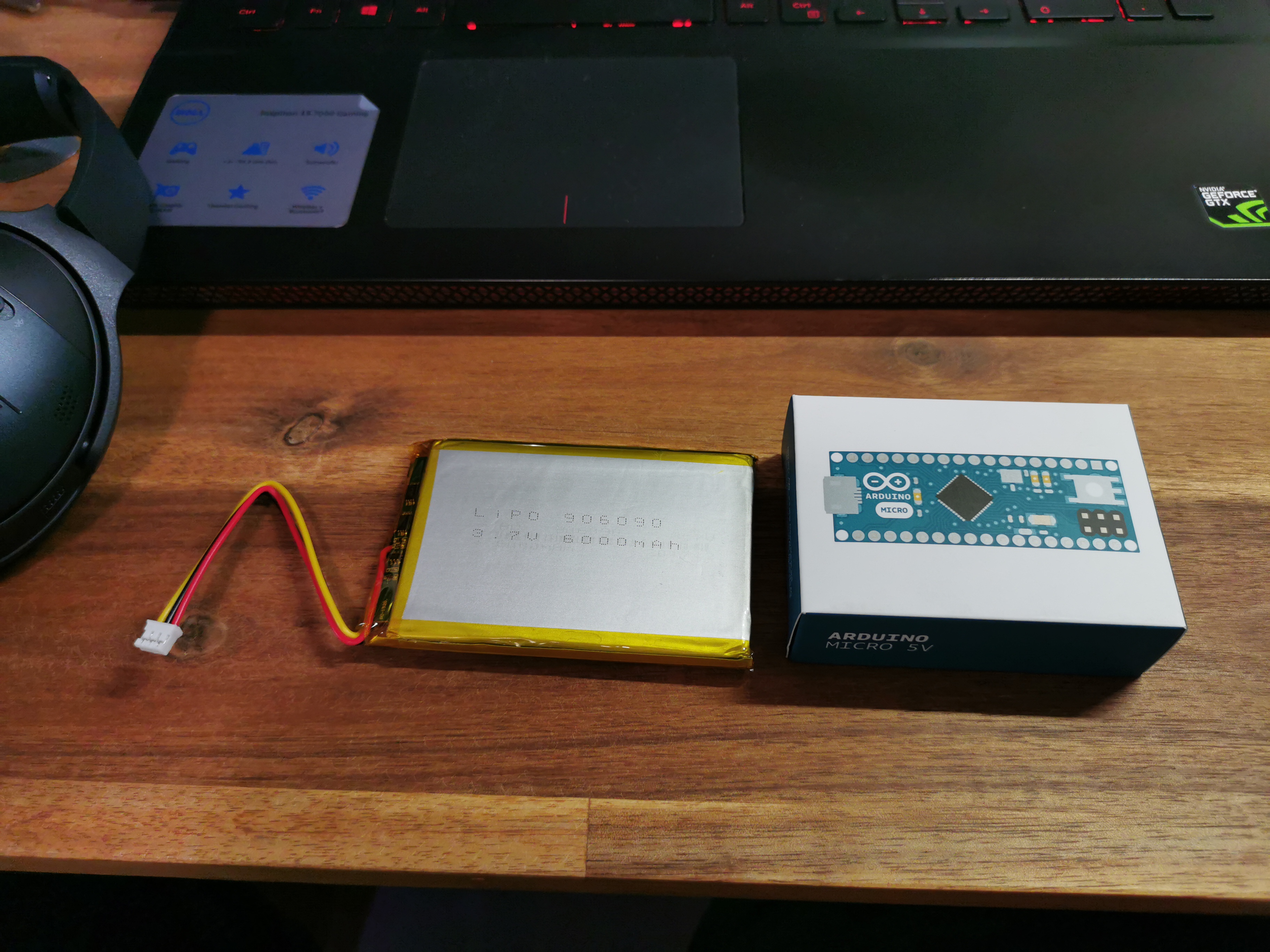

Incredible. What are you using for the game controller?
Arduino micro. I've got one on order, just waiting for it to turn up. I'm still in two minds about how I'm going to do it. I'm considering running two of them (one for each side of the controller) and getting one to emulate a mouse with one of the joysticks for games that don't have good gamepad support. I'll try it with just one as a gamepad to begin with though.

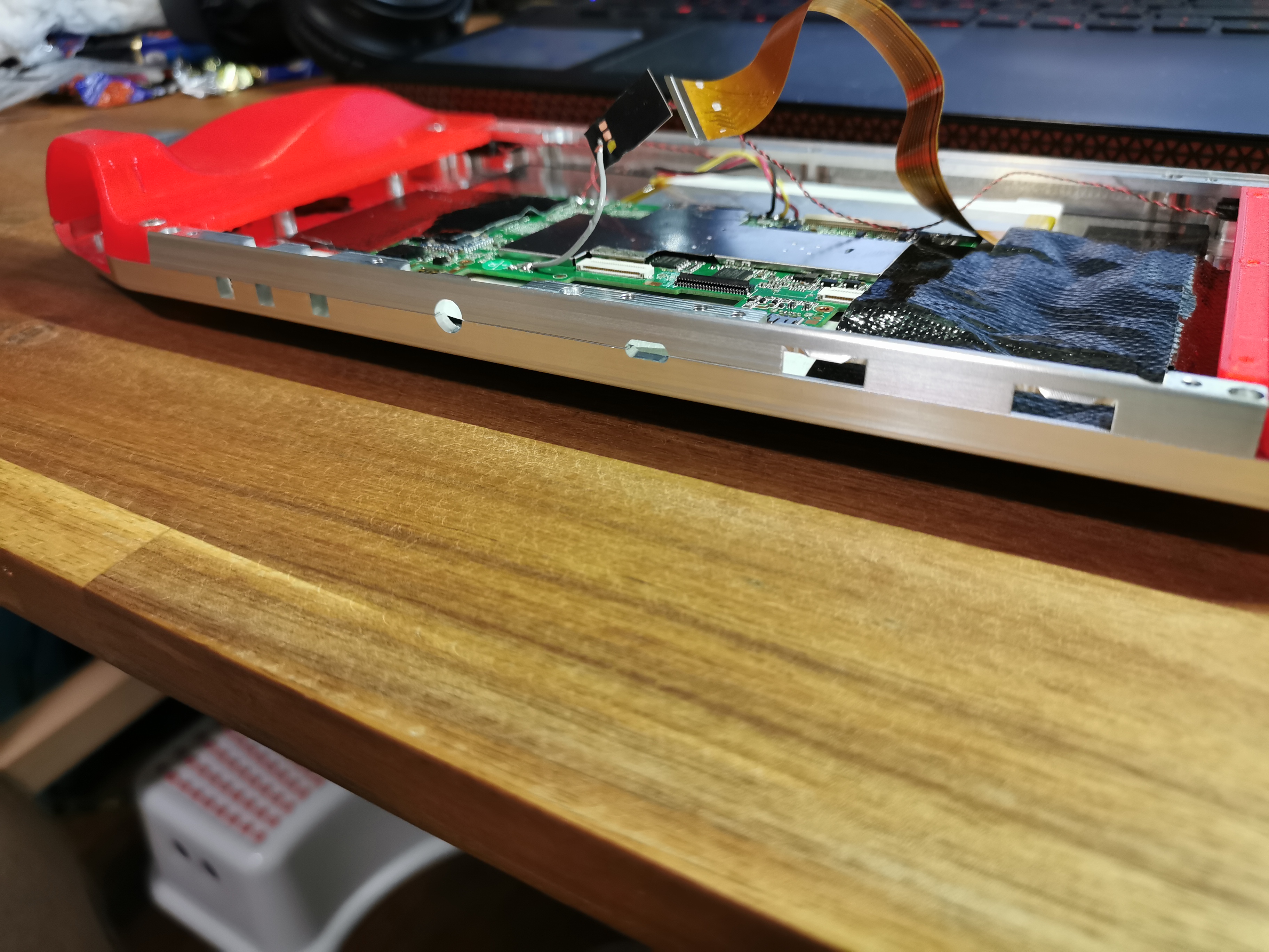

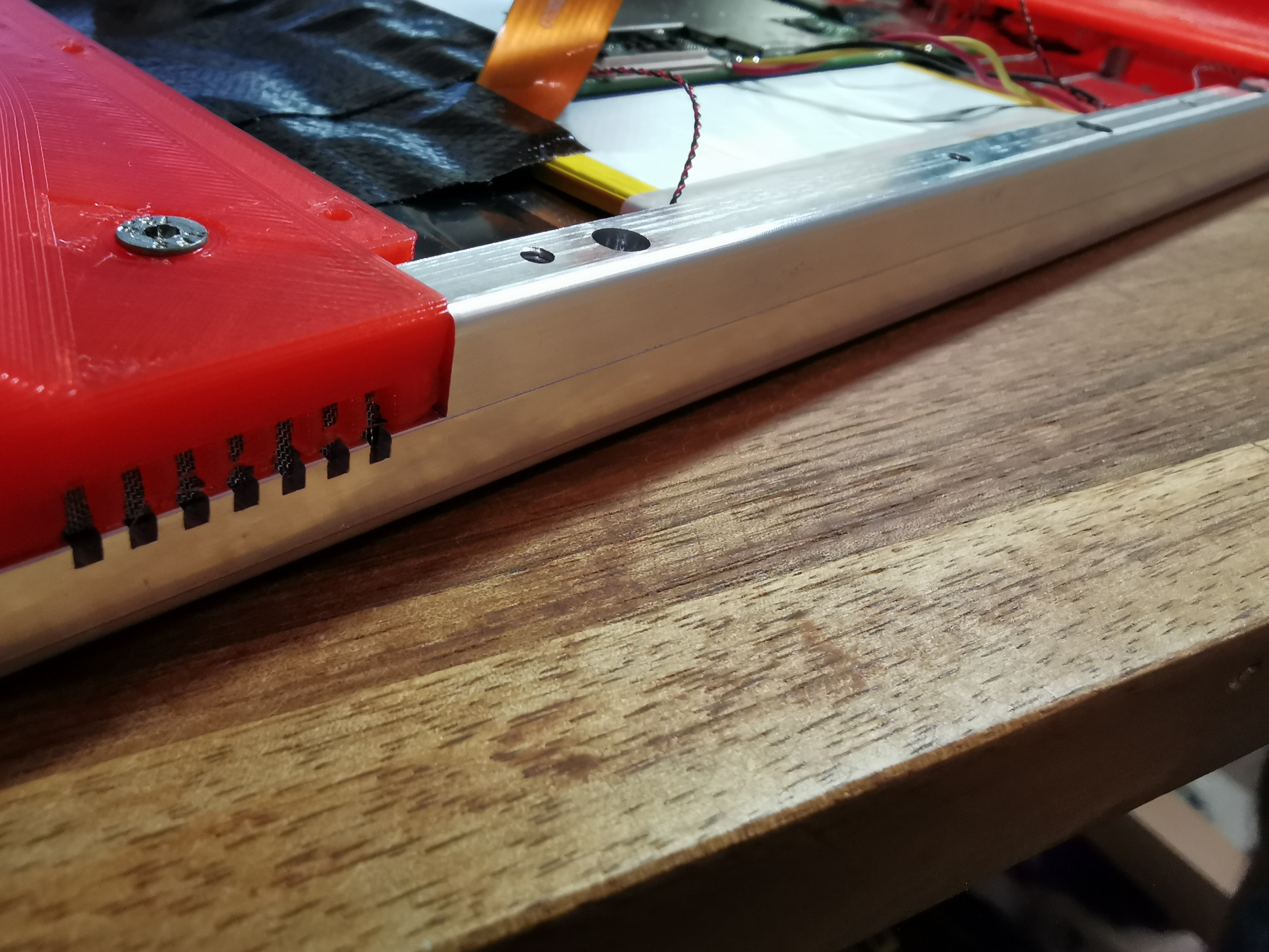

Well I've officially made my first mistake of the project! I accidentally toolpathed some of the pockets on the second side of this job for the wrong sized tool. I also didn't realise that I hadn't taken the USB ports deep enough on the first side of the job. If it was just the USB port holes I'd have a go at fixing it, but since there's a considerable amount of material on the top side that has been removed that shouldn't have been I'll probably just have to start these parts again. The outside of the parts are correct (asides from the wacky bits above the USB ports due to the machining not being deep enough) so at least I've been able to fit these ones up and see what it looks like! Ignore the fact that it doesn't line up with the 3D print. The filament I used is horrible and it did not want to do what I wanted it to, so the edges ended up curling up a bit. I'm pretty sure the machined ones are going to fit just fine when I get around to making them ;)

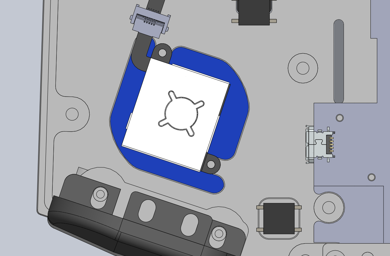

Just realised I've made a huge mistake with this design. I mounted this joystick on an angle to try and keep it as far from the shoulder buttons as possible. But its just occurred to me that means I'm going to need some pretty tricky maths in the controller program to "rotate" the axis to make it work properly. Otherwise I've got to try and make an adapter to get the rotation right, or remake the front housing which I really don't want to have to do.

Nothing complex: https://en.wikipedia.org/wiki/Rotation_matrix
Maybe not to you, but maths is definitely one of my shortcomings haha. I could probably work it out, but I'm not sure if its worth all of the hair pulling.....
Maybe 3d print/CNC a small mount to rotate it slightly, losing a mm or so of height shouldn't affect it too much as joycon stick ranges are pretty low anyway.
Yeah that's what I'm thinking. I've checked and I have room to straighten it up without having to remove the existing standoffs. I'll just make a new plastic insert with standoffs in the correct orientation as part of them. The frustrating part is now that I'm looking at the joysticks in real life I can see that the body of the joystick isn't actually central to the stick itself. That means I could have just rotated the joystick 180 degrees and given myself more room for the shoulder buttons from the word go, but instead I chose to make life difficult lol. Need to fix up the model of the joysticks first before I go too far, as they don't quite match up perfectly with the ones I downloaded before I had the joysticks here. Seems to be a running theme, as I had trouble with the downloaded models of the PSP joystick I used on my first portable too.
