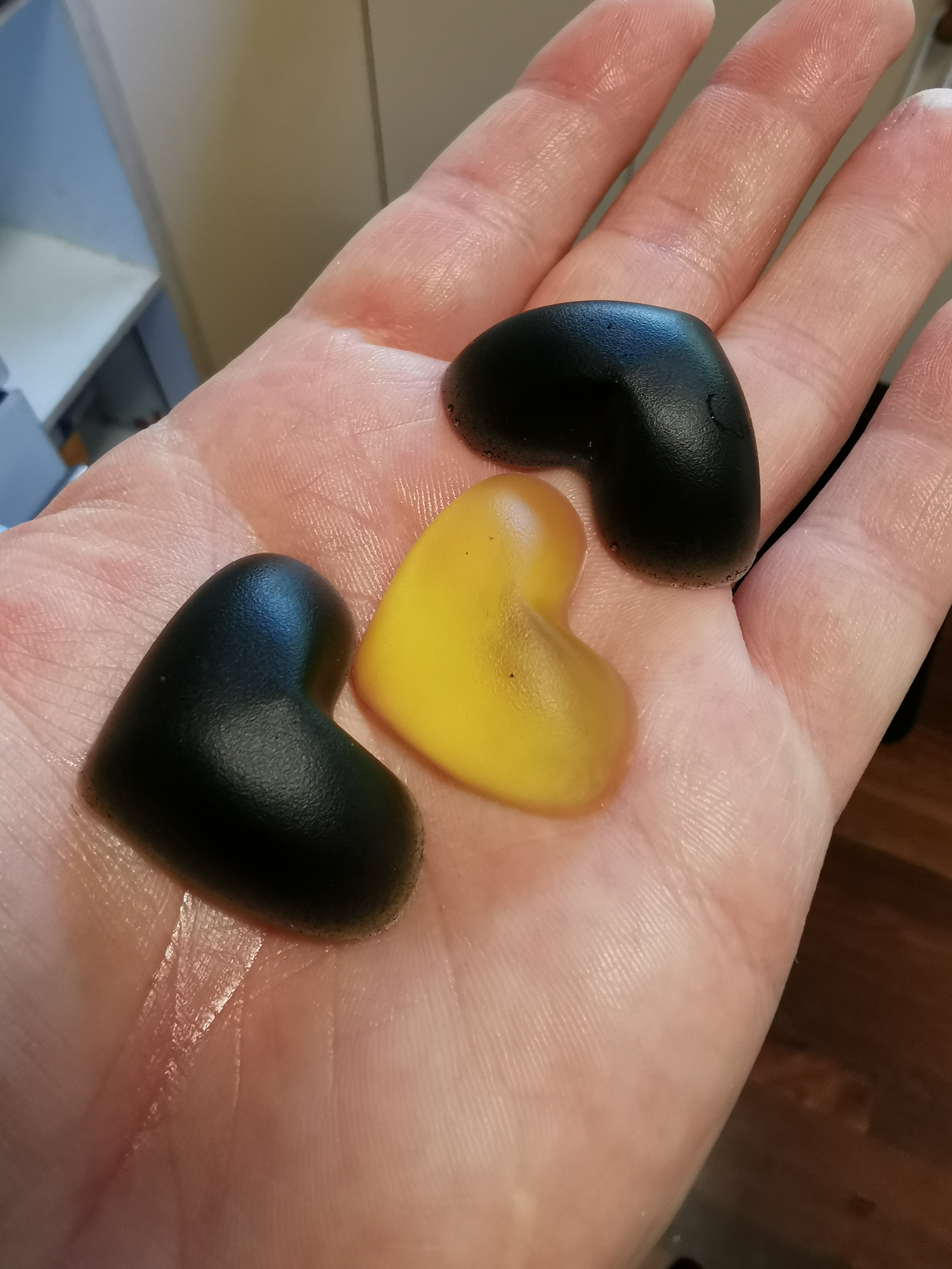

I'm sure you may have already tried all this but maybe you could make a batch of small [maybe square] samples with different quantities of catalyst and check them periodically noting down how hard they are. This way you can find the exact amount of catalyst you need. Good luck!
Yeah I've tried a few different batches now and they aren't really working well. Now at least 12 hours on since I mixed the batch with pen ink in it and its still liquid so it really hasn't worked well at all. I've got my original test pieces that have been sitting for weeks and they are finally mostly hard but I swear they were still "tacky" for days.
I've ordered a kit from a reputable seller that claims a 3 hour de-mold time so at least I will know quickly if its not working. I suspect I'll have much more luck with this brand, I guess we'll see when it turns up!
Well the good news is it wasn't my incapability that was stopping the resin from working properly. Did a test pour of the new fancy brand name resin into a silicone ice cube tray we had for a test and these ones have set harder in one night than the other ones did in a month.
Interestingly, this resin reacts with the pen ink and changes colour (the yellow, pictured) so that's out of the question for colouring. I suspect the last resin reacted with it too, it just didn't change colours like this one, it just never set. This one mixed well with some fancy food dye I had though and looks like it's going to be dark enough so I guess I'll pour up a batch into my button molds and see how they come out.

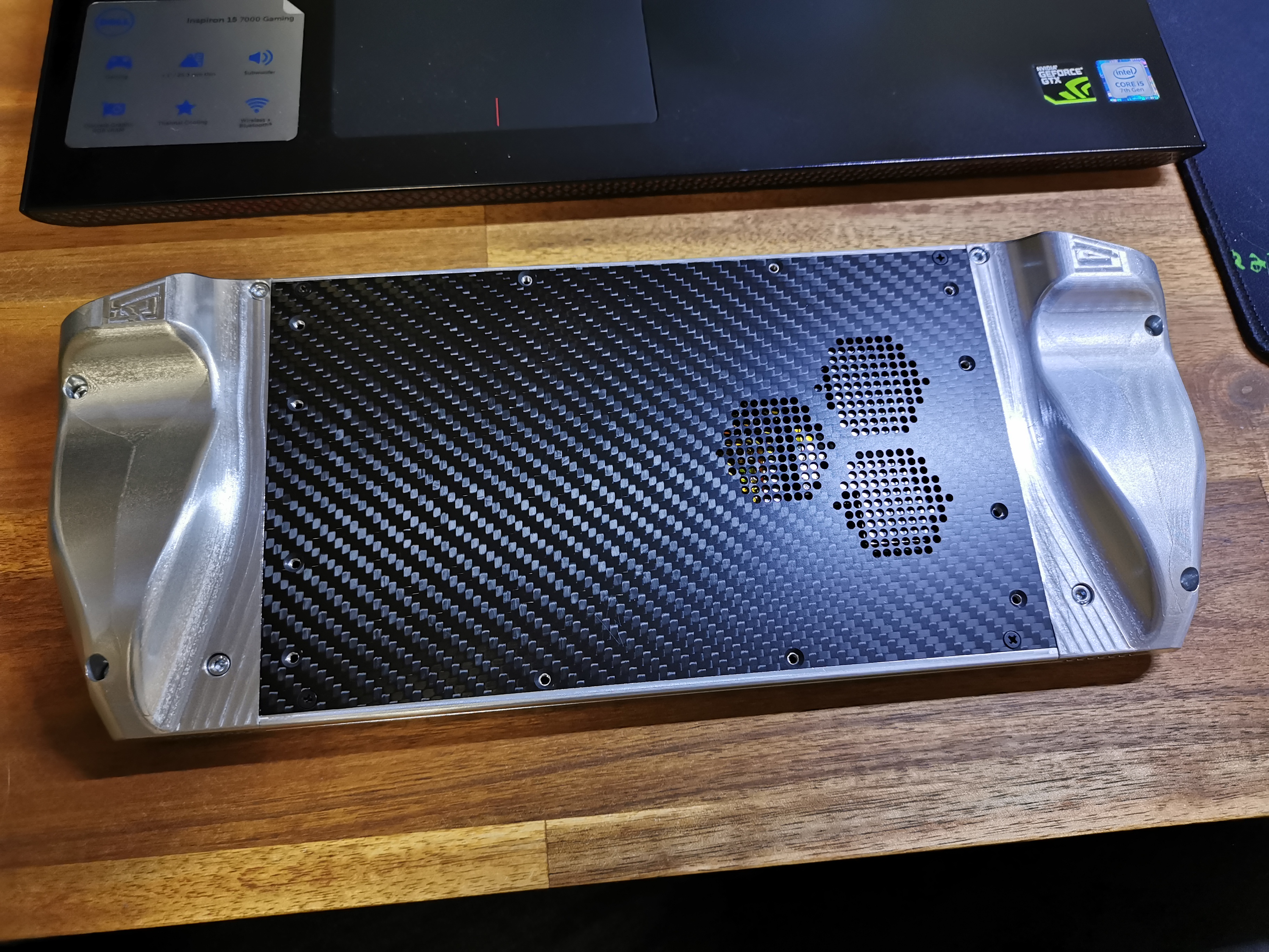

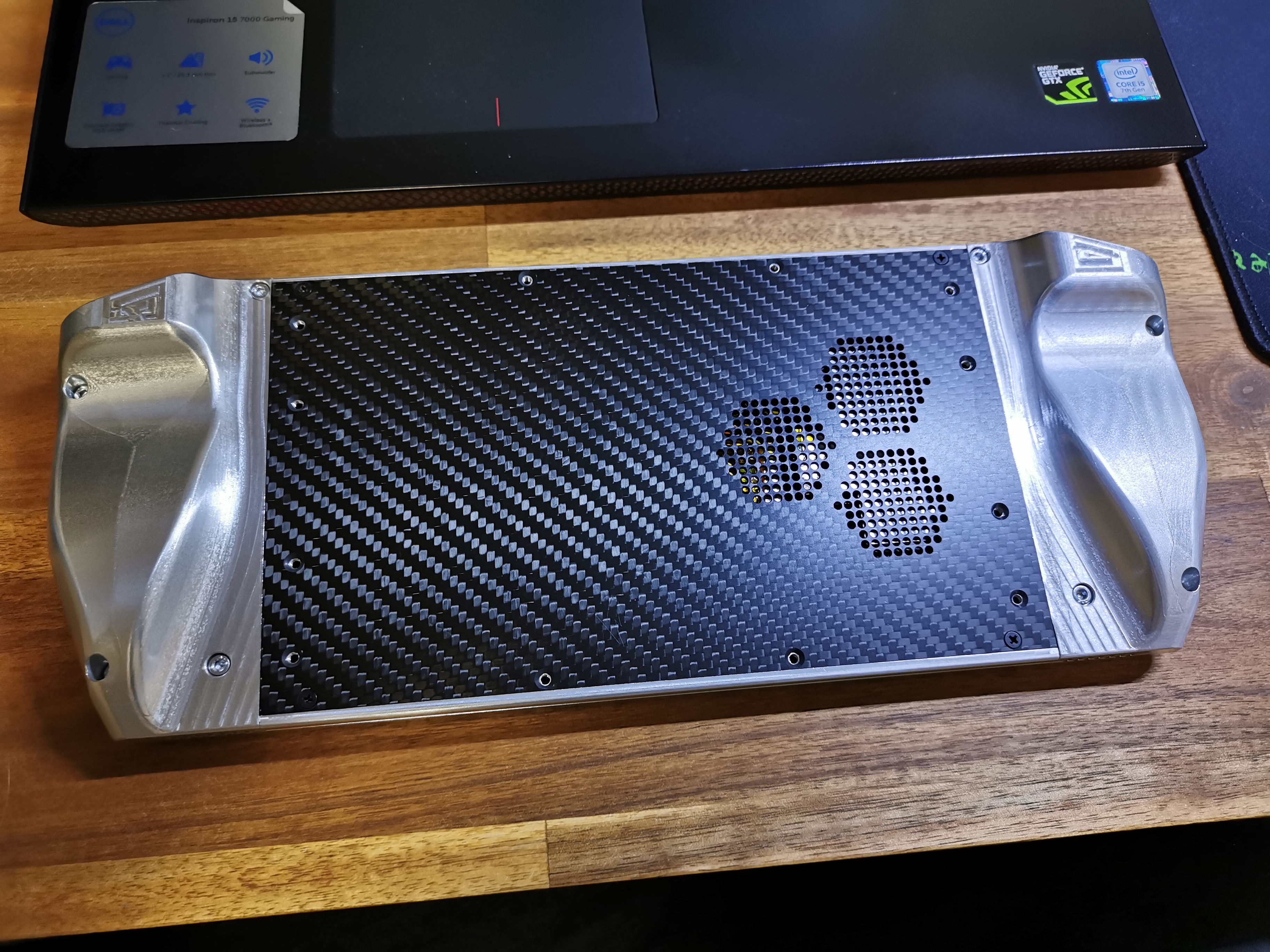

Wait...you're going to paint this beauty?! My opinion would be to keep everything with that industrial look (but I am an industrial fan so perhaps I'm biased)
You could paint that thing hot pink and it would still probably look sexier than anything I've made.
(I say keep it as is though)
Thanks mate! Yeah that's what I'm thinking too, carbon is just too good to cover up.
As much as I am also a fan of the machined look, the machining on this is no where near neat enough plus bare aluminium marks up pretty easily. I could anodise it but because the body is made out of multiple thicknesses of aluminium there's a possibility of miss-matched colours due to the alloys potentially not being identical. Also, there's one or two little spots that really need to be hit with filler and sanded back which would have meant starting from scratch if I was planning to anodise. I could try and fill the areas with weld and sand them back, but then there's an extremely good chance that area would anodise differently due to the weld.

Thanks mate, I had a look at it but probably still stick with white for this one. I just think the black screen surround and buttons are really going to pop with a white case.
So when is this guy joining the bitbuilt team!? Gotta get me an all aluminum G-Boy!!
Haha thanks, probably a bit difficult though as I assume I'm in the wrong country! I'd be happy to take a look at the design and make suggestions on how to make it easier to machine though if whoever designed it was interested. I know a guy who could do a batch of cases too if we had a design. They wouldn't be really cheap but generally the more you get the cheaper they become.
Don't worry about it, in the end, its your portable, if you love it, then its the best console in the world.
PD: i think that white is a nice color, but the matte white on the UFO will get dirty fast.

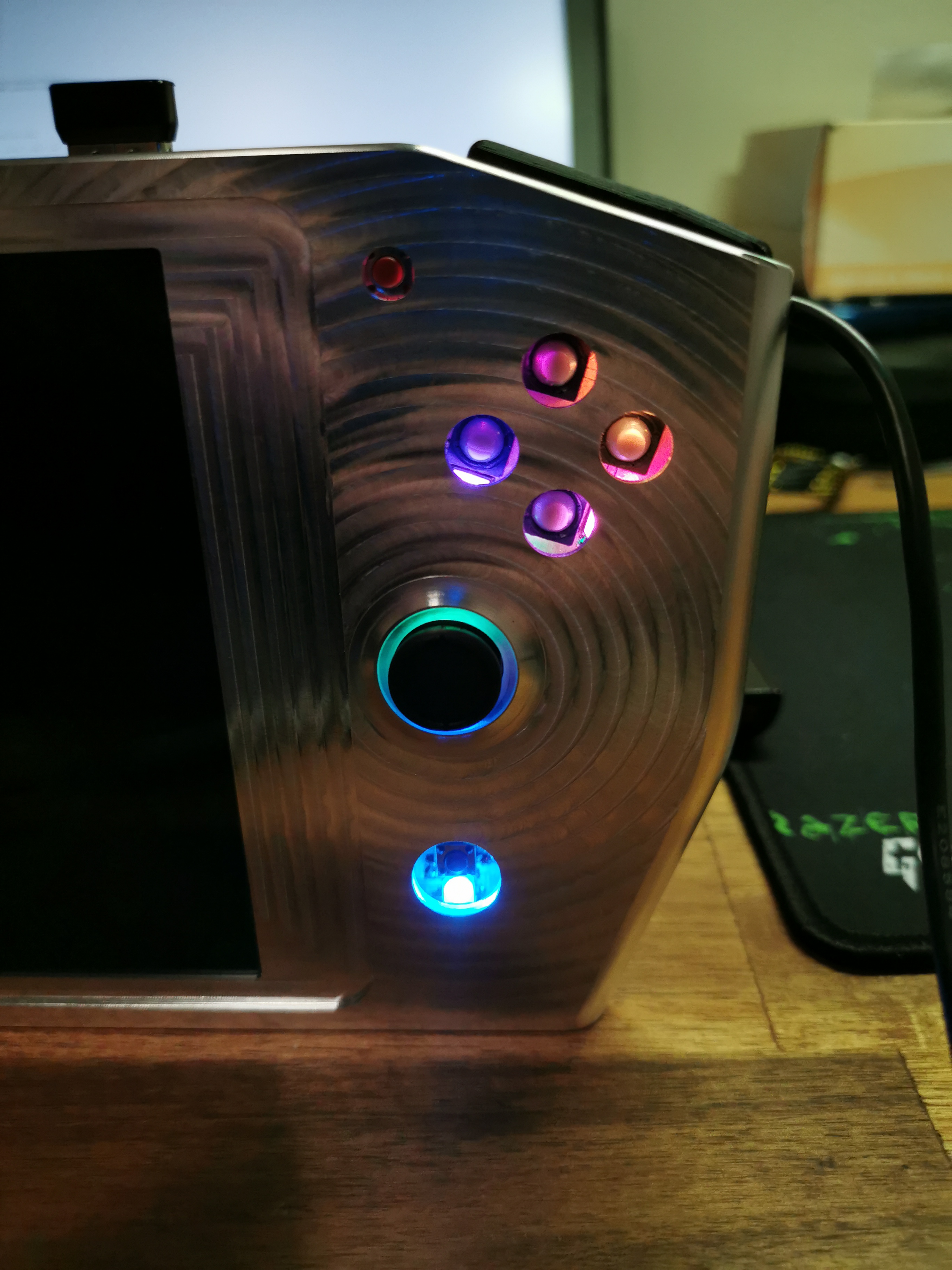

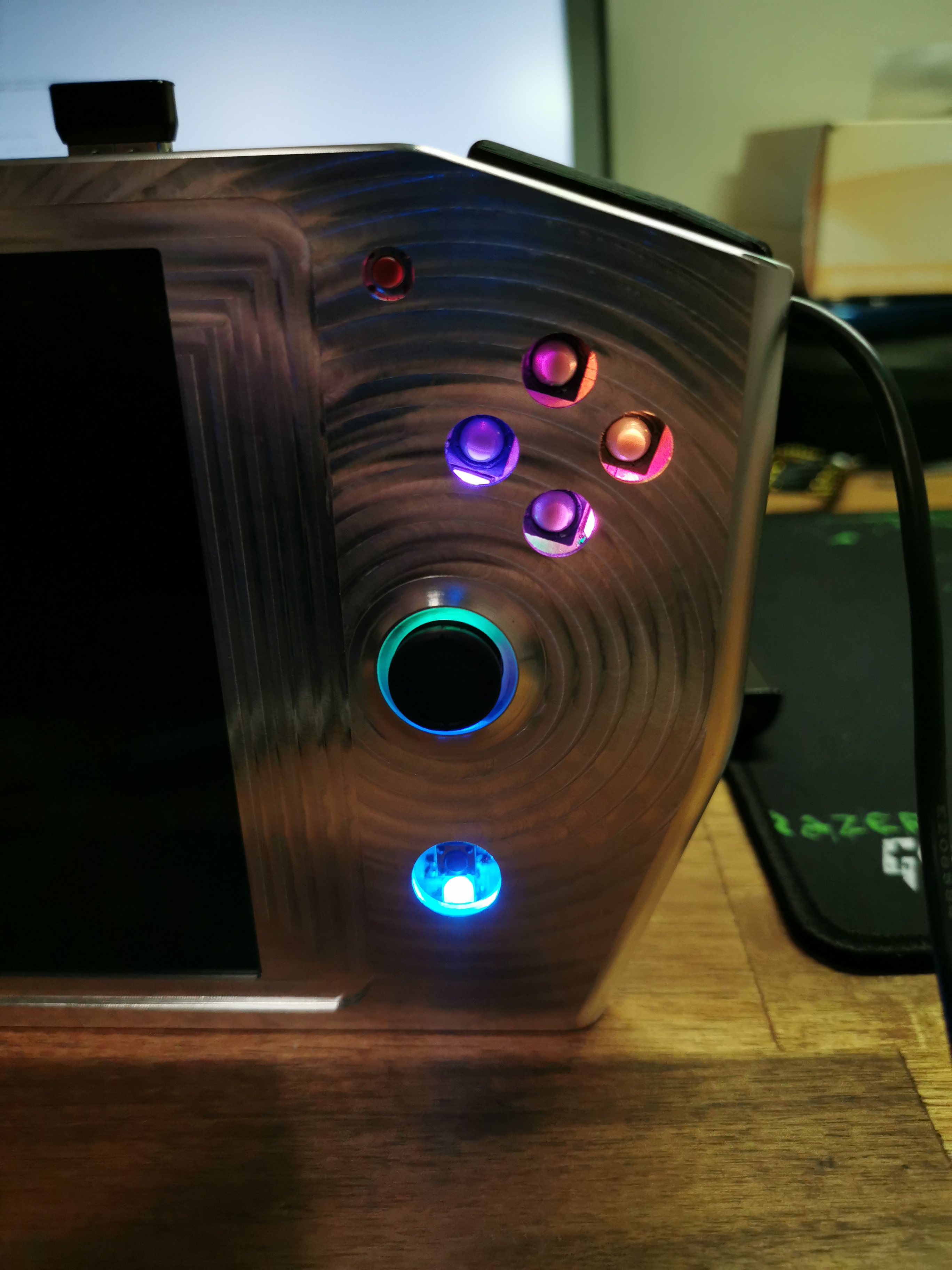

You must have missed my earlier picture, I've got the glowing rings sorted ;)
I'm going for glossy white. Hopefully with a good clear coat it should stay fairly clean. Can always sand it off and repaint in future if I decide I don't like it!
Oh yeah, and mine are addressable RGB. So with two LED's per ring I should be able to make a few interesting effects!
