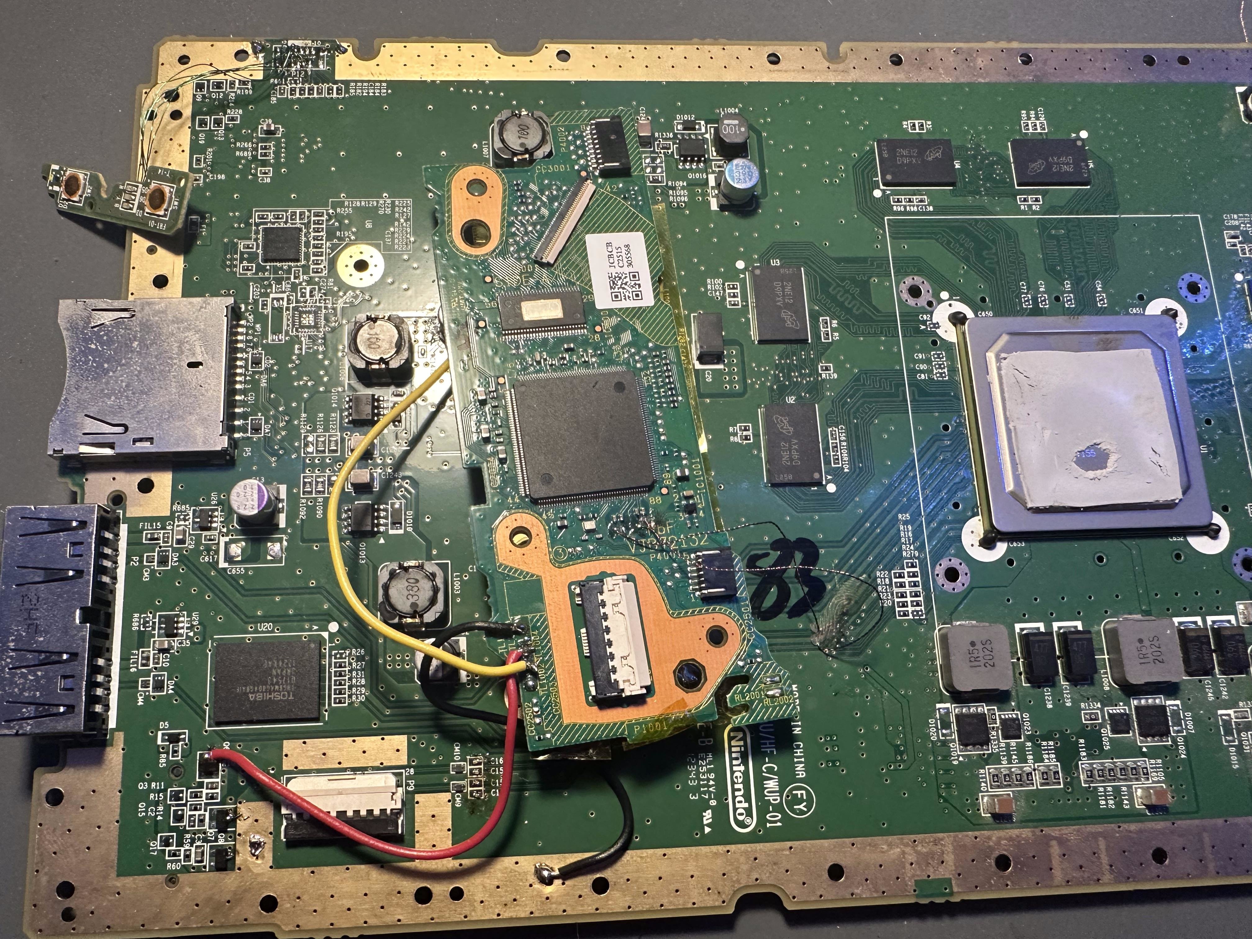

Nothing too major to report. I've been busy with some other projects, but Wii U is still on my to-do list. Here's a quick update.

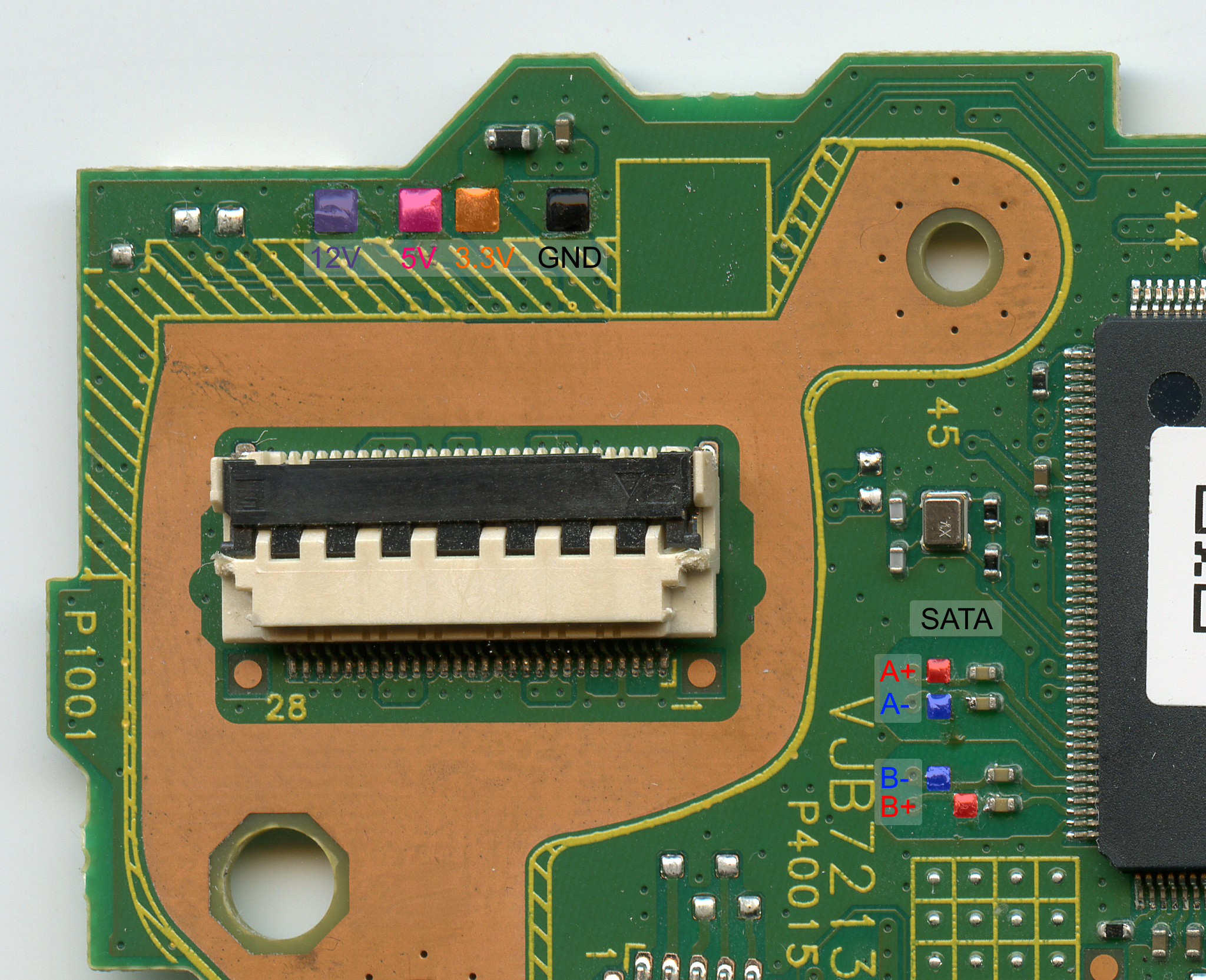

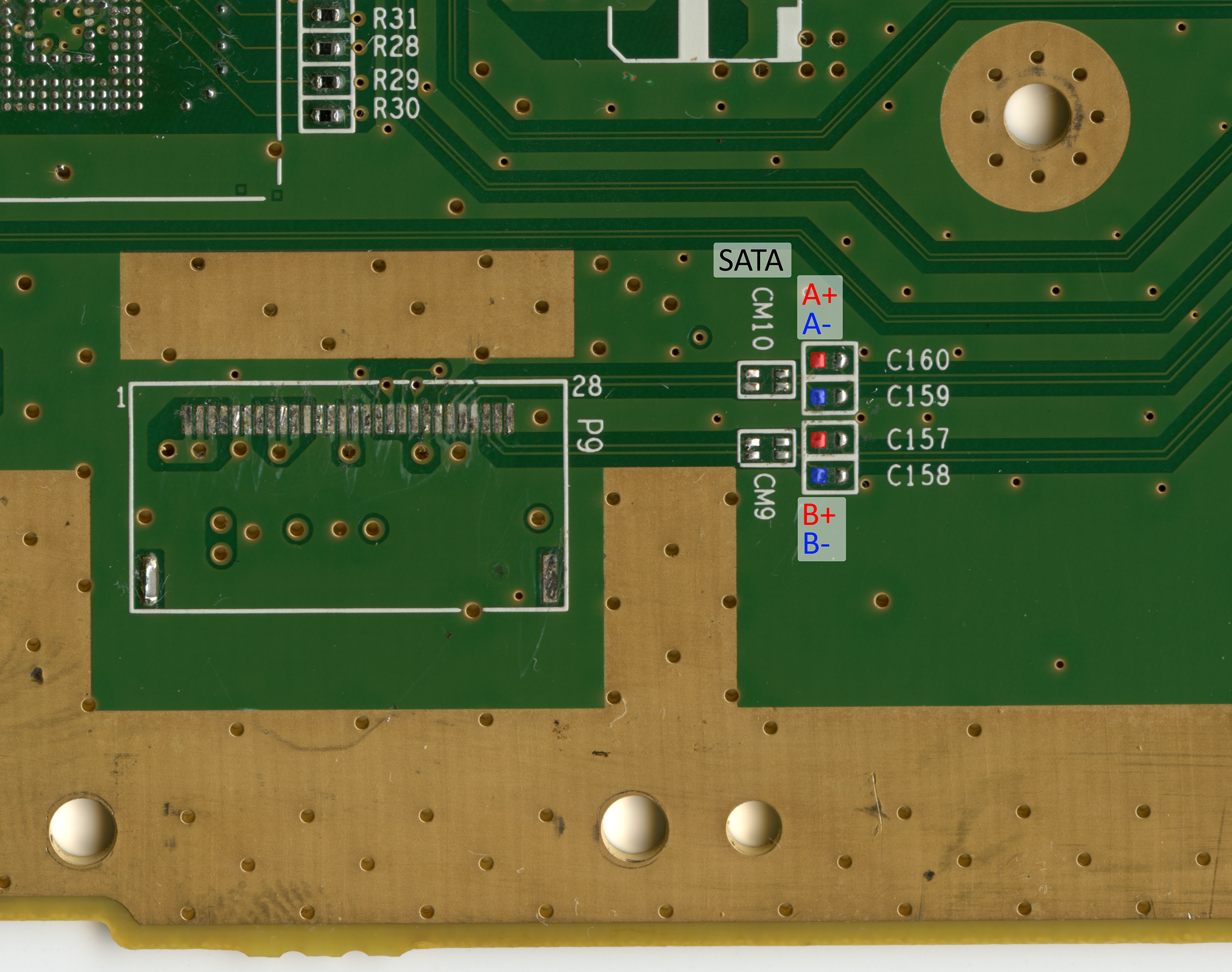

I succeeded in rewiring the disc drive daughterboard to the AC coupling capacitors on the SATA lines. The 10nF series capacitors are required as part of the SATA spec and the daughterboard does not work if they are bypassed. When trimming, we'll need to trace-scratch and relocate these capacitors further toward the Latte.
The only disc drive daughterboard connections that are required for boot are power and the two SATA differential pairs (not sure if any other signals are needed when loading backups.) The daughterboard does not require 12V to operate, only 3.3V and 5V, and there are convenient solder pads present for both SATA and the power rails. Thanks, Nintendo!
View attachment 21074View attachment 21075

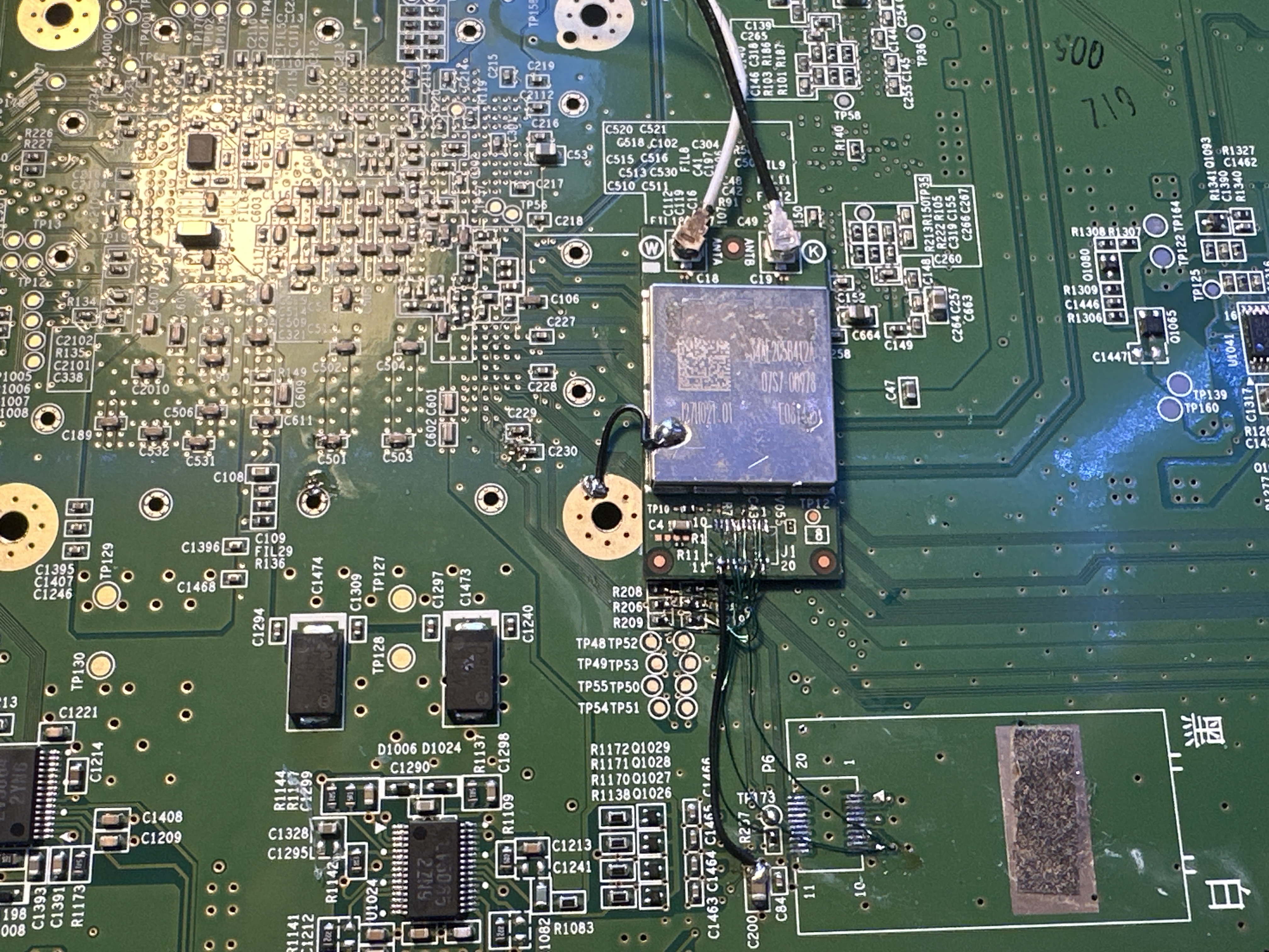

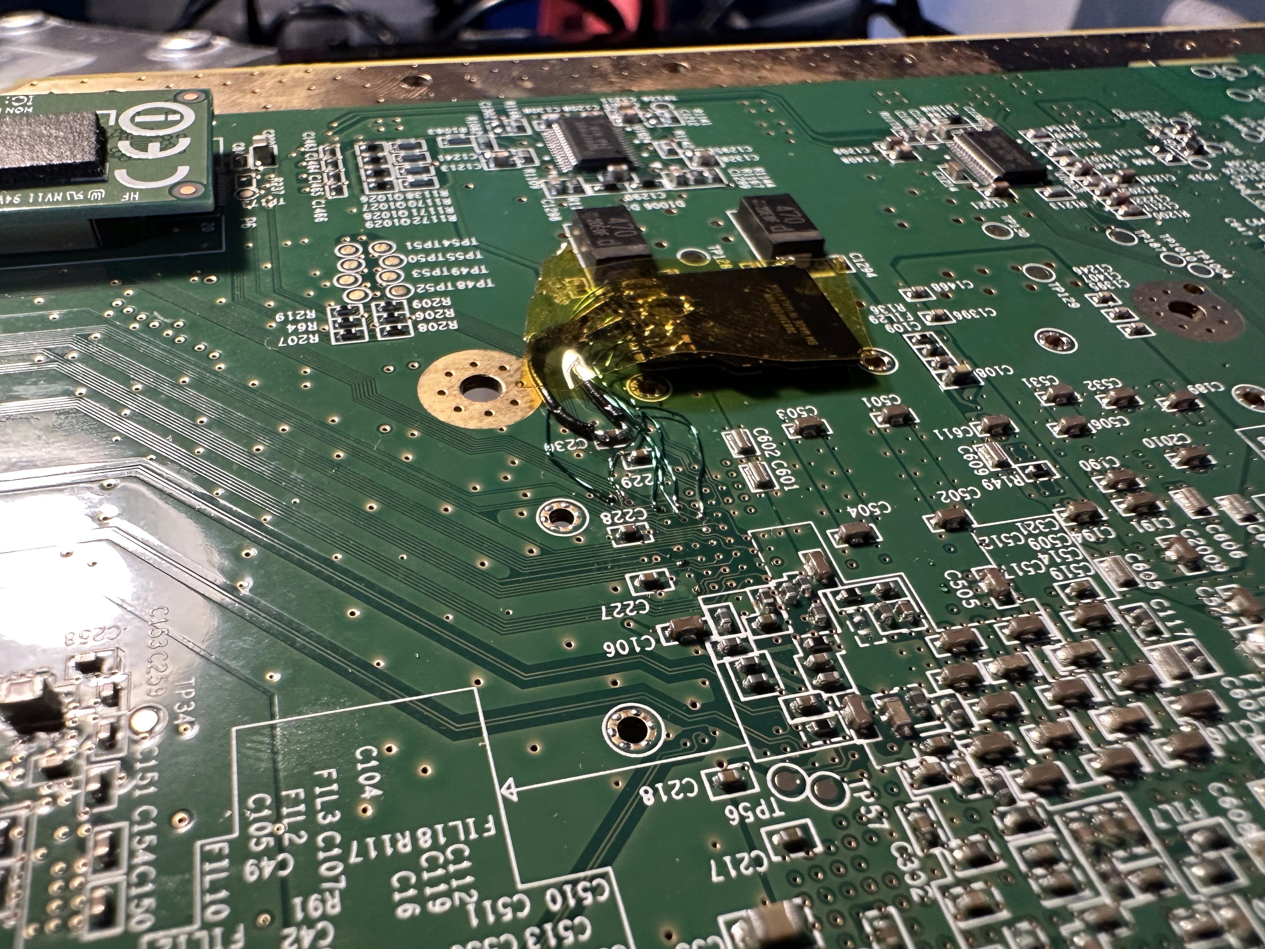

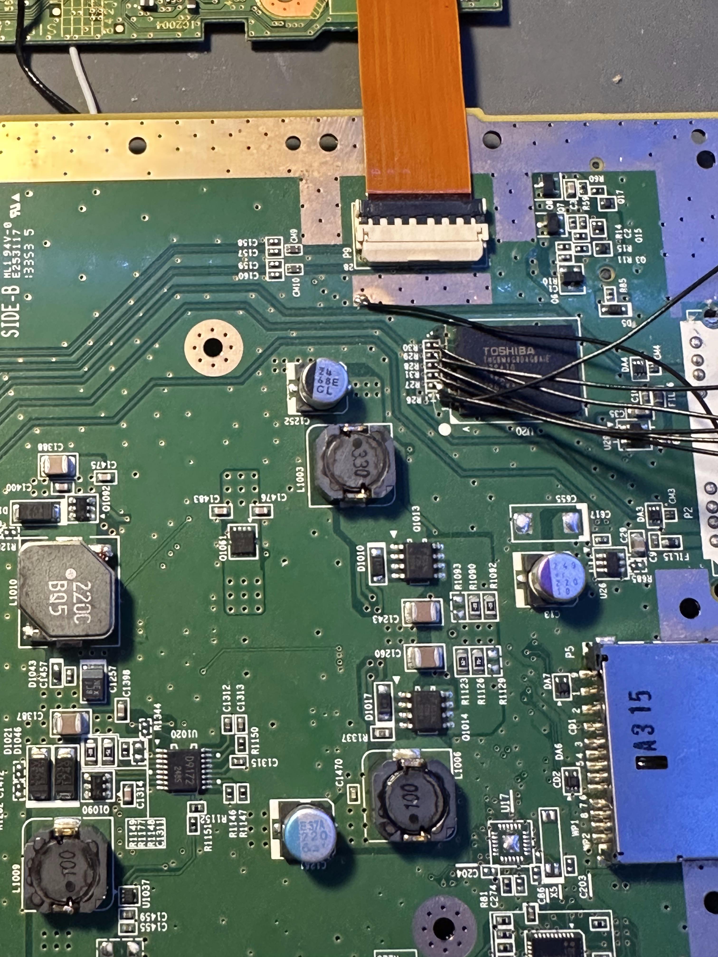

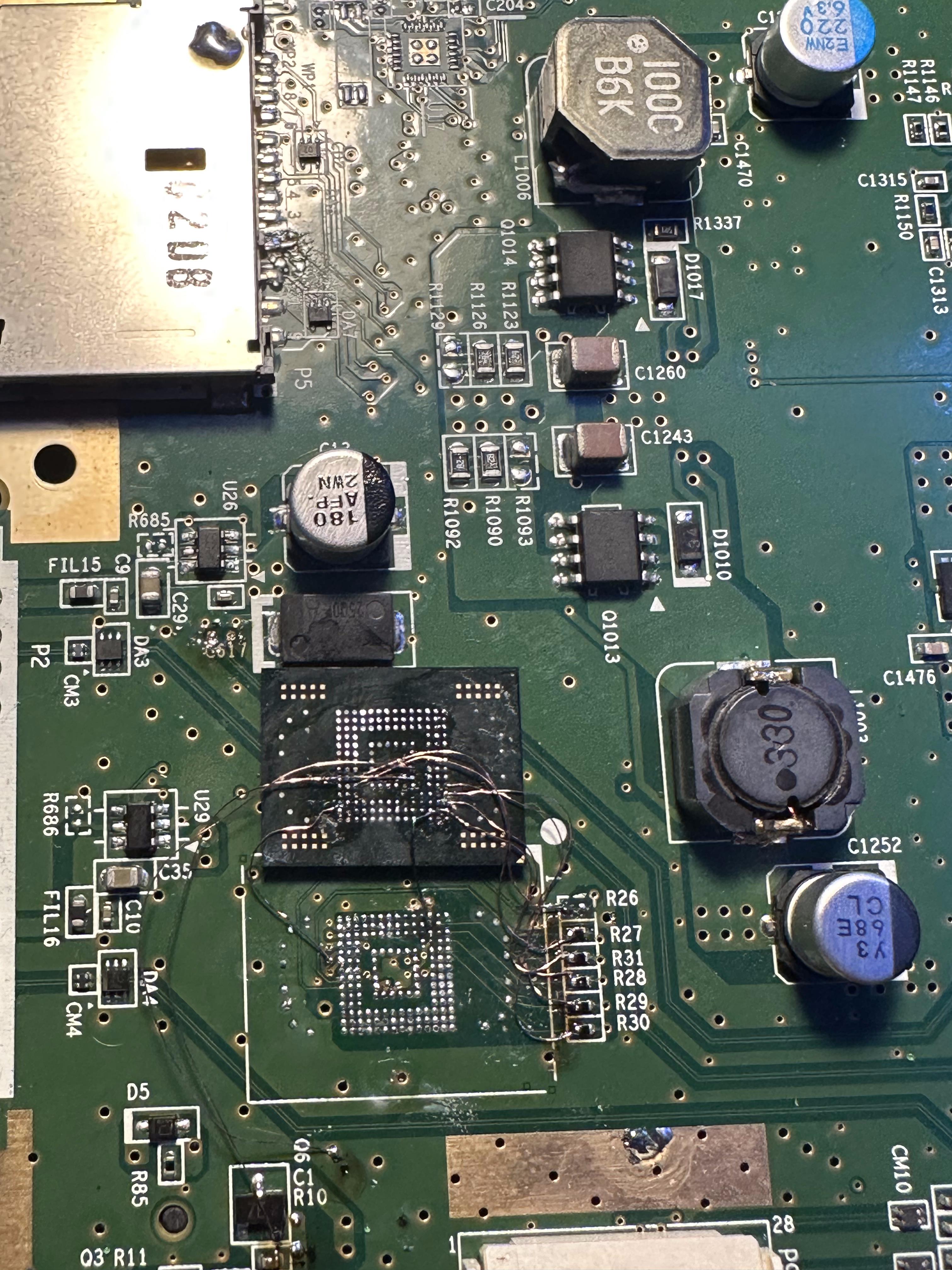

Over the past couple of weeks I decided to start working on the Wii U as I've been interested in portablizing developments on this console for some time now and I made some good progress on it.

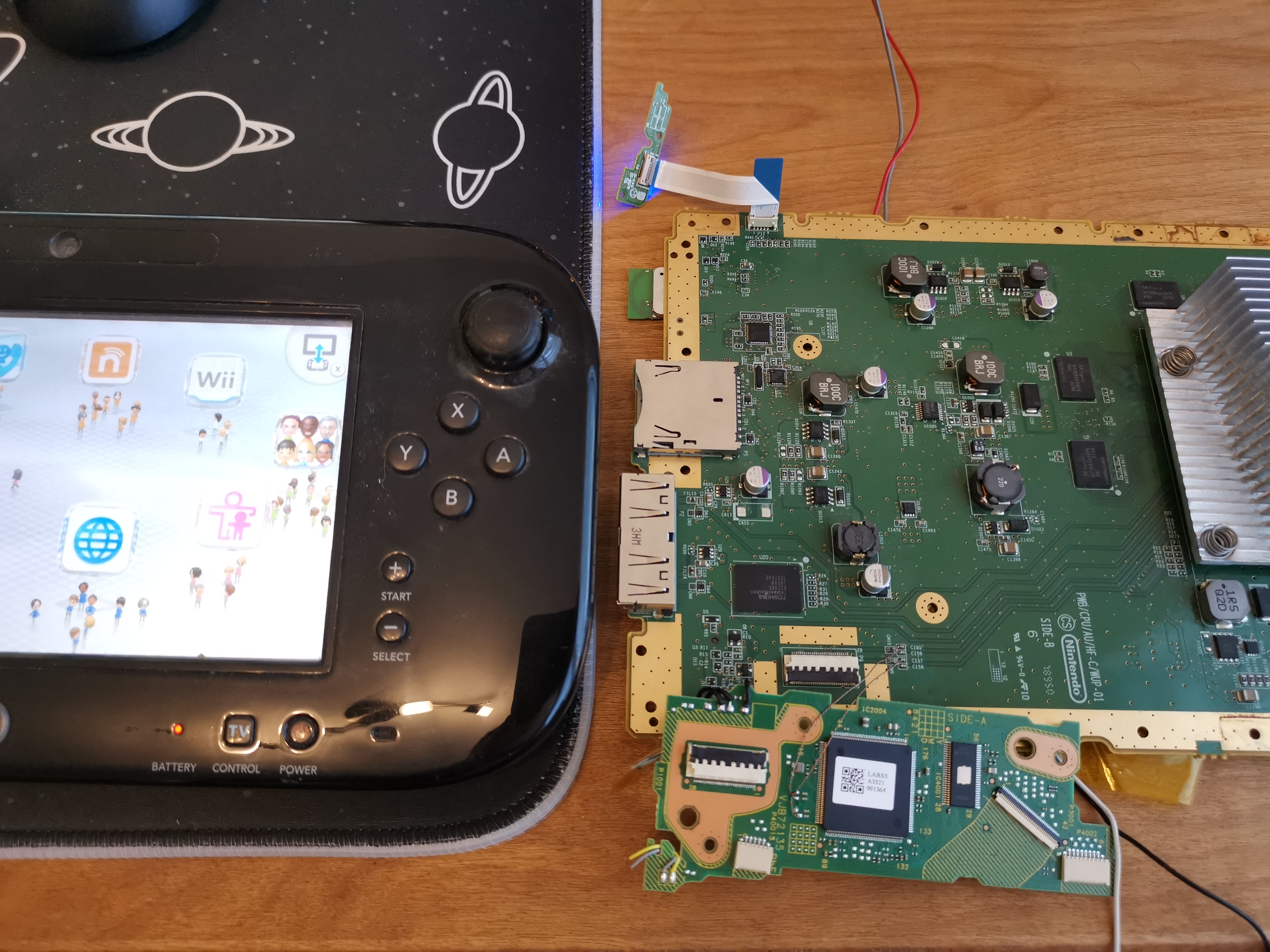

First thanks to the help of YveltalGriffin in previous postings I was able to successfully relocate the disk drive. I ended up bypassing the capacitors and it seems to work. But as stated previously this won't be necessary using de_fuse.
Next I was able to relocate the bluetooth module and sync button too showing a connected wii remote
I then decided to try to relocate the Gamepad Module which is where the current bottle neck occurs. The system will not recognize it even after connecting all of the data lines.. I will need to further investigate this issue. I'm guessing it could either be an issue with wire length or the SMC controls the syncing of wii remotes and the gamepad as well which would be a huge pain.
Lastly I did something really silly which I do not recommend at all but I will post it here for memes
I was able to relocate the bga nand. I have not fully tested this at all unlike the bluetooth and disk drive. So I'm not sure if it works in game but I am able to boot to the menu which should mostly confirm it working. Either way you can easily replace the nand with an sd card which actually allows you to solder to the CPU passives.
But yeah don't do this I will back up the nand and try to replace it with an sd card.
I will continue experimenting and hopefully I can figure out the issue with the gamepad module!

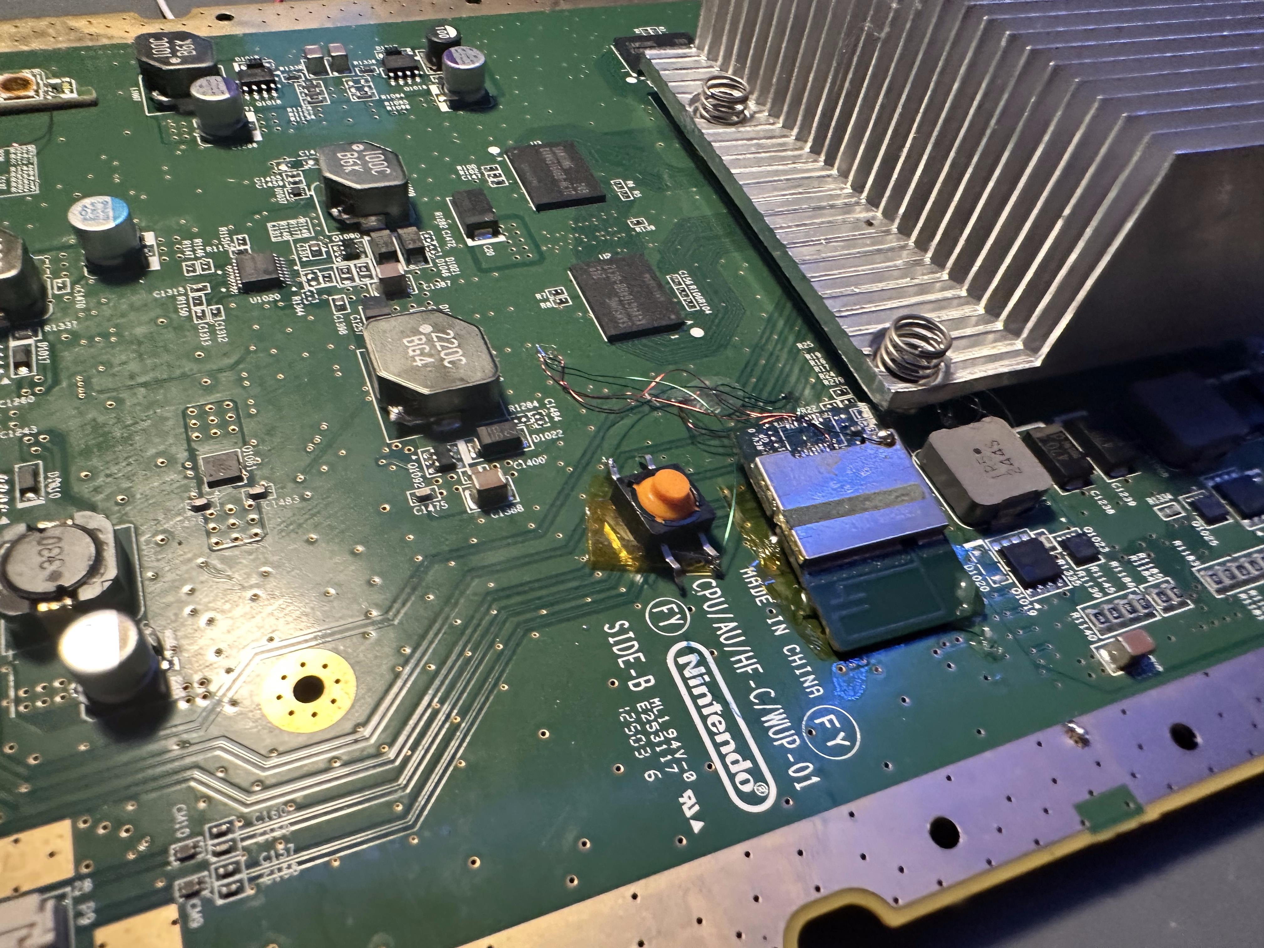

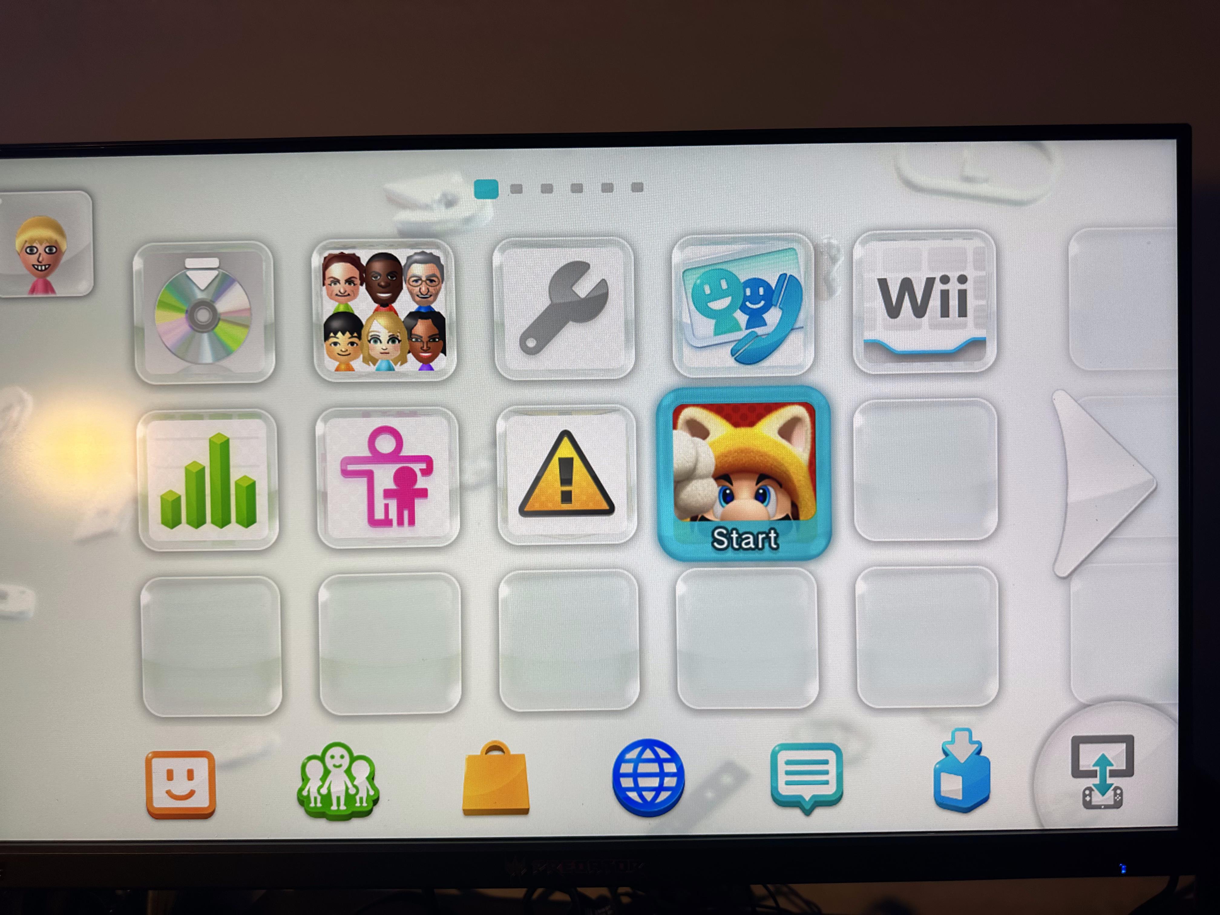

Just wanted to post another update on my progress before I forget
First off I decided to switch to a different U motherboard for now because the other one I have can't test games for now since the gamepad module isn't working at this point. I wanted to test to see if it was possible to fully replace the eMMC with a micro sd card since I have seen other modders doing this in order to save the Wii U from being bricked by the eMMC.
I backed up the nand by soldering its data lines to an sd card reader and saved the back up to my pc. One thing to note is you cannot turn on the Wii U after doing the backup you can only turn it on once you replace the nand because the slc dump (from the nand on the bottom of the motherboard) will not be in sync with the eMMC
Then I traced the top vias from the nand to the vias underneath the SOC and wired a micro sd card. It is required to have a 100 nF capacitor between 3v3 and GND I took one from a spare Wii I had and used a pretty jank method to attach it. I'm hoping to eventually design a pcb to make this easier and a flex would be great for this application.

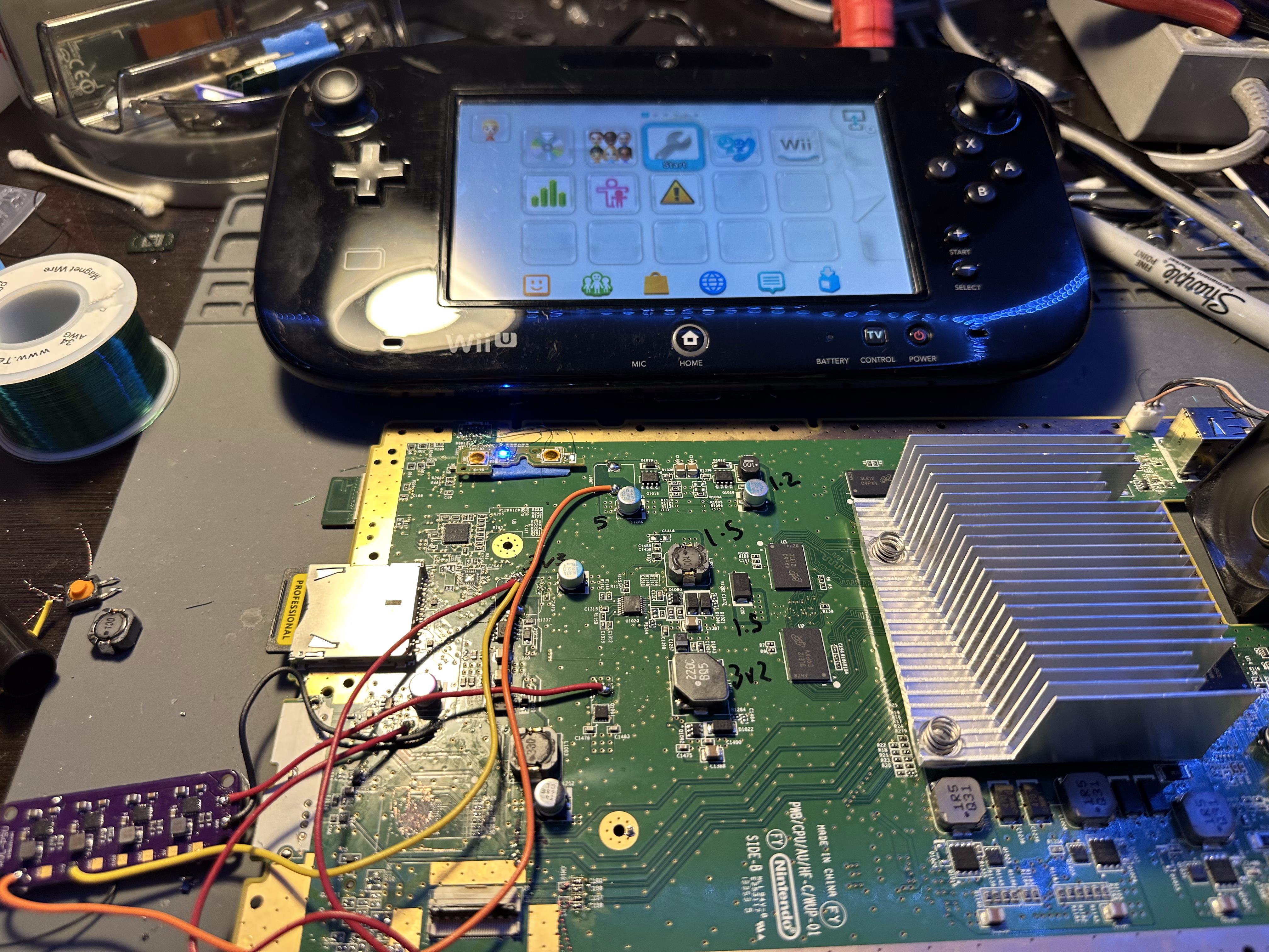

After it was confirmed working I also started working on the next goal I have for the U which is custom regulators. I was able to get it working with 3v3 and 5V using the PowerMii board but I will need 5 more regulators as mentioned further in the thread: 1V, 1V15, 1V25, 1V5, 2V65. I am aware that 1V and 1V15 are for the SOC, 2v65 is for the gamepad and the rest I'm not sure about.

I’m mostly trying to test what is capable of being relocated with just the stock U. Currently what is possible is
Relocated:
Bluetooth, eMMC (SD card replacement), 5v Reg, 3v3 Reg, 1.2V Reg
Untested (To my knowledge) But Possible:
Wifi Module, SLC Nand, Smc
Failed (From my testing):
Gamepad Module, 1V, 1v15
It seems all of the regulators are monitored by the SMC so as YveltalGriffin was saying they will need to be disabled. The gamepad module needs more documentation and testing too.
