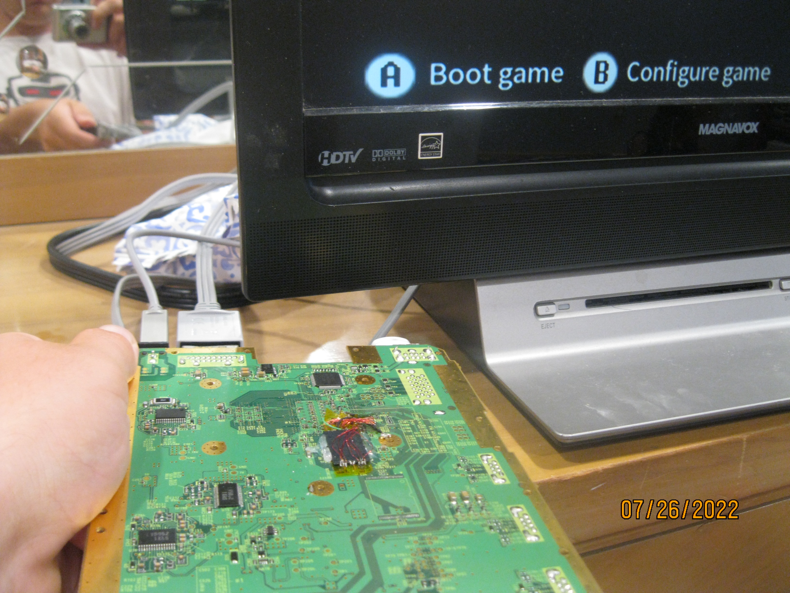

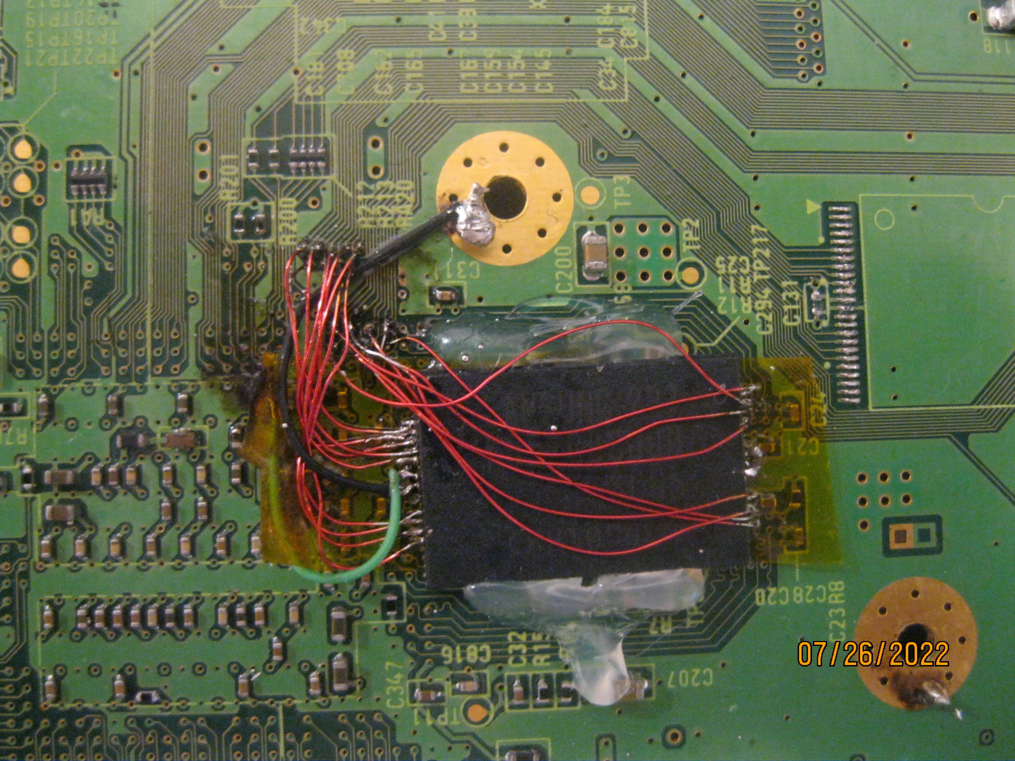

This is a thread I'm making to document my little Wii projects in progress before posting them in their own thread. For now I'm gonna document progress on an OMEGA trim I'm working on.
I intended to use the NAND flex boards from 4layer. However, I wrecked both trying to fix some joints that weren't connecting. Rather than order more flex boards, I said, "Screw it, I'm doing this by HAND!!"
It works!
Has anyone else done a full NAND relocation by hand?

Me Too! I used half of the stock nand pads bent 90deg… not as compact but less wires.

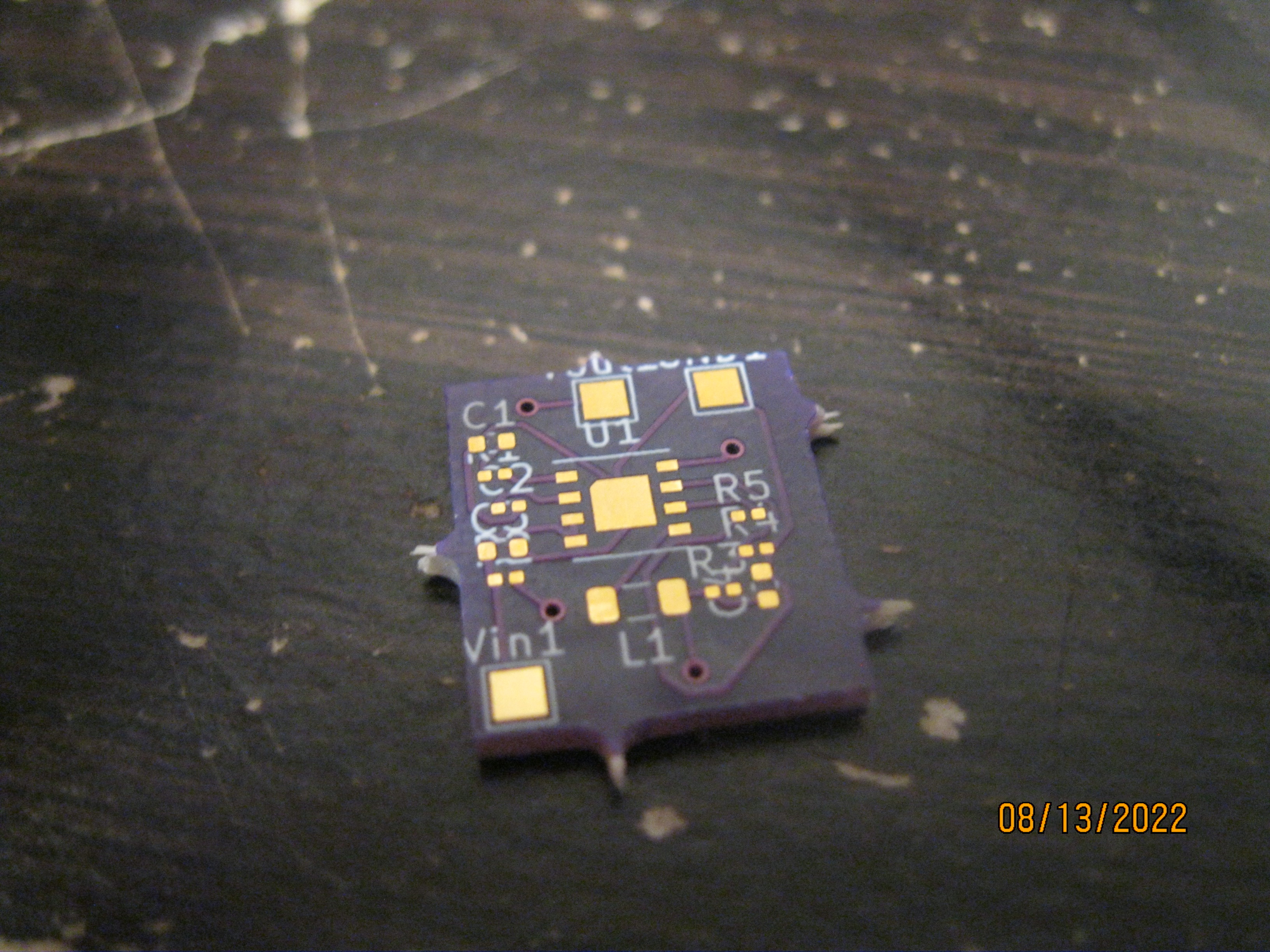

Just a little teaser for something I'm working on. Will assemble in a few days. Can you guess what this is?
Not to rain on your parade, but what width are those traces? For carrying up to transients and load currents of 2A like the Wii draws, I would be very surprised if the regulator board functions at all. You should use the polygon tool in your CAD program to make voltage and ground input/output planes so that there is no voltage drops. The general rule is more current = thicker/wider trace widths required.
You're right, they are pretty skinny. I realized that when I ordered them. These are just to test to make sure the reg board can make the voltages I need.
I am not intending to power the Wii on these as a permanent solution, or possibly at all.

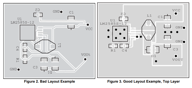

The datasheet for the part you're using will often have a recommended layout and/or a list of layout guidelines. Often you can just copy the provided layout if you aren't comfortable winging it!
Also, here are two application notes I really like that walk you through making a good switching converter layout:
AN-1149 Layout Guidelines for Switching Power Supplies
Five steps to a great PCB layout for a step-down converter
The gist is to put the inductor, input caps, and output caps as close to the IC as possible to minimize loop area, while using very short, very wide traces. Like StonedEdge said, polygons make it a piece of cake.
