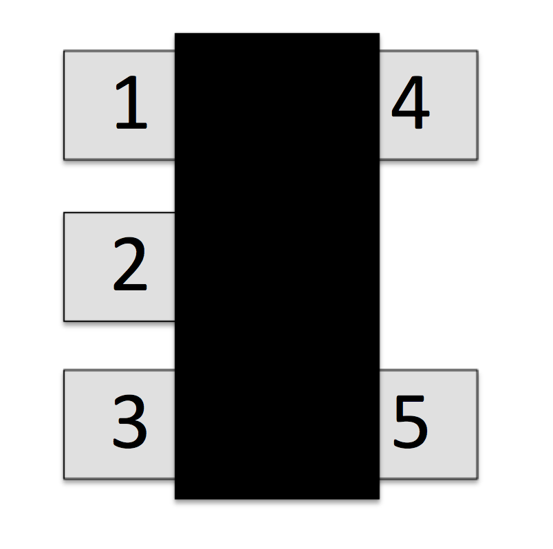

Mysterious 5 pin ICs
The purpose of these small 5 pin integrated circuits is still not fully understood.
Here is what I believe the datasheet for U9 and U10 to be. It appears to be some voltage check that sends a 3.3v signal to the mx chip when the voltages of the 3.3v and 3.3v standby lines are at the correct voltage.
U9 (not mandatory)
Input voltage is the 3.3v standby line. Output is to a pin on the MX chip. 3 pins in a row connect to ground. This chip can be removed, but the data lines of the two non-grounded pins (Pin 4 and Pin 5) must be shorted for the console to boot.
Pin 1: GND
Pin 2: GND
Pin 3: GND
Pin 4: 3.3v standby
Pin 5: Bluetooth Pin 14 + MX Pin 25
If this chip is removed:
Console WILL NOT BOOT if data lines of pins 4 and 5 are not shorted on startup
Console WILL BOOT if data lines of pins 4 and 5 are shorted on startup.
U10 (not mandatory)
Behaves similarly to U9, with a few key differences. The console will not boot unless pins 4 and 5 are shorted AFTER power on. The pins must not be shorted when power is first applied, but must be shorted at least .1 seconds afterward.
While the EXACT purpose of this chip is unknown, it is believed that this chip examines the 3.3v line, and sends a reset signal to the GPU and bluetooth board. This turns on both devices, and "re-calibrates" the 3.3v line.
Pin 1: GND
Pin 2: GND
Pin 3: GND
Pin 4: 3.3v
Pin 5: MX Pin 24 + GPU
Console WILL NOT BOOT if data lines of pins 4 and 5 are shorted on startup
Console WILL BOOT if data lines of pin 4 and 5 are shorted AFTER STARTUP
After bootup, data lines do not need to remain shorted.
Reconnecting the line to 3.3v at any time while the console is powered on resets the console.
If custom regulators are used, the console can boot without U10 under these conditions, but it causes issues.
-1v and 1.15v MUST be powered before 3.3v power is applied.
-pins 4 and 5 must be shorted
In the current state, this is not recommended, and is only being mentioned for documentation purposes. 3.3v data lines such as the gamecube controller lines will act completely sporadic, because their reference voltage was not correctly set.
