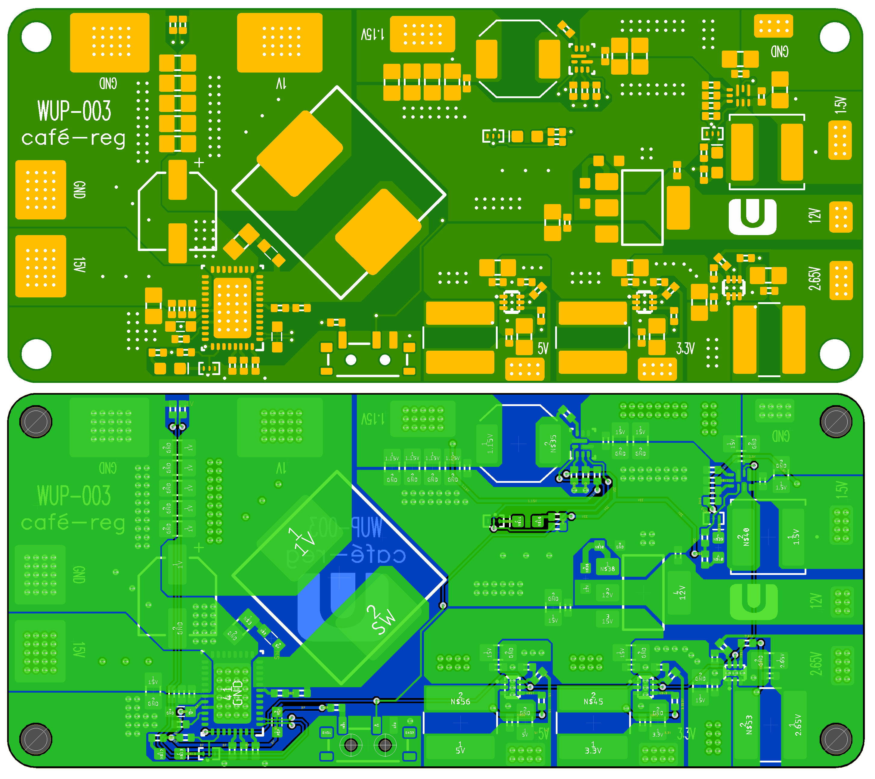

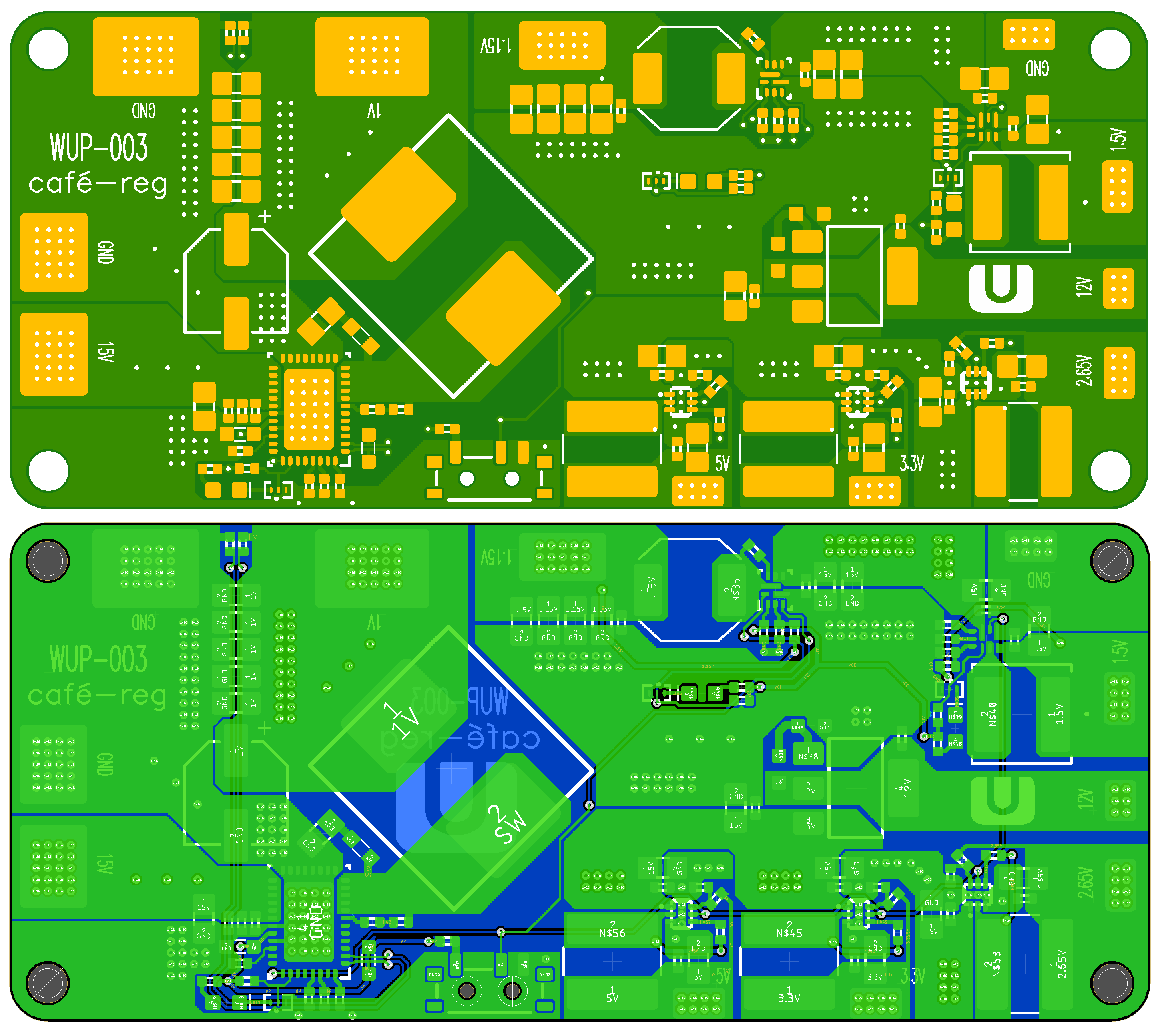

I did design a Wii U regulator board that uses the stock 15V Wii U power brick and generates all the necessary voltages, but I never ordered the PCBs.
It has an on-off switch and power-good LEDs for each of the high-current regulators. BOM cost is about 45USD/board, but most of the regulators are impossible to get anyway due to the chip shortage. If the regs do become available anytime soon, I would be more than happy to assemble a few of these and ship them to anyone who wants to run tests.
