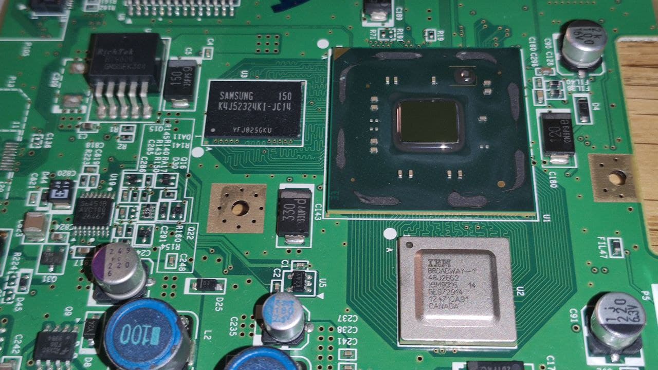

I got a Wii Mini (RVO-CPU-01) with a HOLLYWOOD-2, which has not been documented in this thread yet. I have delidded it, and it seems to be a 45nm die-shrink of HOLLYWOOD-1. Also, it is branded Renesas instead of NEC.
Yes, the existence of this chip is known. It seems to appear interchangeably with the Hollywood-1 on Wii Mini boards. I haven't performed power consumption tests myself, but another user who tested it told me the power consumption delta was not significant. If you can acquire a Wii Mini with a Hollywood-1 chip and perform comparisons, that would be useful data to have.
My suspicion is that the power consumption reduction from an (assumed) 30% GPU shrink alone is not going to be enough to justify making portables out of them. From the 01 to the 40, both the CPU and GPU were die shrunk, which is why we have such a drastic reduction in power consumption. Wii minis are far less common, and there would be no way to know from the outside if it has a Hollywood-1 or Hollywood-2. To make matters worse, hacking a Wii mini is far more complicated, and the board and its behaviors aren't as well documented.

Cool! Thanks for measuring. It would be nice if someone confirms the numbers, but I don't see why we couldn't trust what you measured. So the difference between Hollywood-1 (8.2W, which I believe is what a non-Mini 4-layer draws too) and (6.8W) is 1.4W, about 20%.
So a 20% increase in power consumption between Hollywood-2 to Hollywood-1 isn't as impressive as the 40-50% decrease between Hollywood-1 and Hollywood/Hollywood AA. With no way to see from the outside if it's a Hollywood-2 and the relative rarity of the Wii Mini (at most 100th of the sales numbers of the regular Wii), I wouldn't start recommending these to portablize.
But installing BBLoader onto a Hollywood-2, if you have one, shouldn't be impossibly hard. And Wii Minis, where I live at least, are worth 15-20 eur and aren't extremely rare or anything. Looks to me that if you have a BT adapter and a way to run Linux, it acts the same as a regular Wii. Maybe @Aurelio knows if the Wii Mini is more locked down than a regular Wii in relation to Hiidra or VGA, etc.
I have never tried BBLoader and Hiidra on the Wii mini, so I don't know tbh
Tried installing BBL onto a Wii Mini last night. It installs fine, and everything seems to be working fine. Basically Bluebomb the Wii (instead of using Letterbomb) and you can install it the same way as a normal Wii.
Now someone just needs to try to install BBL onto a Hollywood-2 board, since according to @Aurelio there may be a difference between the two dies. I'd be down to try it out, but it would take some time to find a Hollywood-2. Maybe @nino wants to try, to test out BBL you can run the installer and press B when prompted, and it won't install, just run.

I was able to get a hold of a 50. It appears to be exactly the same as the 60, but only in PAL regions. I appreciate it though!
CPU-RVL-40 isn't the last revision to still use Sharp parts, I just saw a RVL-60 on ebay that had a Sharp 1.8V regulator on the board.
I also found a RVL-40 that used a 1.8V regulator by RichTek, so it looks like they were simply used interchangeably for these revisions.
Not sure if any 101s have Sharp regulators.
RVL-CPU-50 is also the first revision to have the revision number written in the SD card slot
RVL-40 photo:
RVL-60 photos:
