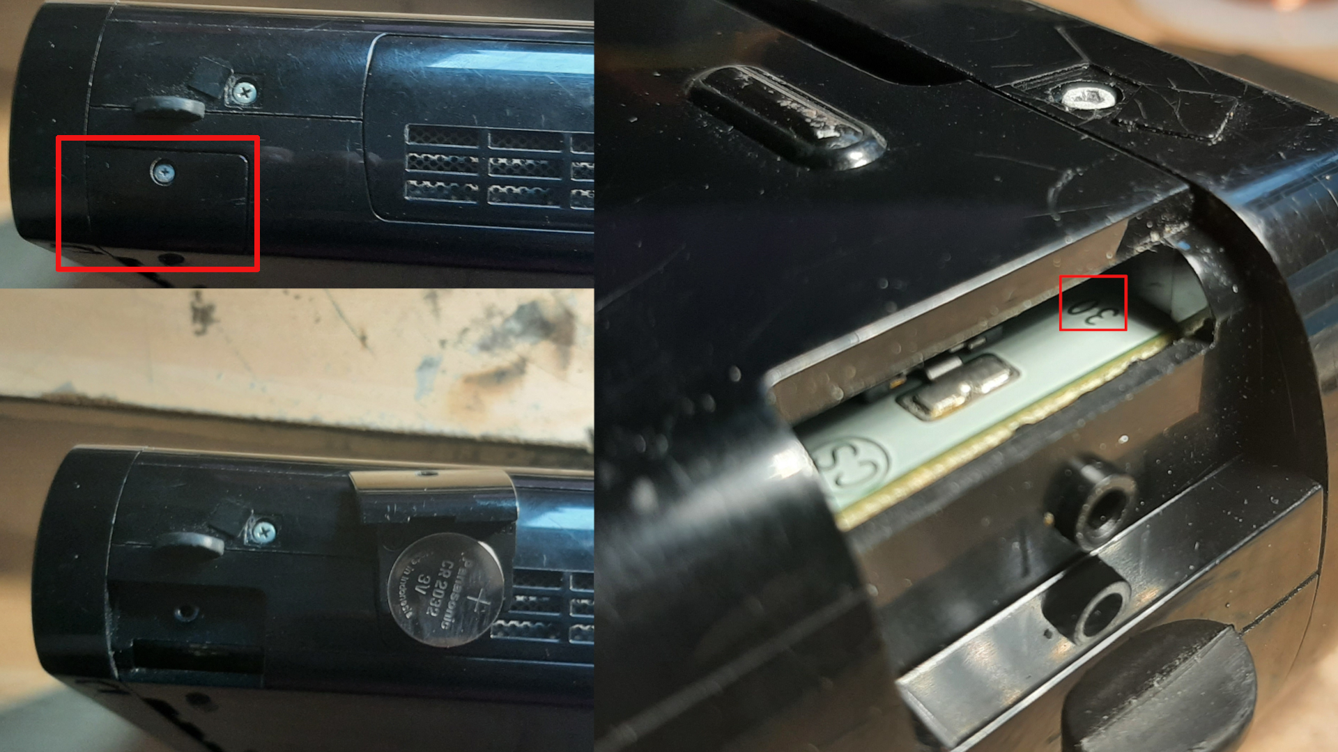

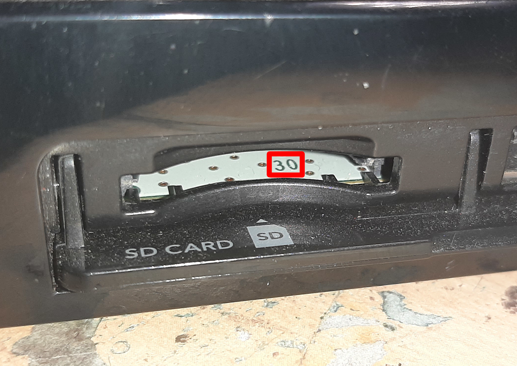

3. Battery Tray or SD Card slot
The motherboard revision is part of the solder mask and is left out of the silkscreen in these areas. The battery tray requires a single phillips screw to be unscrewed and can be seen on the board. The board revision can also be seen in the SD card slot by pushing open the door at the front.
