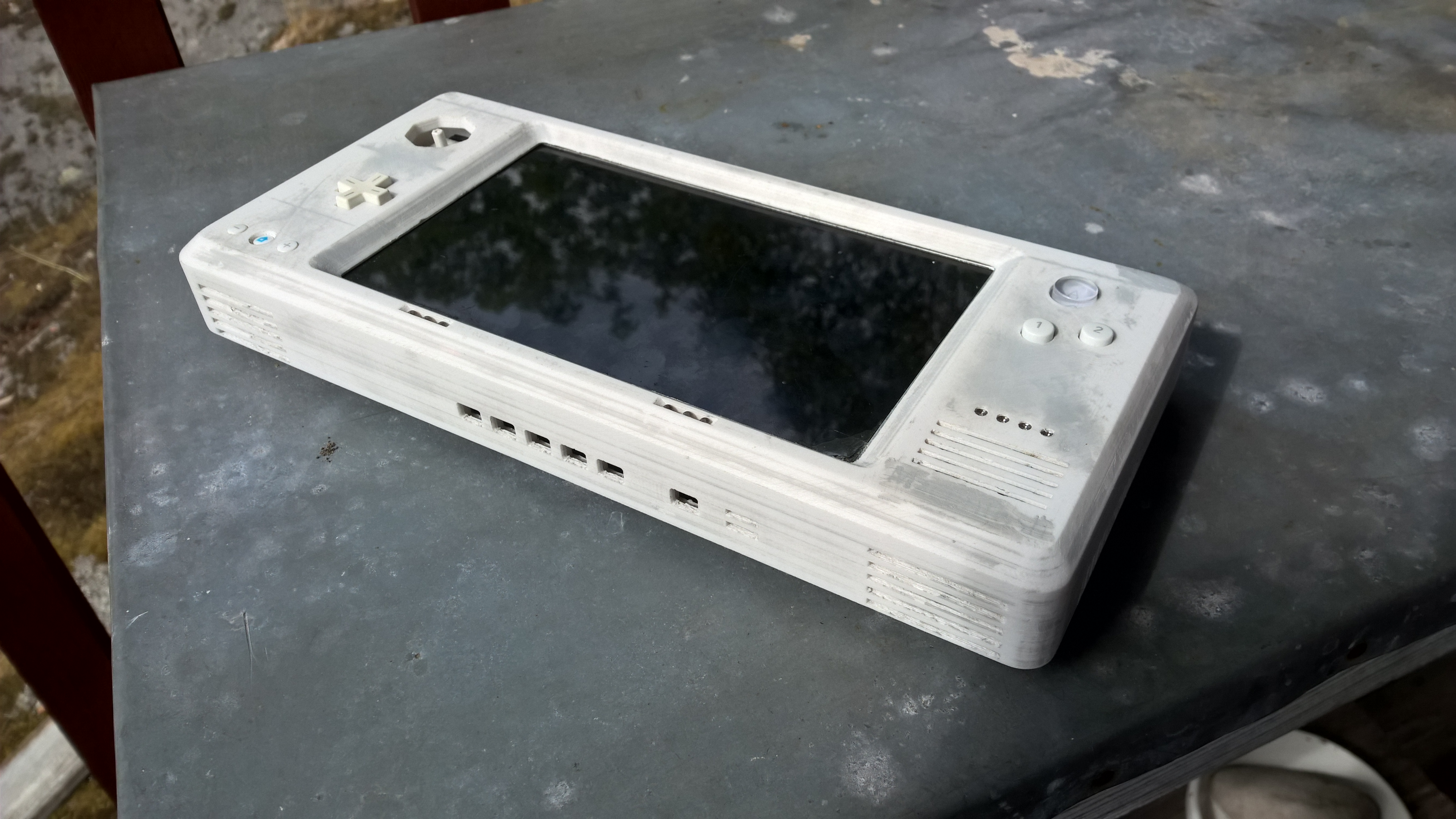

This is the case so far:
8 batteries is going to make this rather heavy to hold. I like the design, are you just going for the Wiimote and nunchuck controls?

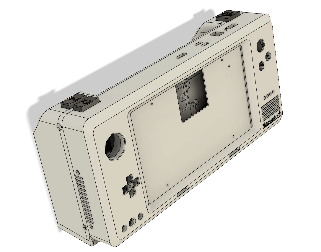

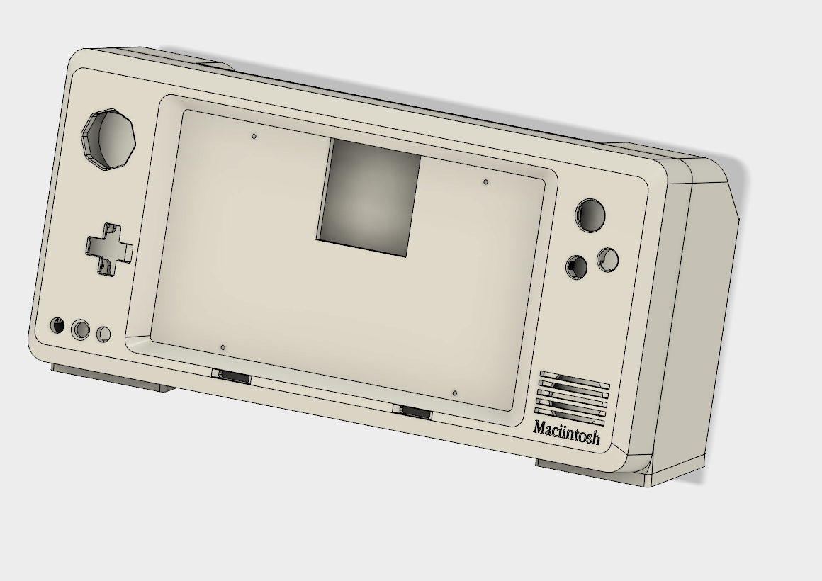

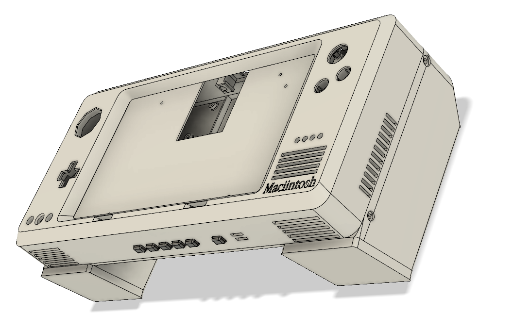

Onto the updates:
I'm almost finished with my case design. Not much has happend on the outside but I have worked a bunch on the inside.
