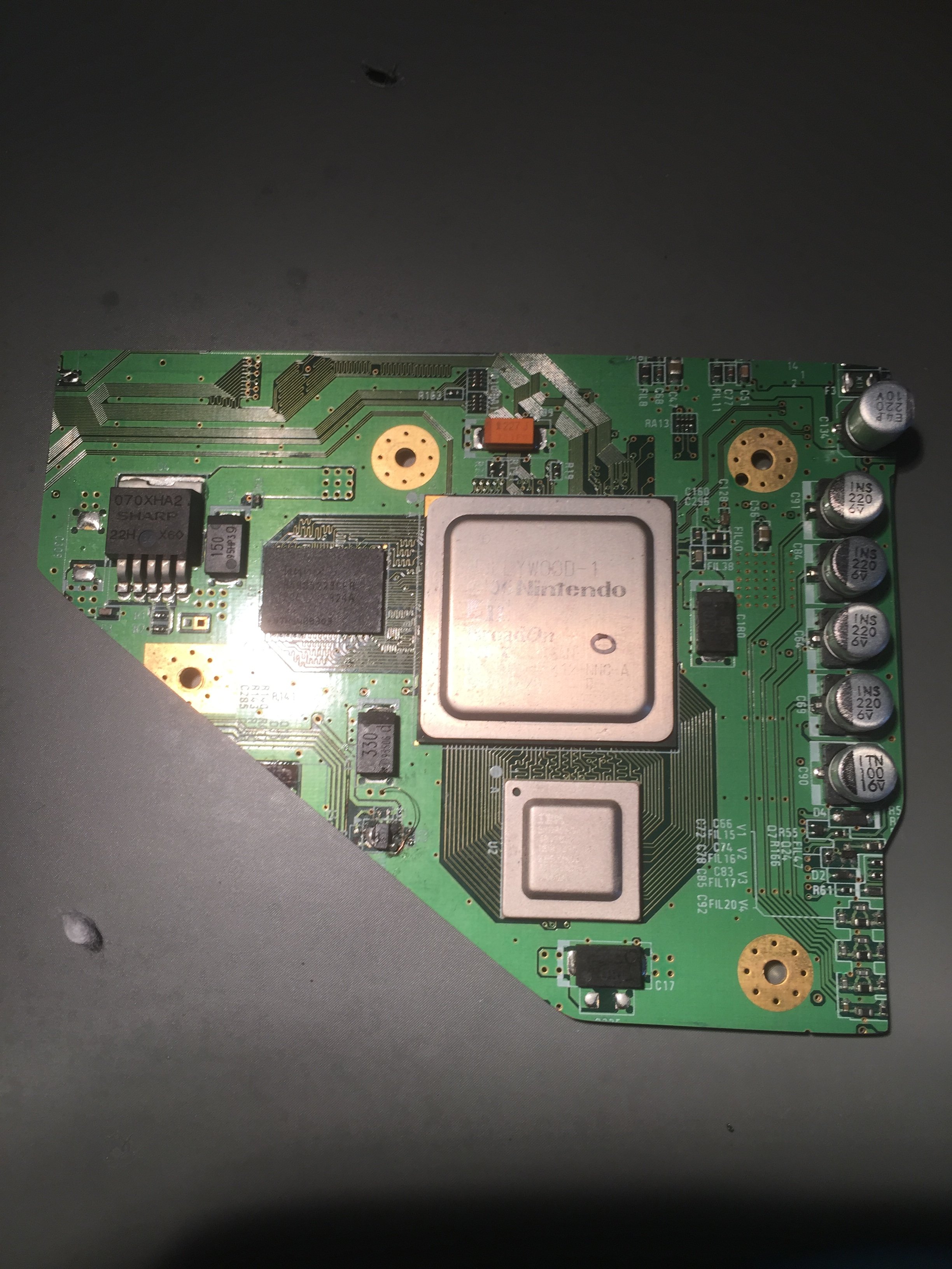

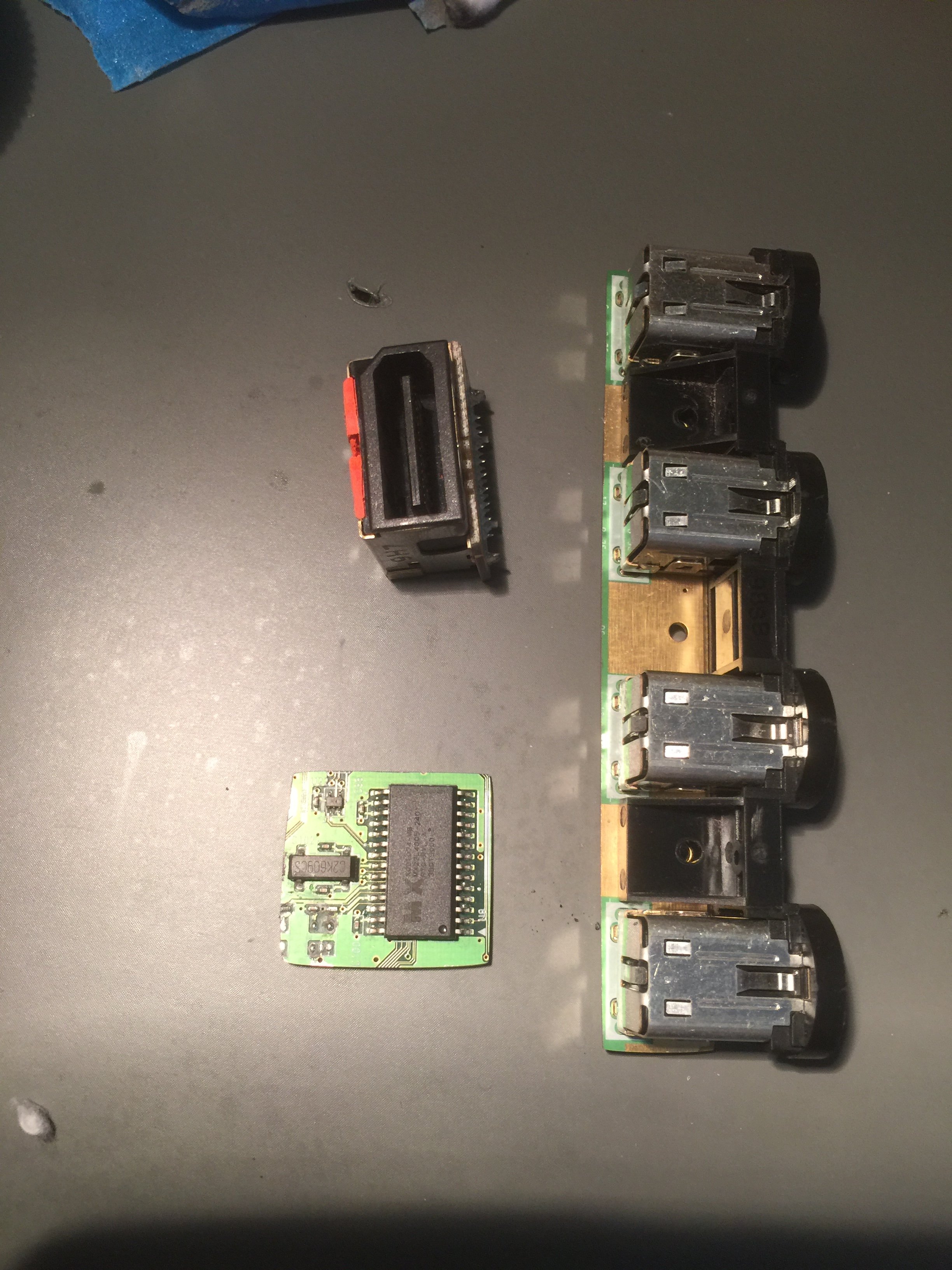

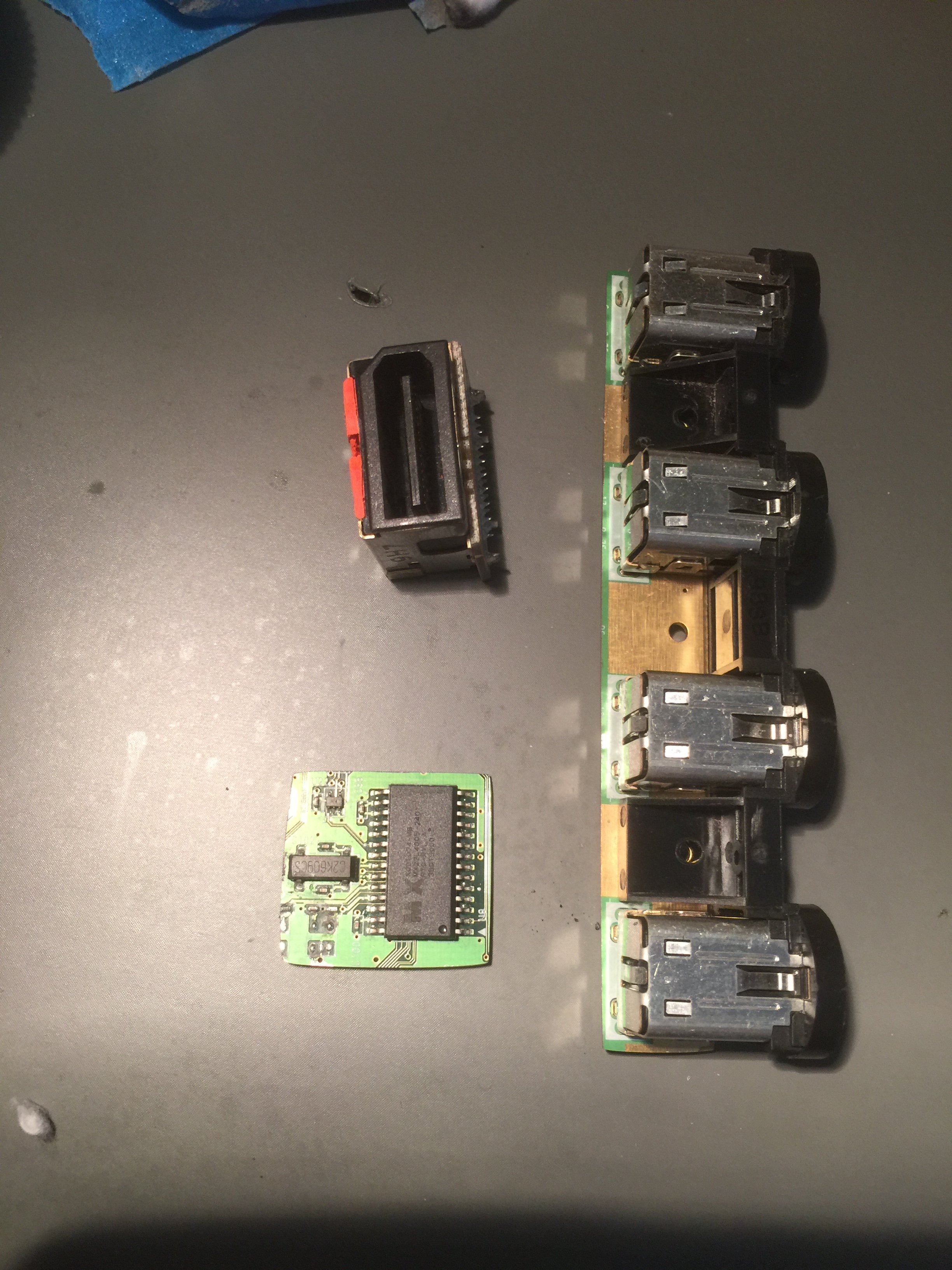

Here it is! My first-ever trimmed Wii!
Plus accessories:
Still a long way to go but finally some results. I really wanna test this thing once I fix the Bluetooth again. The only problem is that I don’t understand where to connect the wires from my custom regulators to the board. Do I just connect them to any pin, via or component leg of choice within the highlighted area?

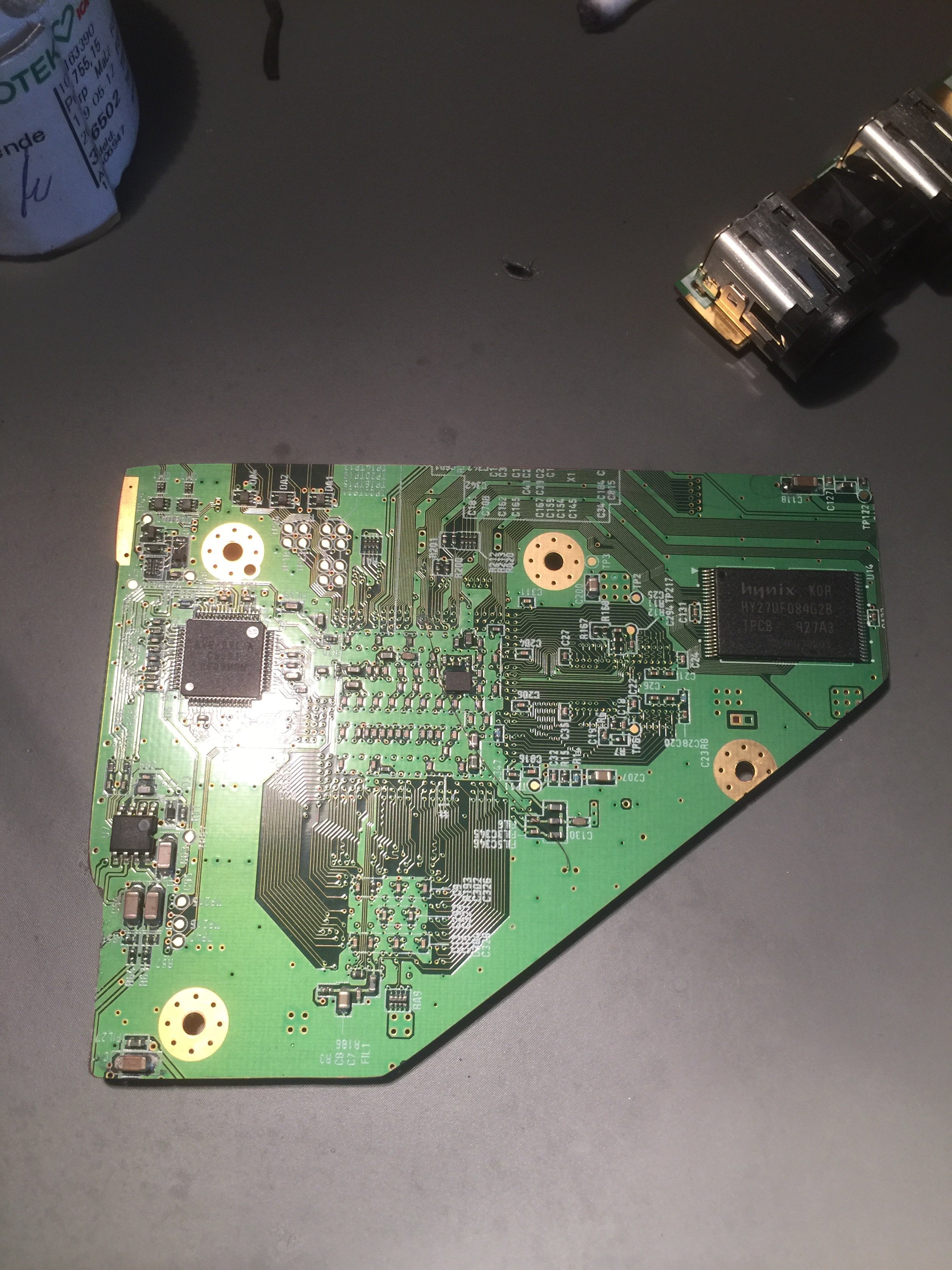

Oh shit almost forgot. Here’s the back:
Yes, you can connect your voltage to any of the spots indicated in the guide. The voltage points are all internally connected inside the Wii, so you only need to run one connection from each reg to the Wii.
Ahh that’s what I thought. In that case I might hopefully be able to get everything hooked up pretty soon. More pics on their way

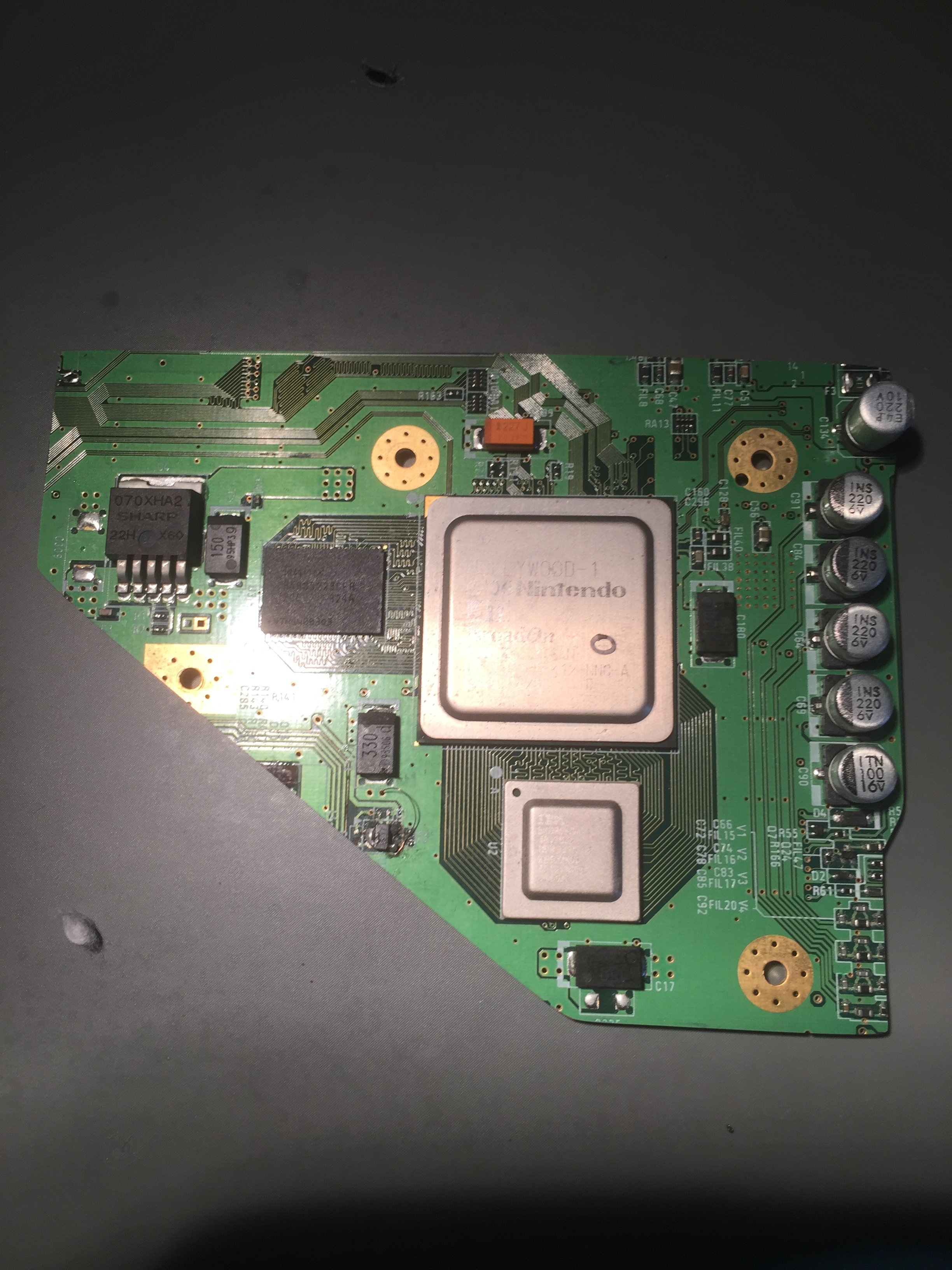

Plus accessories:
That's a fucking good first trim, I'm impressed my dude!

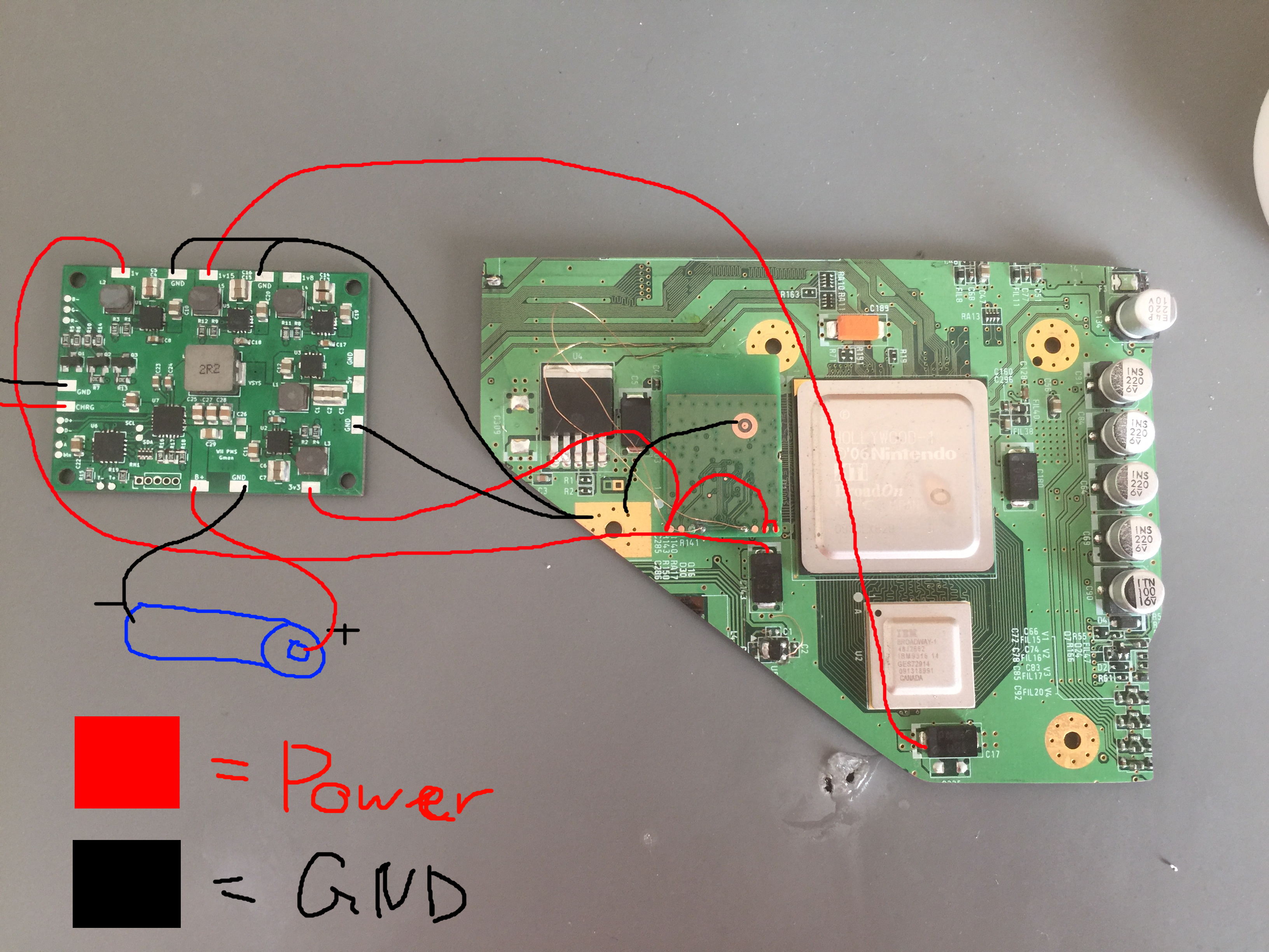

I think there might've been a misunderstanding regarding the PMS. I'll show you what I mean:
Is this how it's all supposed to be wired up? Sorry for being so finicky but I'm waiting for my battery holders so might as well ask.
Looks pretty good, you will need to connect 3.3v to the main board as well as the Bluetooth module, and you only need to run one ground wire to the Wii, as long as it's 22 gauge.
@Davve_DP
Bluetooth 3.3v line in your diagram looks incorrect as you would be shorting it to ground. Double check your diagram, it should match the pinout of the trim guide for the bluetooth here:

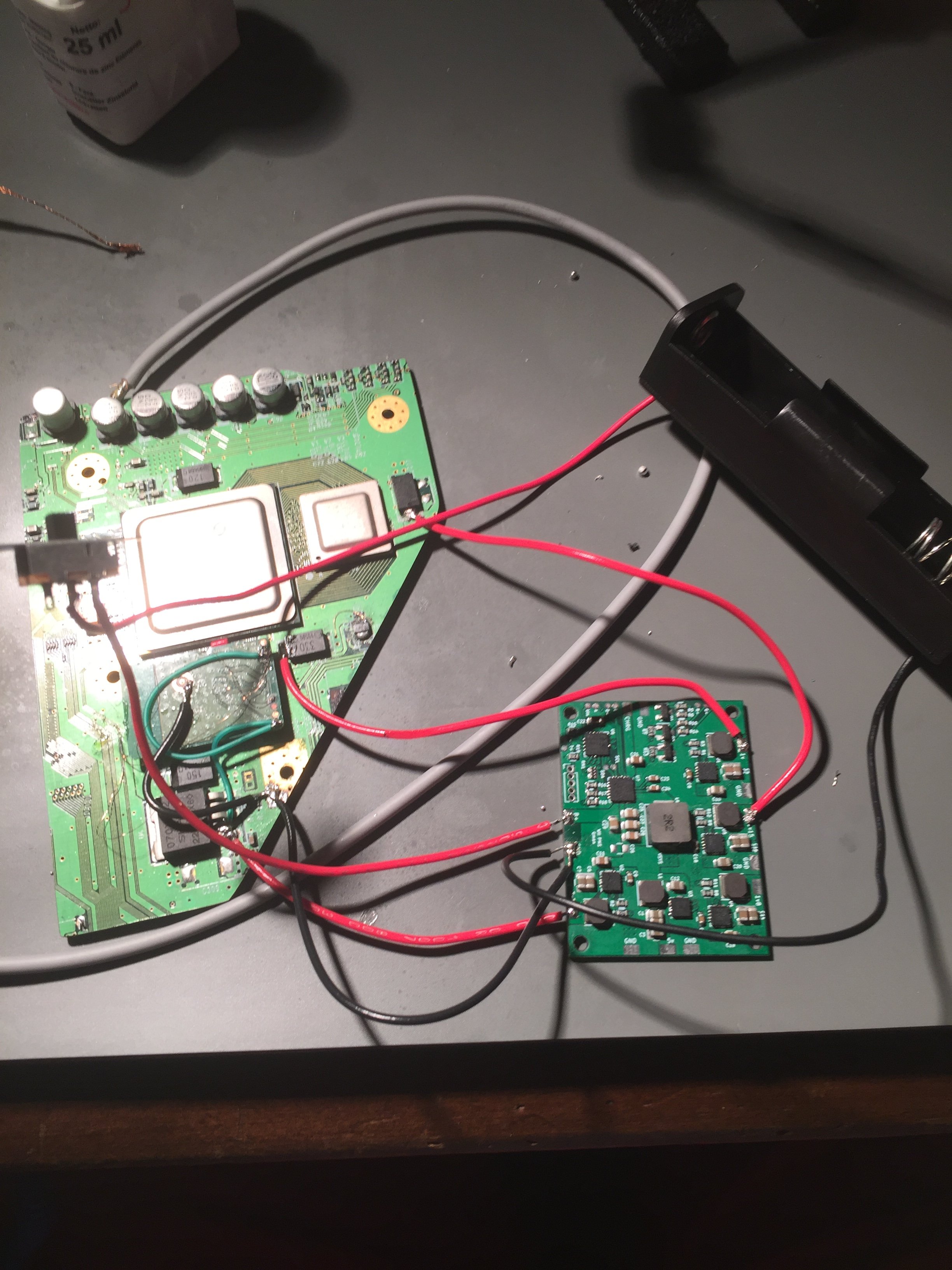

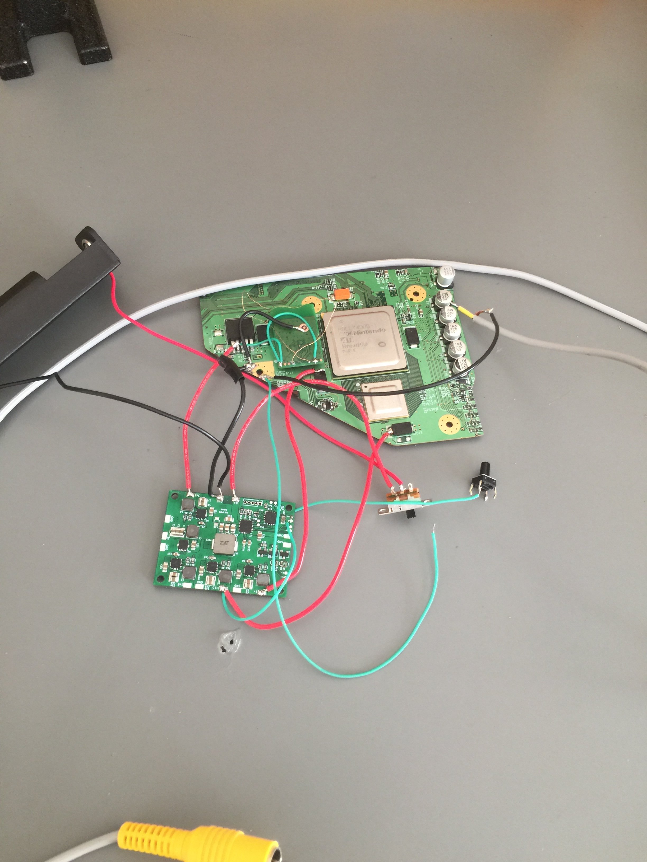

So after being away for 2 days I finally finished wiring everything up. While doing this I realised that I need to work on my soldering. Not that the results are terrible, but I’m struggling to tin my iron for some reason. Not sure if Weller’s ET-tips work differently but together with some flux and a generous amount of solder my iron always looks the same. No shiny silver surface. Anyway, I just wanted to ask you guys if I’m all clear to connect the battery and power-on.
(The gray wire has a composite connector at the end)
Be sure to also ground the composite connector, your TV won't be able to read the signal properly without having a common ground between it and the Wii.
If you haven't already, be sure to check with a multimeter between any of the voltages and ground.
Also remember that you'll need a button to turn on the PMS board.
And how does one go about doing this? Do I just connect a wire from where I attached the cable to the board to ground?
Yeah, you just solder a wire going from a ground point on the Wii to the shielding of the composite cable.
So first test was, as kinda expected, a discouraging failure. Absolutely no signal. After I flicked my power switch I thought I was good but then I burnt my hand on something and I saw smoke coming from somewhere. I instantly panicked and disconnected the battery and it stopped. Could it be a voltage spike or something? I was carrying the thing out of the room where I have a CRT and this happened while I was watching my step so I have no idea where the heat and the smoke came from. I saw afterwards that the button to the PMS had a wire disconnected so that could’ve been it. I’m honestly not sure what might be the issue. The problem with me not testing the board prior to trimming is that I don’t know where I went wrong. The only things I can think of that might be wrong are these:
- Using 24 AWG wire for GND lines (I accidentally ordered the wrong wire but disregarded the advice I’d heard. Was thinking that I wasn’t drawing that much without a screen, controllers etc)
- A short somewhere because of dust, corrosion, flux residues.
- My battery maybe not being charged yet since it arrived in the mail
- My wiring
Also, I know the thing turned on because the CPU and GPU heated up.
(I’ll edit this post and add my resistance values for the different power lines later)
The wire that broke off appears to be ground, so if it touched the switch next to it where the battery positive is, that certainly would not be good. Use a multimeter to measure the voltages on the regulators.
