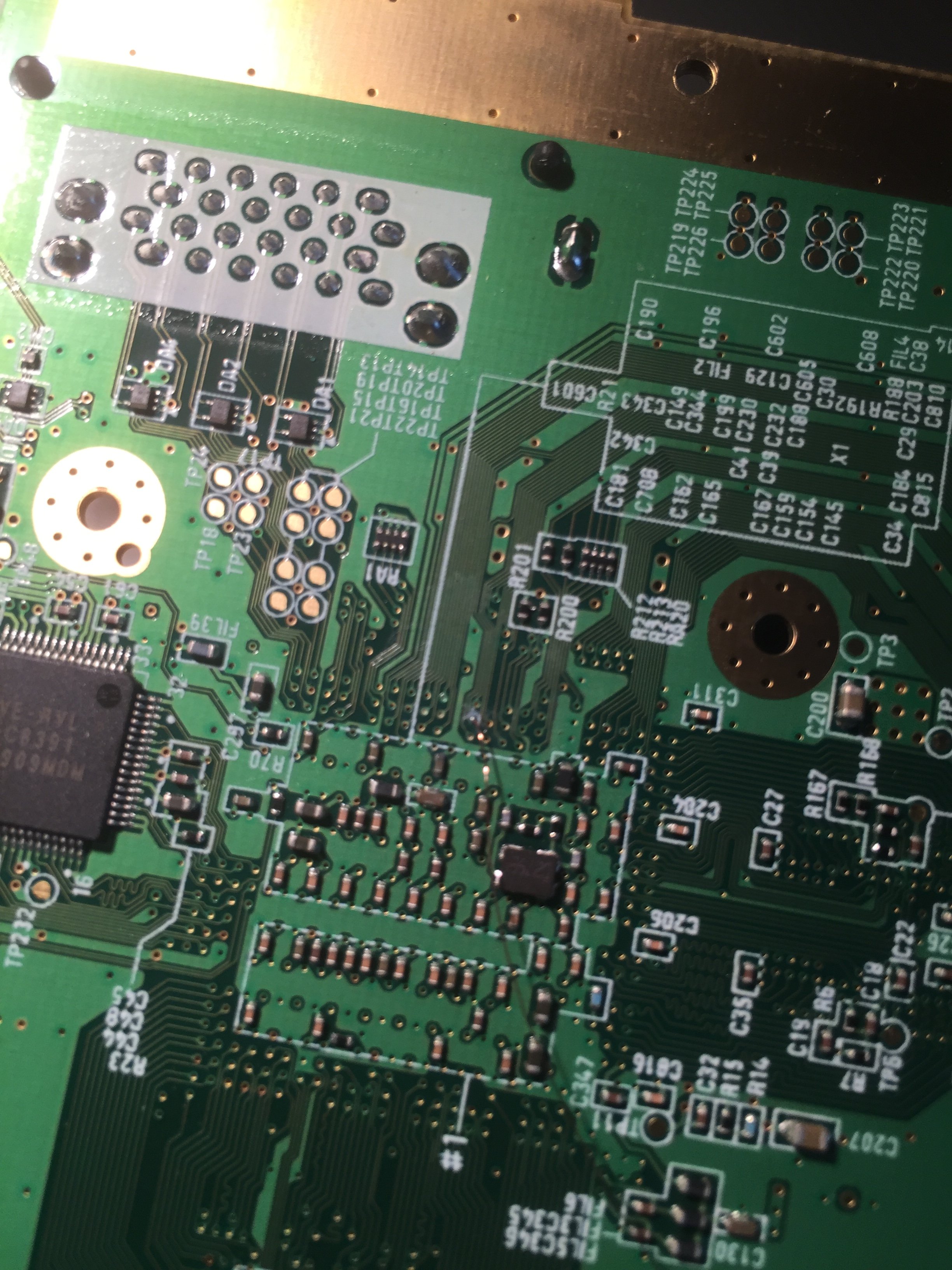

So I kinda got into trouble on the first soldering part. After removing all of the components on U5 and finally desoldering U9 (one of the legs on U10 snapped) I wanted to clean all of the pads to prepare for the relocation. The only problem is that I accidentally removed all of the solder on one of the pads (see image) and I just can’t seem to get fresh solder on that pad. The solder doesn’t melt on the pad and when I put it right next to my iron it just sticks to said iron.
Does anyone have any experience with this or should I just keep at it with a different iron tip? (I’m currently using a 0.8mm tip). If you guys have any techniques that you would like to share please let me know asap. I really wanna get this part done!
PS. Just realised. I’m going to have the same problem when relocating Bluetooth right? How do you guys get the solder to stick to the traces?
I hope these questions aren’t too noobish. Thanks in advance guys!
Edit: After some more research I’ve concluded the solder panda might’ve come off. In that case I was wondering if that pin has to be connected to that pad. Seen as I’m cutting the trace leading from the pad I was thinking that it doesn’t serve much purpose anyway right?

Yep, you pulled that pad off. Since that is the output pin that you run the wire to, you don't need to worry about it, just solder the wire directly to that leg instead of the pad
For that you need to scrape the solder mask off the top of the trace to reveal the copper below, which you can then solder to. Make sure to not expose the ground plane around the trace and to not short the two traces together (it's fairly easy to do since they're so close together)

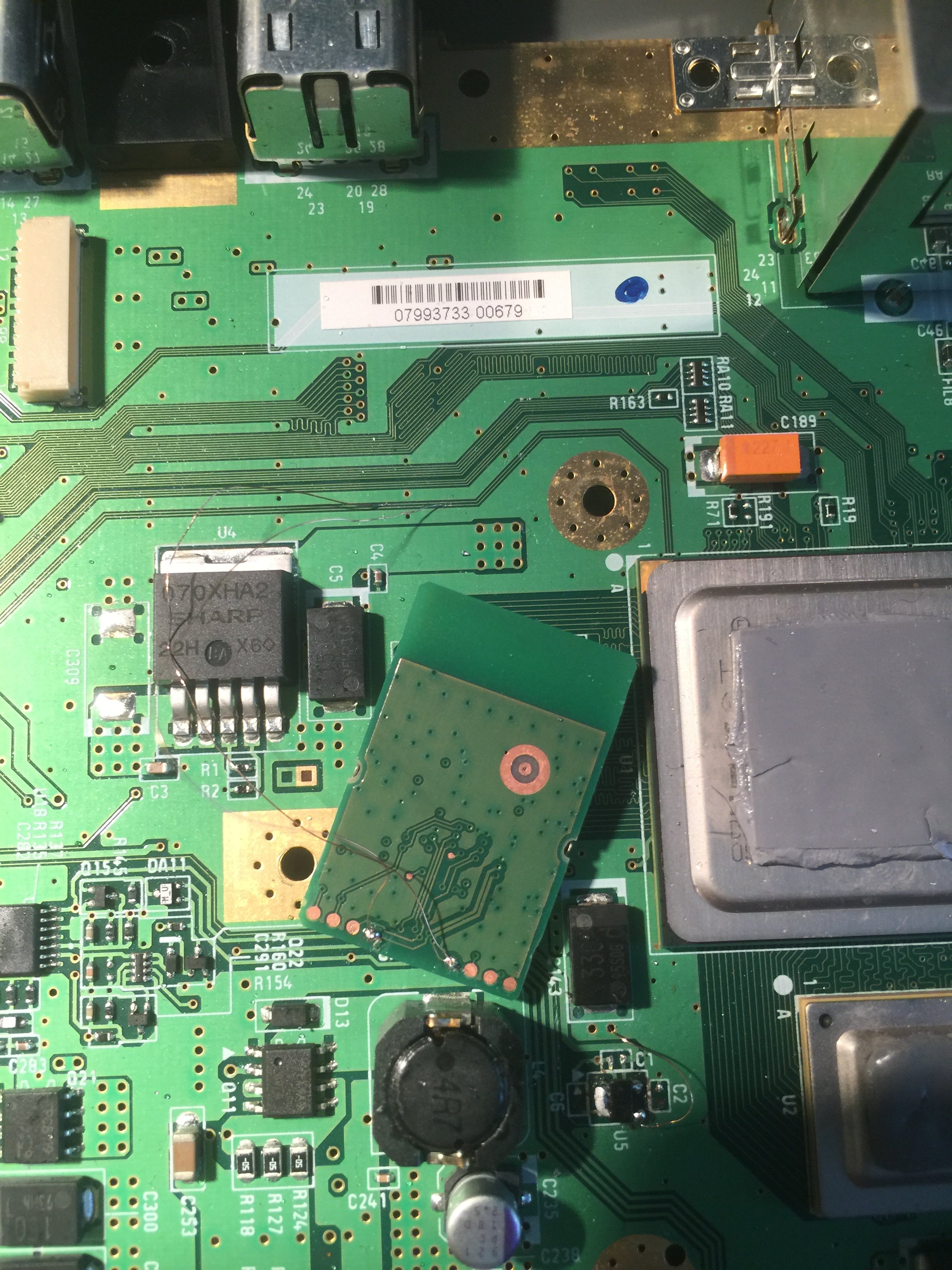

A couple things:
First, you need to get some magnet wire for soldering to vias. Thick wire like that does not make a good connection, and will likely short out against other vias.
Also, you've shorted the input and output pins of U10 together. It's ok if the three pins on the left are all connected because those are all just ground, but if the two pins on the right are shorted then the Wii won't work.
A couple things:
Thanks for the tip! I do have some 38Awg magnet wire but unfortunately it’s not insulated. Maybe I could use some electrical tape for that? Should I replace the wire? I’m sure that the solder joint isn’t in contact with the other vias. Could trying to boot a trimmed wii damage it in some way if that connection turns out to be bad?
Also, as I mentioned before, I’m using U9 instead since one of the two pins on my U10 came off. In your Exhaustive guide u said that when using U9 you must bridge those to pins as well as the 3 pins on the other side. Maybe I misunderstood that...
Don't use the uninsulated magnet wire, go ahead and order some insulated stuff. You can get a spool that will last you until the sun blows up from eBay for less than $10.
And sorry the U9 part wasn't clear, the bridging pads part was meant for the 2 pads where you removed U9 from. You don't need to that if you aren't testing until after the trim though.

Yes, you need to separate the two pins on the chip. You need to bridge the two pads where the U9 chip used to be.
38 awg is just fine for the u10. It's just a digital signal, so there's virtually no current.

Ok so I swapped the cable for the U10 and I also connected the data lines for bluetooth to the module. All I need to do now is trim. Any tips before I start trimming?

Do you mean enameled wire? It looks like bare wire but there is a coating on it to prevent it from shorting on things
And yes I'm using enameled 38 awg wire for this.

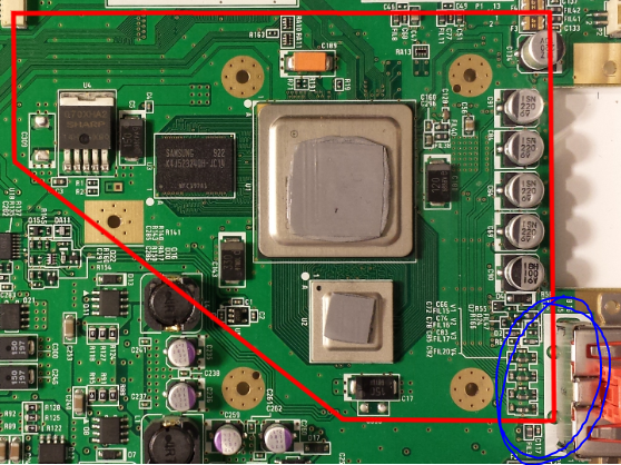

Alright. Yeah I've stocked up on a litre of IPA but unfortunately I think my cutting blades are too wide to cut off the AV-port. If you look at the trim guide the margin is basically non-existant. So I would need a really thin blade and the one I'm using is like 1,5mm. I did however cut off the mx-chip and the GC ports without any issues. Here's a pic of what I mean about the margin:
