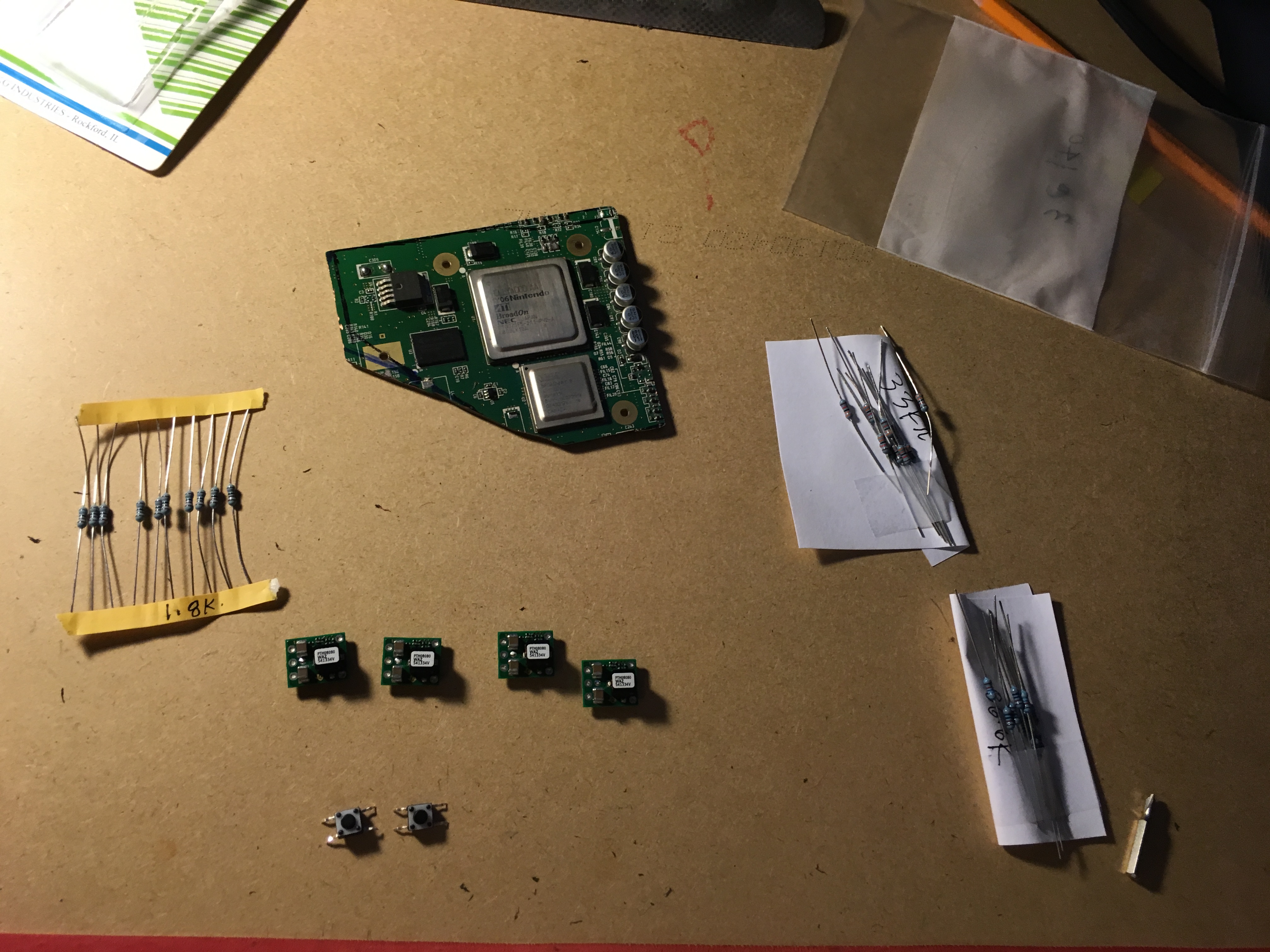

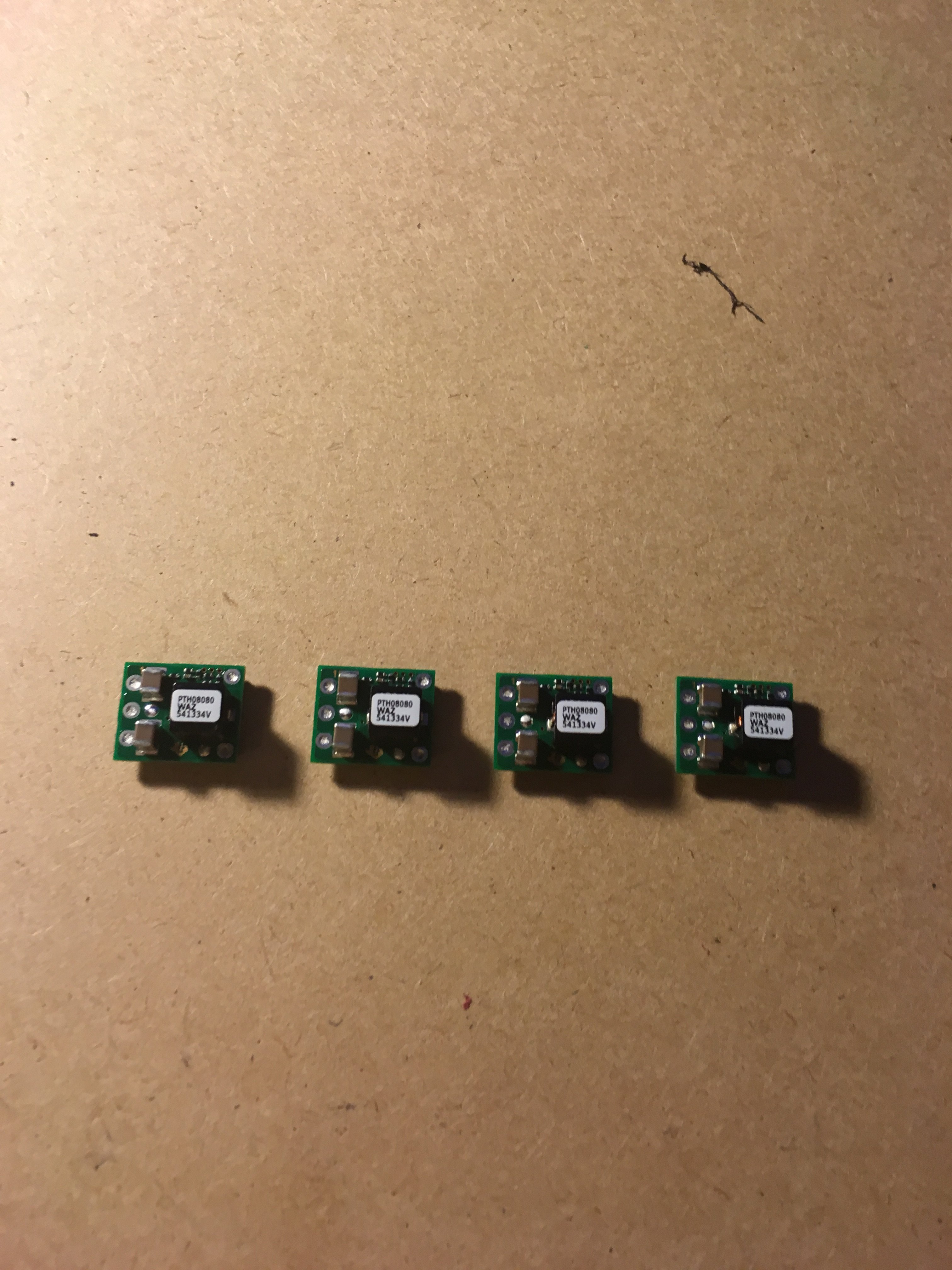

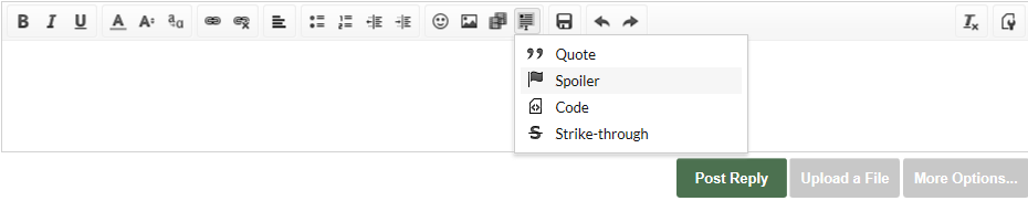

UPDATE: Custom regulators came in, ordering tact switches, flip switches, resistors and compactors. Does anyone know how to do spoilers? Lol.
Got stuff from jk electronicsB|
I could dream my wii portable could be like this
