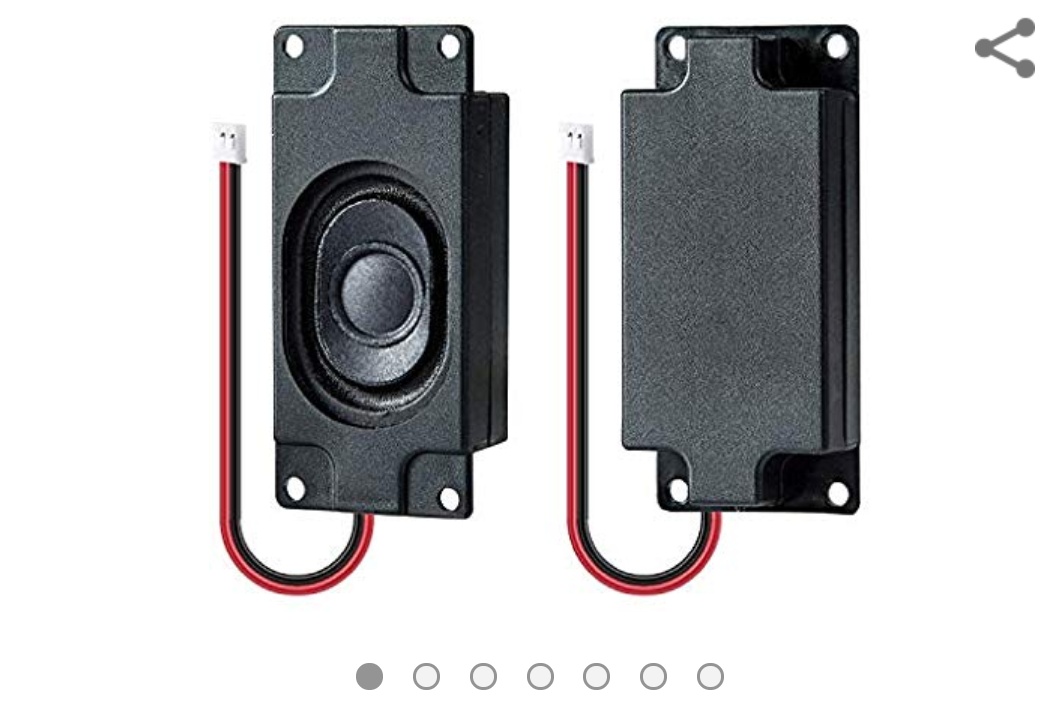

So I wired up these mini speakers but they sound static I'm not sure if it's them or the amp I'm using any ideas?
This is the amp I'm using pretty basic
Static with speaker is usually a ground problem. Make sure you have a proper ground and if it still has static use insulated wire (as opposed to magnet wire that is just coated).
Edit: I used that same amp on my Wii Laptop and didn’t have static issues so I doubt it’s the amp itself.
