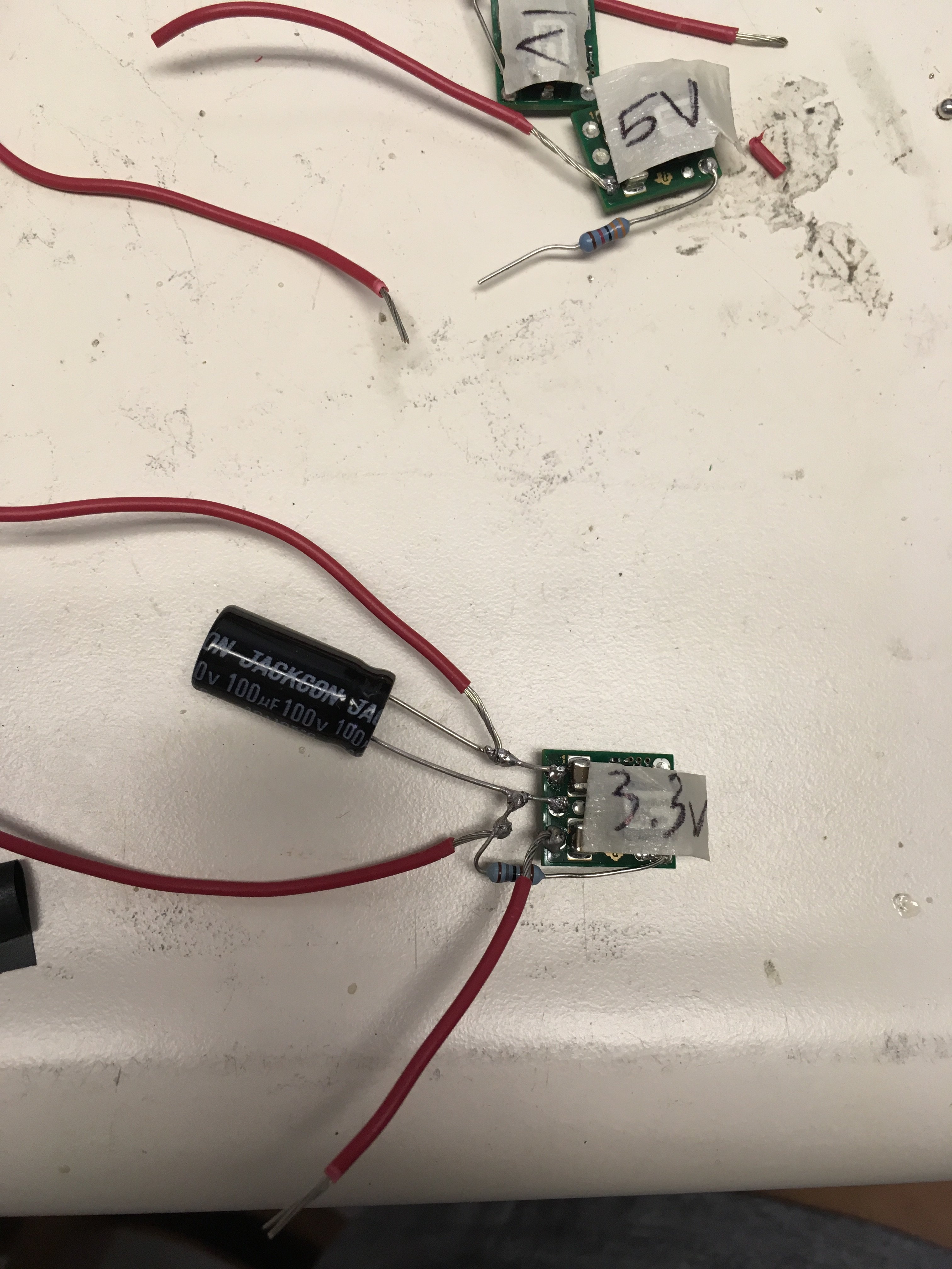

To answer your question, yes that will work. Just has to be 100uF with a voltage rating greater than your input voltage.

This is going to be a pretty long worklog due to school getting in the damn way, so finished one regulator by using this guidehttps://bitbuilt.net/forums/index.php?threads/resistors-for-custom-regulators.1078/
There's only 3 more to go
I would recommend trimming the legs of that capacitor to reduce size and prevent any unwanted contact with other things. If you're concerned about having a spot to solder to, you can solder to the big SMD capacitors on the regulator. See gman's regulators on his Wii portables for good examples.

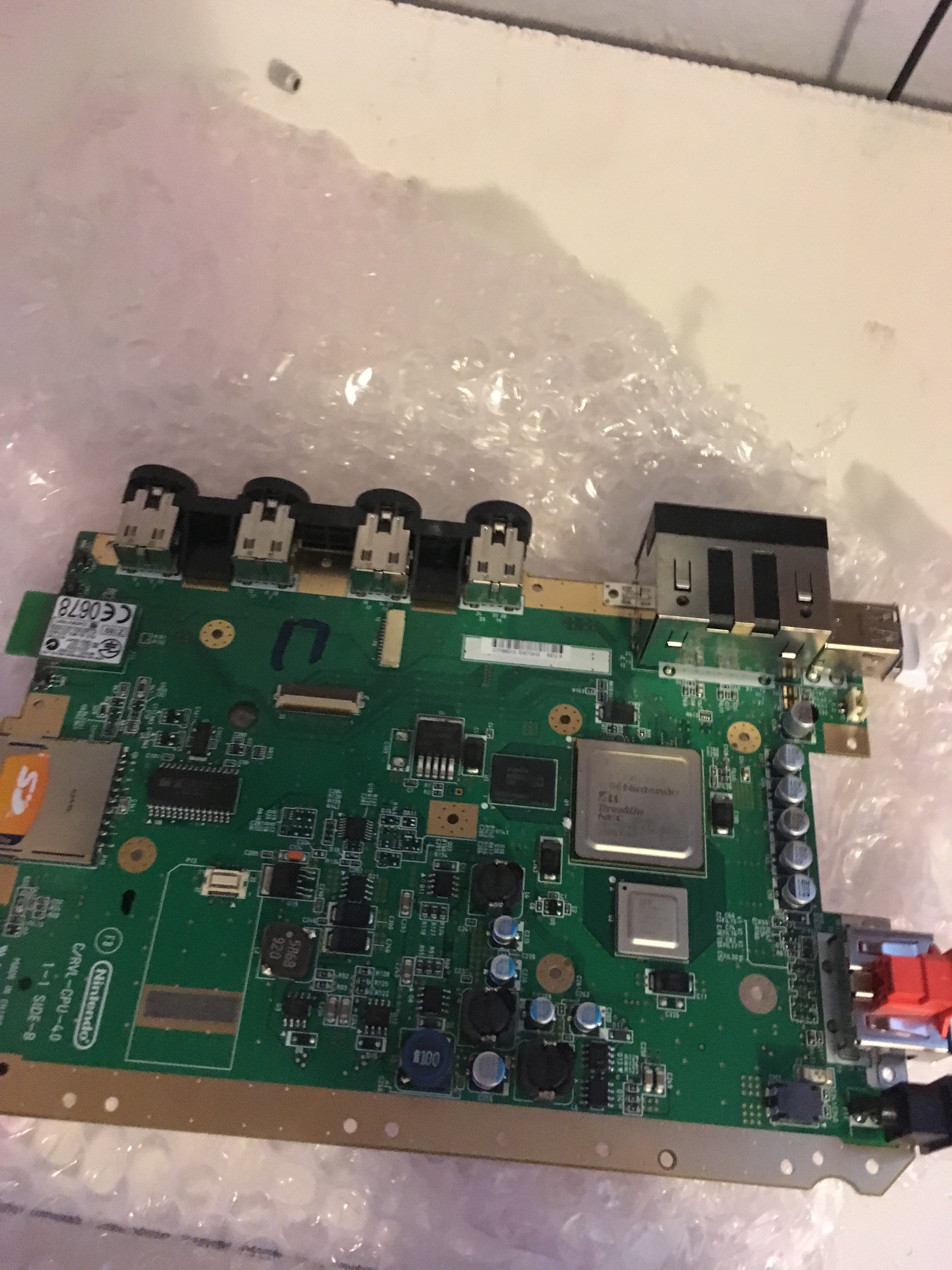

Got a new Wii the one I had was dead Oh well... got a four layer board this time just waiting on the wifi module which will be coming on Friday or earlier..

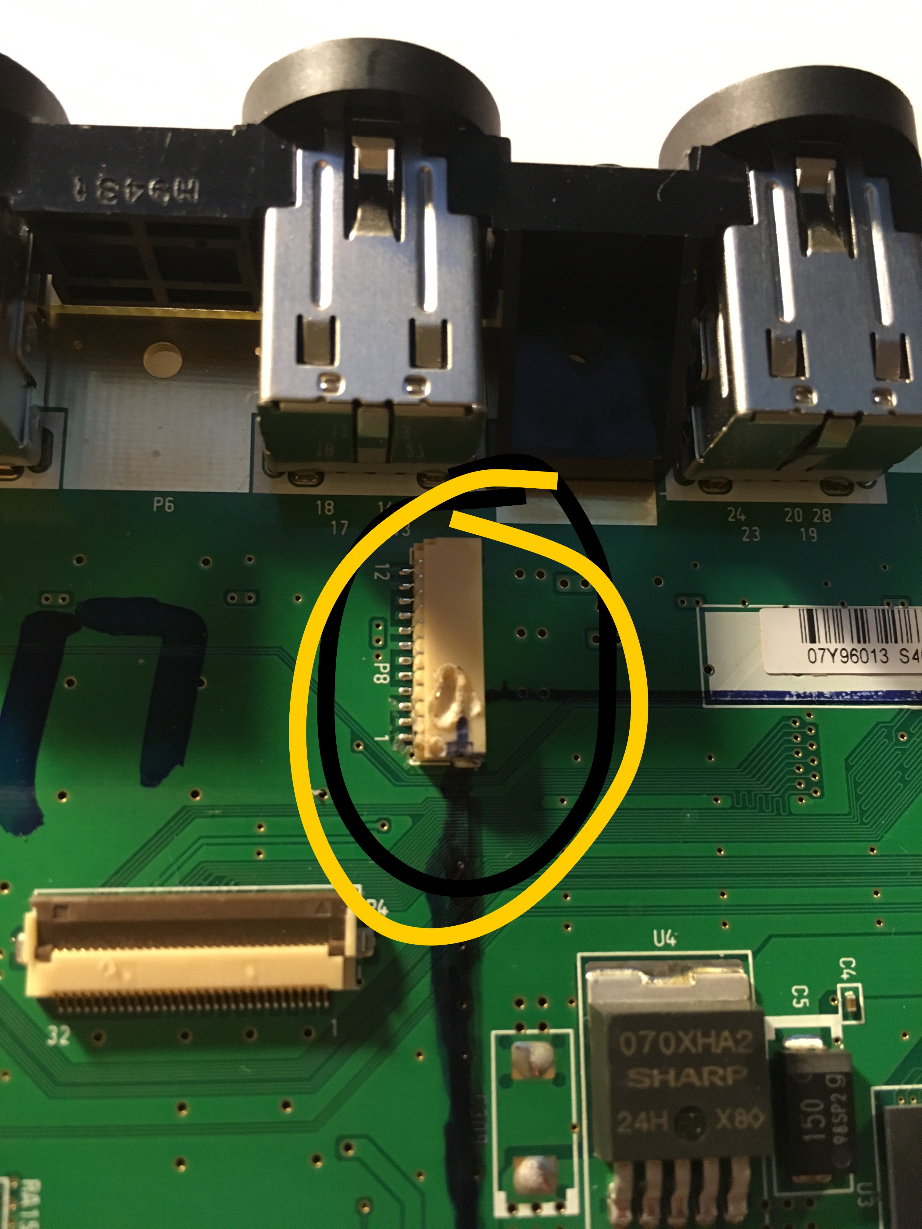

Hi, does anyone know how to remove this? Because it's in the way of the trim...
if you really want to remove it properly though, you can just lay the tip of your iron across the pins and pull it off or just break it off
I recommend dremelling through it. You can pull it off if you want, or put a huge ball of solder across the pins so they all heat up at once.

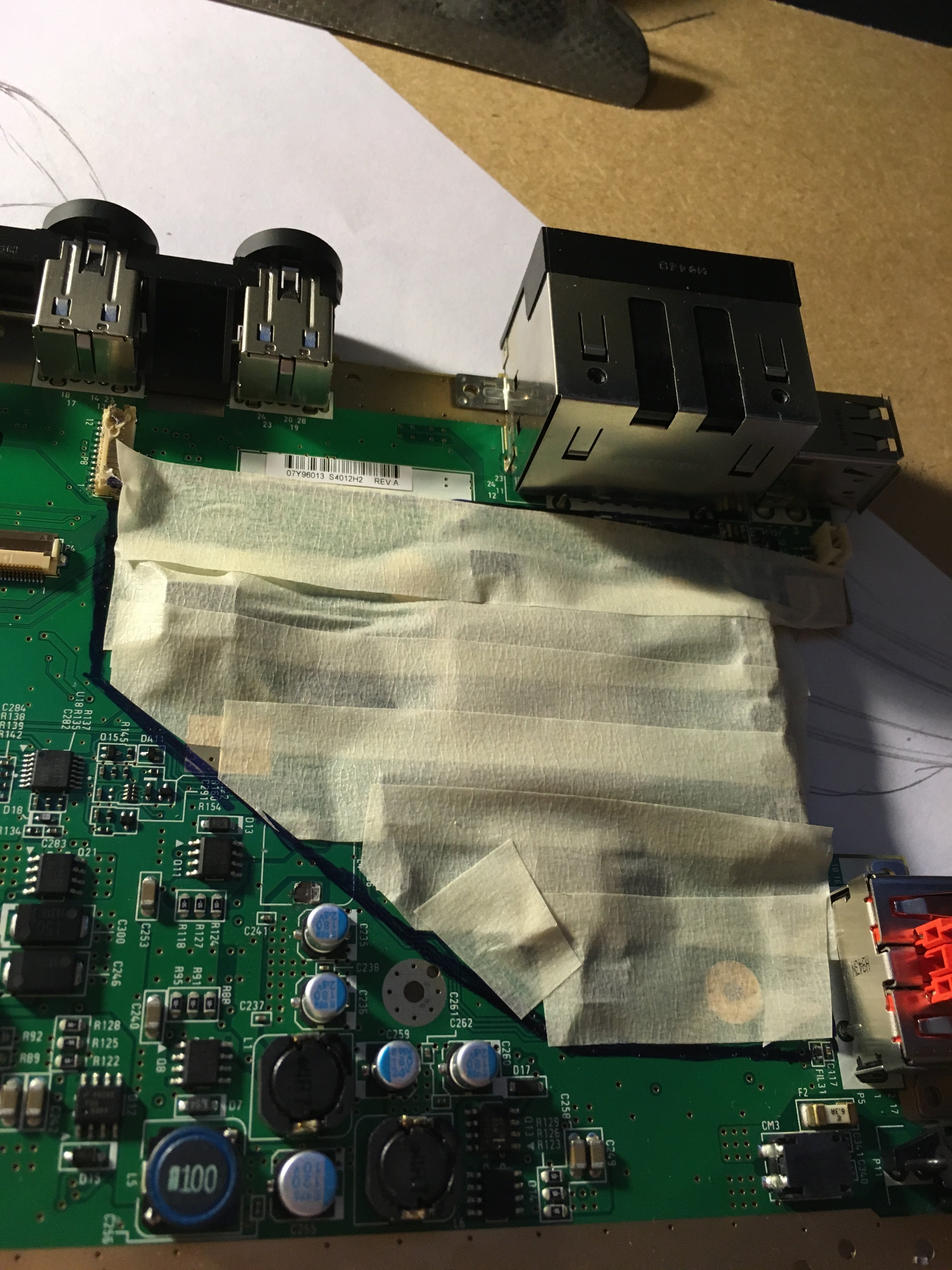

The glorious tape..
