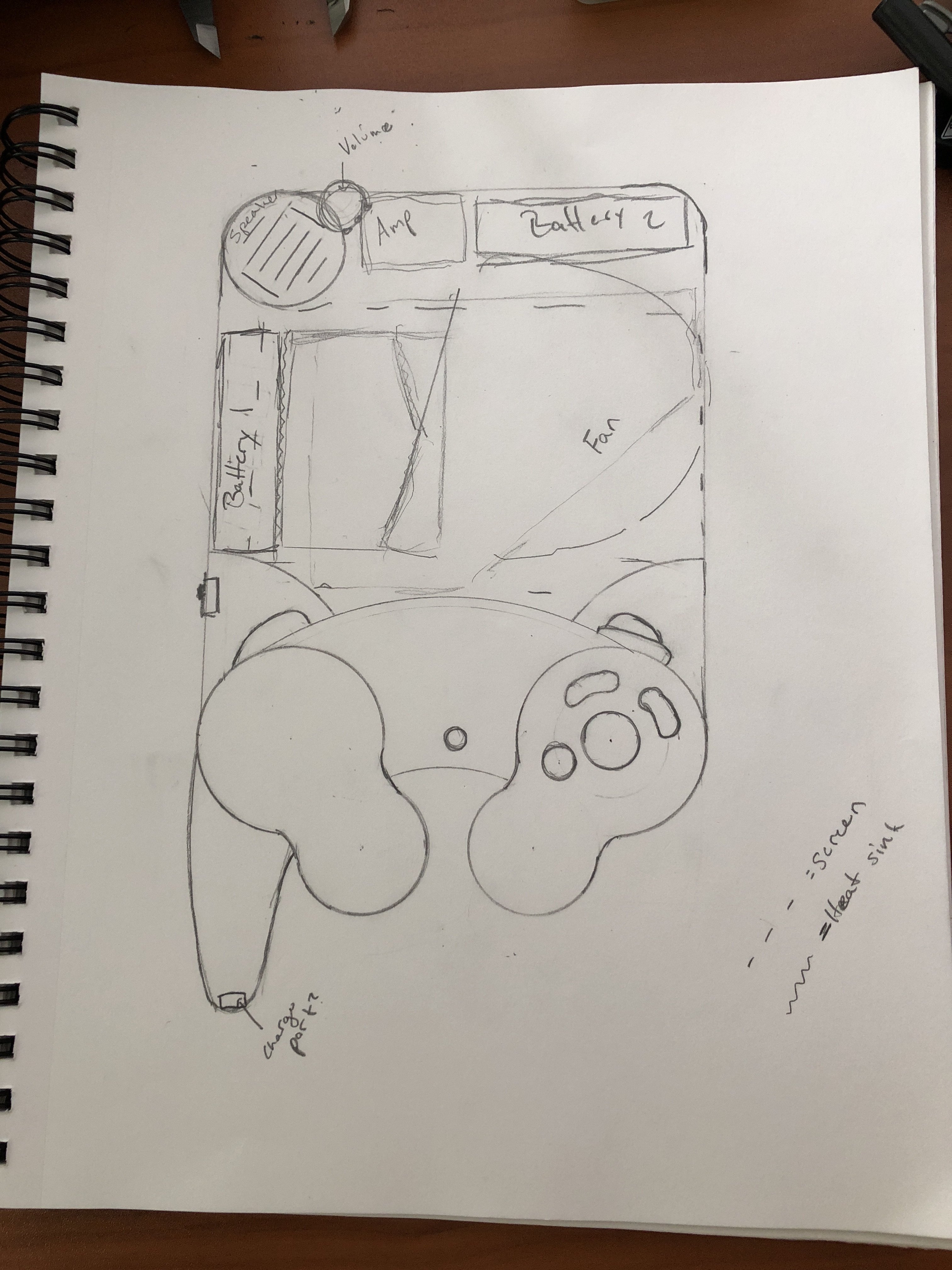

So its been a while since I've done anything on this project, and I'm trying to get back into it. I've got a bit of an idea for how I'd like the case to be, and was wondering how likely it would be to work. Id like to use a standard gamecube controller, and then vacuum form another portion to house the wii, batteries, the screen, and any other components and frankencase them together.
This is a really rough concept of what I’d like to do. The top would be joined with a large area of the controller, allowing for a hopefully stronger bond than I could get with just an edge. The z button will probably be moved to the right leg of the controller to make room for a better connection between the two housings.
