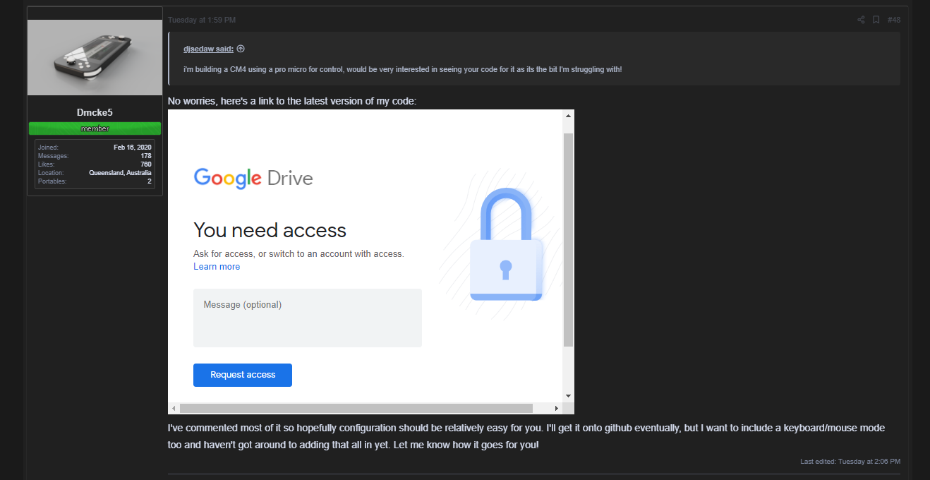

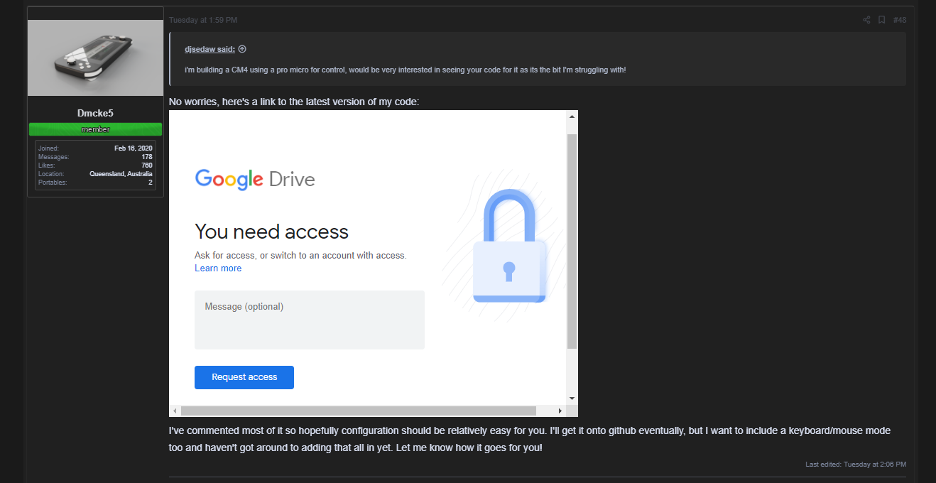

No worries, here's a link to the latest version of my code:
I've commented most of it so hopefully configuration should be relatively easy for you. I'll get it onto github eventually, but I want to include a keyboard/mouse mode too and haven't got around to adding that all in yet. Let me know how it goes for you!

Looks like access is restricted. You may wanna tweak the settings
That's odd, I'm sure I set it to "anyone with link" mode. I've updated the settings and tried again with a fresh link, hopefully that fixed it.

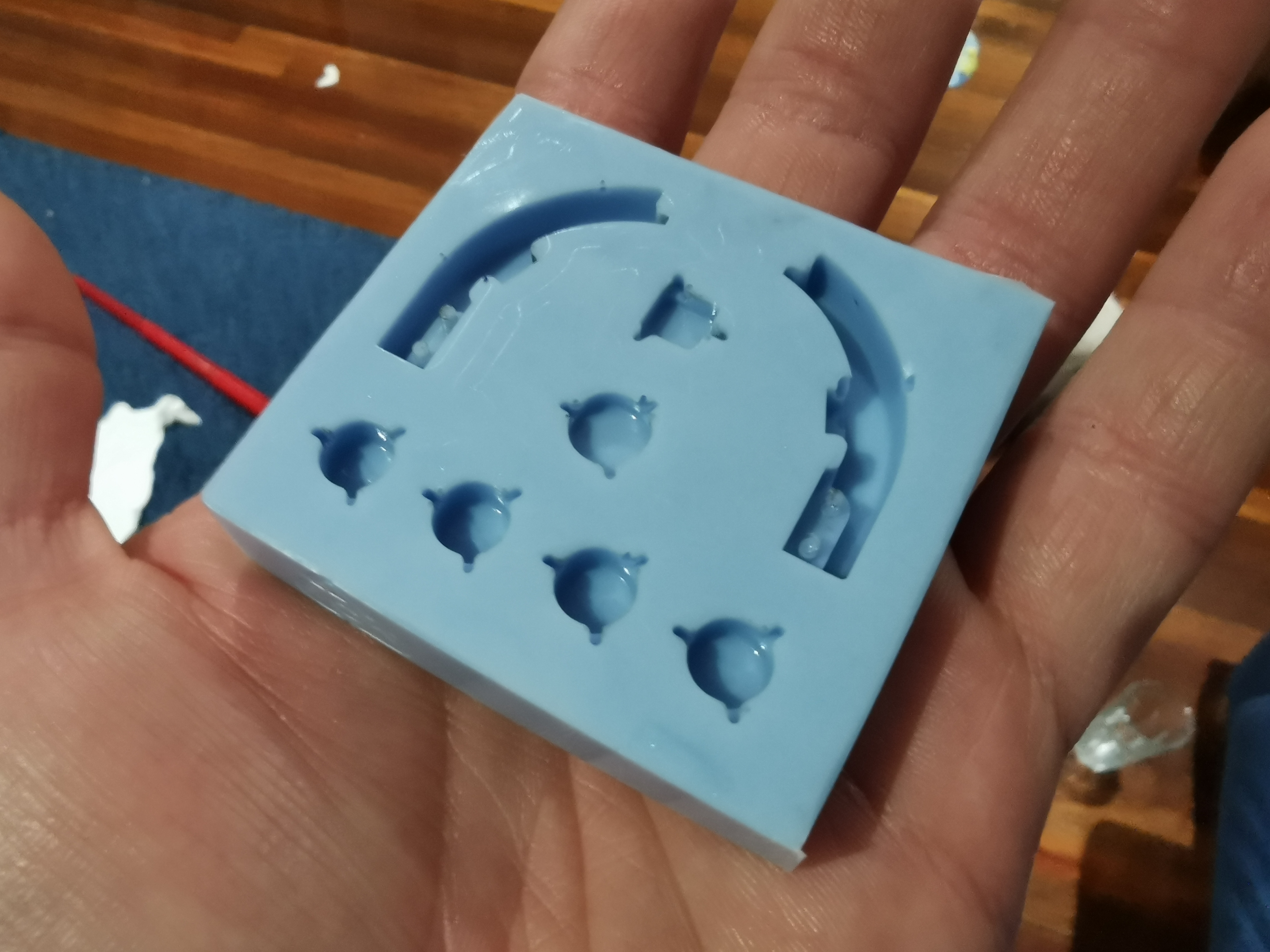

Completed the first of the button molds last night. Came out pretty well, couple of little bubbles in some of the corners but not too bad considering I don't have a vacuum chamber yet. All of them should be easy enough to clean up with an exacto knife when the buttons come out of the molds.
Next up will be molds for the lower trigger buttons and the D-pad. I decided to make them separately as they are much more complex to mold than these buttons. I'm still unsure if I'll make the D-pad as a two part mold or try and make a single mold and then split it by hand. Either way I need to actually make some positives of the buttons first so I've got a bit more time to think about it first.

Yeah we are getting there. Stoned and I both have some other stuff going on keeping us from working on this as much as we would like but progress is being made slowly. I did get a successful batch of buttons out of the mold but haven't had a chance to take any good photos yet. Still have to make molds for the D-Pad and lower trigger buttons.

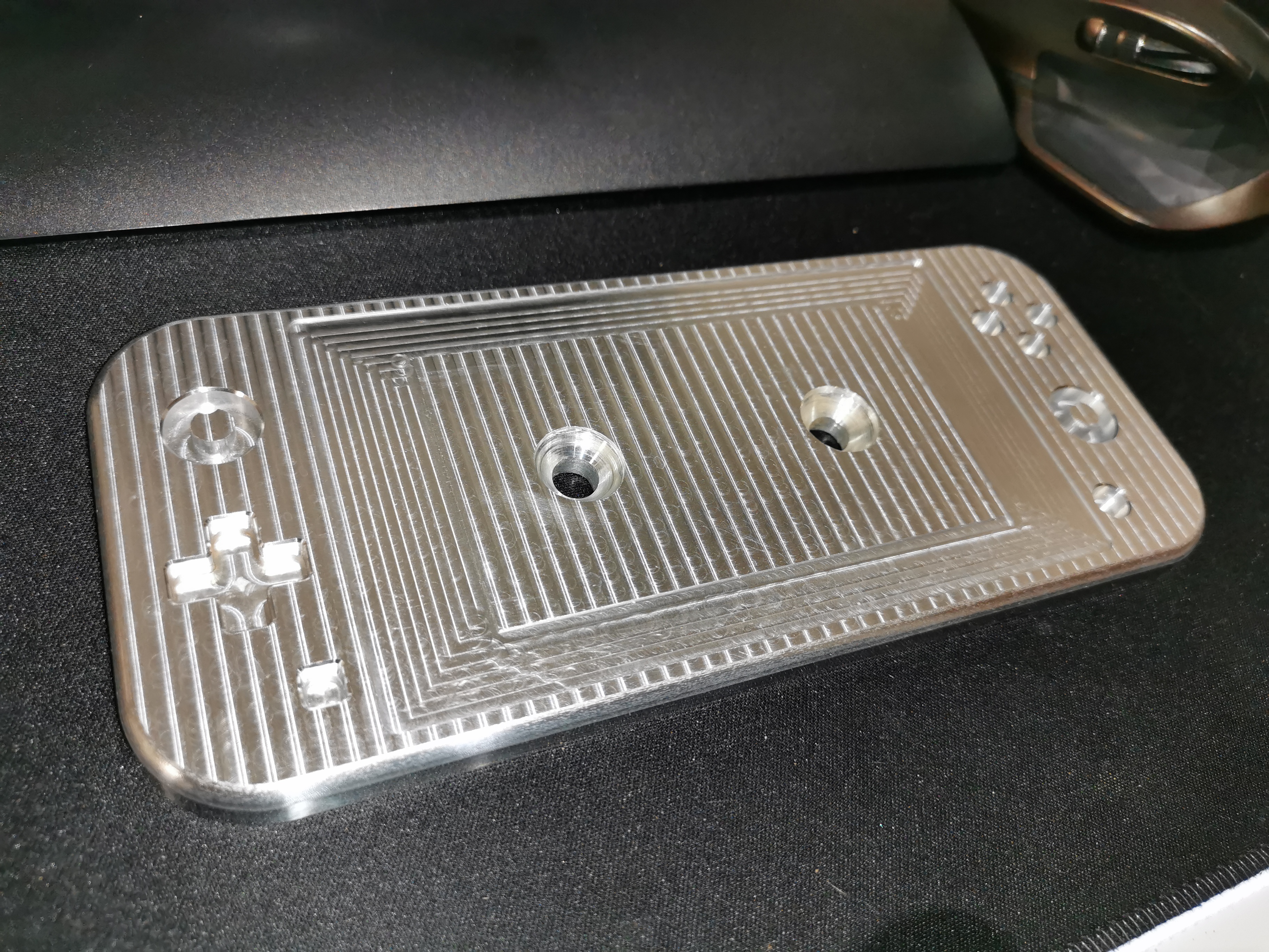

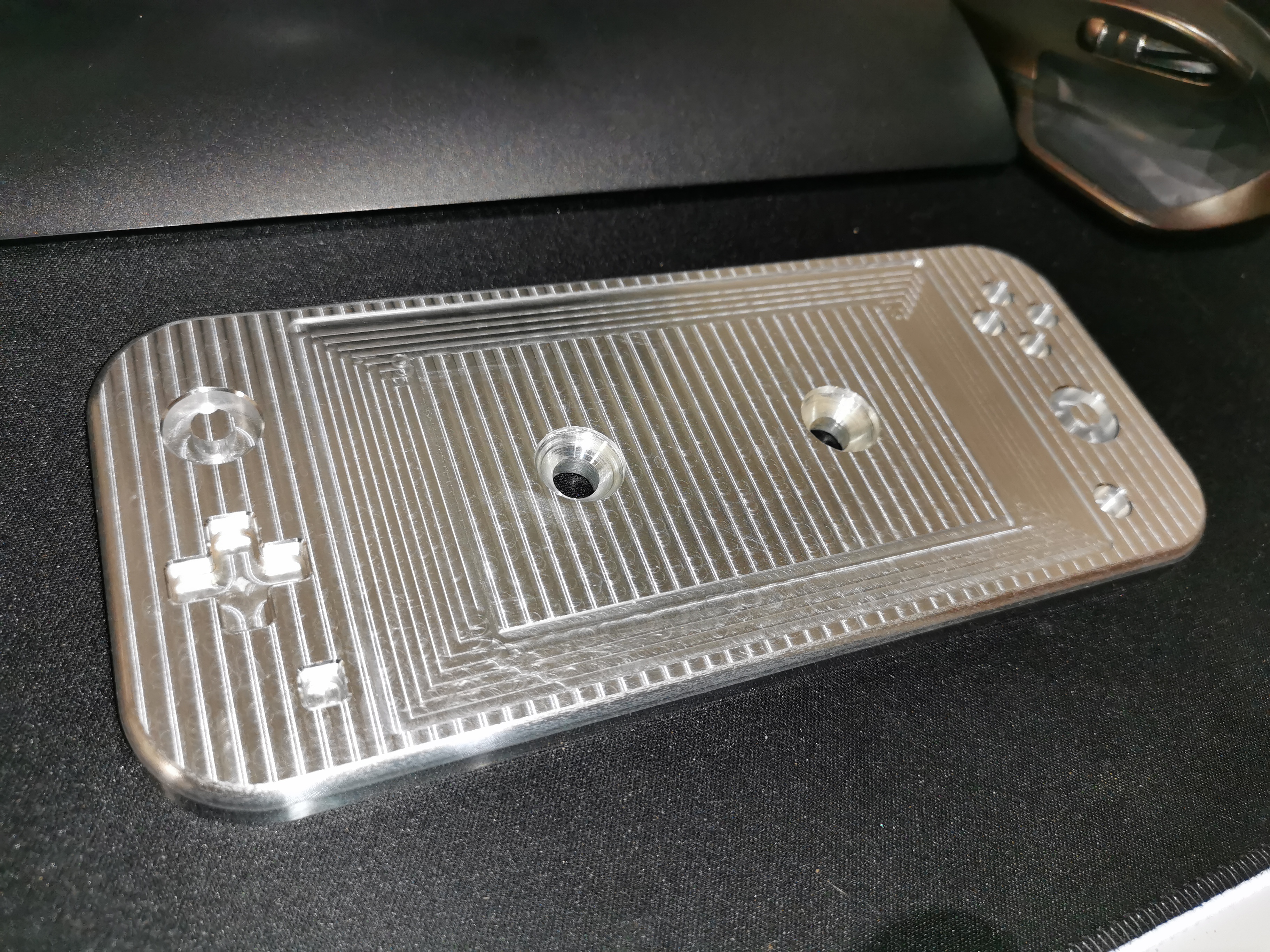

First bit of actual progress! Outside of the first of the two front housings completed. I'm going to run the second one today before I move onto the insides. Extremely happy with the results so far, this 6061 aluminium is much nicer to machine than the 5083 that I usually use. Can't wait to see some complete parts!
Oooo I like where this is going. Can't wait to see some more.

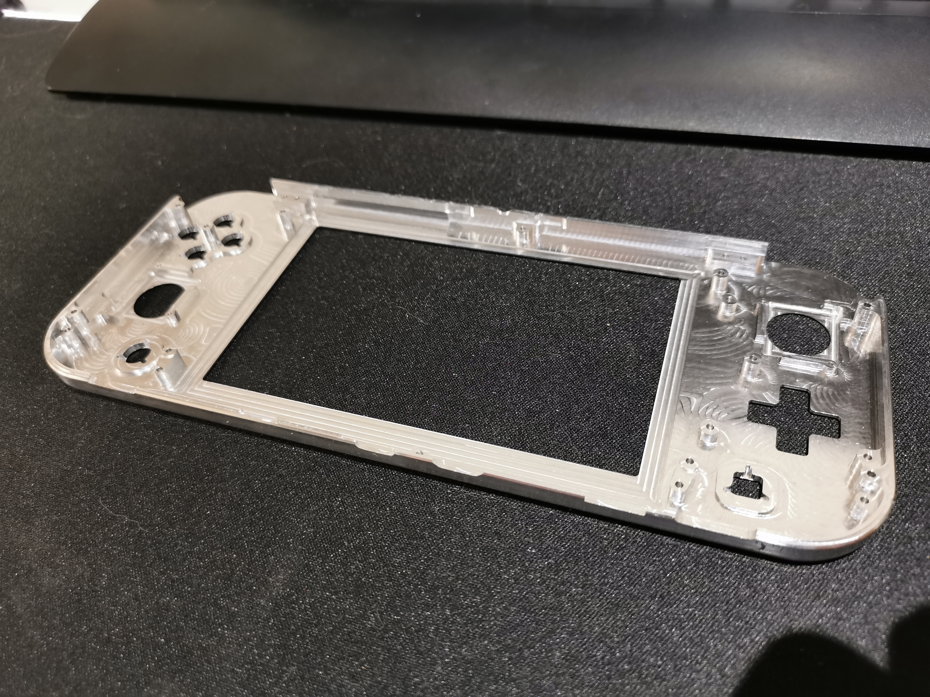

Inside of #1 complete! Still got some holes to add in the top for power/volume buttons, headphone jack and cooling but that will be done with both halves assembled and mounted side on in my machine once the other half is ready.
