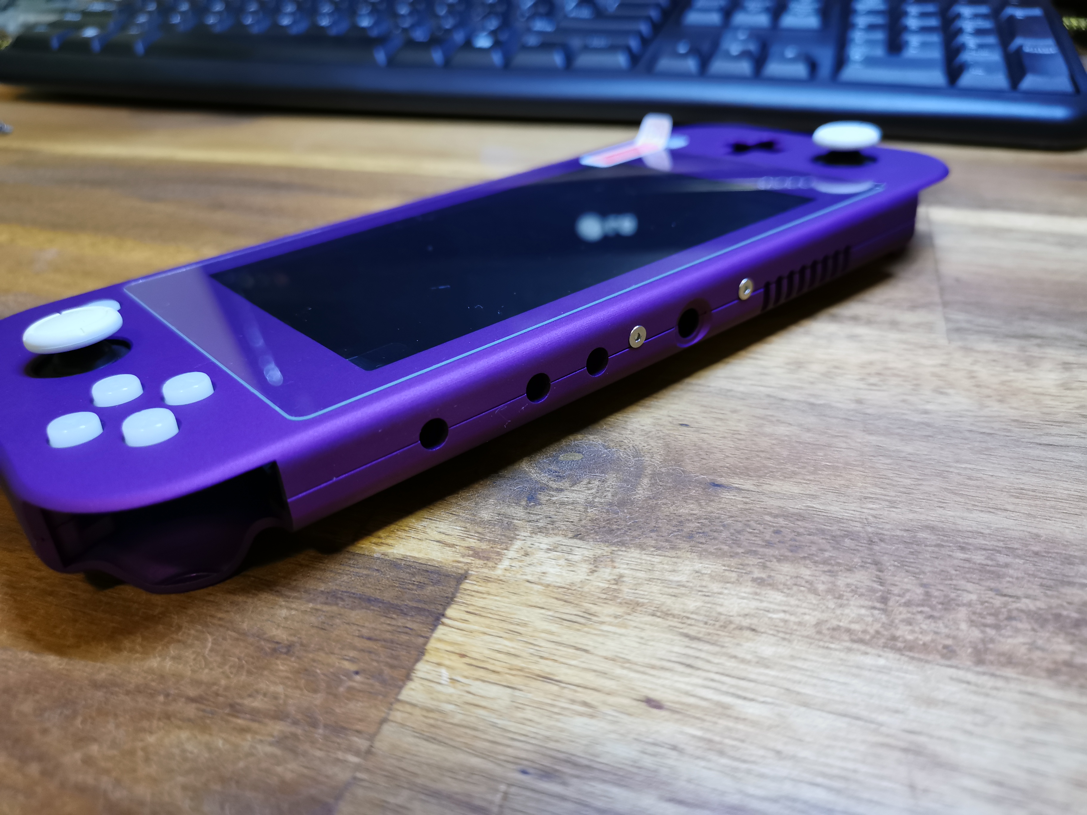

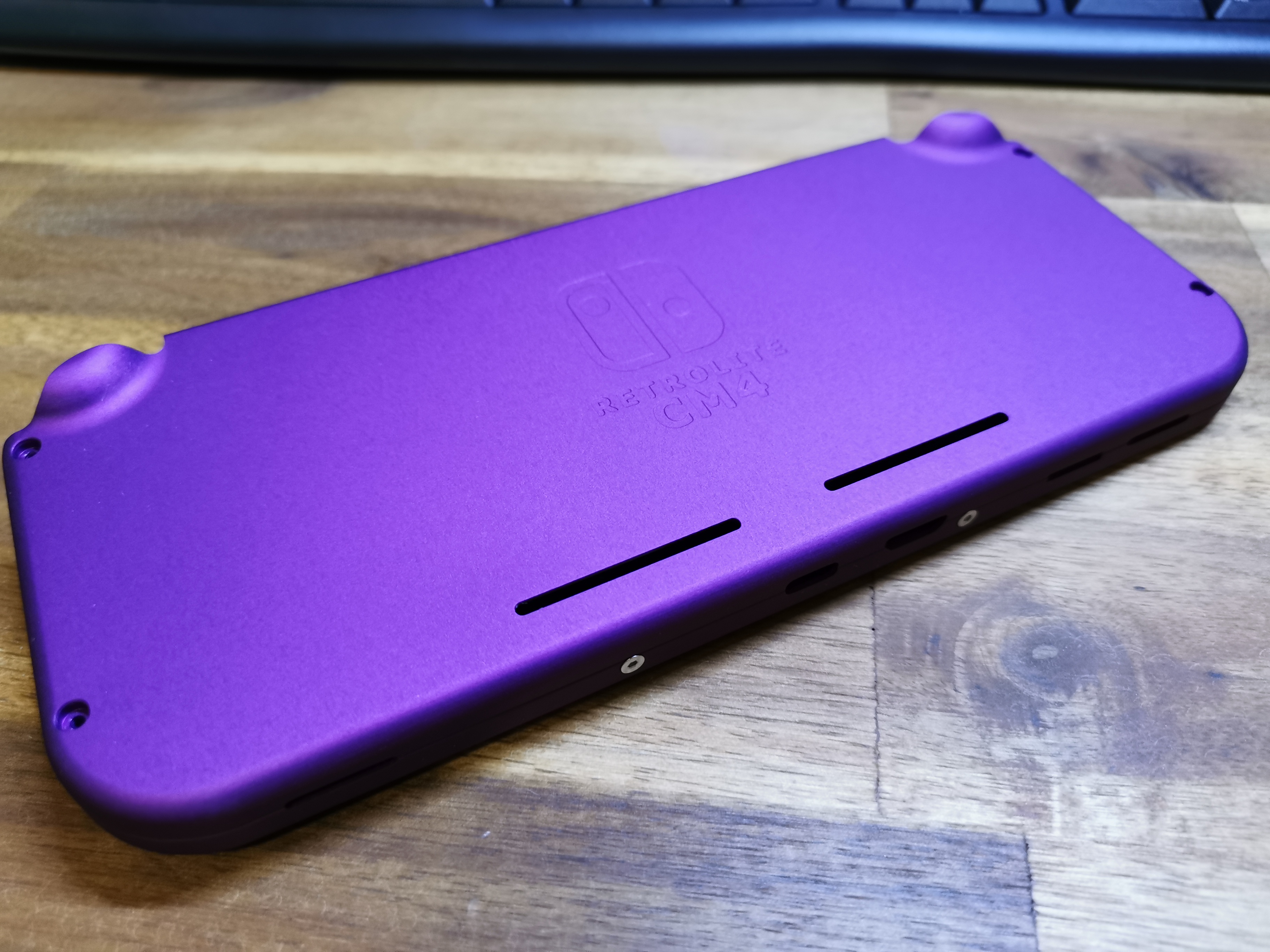

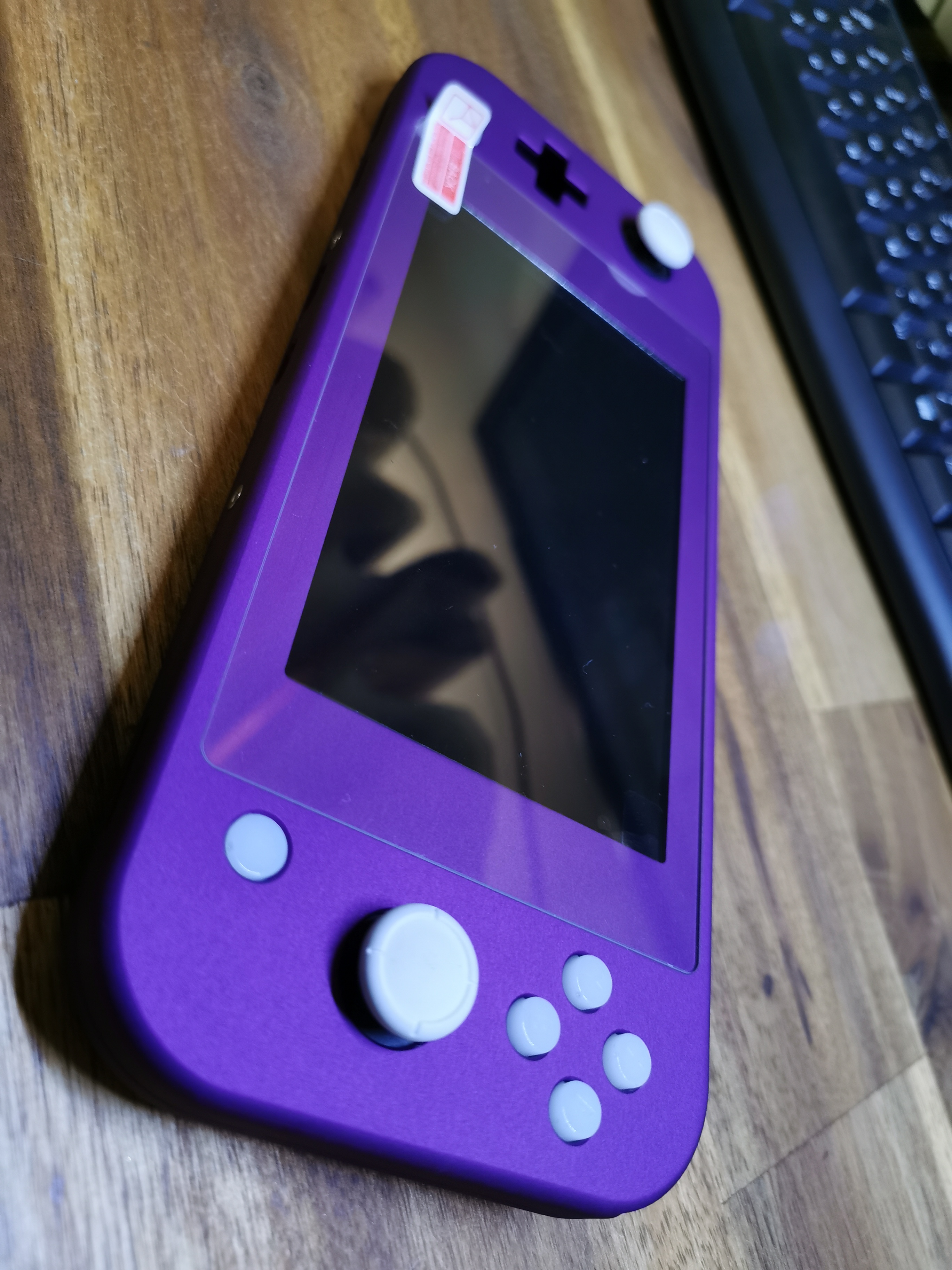

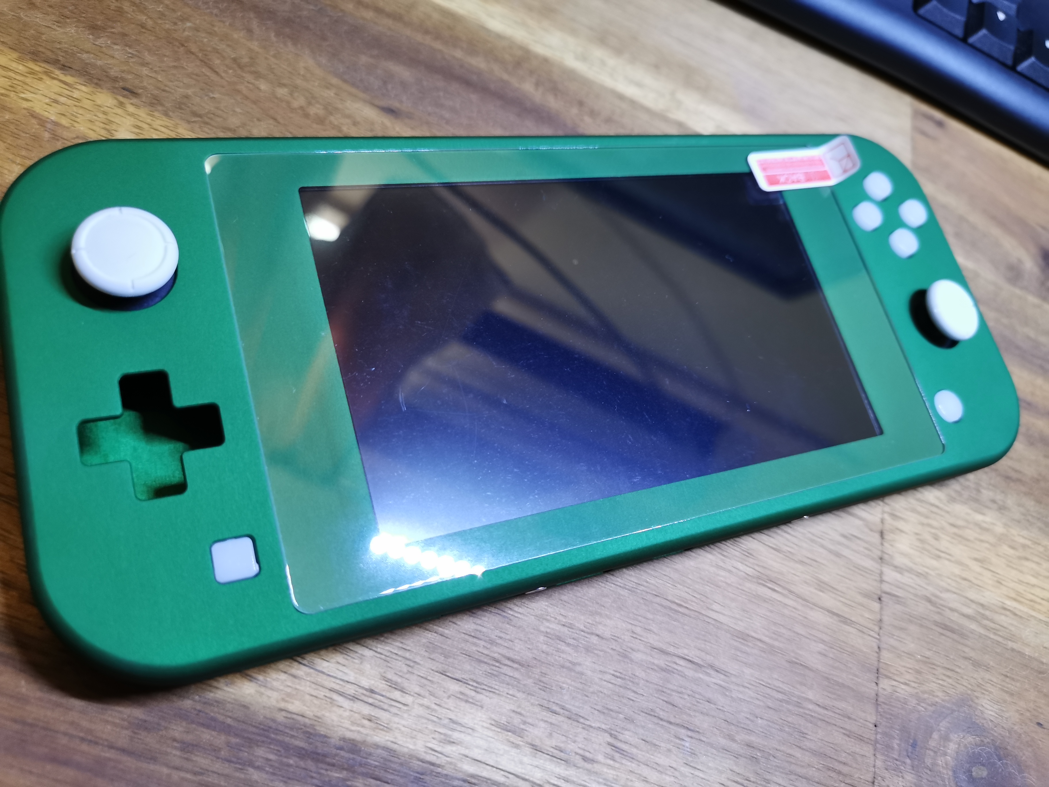

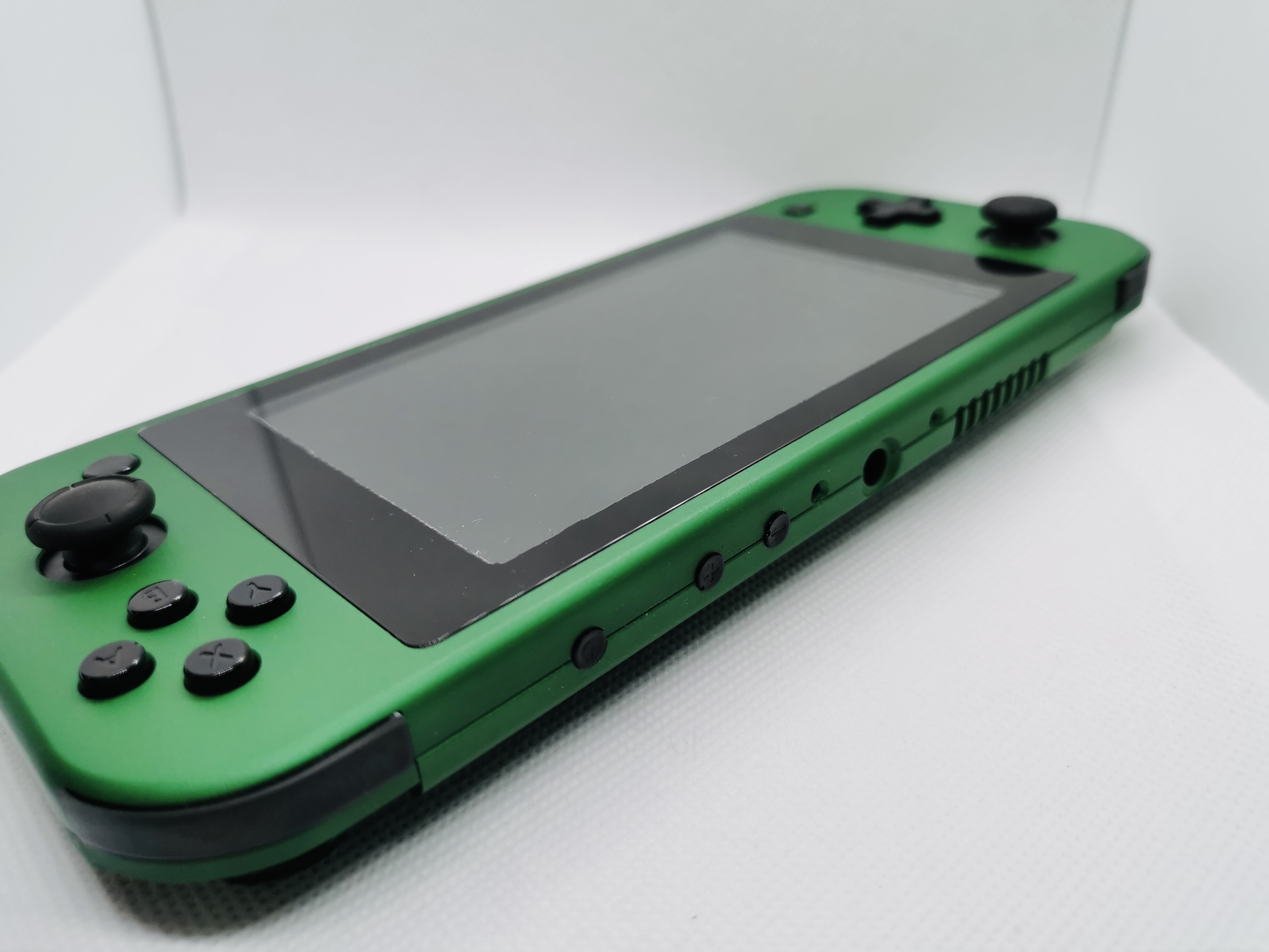

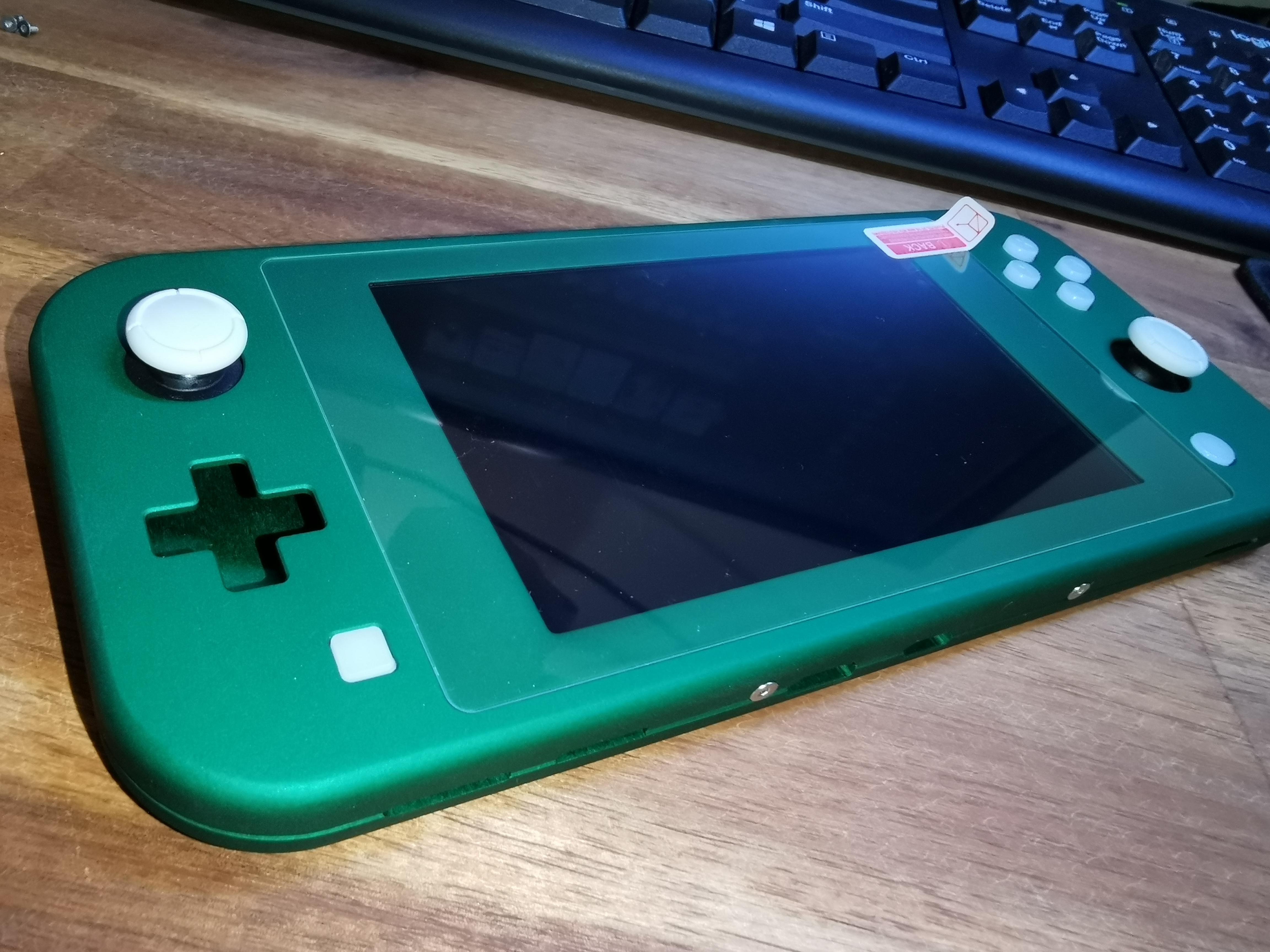

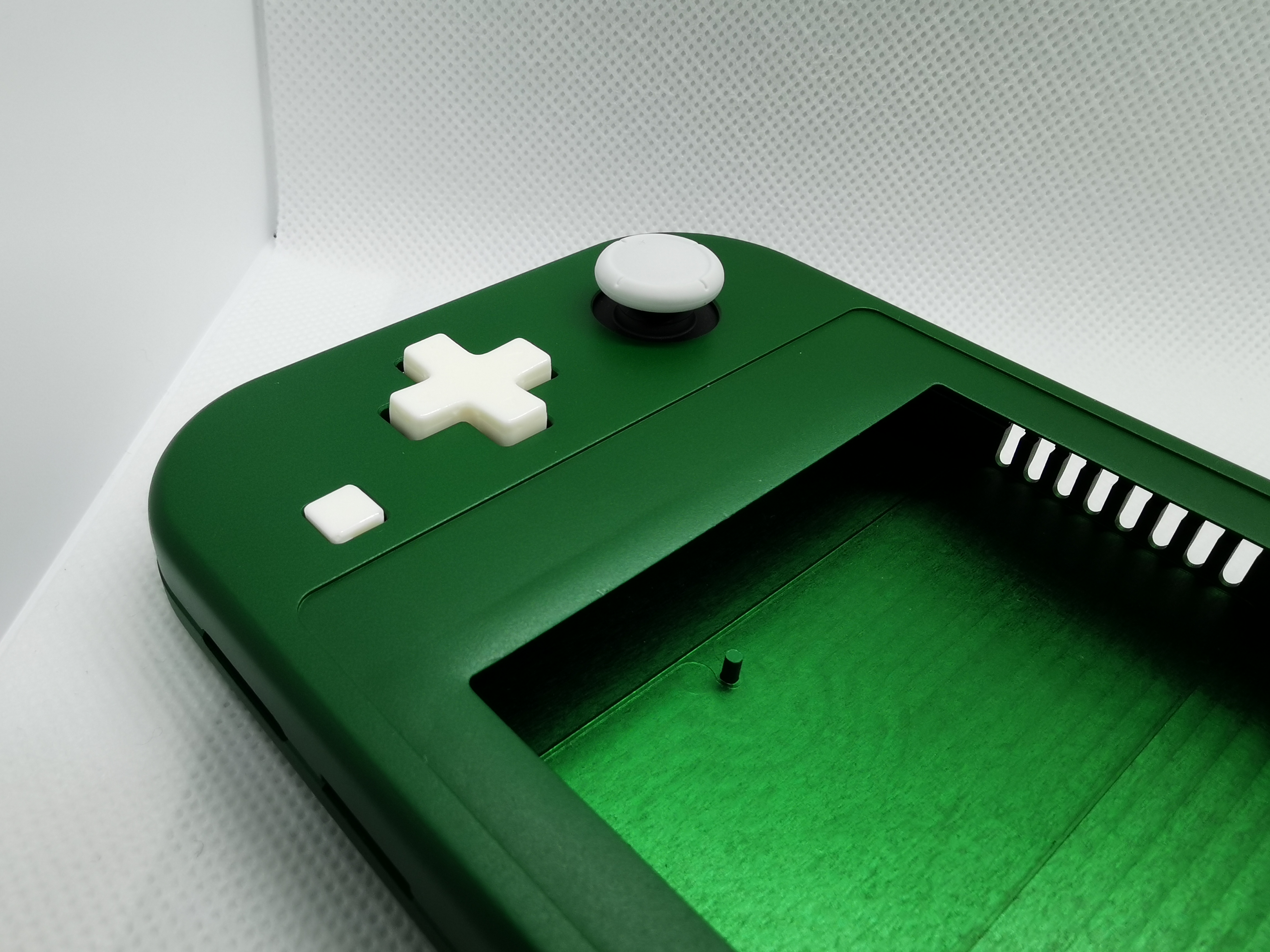

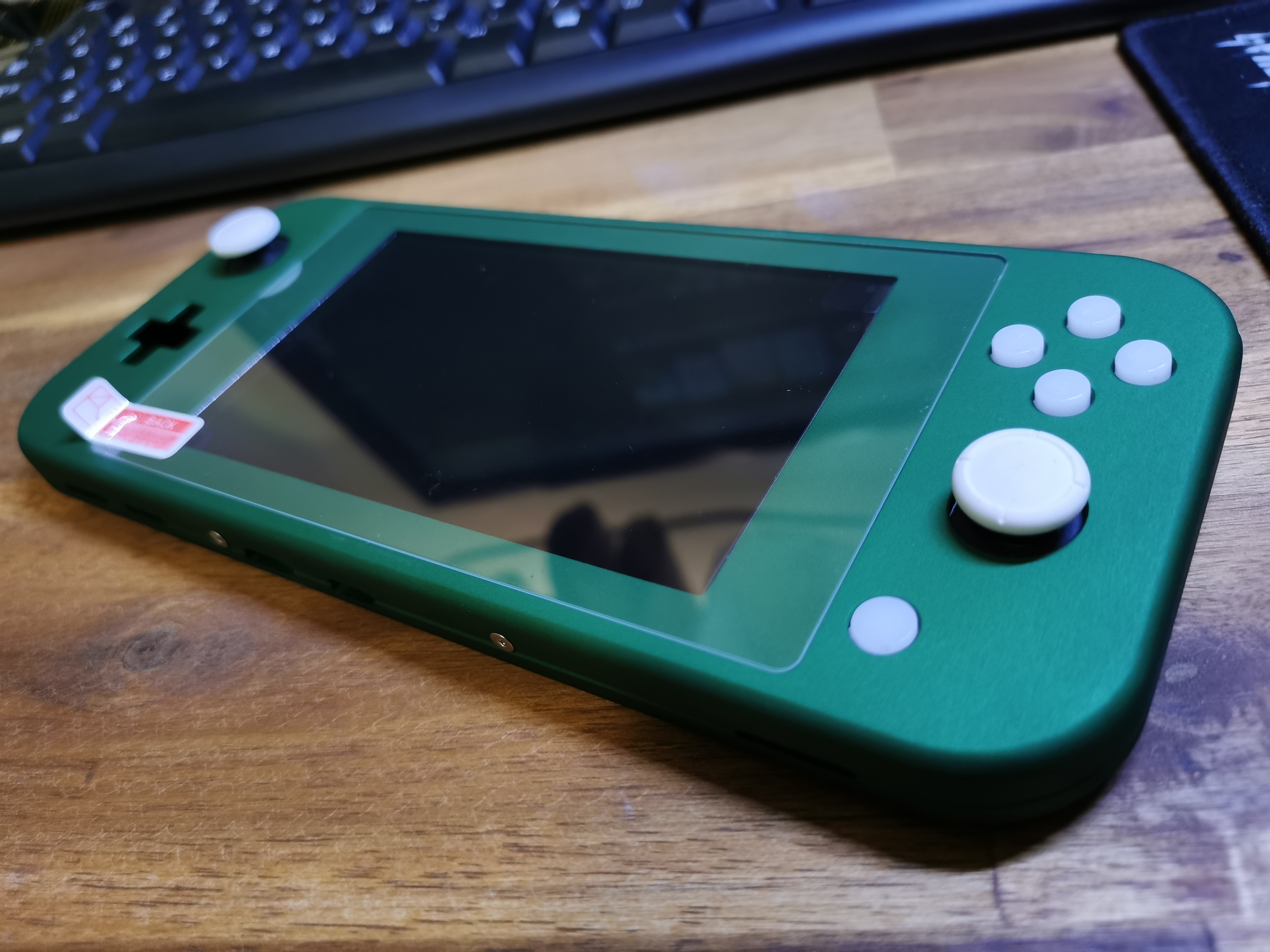

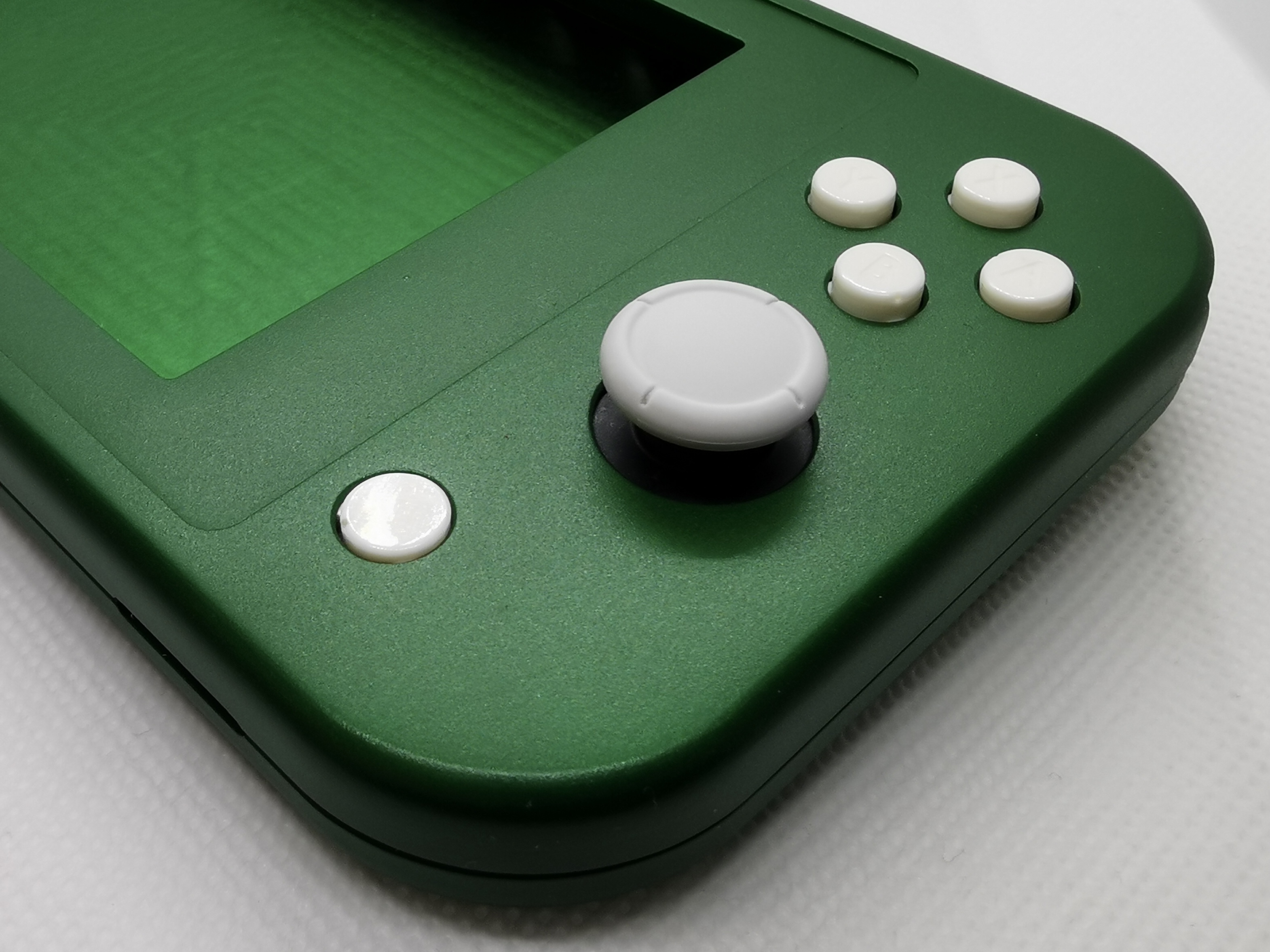

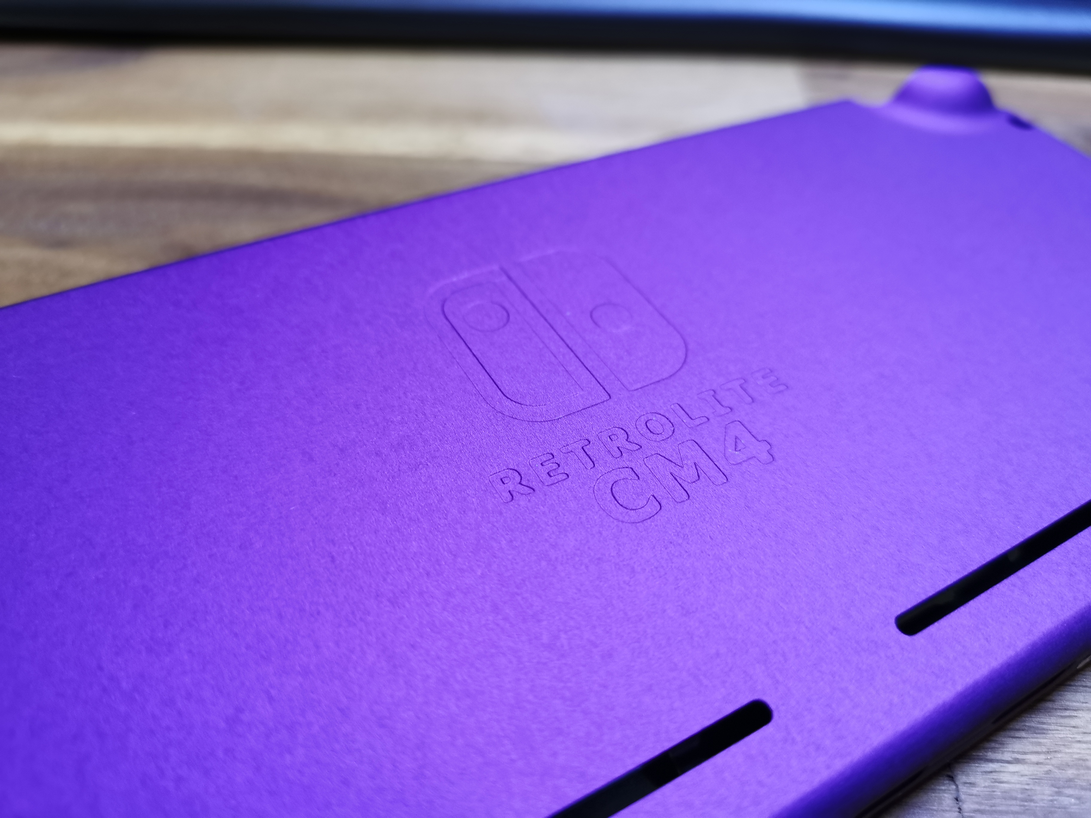

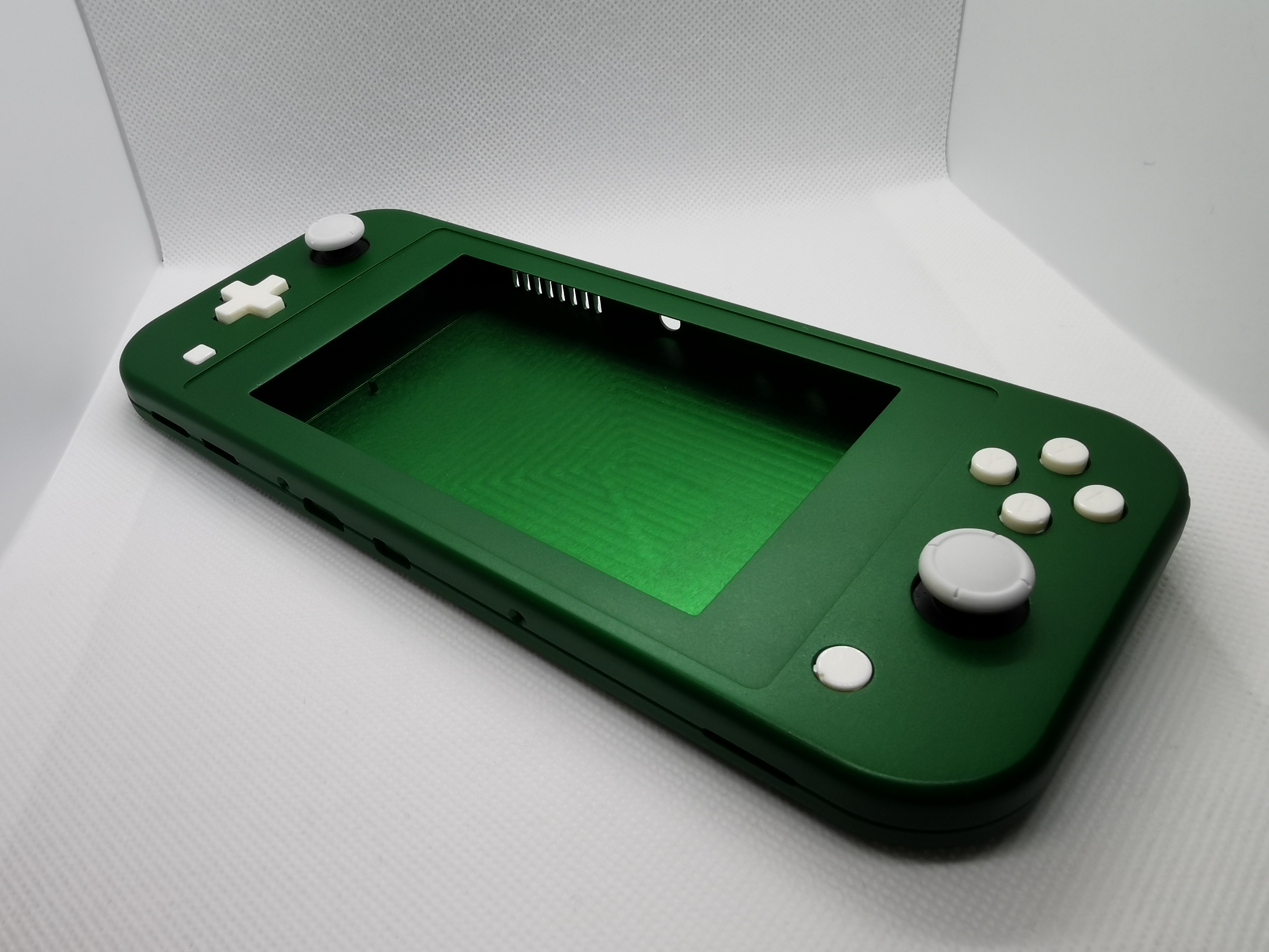

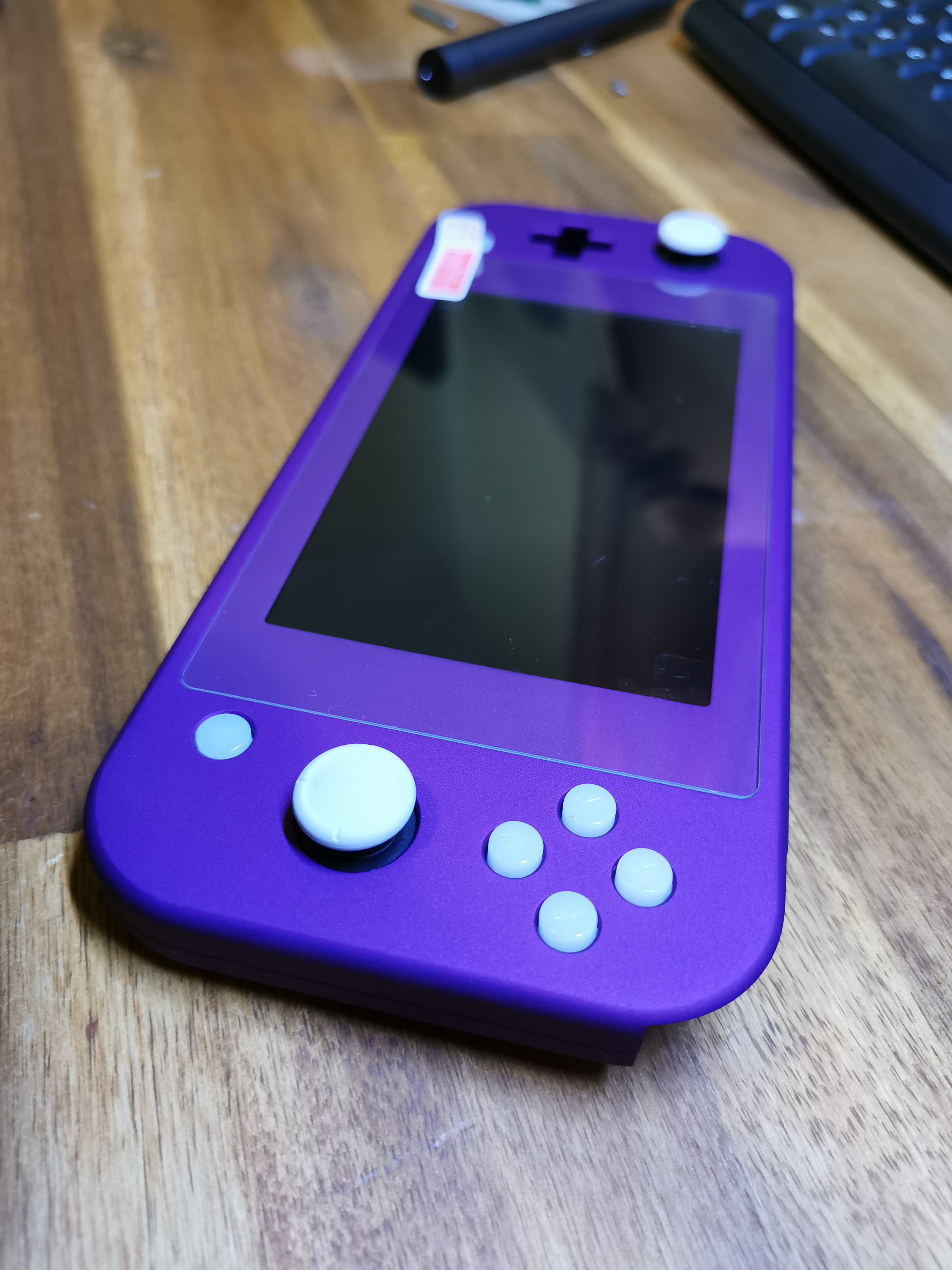

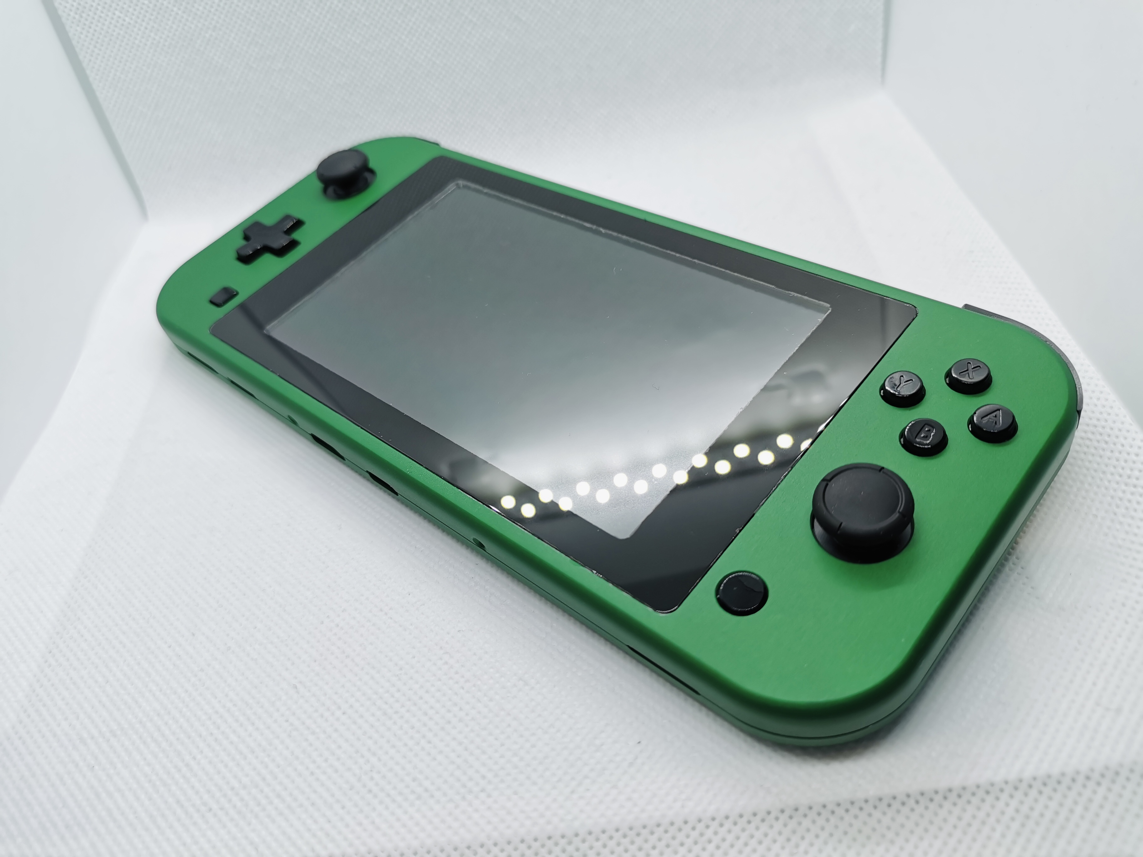

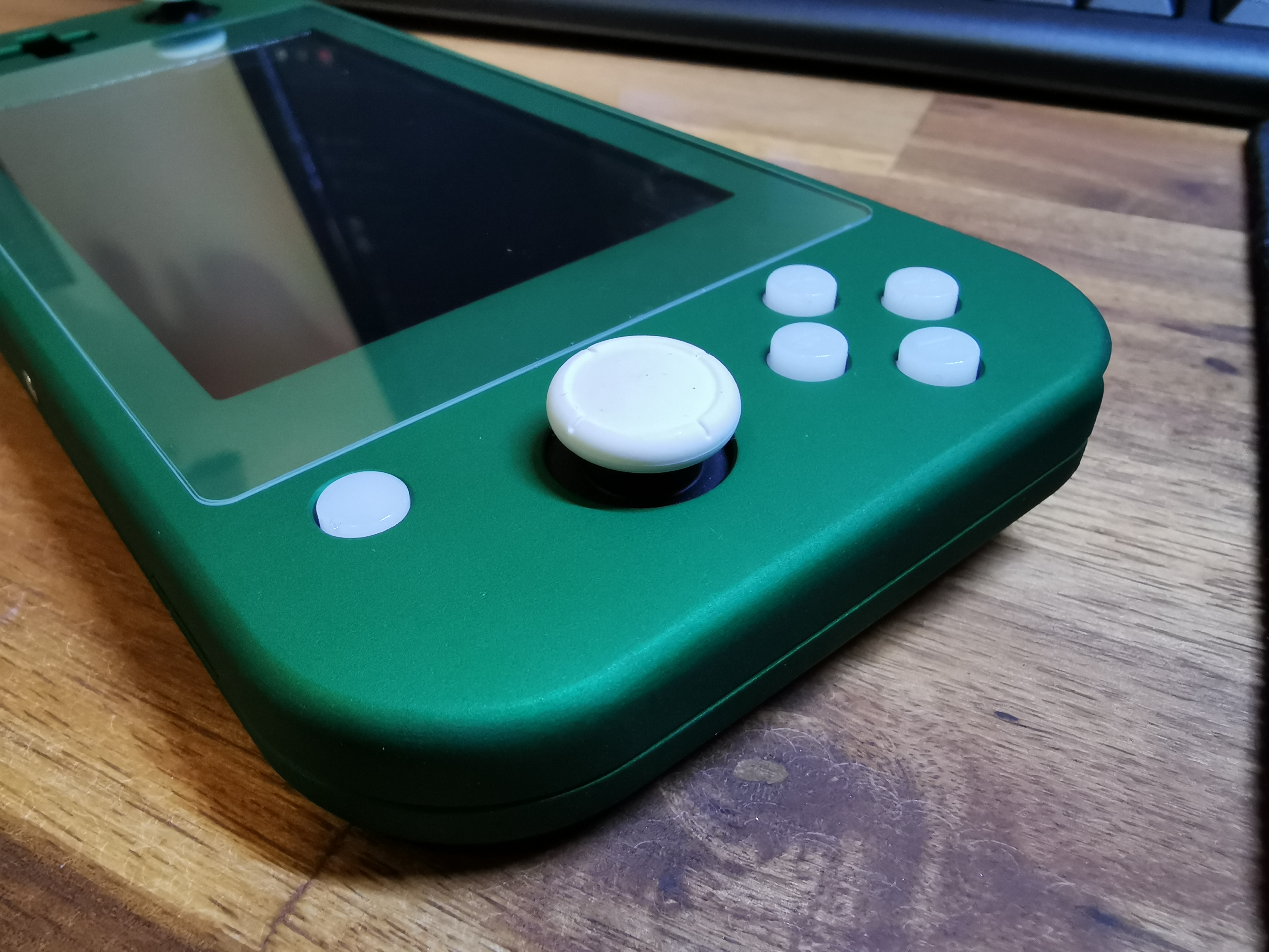

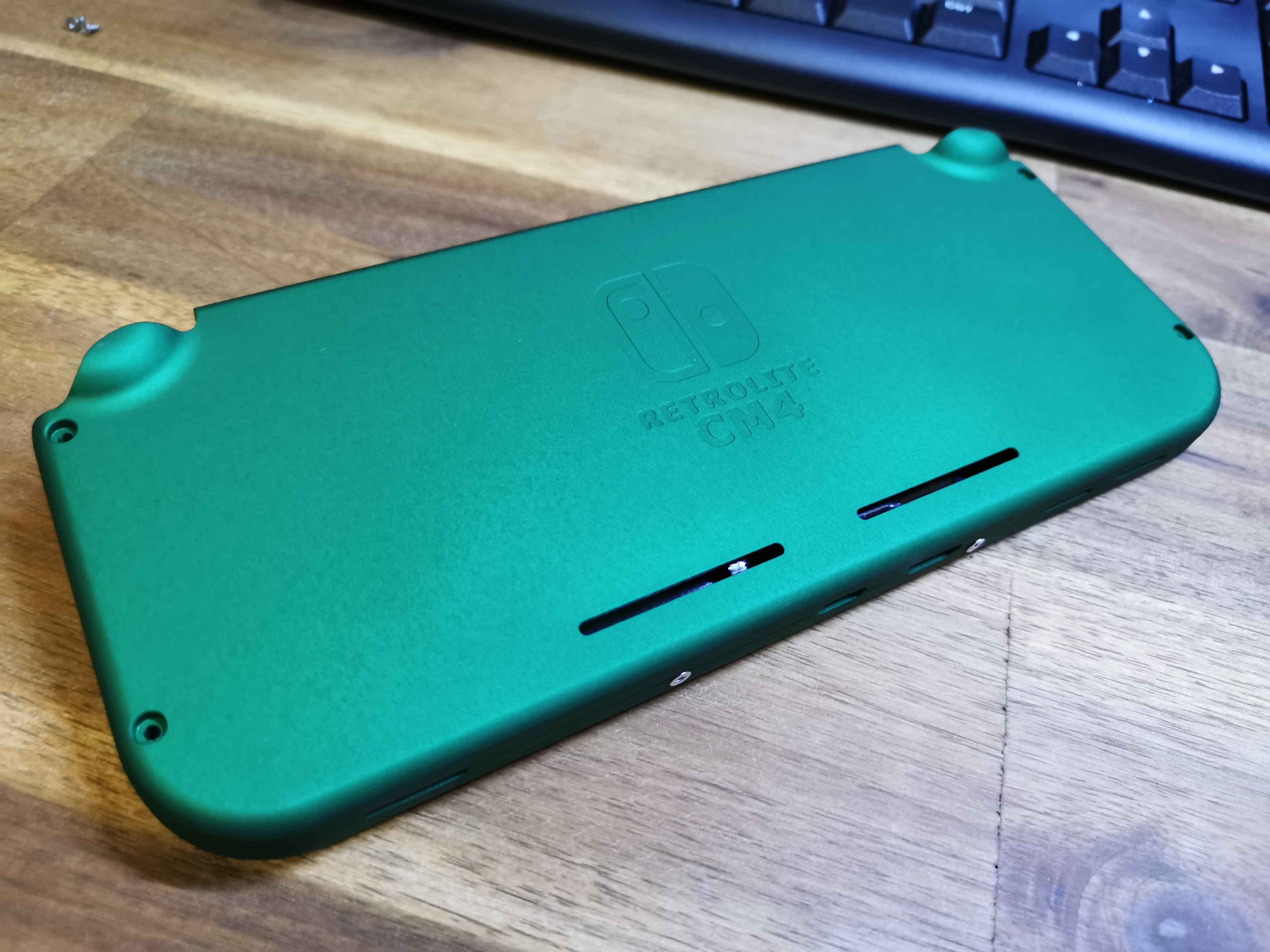

Cases are back from anodising and I am extremely happy with the finish!
Next step is to sort out a vacuum chamber so I can re-do the button molds without bubbles and order some polyurethane resin so I can make some buttons that don't look so translucent.
Still a fair list of things to do on my end while Stoned works on the main PCB but I think we are finally nearing the end of this project!
PS. Ignore the slight angle to the joysticks in some of the photos, everything was just temporarily held in place with tape for the photos.

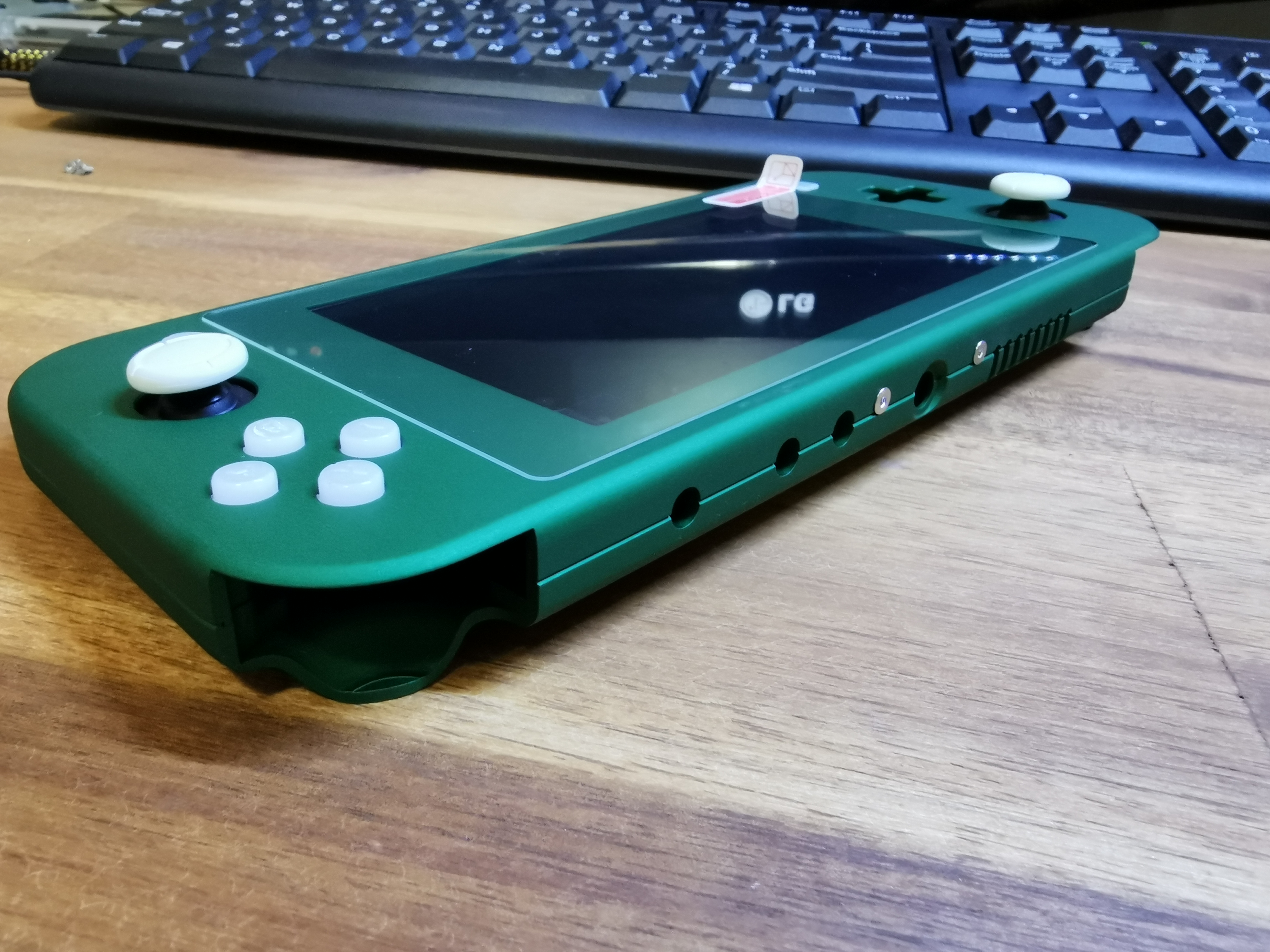

omg the purple case is bad! which workshop can i get such beautiful anodic oxidation?:!:
That looks really good. Does the screen protector just naturally stick to the aluminium? In my experience they don't stick to much other than glass
It was just a place that's local to me that does anodising. Not much use to you unless you're in Australia but they are called A Grade Anodising.
Nah it won't. I'm going to buy a sheet of thin double sided adhesive and use a knife on the CNC to cut them exactly to size so the colour and thickness is consistent.

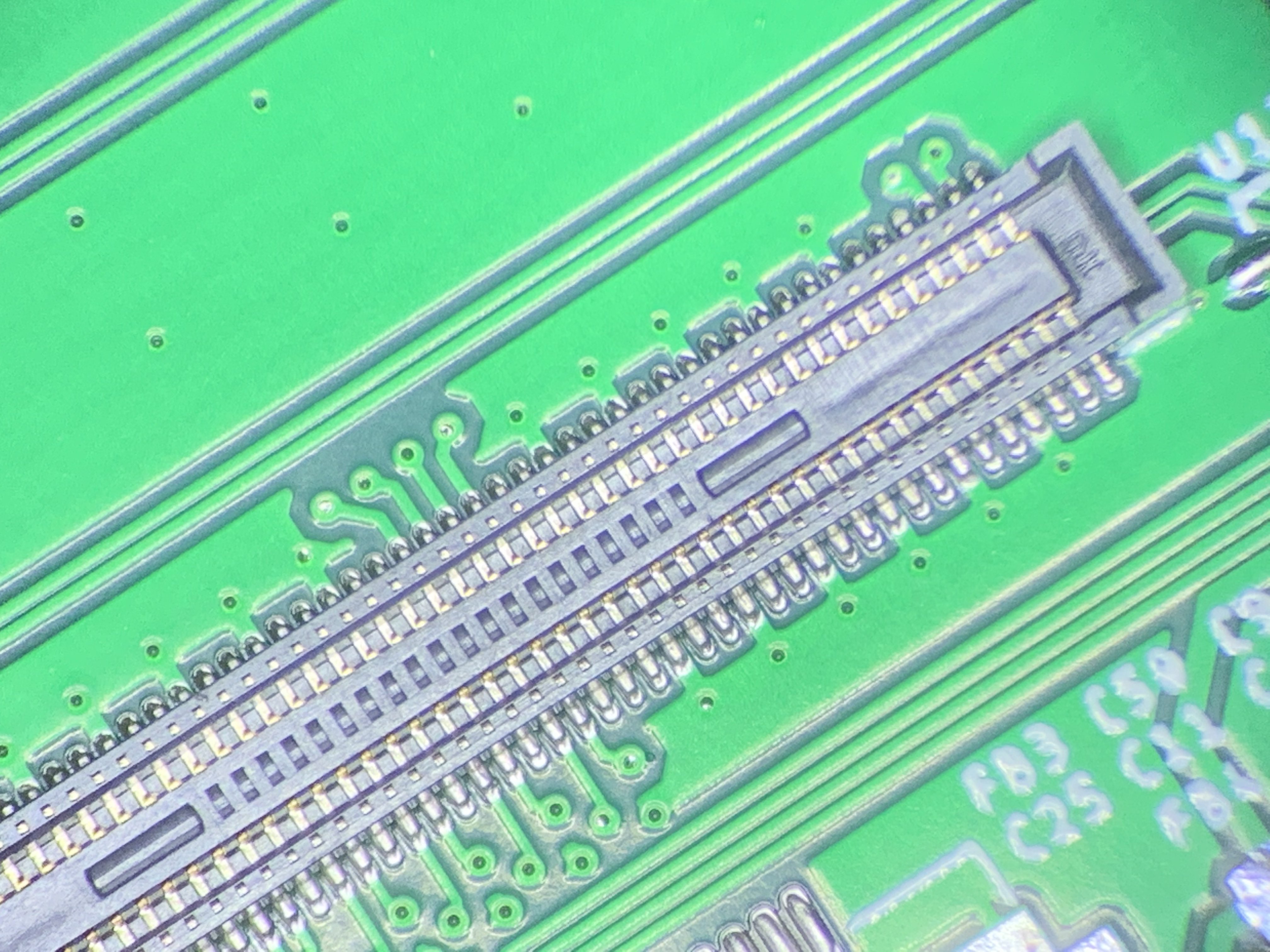

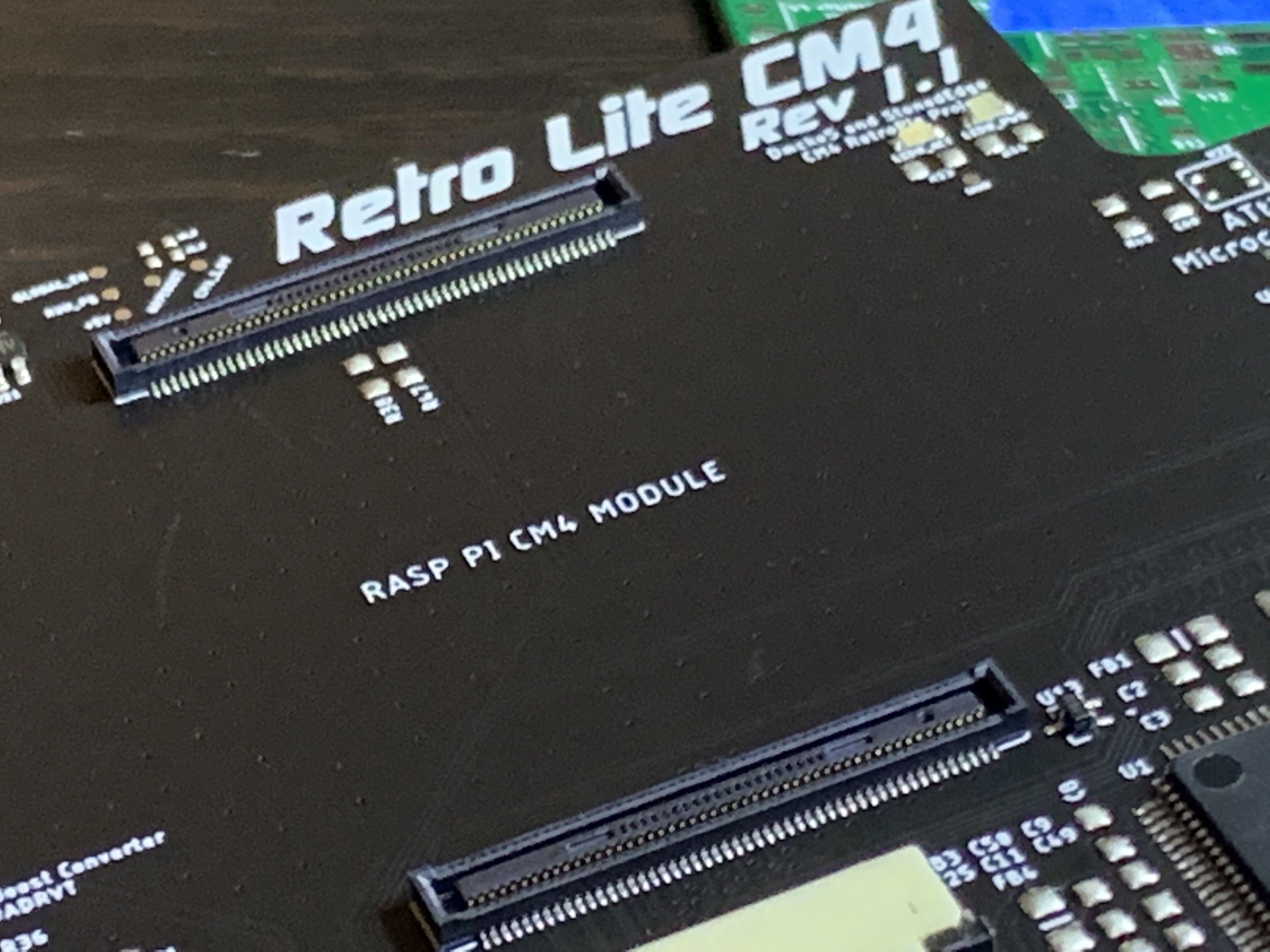

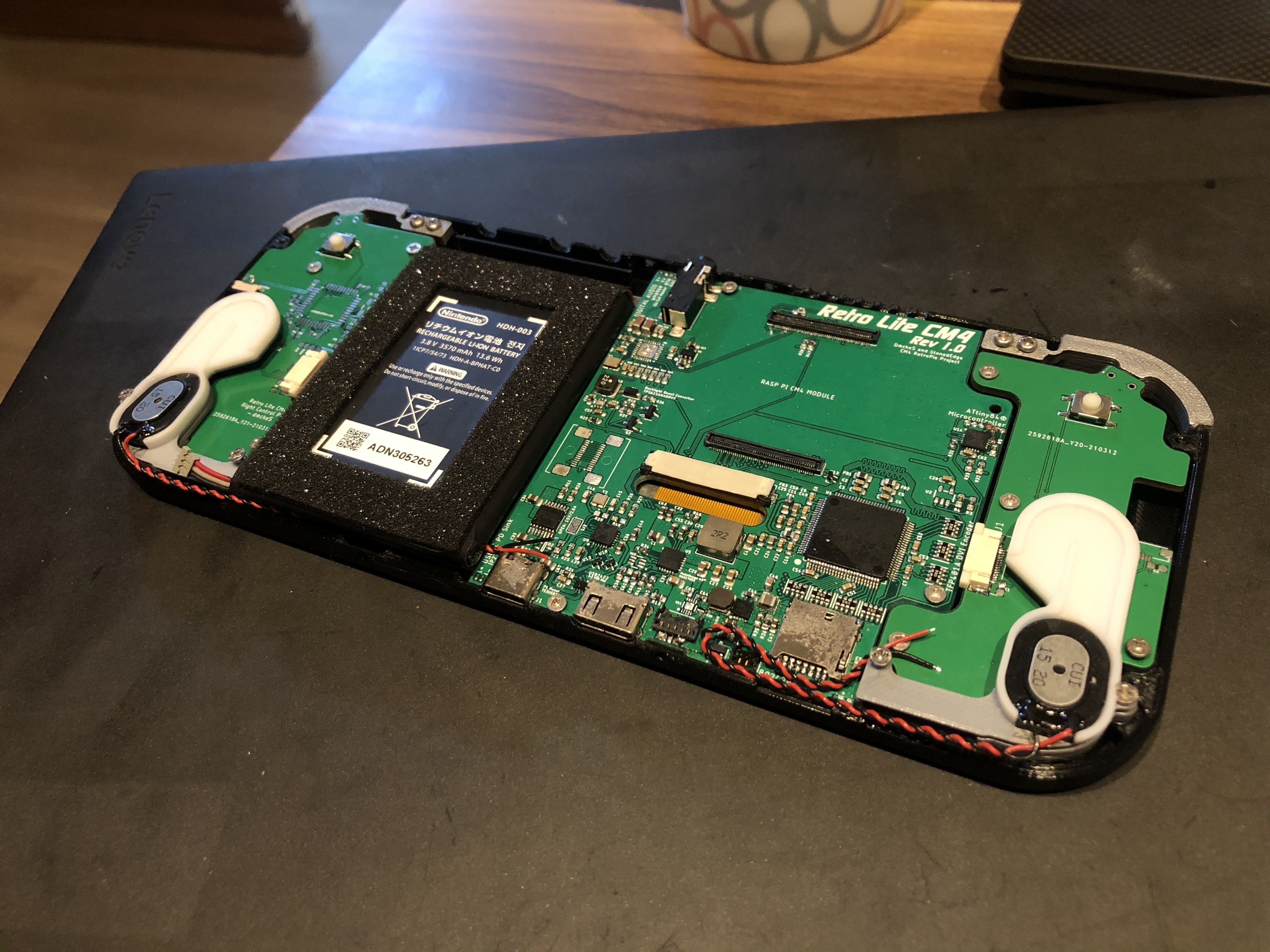

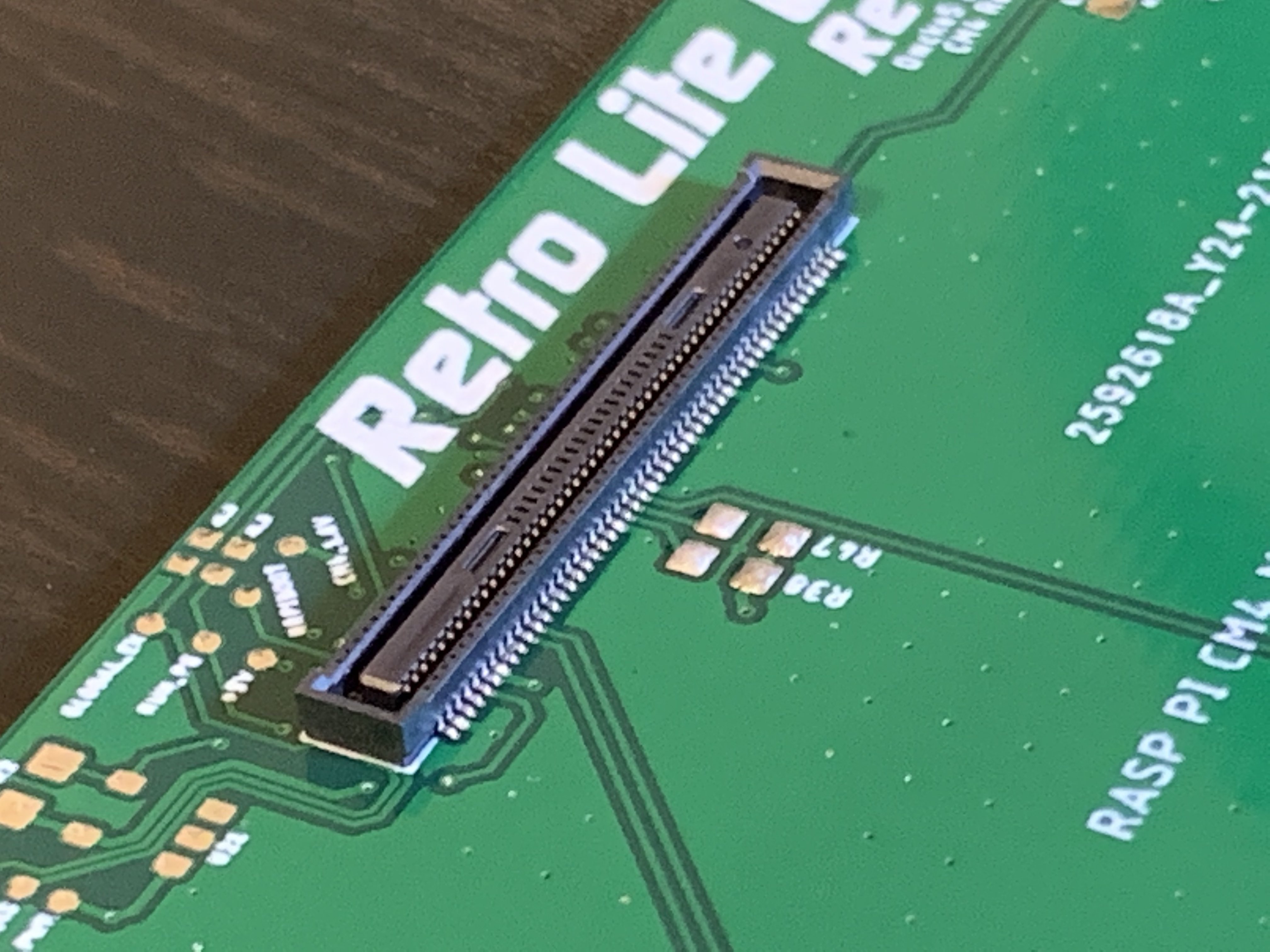

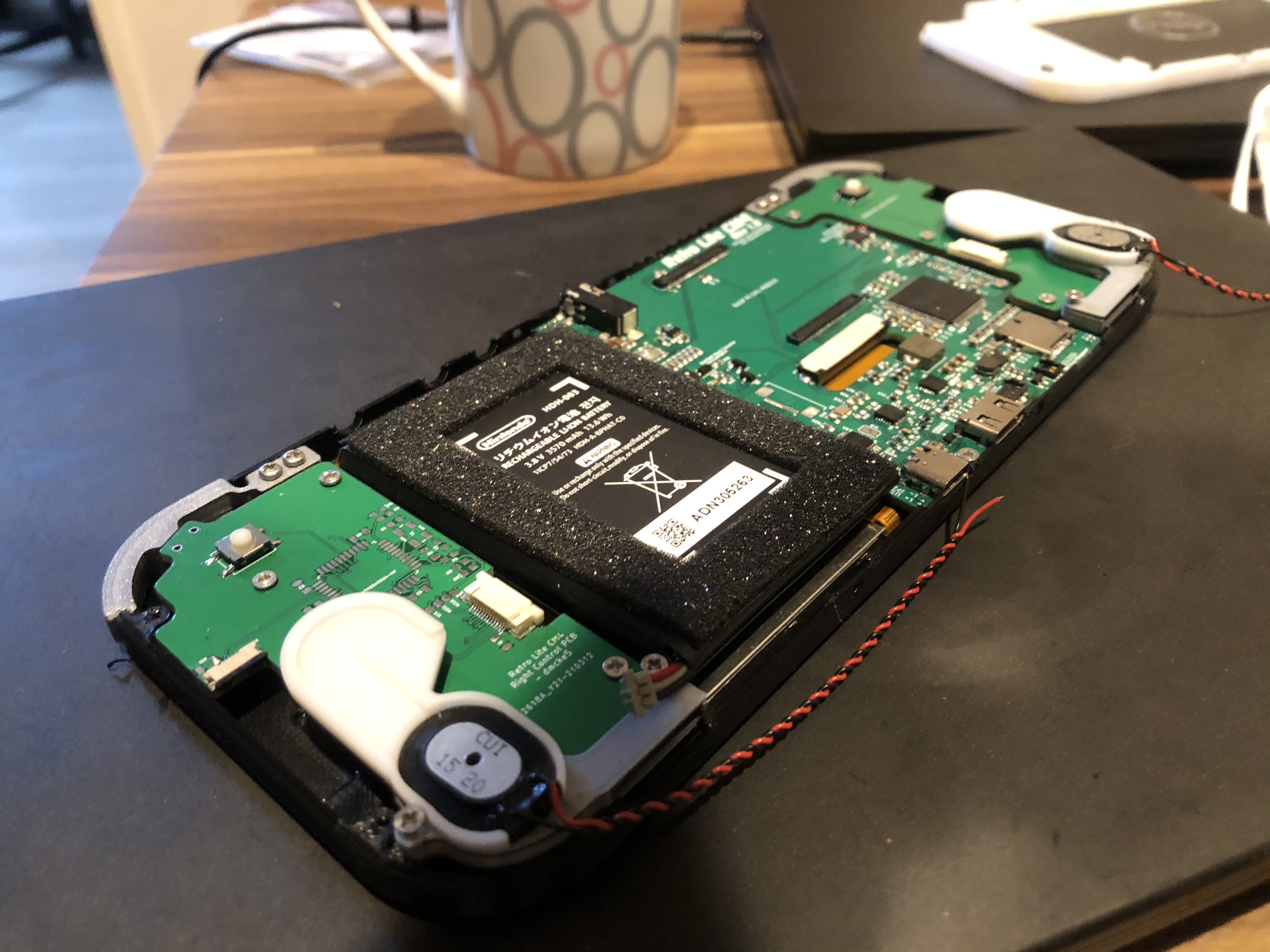

We are currently in the process of ordering a new PCB revision due to a couple of screw ups on my end. The Hirose connectors are difficult to solder by hand as I thought and thus we will be getting them done via PNP to make sure they are perfectly centered. I also may have killed my CM4 by accidentally feeding some of the GPIOs above the VIH ratings of 3.8v, so I may potentially need a new CM4. Let’s see what happens.
I also bought a Switch Lite HDH-003 cell for the prototype. I think it looks pretty damn good in the case along with all of the custom PCBs, even though it’s slightly less capacity than what we were going to go for. Hopefully we’ll have a booting CM4 in the next few weeks to show along with some cool features. Dmcke5 is working hard on the heatsink setup as well as all of the rubber membranes and speaker chambers, so expect to see more updates hopefully soon. Sorry for the delays! That, and the global chip shortage hasn’t helped this project.

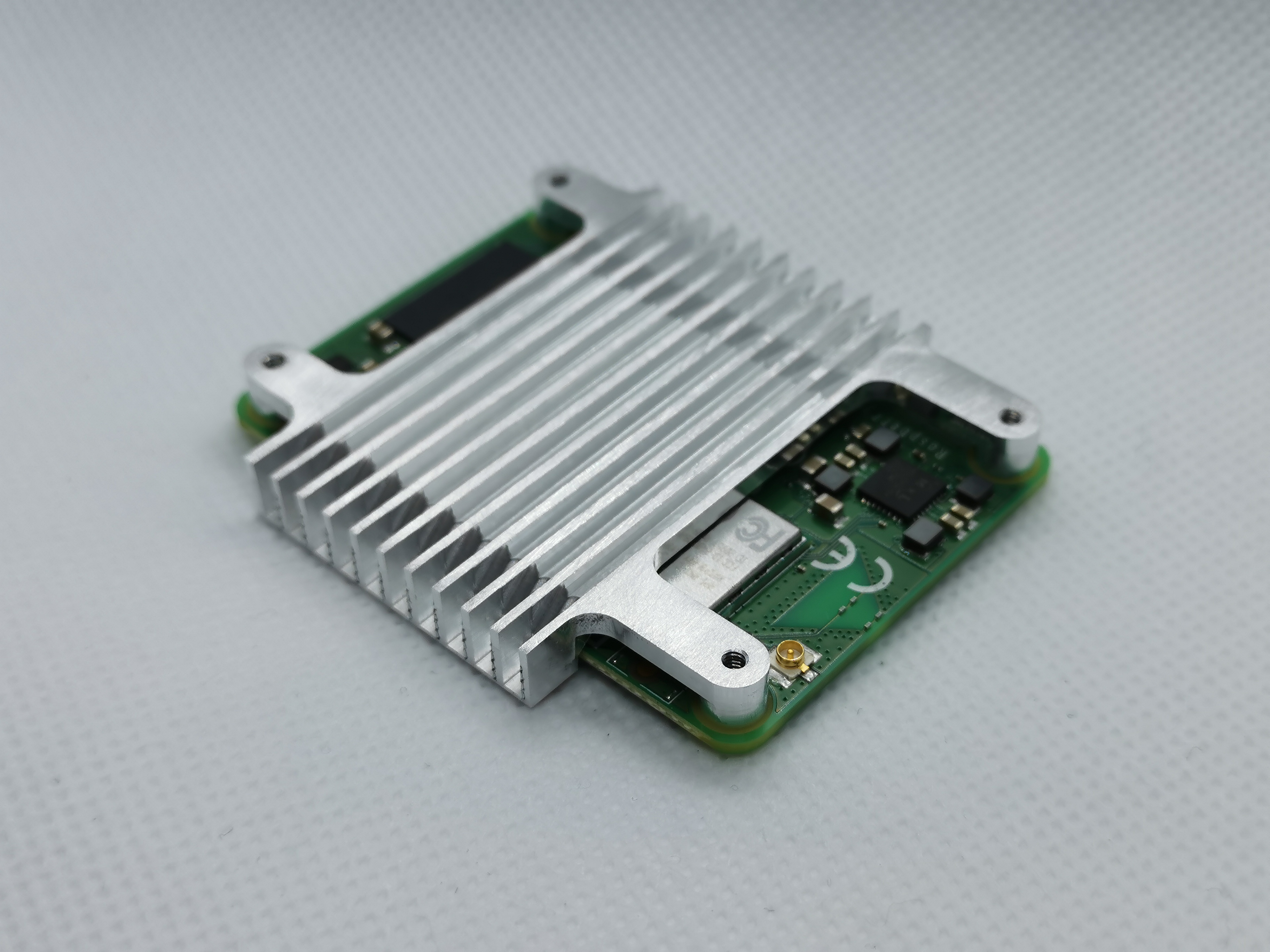

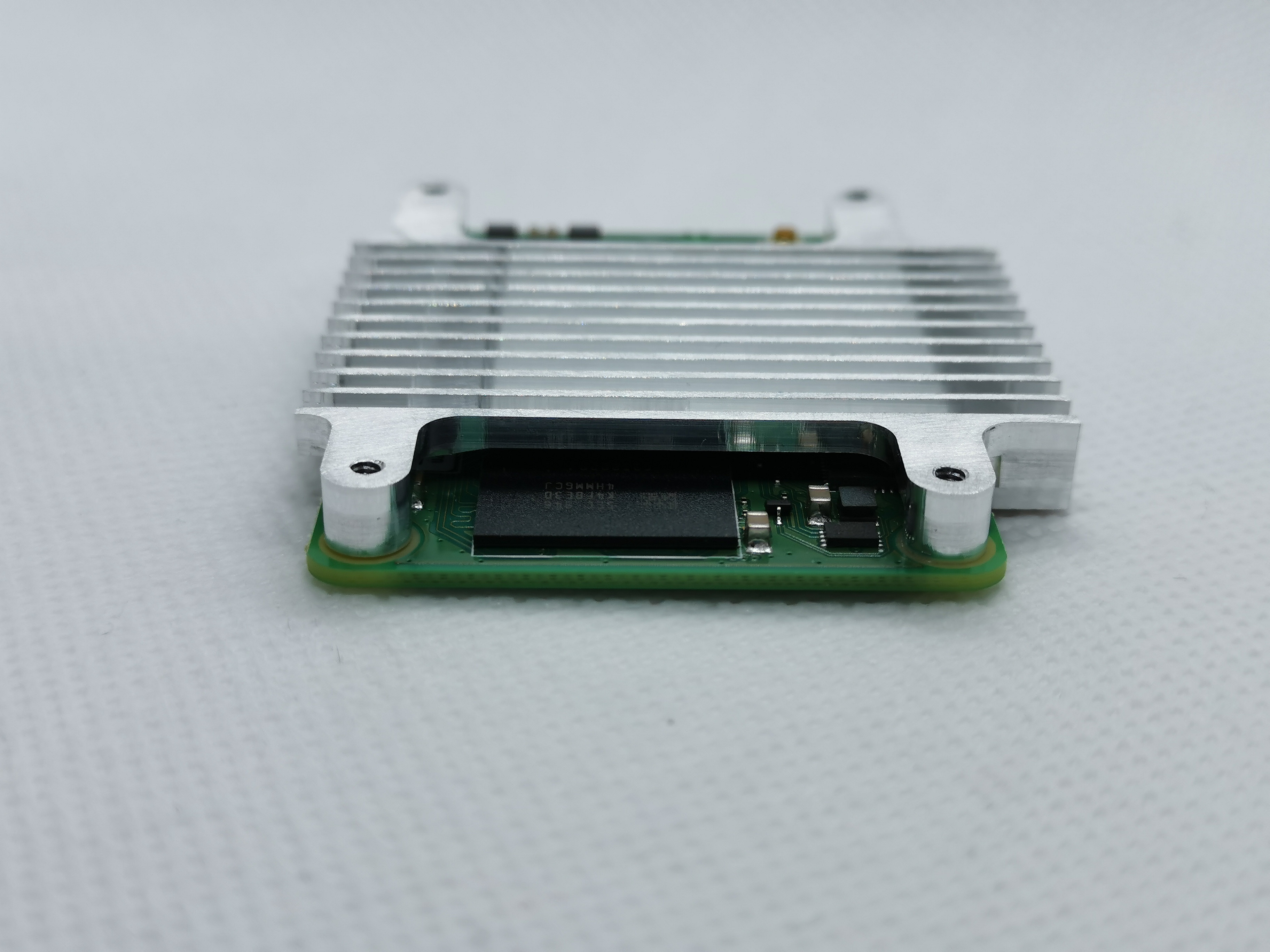

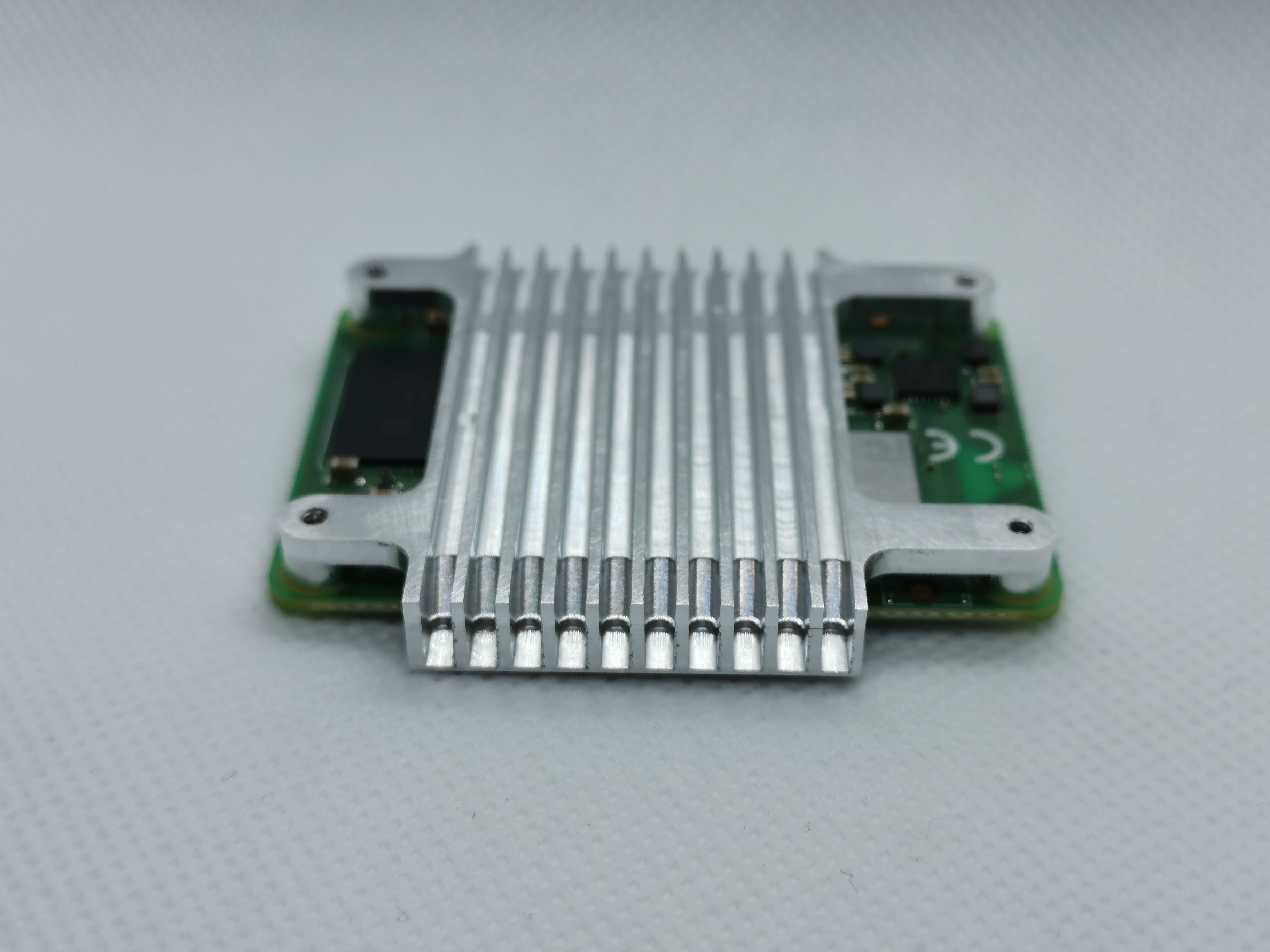

Heat sink done! This was definitely a fiddly little job to machine but this was the best option I could come up with for cooling in the space we have available. A little blower fan behind should provide more than enough cooling capacity as the cm4 apparently doesn't run all that hot.
well that's one sexy heatsink! I would love to have a CNC just to make custom heatsinks >.<
//Edit: Also holy fuq, that case looks so damn good... O.o

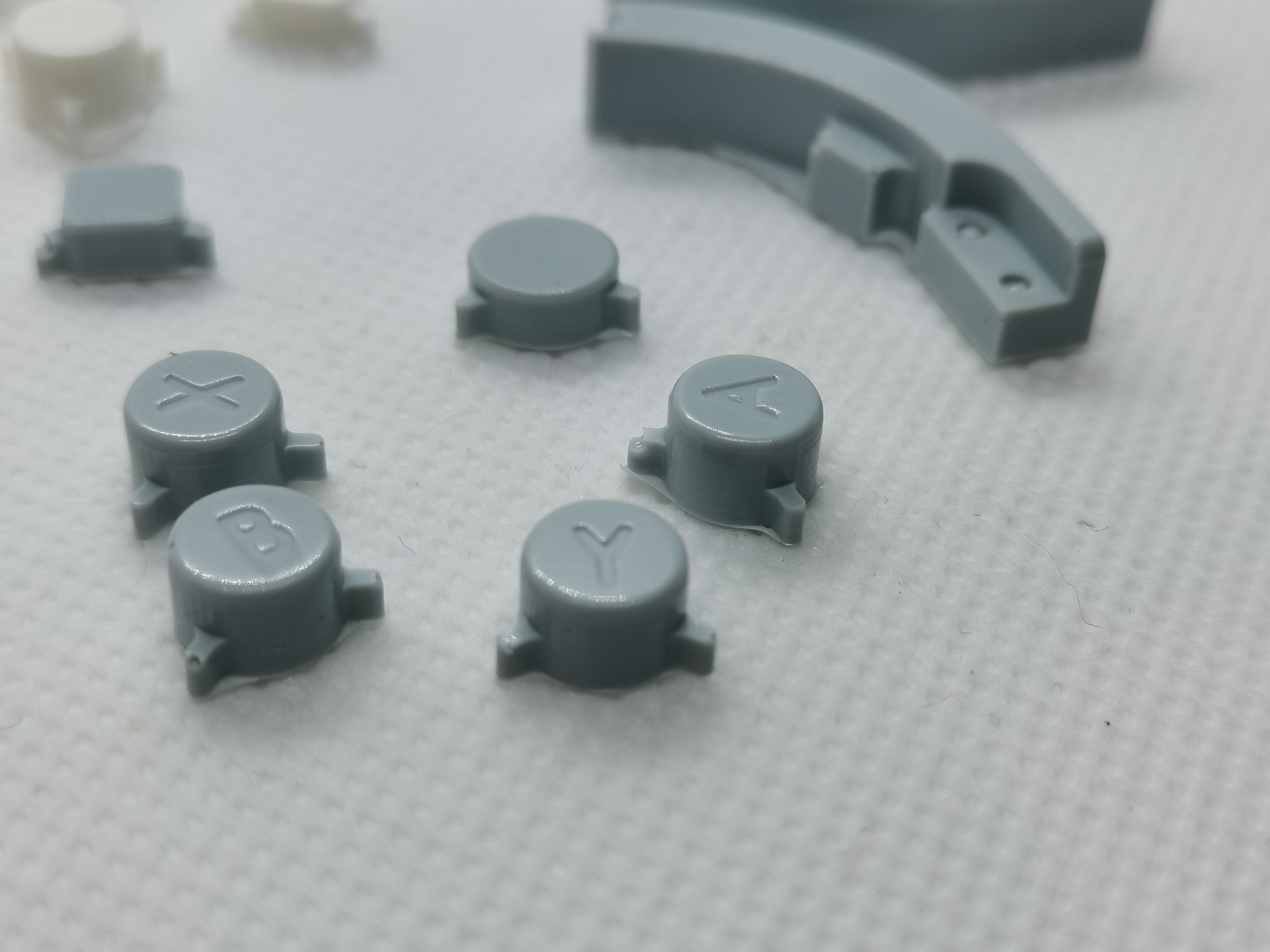

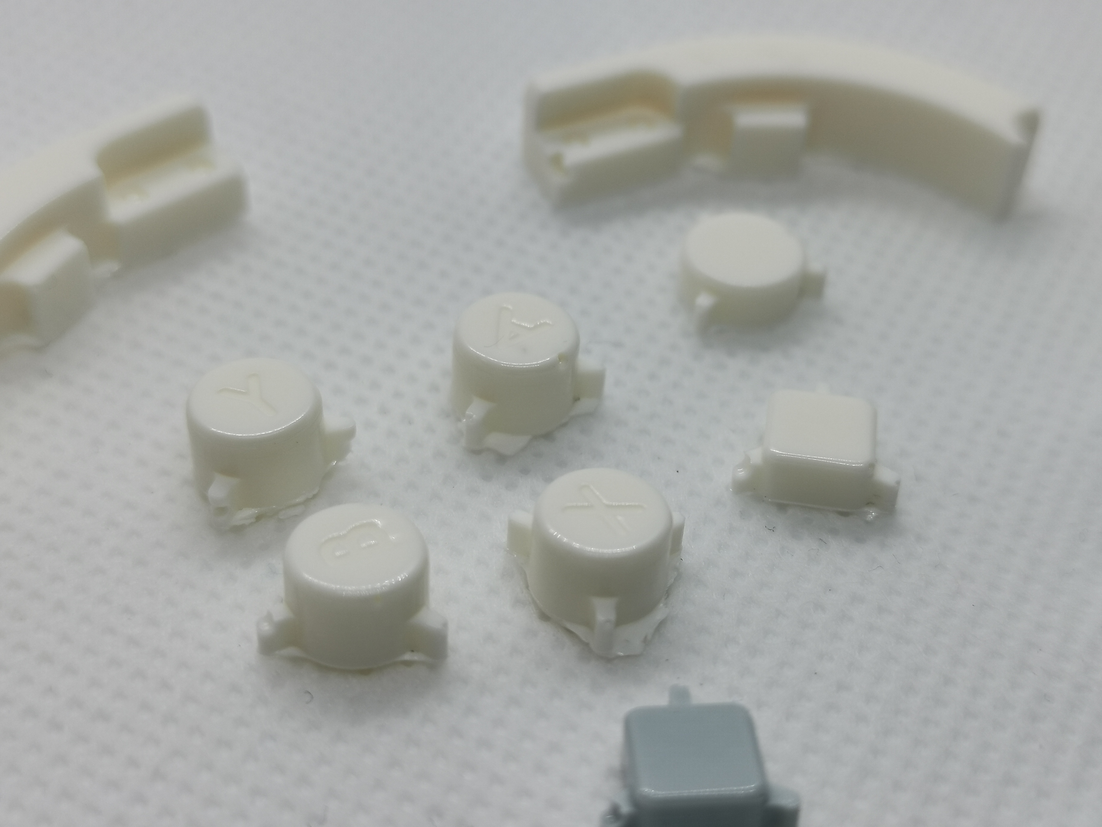

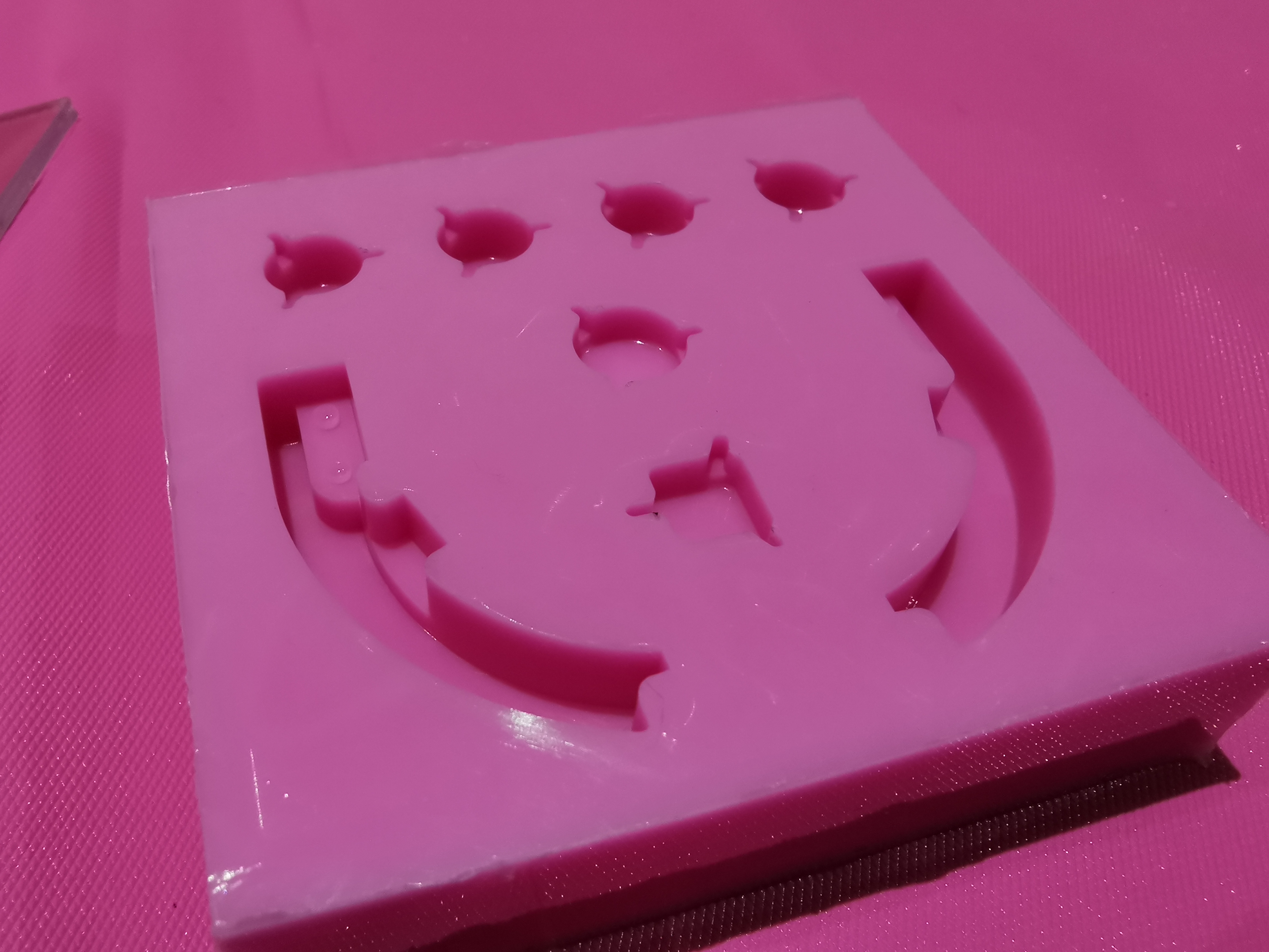

Dmcke5 has clear coated our cases to give them a more polished look and also to remove the dryness from the satin anodizing. He’s also been working hard on some silicone molds and casting us some new buttons for the project. The new button molds and buttons look really sweet! We’re having a bit of trouble with the DPAD bubbles but the top surface came it really nicely. Check it out below if you’re interested.

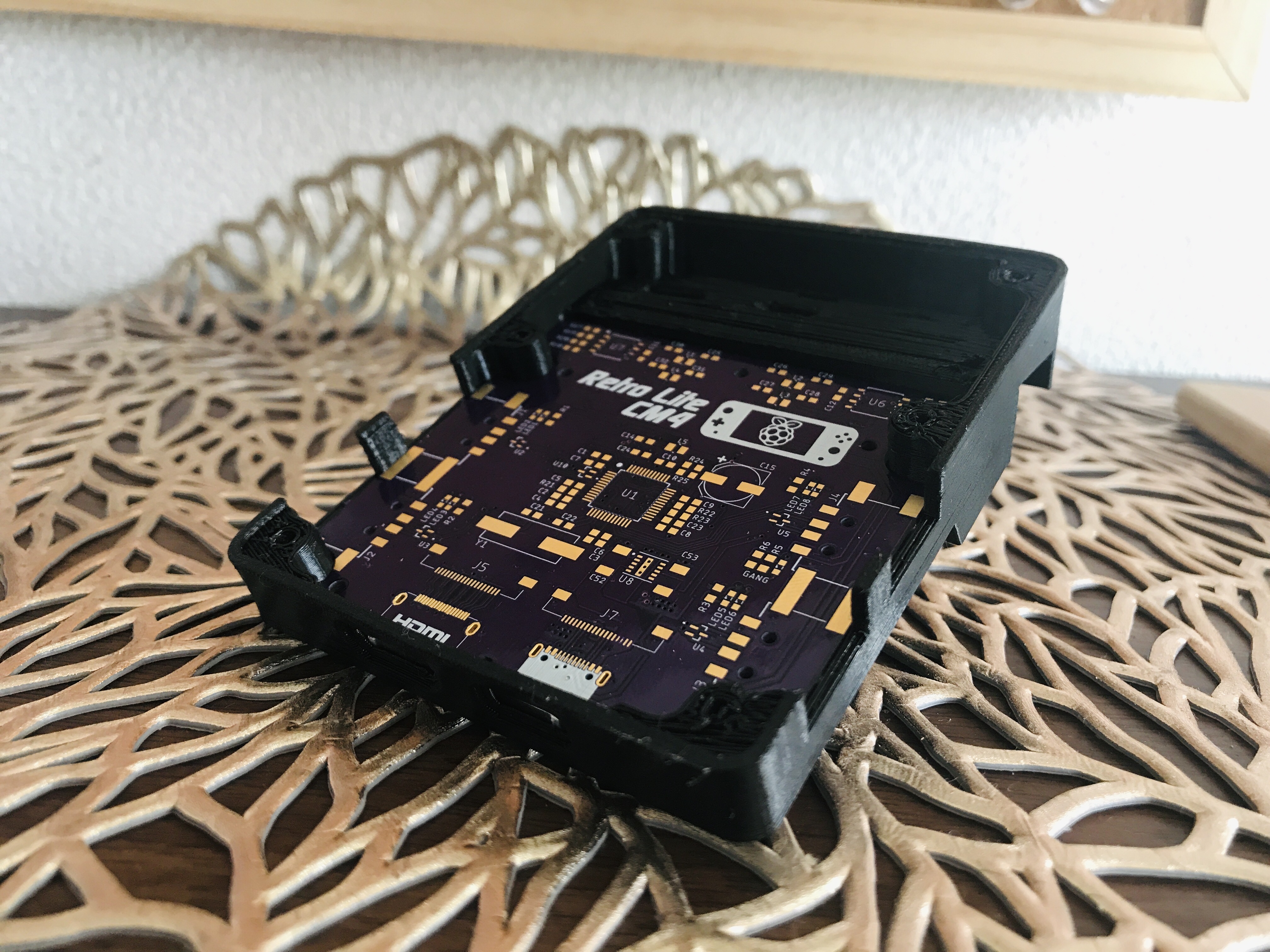

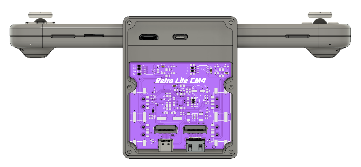

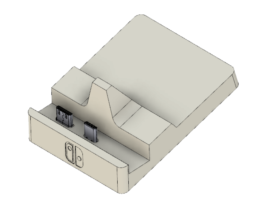

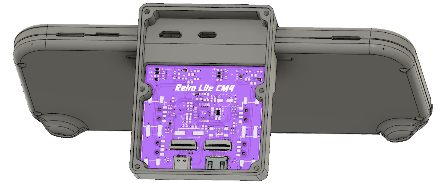

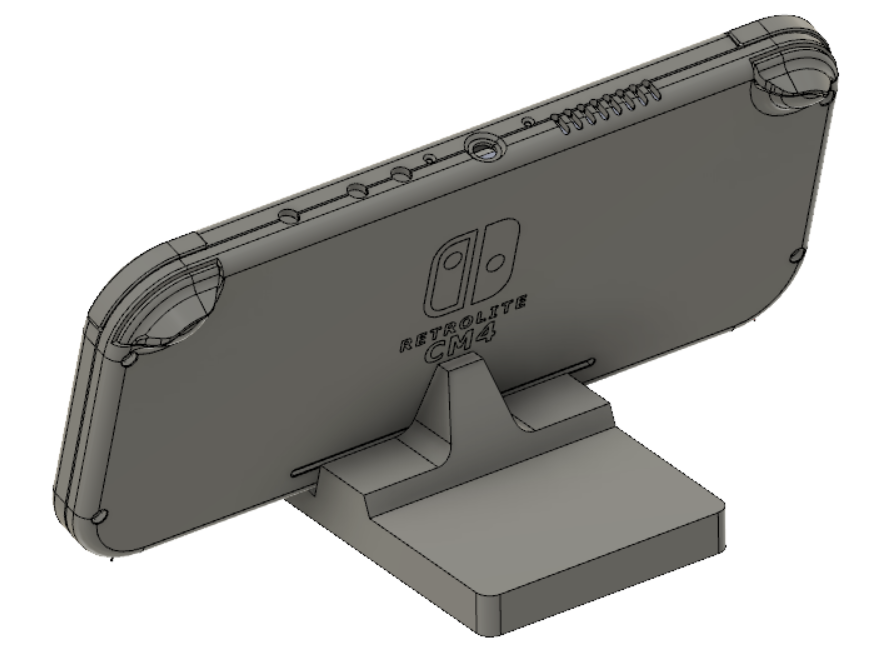

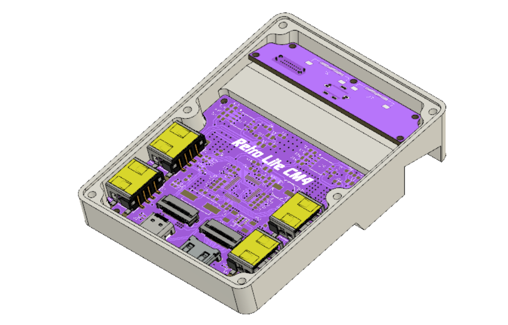

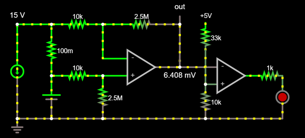

Currently working on a small dock PCB and design with Dmcke5. It connects to the front PCB (not yet pictured) via two 19/18 pin FFC connectors for HDMI and USB-C out. It contains 4 USB 2.0 downstream ports powered by the Cypress CY7C65642 chip for connecting wired controllers and adapters (such as Ethernet) and also being able to add various games via a USB drive to the Pi. It also has a LED to show when the batteries are charged, driven by an op-amp and comparator circuit. I don’t know if this is the best solution (gain of 250 times is a little much) but we have a range of around 0-200mA to play with by changing the 33k resistor on the comparator (currently set to 40mA). The dock is slightly angled at 15 degrees to take the stress off of the connectors. We also designed a back rest to keep it from falling by it’s own weight, and ensured that the vent holes are exposed to allow for adequate airflow whilst docked.
Of course it’s nothing fancy electronics wise, but it should make for a great little streaming device to the TV via Moonlight, or for just playing old retro titles straight from the Pi.

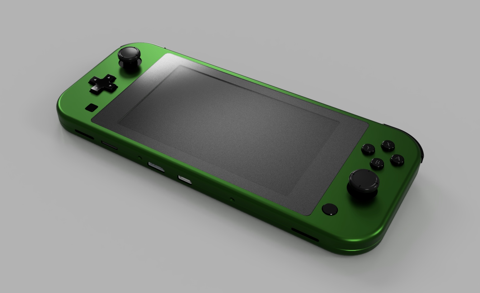

From CAD render to real concept. We’re so close now to having a working prototype now. Awesome work @Dmcke5!
I can't tell the difference from the render and the actual. Great job. Wow.. I would love to get my hands on this sexy thing!

Dock PCBs turned up today. Ready for the inevitable crash and burn... just need to find a vendor that has the IC I chose available lol :rothink:
