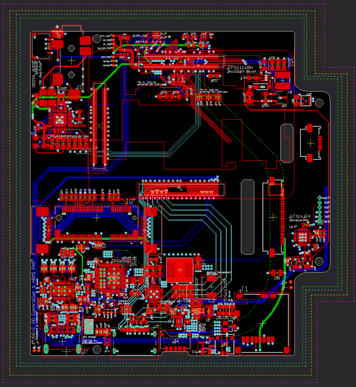

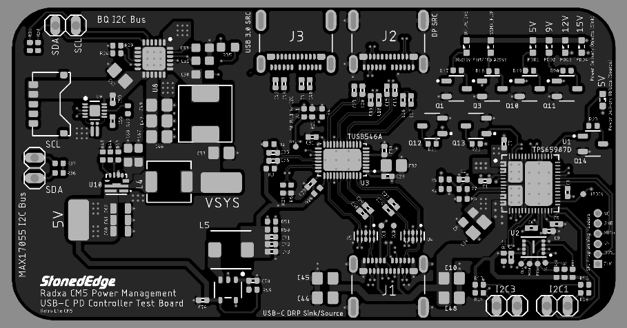

Revision 1.1 of the main board is almost ready to be ordered! I can feel the project end drawing near. There's still a lot to be excited about in the future with this board, like Vulkan support and newer linux kernels which will improve performance significantly compared to the GLES binary blobs. But for now, they work well.

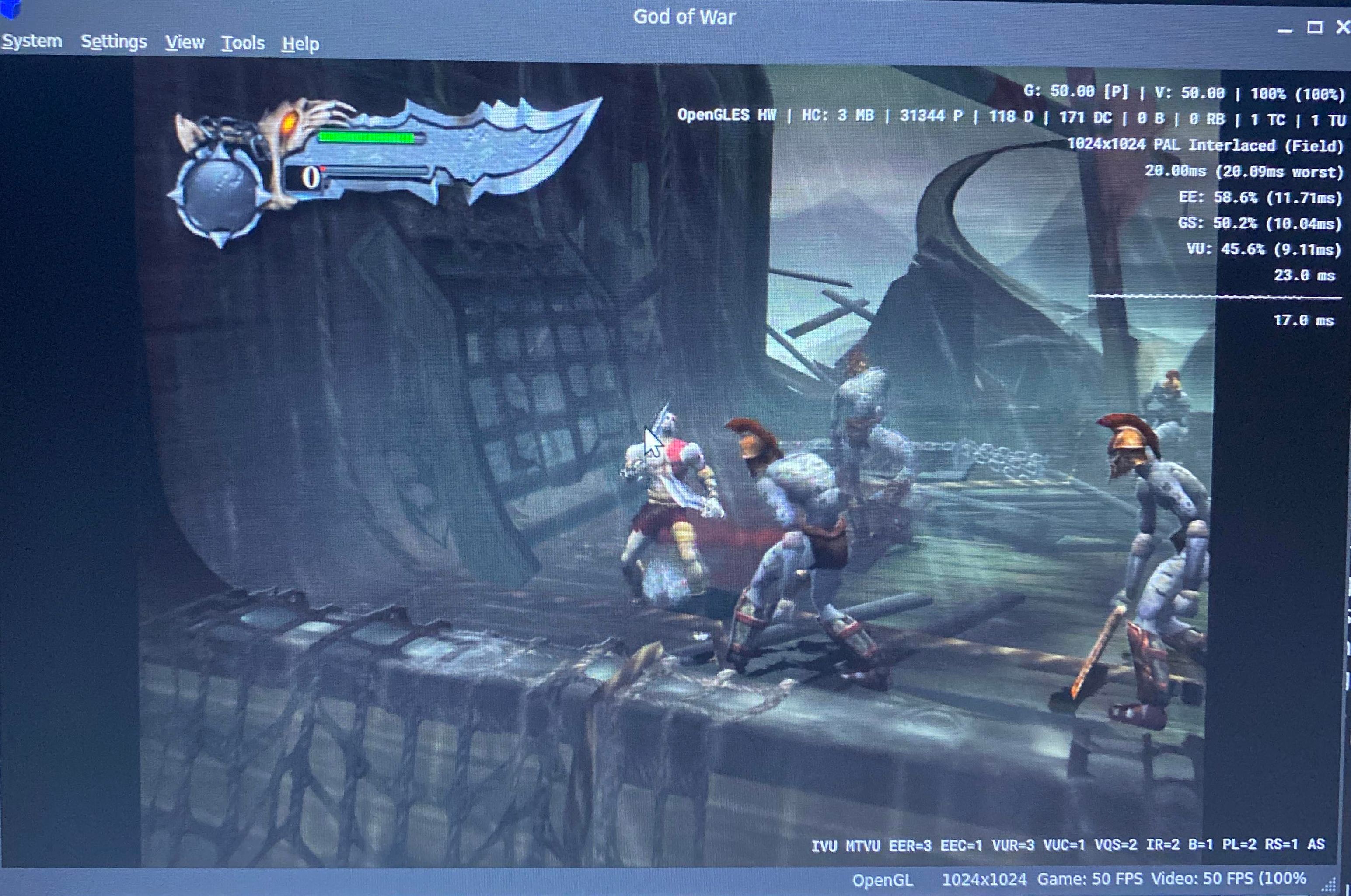

I've been having fun with Box86 too. I wanted to test out our gyro and its working really really well, the EKF algorithm is something else. Portal is the perfect game for using it too (which runs at over 60 FPS, by the way with this SoC! I was surprised). I also installed all of the NSFU titles and they run at playable frame rates too. Wine is really great with this board.
Battery life testing has been rough, however. With a 5Ah cell, we don't exceed more than 2 hours in heavy demanding titles, such as GoW or Shadow of the Colossus. I'm thinking to upgrade to a 6Ah cell since there is plenty of room for that, but the SoC is indeed very power hungry.
We also have a working low power mode. It was a simple as driving PWRON_L to ground momentarily. It'll be interesting to see how "ultra low power" this mode really is. But I got far too excited to see how simple this was to do.

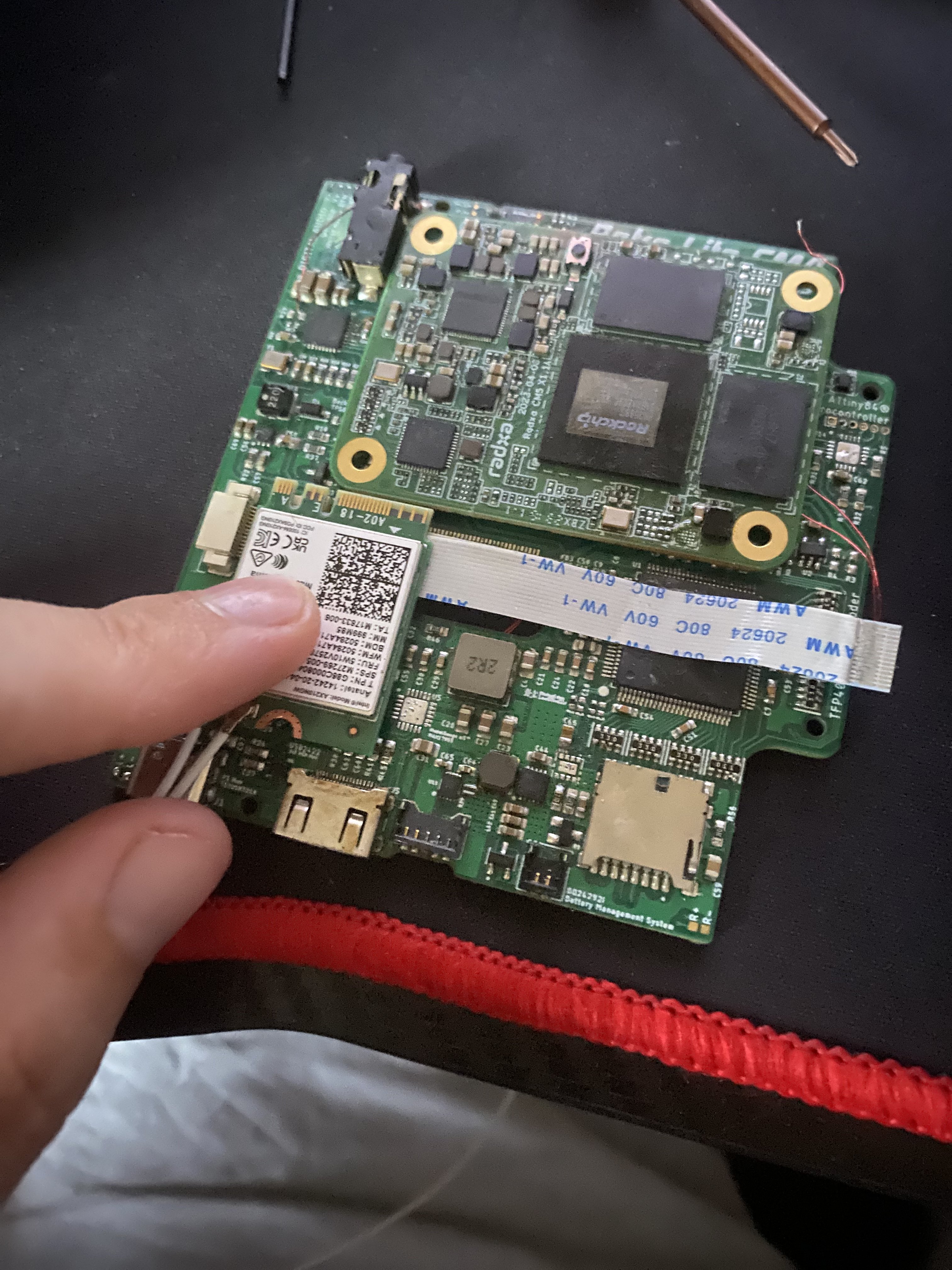

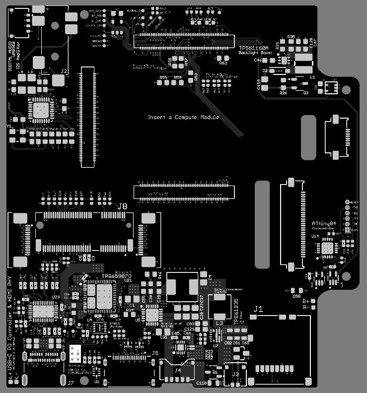

New PCBs have arrived and I only made one mistake, nothing crucial luckily... everything is working!
We're on the home stretch now... hopefully we can get an Android 13 image also working soon. For now we have Armbian and ROCKNIX. Photo bomb incoming...

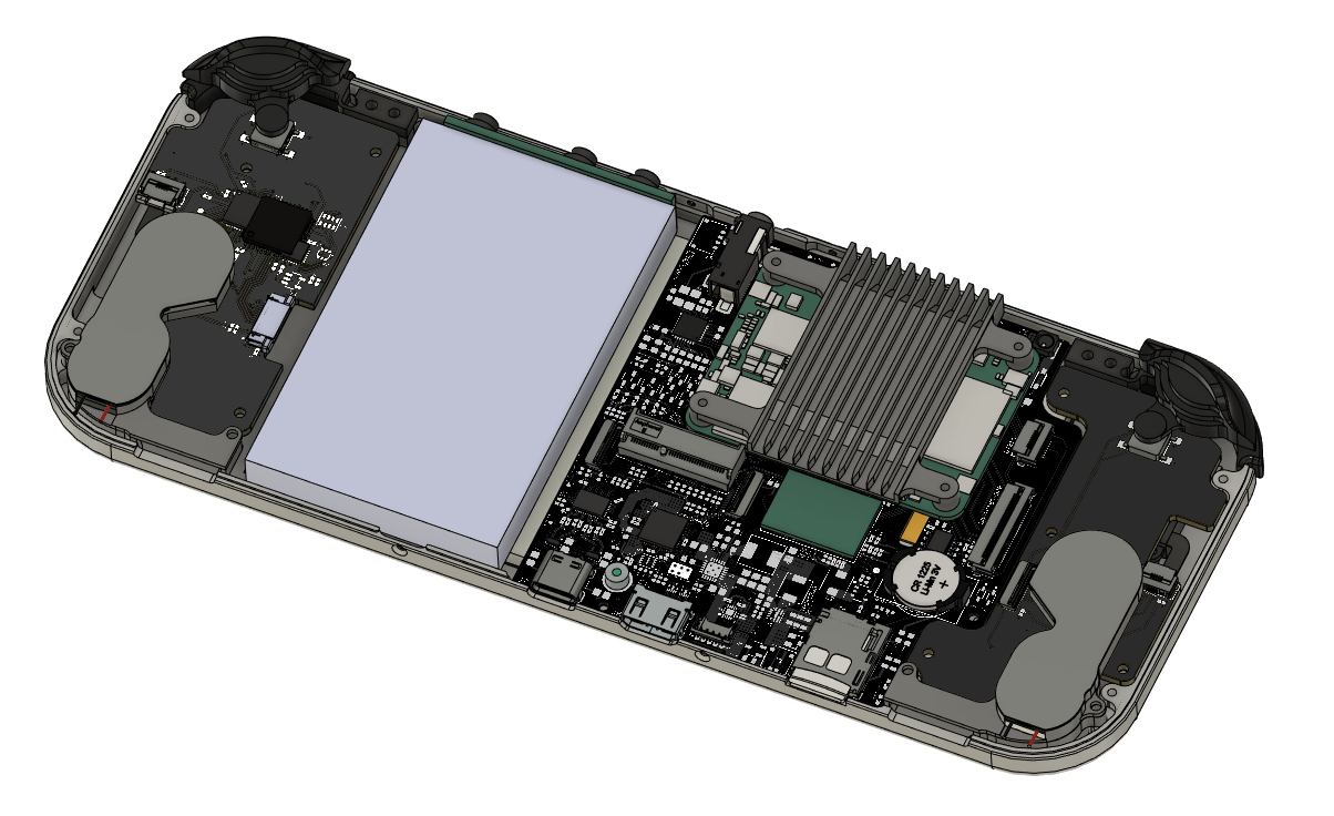

OK, without further ado, let's get cracking. The picture below is missing a couple parts, and some are slightly wrong (all's already fixed in the repo), but you'll get the general idea.
Pretty cool, huh? Let's try putting it together. Some prep work is needed: heat set inserts are going to make the assembly and disassembly much easier.

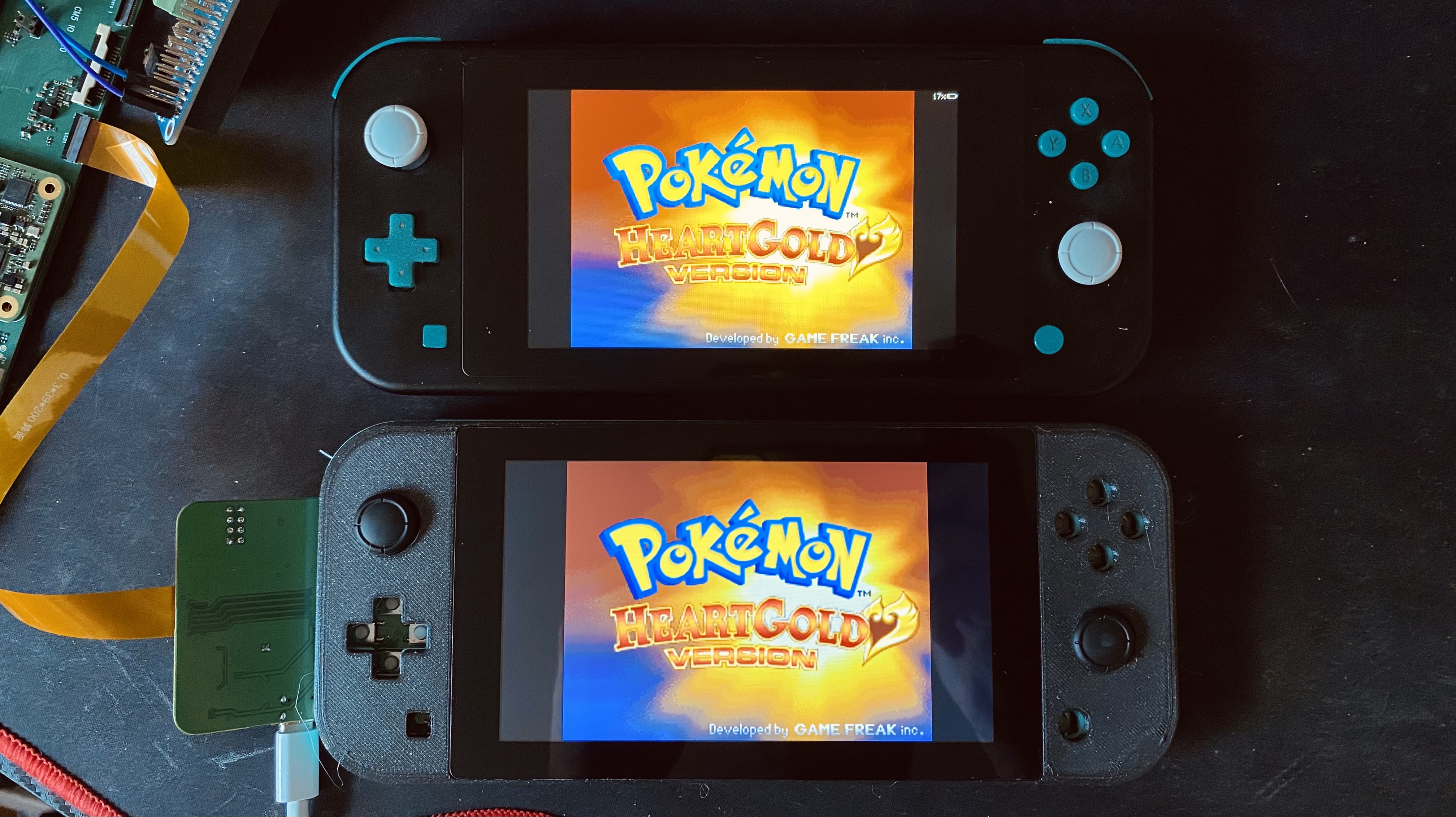

Oh yeah! Told you it's flamboyant. :)
Testing HDMI for a good measure...
"This is getting out of hand, now there are two of them!"

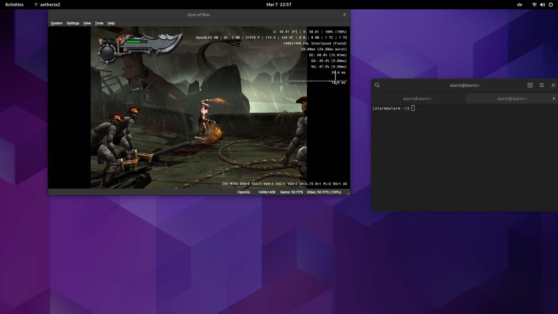

For those that have asked, I've tested a couple of games on the "emulator that should not be named".
All of these are running in handheld mode at 720p resolution (1x scale). Even though these emulators were developed with Qualcomm Adreno GPUs in mind, I was pleasantly surprised of the performance I got out of these easier to emulate titles on the Mali GPU.
Crash Team Racing Nitro Fueled
1x resolution
Handheld mode
30 fps
Super Mario Bros Wonder
1x resolution
Handheld mode
50-60 fps
Crash Bandicoot Insane Trilogy
1x resolution
Handheld mode
30 fps
Hades
1x resolution
Handheld mode
50-60 fps
