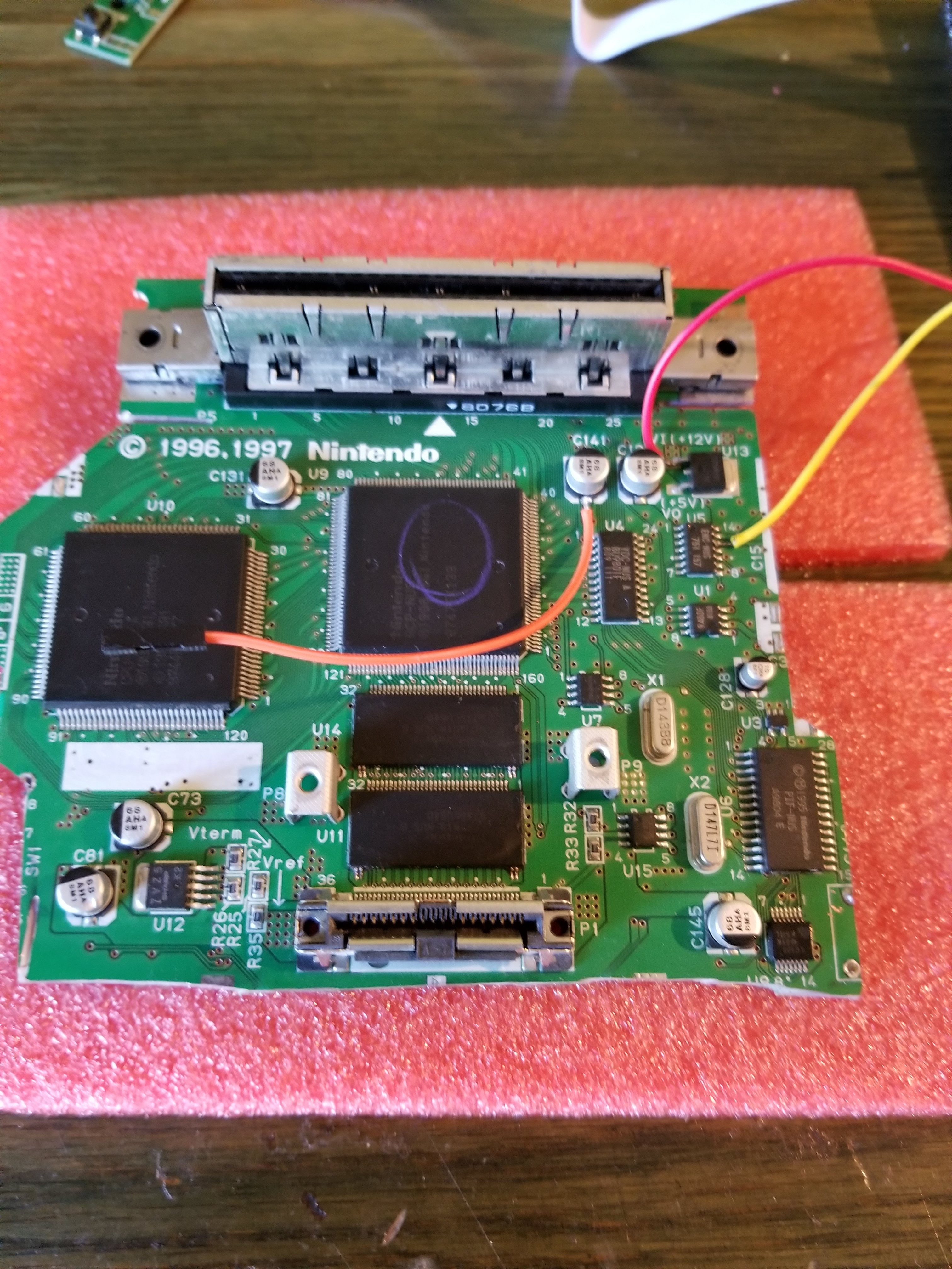

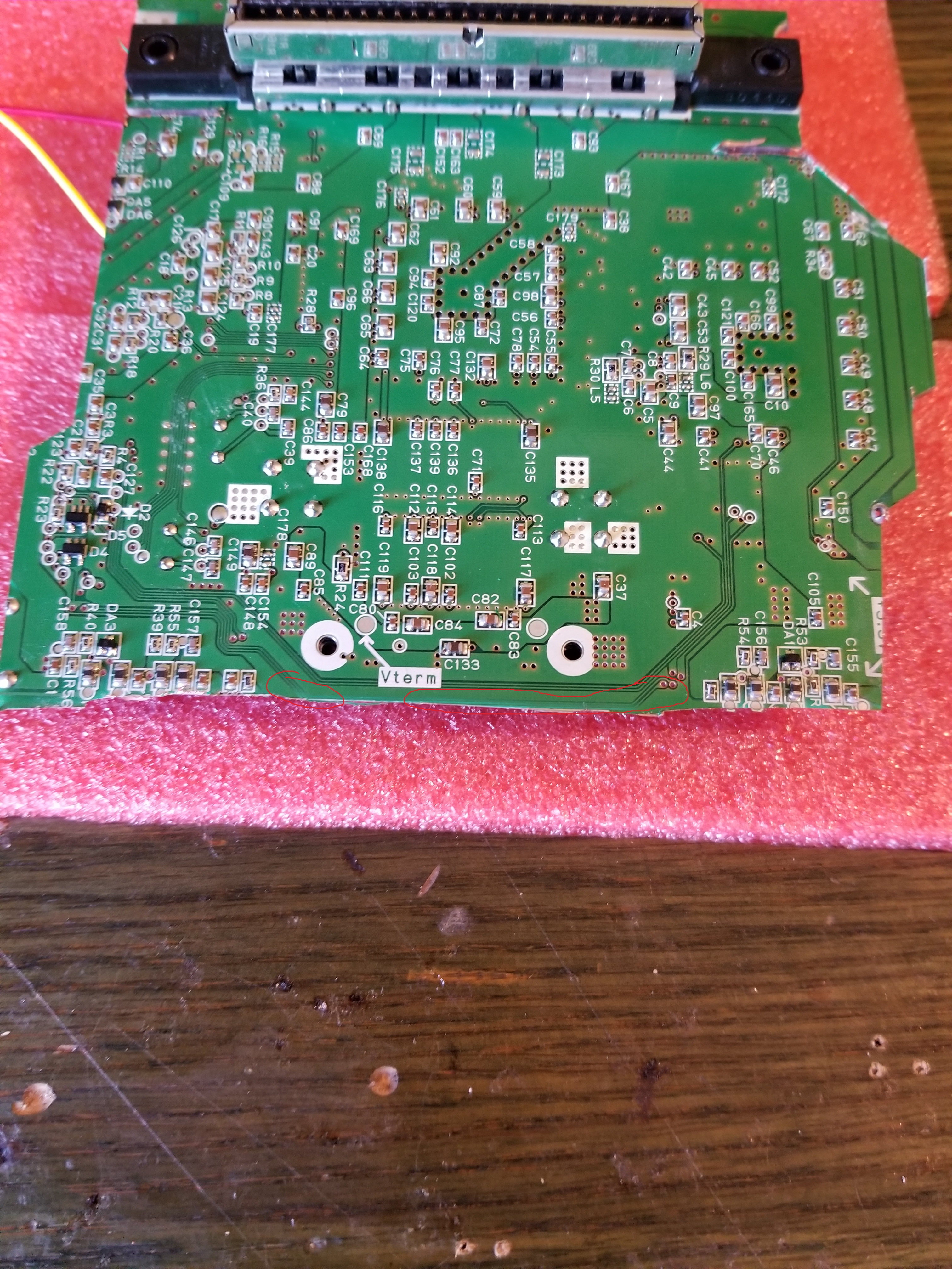

Just did a board reduction and Ive attached a couple pictures. Dont get power on my board or AV.
Can someone take a look and see if I need to connect any traces near the mem cart slot I might have cut?
I think I also need to connect a 2k resistor to pin 8 of the PIF, right?

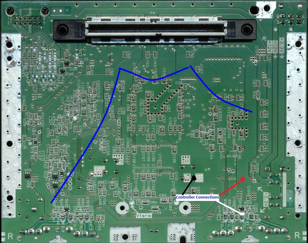

Also I attached a picture I picked up from a board reduction thread indicating I need 3.3v where the blue line is traced... is this standard practice? There arent any components where the blue lines are, so its confusing.

The guide shows the cut as close to the expansion pak as you cut, so I think you may be ok without reconnecting those traces. I would still recommend a little sanding to smooth out those cuts.
The blue lines in the guide are so that you reconnect the 3.3v line on various spots of the board. Don’t worry that there aren’t components or vias to solder to. Scrape away a little bit of the green mask (I use an X-acto knife) to expose some bare copper that you can solder to.
Reconnect the 3.3v lines first. Then if that doesn’t work, do the resistor on pin8 of the PIF. That was what finally got my 64 to boot up.
