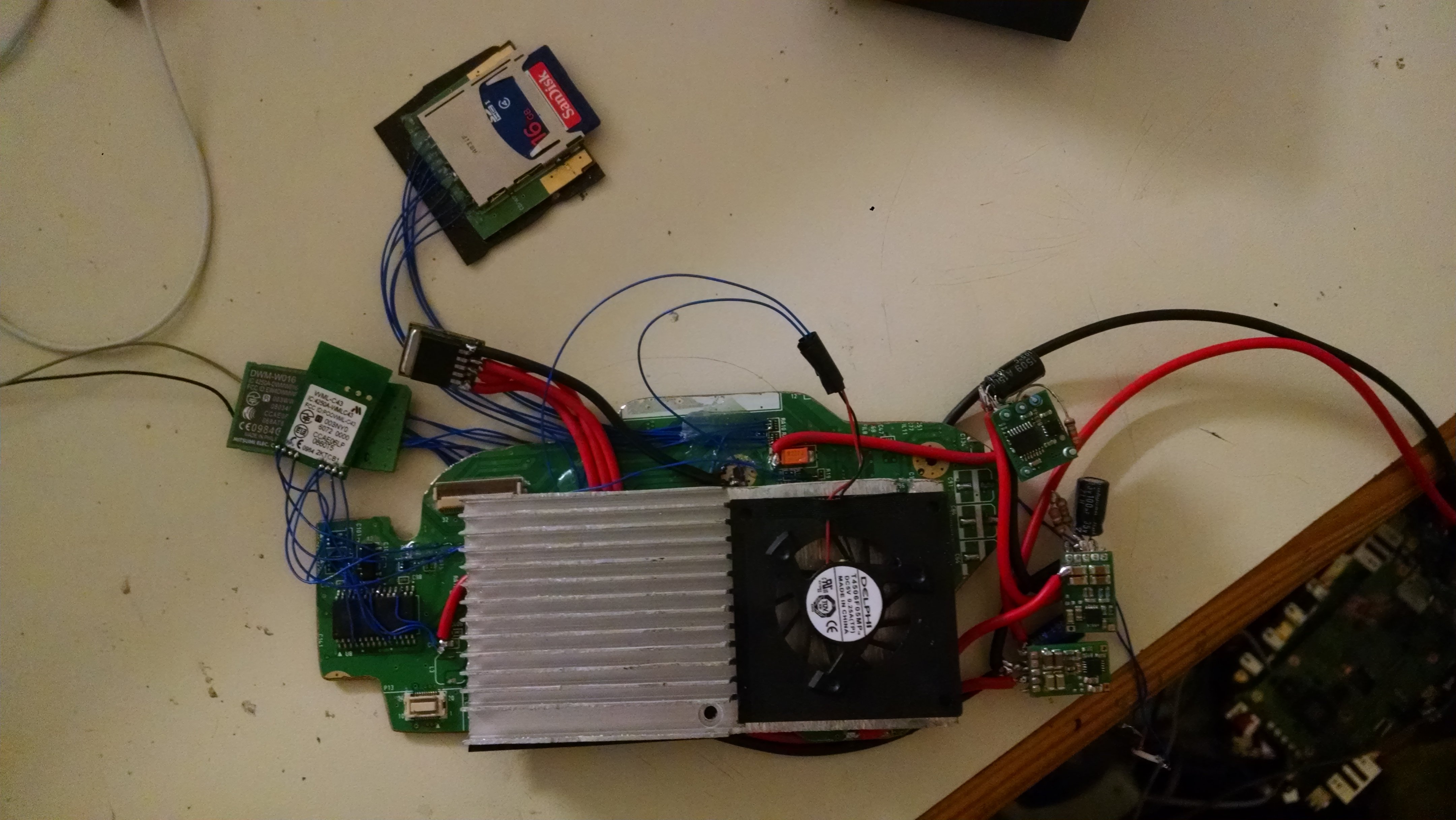

Not my cleanest wiring but hey it's working. Really just want to get this thing closed up. Waiting for some epoxy to dry and then I will put it in the case and attach the controller and video and it should be good to go.
It's so compact :) Will this portable have full wii functionality?
Absolutely. I'll be attaching the disc drive daughter board. I'm still not sure if 5v is needed for it to function but I've got a 5v regulator I can squeeze somewhere in the case.
Nice! Throw 2 IR LEDs on the front of the case you can use as a sensor bar to REALLY get full Wii remote functionality. Also lol at the components that are still sitting on chunks of cut up Wii circuit board like the SD slot and 1.8 LDO. Maybe we could do that with the wifi and Bluetooth module connectors as well, unless that would be even more difficuilt
Hey, that's pretty good ;)
But for real, good job on that there portable, can't wait to see the finished product ^-^
Haha yeah all those dead boards are coming in handy :) I've got a bunch of nice SD card slots and LDO regs now :). You could do it with those daughter boards I guess, I dont have a problem soldering to the pads although they are pretty small for some people.

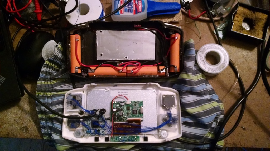

Still have a few things left to do like the audio amp, mem card, low-battery indicator, and disc drive daughter board. This closes up so easily so fitting the daughter board should be easy.

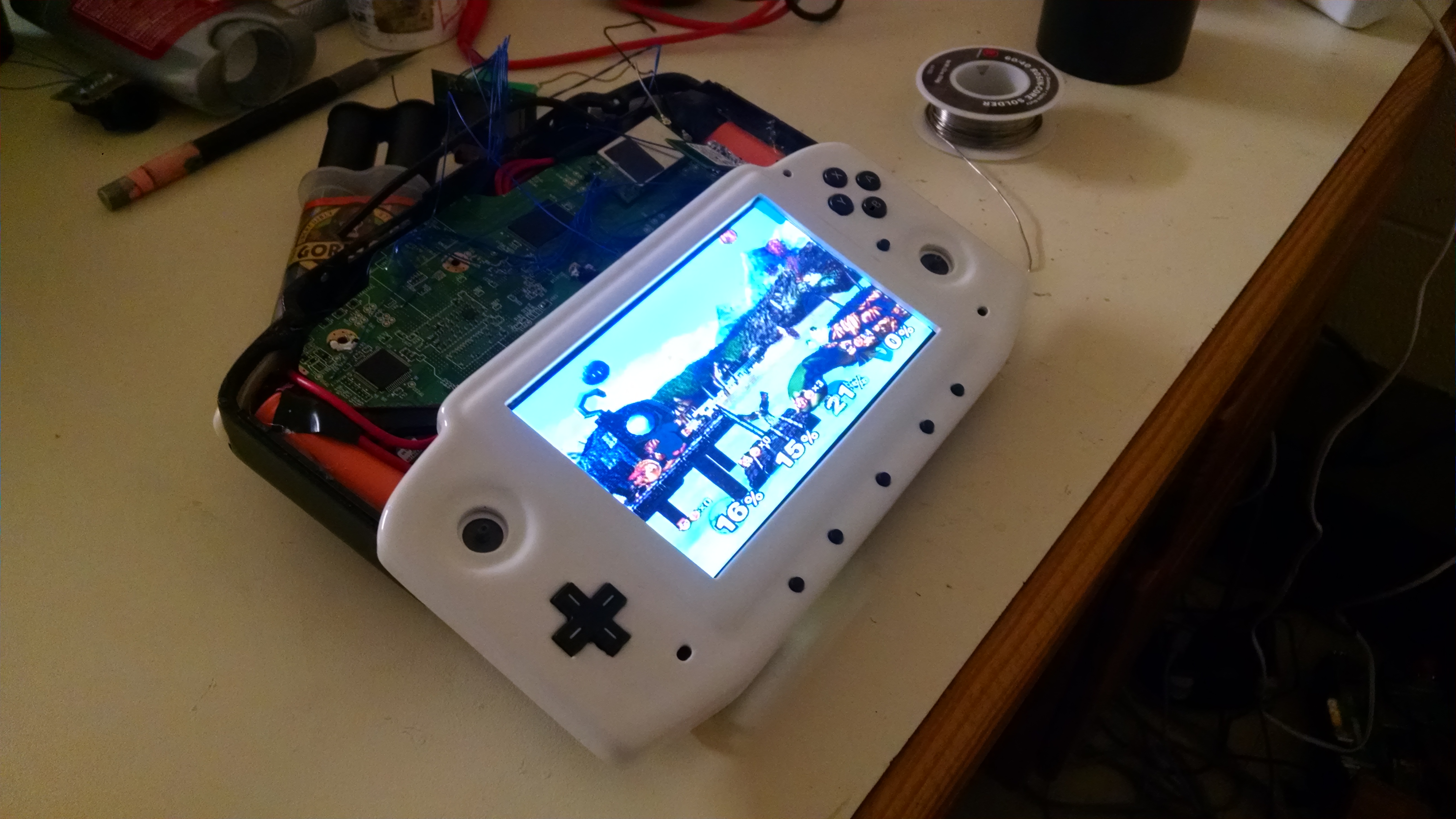

Ooh damn, this will be amazing. Glad to see you're going to be the first to make a decently small Wii portable.
I can envision the headline now for the front page...
"World's Smallest WiiNer, Made by Gman"
Kappa
On a more serious note, I think it will be the smallest, no?

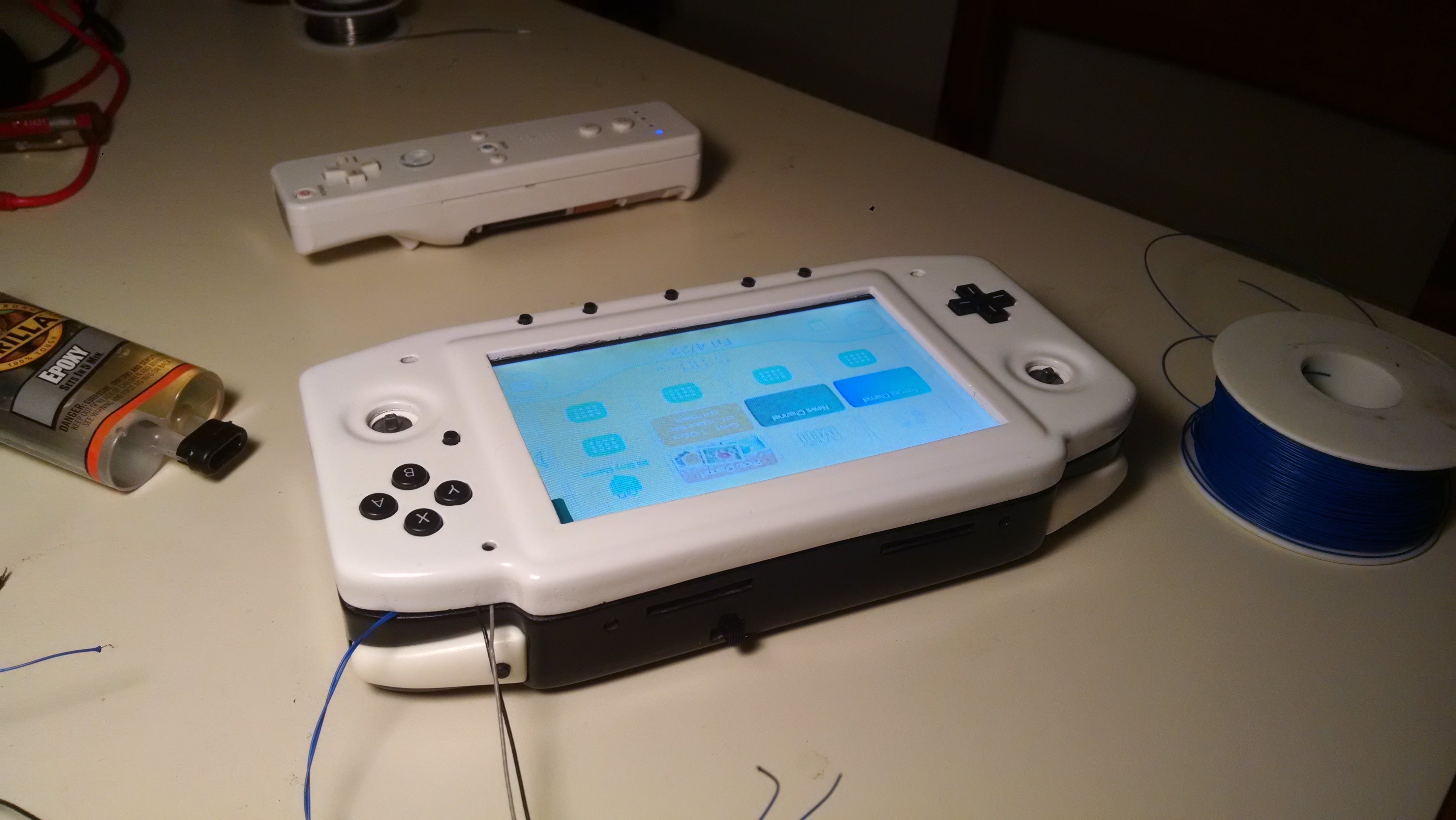

Hell yeah it's the smallest. First Wiip with custom regs and trimmed past the outer ground!
The fusion rev 3 case is actually the smallest GCp with internal batteries. The fusion rev 4 is a few mm thicker than that case however. Somebody can still make it smaller though :)
AWESOME!!! Looking good. So you got the wifi relocation working then? Stable?
I havent tried connecting to the internet yet but the Wii boots every single time so that's all that really matters right.
