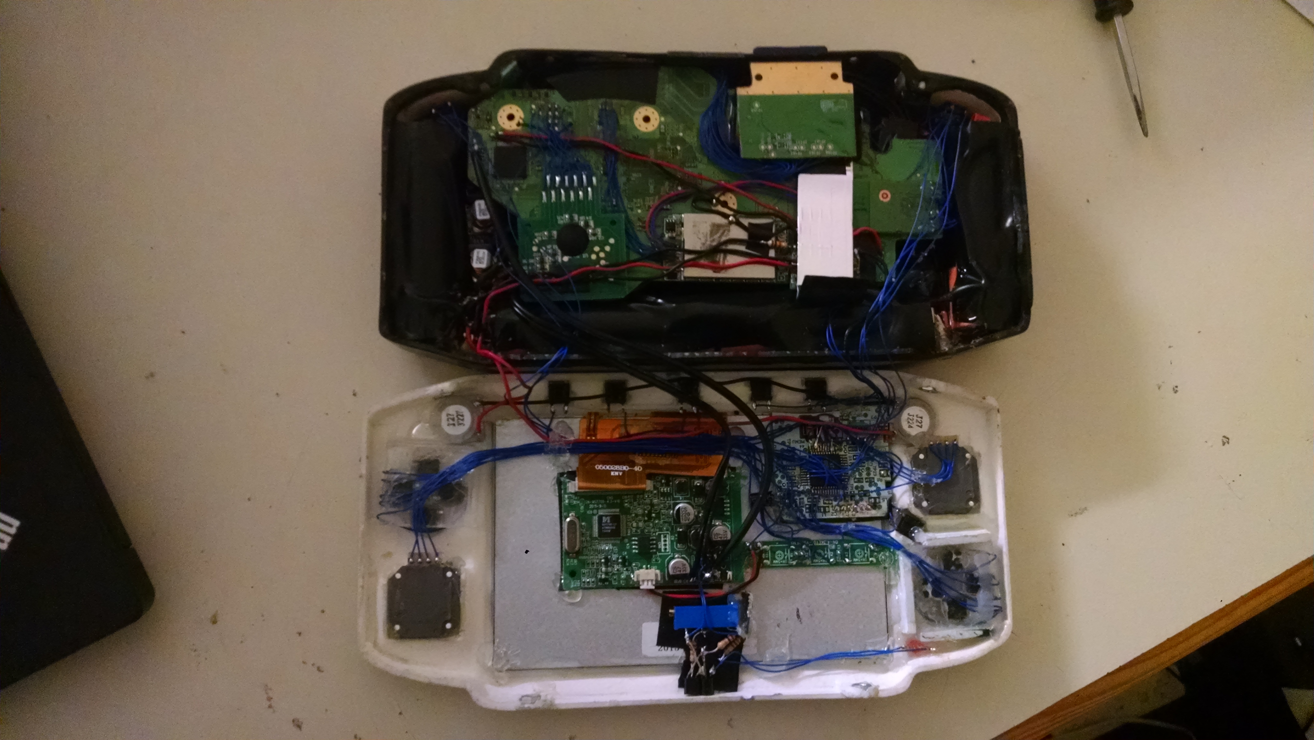

The last Wii started having problems. Couldn't figure out what was wrong with the video even after removing all the wires and sanding the board again. Trimmed another Wii and wired everything up, worked first try :) Even got the mem card in and working so looks pretty done to me.

Tested Battery life. 3 hours 45 minutes @5600mah batteries. The first 2 hours I played an NES emulator which may have an effect on the amperage but I'm pretty happy with this considering a normal GCp usually lasts around 2 hours :) Will also probably reduce the current if I remove the useless memory card.

Yep all functions working. Threw a wasp in there just so I can say full compatibility too. Been playing it for a few days now, its awesome!
