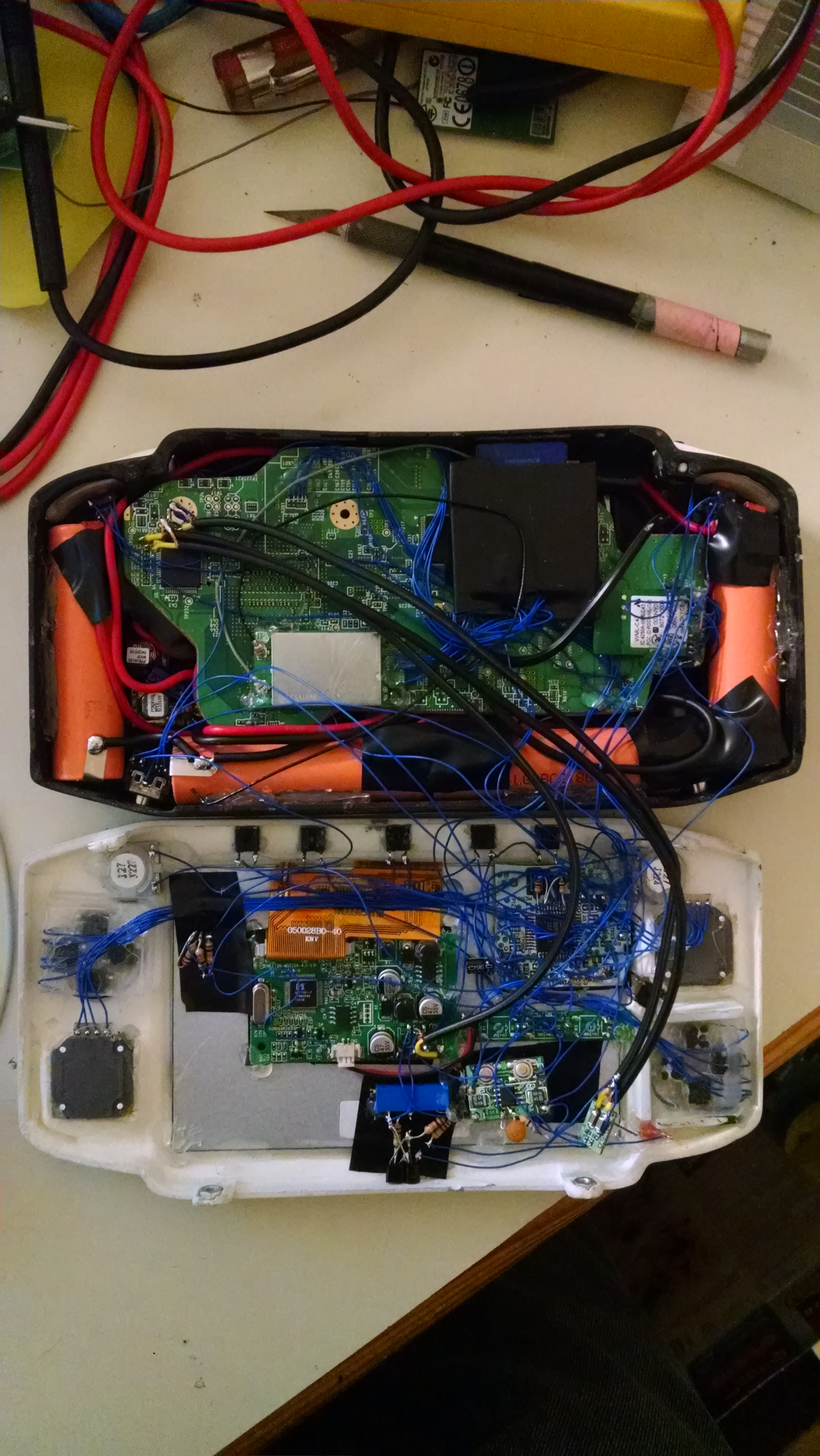

So the circuit works when I disconnect it from the screen button and just touch the wire to ground. I guess I could use the audio amp volume button as the sync button. I dont think activating the sync randomly should mess anything up right?
Hmm I don't thin that it could cause any problems, but I don't know how pressing repeatedly the sync button will affect power consumption
Ok wired it up and the bluetooth is not activating sync. I can confirm bluetooth is functional. It goes from 0v to 3.3v as desired. Looked at a stock board and there is a 10k pullup on the bluetooth that I didnt relocate to the bluetooth module but we did add the pullup on the transistor so idk.
Are you sure it is a pullup?
Wow Gman, why's your work so clean? On a serious note though your work is great!
I can't imagine how this thing is gonna be when finished.
Haha thanks. I've done clean work before but I would not describe this as clean lmao. Either way, it works :)

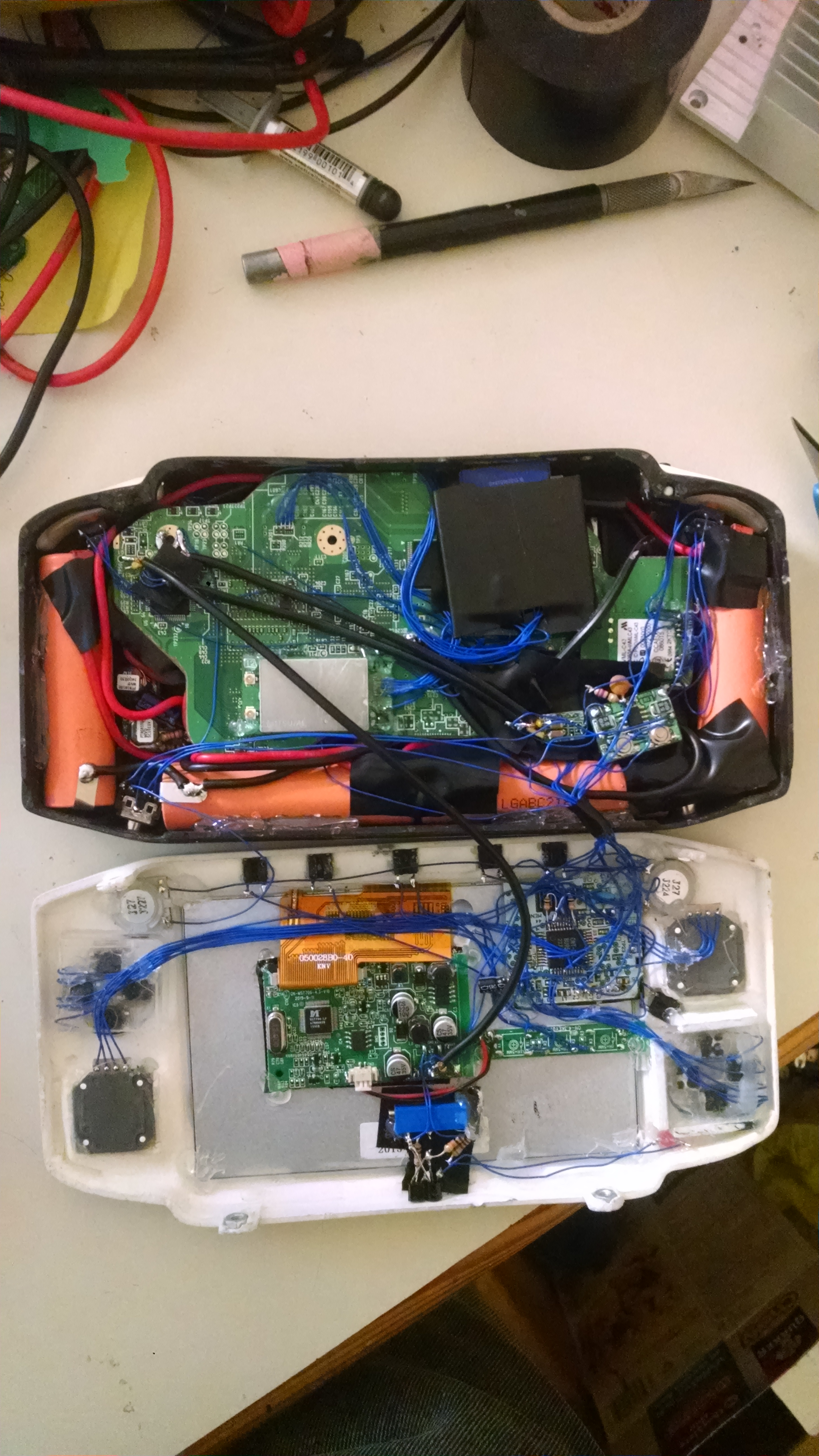

Cleaned up the rat's nest :awesome:
Quick question, did you cut the pcbs off the end of the wifi antenna wires?
Ok you got me, I did not know the wifi antennas clipped on, so I cut them while I was figuring out my case. I will be reattaching them eventually
Also cleaned up my wiring a bit.
