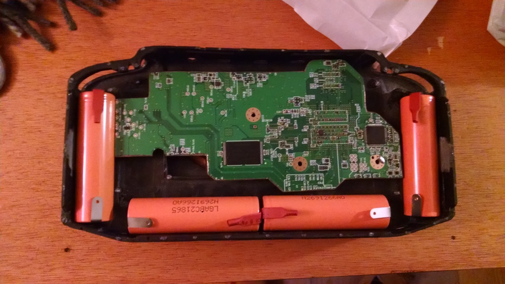

Just got another Wii in the mail today, when I opened it, a penny fell out of the disc drive. I'm getting good feels about this board.
Powering the GPU and CPU separately since there has been some concern with shorting them.
Also this.
That's legit. I love the little baggie spacer between the mobo and the regulators. One time I used a biscuit for the same purpose.
That's one of Ashen's cases, right?
Yeah Ashen gave it to me like 2 years ago and finally just getting to it now lol, I'm glad I waited. I'm doing some filling/painting on the case currently since this was one of his first trial runs that he didn't get perfect, still pretty sweet though.
You really need to hop on the Panasonic train. 3400mah 18650s. I've got 12 and they're awesome.
So I've heard. Will be trying them out at some point but they are also 5mm longer than these so wont fit in this case.
Explain more? The ones I have are 65mm long. Are those 60?
Oh nice, where you get them? The ones on battery space have a built in pcb protection and are 70mm long. I only trust battery space though.
