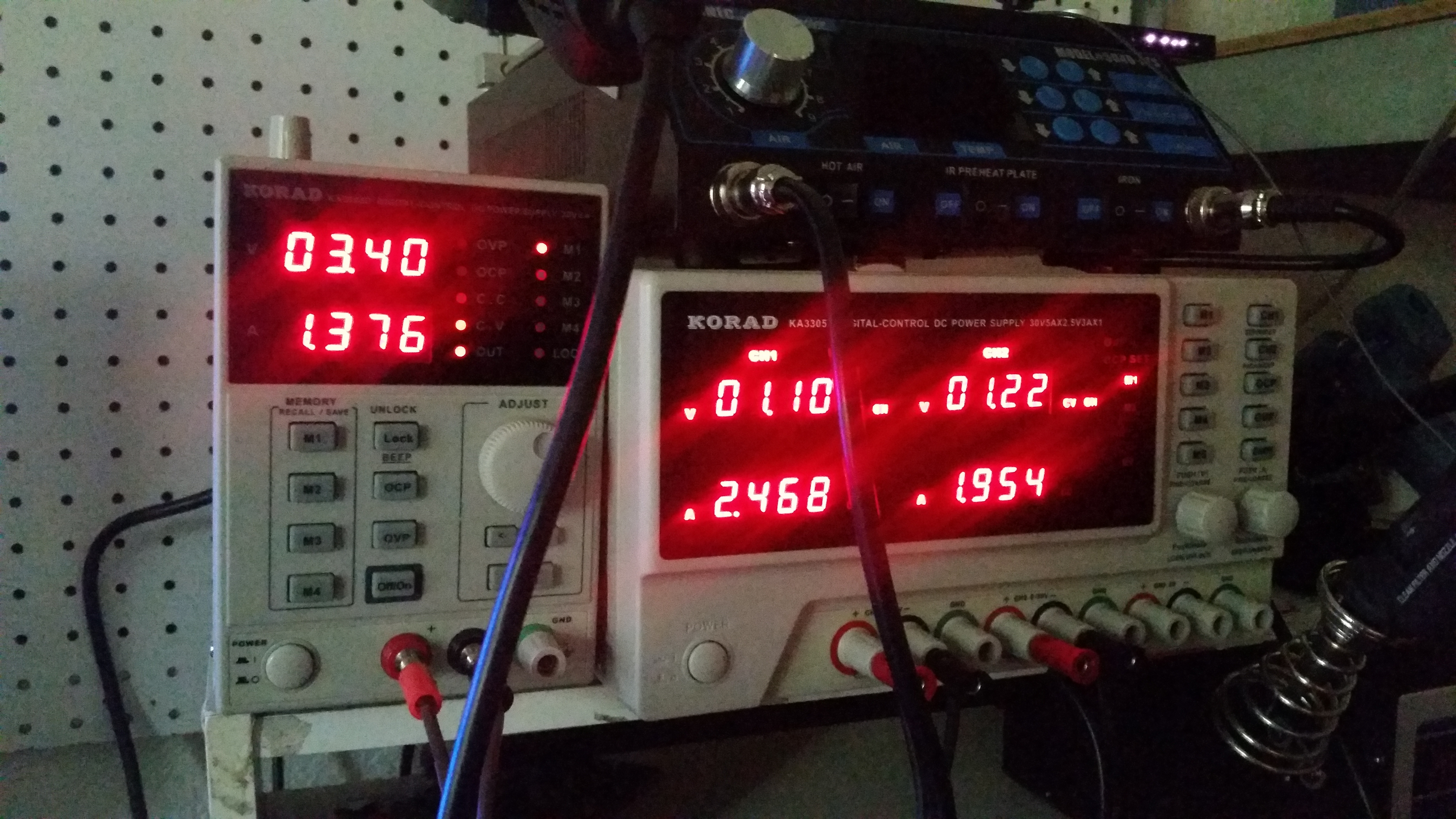

No Wii is safe from regulation. The 01 has been successfully run on custom regulators. Shorting the RVL-01 and RVL-10 exclusive 1.8v line to the1.8v line allows the console to boot. Here are some power consumption numbers from the home menu. More to come.
As for power consumption, Its not looking good, but it's still looking better than a GameCube. Unfortunately my original estimate of "about twice as much power" is accurate.
For frame of reference, the 4 layer boards use ~5.5 watts for GameCube games and about 6 watts for wii games. If the wii uses 20% more power during gameplay than the wii menu, it will put us right at 2x.

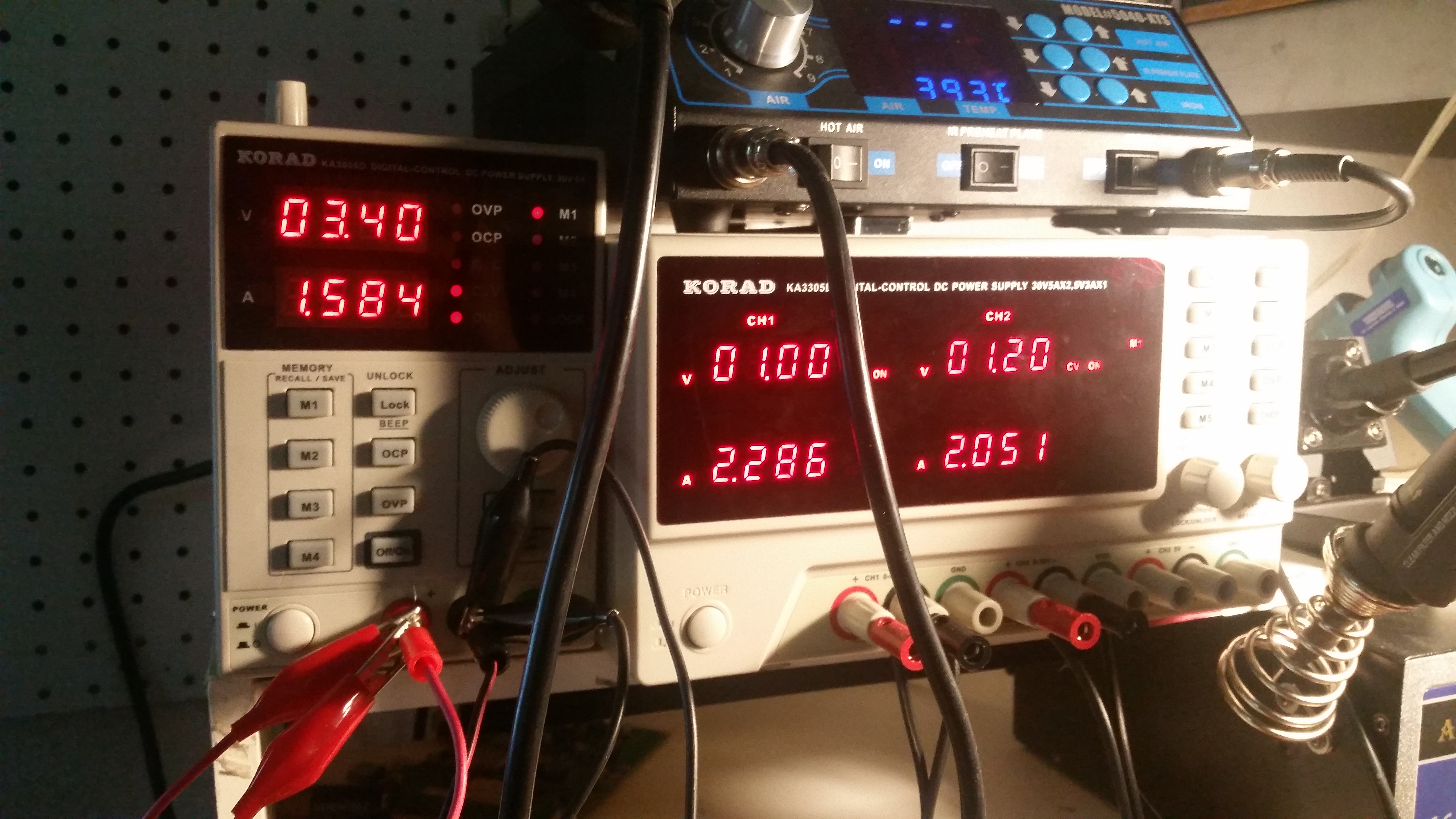

However nintendont, as usual, works without a hiccup. I encountered some graphical issues, and raised the voltages until they were resolved. Here is the power consumption tests for meleeeeeeeeee
That's strange, the power usage went down... 9.777 watts... The 3.3v (3.4? in your test) line went down nearly a watt.

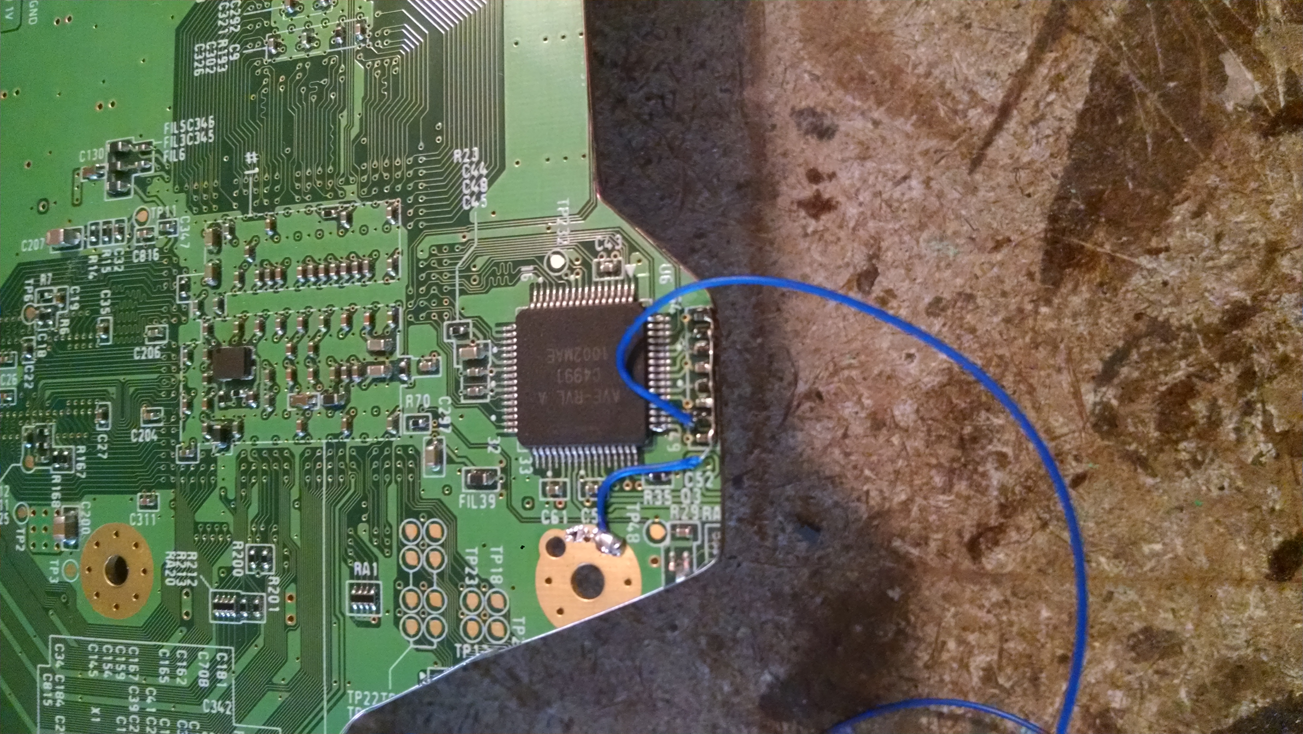

Since the AVE runs on its own 1.8v line, I was curious what would happen if I ran 3.3v to the encoder. The board continued to work and output video. The chip did get warm after a bit.
Even more interesting, increasing the input voltage resulted in an increase in the voltage of the digital signals. Applying 3.3v to the line that powers chip results in the GPU outputting 3.3v to the AVE. 3.3v is the voltage the DOL AVE operates on, so this could be useful information. But again, DON'T DO THIS unless you want to fry your board.
Ok, now the other thing I noticed is shorting the power source of the AVE to a few of the 8 data lines of the AVE (individually) made the screen turn green in different ways. Maybe this could be used to identify which data lines are are which?

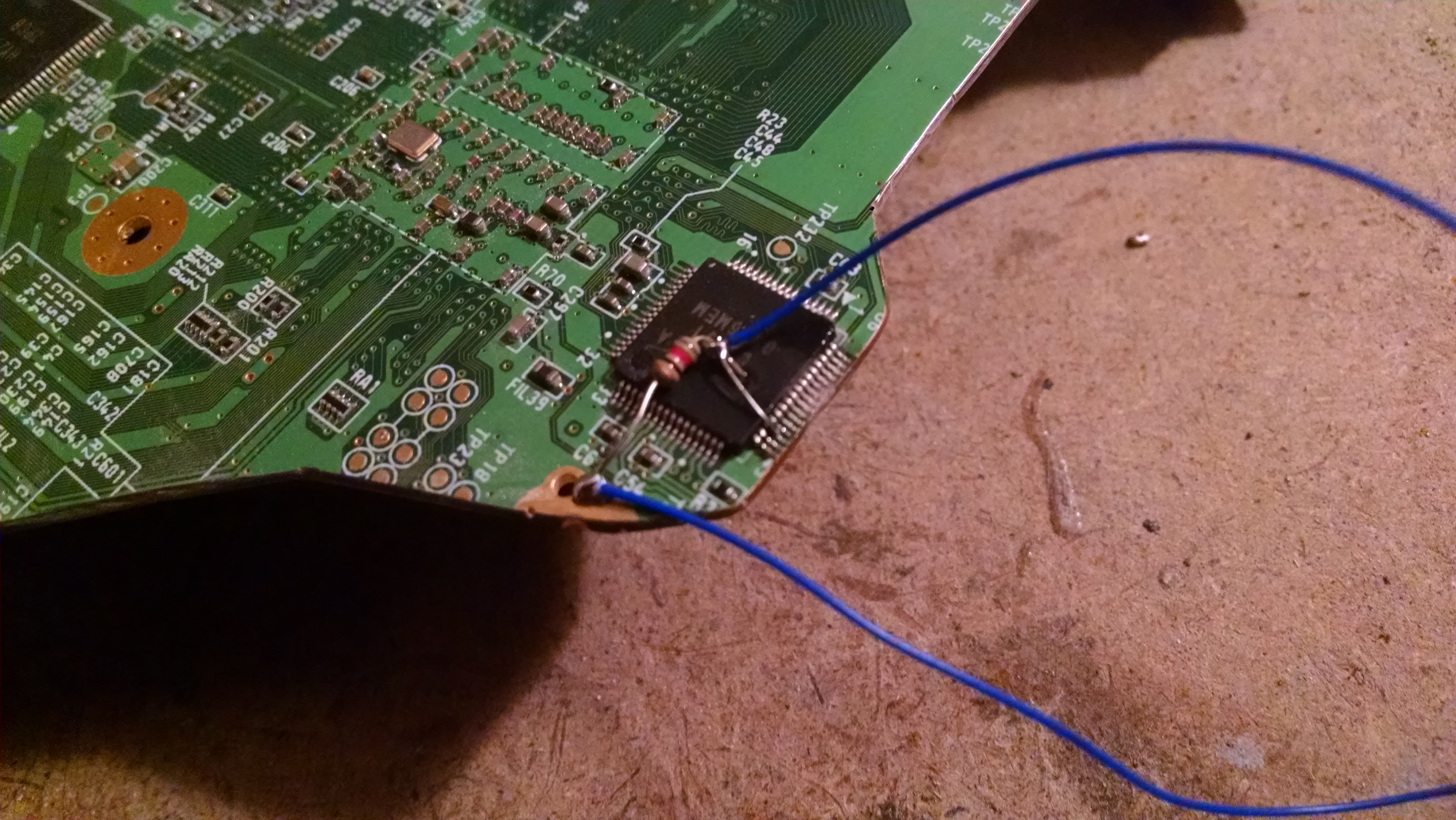

Already removed all the smd parts on the video encoder on this board so decided to trim it all the way. According to Shank's Super Meme, R44 is a 75 ohm resistor. All I had on hand was an 82 ohm, close enough :) Composite works again with just this one resistor connected to the video output pin to ground.
