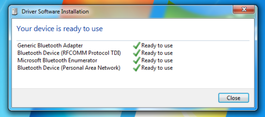

Oh my god. Plugged it in Windows size.
Installing drivers
Your device is ready to use

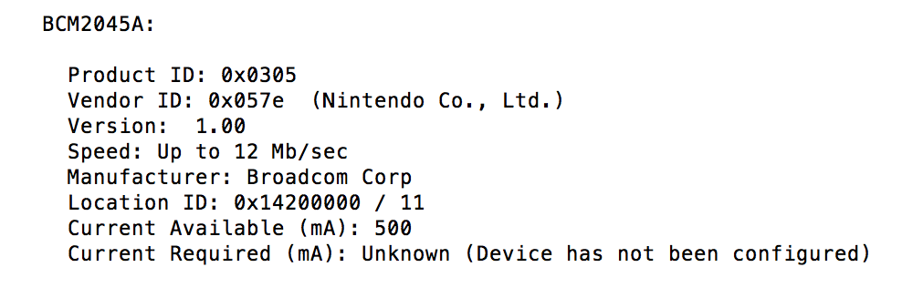

It shows up on my mac.

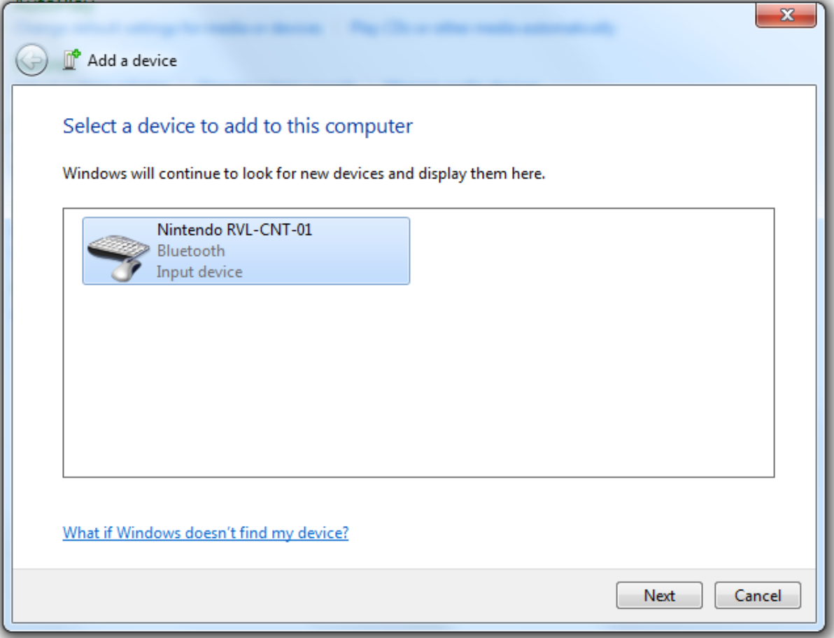

Windows 7 sees it, and knows what to do. I wonder... If i grab a wiimote and hit the sync button on... No. theres no way.

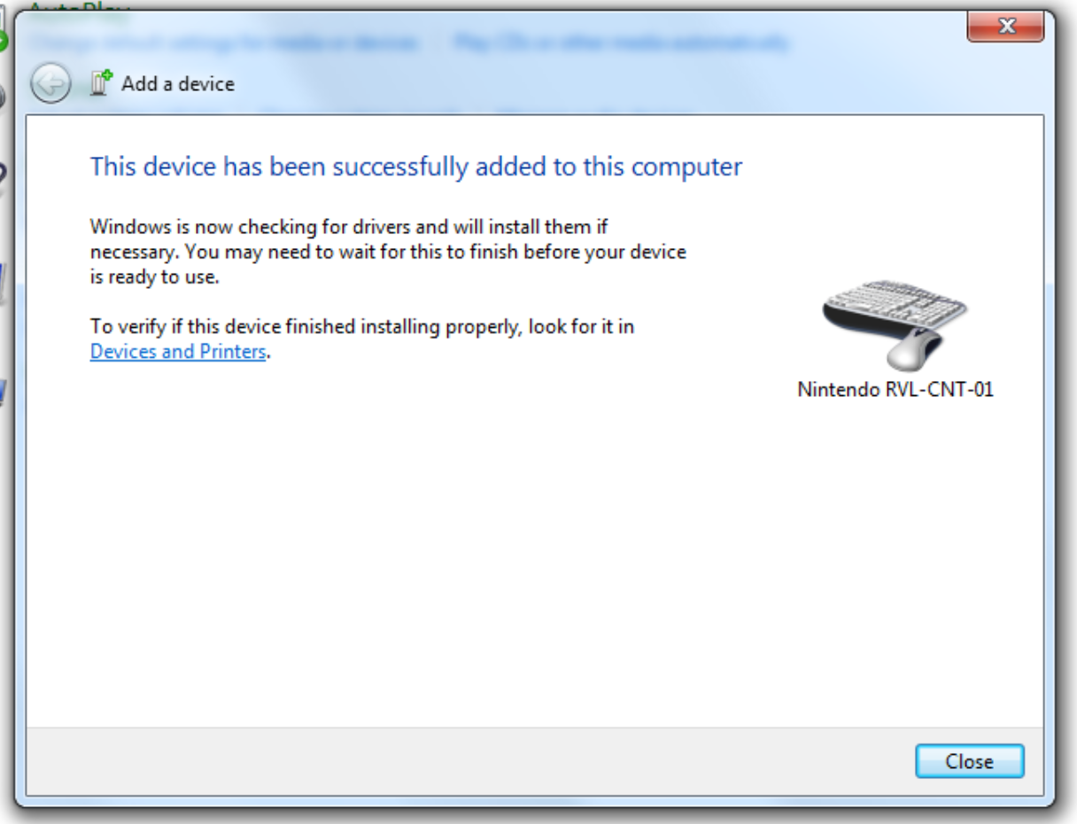

This can't be real. Can I really connect to my wii remote on my computer by plugging the bluetooth module through usb into my computer?

This is not incredibly surprising, I was actually going to try this myself at some point. The Wii's BT is literally an off the shelf USB broadcom chip (with possibly some slight hackery going on that isn't normally possible with a standard module, not sure). In any case, I've been working on a replacement.
Kind of disappointing that it doesn't work on a different port, that would make it easy to just rip out the bluetooth module and plug the spoof module right in the back for testing or temporary use, but whatever. Also interesting that the speed is listed as 12Mbps, which suggests full-speed USB. That's what I figured, but wasn't totally sure. Good to know, thanks for the info :)
