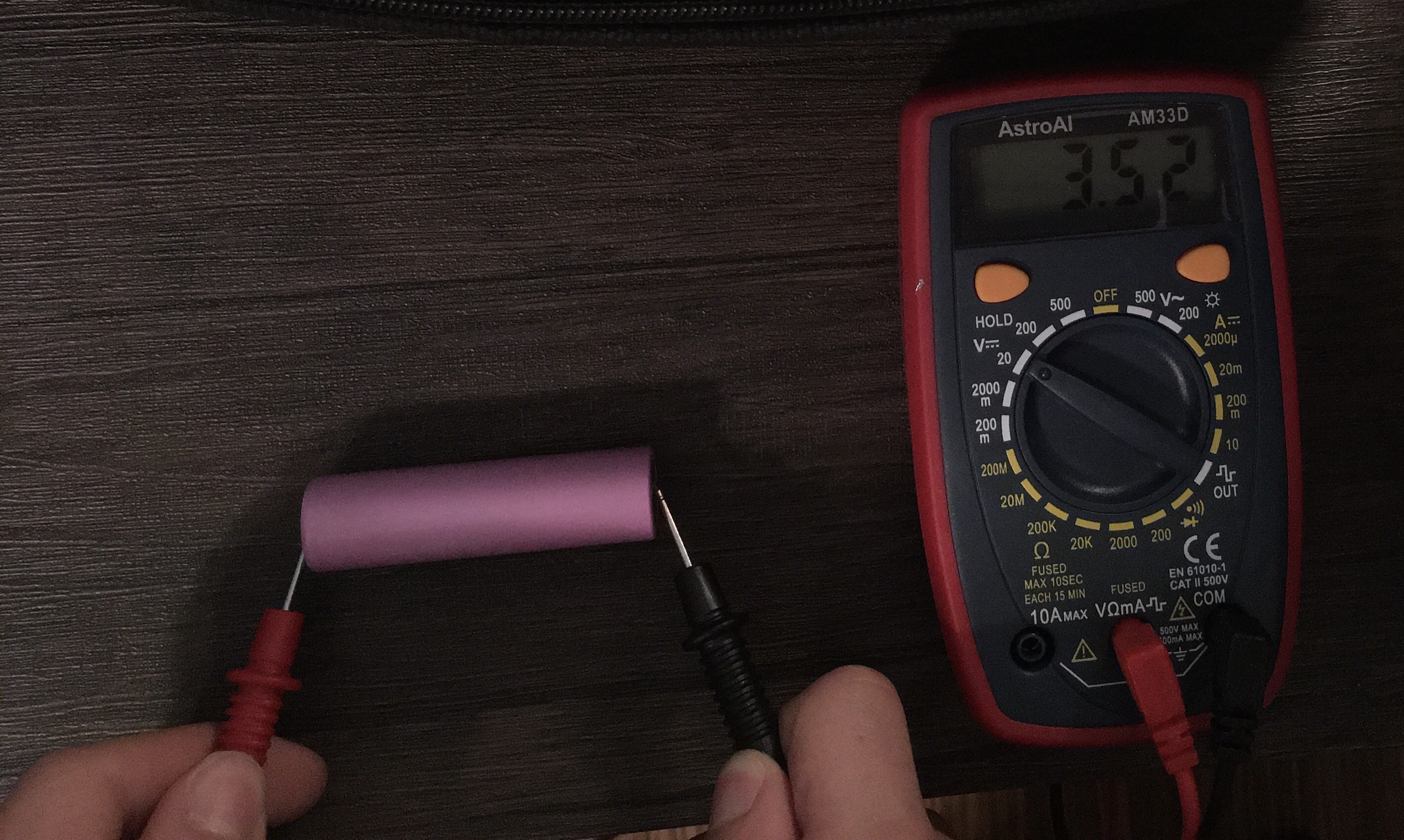

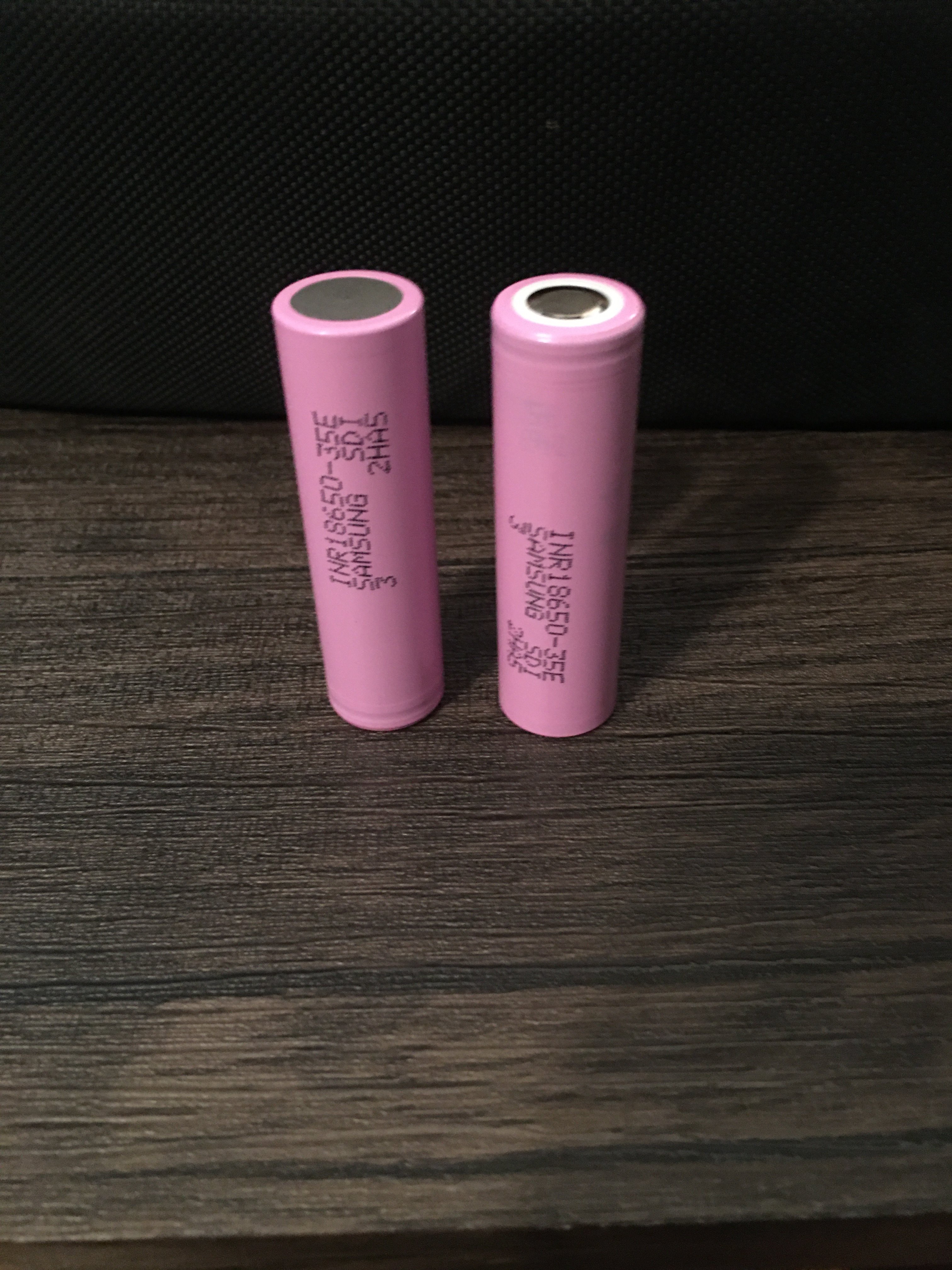

Big Update: The two Samsung 18650s just came in the mail and their voltages are both a hearty 3.52V
Later today after I finish up work, I’ll solder them up in the portable and make another post here about the result. I’m super excited!

And 3.5v might be a bit to low to boot the wii, I'm unsure, but if it does not boot, you can just charge them for a while and try again later

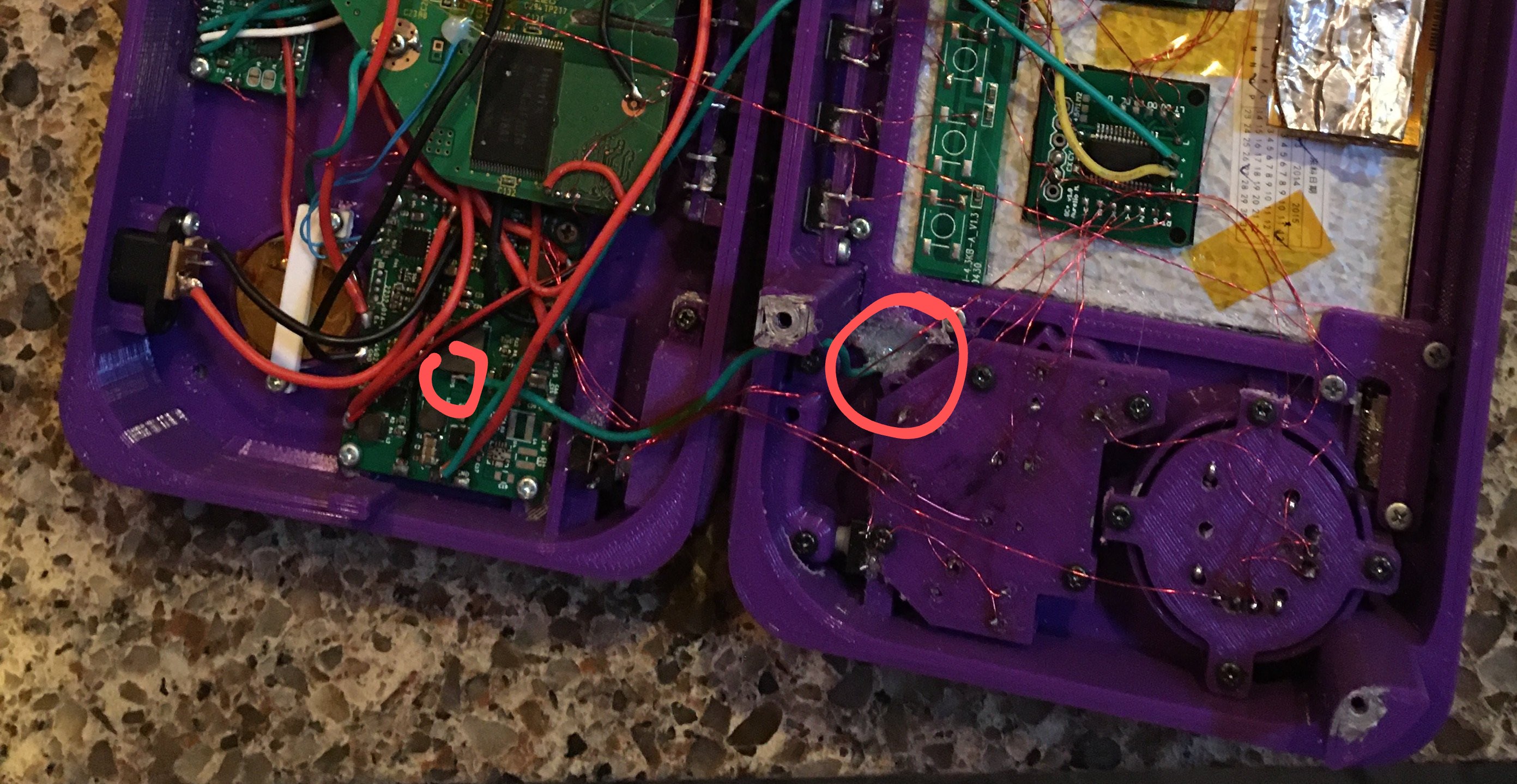

Just to throw my 2¢ into the mix, I was looking at the rvl PMS in this build and was going to mention when you have your new batteries wired up you could check the vsys voltage of the PMS to see if the BQ chip for the charger wasn't accidentally fried.
I did notice on the PMS there's a stray wire that looks to be in a location tied to vsys and hotglued in else where, I attached an image with the locations circled. Can't say if this wire is a problem but the location it's soldered to on the pms is a great spot to check voltage here for the battery chip for vsys.
Gotcha. Will check this out tomorrow. Thanks for pointing it out!

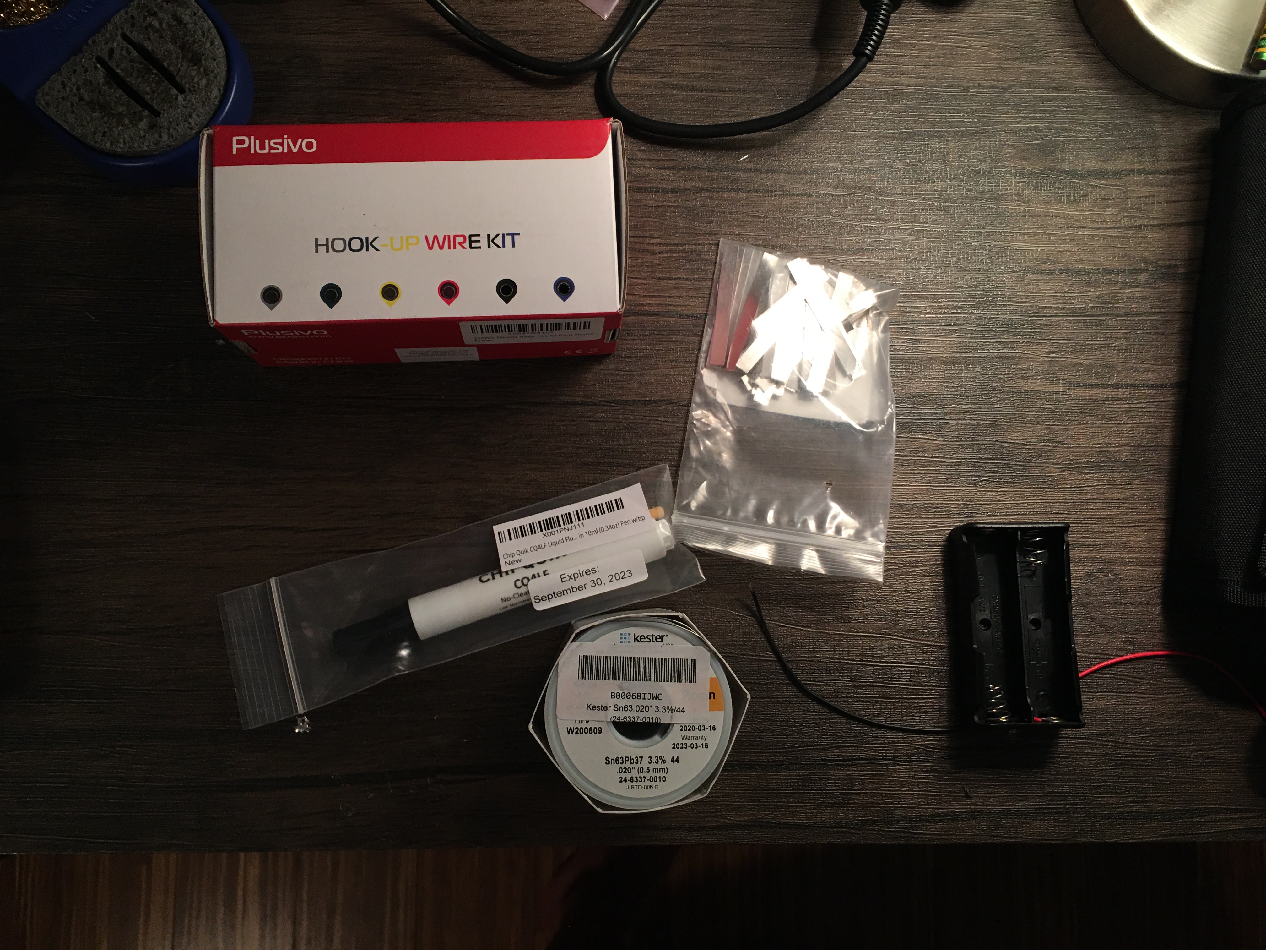

Some things to assist me in hopefully fixing this portable have arrived, including an 18650 battery cell caddy, 22 gauge wire, a flux pen, 1lb of kester solder, and nickel strips (for soldering the batteries when it’s time to close it up).
Some more things that still are on the way include: 34 gauge magnet wire, another set of 18650s cause the first were sadly drained, and an RVL-PMS 2 from 4layertech, just in case I can’t fix this PMS (and if I can fix this and don’t have to replace the PMS, I’ll most likely save the PMS 2 for a potential portable I’d build from scratch).

Be careful that battery-caddy seems to take two batteries in series, not parallel!
Batteries in series increase the voltage, while parallel increases capacity.
Having the two batteries in series doubles the voltage, which will exceed what the PMS is supposed to handle.

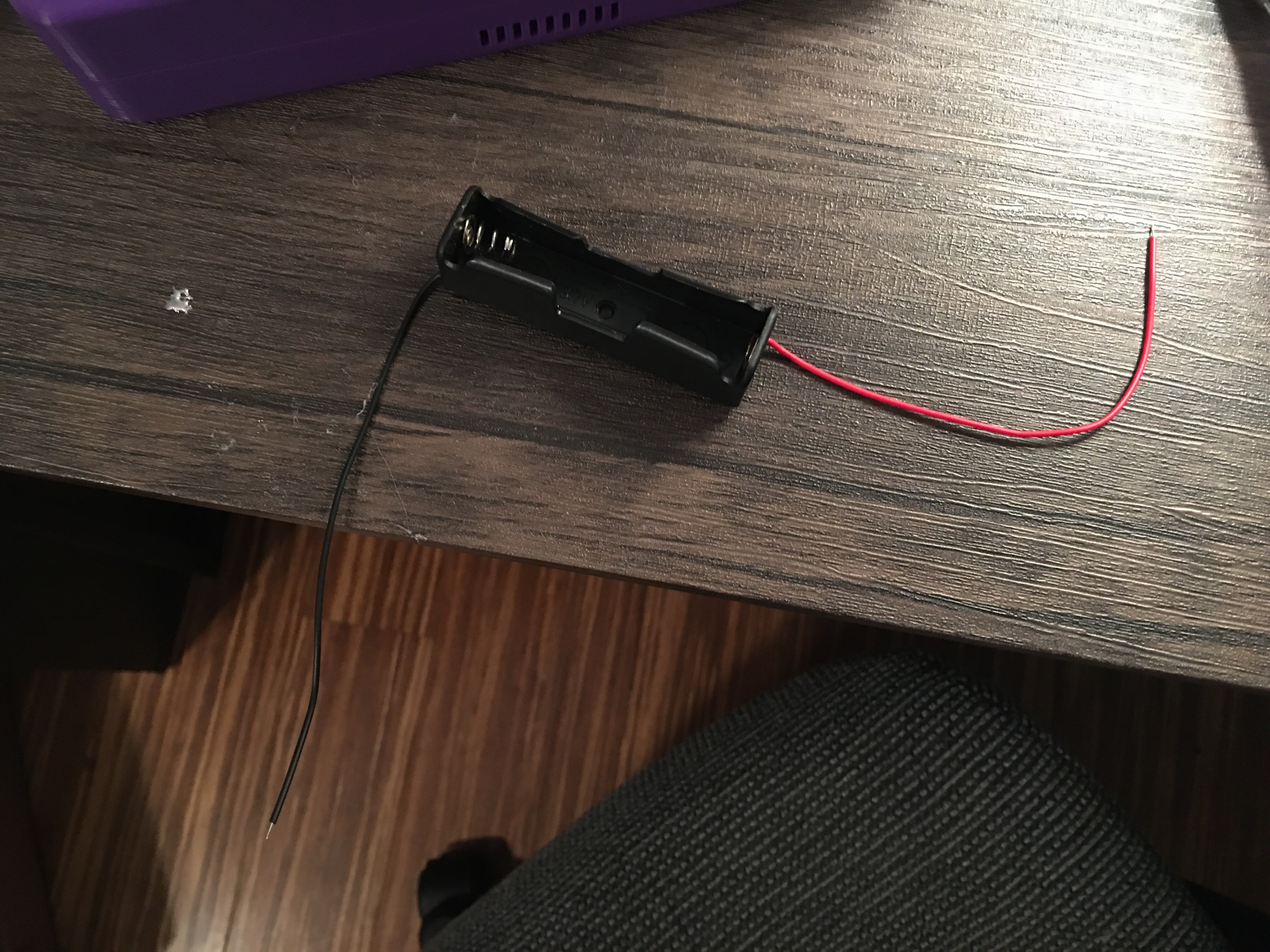

I have multiple caddies, there is a single celled one which is what I’ll most likely use for testing because as you said, multiple batteries only extend run time. Will this caddy work?
