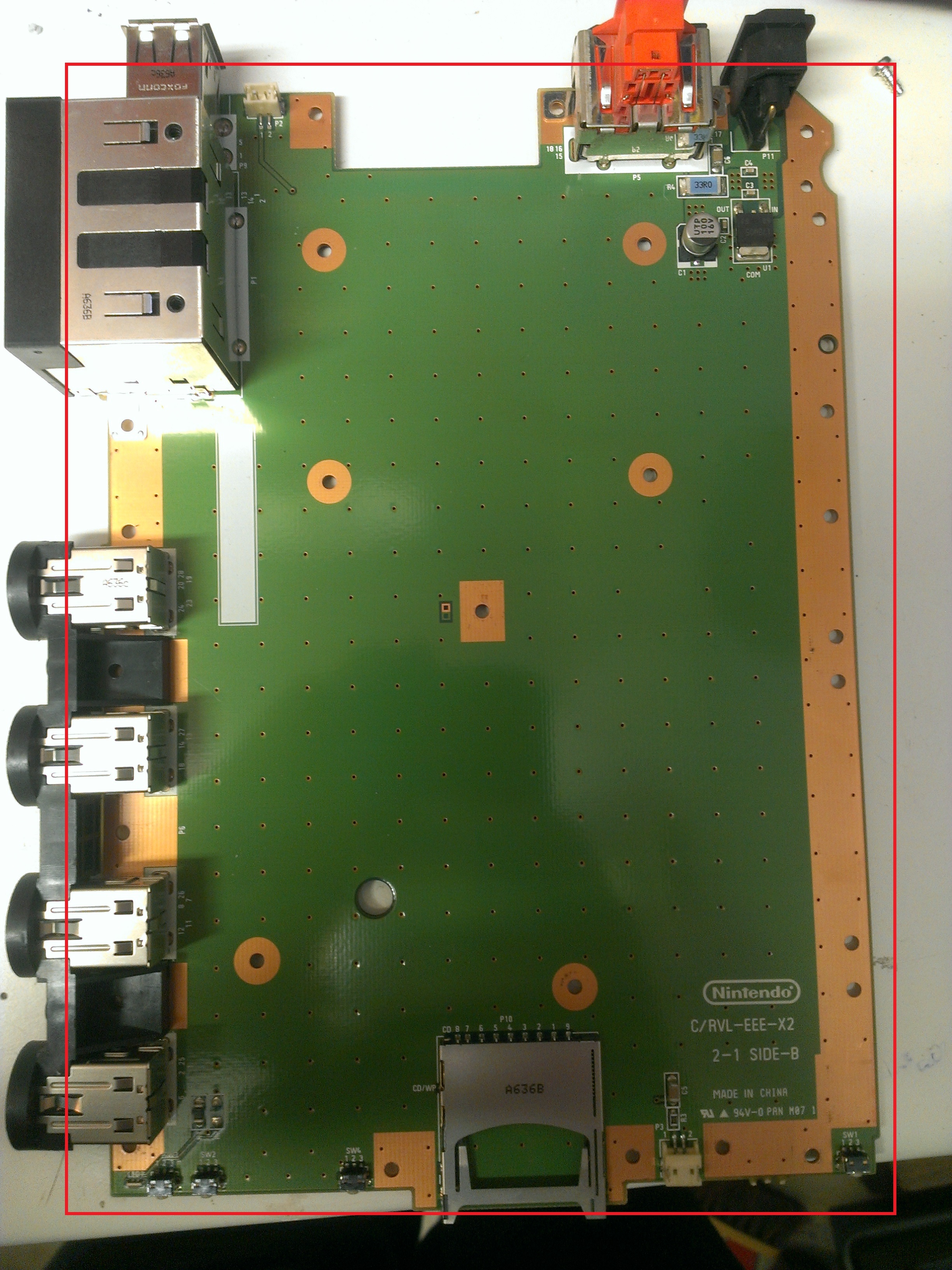

I have a RVL-CPU-40/60 (haven't checked) Wii that came with motion plus from 2011. It may also have boot2 as well, I'll try and check but the most likely scenario is that Noah's Wii has boot2.
Every Wii has boot2, but just the early ones (before 2008) allows you to install bootmii as boot2I have a black Wii that came with motion plus from 2011. It may also have boot2 as well, I'll try and check but the most likely scenario is that Noah's Wii has boot2.
That's niceBootMii installed as Boot2 Boots without the Wi-Fi Module or Bluetooth Module!
Ok so either the IOS loaded by System Menu or the System Menu itself locks the Wii from booting.When going from bootmii to the following:
Wii menu: wont boot. Black screen
Homebrew channel boots and responds with gamecube controller. However, apps dont show up, and the wifi symbol in the bottom keeps on flashing. Maybe its trying to initialize network before it tries to load and view apps form the SD card?
