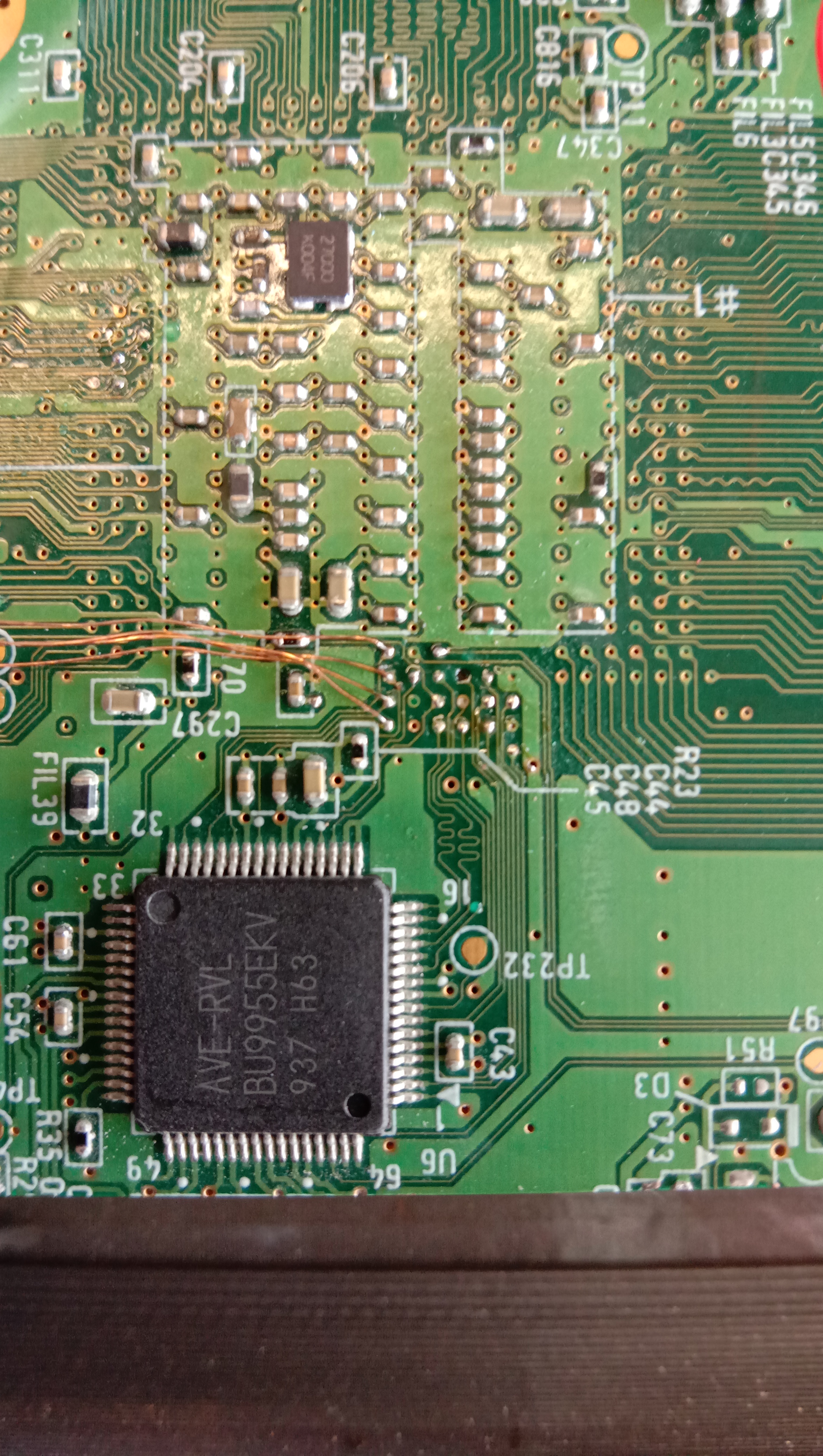

So in the process of putting it together today I made 2 crucial fuck-ups.
1) I missed the part about making sure BBloader was updated to at least version 1.2, since I ripped this board out of my Gboy it was running an older version. Kinda hard to install the update when I have no image on screen.
2) This is the proper fuck up - I somehow managed to absolutely destroy the V5 via, required for both DD and really any video output....... So this board is dead.
So a new board will be trimmed tomorrow, I've already prepped it with the correct software and tinned the required vias so hopefully no more mishaps.

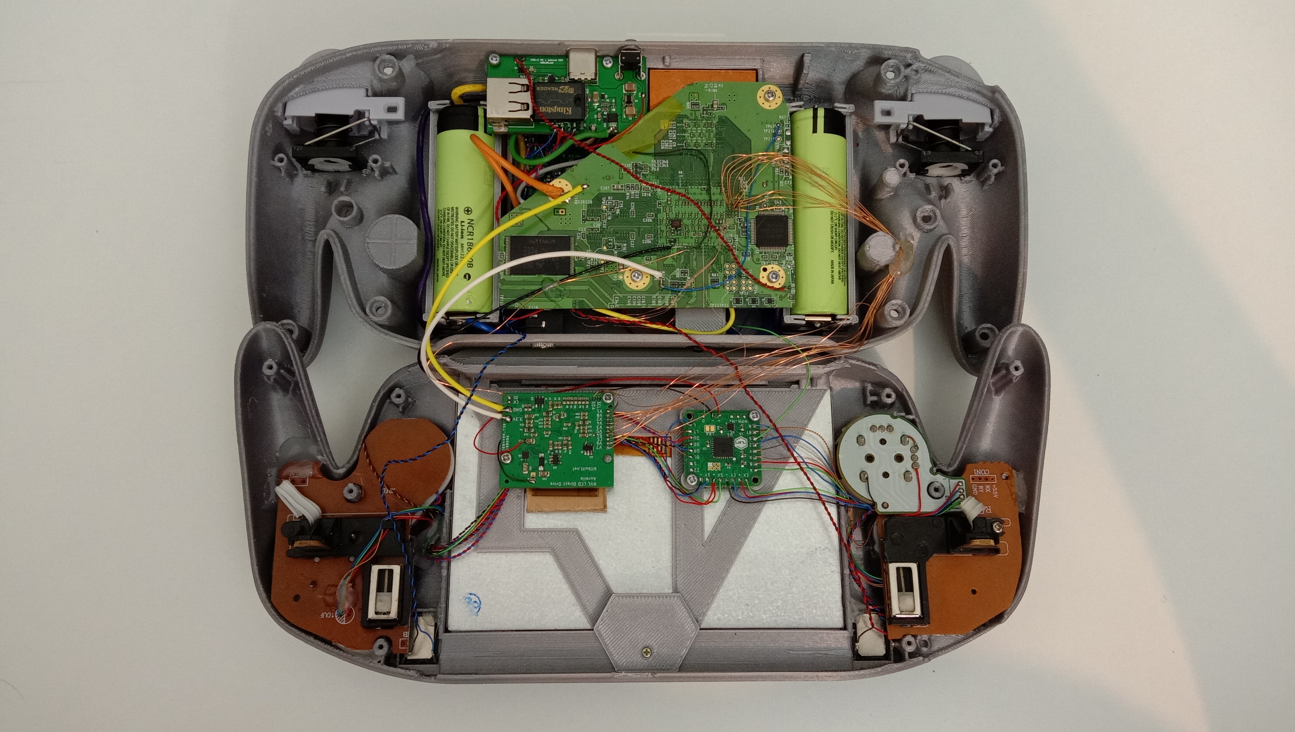

New board has been trimmed and installed. Spent a big chunk of the day testing and making sure everything is sweet.
The amount of wires required for digital audio and DD is pretty time consuming:

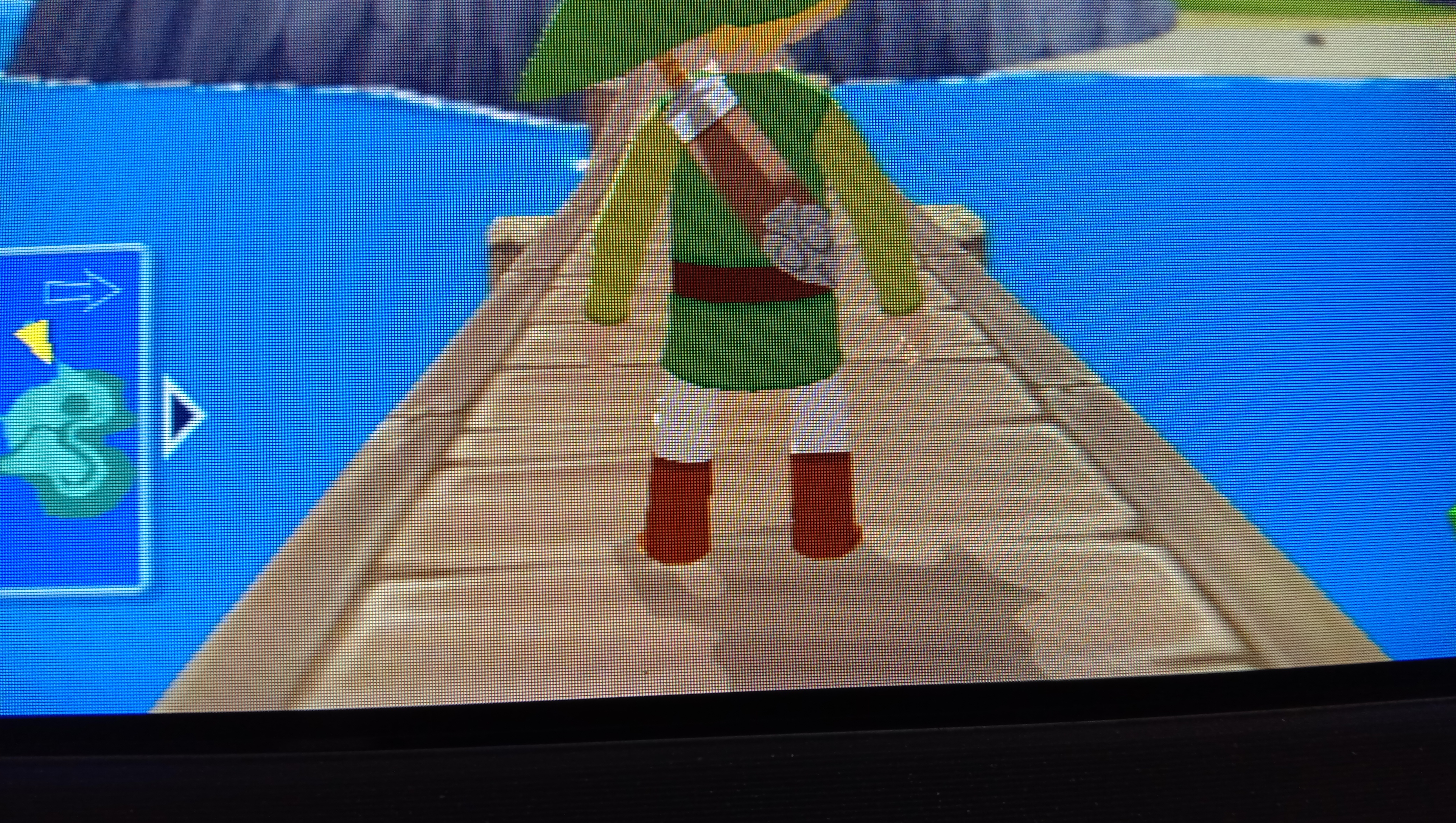

And system is running, albeit with some issues with the DD, flickering and colour changes. Could be my wires or soldering but will have a chat with Aurelio and will see if we can get it sorted.
There also seems to be some glitch with the U-amp - it works as intended but when the volume is increased close to max a whole heap of static noise is generated and won't go away until the unit is restarted. Not a huge issue as I don't need it that loud but it's worth noting.

Screen issues have been resolved, Aurelio and I have determined the issues to be caused by the FFC connector on the DD - seems it needed a little more pressure for a strong connection since the ribbon was bent. So an easy fix was to just put a small piece of cardboard under the ribbon. Now I have crispy, noise free DD goodness.

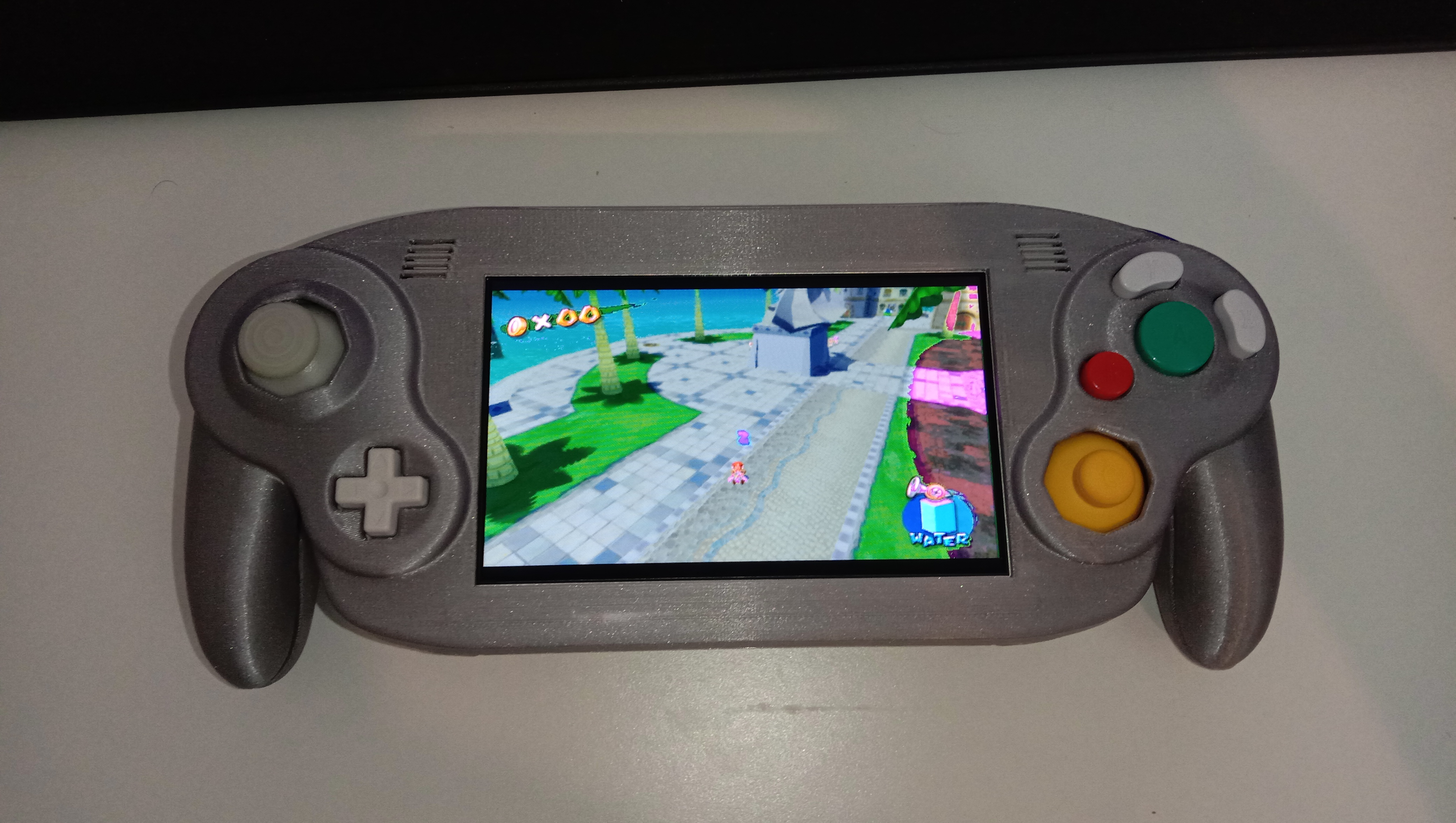

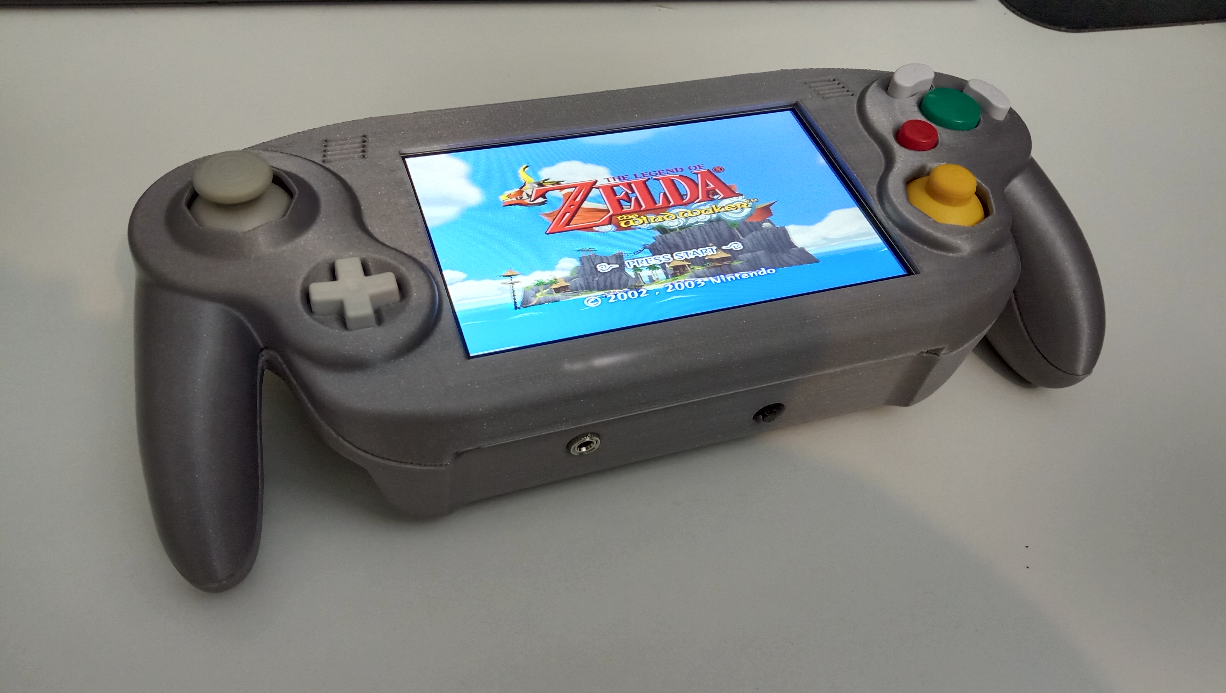

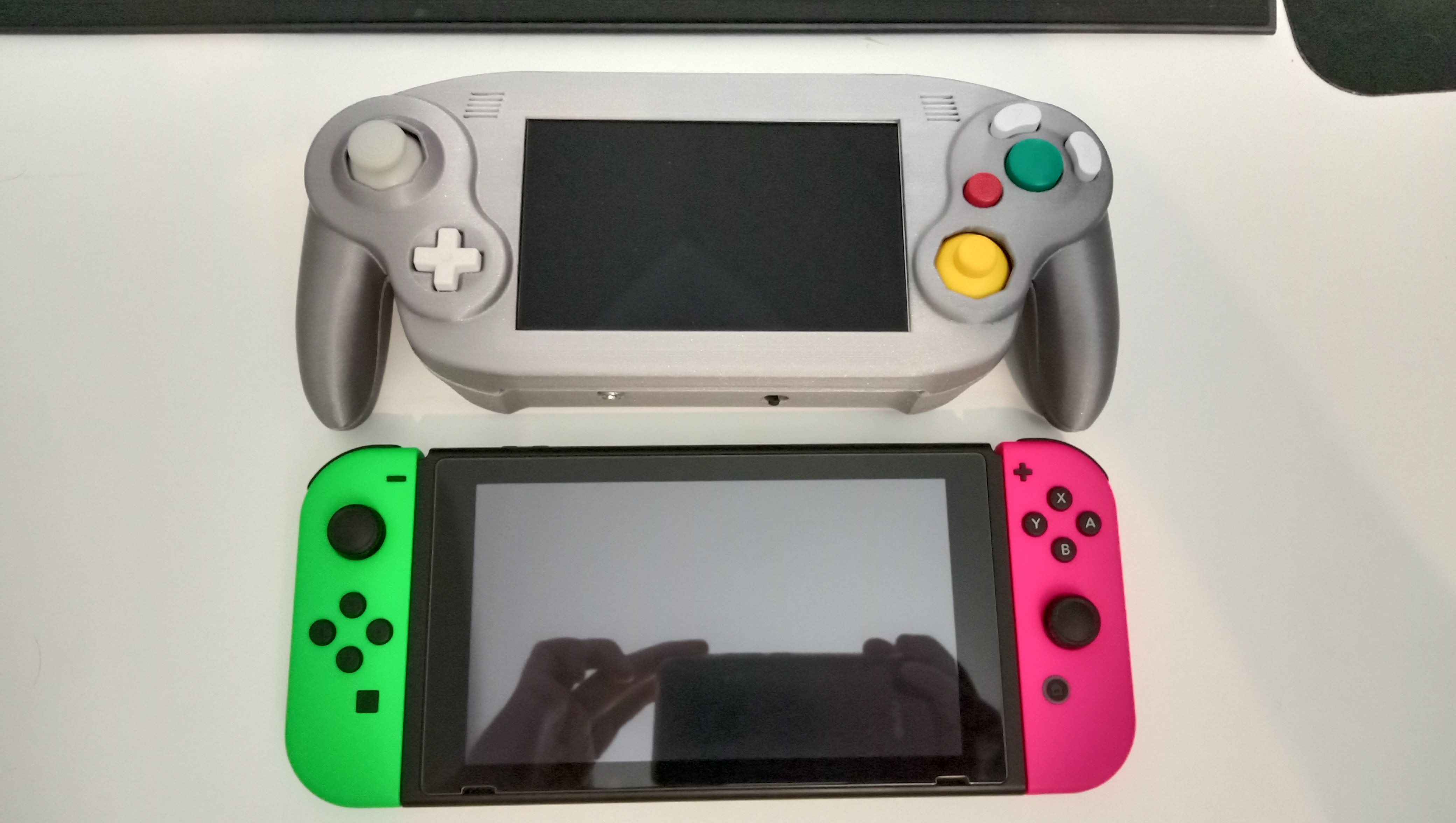

Here's a few pictures of the "Finished" product....and by finished I mean there are still improvements and adjustments being made before the 3D print files become available (larger batteries, other things).

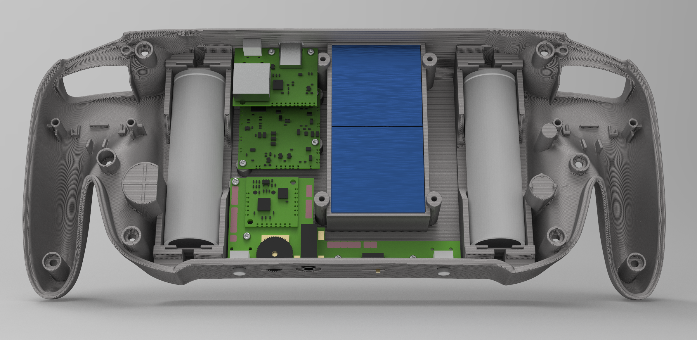

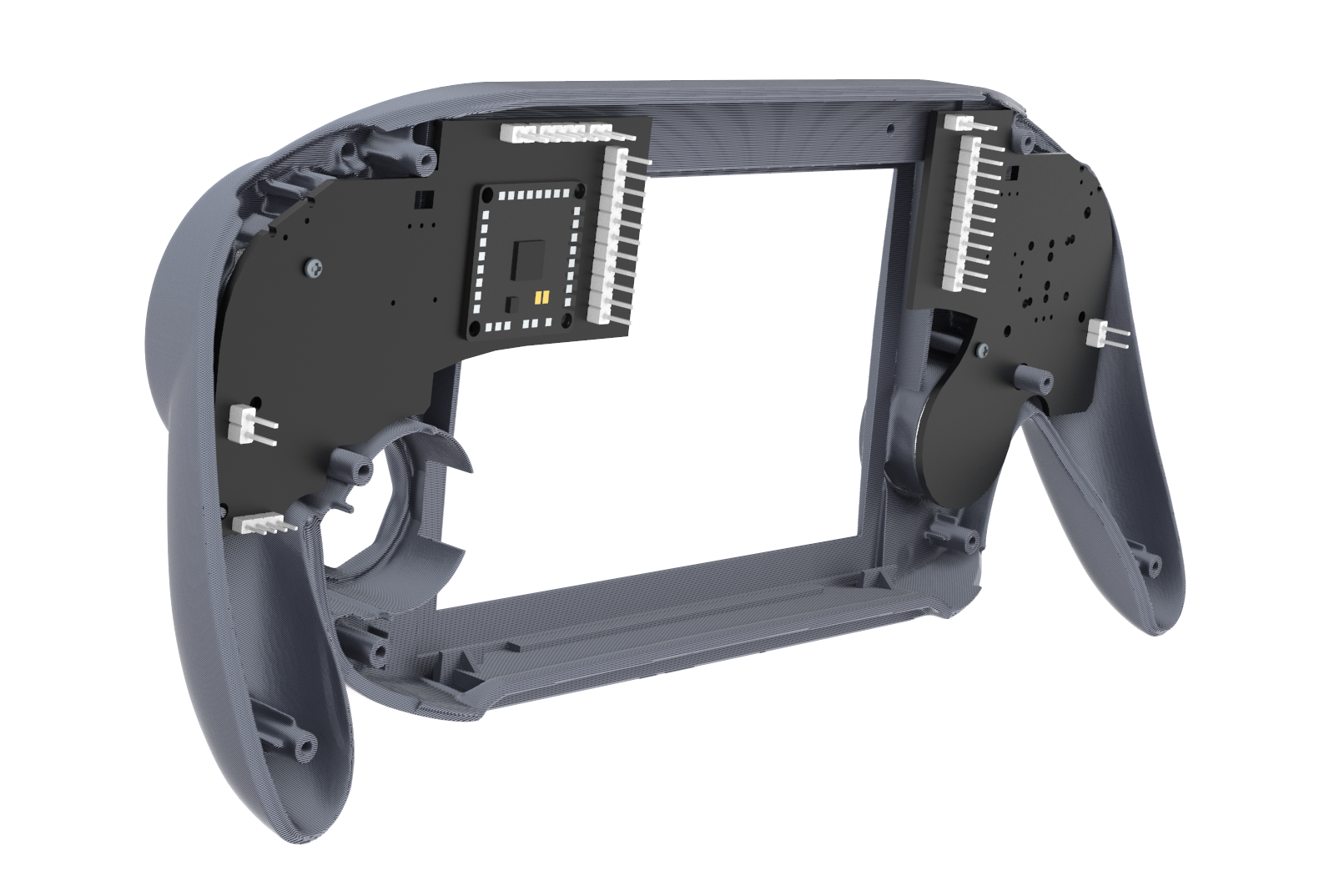

I suppose I can share a bit more information now. I've been working with @Gman and @Shank for the last month or so developing custom boards for the Ashida that will take advantage of the new boards at 4layertech.com. Files will be released when boards have been finalised and tested to verify they fit and operate as desired.
Here's some concept pictures in the meantime:
