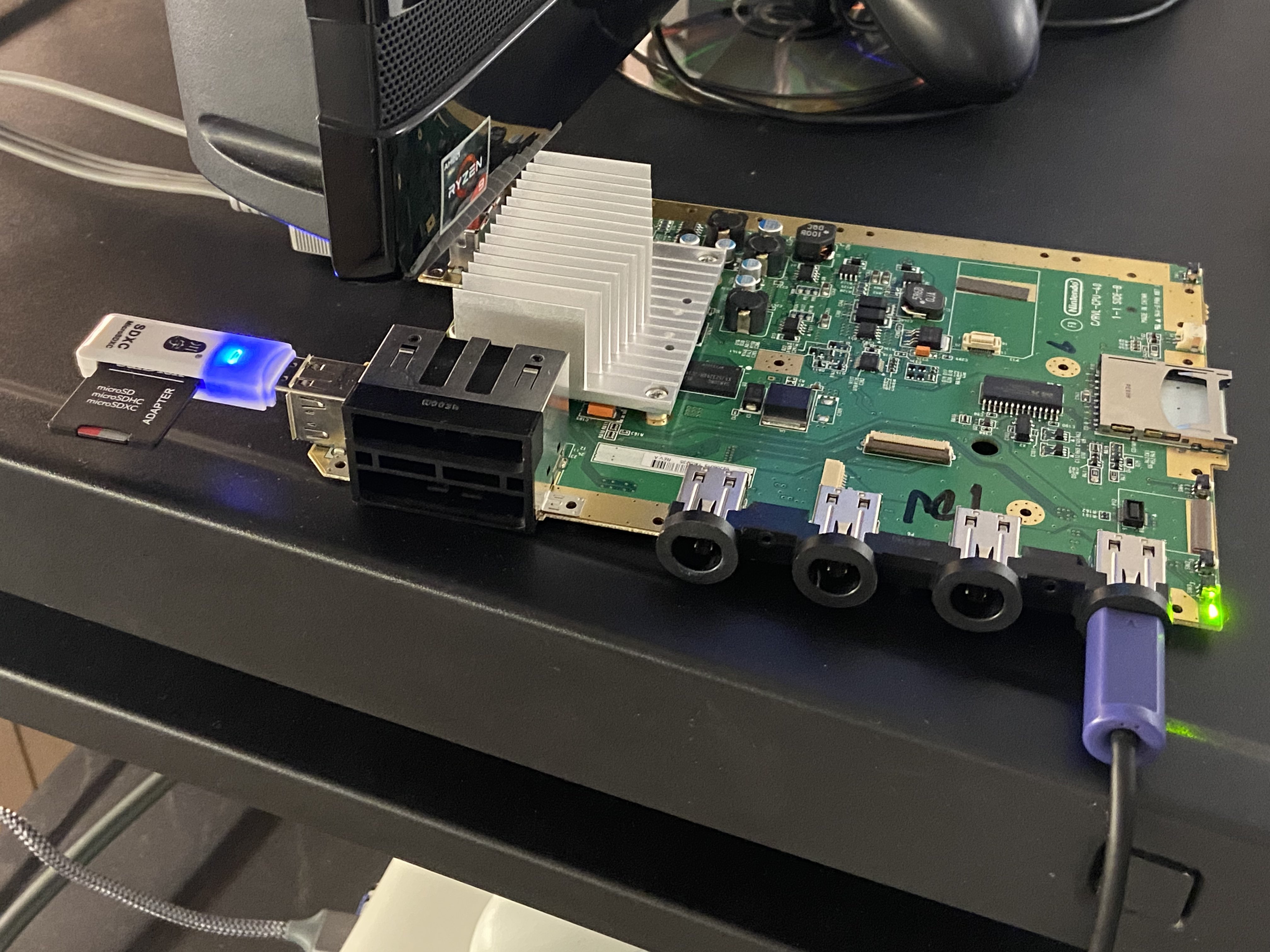

Here are some pictures of the current setup, still in the air if I will add bluetooth support, but I'll cross that road when it comes to it. Micro SD successfully boots to RVLoader and games! So far the only gamecube games I have are Melee, Sims 2, and Kirby Air Ride (It finally ripped) but I'll be stopping by my local game shop on friday to pickup 2 gamecube controllers and maybe a game or 2 on a good deal. 4LayerTech boards have arrived today, but likely won't touch them until after the trim is done, which I'm hoping to do this friday or next week. Still gotta order all the buttons and potentiometers, will do that tomorrow. Progress should likely speed up next week, hoping to also do the Ashida prints this weekend using someone elses printer. Progress: Good , Mental State: Worried

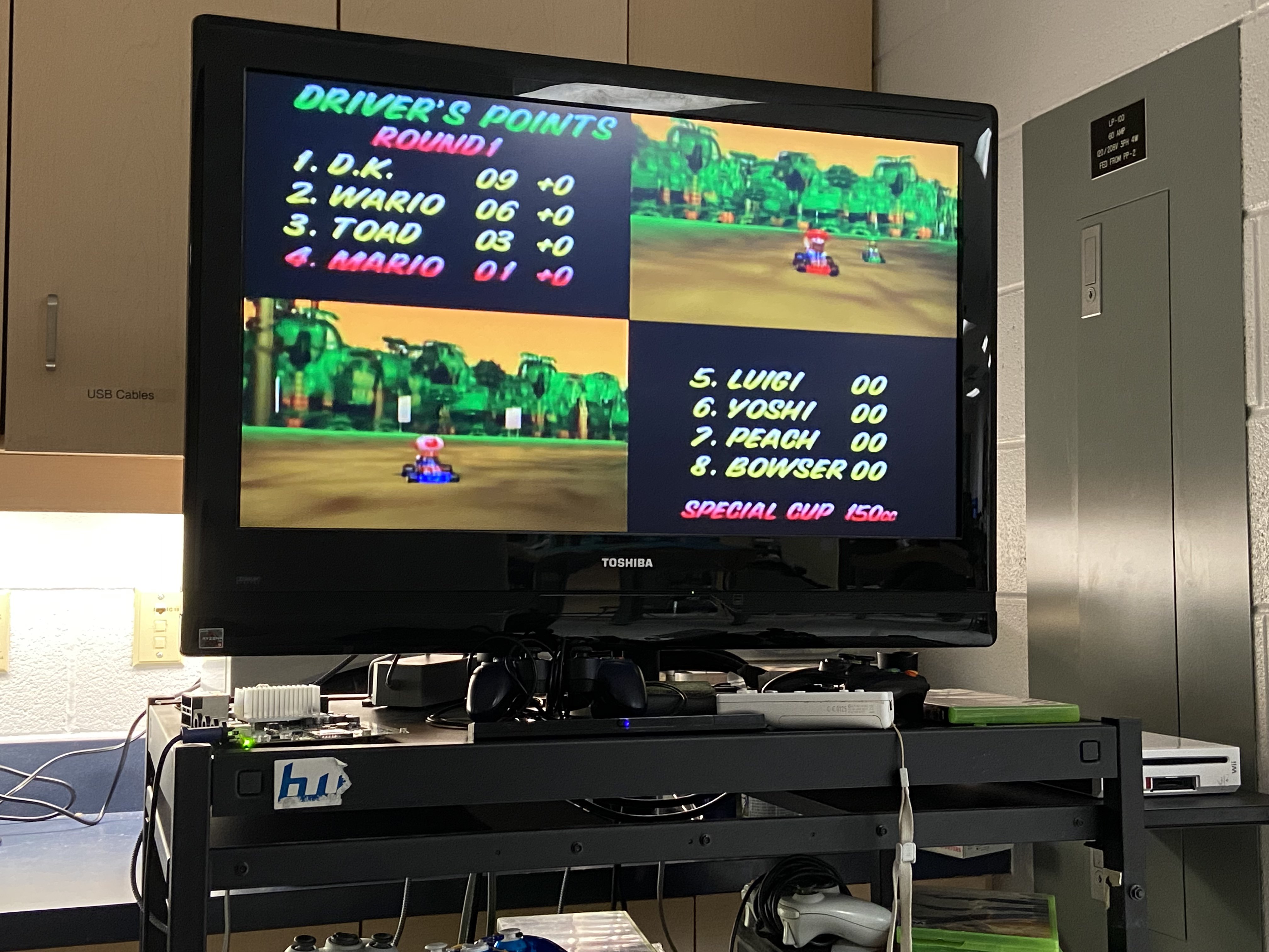

Bonjour! Big updates this week. Finally got around to trying out video on the wii, and I can confirm that it's booting! I thought I would be more excited but I feel like that'll be reserved until this portable is completed. I've learned so much from this project that having it enter the last stage of assembly is starting to get me nervous. I went on JLCPCB and ordered a resin Ashida case, which will hopefully arrive next week. I'll be posting bi-daily updates when I get into that home stretch, and I'll be sure to add one last update on what I would recommend for those doing this as a first project (assuming nothing goes wrong on my end). Weird to think that it's only been a little over a month since I started this project. I'd expect final assembly to take around a month and a half depending on how much troubleshooting/broken parts I need to fix. (Sorry for the blurry image this week, took it in a rush)

Looking good, my man! Just be careful with having all of the electronics all floating about like that; you're one small bump away from shorting / frying something. It's best to secure everything in place with screws before applying power to anything. Don't want to get a major setback from something so silly!
Can't wait to see more updates!
Yeahhh, bless our lord and saviour enamled magnet wire or I would have definitely blown something up by now. Chances are I won't touch anything anymore with the batteries unplugged until the new shiny case comes in.
