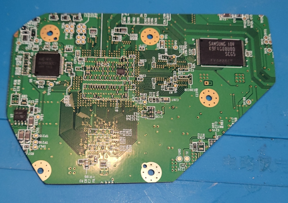

I've gotten the Z button switch out and I'll be putting it in the correct way soon enough. Since trimming the motherboard takes a decent amount of time, I wanted to get that done yesterday. Here are my results:
The other end looks like it might've gone into the NAND traces - while my dad was doing the trim, he did it at a pretty exaggerated angle, so it ended up being a lot closer than I anticipated in the outline. This is why I need to learn how to do these trims, I just didn't wanna learn on this one because I'm sorta rushing to get it done before MGC. I currently don't have a backup motherboard and I'd rather not tempt fate by learning on the only untrimmed motherboard I have for this project. Anyways here's what I'm talking about with the NAND lines on the other end:
It's too blurry to tell by with this image, but I've verified they're intact and I'll be double checking them with a multi-meter. I had to be real careful when sanding this one, but it's been sanded up to 1000 grit and I should be all set once I'm ready to and test boot it.
Progress on this has been a bit slow. I'm going through in an assessment week in college right now and I have 3 exams I need to get through. Once I'm past this coming Thursday though I should start making rapid progress on this. It's been a fun build so far!
Nah, your NAND lines are safe. As long as you aren't secretly Hercules, you won't get close to them

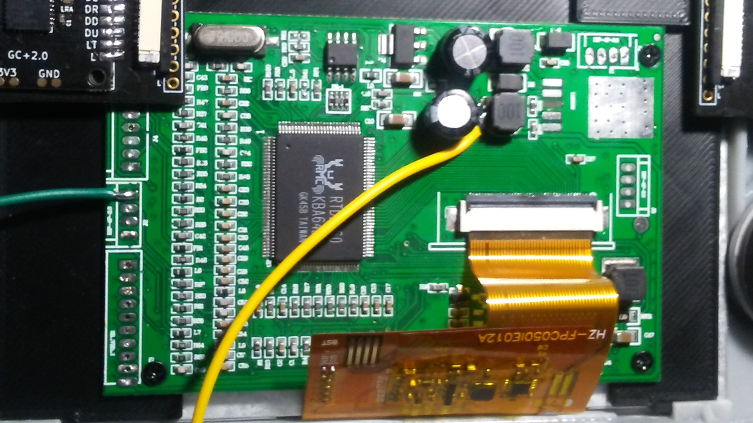

I'm still really not clear on what needs to happen to the screen driver board to make it work but I'm aware it gets modified to work with 3.3v instead of 5 volts. I also know the connectors had to go so I got rid of those. Here's what both sides of my screen driver board are looking like with that out of the way:

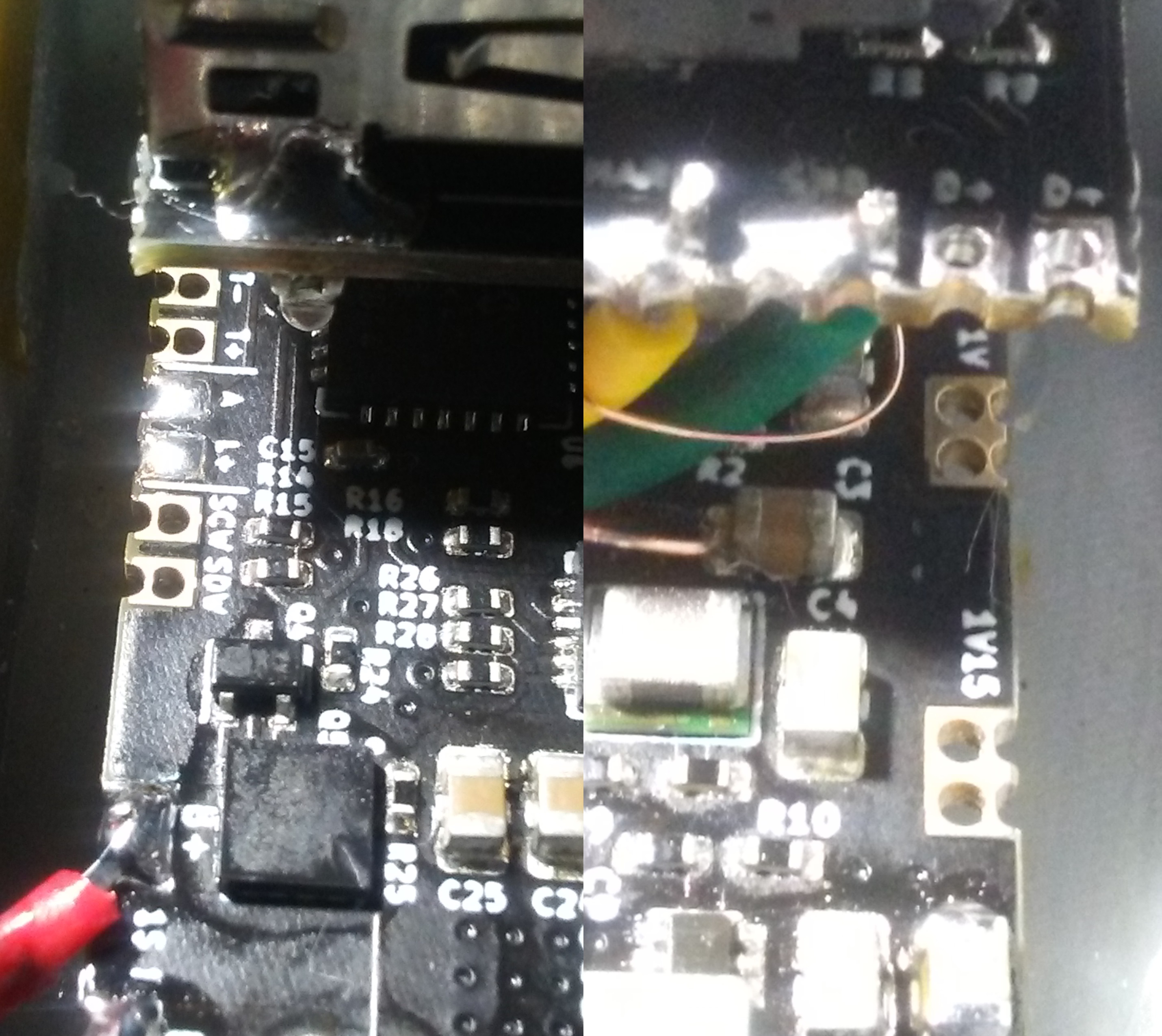

I needed to repair C10 on the PMS due to User Error: ID10T. It's visible but only if you know where C10 is located. Hoping my 5v rail isn't trucked.
As a question since I’m using that driver board.. how exactly do you wire it for power? 3.3v soldered into the spot shown and where does ground go? Also do you have to remove that component? The build is looking sick tho can’t wait to see the beauty shots of the finished product.
Ground goes to any ground location on the board, they're all all connected. And yeah you should remove the inductor for efficiency
I think @Stitches has answered your question accordingly. Thank you! This build really shows how far the community has come. I'm really looking forward to finishing this up and I'm especially looking forward to playing it!
We talking the one occupying the space 3.3v gets wired to? I haven't removed that component on mine yet, should I? I've already verified the screen turns on. You'll see what I mean by this image:

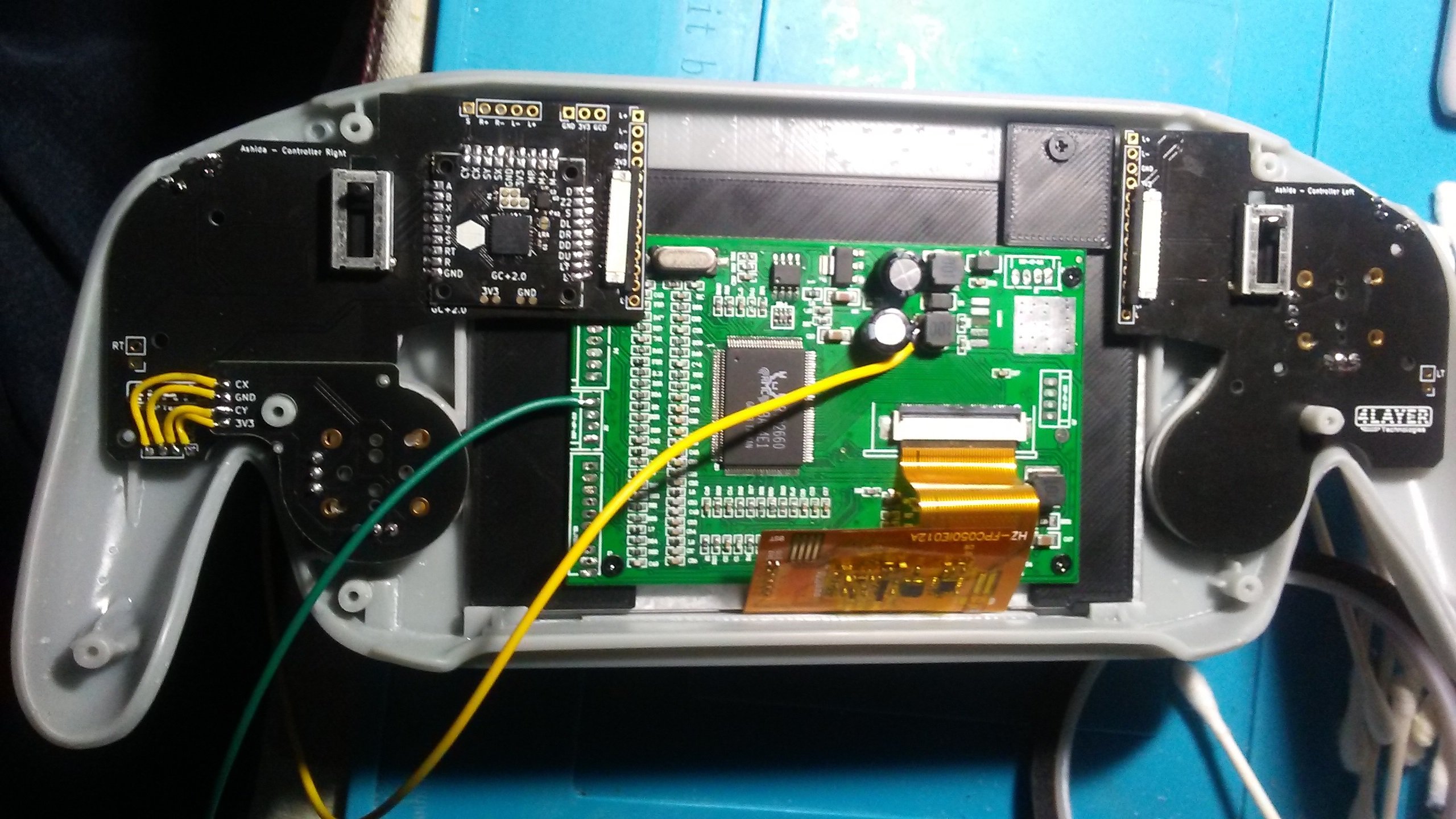

I'm noticing the control PCB is covering most of the VGA solder points. Not a huge deal although it looks like this build will call for shielded magnet wire over antenna wire. It's also probably a really good idea for me to put kapton tape over the area once I'm finished.

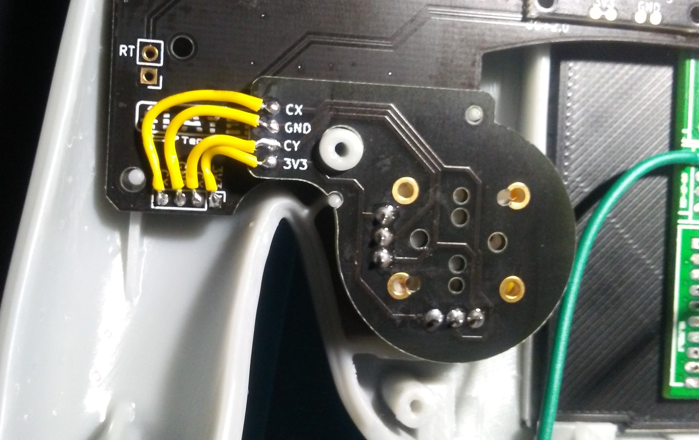

Here's how the wiring for the C-Stick PCB turned out:

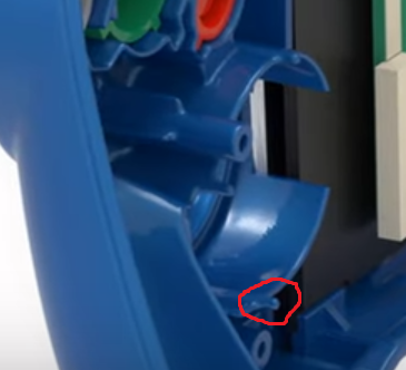

In order to position the C-Stick correctly, I had to trim down this mounting point:
@Wesk said it's a leftover from the OEM controller so I thought I'd mention the need to trim/sand it a bit in order to make the C-Stick PCB fit.

So, this update has some good news and some news that's pretty much ruined my night. Good news is, I got the Wii to boot and my trim is working!
Bad news that's pretty much ruined my night is, my PMS is fucked. I've been having my dad screw in the 4 layer boards because it can be really quite awkward to screw these boards into PLA and SLA printed shells. Unfortunately, he fucked up C10 when using screws that were too big to screw the unit in. Lucky for me, I was able to solder it back on, it wasn't easy but I managed to do it and all was working as intended. Unfortunately, until just a few minutes ago, it slipped both of our notice that he also fucked up C20 which is required for a number of things including the thermistor and likely the SCL & SDL which are data for the PMS to the Wii. I don't know where this resistor could've gone and frankly it doesn't matter because it was crushed when the PMS was screwed in for the first time. I swear it's always something with these builds, everything was going perfectly up to this point too. I was really hoping I could finish this thing up tomorrow but I guess that won't be happening.

In the meantime, I'm trying to unfuck my PMS with the help of Gunnar. I'll keep yall posted with how that goes.

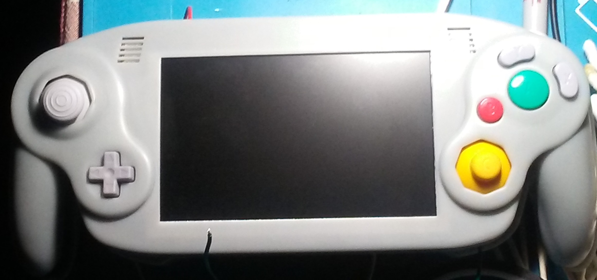

I didn't think I was gonna get it together in time for MGC, but it looks like I was able to! The screw posts for closing the case were hell, and I will need to iron out a few things, but it's all working as it should! Here's a side by side comparison with an actual GC Wave bird controller:
Since MGC is tomorrow I decided to hold off on screwing it closed. Ironically enough screwing it closed has been the most difficult part of this build(yes seriously...). The print was done in SLA and there were a lot of imperfections with the print that have caused me WAY more headache than I needed. Hopefully tomorrow or Saturday I can take the rubber bands off this thing and I'll be able to get the proper Ashida Wavebird experience haha. That said, here's how my internals turned out:
I was in such a rush after getting in the new PMS, I hardly had time to take pictures along the way. I got the replacement PMS on Monday and I had an incredibly challenging quiz that day so I wasn't able to make any progress. That left me with Tuesday(which I had another college class and homework to do), Wednesday, and Thursday(today) to get the unit together and finished up. None of this factors the lengthy list of preperations I needed to make for MGC; so I've been busier than a 1 legged man in an ass kicking contest. The unit is currently missing the MX Chip and while I usually do an MX relocation, I'm thinking of skipping out on it this time. I'll be building another G-Wii at some point and I won't be skipping out on it then. Virtual console games would feel sorta out of place in this build being that it's really a GameCube controller with a screen and all. Maybe I'll come back to it, but for now this is what I have and other than the shell's bothersome screw posts; I couldn't be happier with how it's turned out!

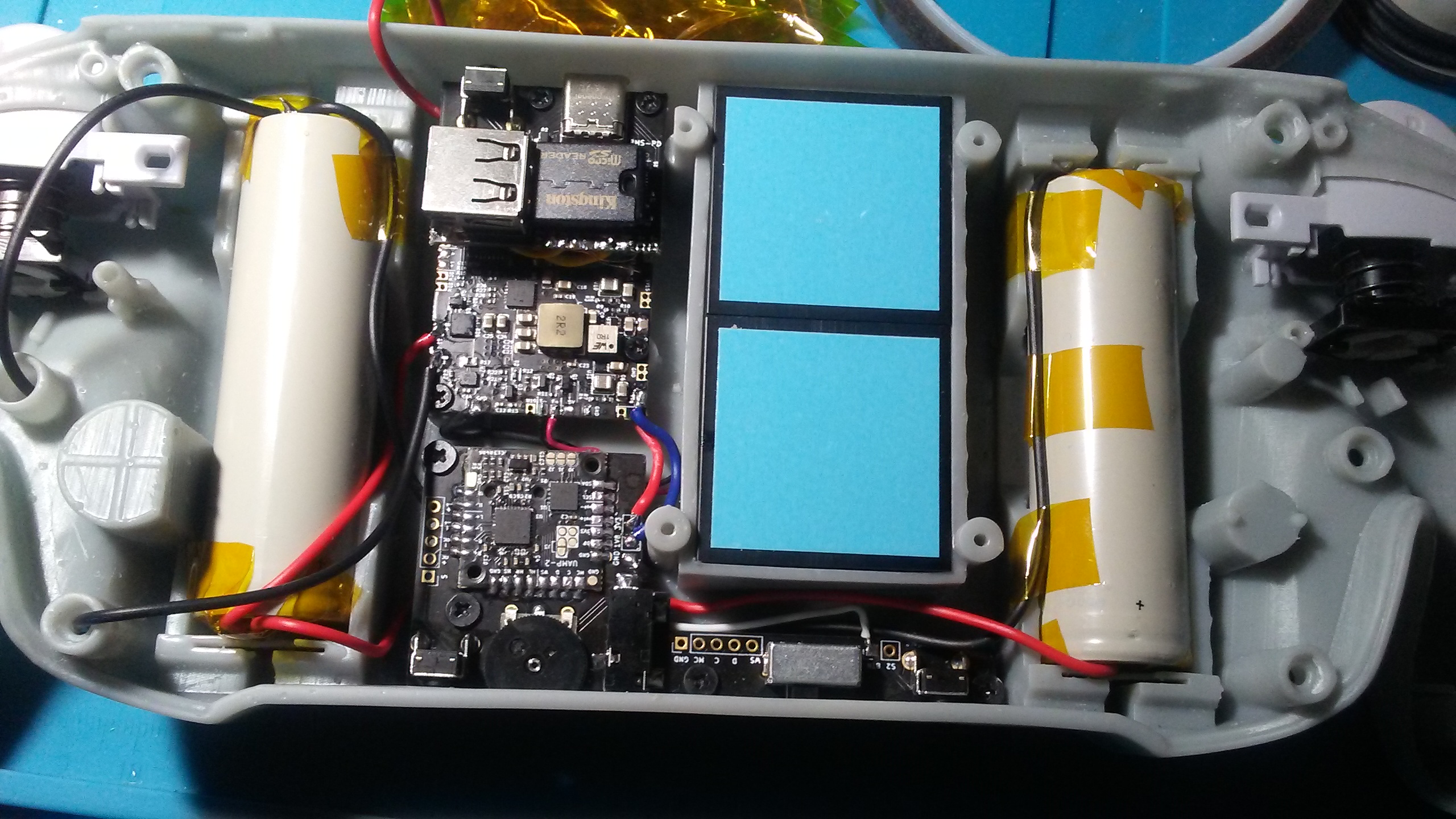

I needed to be careful where I located the MX Chip and battery on the back of the motherboard due to clearance issues when closing the case. This positioning seemed to do the trick with the coin cell tucked under the motherboard.
For some reason the internals look a lot sloppier on camera than they do in person. Probably because of my excessive use of kapton tape.
