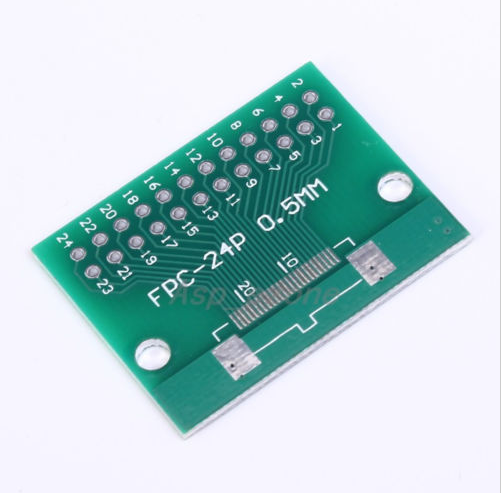

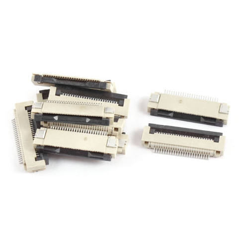

Flex is not included. I use the connector for testing and provisioning. I can't sell the flex because not only is it a big hassle for me to deal with shipping and payment for basically no profit ,I don't have enough flex.
If you wanted, you could buy a cable off digikey to plug in and then run very short wires from the end to the RCP.
