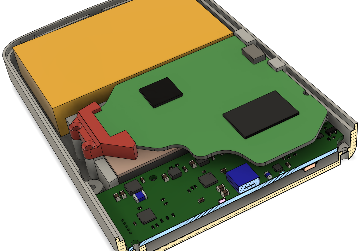

Today I worked on a way to secure the Omega trimed Wii in place.
It will be fixed on one side by hooks, and on the other by a part that will stick it on the heatsink (red part).

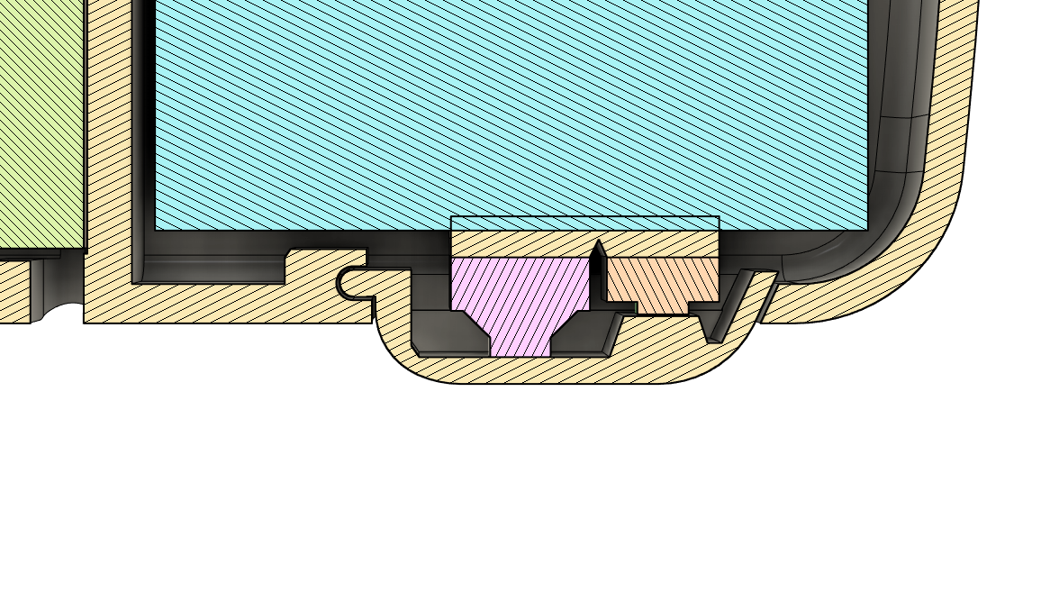

I have also worked on L/R trigger.
For now I need to test this concept.
Today I tested some print to adjust the L/R trigger, and now it work perfectly.

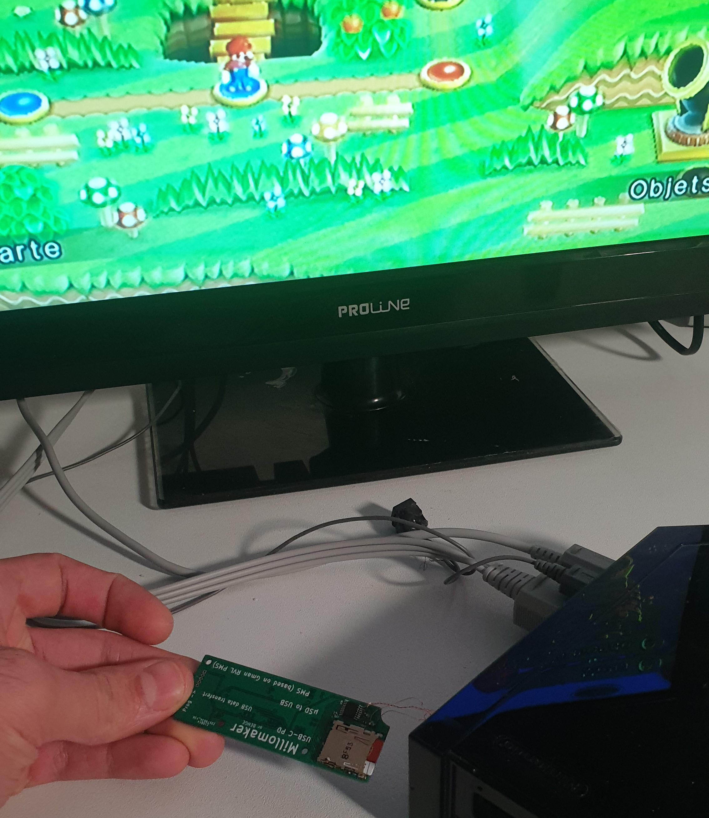

Test time !
I just tested the GL823K µSD to USB, and it works like a charm !
Tested with GC and Wii games with noname 4Go µSD cards and Samsung 64Go µSD cards.
This little circuit is really great, only needs to add 4 capacitors to make it work (no external oscillator, no resistors).

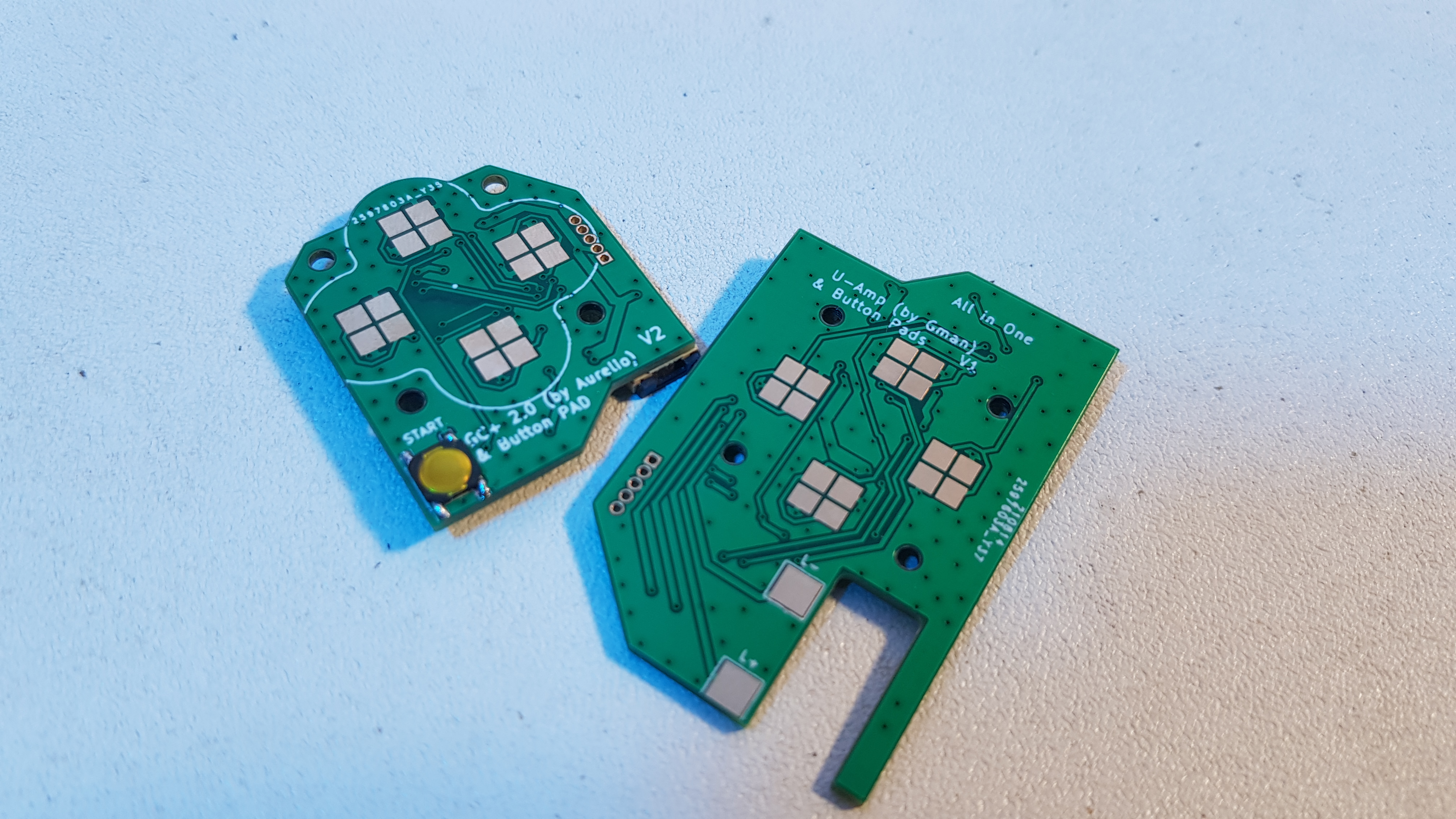

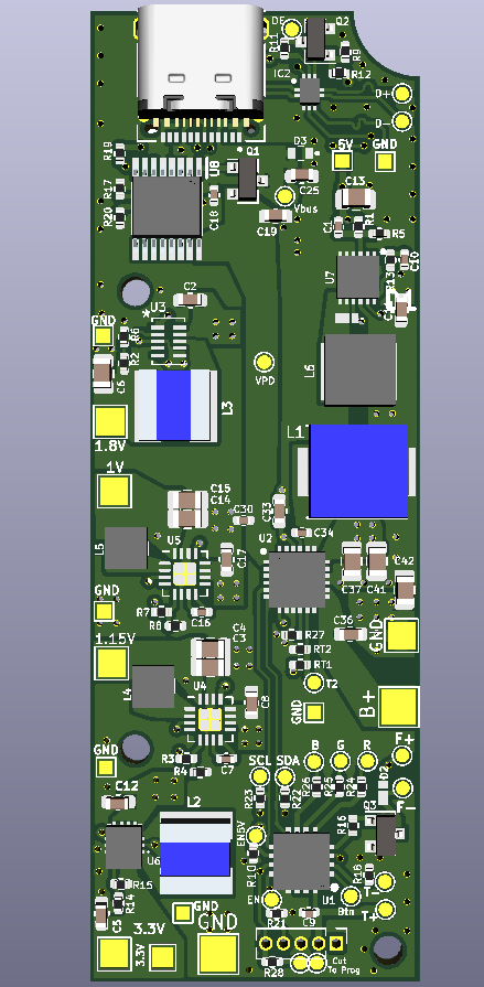

I also finished the new version of my all-in-one PCB (after changing all the regulators at least 5 times and doing 3 different versions).
And thanks to @Gman and his explanation, I was able to adapt the PMS code to be able to turn on the 5V regulator when you plug into a USB socket (for data transfer).
I also used the IP2721 (nice discovery, it is super easy to use) to activate the Power Delivery instead of the stusb4500, which is unfindable.
I also added something to make PWM fan control, but I have to find out how to use PID for regulation.
So it's not for now, but at least it will be possible

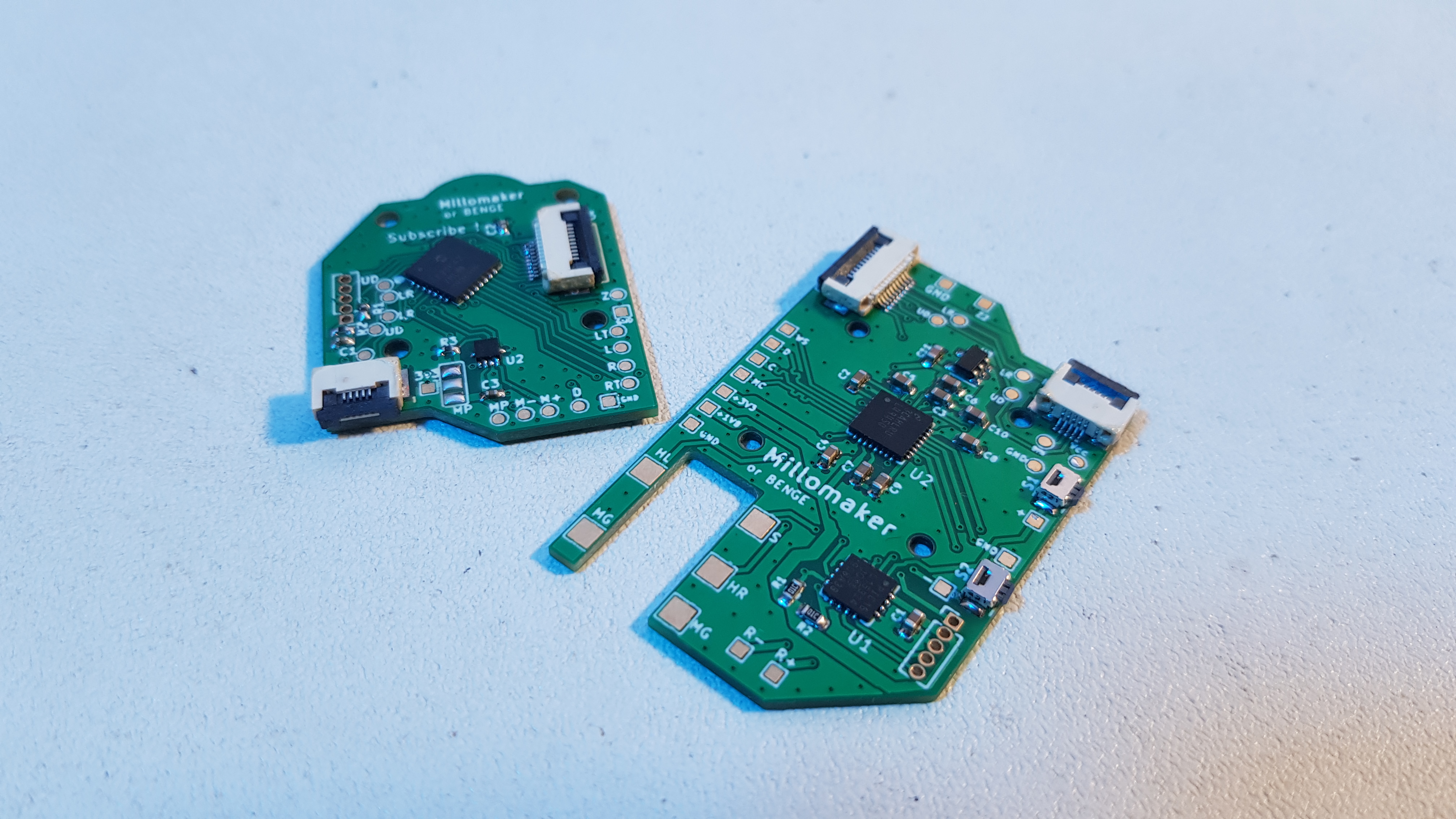

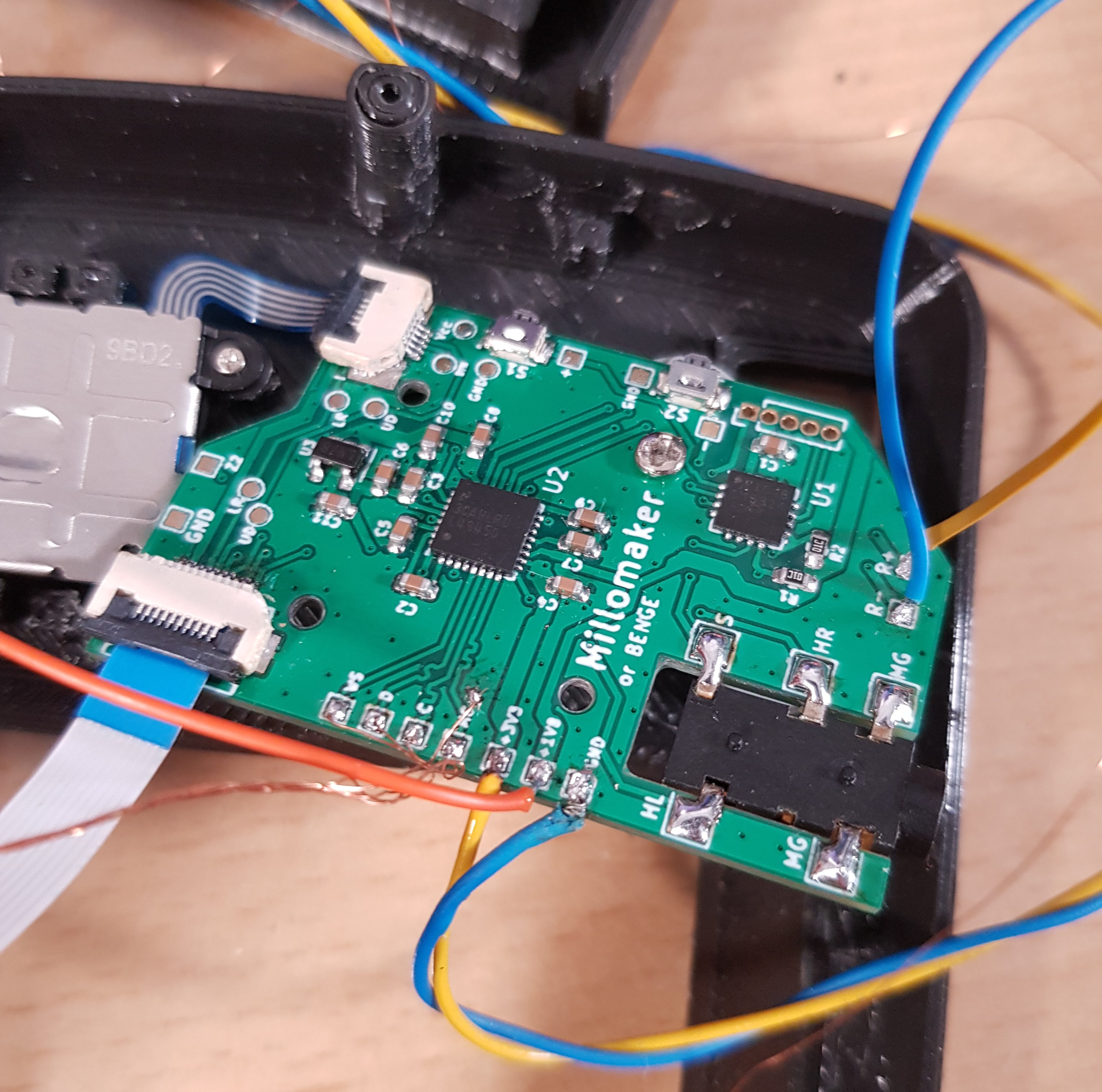

Today I tested the Controller, and it works very well !
After I tested the U-Amp, but I got a strange issue :
The sound come very low, even when I ride it to the max, and when I go down to the minimum it goes down well because after a while we hear nothing.
After testing with an audio Jack input, the sense didn't work.
But after checking everything, I found no mistake ...
As I had connected the 1.8v with a fairly thin wire (0.2mm) directly to the Wii and not to the power supply, I connected a larger wire directly to the 1.8V output of the power supply.
And the problem is just there, so now everything is working.

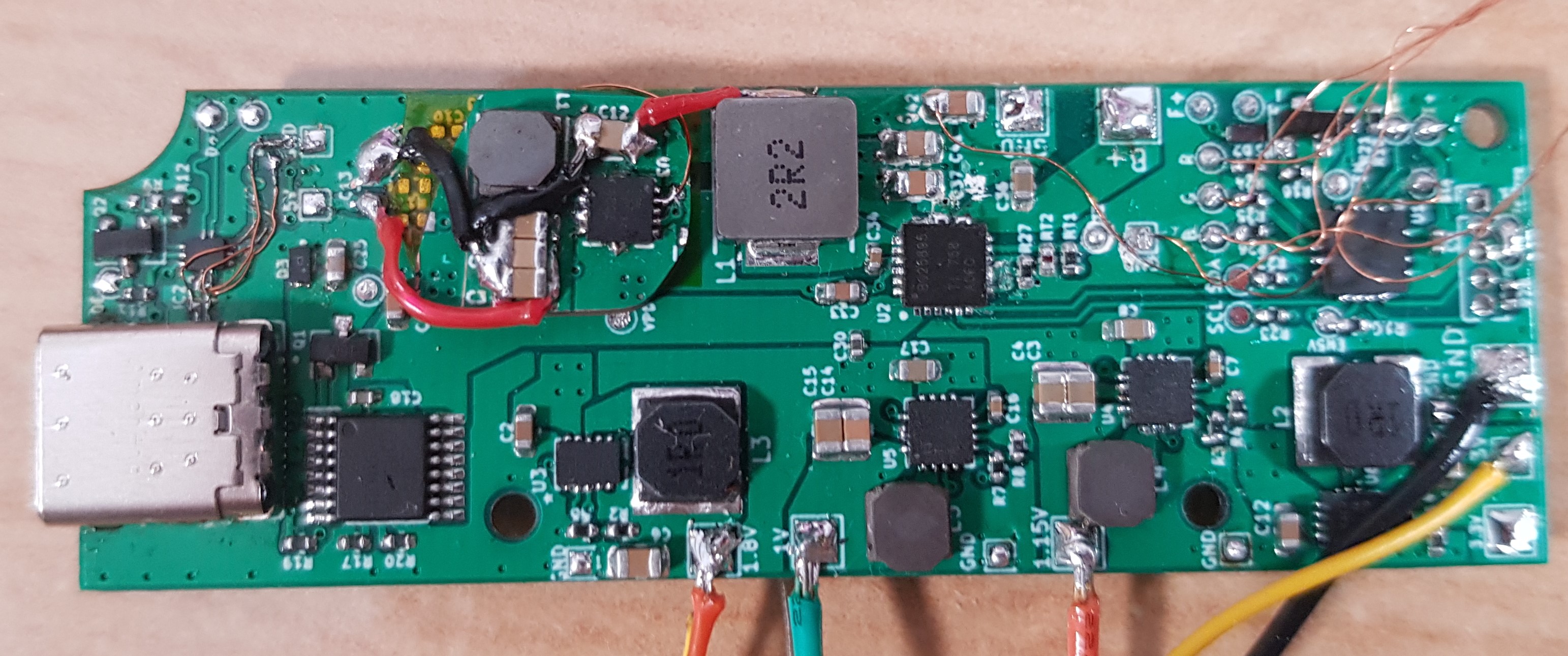

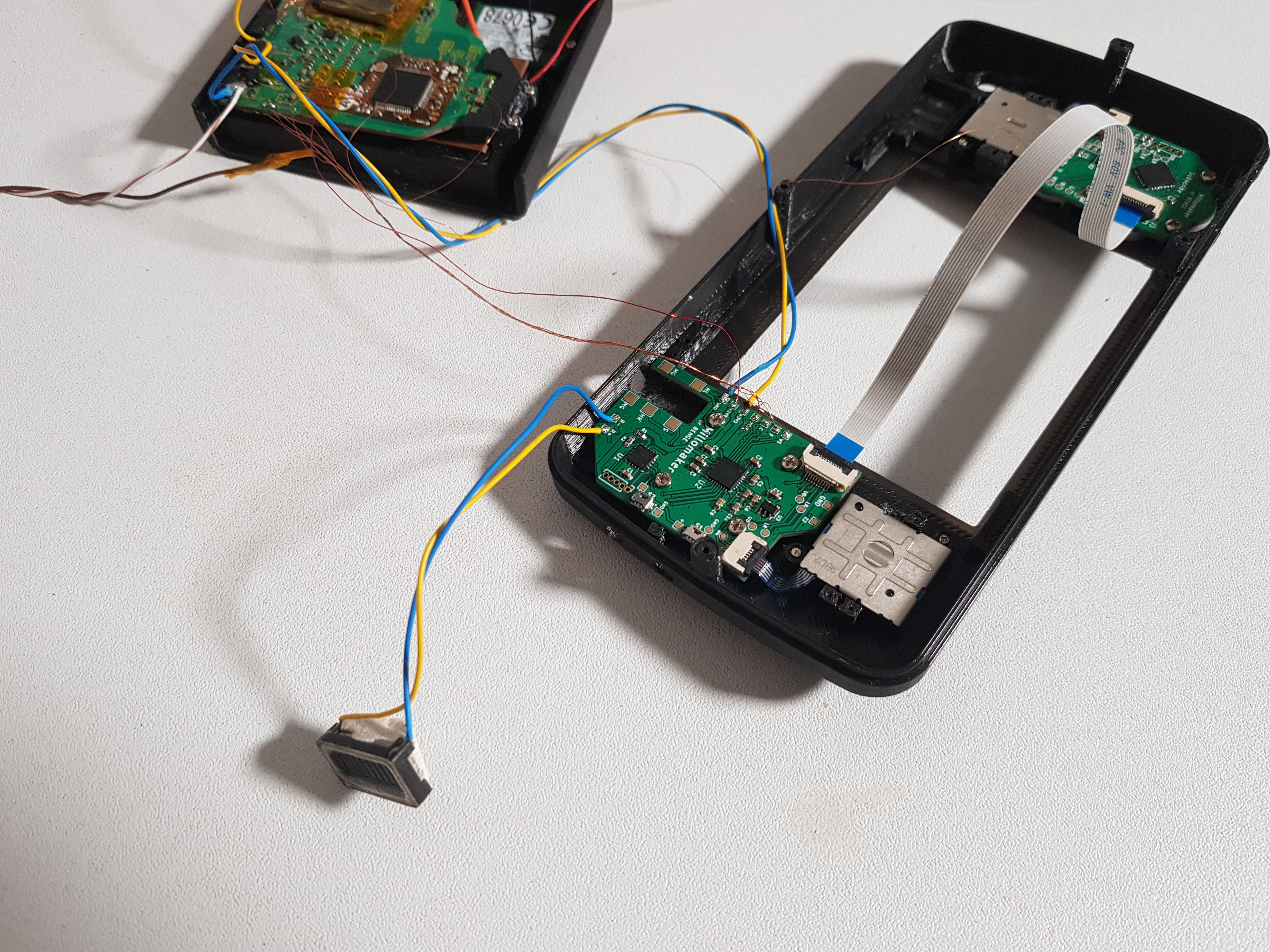

I made some advancement on the project !
Some time ago I received the second version of my main pcb, so I put everything together.
All voltages are working, unfortunately I have made several mistakes :

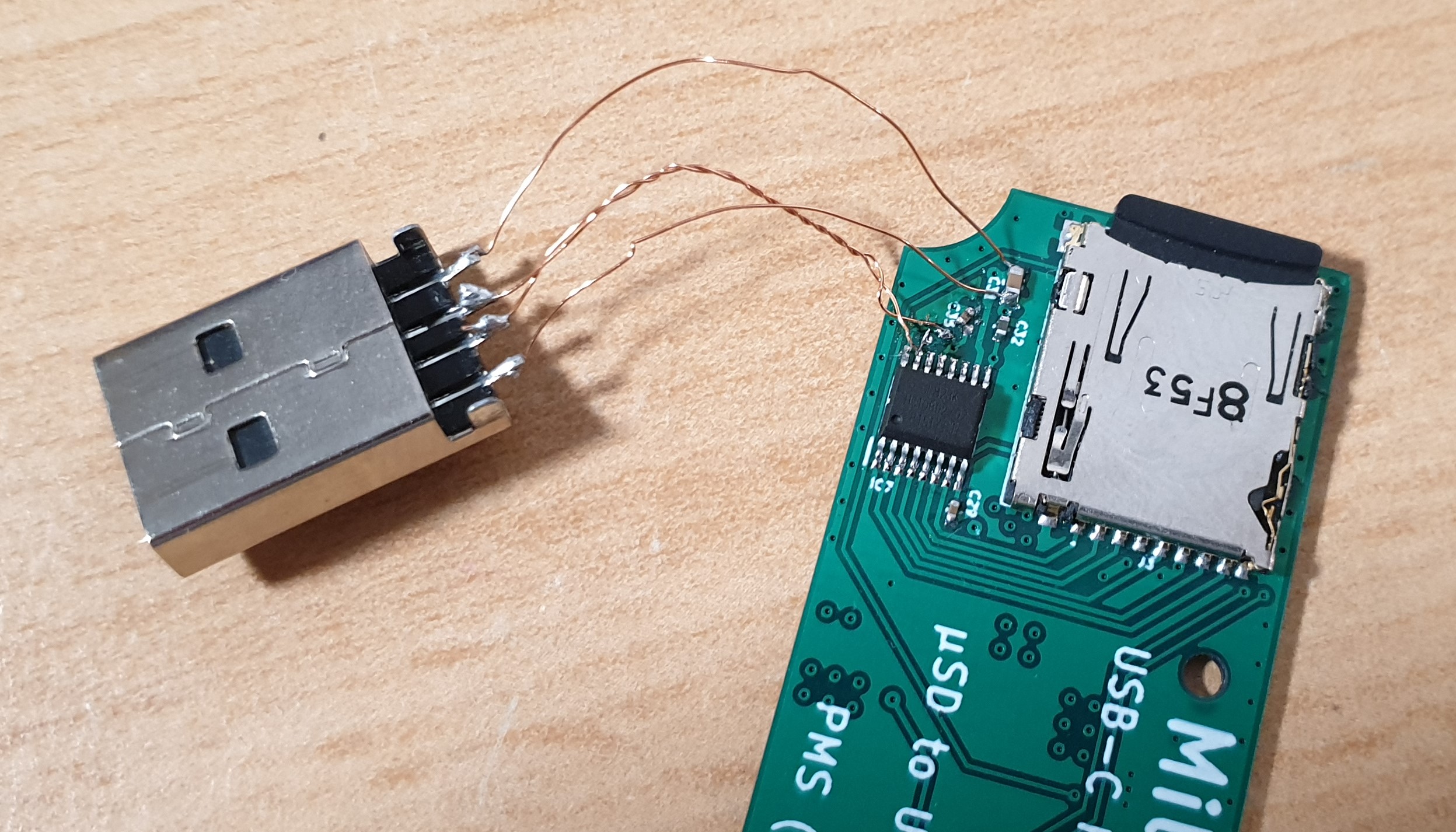

1 - I reversed the connections at the USB multiplexer, so I rewired that with magnet wires.
2 - 5V reg are not Synchronous regulator (so efficiency are not optimal) ... I learned this while watching a GreatScott! video after having already send the PCB order.
3 - 5V reg can't be full turn OFF, so I have Vsys on the output even when EN = 0V, that break the logical of the USB multiplexer.
Luckily I still had an RVL PMS pcb, so I soldered the regulator that goes on it and I cut the PCB to then connect it to mine.
So here is the result :
So now all of that work fine :
- All regulators
- USB PD
- µSD to USB
- Enable 5V reg when 5V is plugged in and the circuit is OFF (to switch the µSD card to the USB-C connector).
- D+ D- to 2D+ 2D- connection way on the multiplexer
And the big problem that I have now is the multiplexer that switch correctly to the D+/D- to 1D+/1D- or 2D+/2D-, but work only on the 2D line, it doesn't work at all when it is on 1D line.
I think it is because this multiplexer can do audio too ?
I use the NLAS7242, firstly I wanted to use the TC7USB42MU, but it is nowhere to be found in stock.
So for now I will order another one (TS3USB30) that have the same logic and footprint, and almost the same pinout (only one pin to change) for testing ... I hope it will work !
