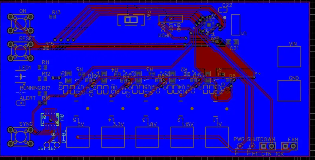

After finishing my first Wii project, an ashida with a translucent shell (and amazing result :awesome:), I want to make another Wii project and I want to play it on my TV but I not want a poor quality because I use a recent TV with no composite or YPbPr input and I not want a converter because I want a AIO conception with the Wii (Trimmed) ,the HDMI mod and all the Wii need to work.

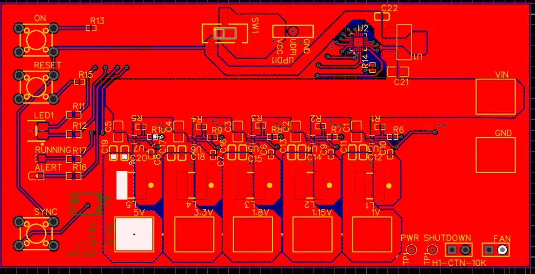

I have designed the power PCB based on the PSU-plus conception (files below) and I am verifying if I can order it safely (and if will not burning on me:awesome:).

I just have a doubt about the power supply of the BT module: I need to feeding it 3.3v at just the power pin like my pcb or also on the sense pins like the definitive wii trimming guide when the wii are turned off and standby regulator turned on (PCB connected on a power supply via VIN)?
I have also finished the comparison of my pcb with the pcb of the PSU-Plus and it looks very good and I think order the pcb soon
Afaik you can only sync wiimotes when the system is running, so 3.3v standby just needs to supply the BT module's running power. Regular 3.3v can be used for the sync button.

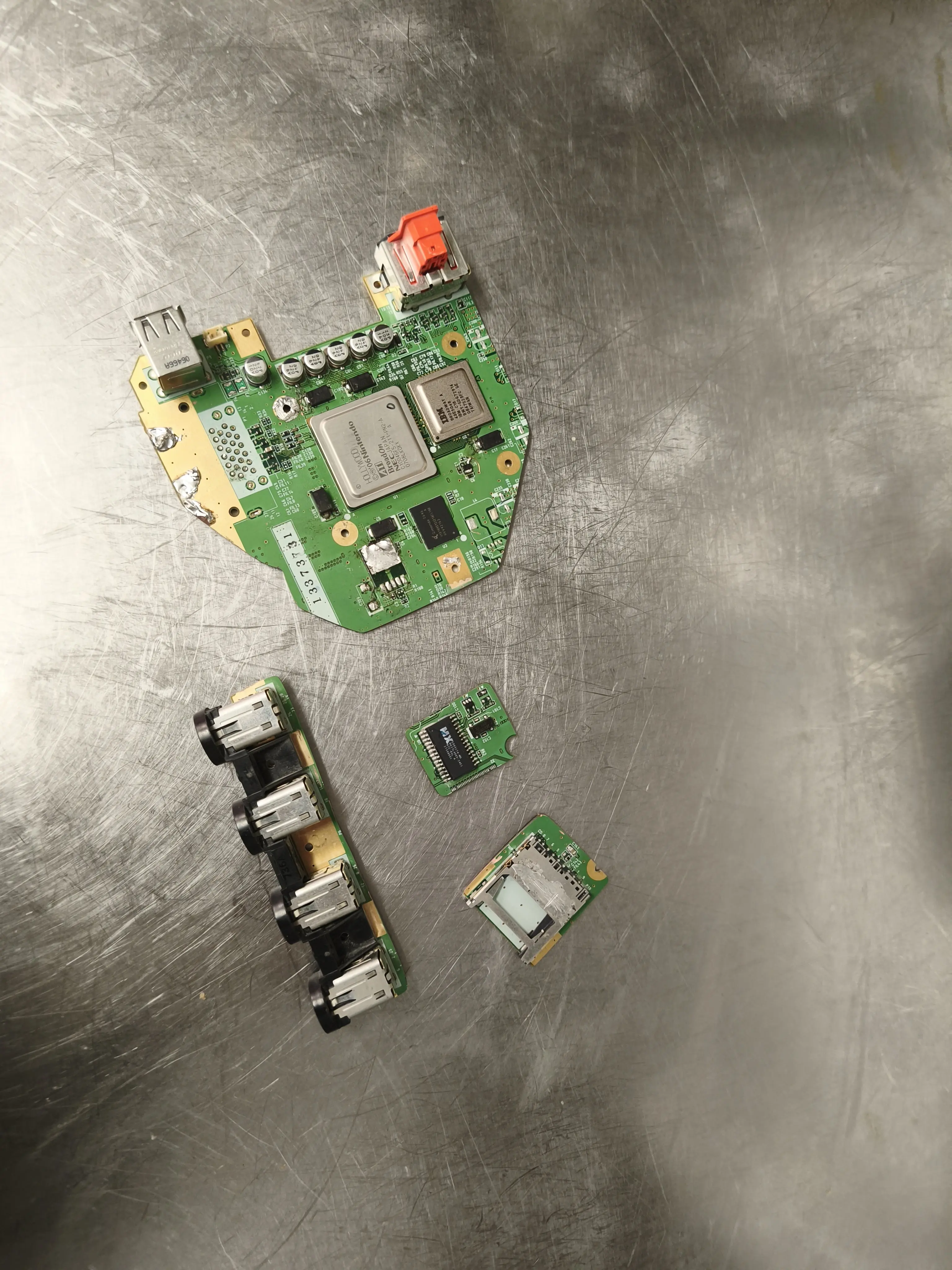

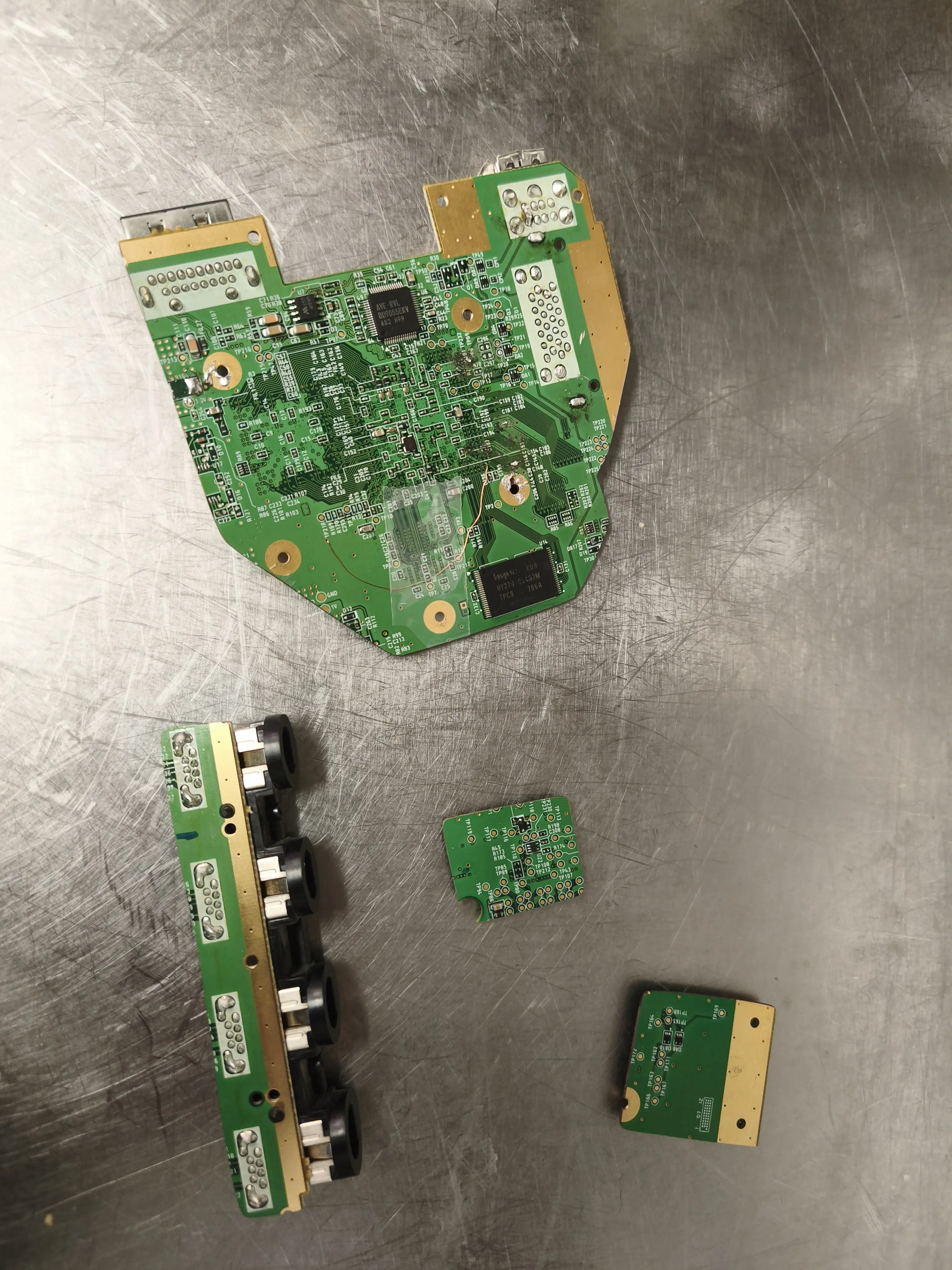

Little update:
I trimmed the wii and sanded it with 80 sandpaper and 600 and I'll test it soon (this metallic plate is not my workbench:awesome:)
I have also trimmed the SD card slot for some homebrews that does'nt work on USB like WiiXplorer (I cannot access USB on it with my ashida)
