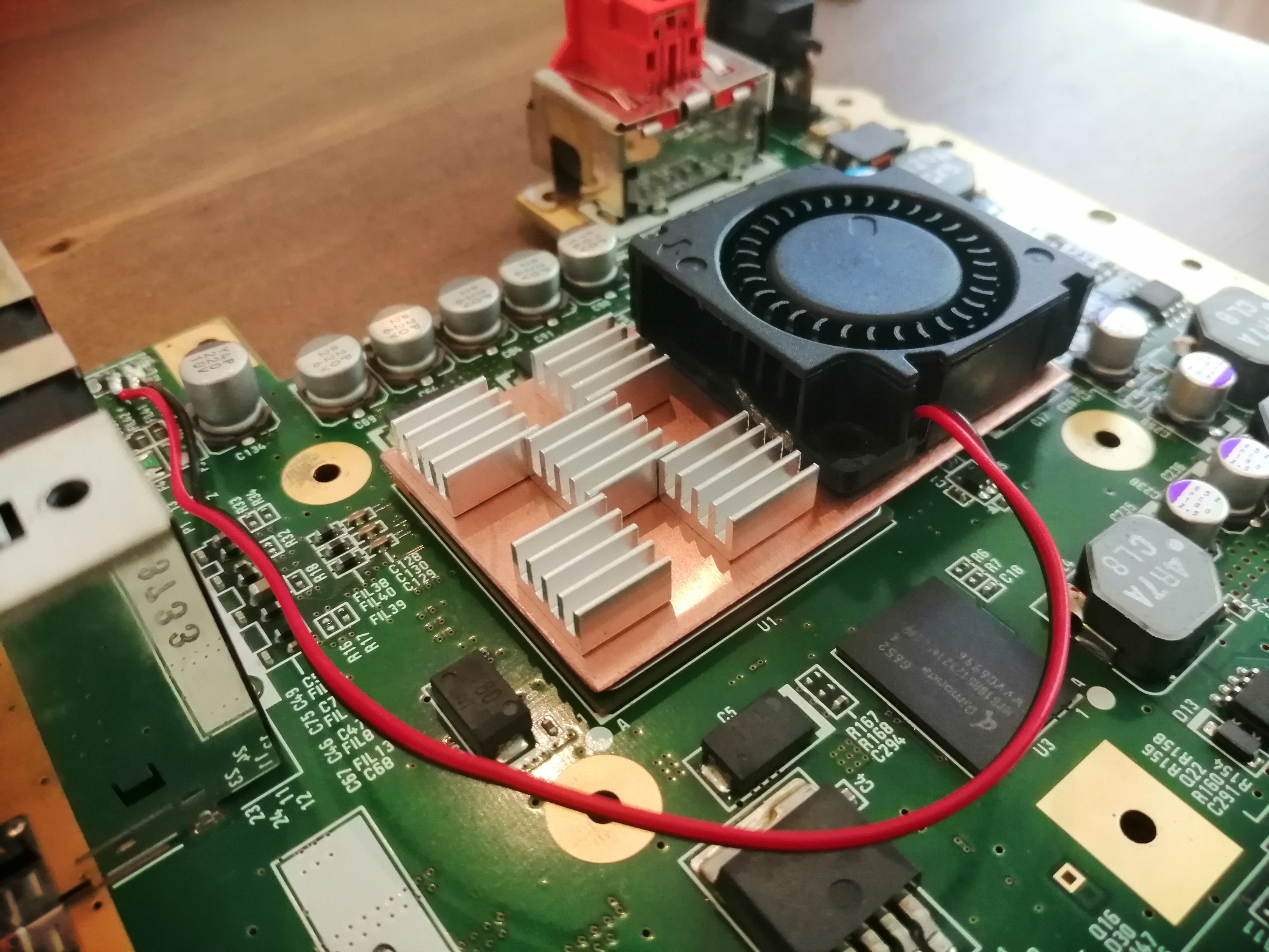

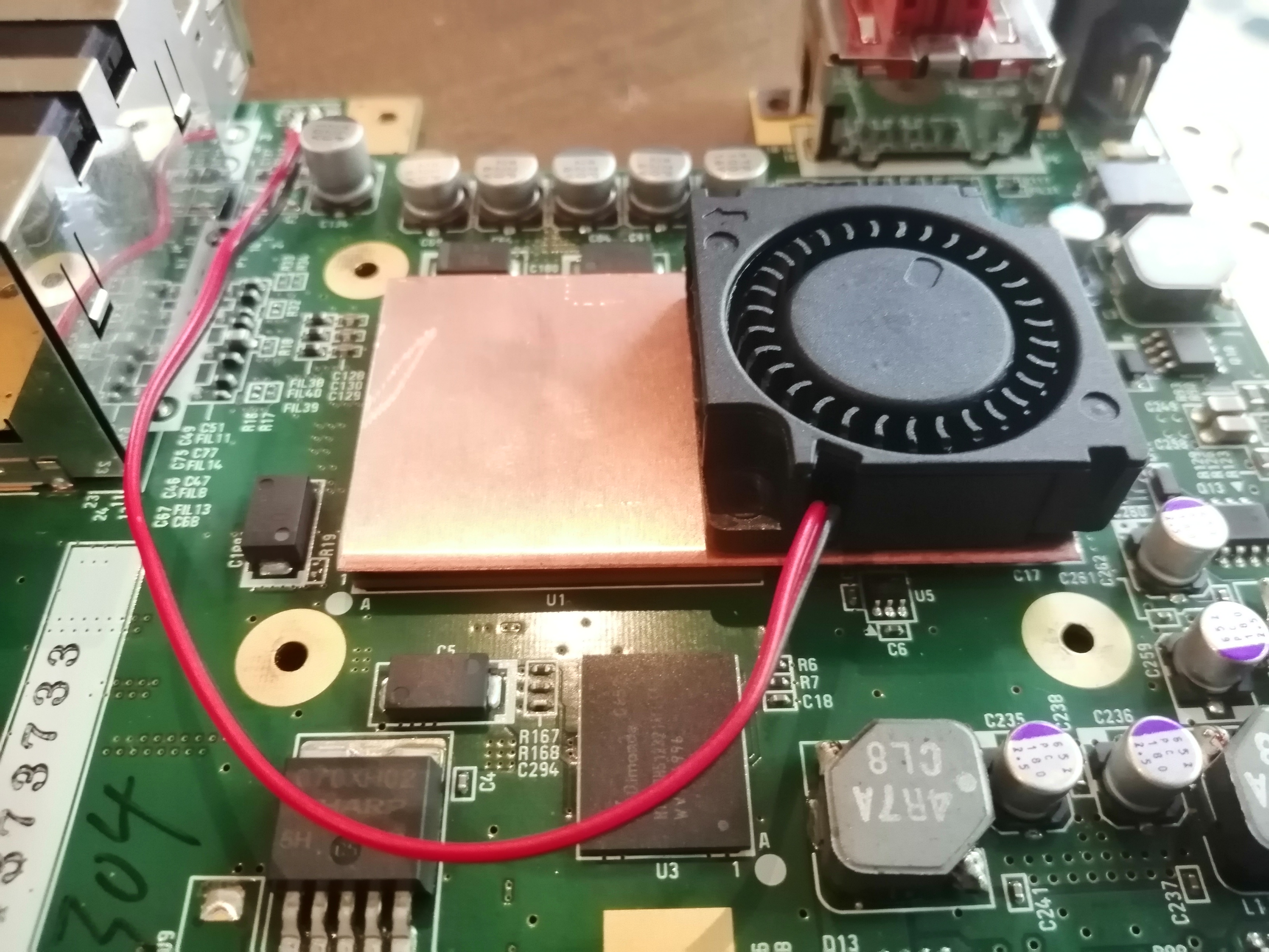

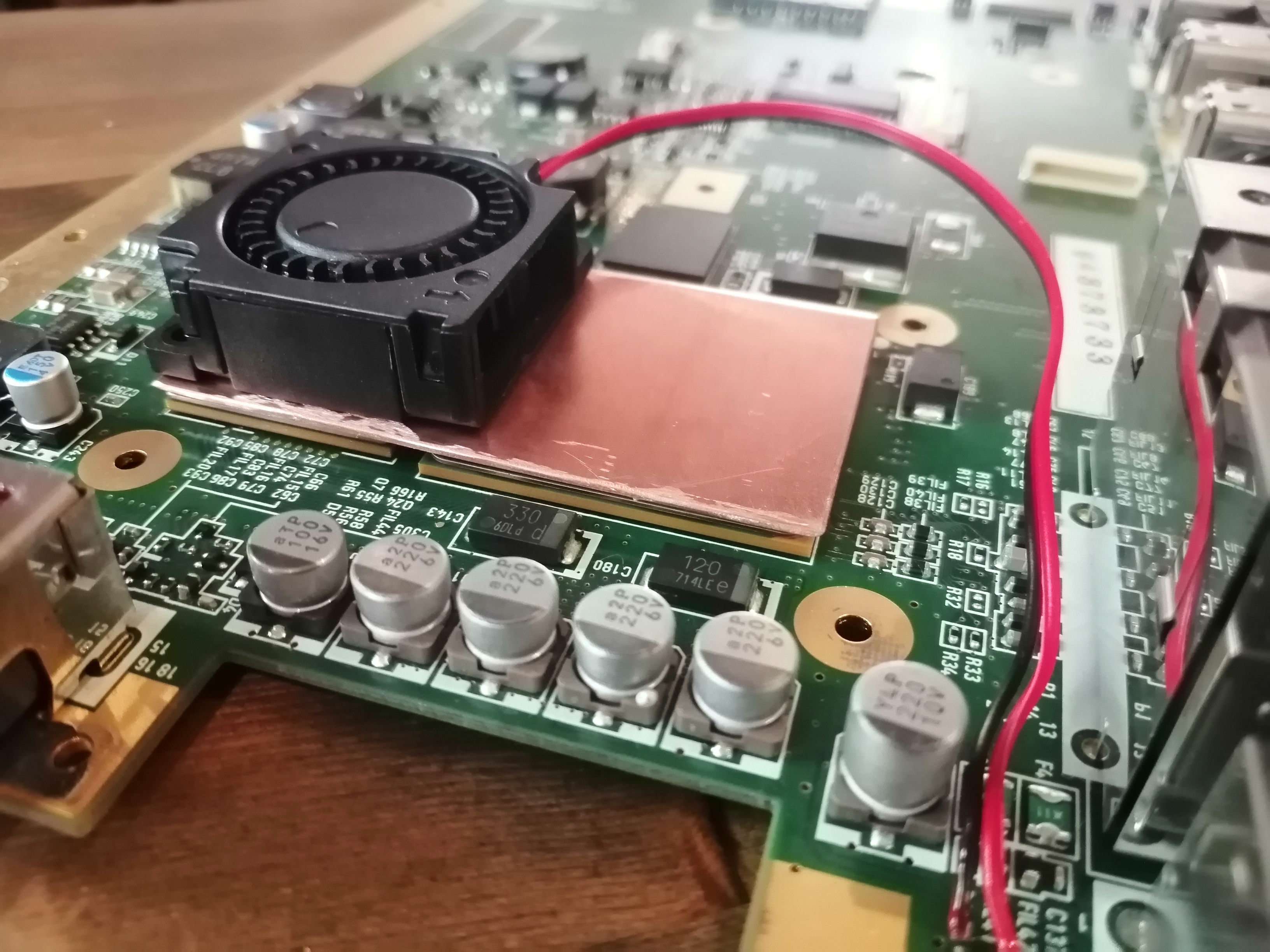

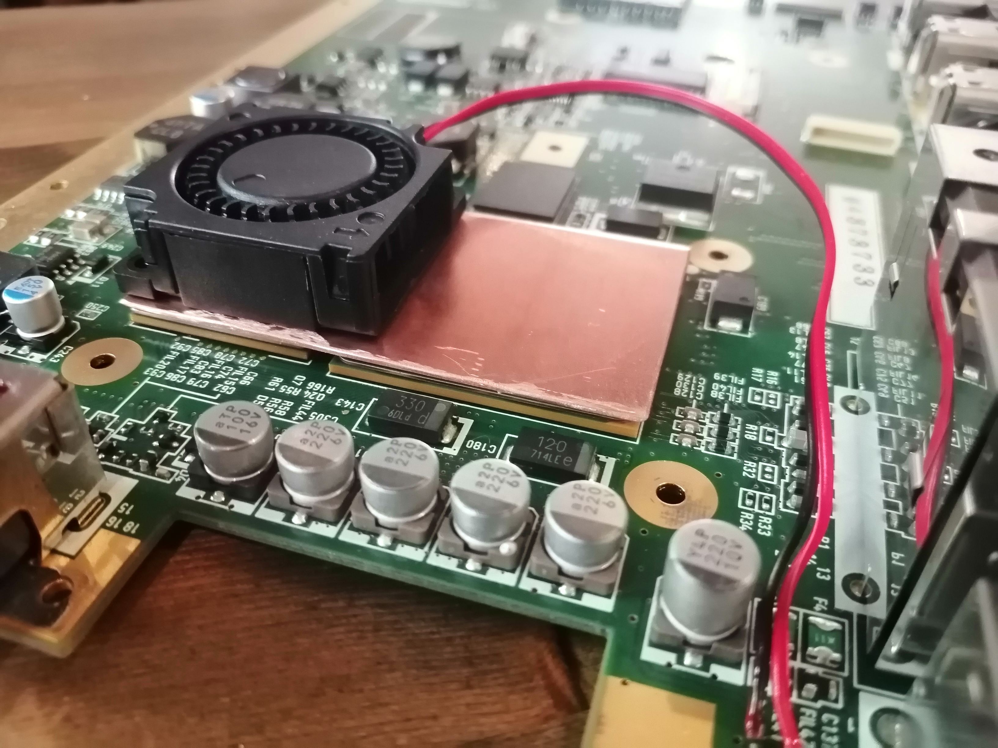

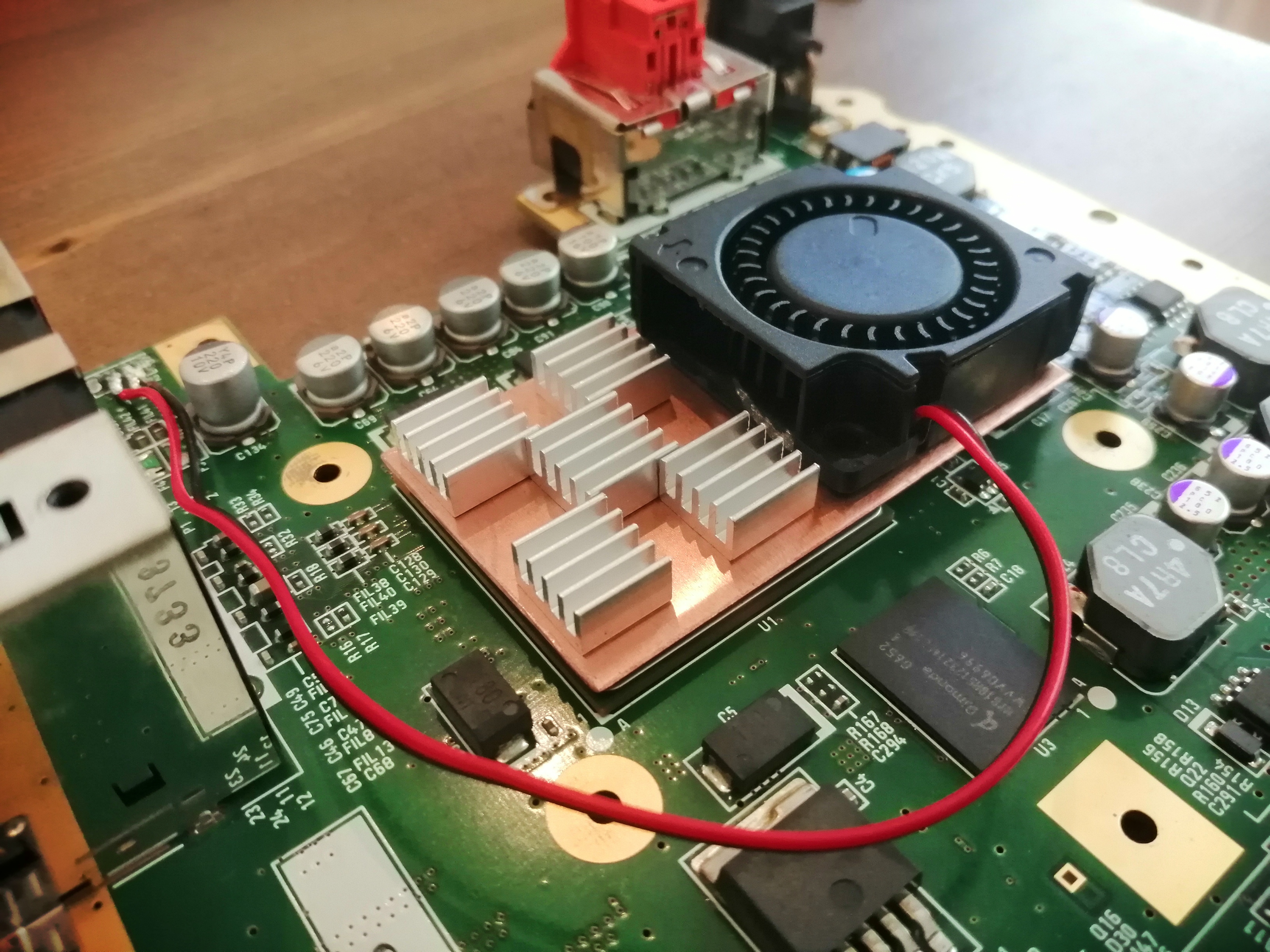

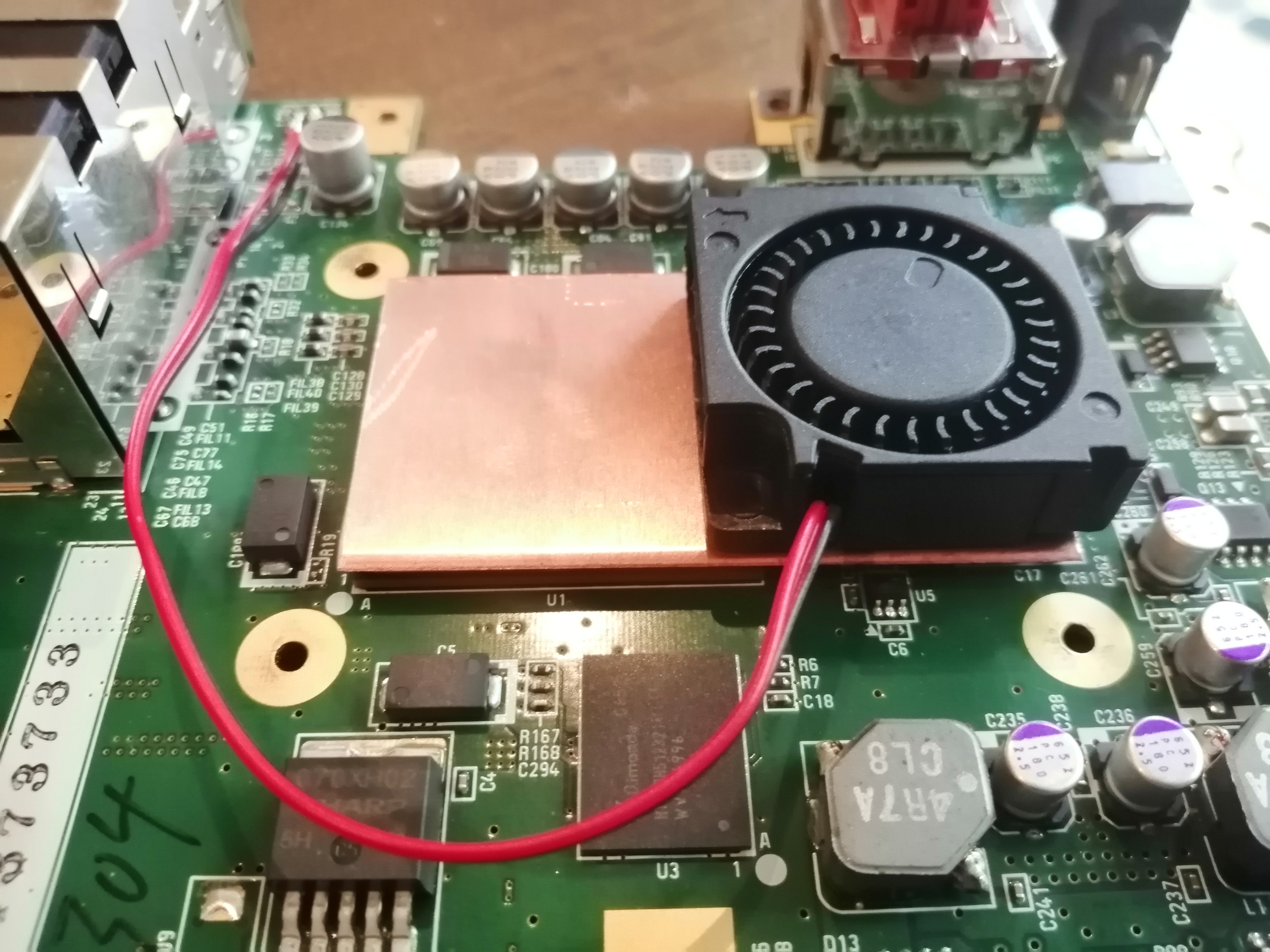

So I've been waiting a while for various parts to arrive but been working on the cooling side of things. Taking inspiration from the G-Boy solution I sourced the items separately to match
Parts used:
  • 100x100mm 0.7mm copper sheet - link
  • 30mm x 10mm fan blow - link
  • 9x9mm 5mm aluminium heatsink - link
Work
As the original fan and new fan are different header pin sizes I removed the original board connection and soldered the new fan directly to test it. I was really surprised by how much more powerful (and loud!) the new fan is compared to the original. I think it should do the trick nicely. I then used a dremel to cut the required size of copper sheet which will sit on the CPU & GPU with a mix of thermal adhesive and paste (I found this idea here). Fan will be fixed with epoxy resin and finally the heatsinks added using the same method as the copper plate.
(I may have underestimated the heatsinks but maybe this will improve airflow with proper case exhaust)

1. your cooling solution looks really nice, i love the arrangement of heatsinks! i’m looking forward to see how well it works.

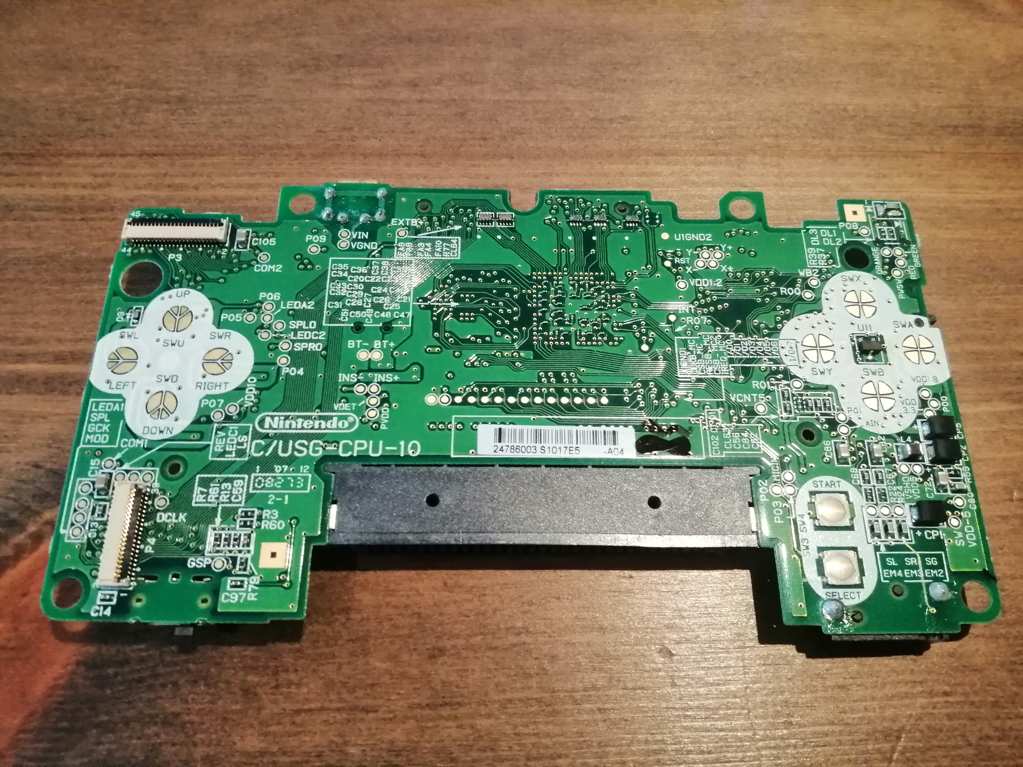

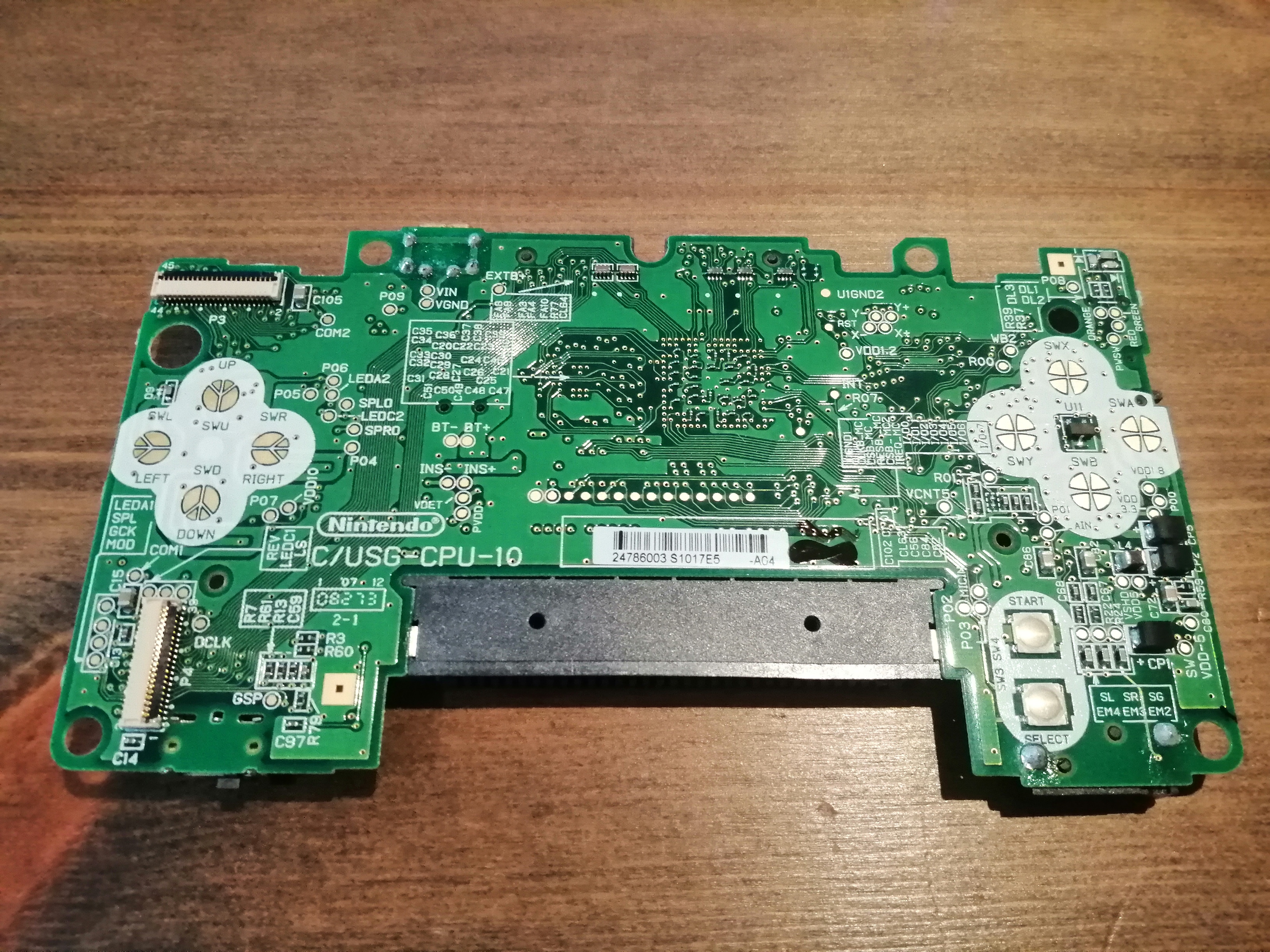

Hi all,

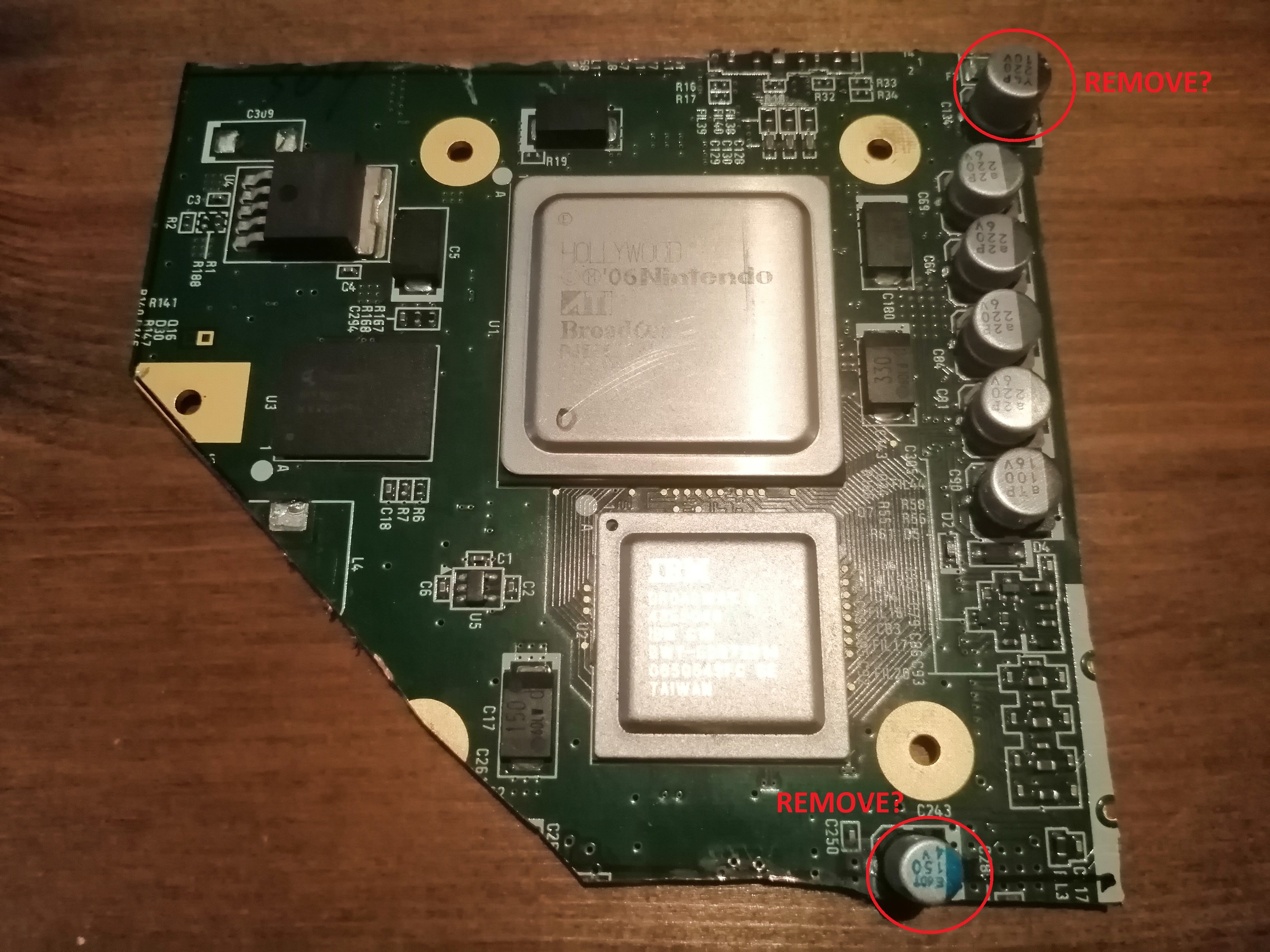

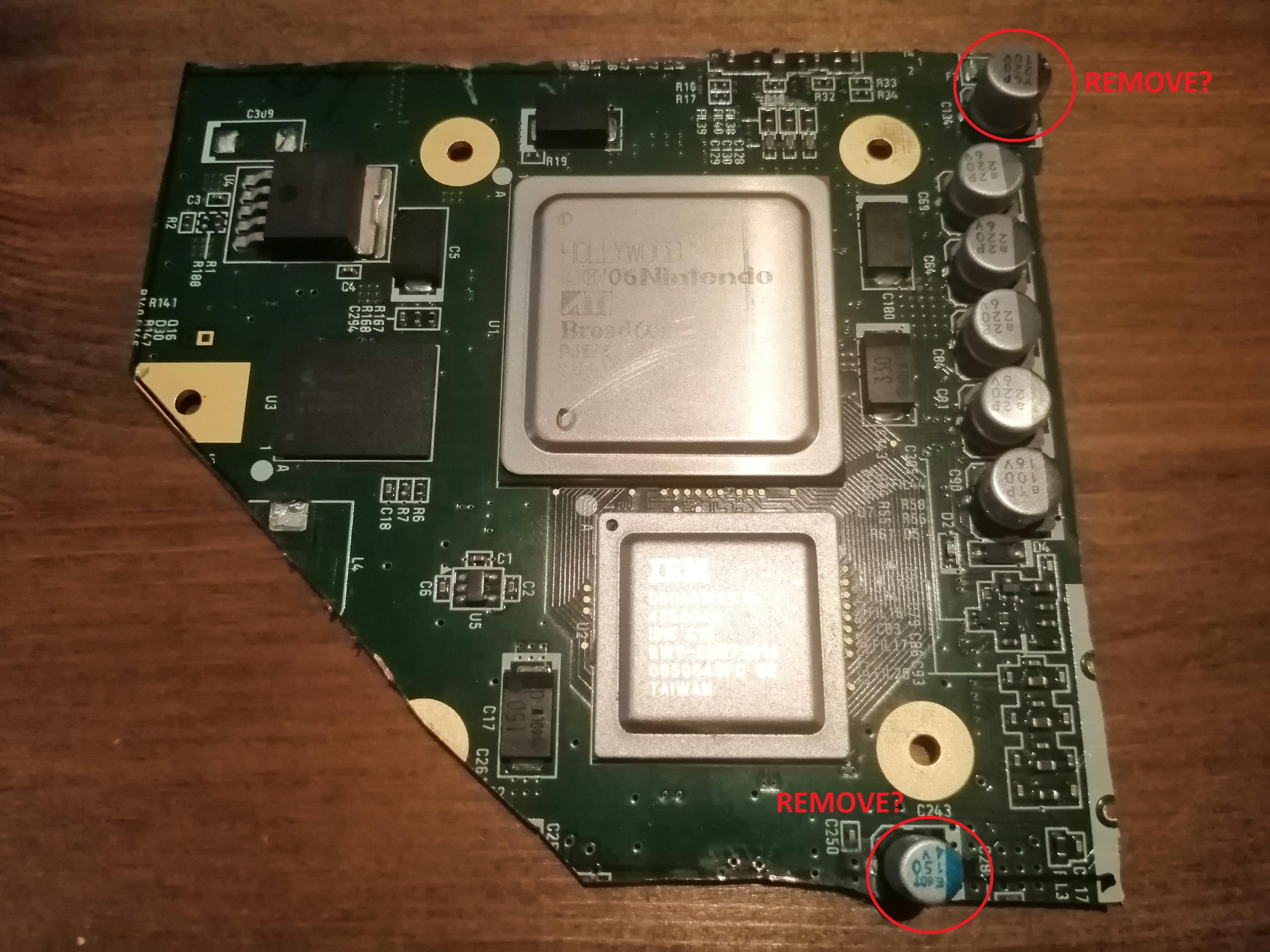

Just a quick check on my trim - can I remove the 2 capacitors(?) shown in the pic? Also confirmation that I've not screwed anything up so far would be great!
I'm planning on removing the LDO (using RVL-PMS), removing C1, C2, C6 and U5 chip (U10 removed already) and then soldering U10 in place. Waiting for magnet wire to complete the via.
Contemplating keeping the MX but not sure how much it will be needed in reality - anyone got any experience on if its worthwhile?

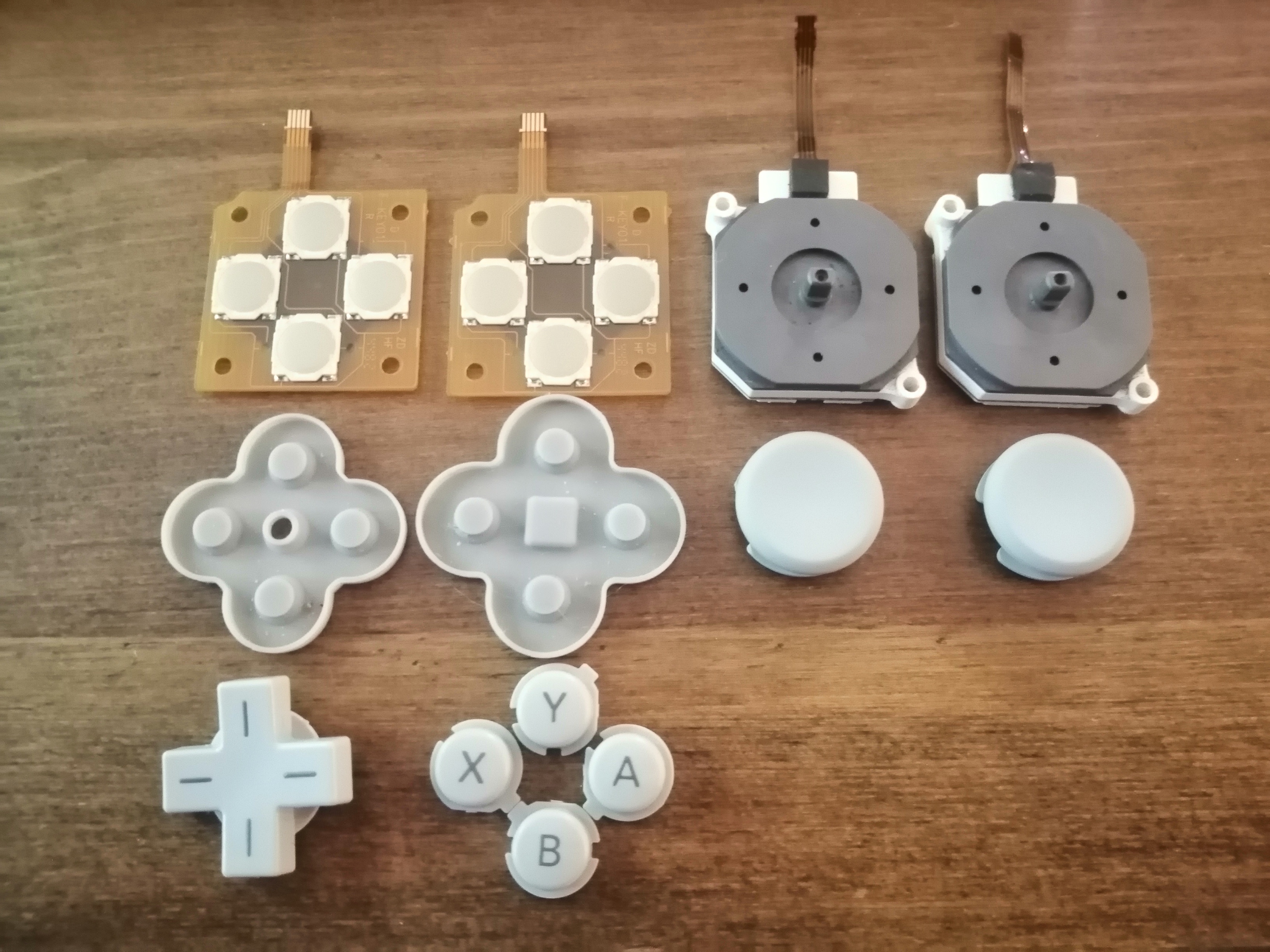

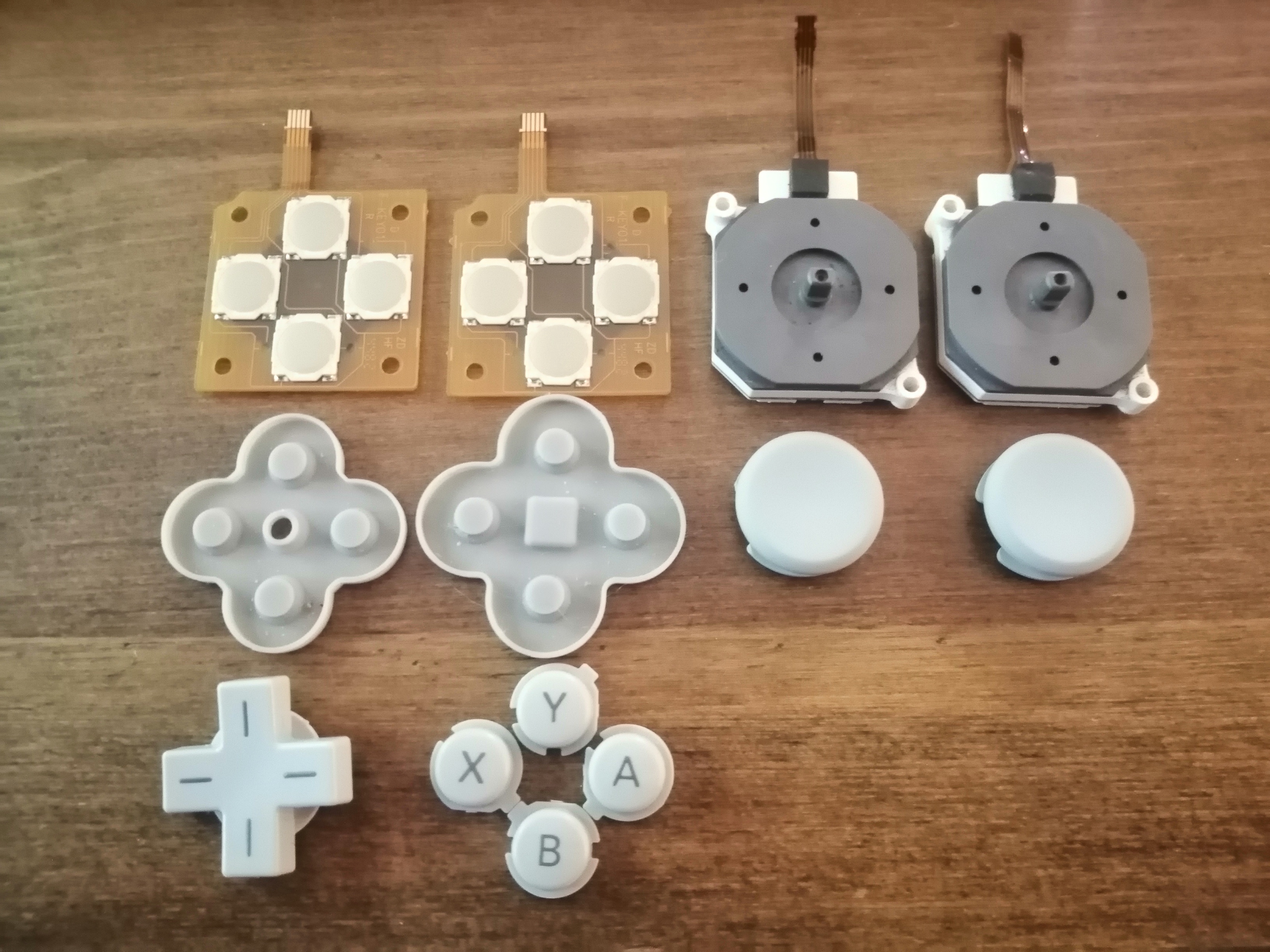

I've got the following components through ready for the controls:
  • 2x D-Pad button flex cable (for d-pad and ABXY buttons) - link
  • 2x Analogue stick caps - link
  • 2x Analogue stick component (lower profile than Switch style sticks) - link
To be sourced:
  • GC+ v2.0 - from BB store
  • Joystick breakout PCB - from BB store
After a crude test the D-Pads have a strange double click feel due to the rubber button seat and the PCB button click itself. This leads me to consider using the DS donor board direct with some custom trimming. I've found the pinouts for each one:
UP - P06
DOWN - P07
LEFT - P05
RIGHT - P04
A - P00
B - P01
X - R00
Y - R01
Thanks!
To be sourced:
UP - P06
DOWN - P07
LEFT - P05
RIGHT - P04
A - P00
B - P01
X - R00
Y - R01
Thanks!
btw the joystick breakouts in the bb store are for joycons, and i don’t think they’ll work with 3ds sliders. overall, joycon sticks are better in terms of comfort and ease of use, and iirc in the end they’re basically the same size. i’d recommend using those. they’re also available in the bb store
btw the joystick breakouts in the bb store are for joycons, and i don’t think they’ll work with 3ds sliders. overall, joycon sticks are better in terms of comfort and ease of use, and iirc they’re basically the same size. i’d recommend using those. they’re also available in the bb store
If the OP is trying to achieve original SP thickness, there is no way he is going to do so by using switch analogs in a clamshell. I’d recommend using sliders if you’re trying to keep it thin. Switch analogs will require a significant recess in the case to get them to rotate the full 360 degrees.
If you’re tryi
oh damn, my bad! sorry about that, i kind of forgot the theme of the build O.o

There is no way in slowy hell those dinky little VRM sinks are going to adequately cool a 6 layer Wii. You need a proper 30x30 or 35x35 heatsink minimum
Yeah I think it may fall short. I did have a test run of Super Mario Galaxy for over an hour and it was fine. That was in open air. The fan is much stronger than the stock though and gives a very 'feel-able' breeze. So much so that I'm concerned about noise. With proper channeling I reckon it could work.
That said, I will probably swap it for a larger one on the final build though.

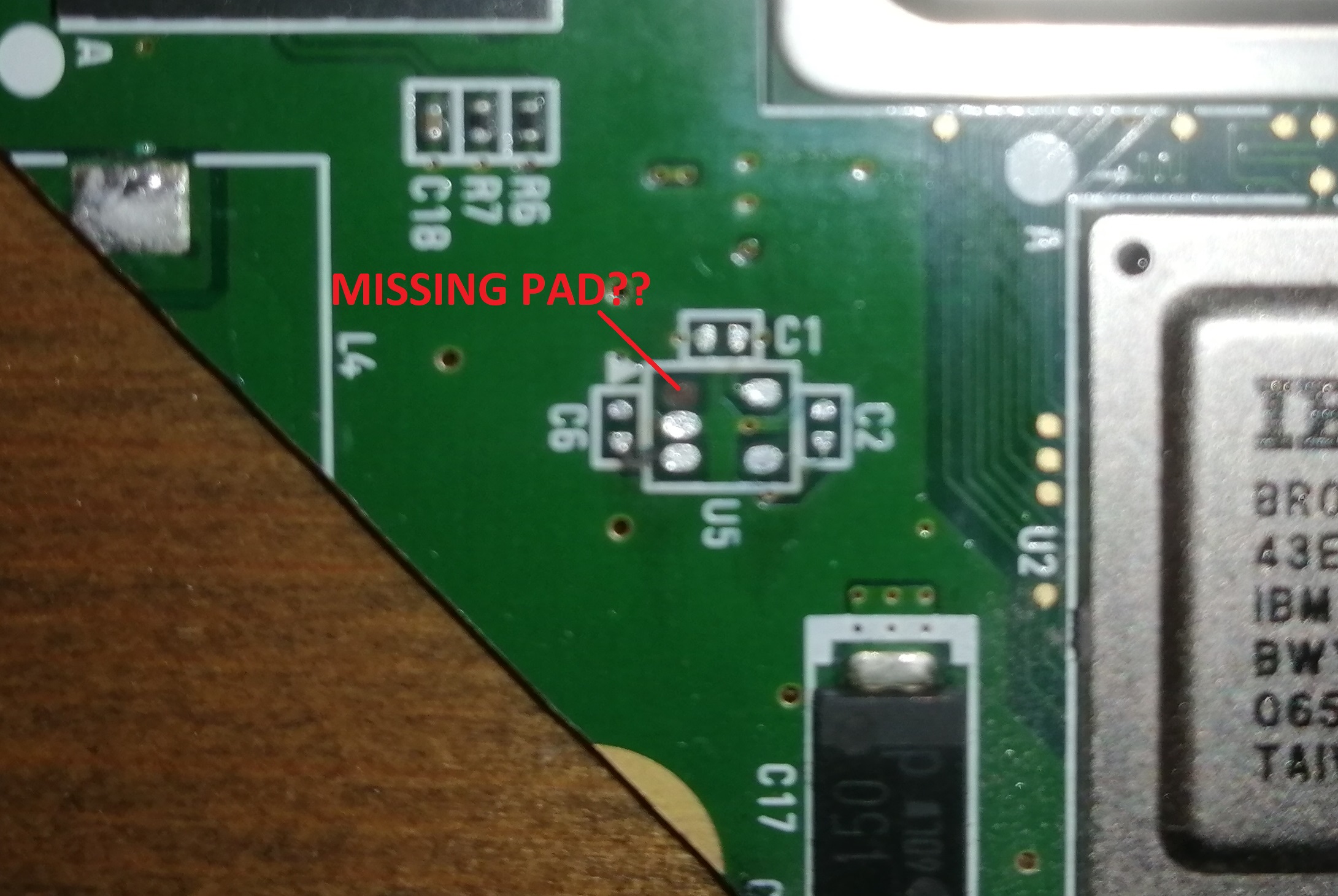

Think I've killed the U10 relocation.... it was so clean with the exception of one pad
Is this salvageable? :oops:
Yeah that's fine, the ground pads are all connected
When you say that's fine do you mean
  • It's fine there shouldn't be one there anyway
  • It's fine because all the pads are connected (elsewhere)
Thanks for the confirmation though! I was proper sulking about it being a write off.
David's morale has increased! :D
Yep, that u10 will be fine! I’d highly, highly, highly recommend switching over to a 4-layer Wii for this project. I know you’re adamant on using a 6 layer, but you’re really shooting yourself in the foot by doing so. Heat generation is almost double that of a 4 layer, and battery life is going to be minimal with an OM6 trim. It’s up to you of course, but I would never make a portable with a 6 layer Wii, particularly something as difficult as the project you’re trying to do!
