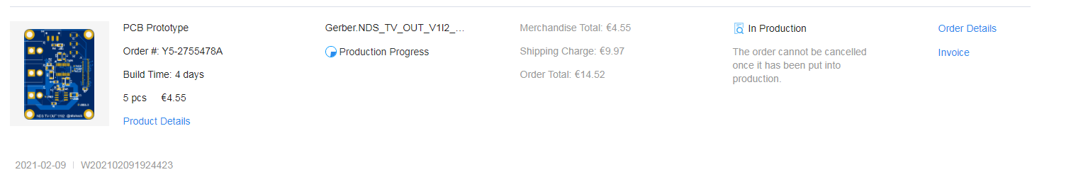

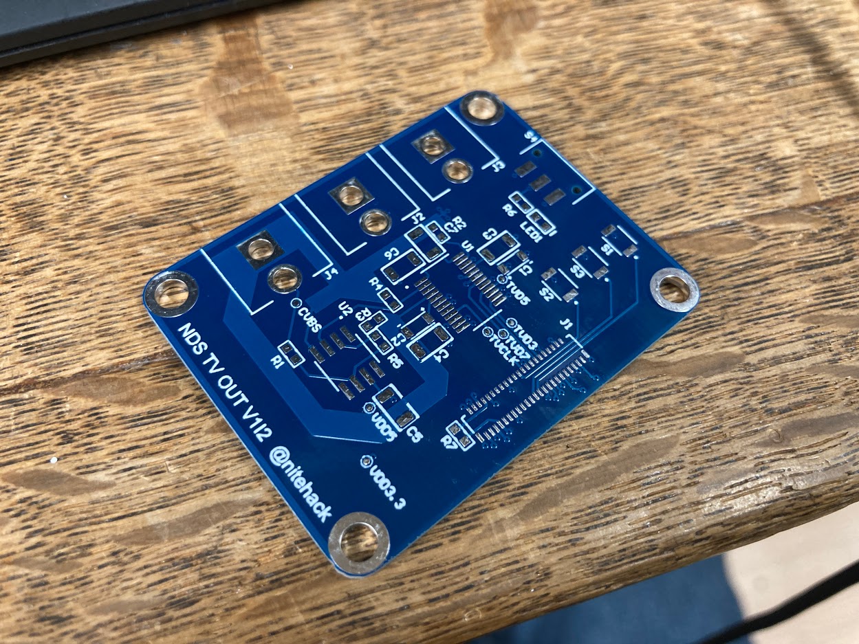

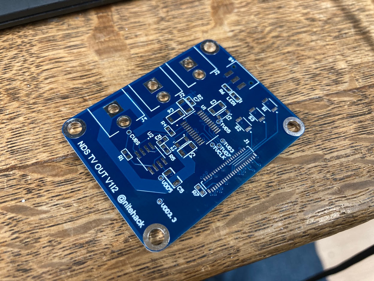

It's reasonably easy, as long as you're a little experienced with soldering. Just export the PCB gerbers from their github using Altium and order the boards using something like JLC. All the components can be ordered via Farnell or mouser, and you need aliexpress, using the BOM on the github. Do the software stuff, the new tutorial looks way easier than the old one. Then solder it together and it should work ;)
PS. I don't know why the LED on my board doesn't work, but maybe I need to update to the new software..

So like, I did it:
It's attached to this molested GBA macro that I made when I just started with electronics, but it works lol. You have to hold down A, B, select, start in order for the firmware to work, since I followed the old tutorial. Looks like that they fixed that in a new version? If so, good job guys lol

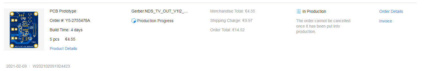

@Luca
did you see the polarity of the led? maybe you have it backwards. There is no software there, the led is an indication that the output of the DAC is enabled
We have released a patch for the firmware to have the functionality without having to do the button combination and without having to use the homebrew. I don't know if you've seen it https://github.com/LostNintendoHistory/Lost-NDS-TV/tree/main/fwpatch
Cool :) That's a giant improvement
Could be, who knows lol. The switch doesn't do anything either, maybe it's related. Or I did something dumb.

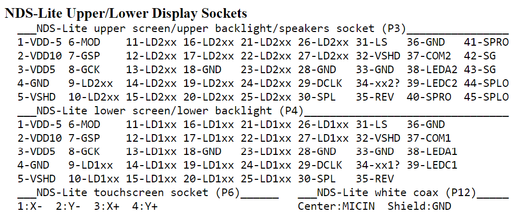

How many pins are in a Ds top screen ribbon cable? I’m looking for a long one.
The BOM in the github has a link for the correct cable I think.
