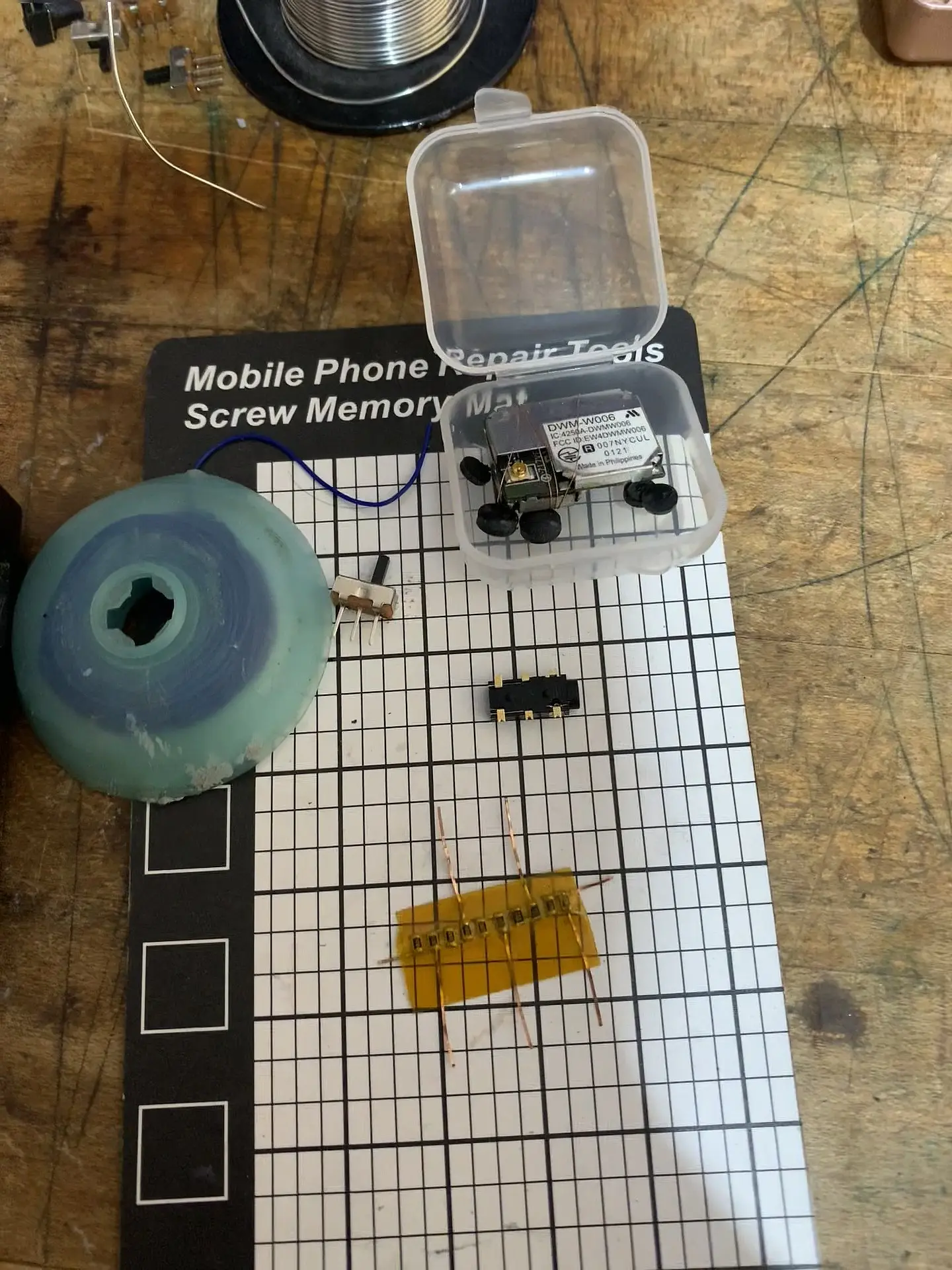

Is a DS Lite with the video mod, but I didn't want to lose the upper screen, so I needed to add the dual wifi mod and have 2 different firmwares.
Tools. -
  • Hot iron
  • Solder wire
  • jumper wire
  • Flux
  • 2-position switch
  • 1 push button
  • A Dremel tool
  • 1 TRSS 2.5mm connector
  • UV curable solder mask
  • T-7000 Adhesive
  • Krazy kola
  • A modded Wi-Fi module
  • 6 470Ohms resistors
  • 4 220Ohms resistors
Log. -

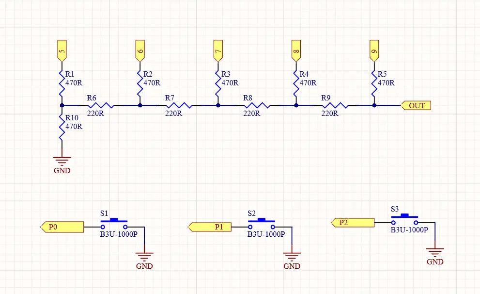

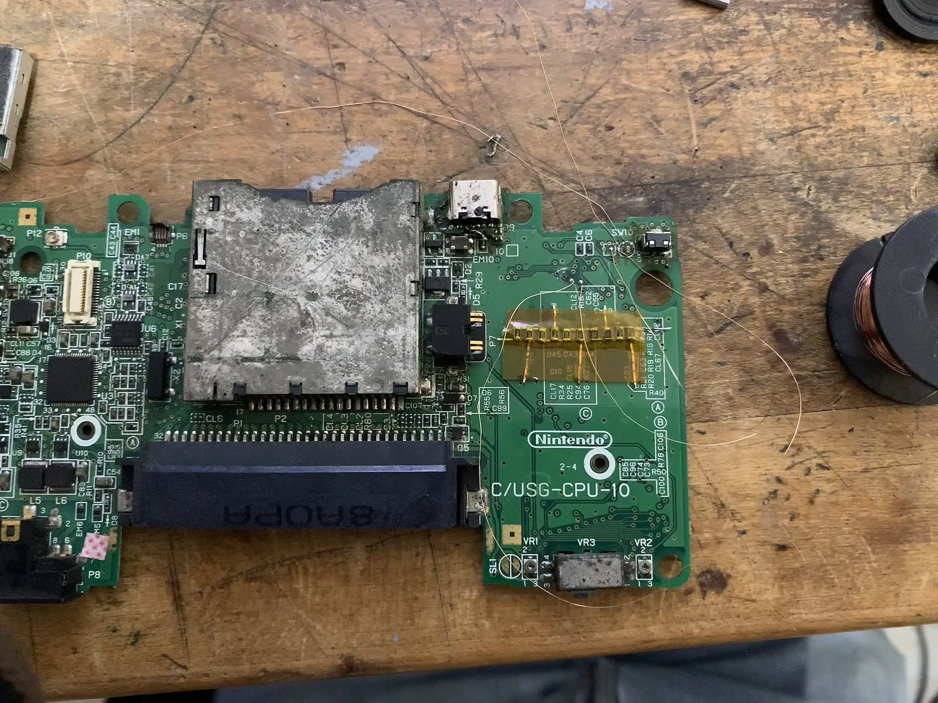

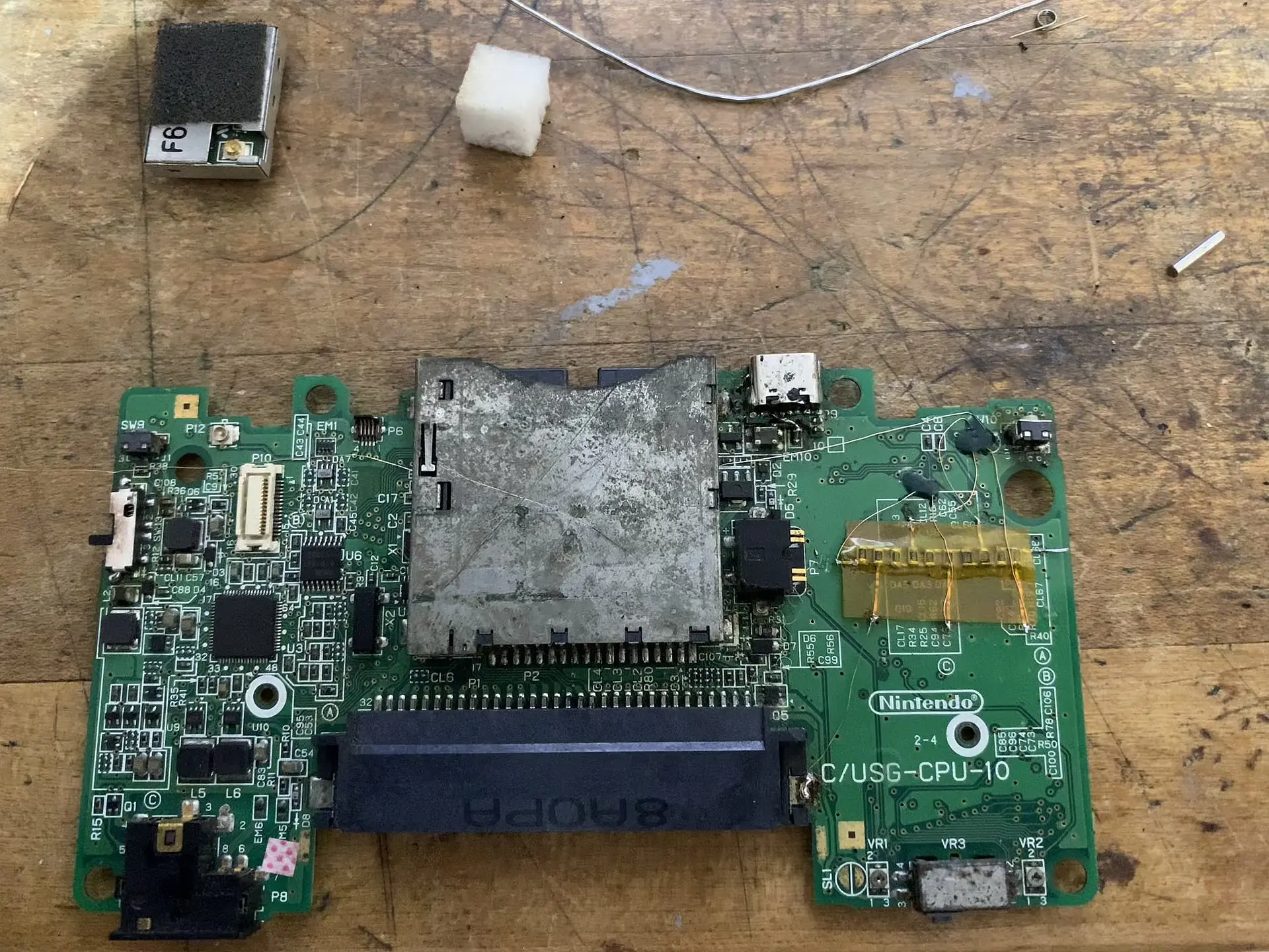

First thing I opened the DS to get to the motherboard, i soldered a circuit made from resistors to get the video signal then cured the soldered pads and VIAs.​
I already had a USB-C mod installed. (I know it looks bad but it's working)​

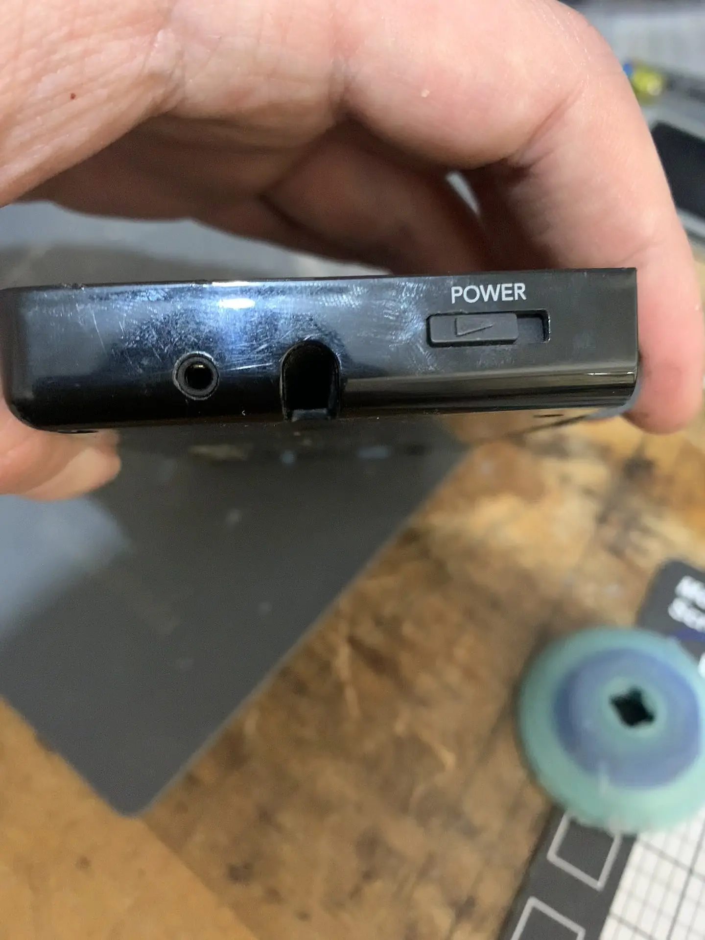

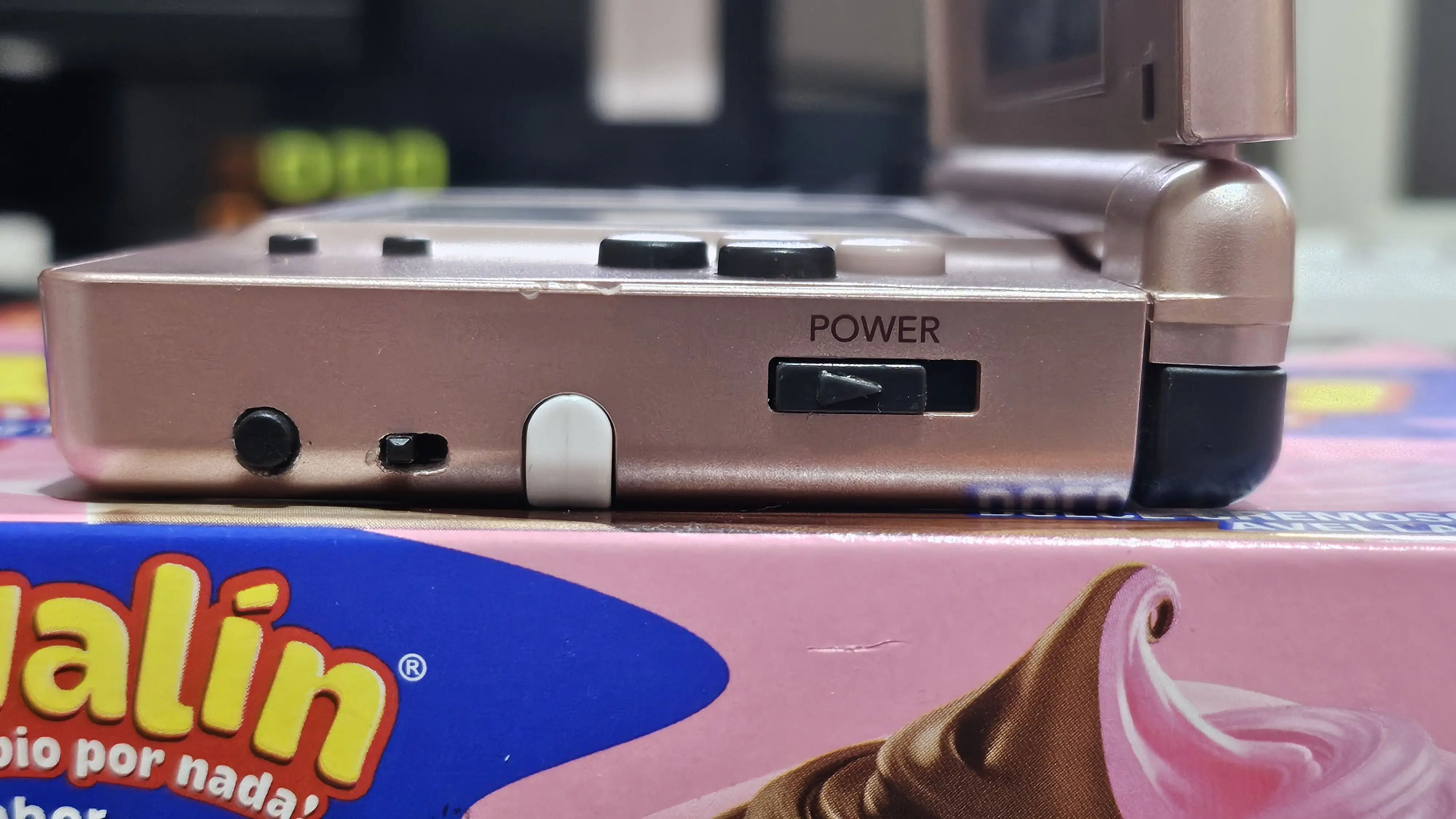

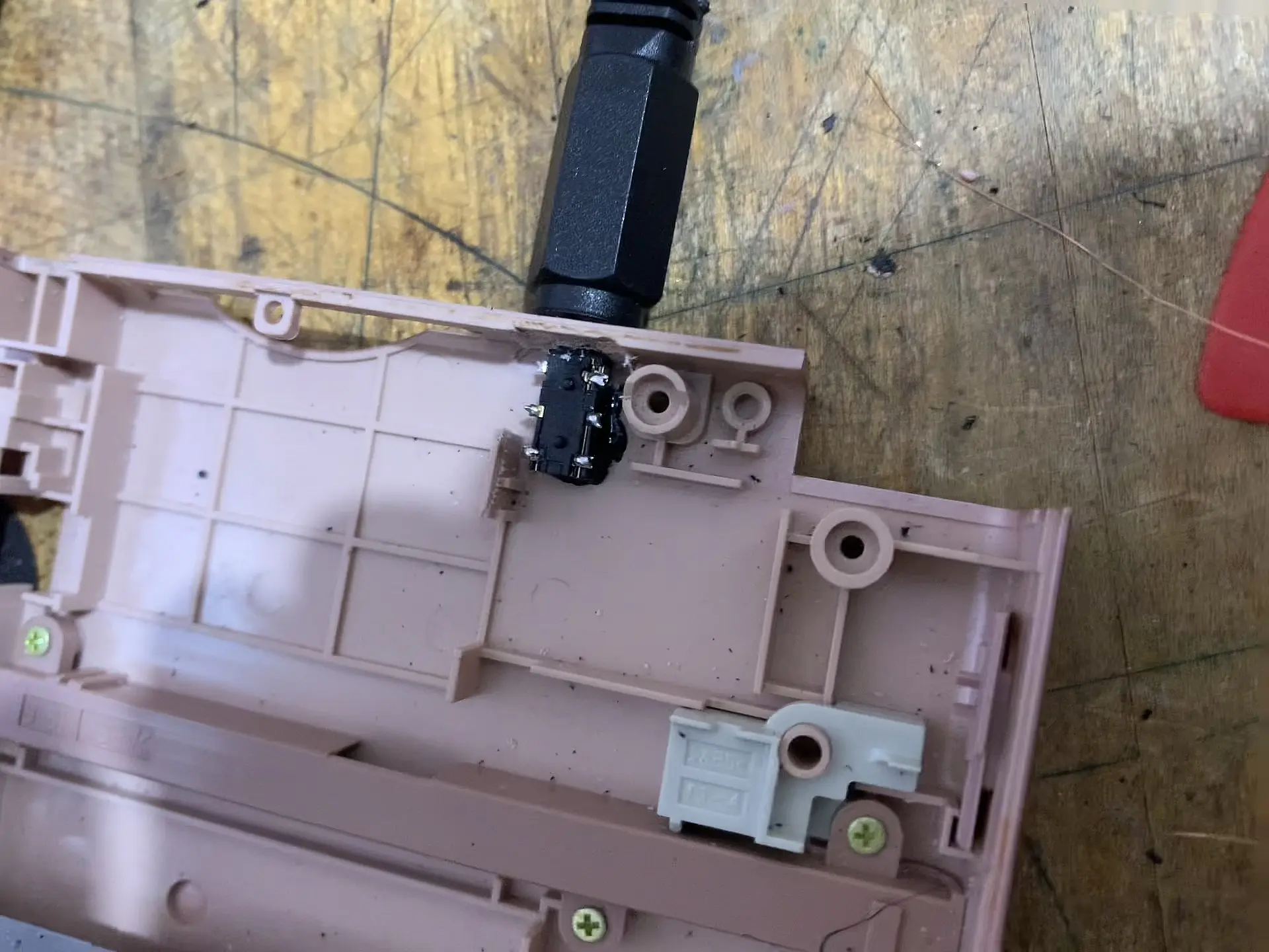

Then I tested on other bottom cases so i can plan where to put the 2.5mm connector, the switch and the button.​
I liked how it looks on the side of the case, but I tough It was going to be uncomfortable to hold while playing so I decided to put it on the top.

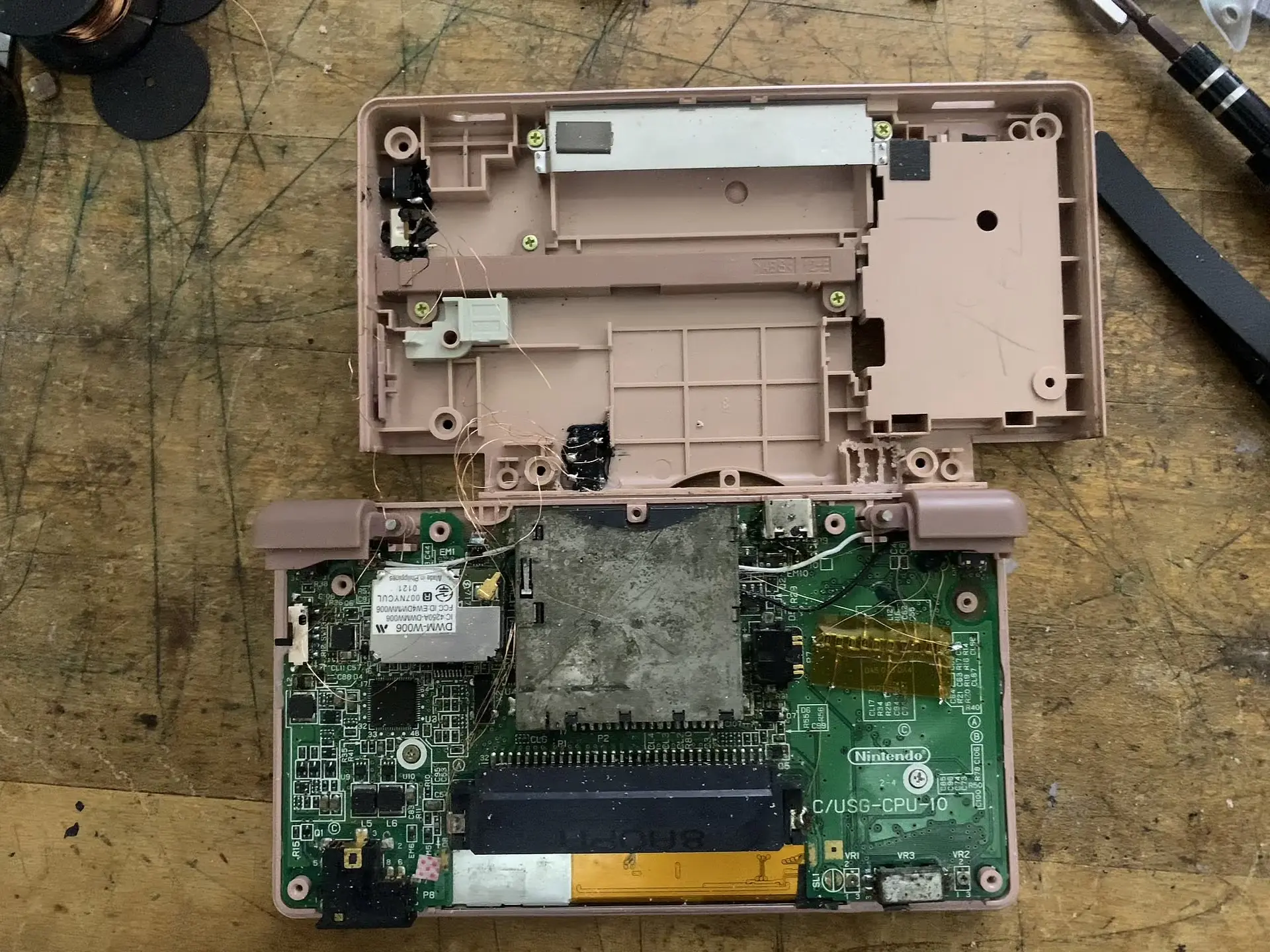

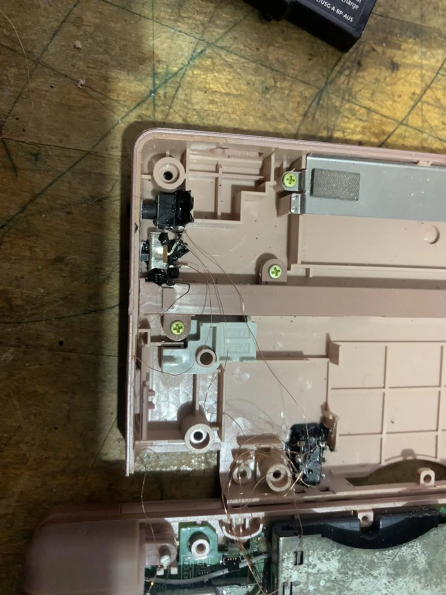

I jumped the video wire to the 2.5mm connector then the GND signal to the motherboard then I soldered SPL0 and SPR0 to the connector (sorry I didn't have pictures of that)
basically, I jumped everything.

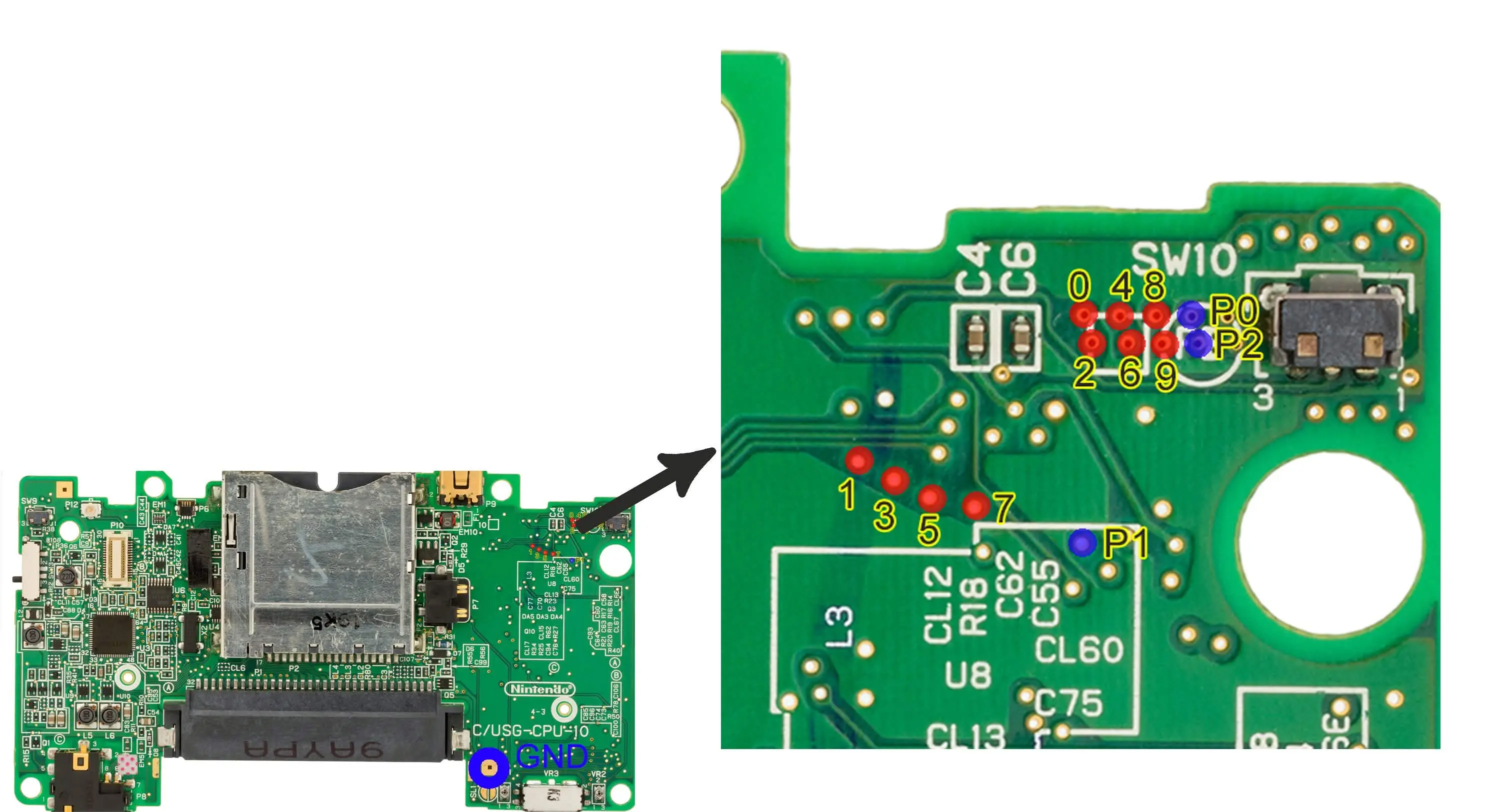

The switch's middle terminal is routed to GND also the pushbutton, I broke 1 terminal from the switch because I only needed to short the dual Wi-Fi to GND when I want to use the original firmware, if it is not shorted the ds boots with the video modded firmware.
The pushbutton is routed to P0 signal on the diagram.
I only using the P0 signal button because I don't need the PiP or the transparency functions because I will be using only the screen switching while connected to a screen, when not I can use the two screens.

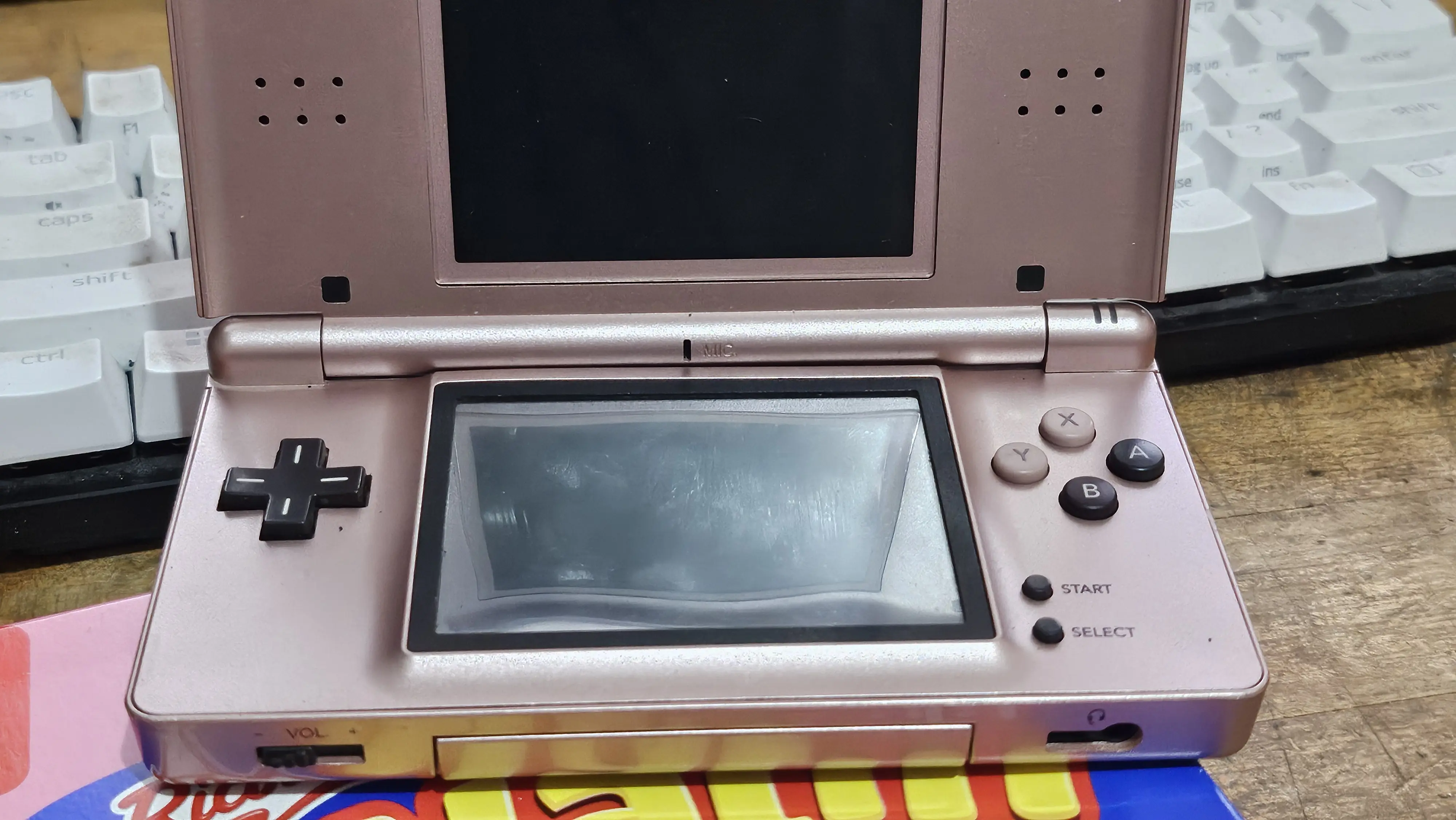

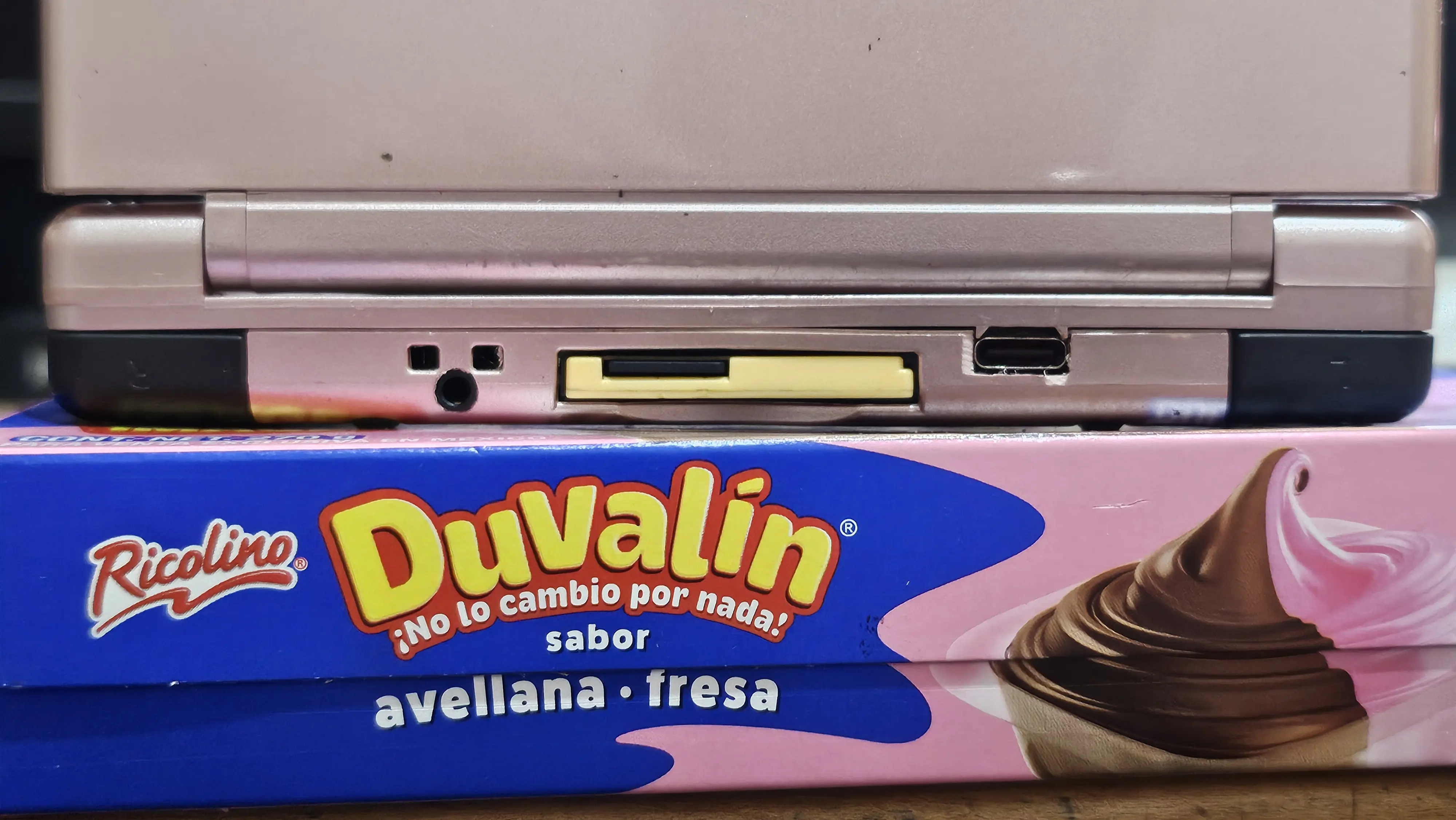

I changed some buttons to give it a cool look, I called it the Duvalin because of the Mexican candy colors and also the fact that there's 2 modes of use.
Final result. -
