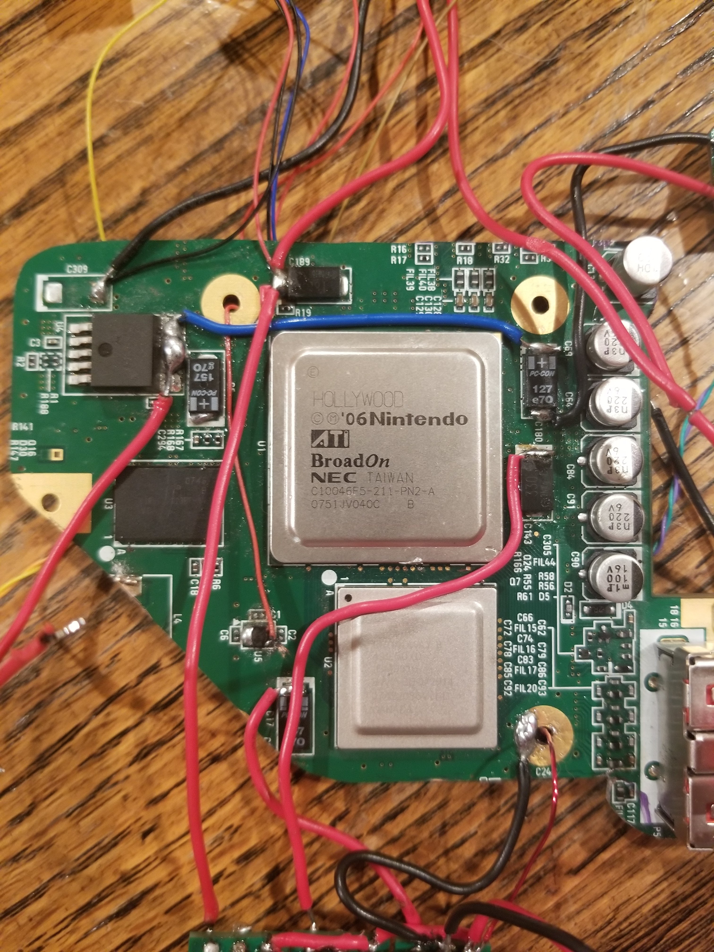

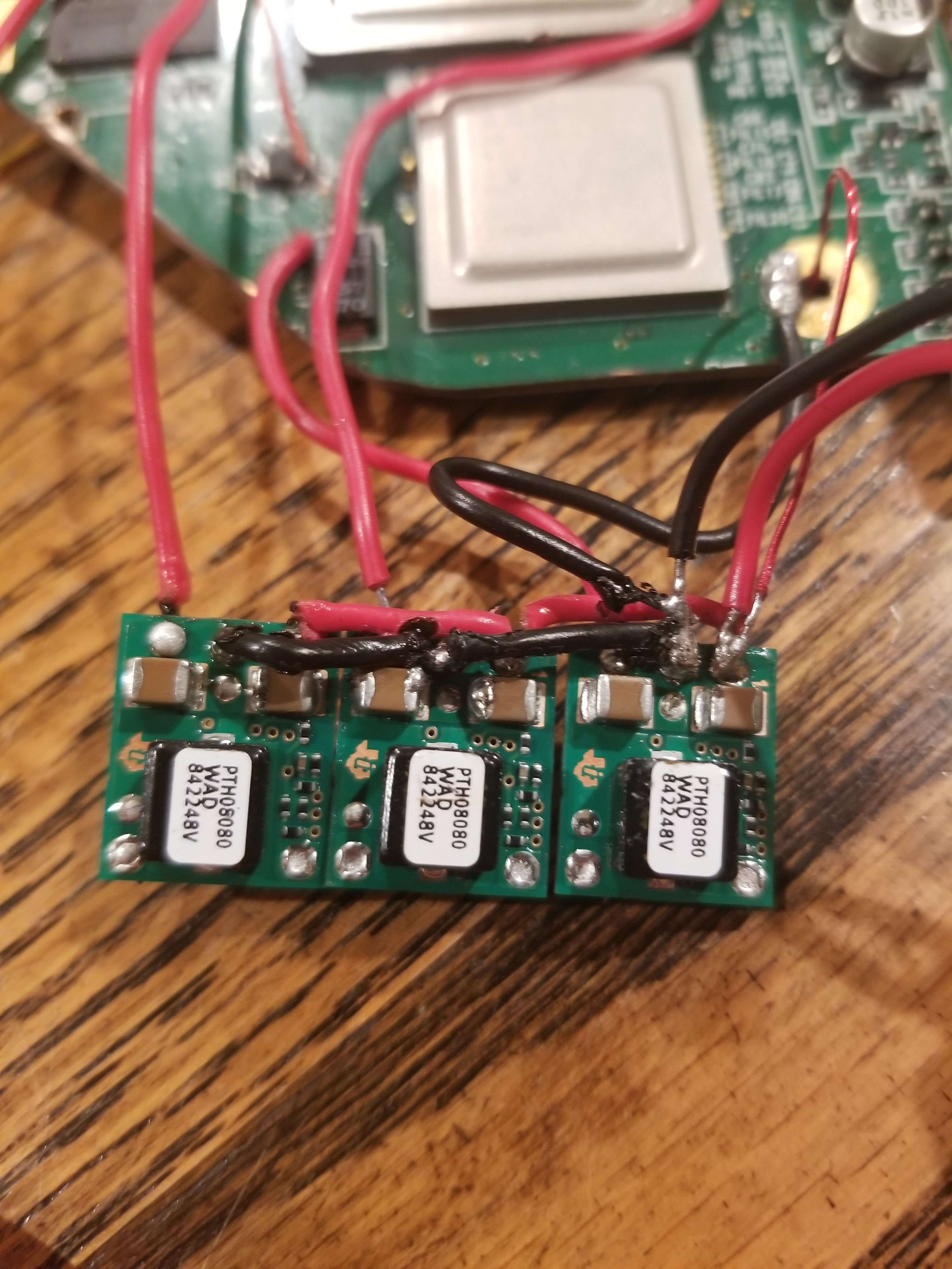

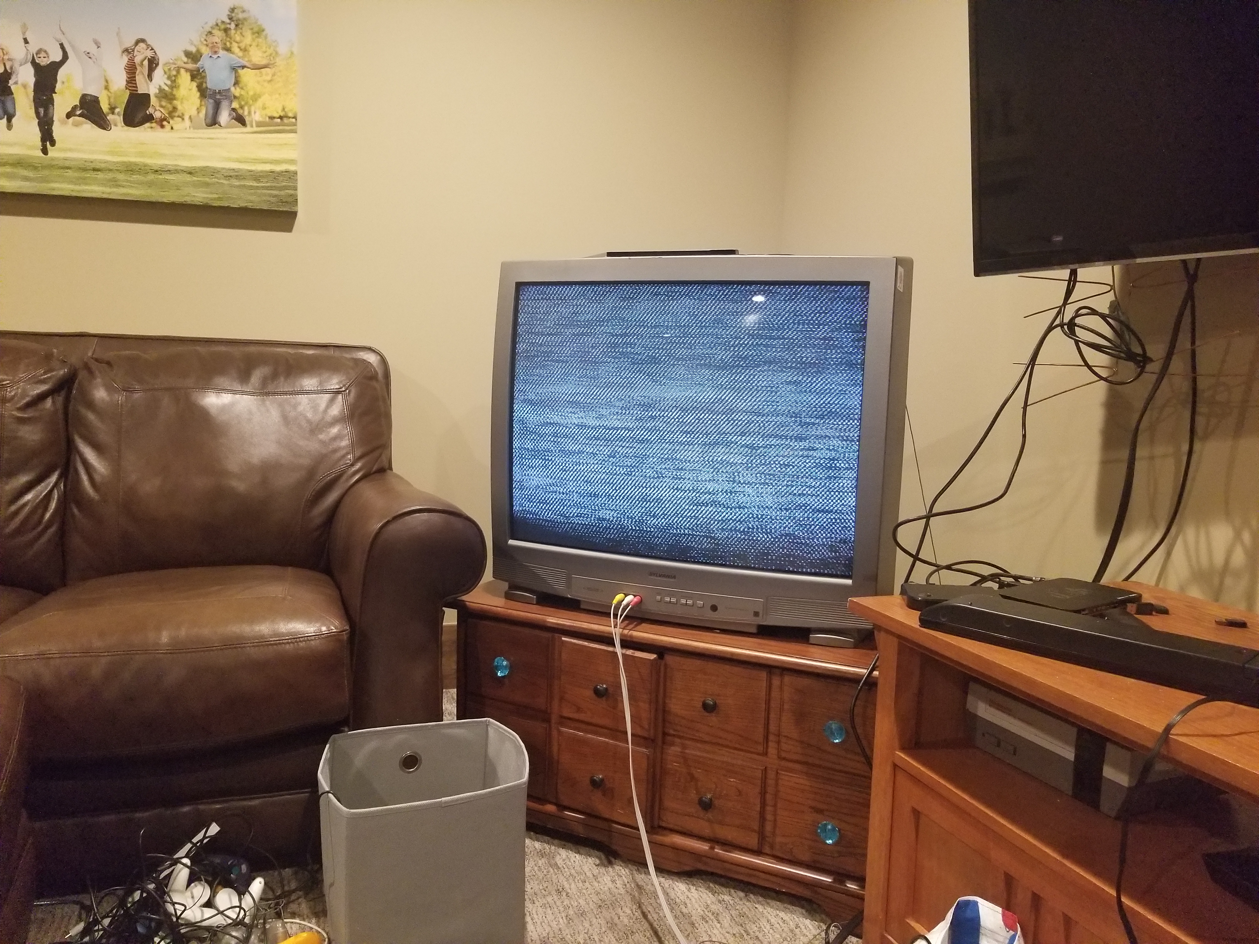

20181016_161417.jpg 20181016_161732.jpg 20181016_161754.jpg So, the voltage regulators I ordered (the correct ones this time) arrived, so I got it all wired up, aaaannnddd, I'm pretty my wii is dead :(
All the wii outputs on the video is static, like before, but this time I checked all the voltages and they are stable at what they are supposed to be. Additionally, the CPU & GPU get much hotter than before. I assume this means It's actually doing something, as it did not get very hot before. I'll attach pics in a sec.
Edit: Ew, my crappy wire looks gross up close
Time to find a new wii !

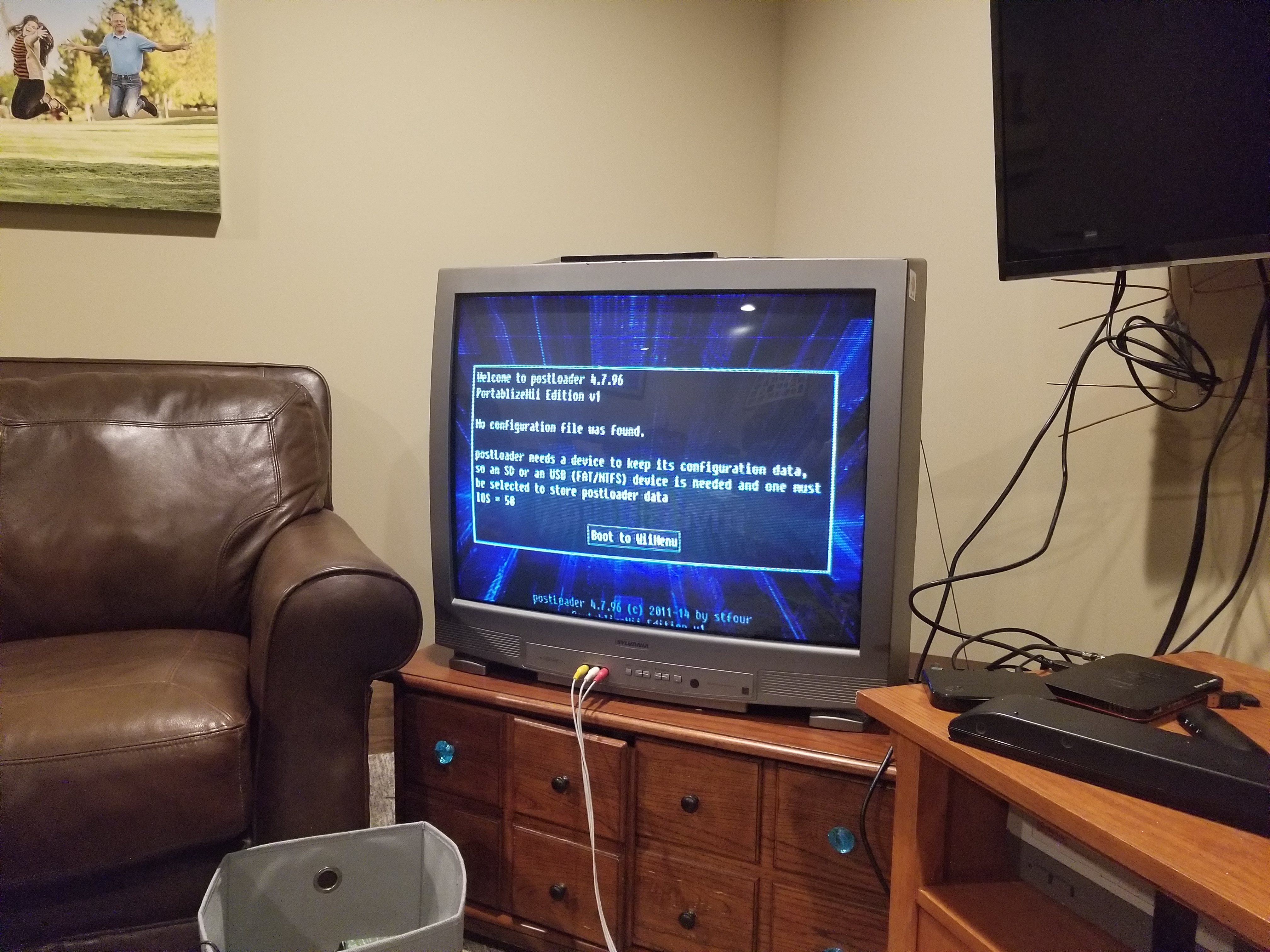

Oyes, thanks to @BocuD on discord, I got it working! He is truly a god of debugging. My U10 was at 1.45 volts

I wouldn't say god lol, this is just what happens when you first break (and then fix) so many Wiis. The U10 wasn't the only problem, as the 3.3v reg was, well, fucked and didn't work correctly. The resistors are apparently on the bottom, so that why you couldn't see them @cheese
