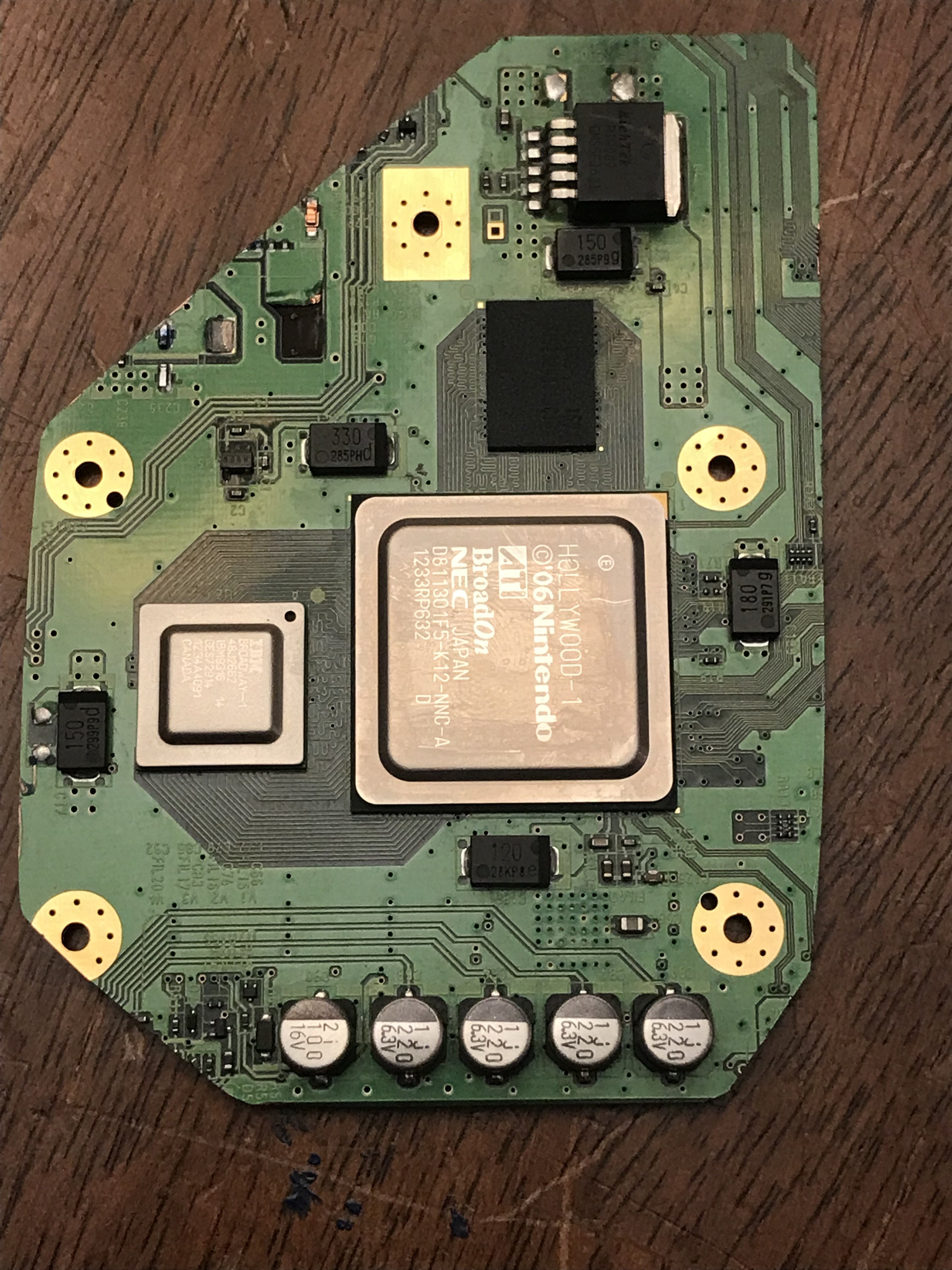

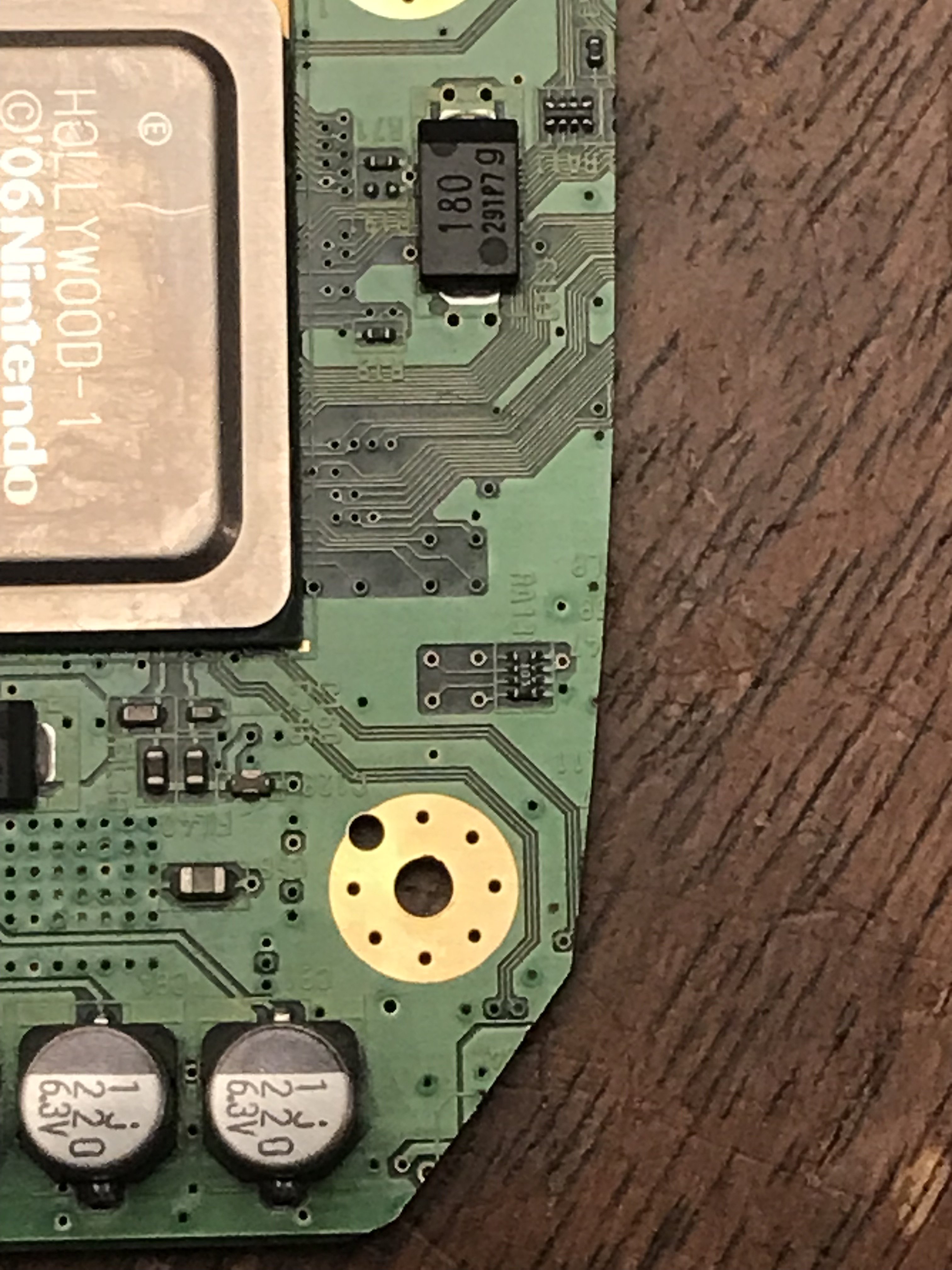

Hey everyone I have started working on my first portable, an altered gboy. Anyway I made the MOBO cut and wanted to know how I did. Please point out any mistakes or things I should do or change about this trim. I am slightly concerned about the long edge as i may have cut close to a trace on the board (2nd pic)
thanks

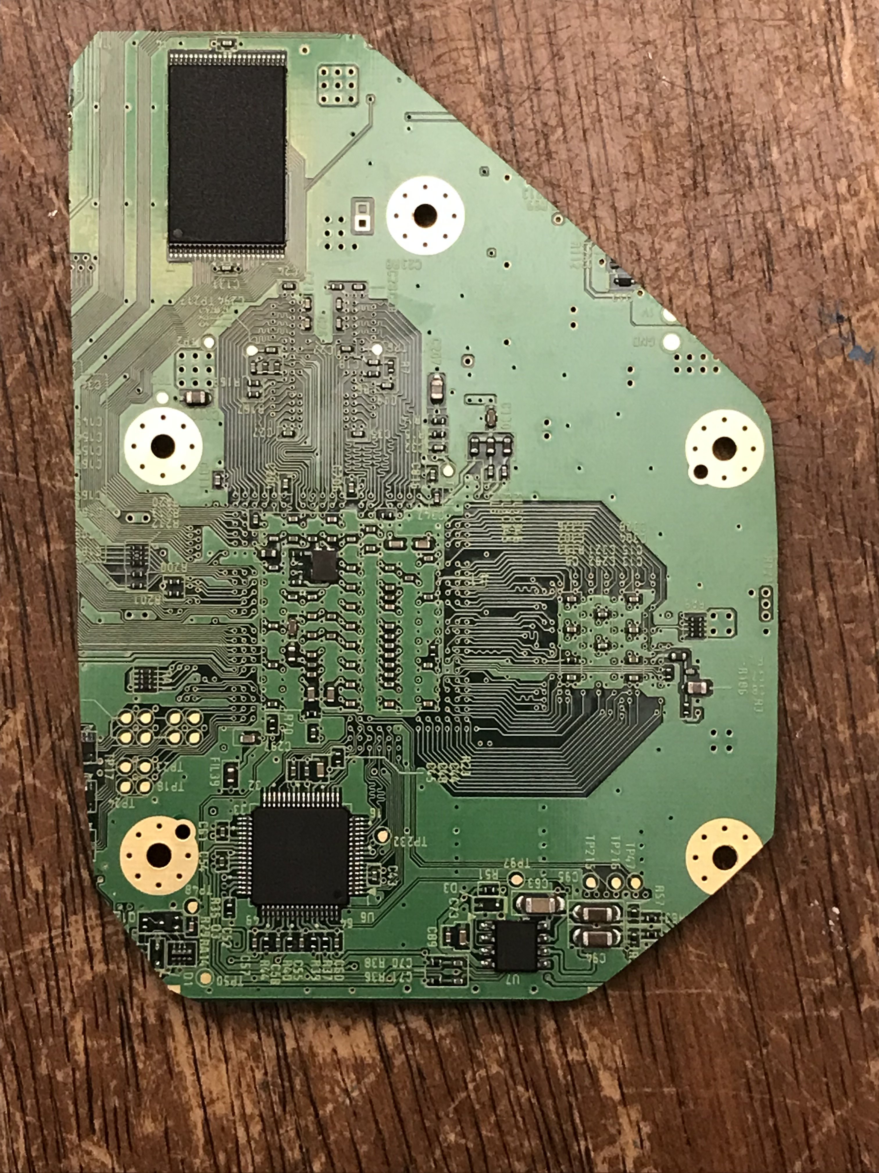

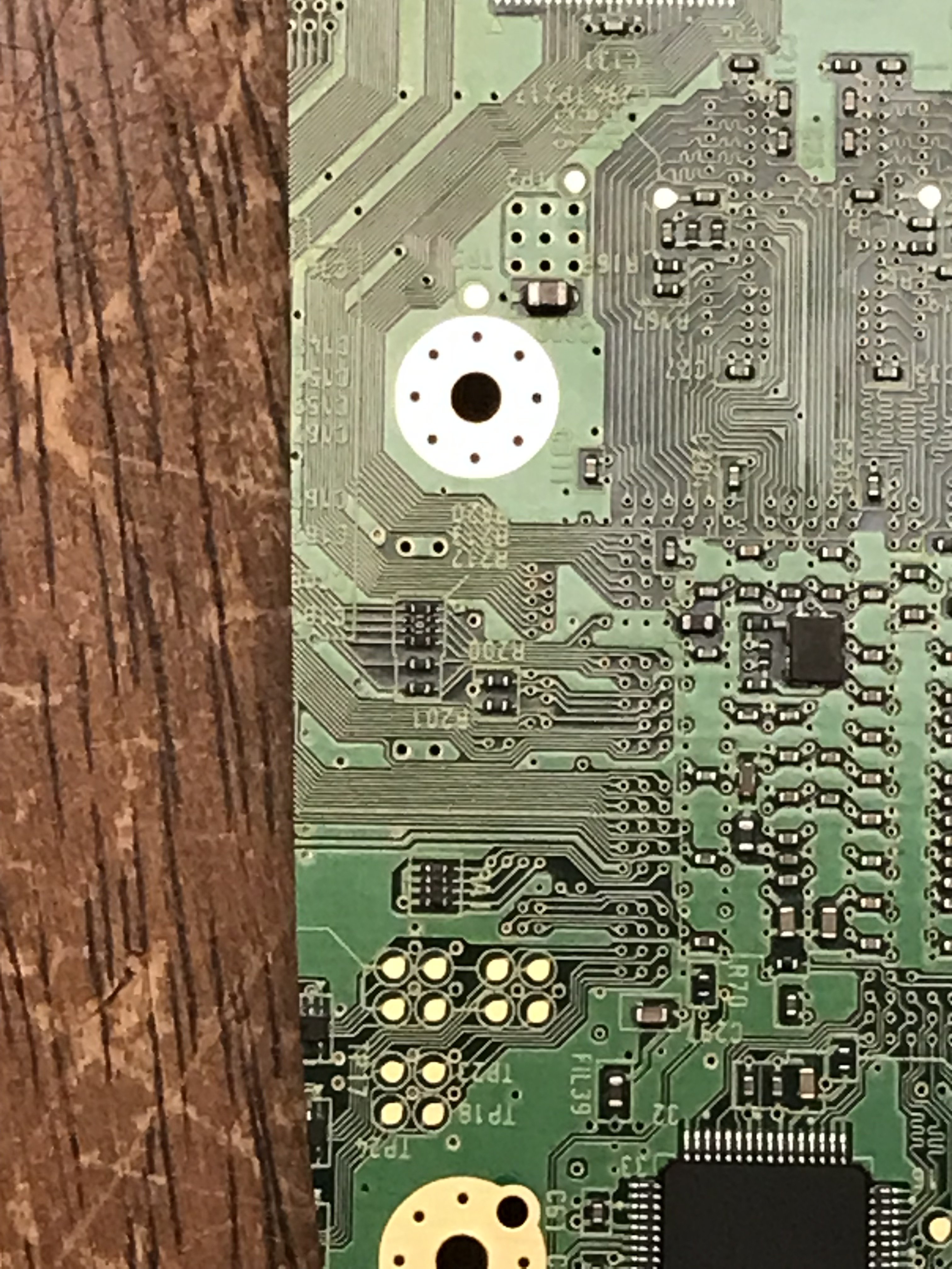

Can you upload a pic of the back of the board? I think you trimmed a little too far on the long side, you might have cut into your nand traces. You also cut off one of the USB lines, but that's not an issue. You can just use the other set.
shoot yeah here are more pics
