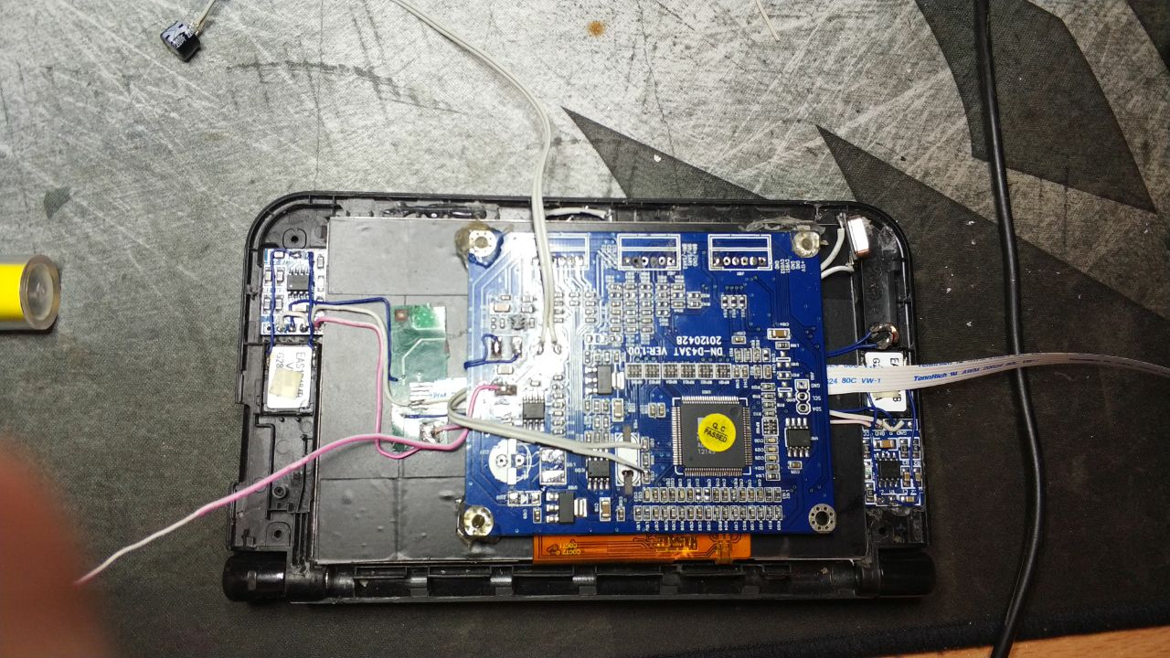

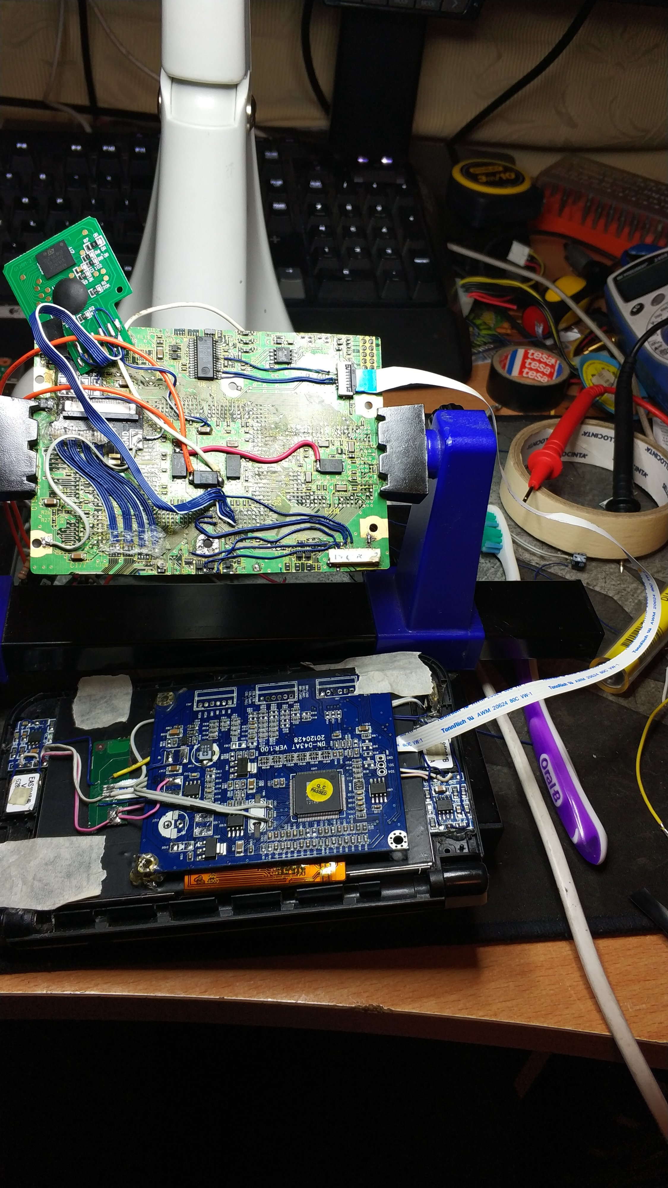

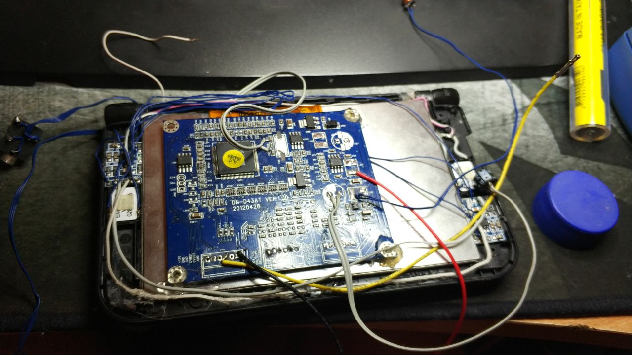

Worklog My first GCp
Little update.
making some order in this portable.
Before:
After:
this time, I'll take off the headphone jack
Looking good!
